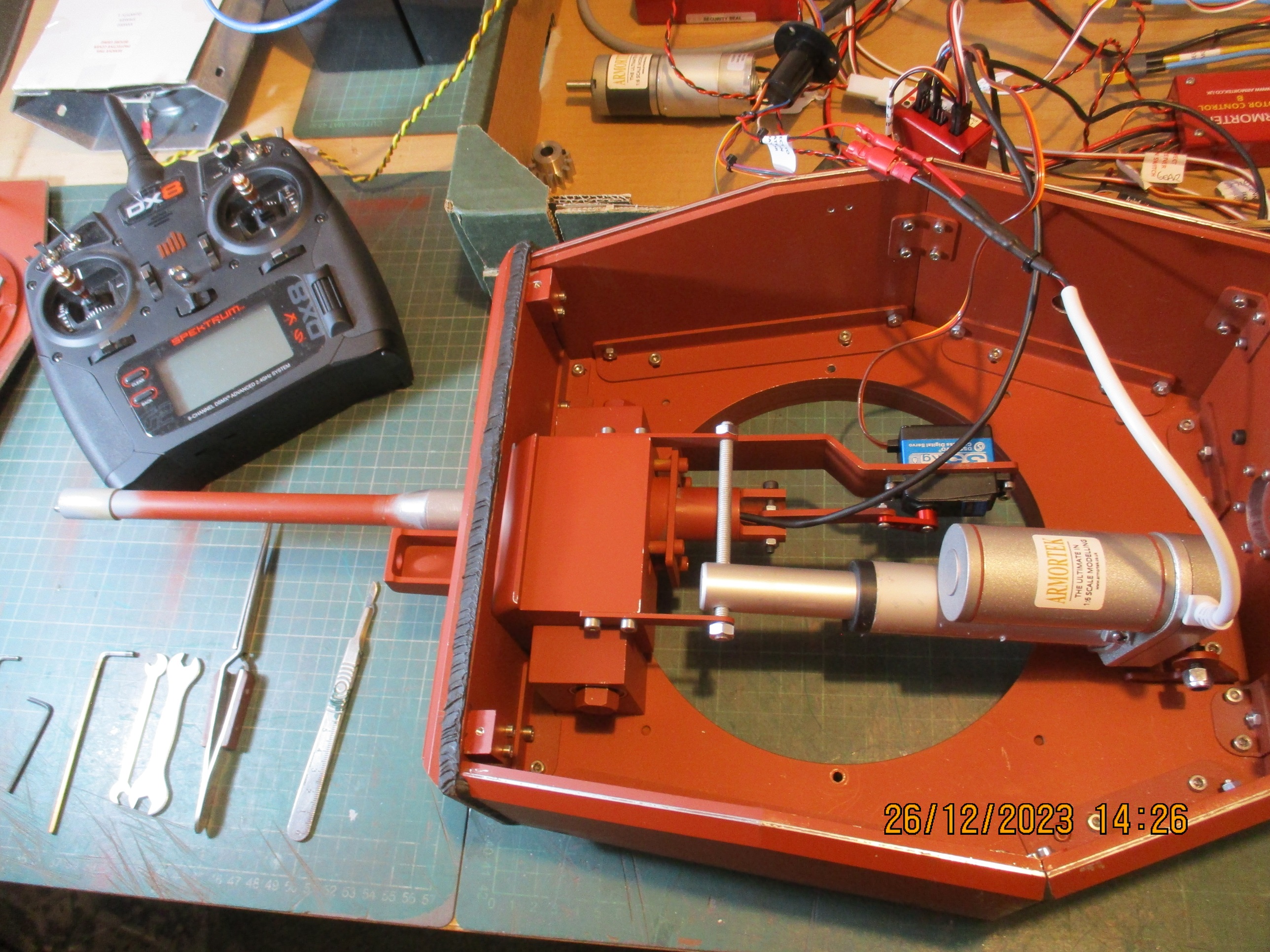

Good morning everyone, a trip to the Royal Shrewsbury Hospital eye clinic this morning, feeling much improved....
Yesterday unable to go a day without messing with the Churchill...I tested the elevation and recoil systems. Both working a treat, never in doubt, Armortek at it finest. The Linear Drive is as smooth as silk and a big improvement....love it.

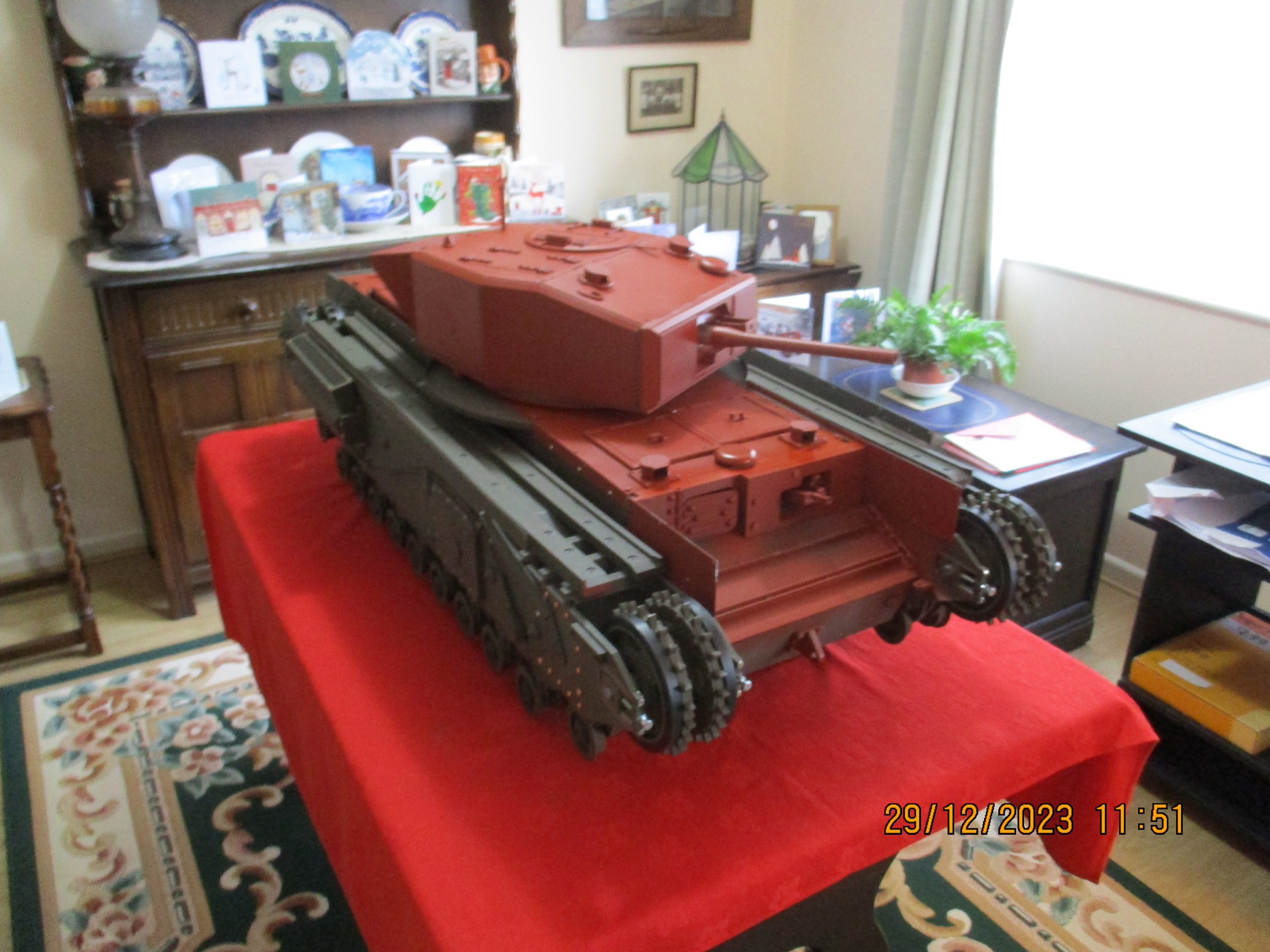

Re: Mick's Churchill (57)

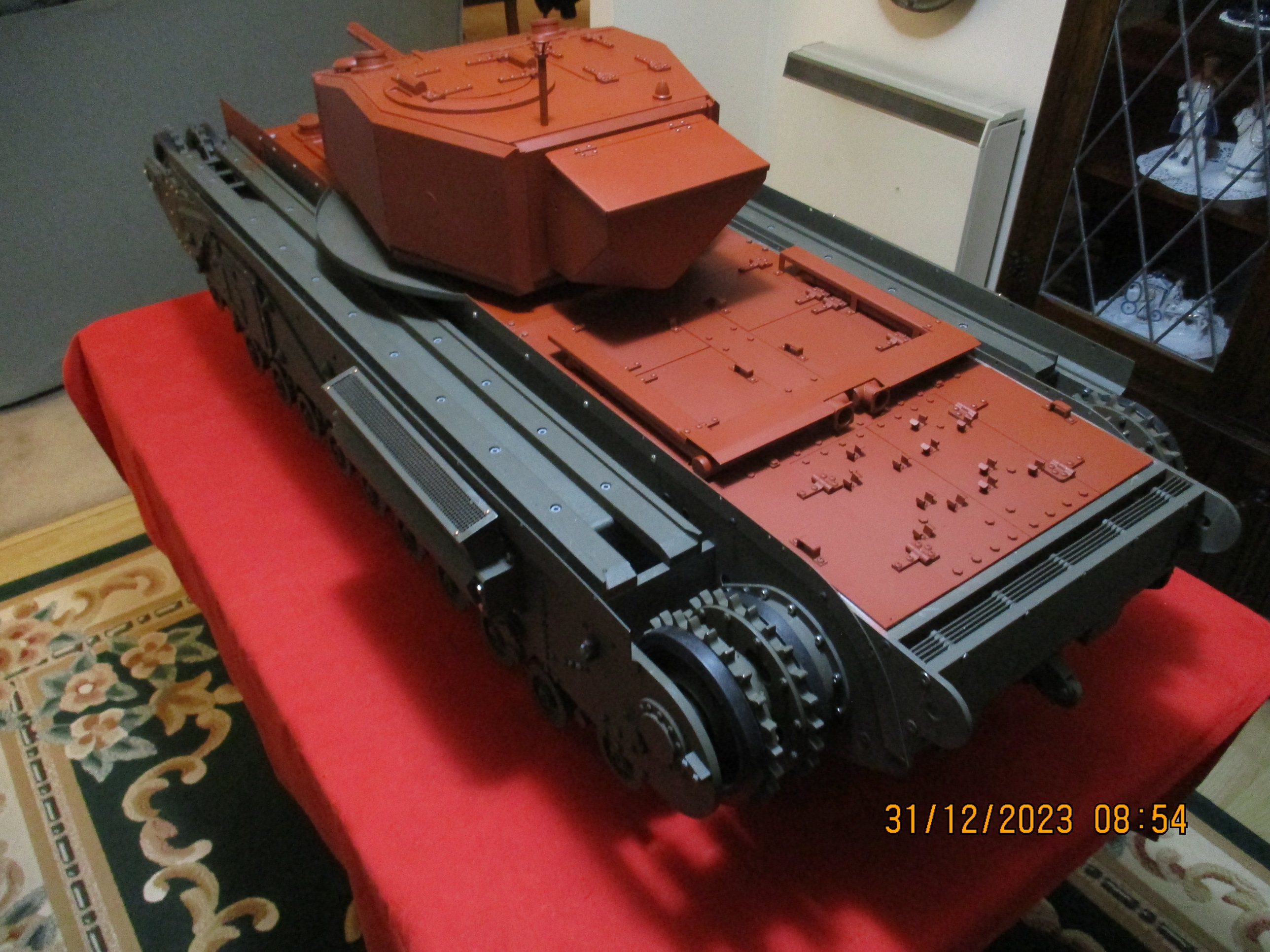

Good morning men, more or less recovered following my trip to A&E. Spent a couple of hours with my trusty rattle cans, I am using Simonize Acrylic Red Oxide must be the smoothest finish I have ever achieved.

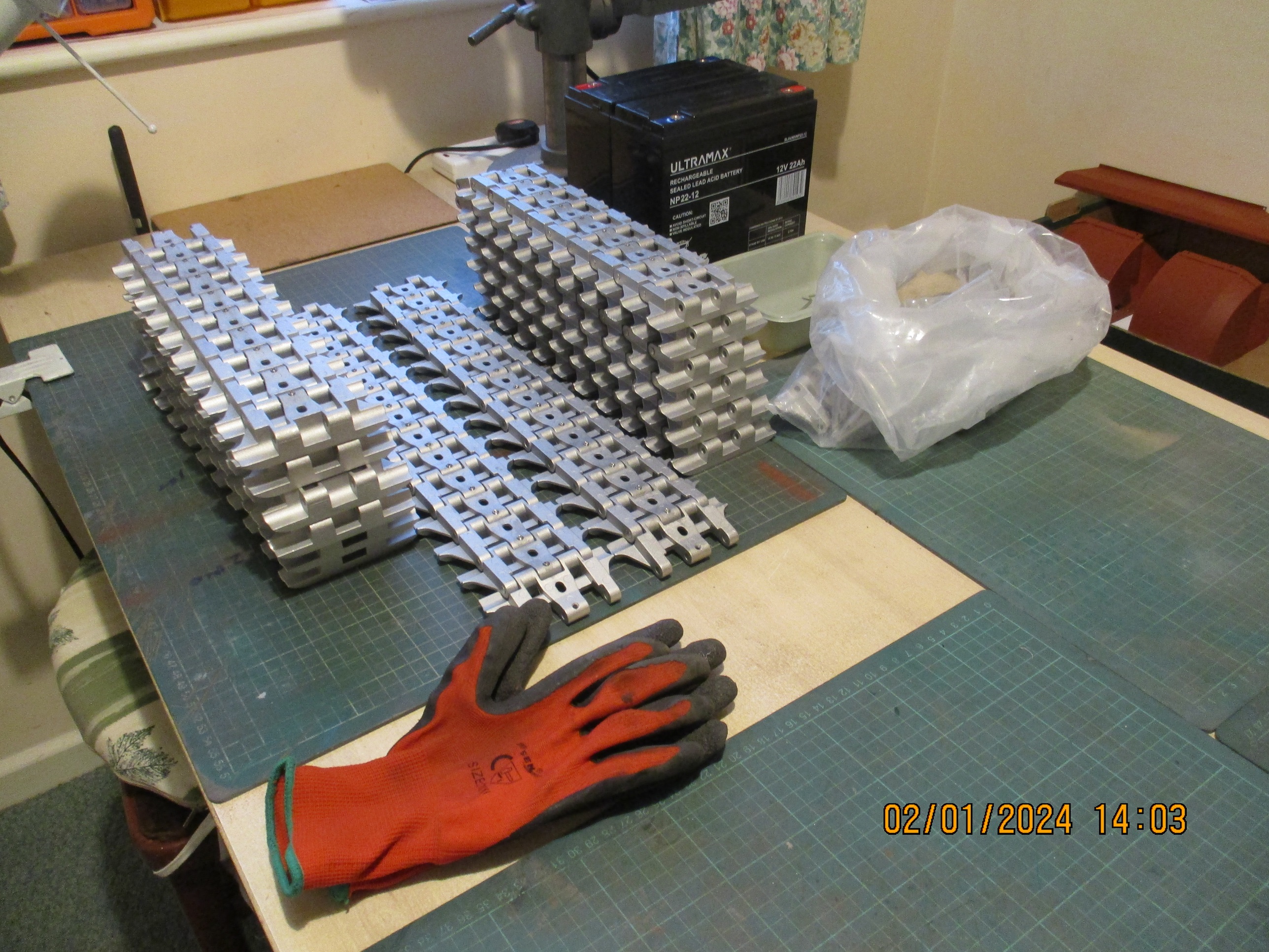

Now for a change, I have the tracks to assemble, anyone noticed how 'clean' today's tracks are.....oh, for the old days....things were different in my day
Happy New Year you happy breed, this band of brothers, keep safe.....Mick

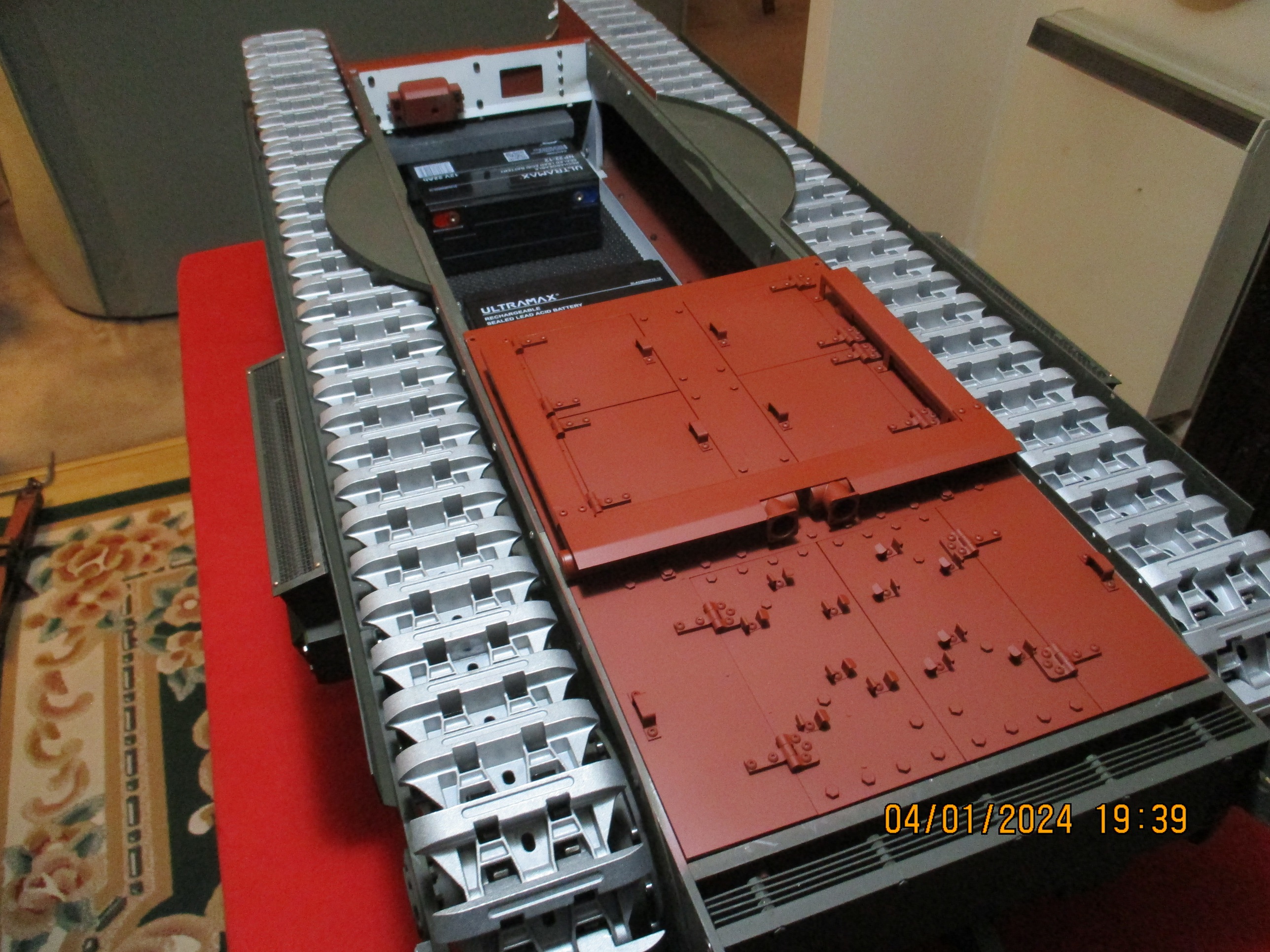

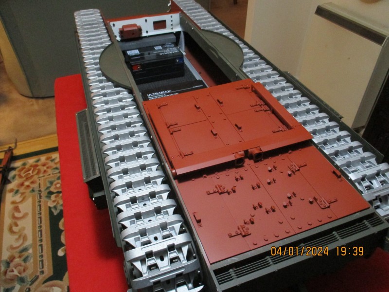

Good morning men, my, what a change in the weather, lovely day so far. Just a trial fit of the tracks...Mick

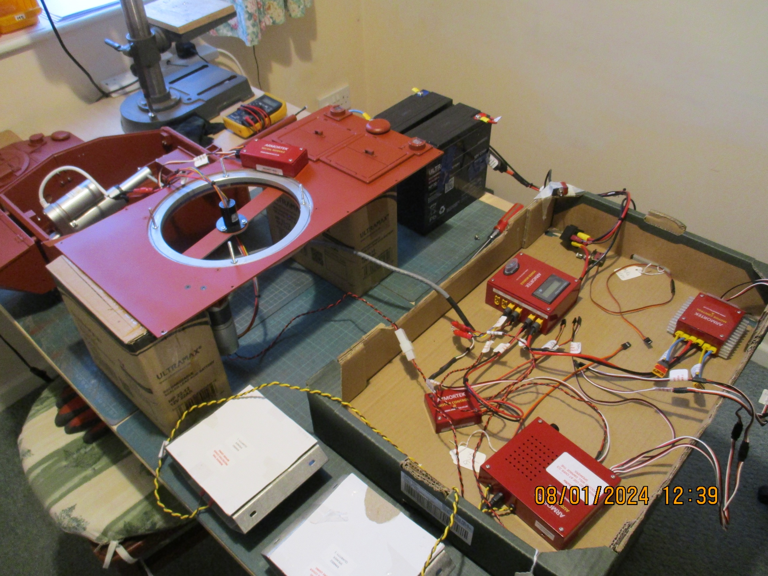

Good evening lads, thanks for that Adrian
Throughout my long and eventful life I have had this habit..... when the occasion arises..... of cocking things up. I know we all have our moments....I just appear to have more than my fair share

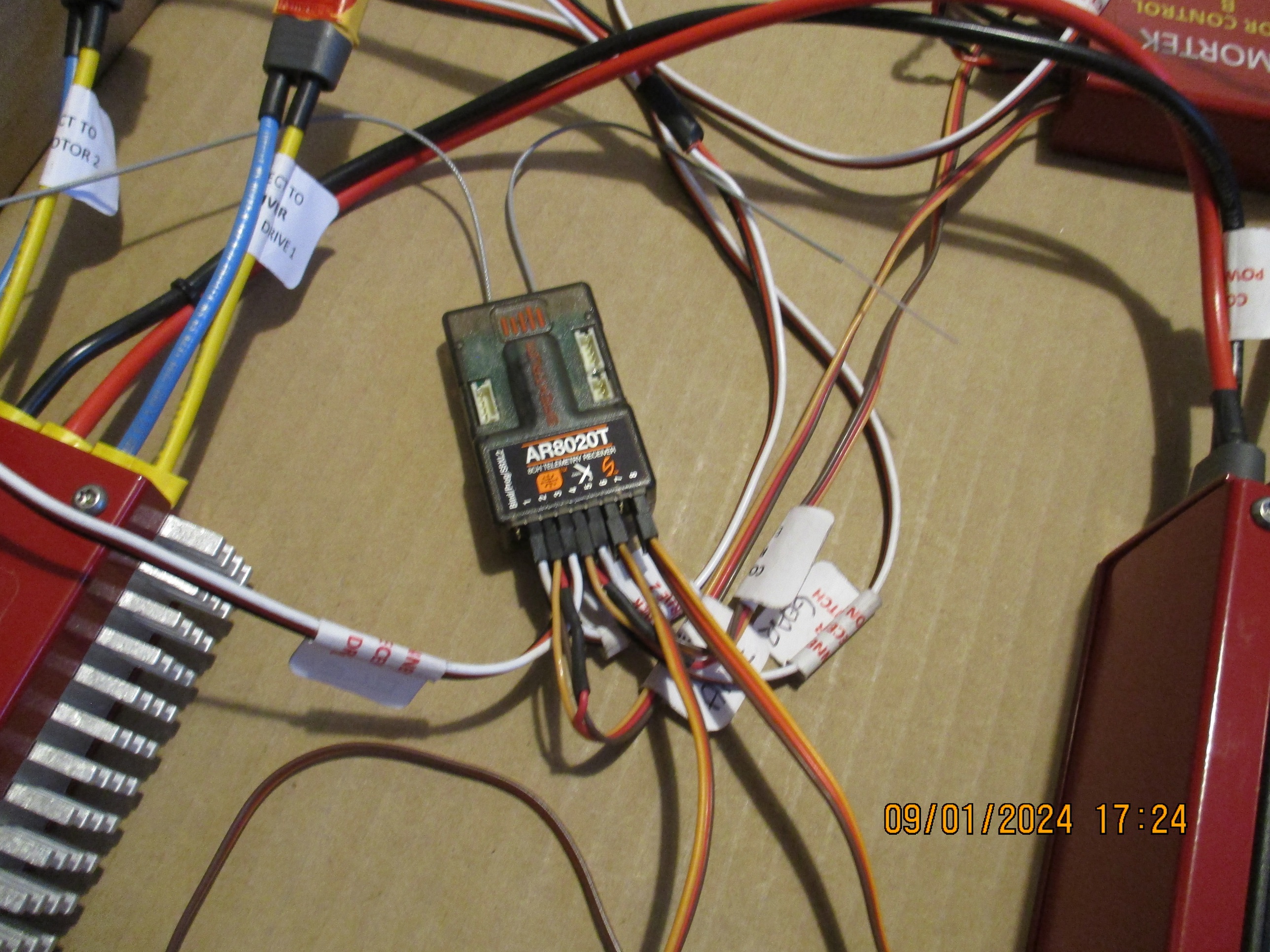

To begin....as you will have no doubt seen, I have begun the first install of my motion packs. Not very successfully, but a start nonetheless....enough of this twaddle....the batteries are in the hull and the red boxes laid out. I was peering into the hull at my first efforts when I noticed one of my Spektrum receiver aerial wires ( exposed ) was lying dangerously close to one of the positive connections on my SLA batteries. With shaking hand I slowly grasped the receiver.....now you know what a firework sparkler looks like when first lit.....
I will order a replacement receiver tomorrow......I just hope the motion packs are ok.......Mick

Sorry to hear that Mick.
"It happens"
fingers crossed, nothing else cooked.
BTDT but with a Frsky X8R antenna, which are a length of circuit board with exposed plated through holes. I now cover them with a length og thin clear heatshrink tubing. Once bitten...
There wasn't any damage done to the tank but I replaced the receiver just to be sure, as it might have only been operating on one antenna.
Good morning everyone and thank you John, Adrian for your replies. Hopefully i will not make that mistake again. I have tried to resuscitate my receiver, to no avail.....R I P my friend.
I decided to decamp the batteries, red boxes, etc, back into my workshop to await the new receiver ( ordered ), and have a review/reset, . The latest Rx looks to have the much shorter aerials already covered, anyhow I will check.....of course.....Mick

Good morning men, just a quick update....Spektrum receiver arrived this morning....tested....all is well. I guess the original receiver '' took one for the boys''.
Need a sit down and a cup of tea....it's a simple learning issue, and on both my other models I have taped over the battery terminals....older, but non the wiser
...Mick
