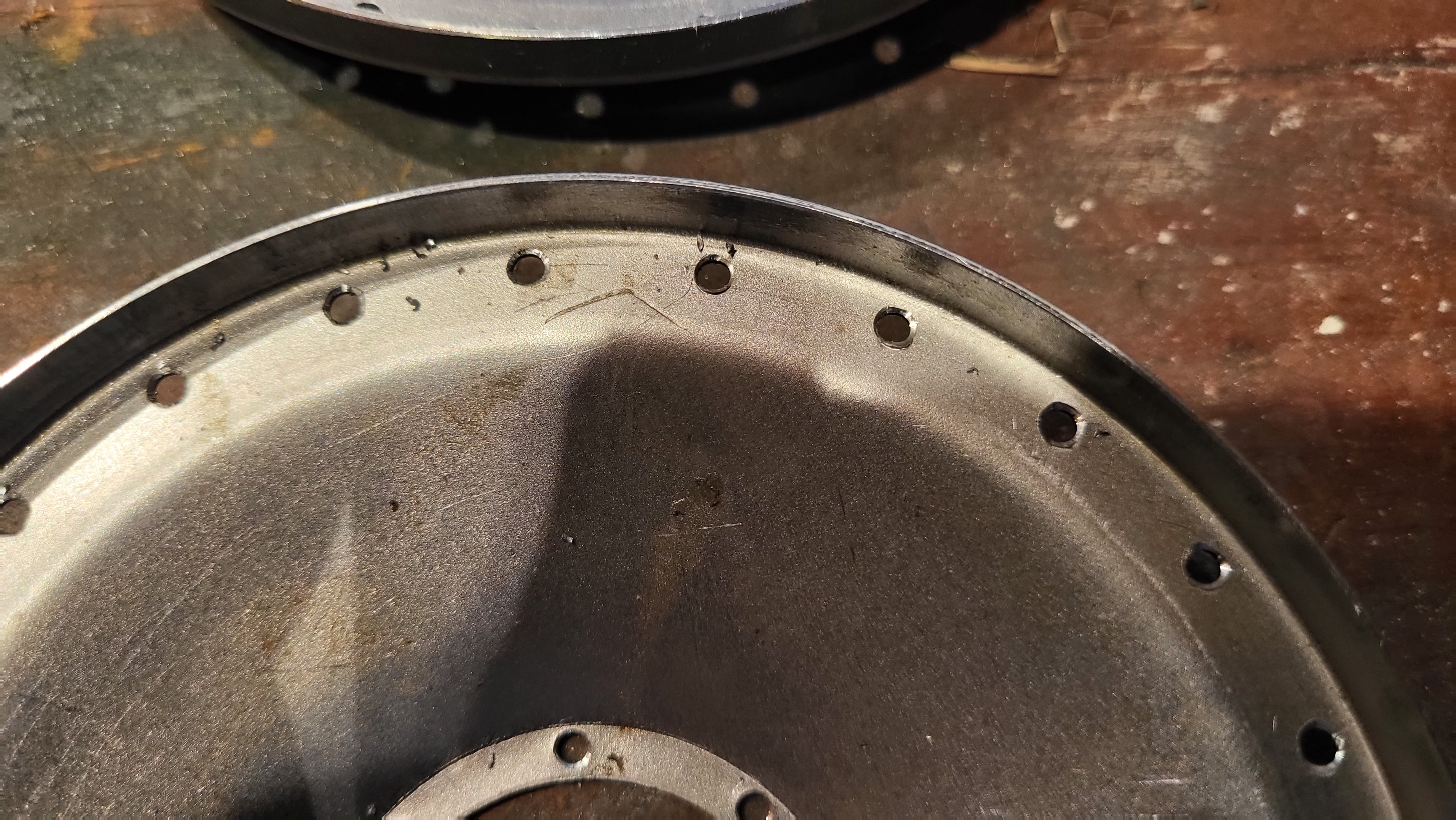

Wheels are still ongoing lost track of how much time taken so far.
Hopefully have them ready for priming In the next week or so.

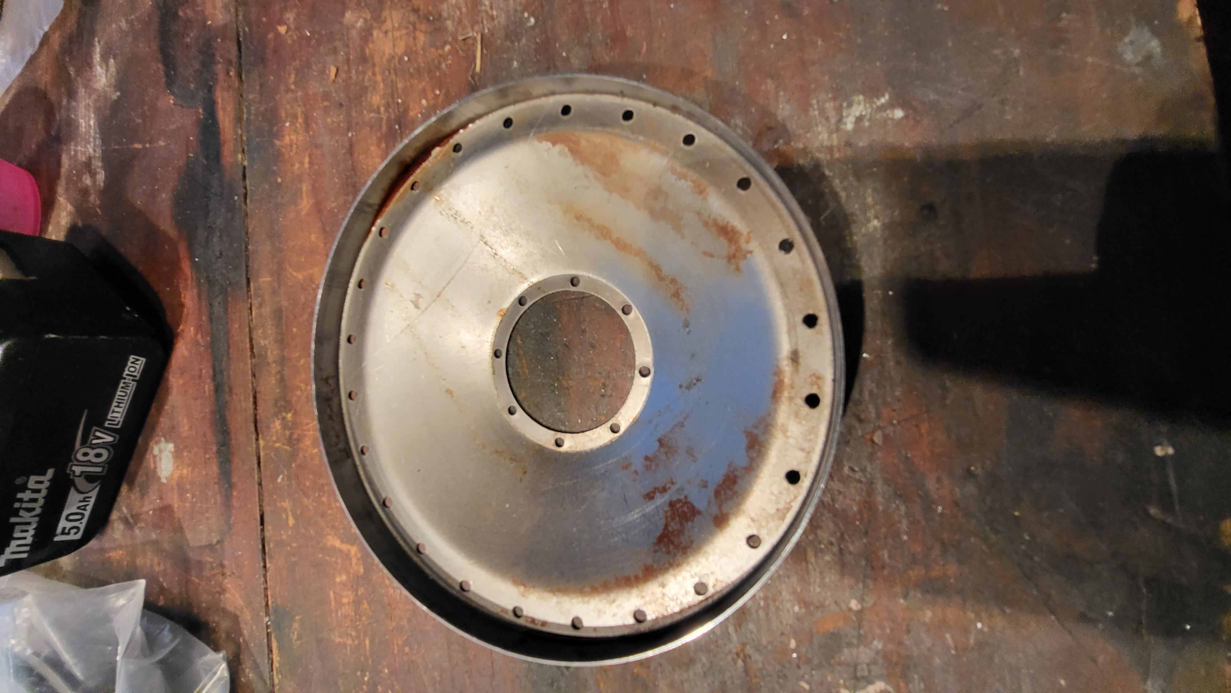

Come across 3 Wheels that have a chevron style stamp mark on them which will need to be sanded back
And some of the wheels have quite a lot of surface corrosion on them not that it is a problem to be honest.

I'm just about finished with assembling the wheels thankfully it's taken a while..
Corrosion on the wheels would be quite cool unfortunately you have to remove it for painting sadly

Hi All
Hopefully everyone is having a great Christmas, have managed to get some time to carry on the build.
Finished assembly of the wheel rims need to paint them then fit tires.
Building the wheels was a mission in itself.
I'm not entirely sure how much paint I will need..
Thinking of ordering 6 upol grey etch primer 500ml 6x 500ml halfords red oxide, and 6x 400ml fosco Dunkelgelb spray cans hopefully this will be enough for a good base to then send to the painter.
Starting to assemble the sprockets, both of the outside sprocket rings will need to be filed and sanding As they have machine marks on the faces around half a mm deep, and flash around edge of machined faces.
Keep me busy this afternoon.

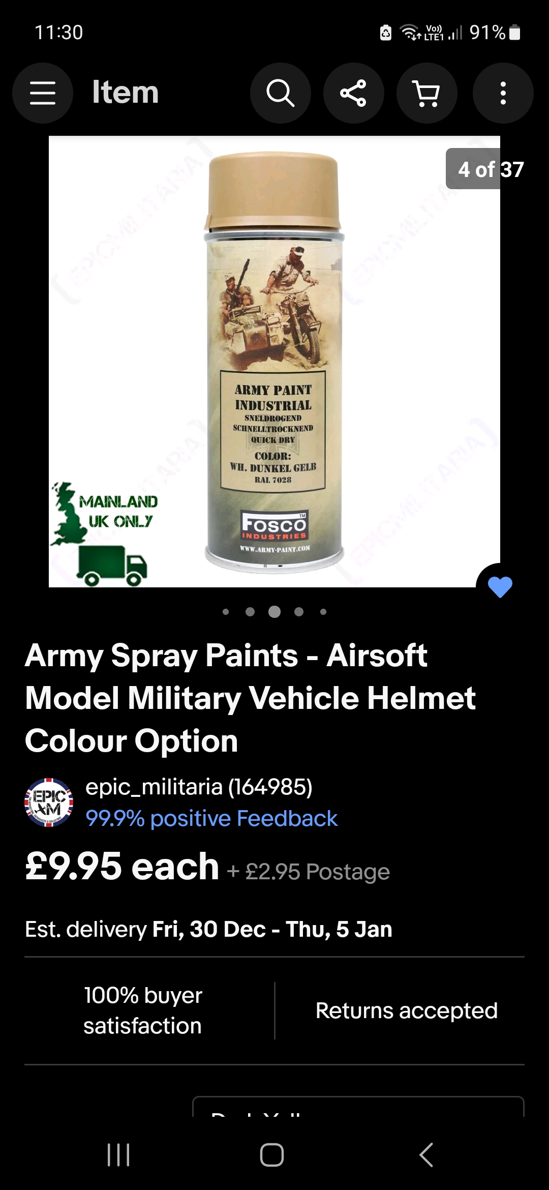

Hi Gary, great work and enjoy your build! Just one thing, the paint you intend using is not the correct type. You need RAL 7028 which is available in the same spray can format from the same manufacurer MFH, Army Farbespray WH dunkelgelb matt. I get mine from Germany.

The picture of the spray can is the ral 7028 is there a different version?

Hi Gary, sorry, didn't look closely enough at your photos - it is indeed the correct stuff!! I tried the Fosco paint but, following Brexit, couldn't get anyone to ship it to France, so I use MFH from Germany. You can get it on German e-Bay. Here's what the can looks like and also on the model when dry.

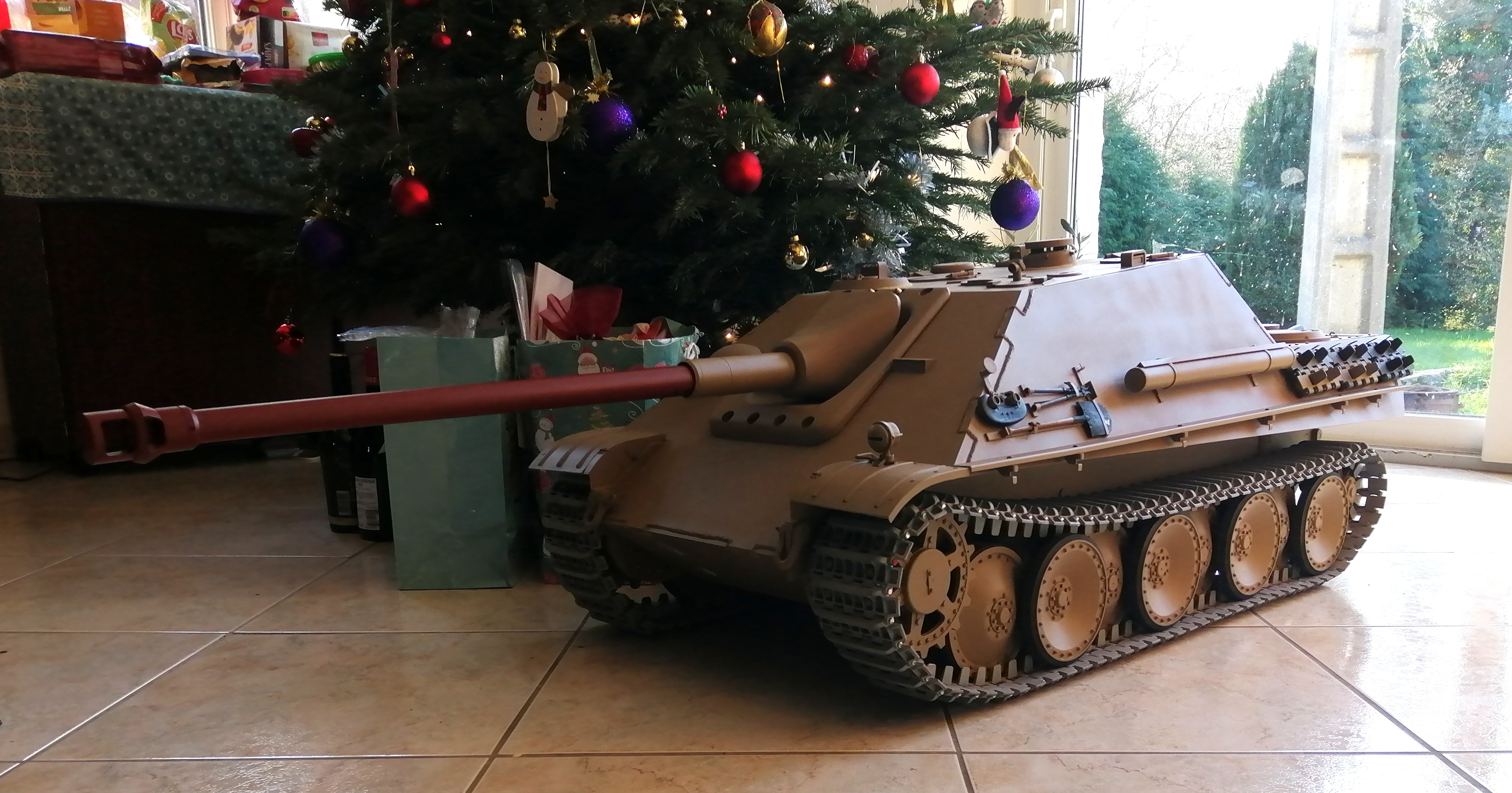

I know you'll enjoy the build - my Jagdpanther was 2 years of fun!

No worries, luckily a company in Wales imports them as we cannot get them either..
That is one very nice looking jagdpanther

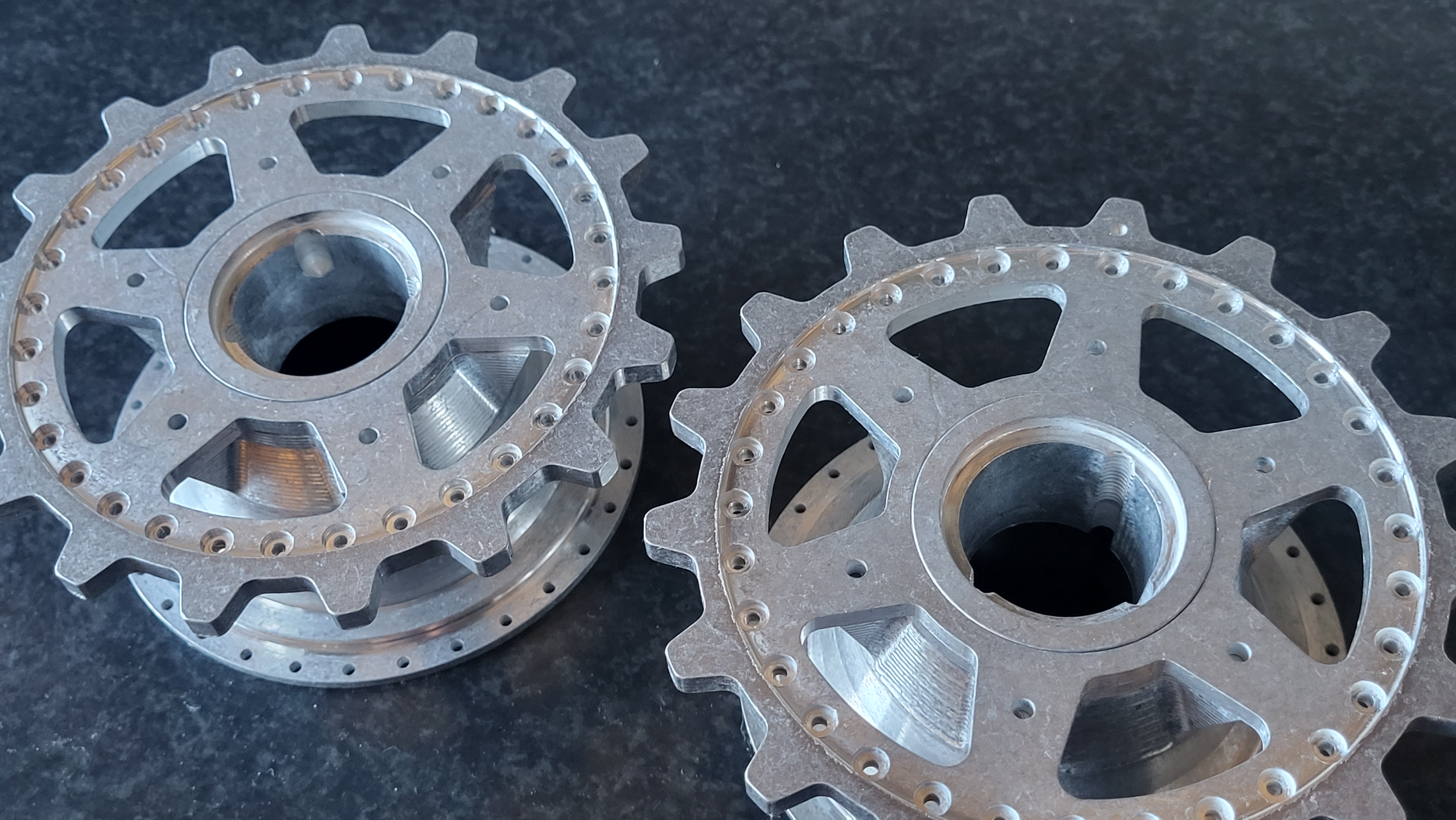

Sorting out the sprockets when quicker than I expected thankfully on filing, and clean up.

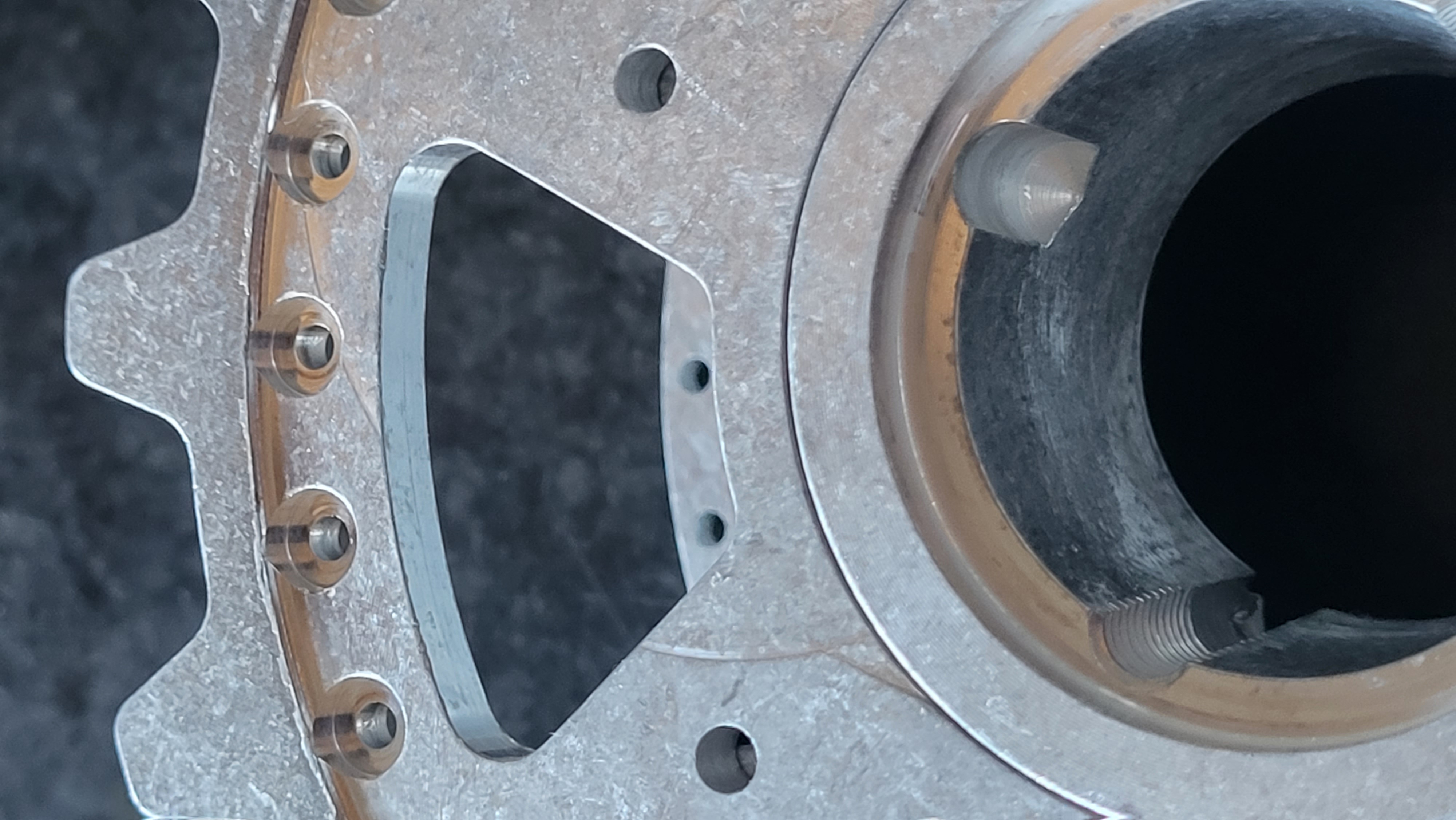

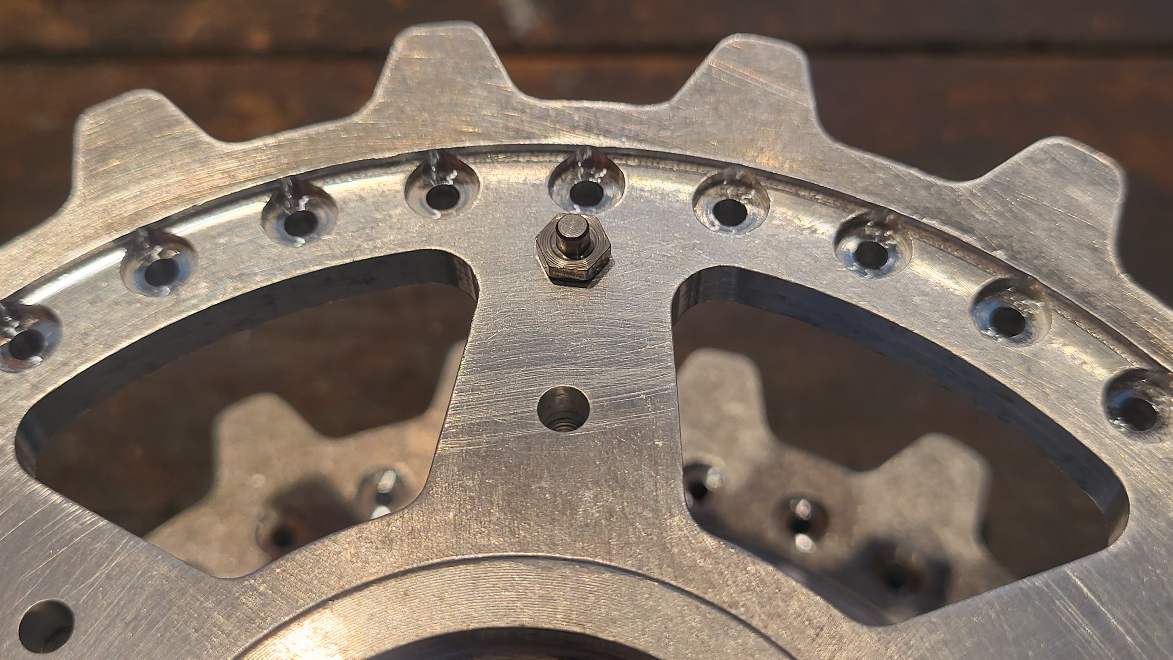

So now building them I've lined up the timing marks on the sprockets, however it looks like you just glue the M2.5X2 HEX to the outer rim..
Not so keen on this to be honest.
And do you use loctite on the other fixings for the inner sprocket ring?
No mention in the instructions just seem as bit odd, would have thought the vibration from the drive train cause issues?

Hi Gary, those look nice. Armortek like to leave most of the construction up to you since everyone does things differently. If you are only going to build your model for static display you might not worry about Loctite or glue strength etc.
If you are planning to run your tank hard and don’t want to worry about parts coming loose and won’t be checking things closely down the line then yes, use Loctite (blue)
For the outer rims regarding those hex bolts. I think they would look a bit funny with no screws there. Luckily I have a large supply of 2.5mm bolts I got on Amazon in a variety of lengths. Cost was maybe $10-20. I’ll probably fill those nuts in with a screw.
Hope that helps.
Brian.

PS there is a good chance they give you the screws for those outer hex nuts and they aren’t in the drawing.
Also don’t forget to chamfer the sprocket teeth.
