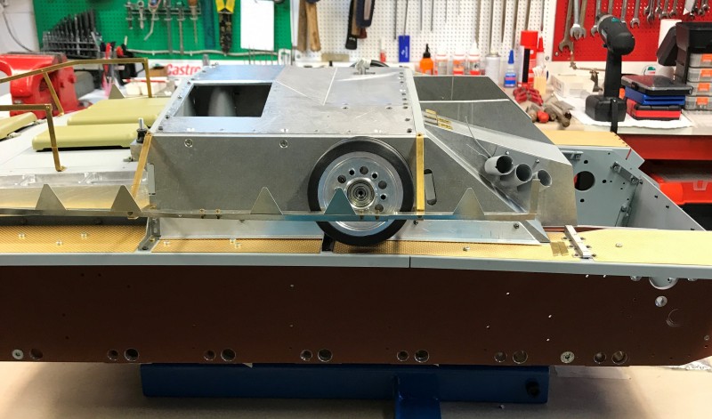

Not to much done to the Stug for a couple off days .
Mostly rebuild off the man cave to be able to work during the Autumn/Winter.
Change place for the spare wheel , drill and tap for the spare wheel holder.
Keep it from roll around when driving.

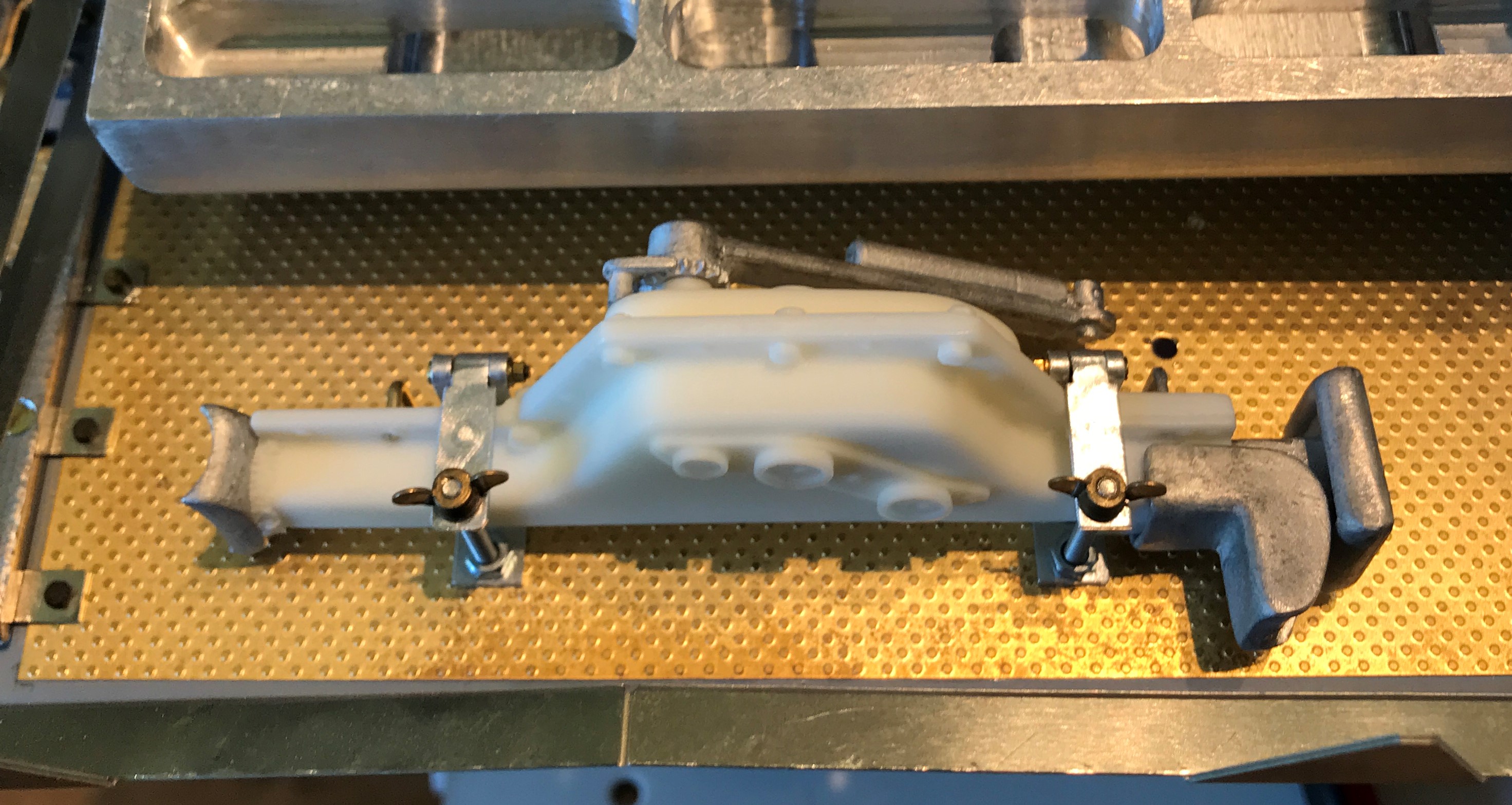

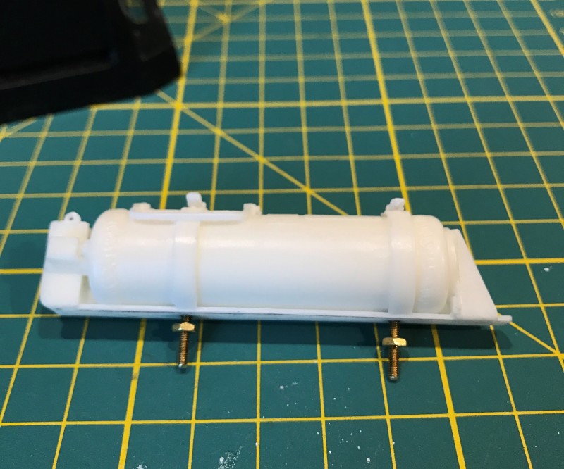

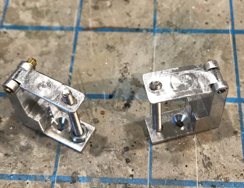

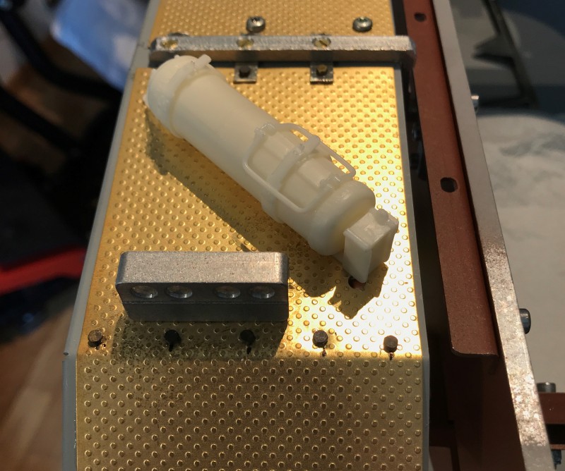

At last some detail work today , after a long absence due to much IRL things .
Did some small mods on the 10t Jack and holders.
Just slim them down abit and ad a bolt/nut Add another handle mostly to keep it from moving around to much . Next was the Tetra mostly a clean up and then drill and tap for two 1/72 bolts to keep it in place. And as a final for today some small work on the Tow hatch.
Kind regards from Björn

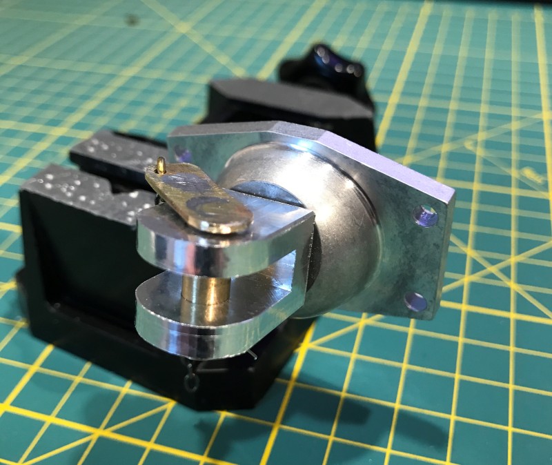

Re: Stug III 2020 57

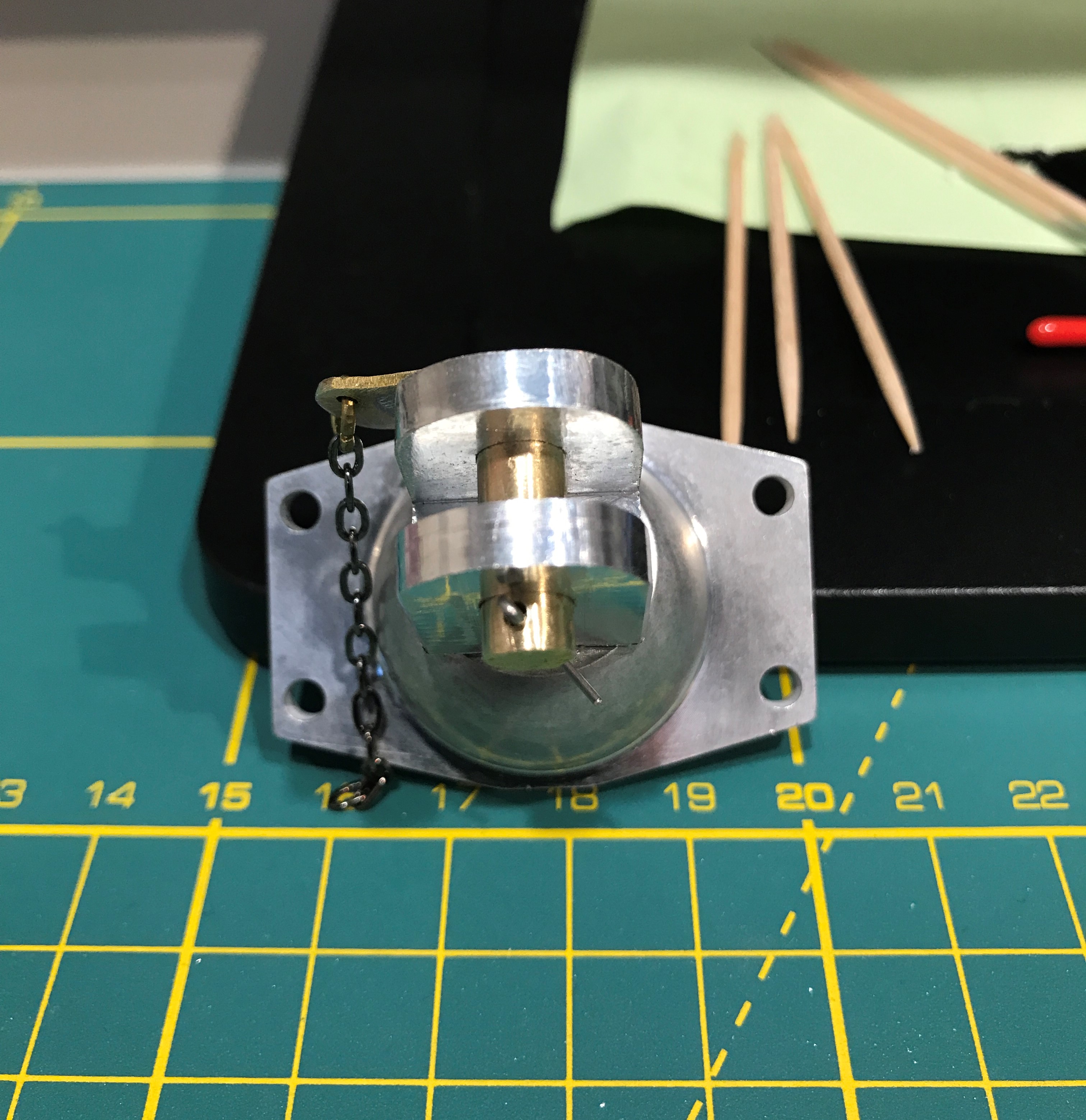

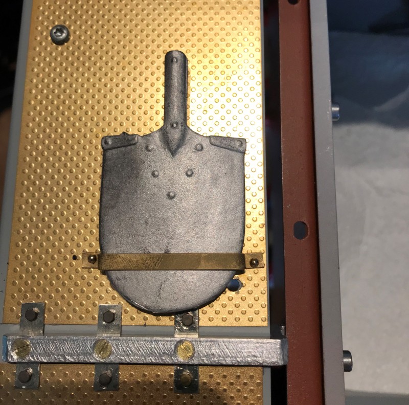

Only some small details done
Small try to copy "Stannard´s" sure miss him
Not finished due to material lack
Mount
Test fit off Tetra "Notek dummy only for measurement"

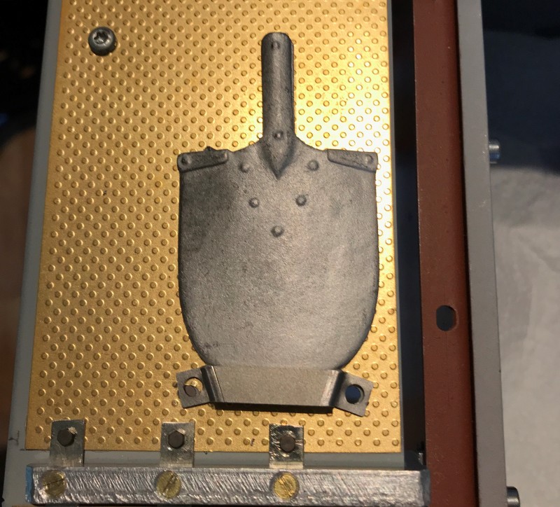

Had to fix the shovel holder , not sure what went wrong here
My own attempt
All for now have a nice weekend

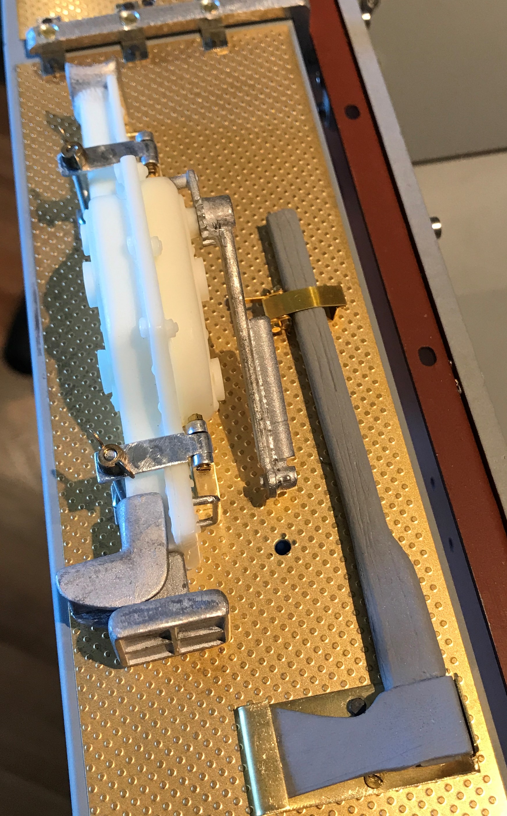

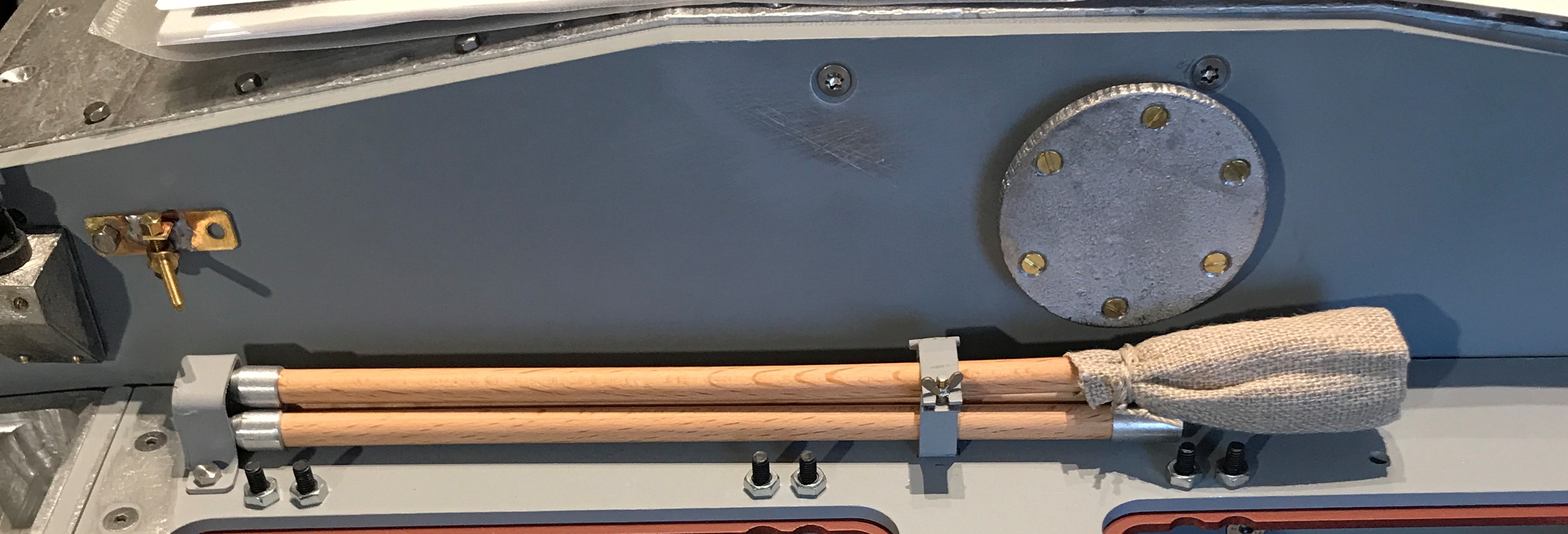

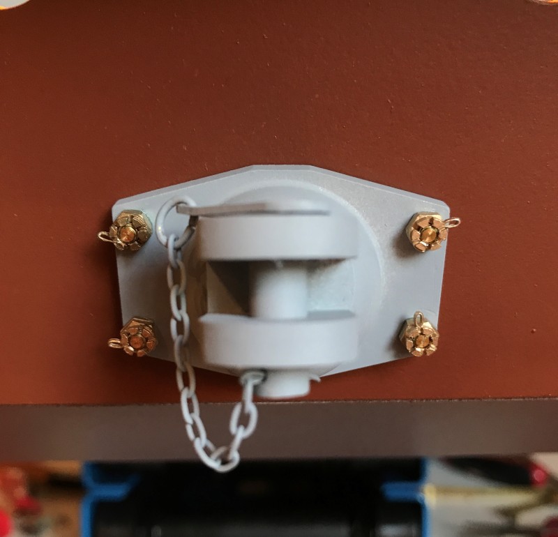

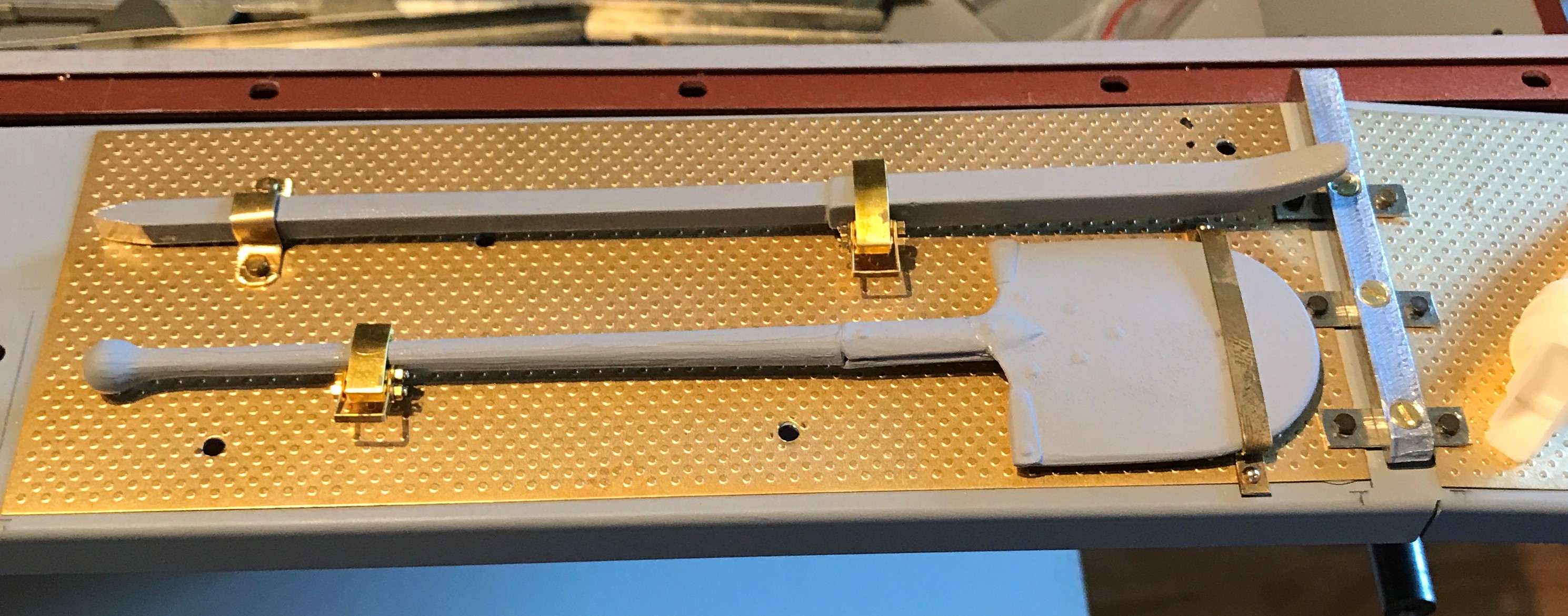

Working on those tool clamps form Armorpax real pleasure to work with
to hasty should have test it before
Had to make another mount for it no big deal , left to do is shorten the shaft a tiny bit and make the head more accurate
Then on to the jack made some small mods to be able to change direction off it. Oh those ref books go to you´r head
Then a axe holder on its way , a not so tidy bench at the moment
Also took the time to change position off the spade , and
made a mod to the prybar
who could have thought that you could

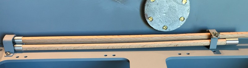

found the idea in "On Display book about Stug III " A little holder to the cleaning rods thats about it for now on the Stug 57
only mod was some bolts on them insted off plastic rods.

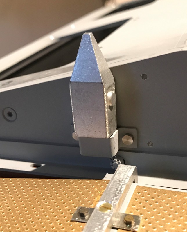

Next thing was the sledge hammer ,

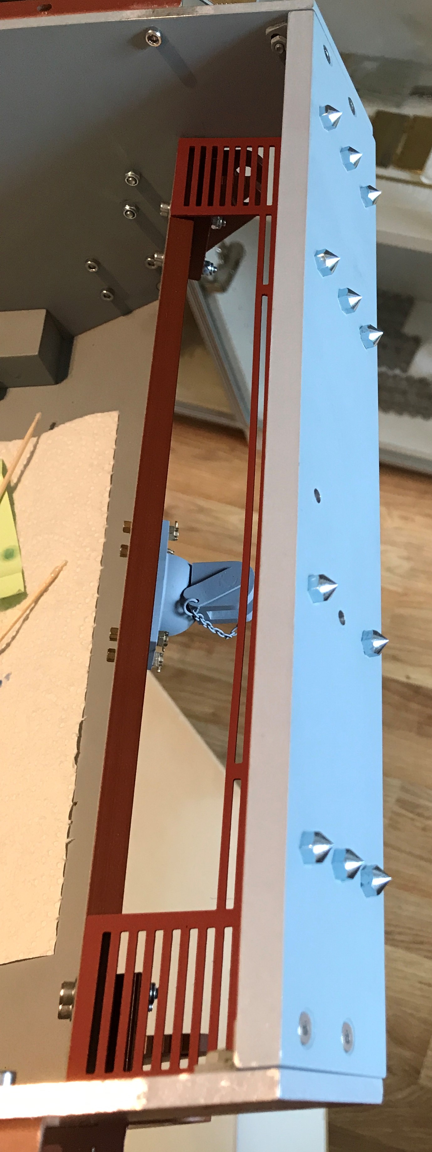

Agree Florian they sure do,
In a flow at the moment just try to keep it going

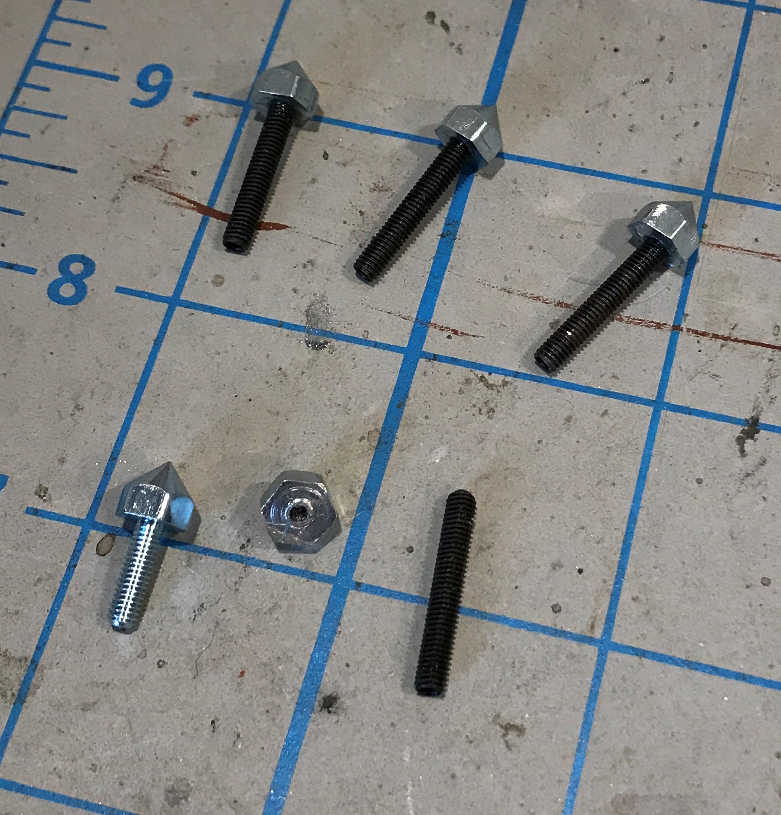

Come up with a
on those cone bolts , "probably invented the wheel again
" any how my version

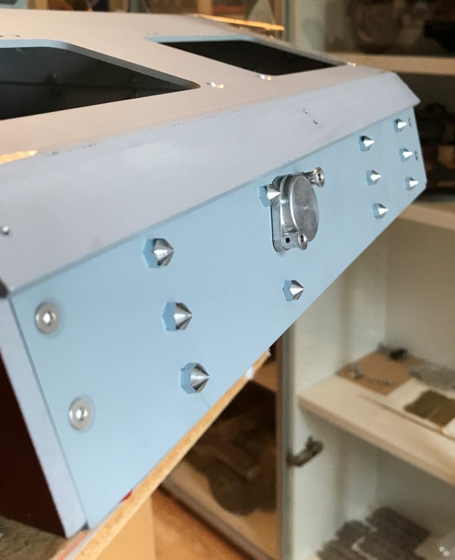

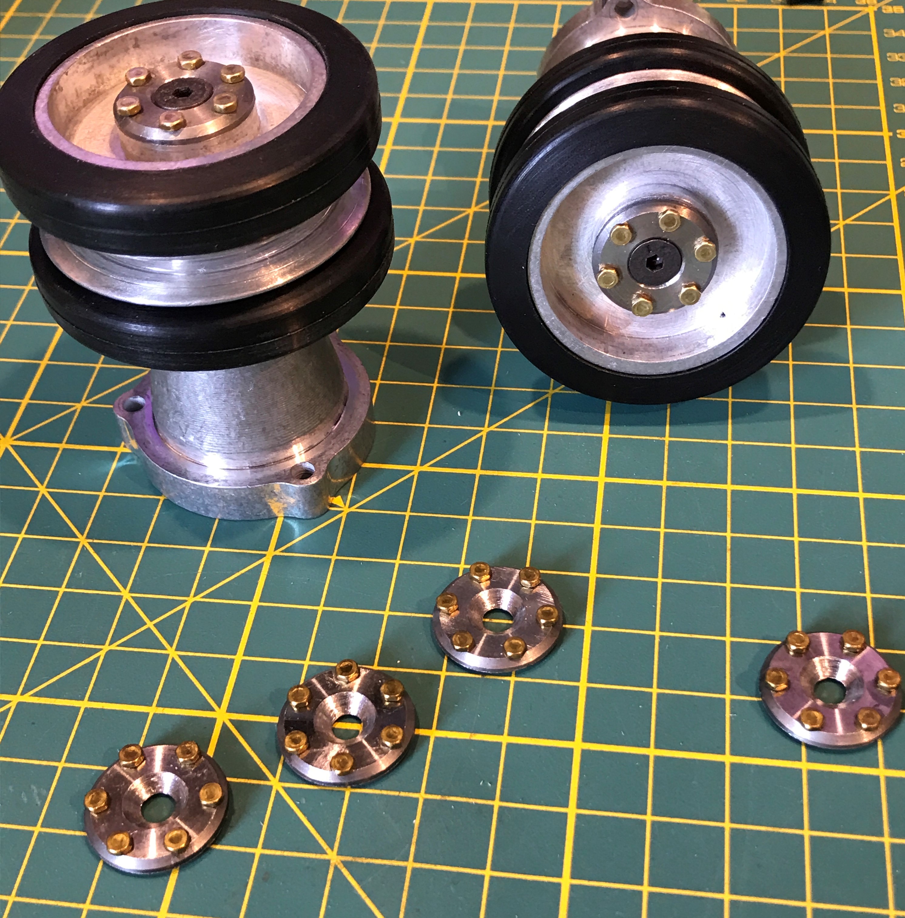

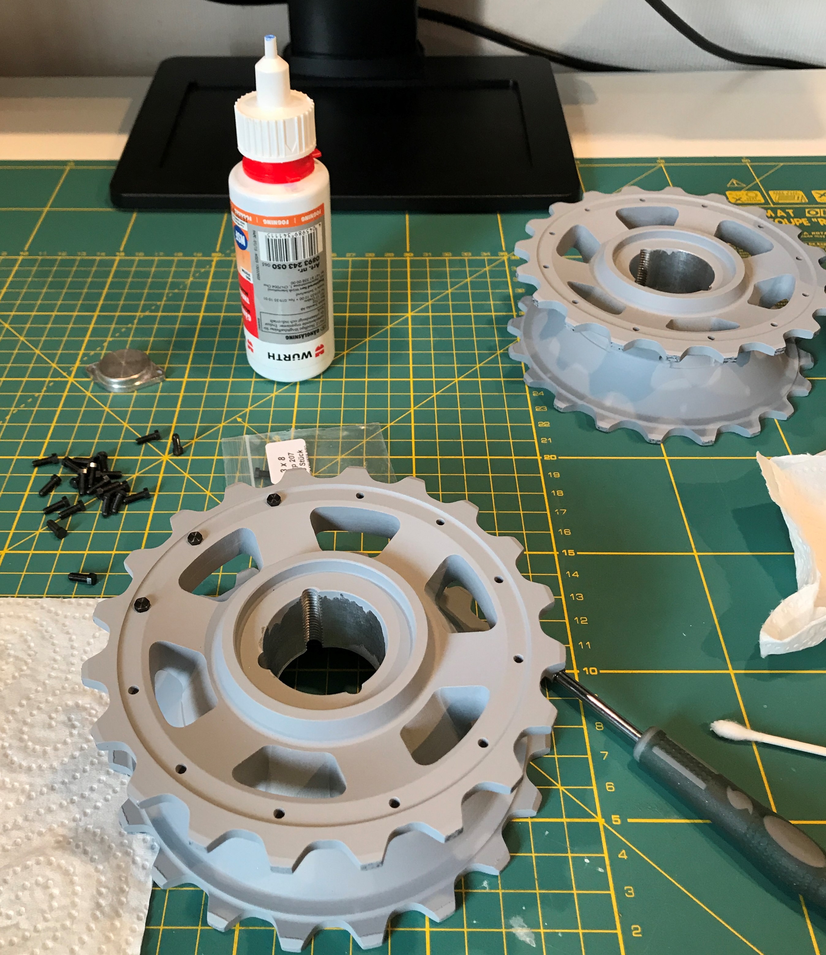

cut drill and tap 3mm Also found in the scratch box two ex Corally details that I will use for the " start cover nuts " After that" brain storm"
just some small deatils to drive spockets
See you
Come up with a

Right.
The Kegelscrews are realy short for the back side, but it worked in my case.
Not much done today mostly read those books
,some adjustment to length off those cleaning rods and moving the holder off them
to hasty should have learn by now
and prepare for some filling on the hole /screw .
A holder for the S-hooks
Have a nice weekend

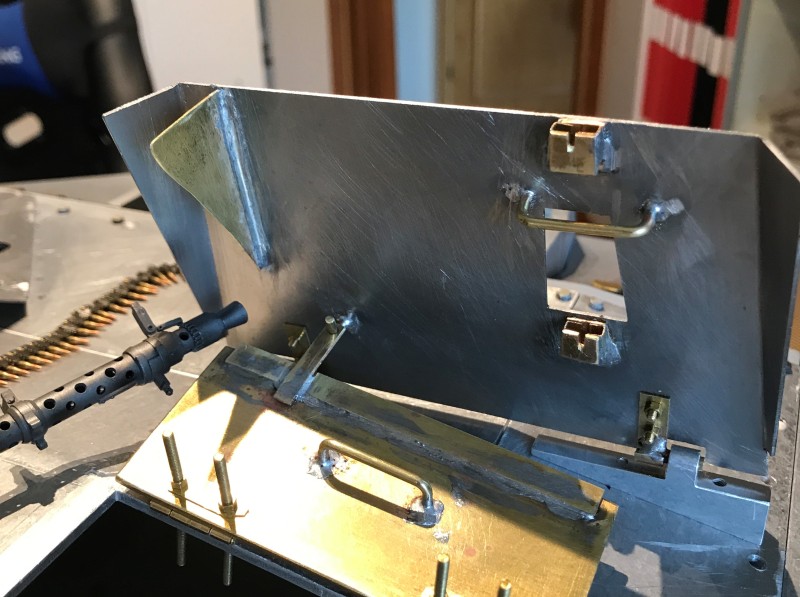

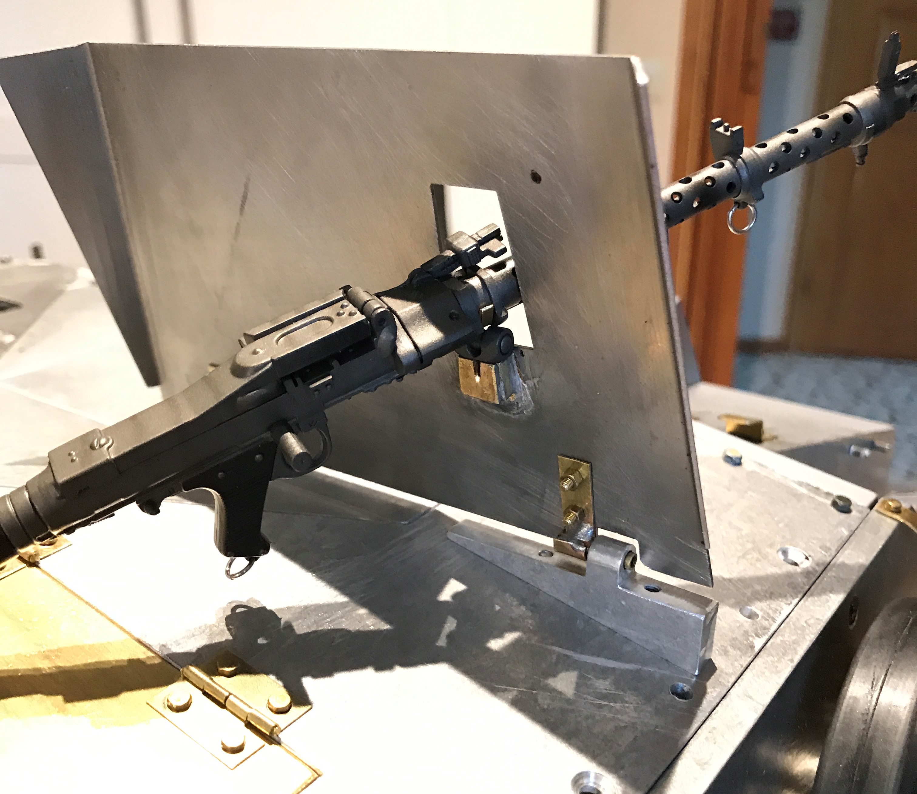

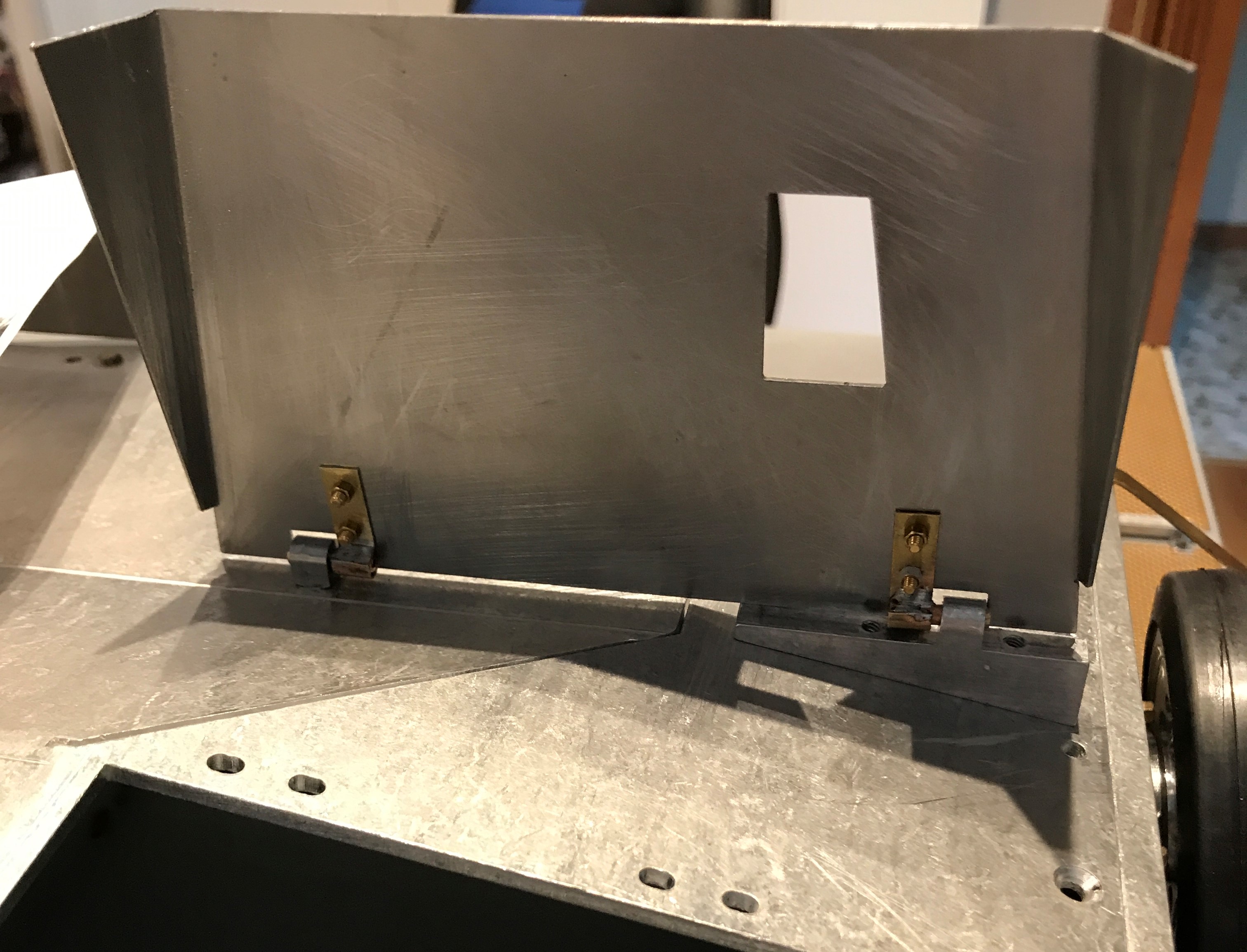

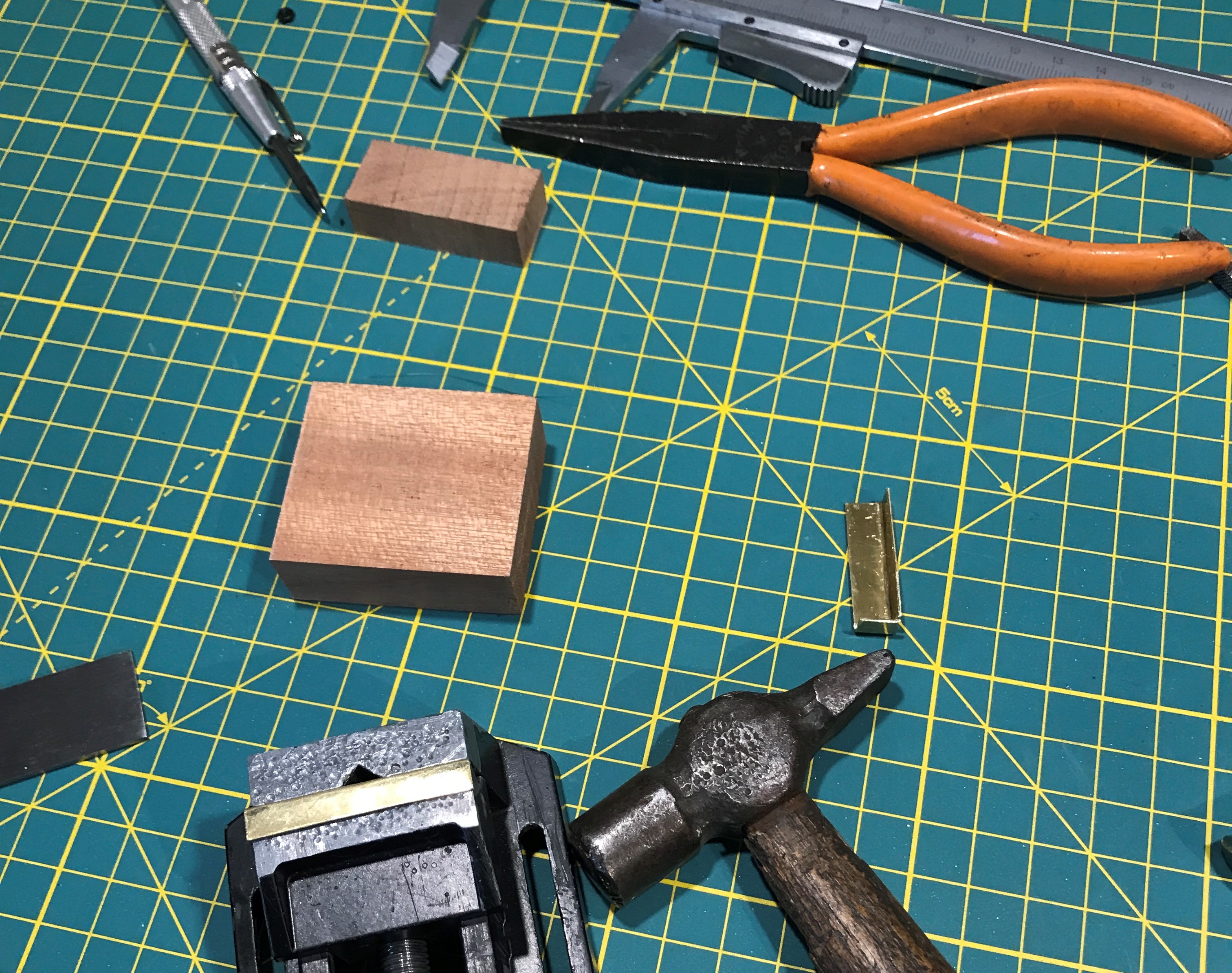

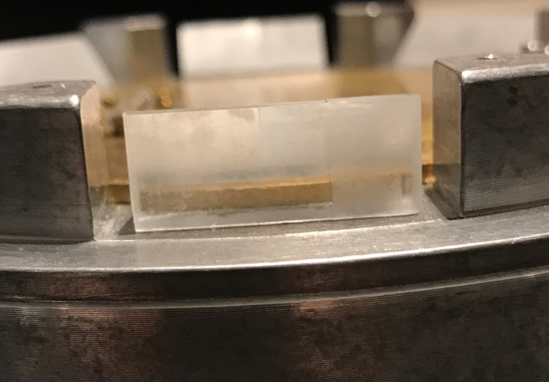

Back in the "black smith" try to learn how to solder brass on steel
Started out with this little fellow , that went ok
Next was the MG shield , some re-position and other mounts
First try out with the mg , after that the ego was boosted
End result ,
Couldn´t resist a try out
So on to next object
