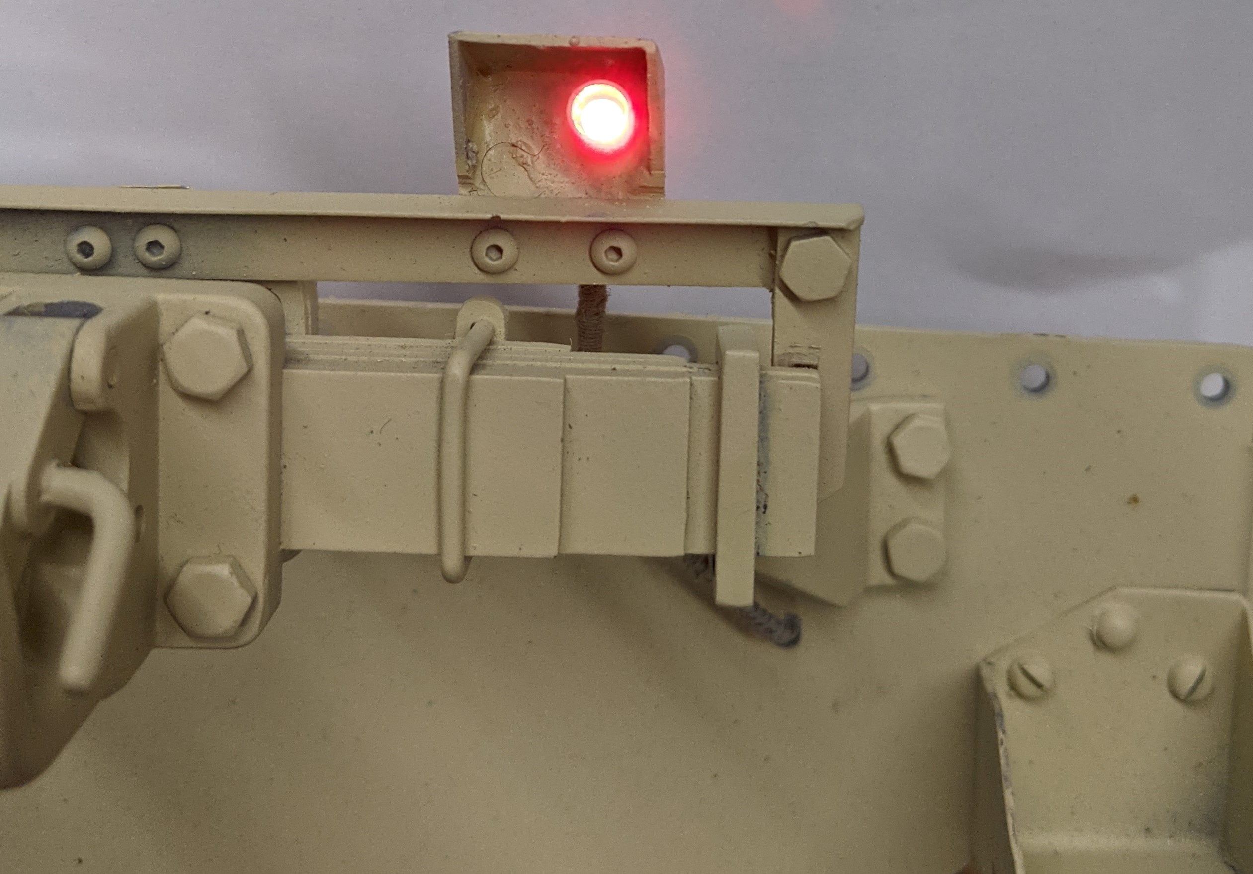

Two photos of lights working. Is it possible to switch on/off the light via transmitter? Explain please.

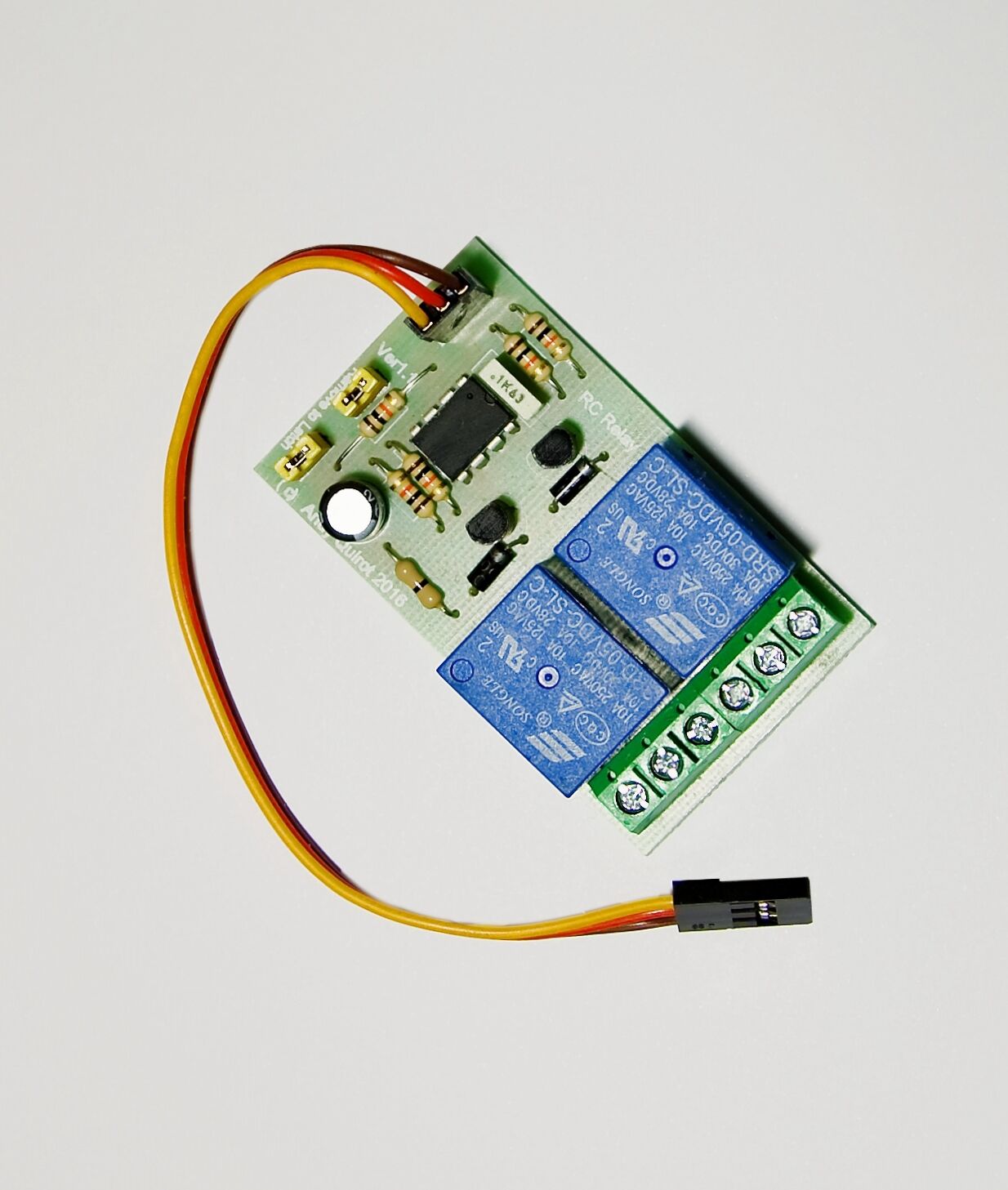

You'll need a Radio control switcher.
This twin relay version is the best one I ever used. it is built by one of the builders on the forum Andy Quirot.
They can be setup as a latched output or momentary output on either relay.
Because its a relay you can use any voltage with in reason up to 10 amps. n/o or n/c contacts.
Two separate relays, so you could use two different voltages.
Two different devices, side lights,on off, main light on off
Controlled from a three position switch on the transmitter or one of the spare R/C transmitter sticks or an analogue output on the transmitter using one output from the receiver.
There's cheaper similar looking switchers, but the quality and reliability of these switchers out shines the rest.
Some may prefer the twin solid state versions, lower current drain, quieter etc but they can only deal with one voltage.
And anyway, I do like to hear a comforting click of a relay when I waggling a switch on the transmitter.

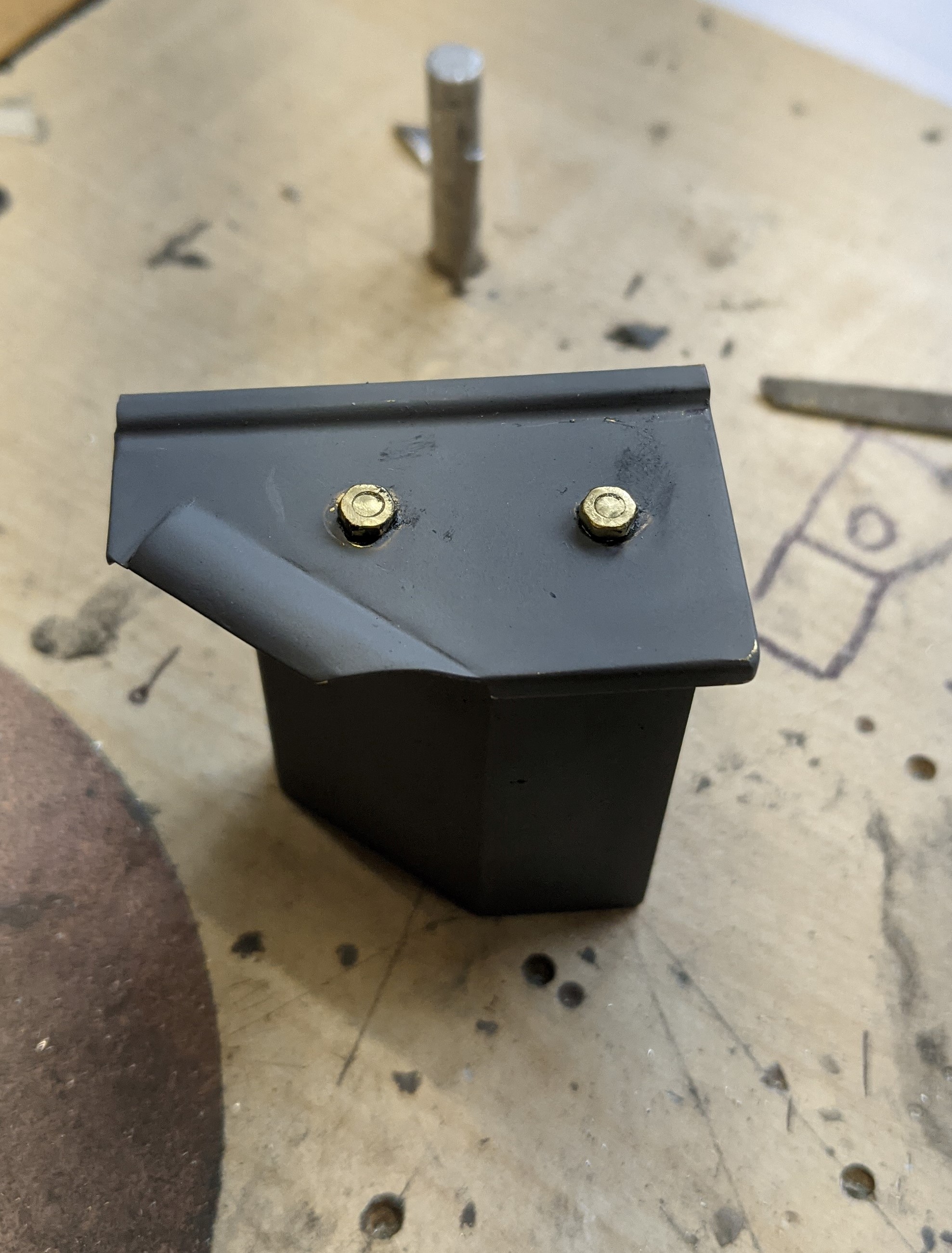

Started work on the Instrument panel. Good to have the panel light working? Made the cover from folding brass sheet and reshaped the original block to change the relative sizes of the to faces. Need to add instruments and dials. Looking at source material there doses seem to be different layouts. Does anyone have an image of the definitive (?) Mk2 panel?

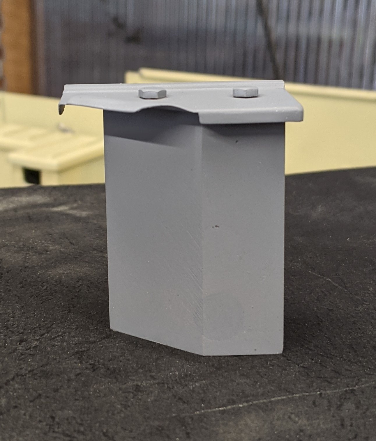

Whilst I wait to be able to visit my son so that he can sort out the electrics for me I have been fabricating a few bits and pieces. The driver's aiming sight and the cover for the instrument panel. Hopefully if everyone follows the rules we will be able to visit relatives before summer.

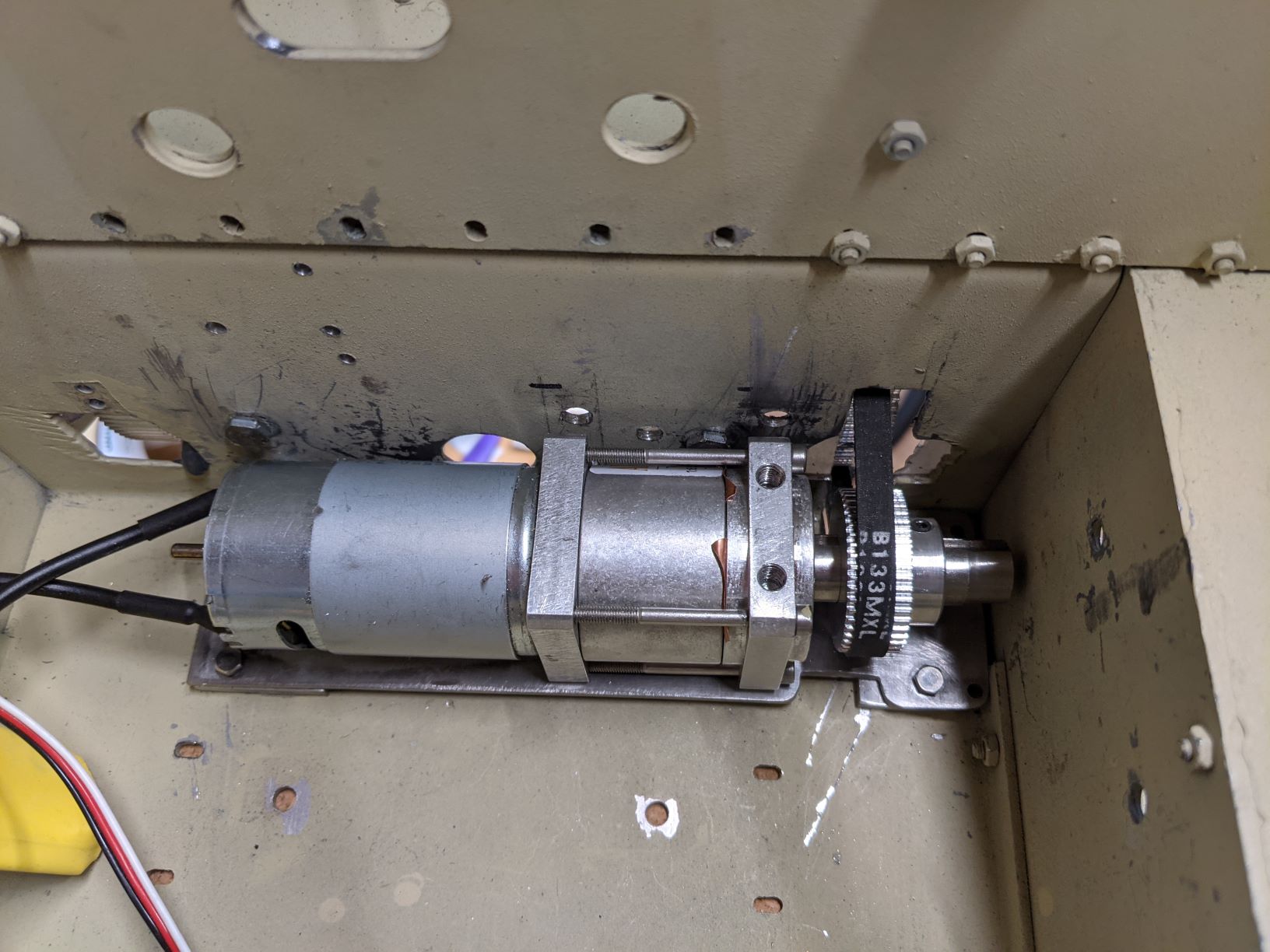

Re: Universal Carrier Nr 34

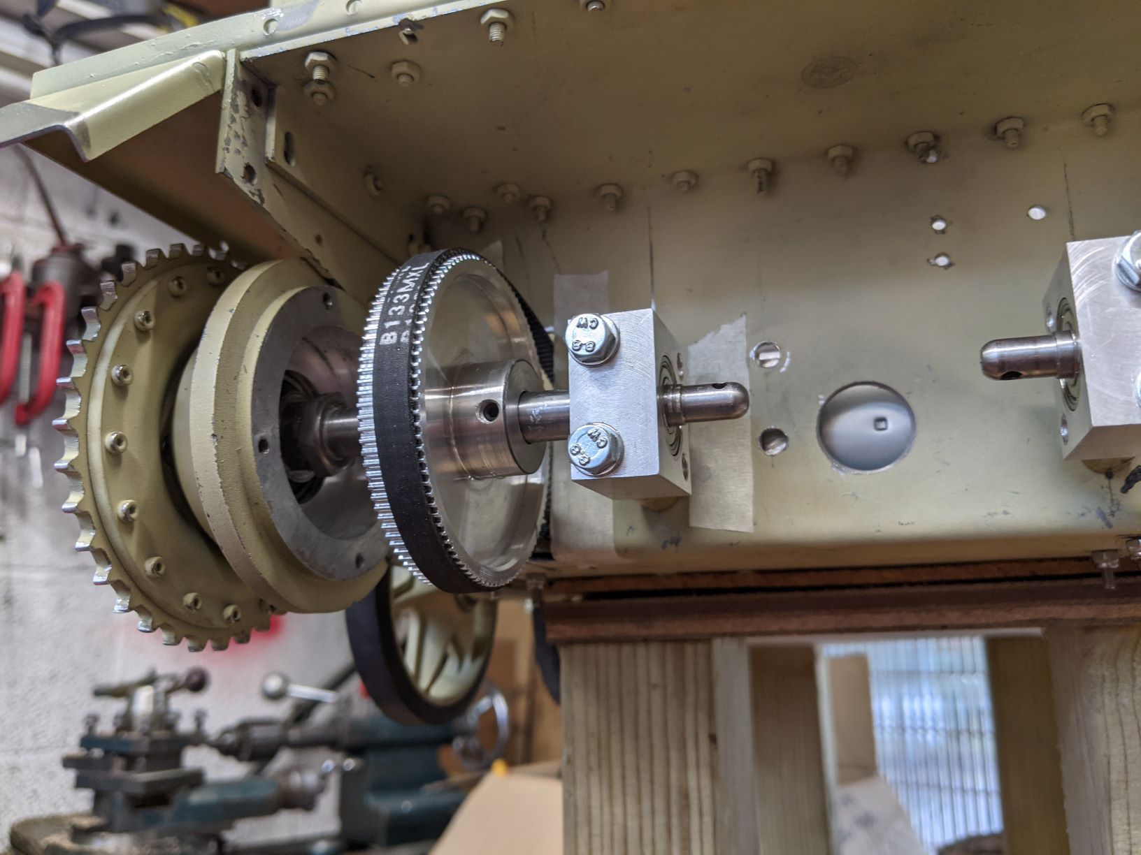

Had first trial of my two motor system (waiting delivery of the second motor), using timing pulleys and belts. may upgrade to 9mm wide belts.
