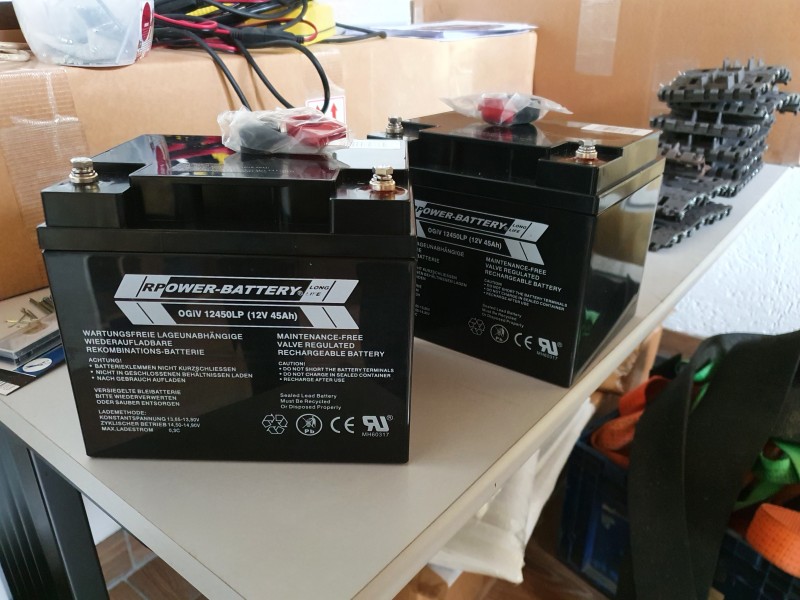

Batteries arrived today

Nice power packs. It seems to have enough torque with 45Ah
But I think a bit over sized?! - With this you can drive 2 days non stop
How big and heavy are they?

Hello Peter,
well, nice packs, but ugly heavy!
I used the same capacity in my Bigtanks JT, until I replaced it by 8 LiFe cells of 36 Ah; actually shown in the Chieftain battery thread. Now I have nearly twice the operating time and could save 18 kgs!

Batterien are 197 x 165 x 170 mm, 14,6 kg each. Gives you about 4 to 5 h running time w sound and w/o smoke.florian rudolf wrote: ↑Thu Oct 15, 2020 5:39 pmNice power packs. It seems to have enough torque with 45Ah![]()
But I think a bit over sized?! - With this you can drive 2 days non stop![]()

Hello Gerhard, How much did you spend on them?Gerhard Michel wrote: ↑Fri Oct 16, 2020 12:05 amHello Peter,
I used the same capacity in my Bigtanks JT, until I replaced it by 8 LiFe cells of 36 Ah; actually shown in the Chieftain battery thread. Now I have nearly twice the operating time and could save 18 kgs!![]()

Ah ok, thanks. It seem verry heavy to the LiFePo. - My opinion with Gerhard.Peter Quambusch wrote: ↑Fri Oct 16, 2020 12:56 pmBatterien are 197 x 165 x 170 mm, 14,6 kg each. Gives you about 4 to 5 h running time w sound and w/o smoke.florian rudolf wrote: ↑Thu Oct 15, 2020 5:39 pmNice power packs. It seems to have enough torque with 45Ah![]()

Hello Peter,
I bought 8 of these cells (without BMS):
https://www.i-tecc.de/shop/einzelzellen ... -3-2v?c=97
Actually there is an interesting discussion about LiFes with and without BMS in the Chieftain-thread. I think everybody must know by himself whether or not to use a BMS. But saving a BMS means that there MUST be a suitable concept to monitor the single LiFe cells when charging and when using.
I'm using the Jun-si iCharger 4010 Duo charger with integrated balancer:
https://www.lindinger.at/de/akkus/ladeg ... ladegeraet
