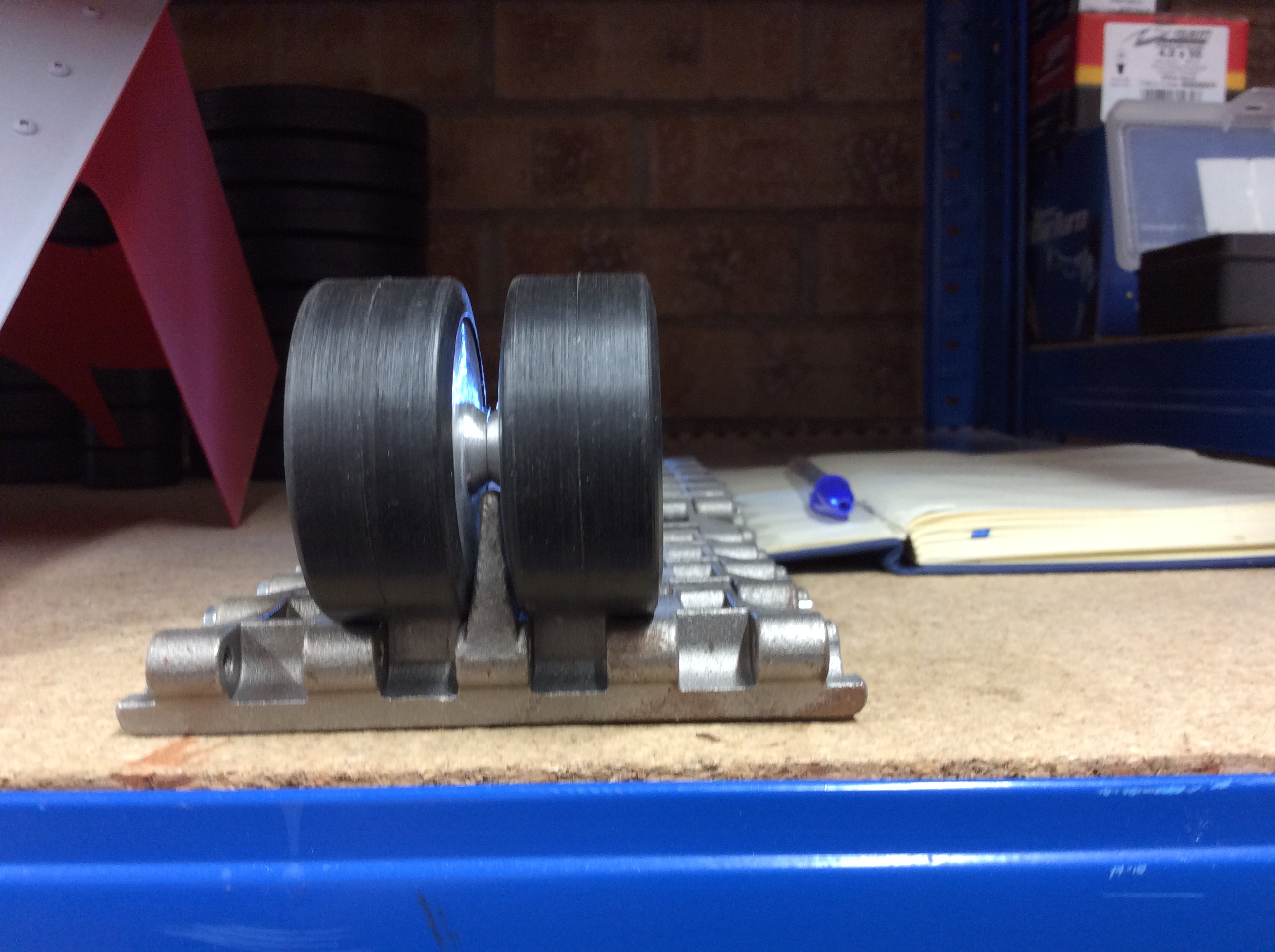

Personally think the track horns need reducing , by reducing them by 3 mm isn’t going to affect them in any way as there will only be a mill clearance .As I measure the centre boss is roughly 2mm thick , if the horn is being held off by 2mm when it beds in there is going to be hardly any centre boss left ! Then over a period of time does it keep wearing and the cast iron track keeps on grinding away only now at the steel shaft ?

I totally respect Amortek's suggestion on the return roller question. To make the changes is long winded exercise that could lead to long stay in A&E if proper precautions are not realized.
Nobody wants to have less digit's at the end of the day than they woke up with in the morning.
Though in my Village loosing a digit, most would still be able to count up to eleven on their fingers and thumbs....That's if they could count that is.
I know it's not a Rolls Royce and sadly, I can't wait for the knocking to stop, so I've taken up the Glen Campbell song and put it into action. The "Grind stone cowboy"
The track link horns are a little off scale, so a little more won't hurt.
Simply found a piece of plate the right thickness (metal ruler 15mm), painted the offending bit 2mm+ (my opinion only) ground it off, and finished by hand. The track horns well within 0.5mm tolerance of each other.
The tracks are fantastic, even with some of the abnormalities and casting marks that some have. A small bubble hole here, a lump there.
One things for sure these tracks will last and last. So once their on, I should never need any more.
Ahhh that better (my opinion only)

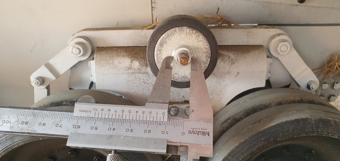

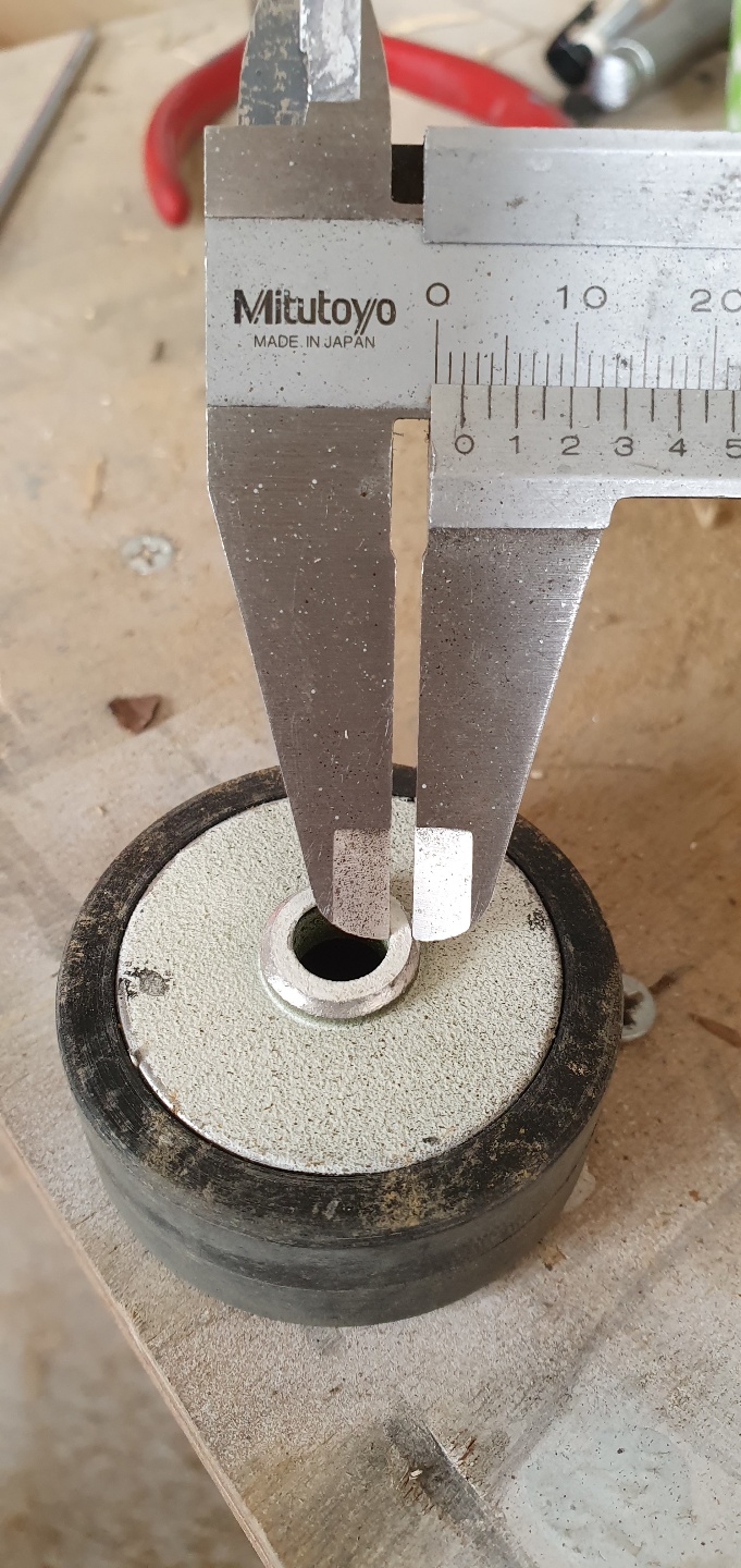

I did maintenance on my Chieftain drive system for several days.
I operated for about 20 hours after assembly and learned many meaningful situations.
The U-shaped erosion of the return roller was about 1mm deep and the remaining flesh was 2mm deep.
This translates into correct values published by Armortek.
Therefore, I will use my track horn as it is now and I will not modify it in the future.
Youngjae

- Posts: 1693
- Been liked: 1842 times
Re: Return rollers
Excellent pictures Youngjae and Steve, I'm sure many will be happy and have there fear's laid the rest on what damage might have occurred if nothing was done to avoid the impact on the return rollers.
That said, I've nearly completed my horn modification so they (Horns) will have no impact on the return rollers now or in the future.
Keep up the great R & D work, it will be wonderful guidance for all during the Chieftain builds.
I'm sure we're all watching intently at the options fit and operation.

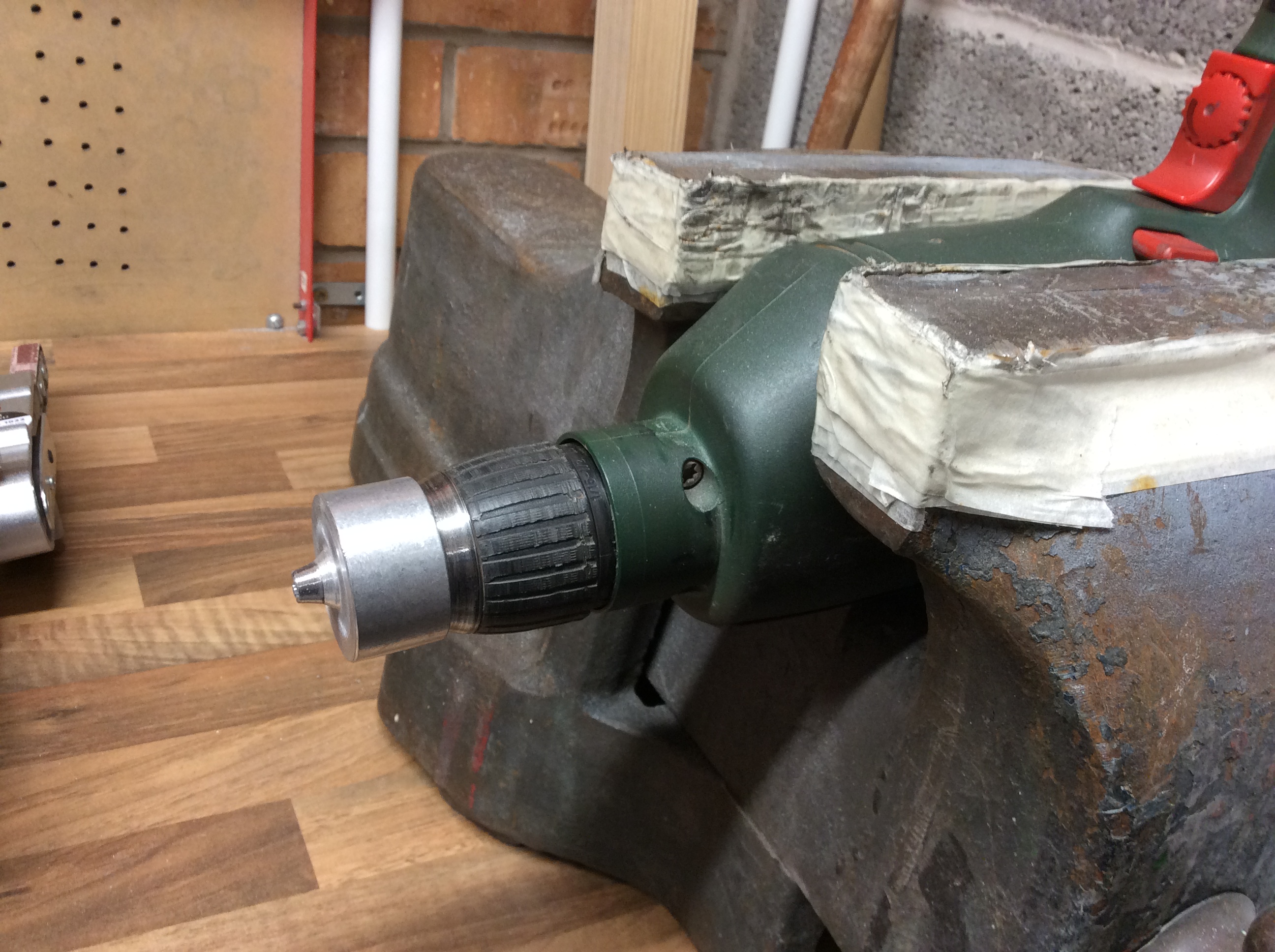

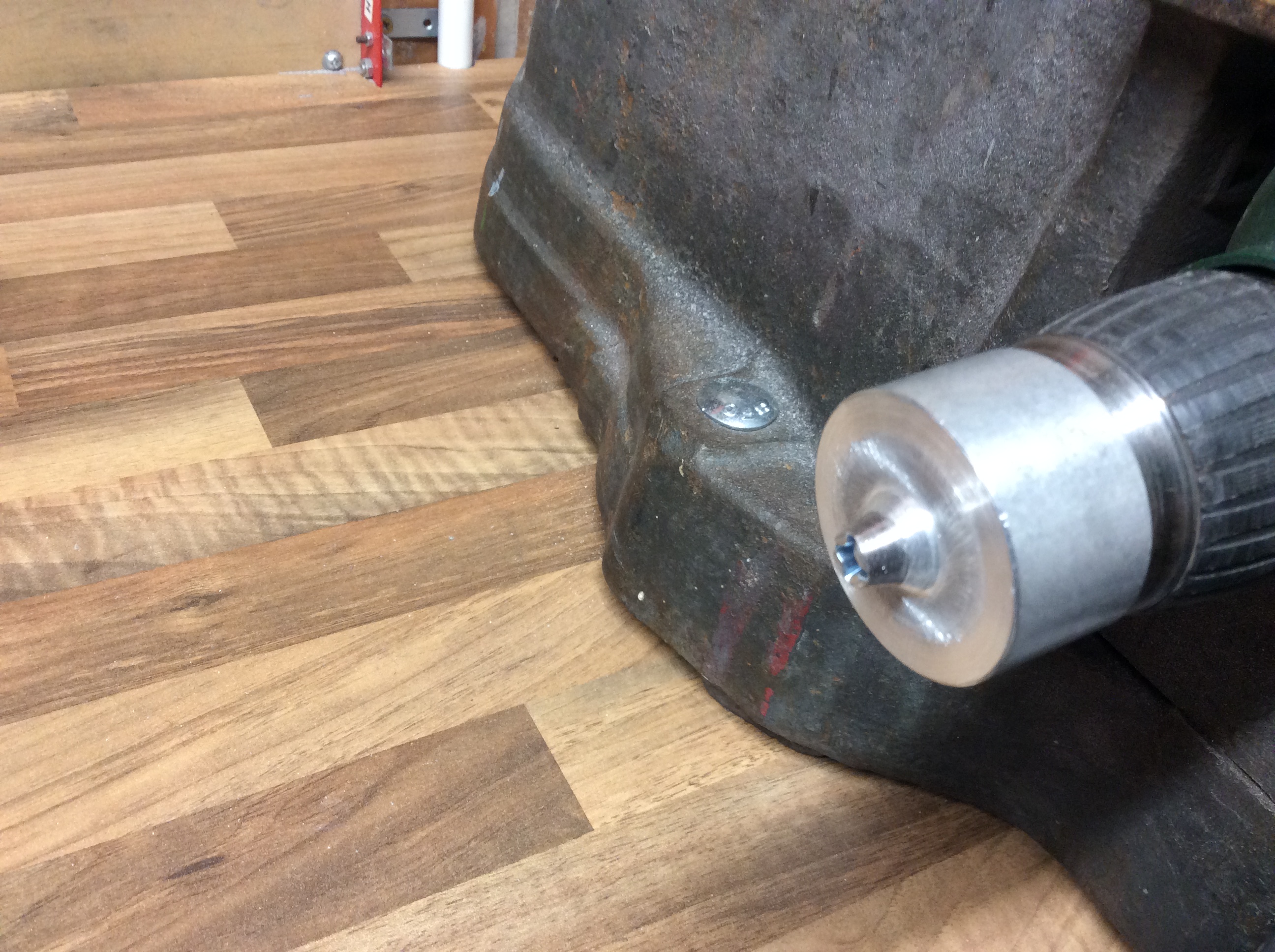

Here is my solution for modifying the return rollers. I don’t have a lathe so used my faithful Bosch drill as a substitute. Put the return roller in the chuck held with a suitably sized bolt and a power file. No need to modify the tracks and all done in less than 30 minutes for all 12 return rollers...

Great solution, certainly simpler/better than mine. This way you've predetermined the profile and not had to worry about a balanced in bedding in process. No lumberjack song sung here either.
I hate squeezing hand drills like that, but sometimes "you gotta do what ya gotta do" makes a cracking little lathe:D
