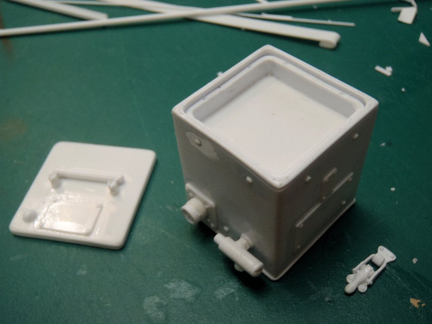

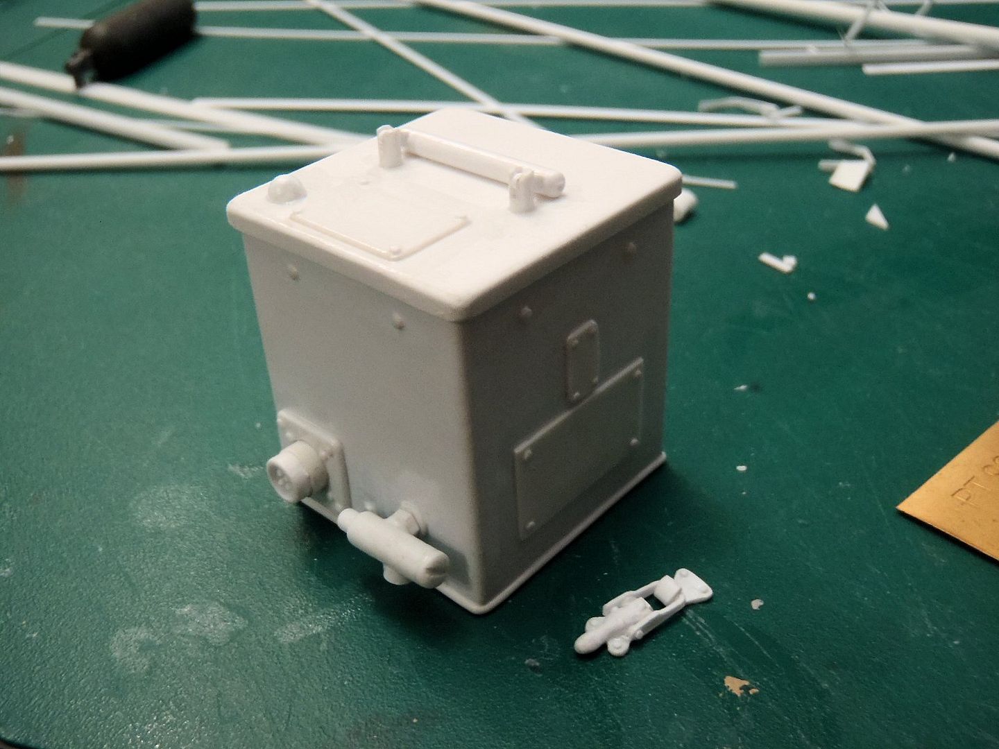

Almost there with the BV but eyes have had it for today. Just the lid rear locating pins and brackets to do and then the cable plugs.

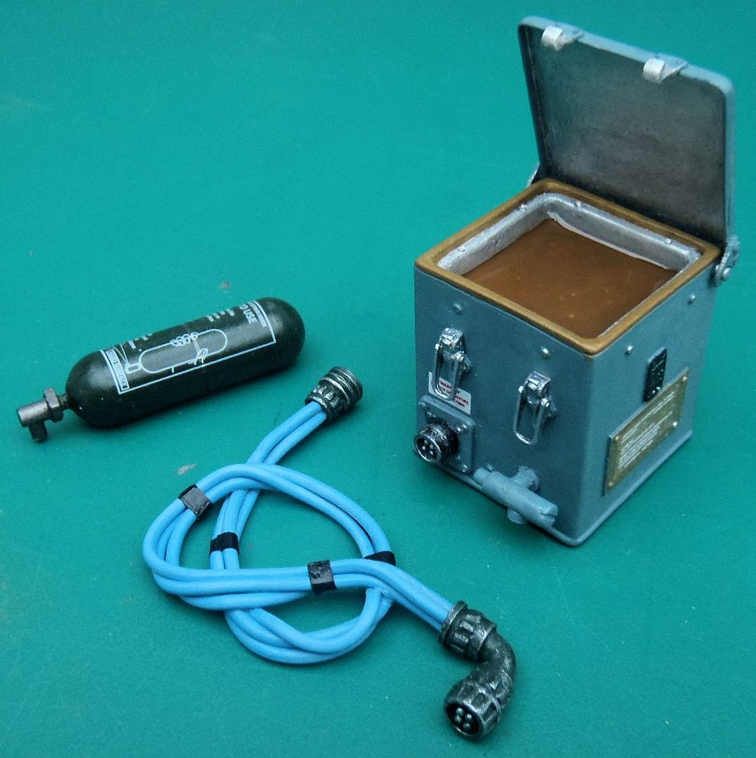

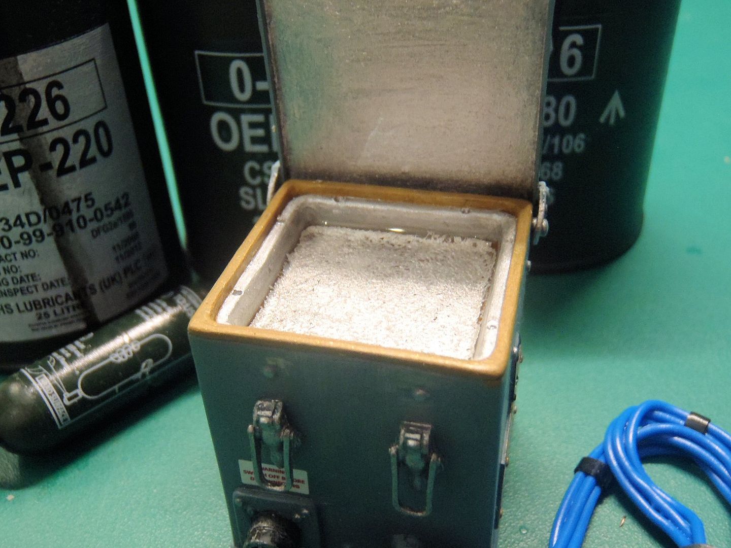

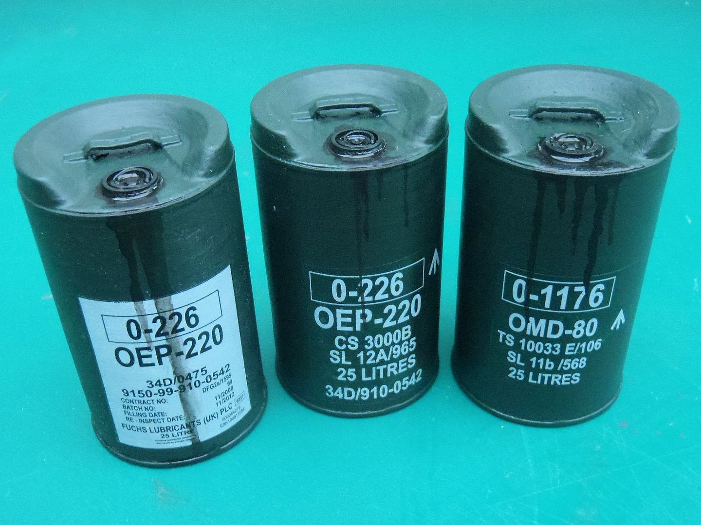

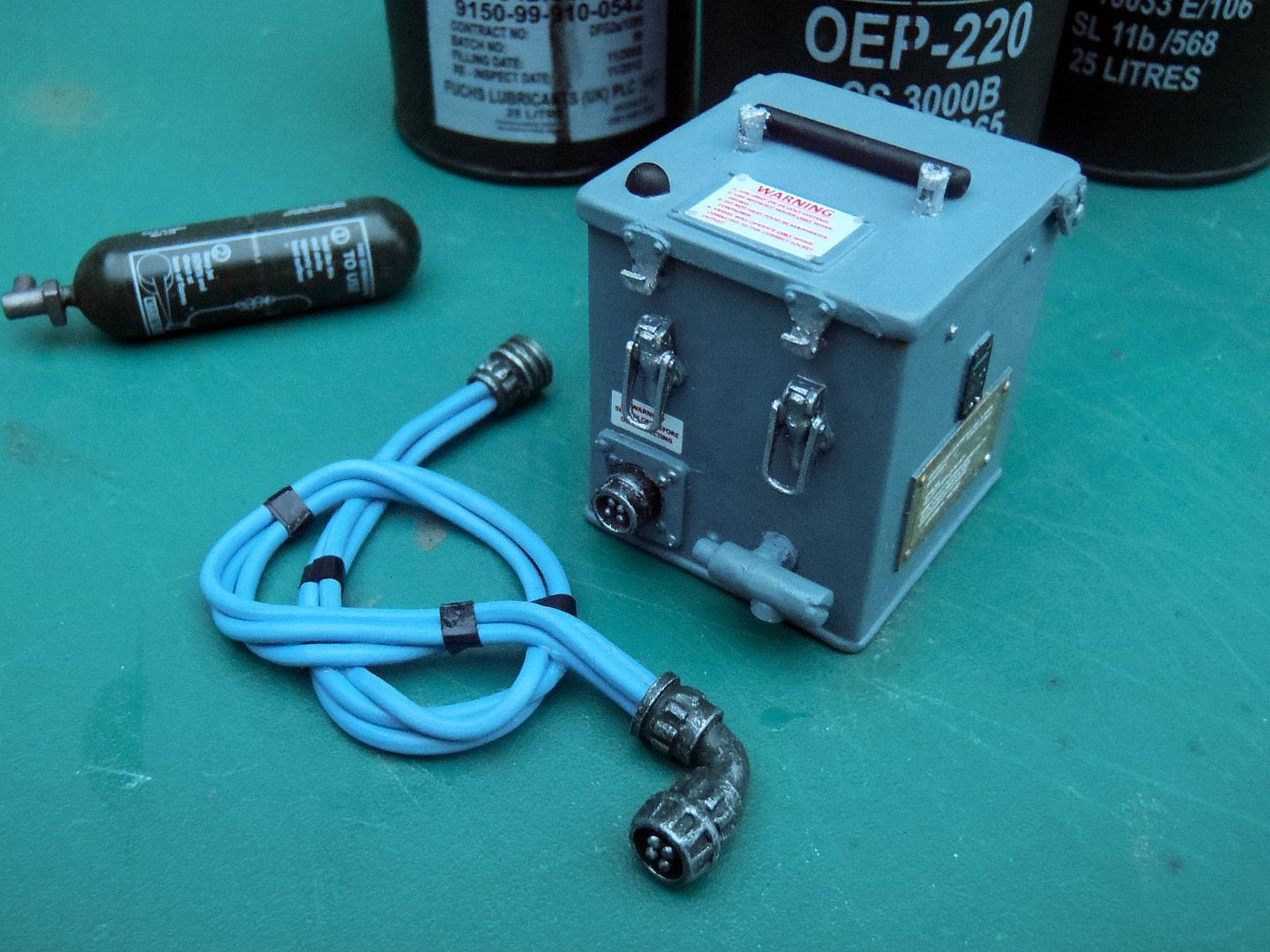

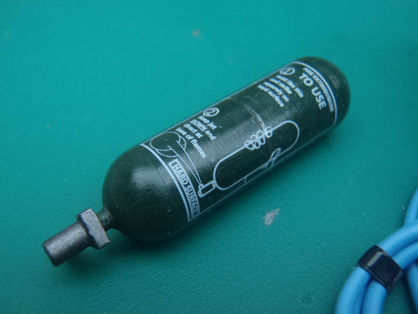

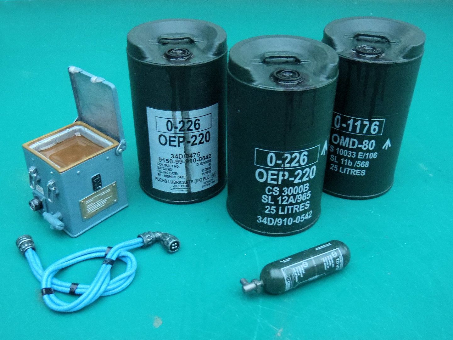

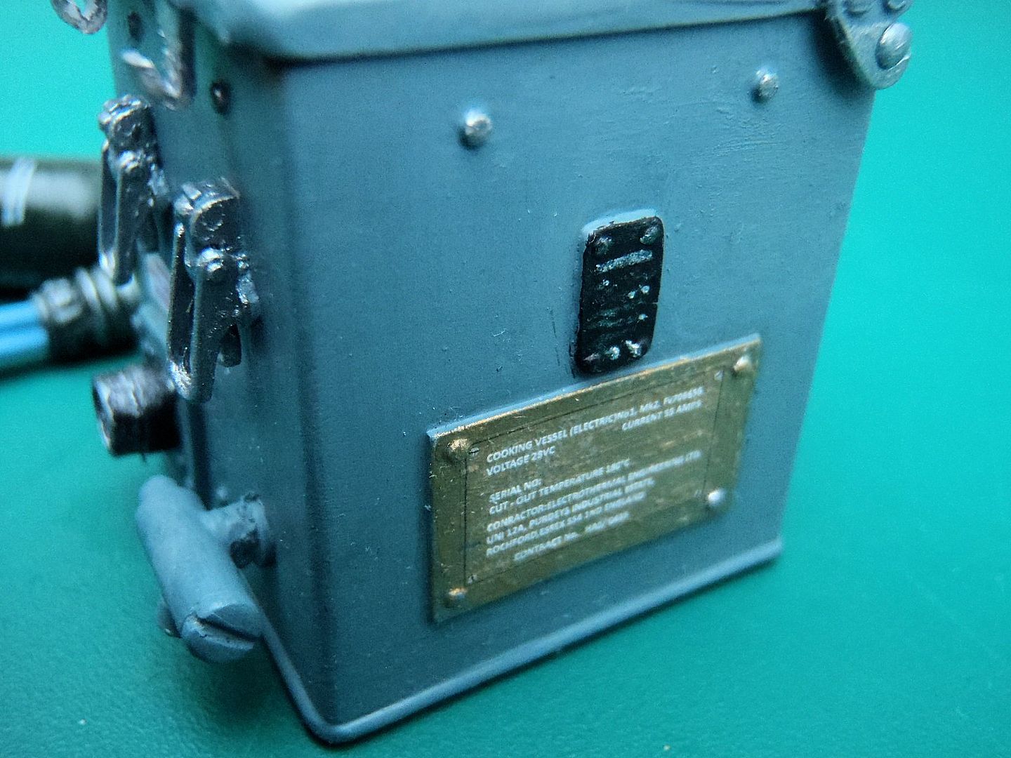

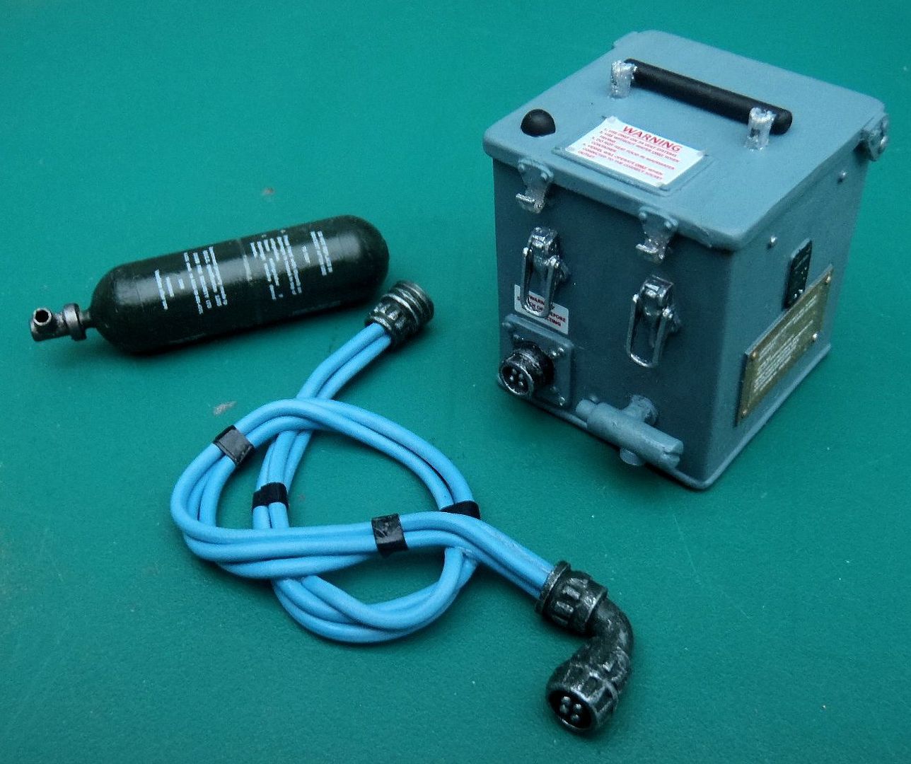

New decals arrived from Peddinghaus while we were away last week so in between casting some of last weeks orders I decided to paint up a BV and oil drums etc.

Great achievement Dave, they look spot on. You're making a lot of work for yourself, which I guess is the object? Form an orderly queue please ......
My only question is what the hell is that in the BV? It looks like mulligatawny soup with lumps.

The best mulligatawny has lumps :D

I thought from your descriptions at Bovi that the stuff in your BV looked like that :-)

Few comments on the BV and BV lead.
The BV was used for heating water. When cooking food, the food did not go directly into the BV but into a handled insert that was dropped into the BV.
The BV lead wiring has the correct colour but I can only make out three strands, there should be four, pos and neg for the heating element and pos & neg for the switching circuit through the thermostat on the the BV. As an emergency repair of the lead, the negs could be commoned to make it work on three. Better was to add two lengths of "yellow string" replacing the thick wires for the thermostat circuit. Then you had a spare thick wire for the heating element should it be required at a later repair.

I am aware of the insert but chose not to add it, the BV has a moulded in liquid surface to make it more practical to cast and although it might not look like it in the pics it is supposed to be tea.......................................
I'll modify the lead when I get chance.

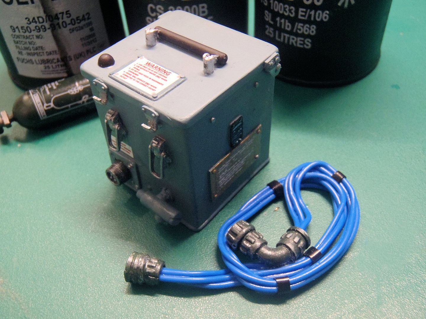

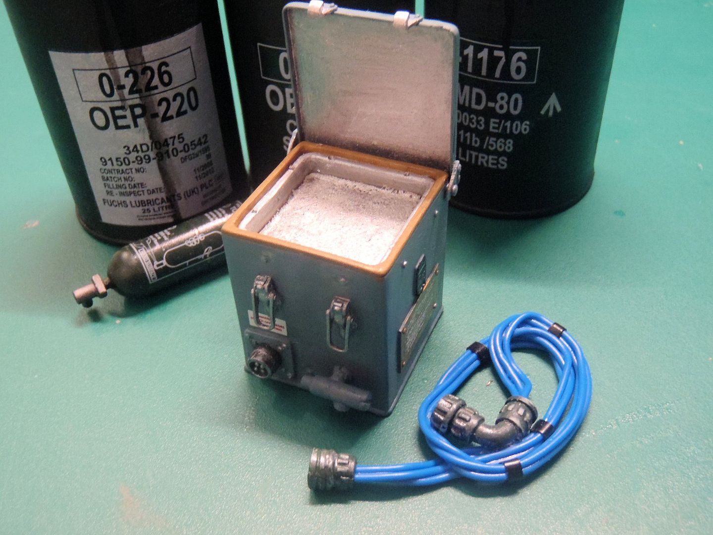

I have found some thinner wire on Ebay so I have corrected the lead to 4 cables rather than the 3 I had done originally. I have to be honest that making a solid look like water is much harder than making it look like Tea. Not really happy with the result so the lid is likely to remain closed now.

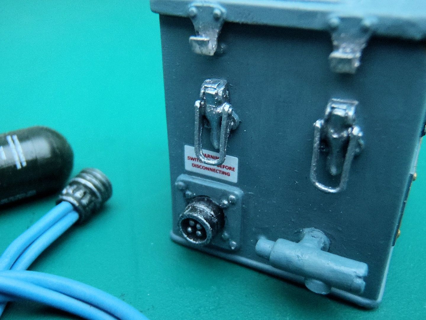

For anyone who didn´t serve , the way the BV lead is laid out in the photos provided is correct. The straight end is a female push-on connector to the BV, both socket and plug should have key-ways, key-way on the BV was at the top unless the heating element had been replaced at some time. The right-angled end is a male screw-on connection to the junction box in the turret ( TDB ).
