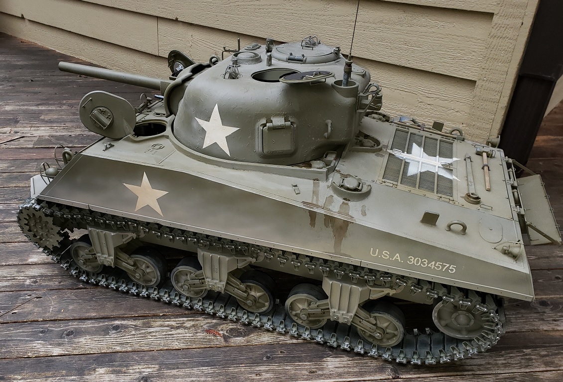

You are too hard on yourself - your M3 looks awesome. The yellow and blue markings look prefect (and nicely faded). I use the same Krylon camo for an overspray of dust on my models as well. It works great and only takes a couple minutes! You got some paint and weatherin skilz brother! I like a dark wood stain on the filler caps - it looks great over the dust for spilled fuel. See my Shermy pic below (note Krylon dust!)
