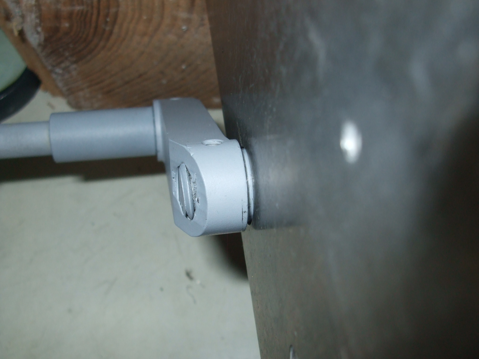

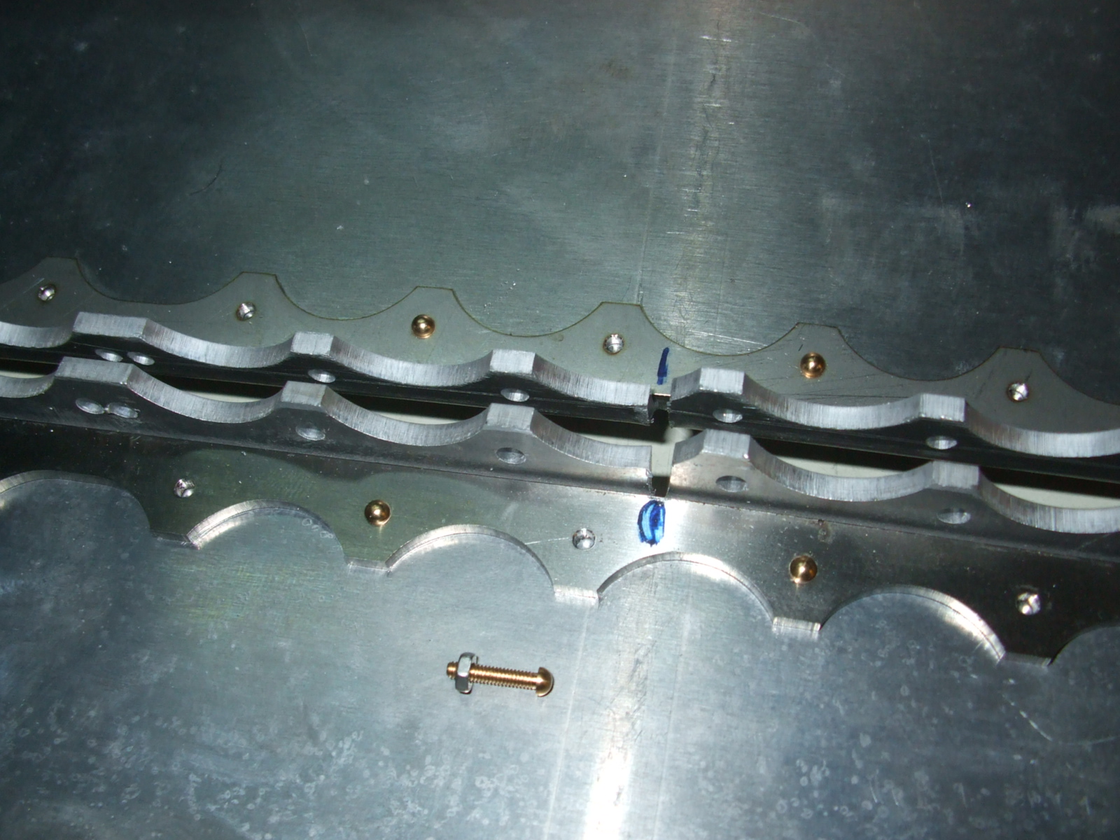

This is the spacing I have now on both sides between the swing arms and the hull.
The shoulder of the shaft just touching the brass bush.

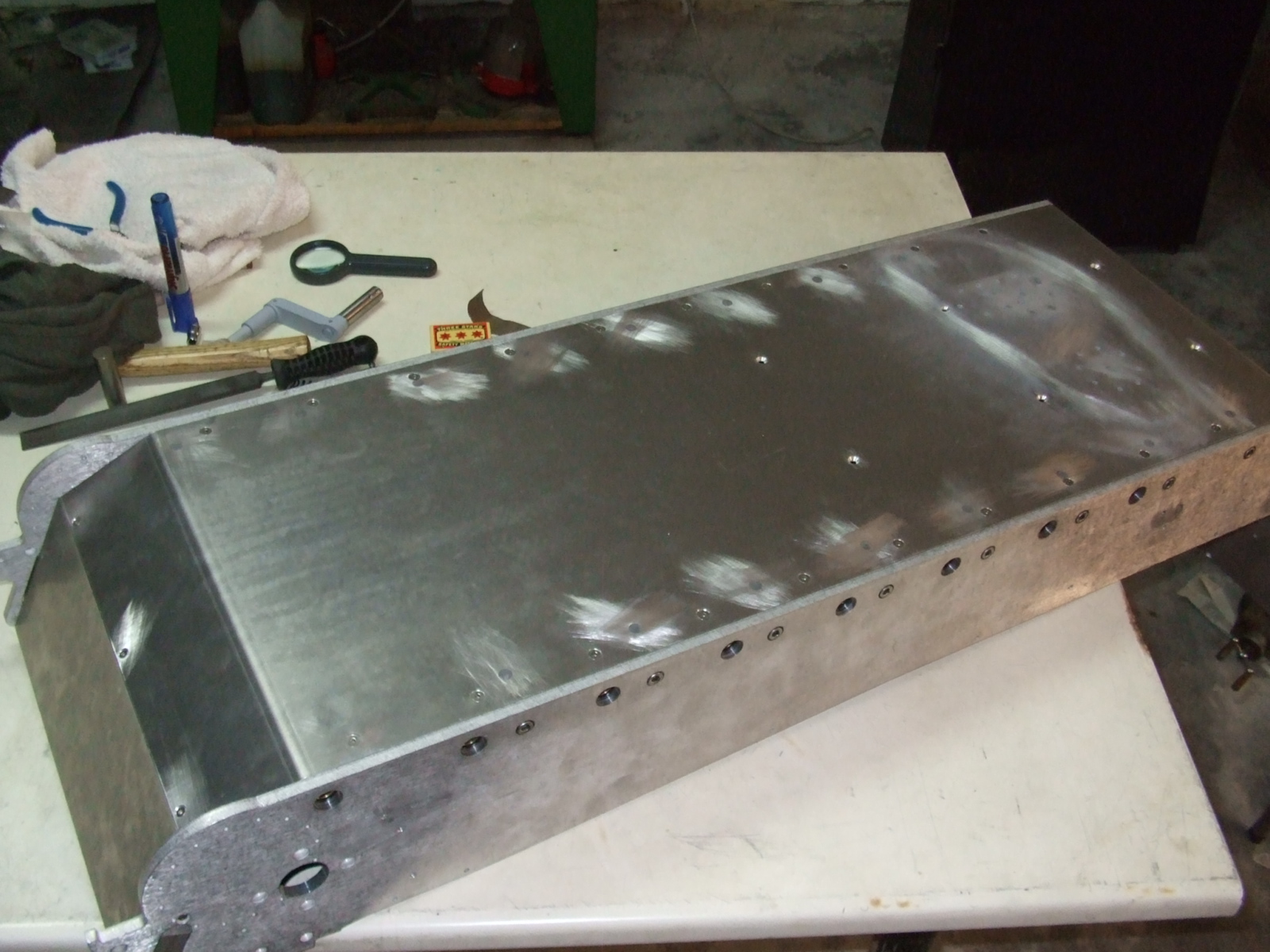

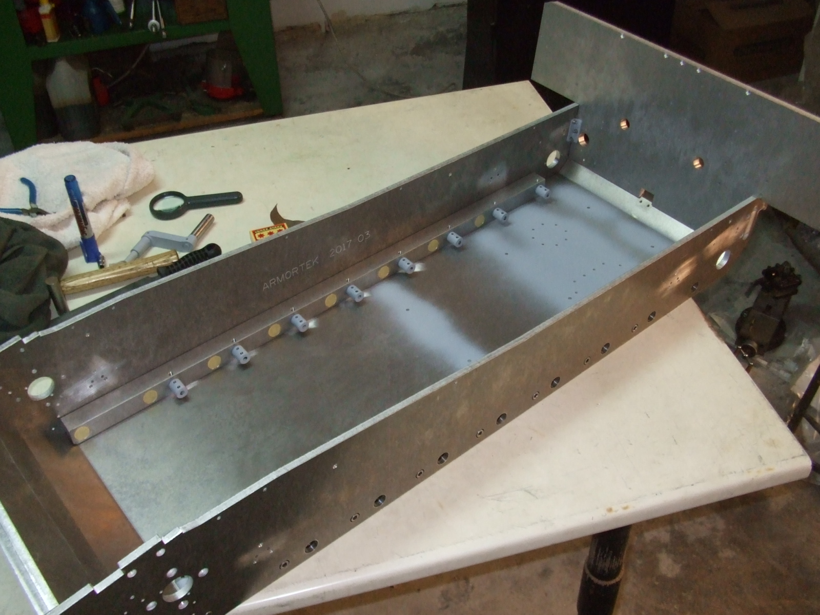

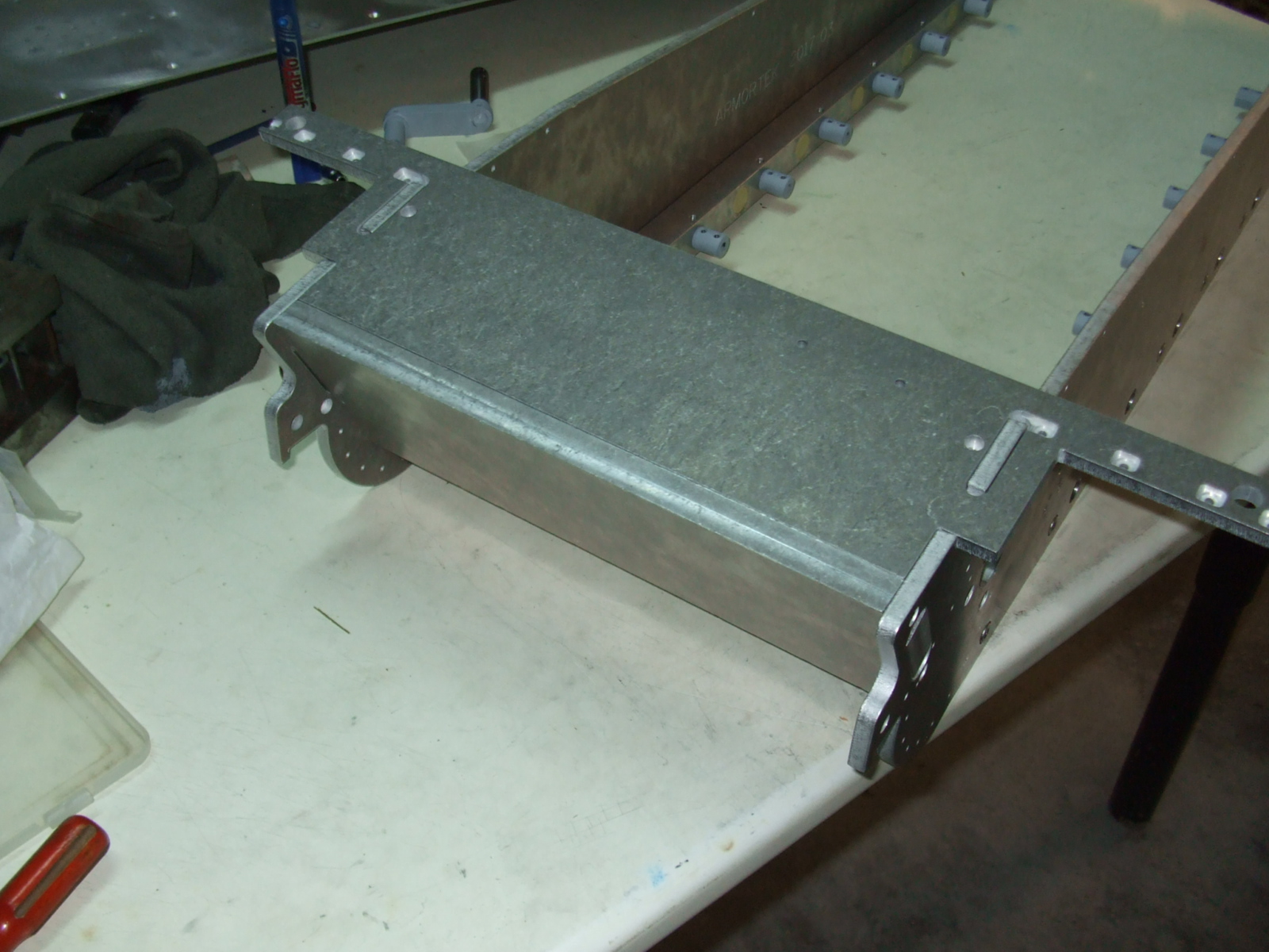

As it did not take long to fix the counterbores I had some time to spare and did the assembly of the lower hull. Assembled the suspension bars to the side plates. Tested again all the holes for the swing arms and then masked the brass bushes. Also loosely fitted the two brackets which will hold the rear plate.
Bolted up the front sloping plate. Used the glacis plate for alignment purposes only.
Fitted the rear plate and turned it around to fix the hull floor with countersunk screws.
I do not know if this is the correct sequence to follow but it seems to have worked for me. Finally officially started the build.

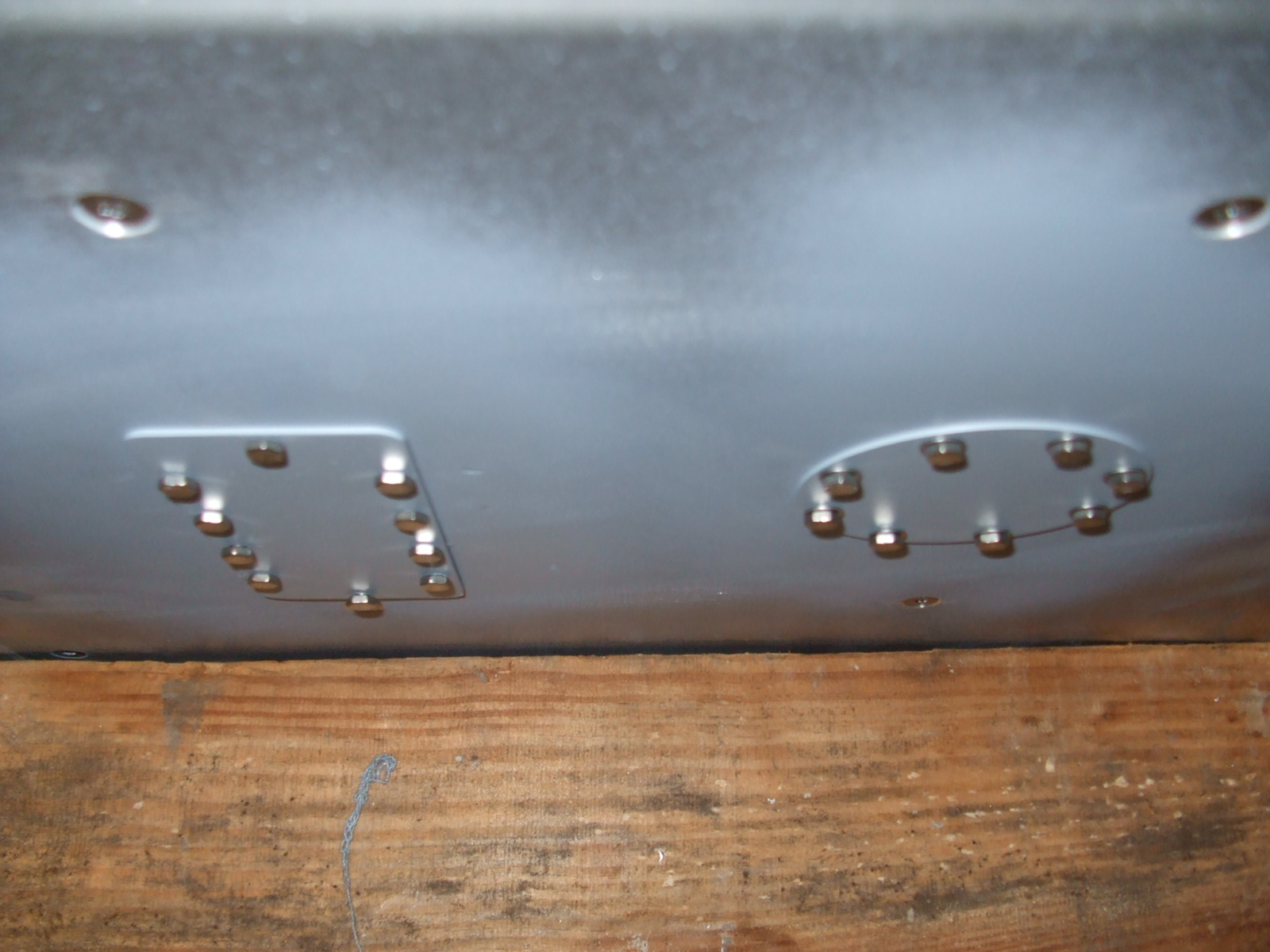

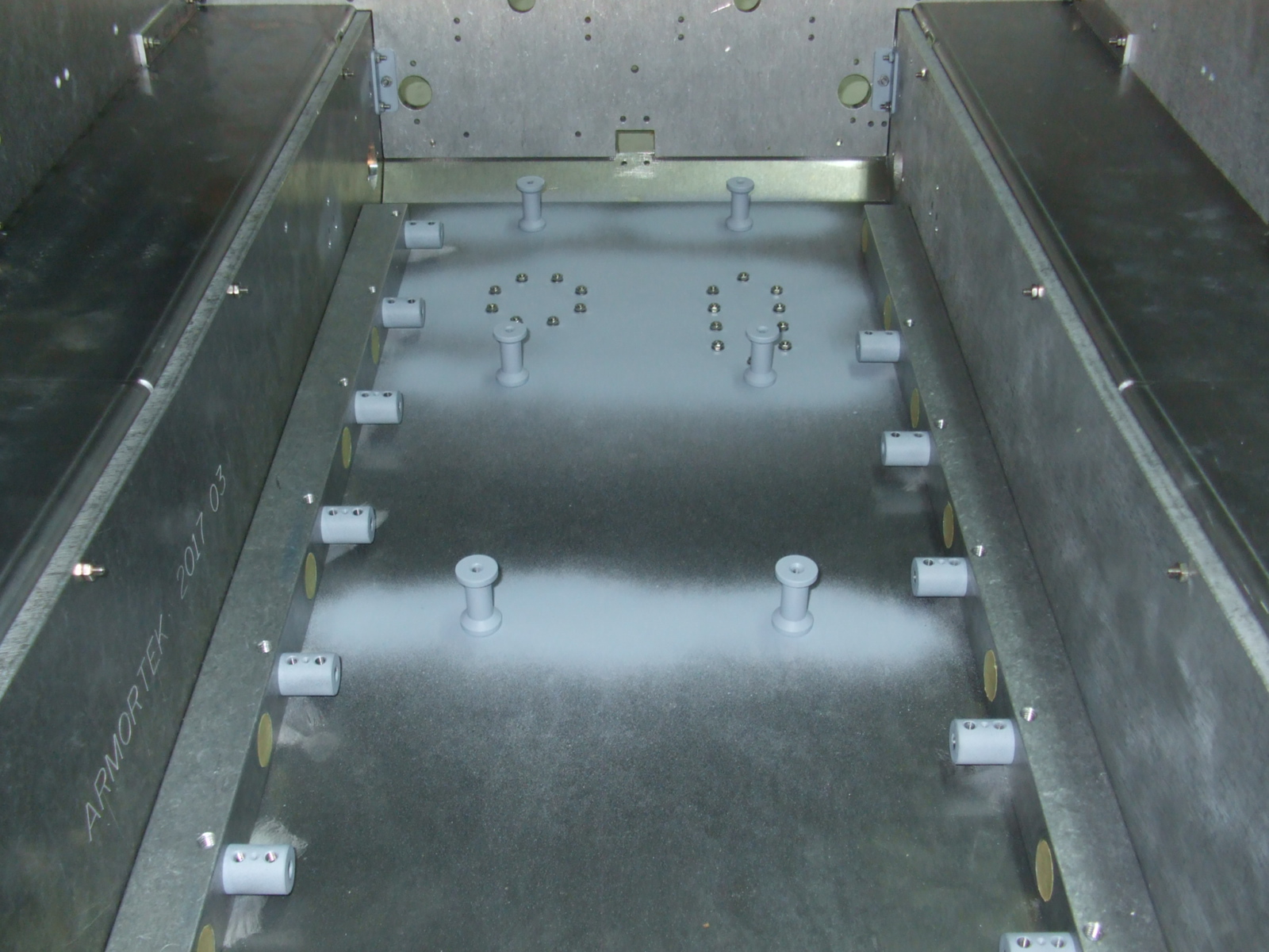

Fitted the upper part of the hull so that I can fine tune the alignment of both the rear plate and the front sloping plate.
Bolted the 6 battery tray pillars to the floor.
Also bolted the floor access panels.

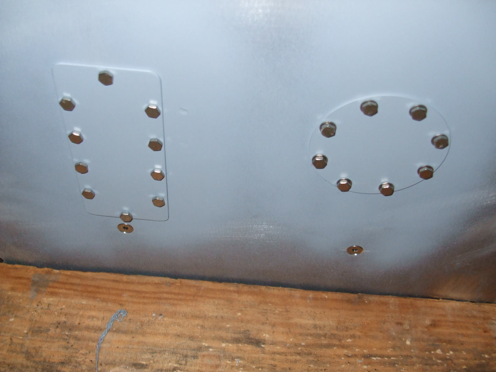

As can be seen, I used washers with the round access panel and no washers with the other one. I am still not sure which looks best. Were washers used on the real thing?

Your Tiger seems to be coming along nicely Vince.
Re the washers, the only way to know would be to study books such as the PanzerWrecks series, to see if you can find a picture of an overturned Tiger.
This is one I found on Pinterest, which doesn't seem to show any washers but the quality isn't that good.

Thanks Adrian for the encouraging comments.
I have been looking at the books I have at other parts of the tank where bolts are involved. It seems during that time washers were not common except for washers with lock tabs.

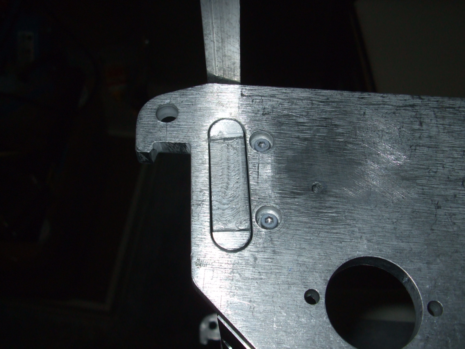

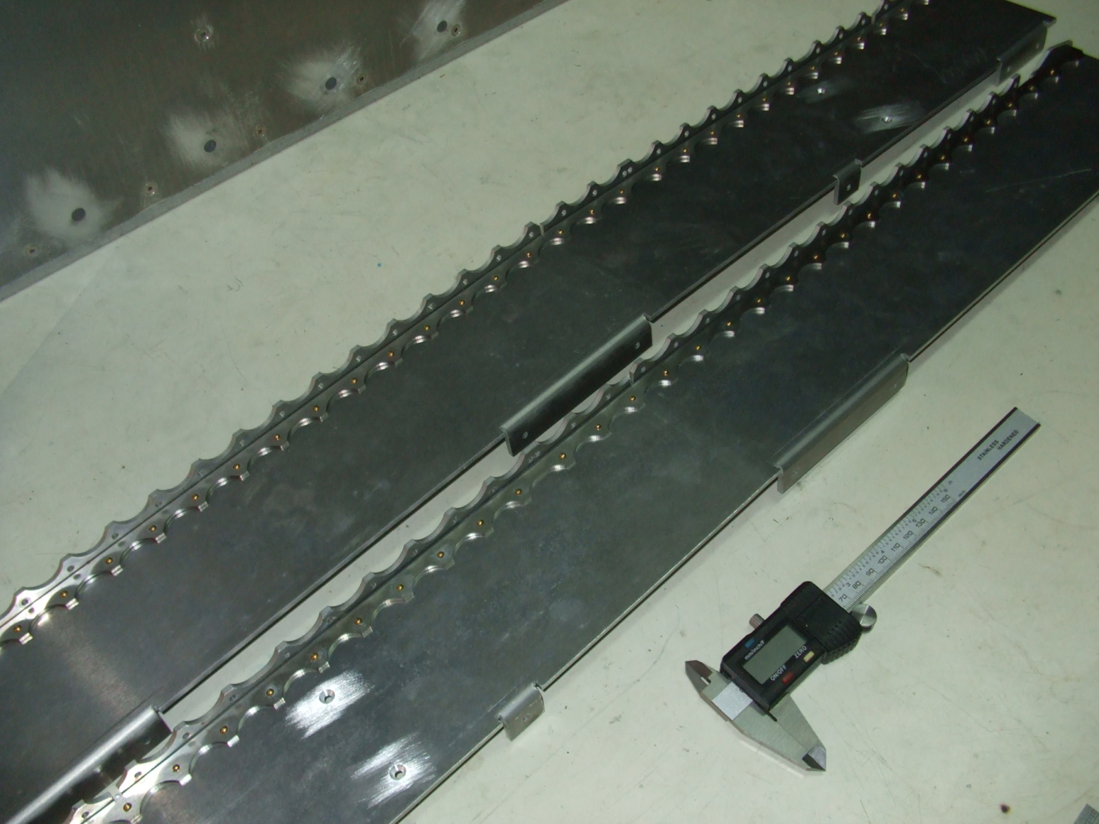

In the meantime, started work on fixing the pannier gusset to the pannier floor. Used some rivets with a threaded shank to attach them together.
The rest of the holes I will fill with glued in rivet heads. That is going to be fun.

Pannier gusset fixed to pannier.
Made some filler fillets for the interlocking plates.

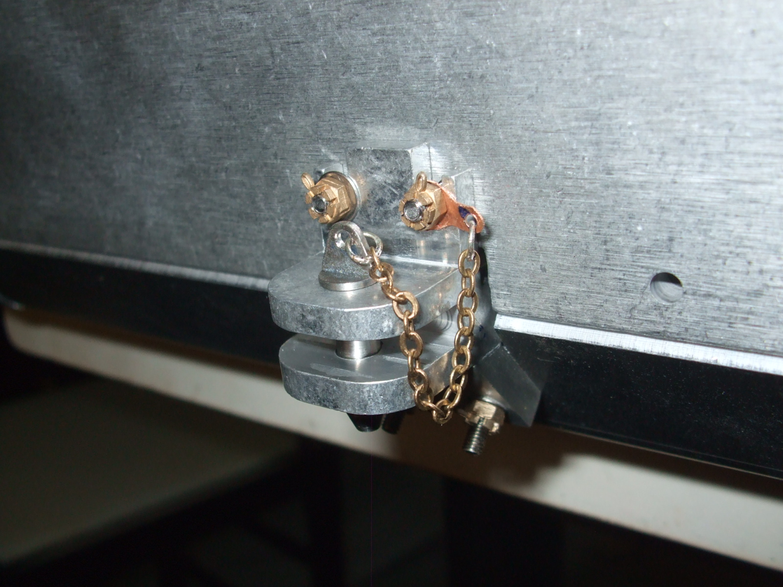

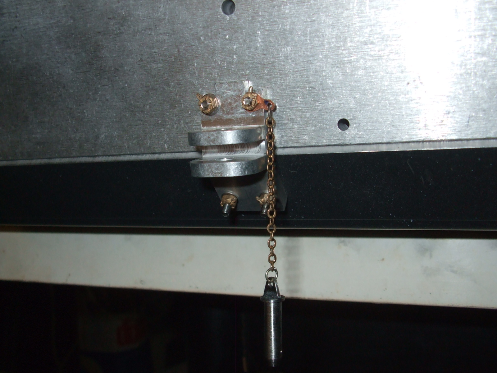

Today I felt a bit adventurous and took some artistic licence (or should I say mechanical licence). I made what could have been a field modification to the tow bracket. I added a chain to the tow pin so that it won't get lost.
