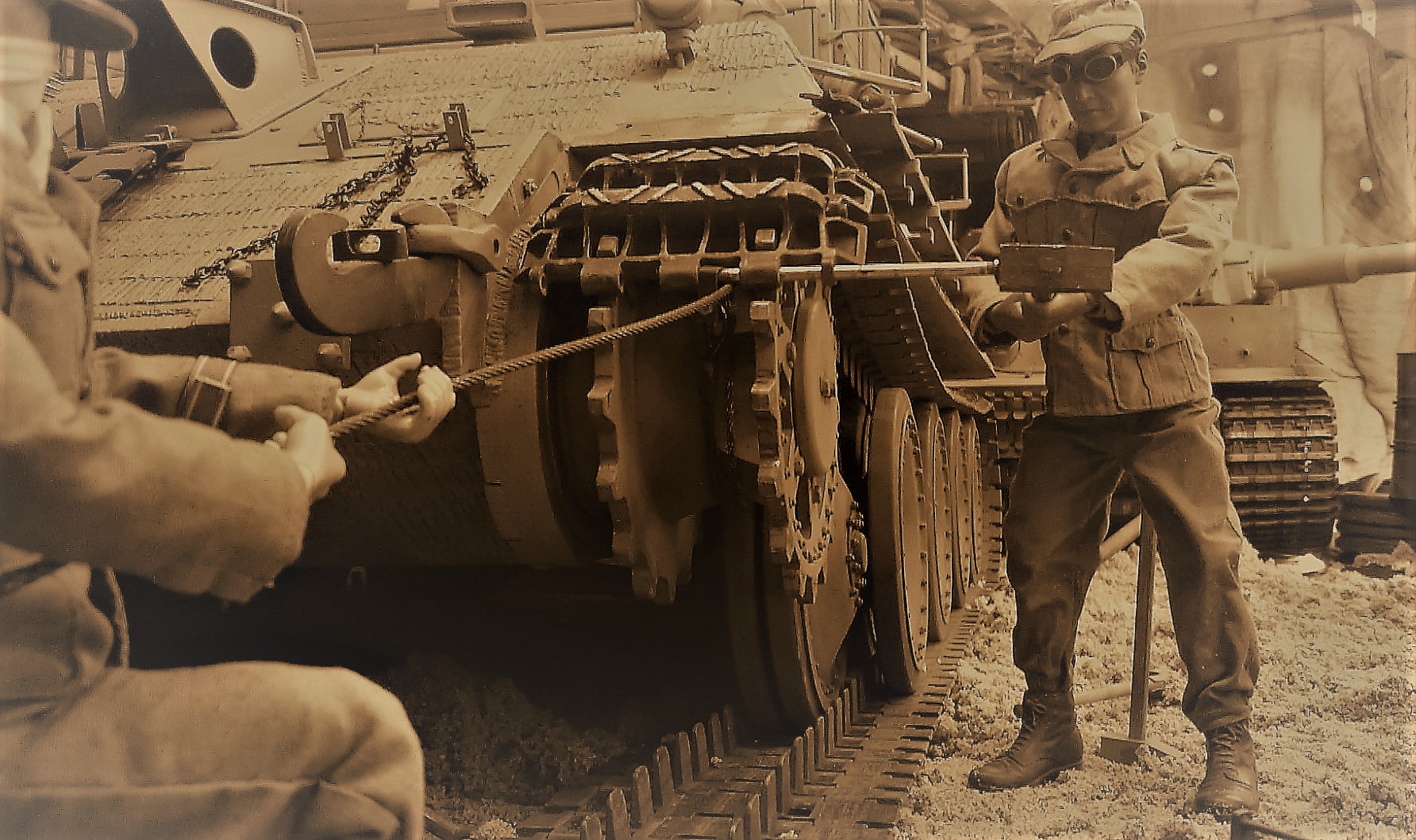

Something a little different guys, I bet you smile when you see the little guy hammering the track pin
The shot of the guy hammering that track pin reminds me of the close ups that you got whilst watching Thunderbirds or Joe ninety.I haven't used any ageing filters with this video, just toned down the colour to 20% and it's realtime to, that way the edit suite seems to behave itself cheers Phil. :)

Would you mind interrogating the little man about why he's knocking the pin back in before re-joining the track? You might also whisper in his mate's shell-like that he needs to run more track over the sprocket so that he doesn't have to lift the split track so far. And I only did signals and gunnery courses and know next to nothing about what goes on in the bottom, grubby bits of the tank. I do know about track bashing though, my first troop sergeant made sure of that - "sledge hammers aren't for leaning on, Sir........"

Thanks guys, it was a lot of fun doing it.I have had a word with the plastic army and they said they were just making sure the pin would drift in when the track links were offered up in part two ! :)

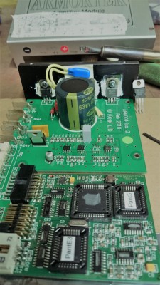

Busy day yesterday, I installed a new pair of power transistors in the Bergs amplifier and all is working as it should...thanks to Adrian for his advice and info on parts, so if you do accidentally short out the speaker connections the unit in this case was quite repairable.

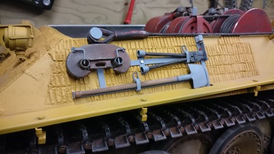

Also made a start installing the gucci tools and hangers (and I am aware that the C hook is probably up the wrong way) :?

The power transistors for those that are not familiar are the three legged components on the heat sink at the top

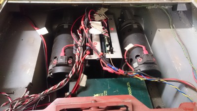

For this build I have managed to get the amp and con unit between the motors and all seems ok I just hope the crew compartment fits over the top.

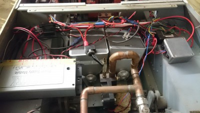

Well it's all in there so now I have to make it look half decent.
Using m2 nuts and bolts which are sooo fiddly

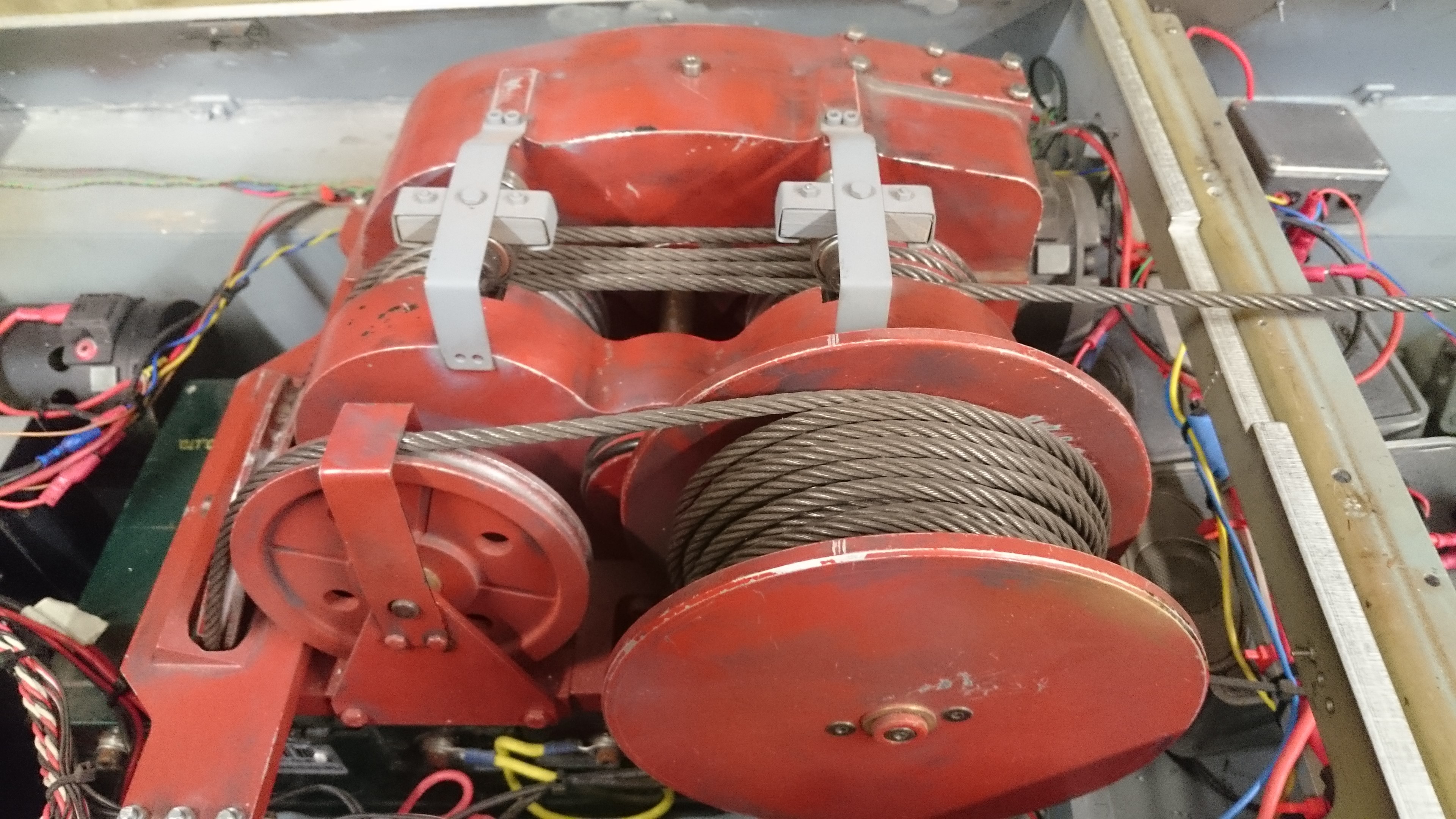

Isn't that winch a thing of beauty even in red oxide.I have made some cable tension blocks (in grey)for a little extra detail which actually help keep the cable tight by applying just a little pressure on the bearing.

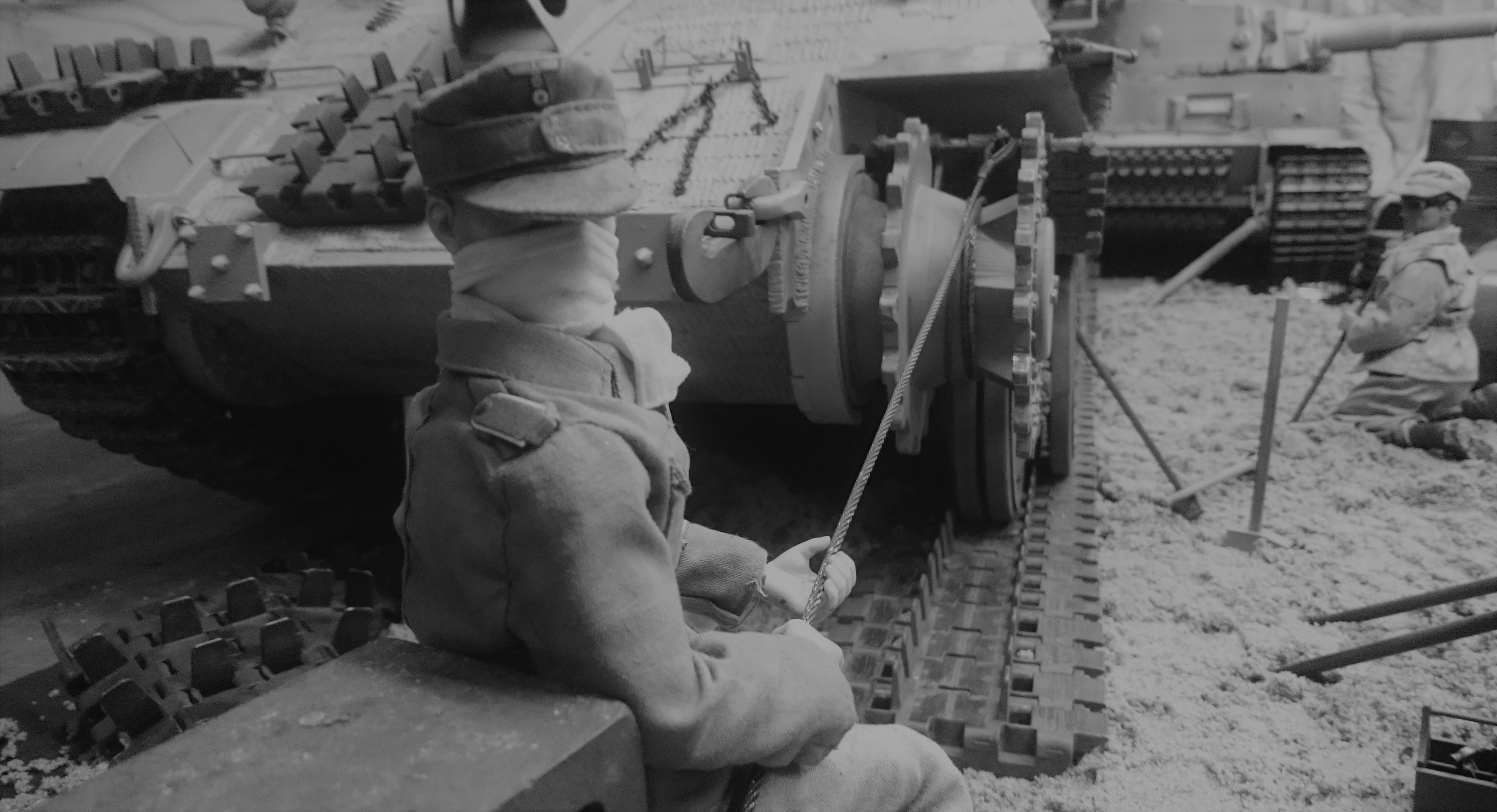

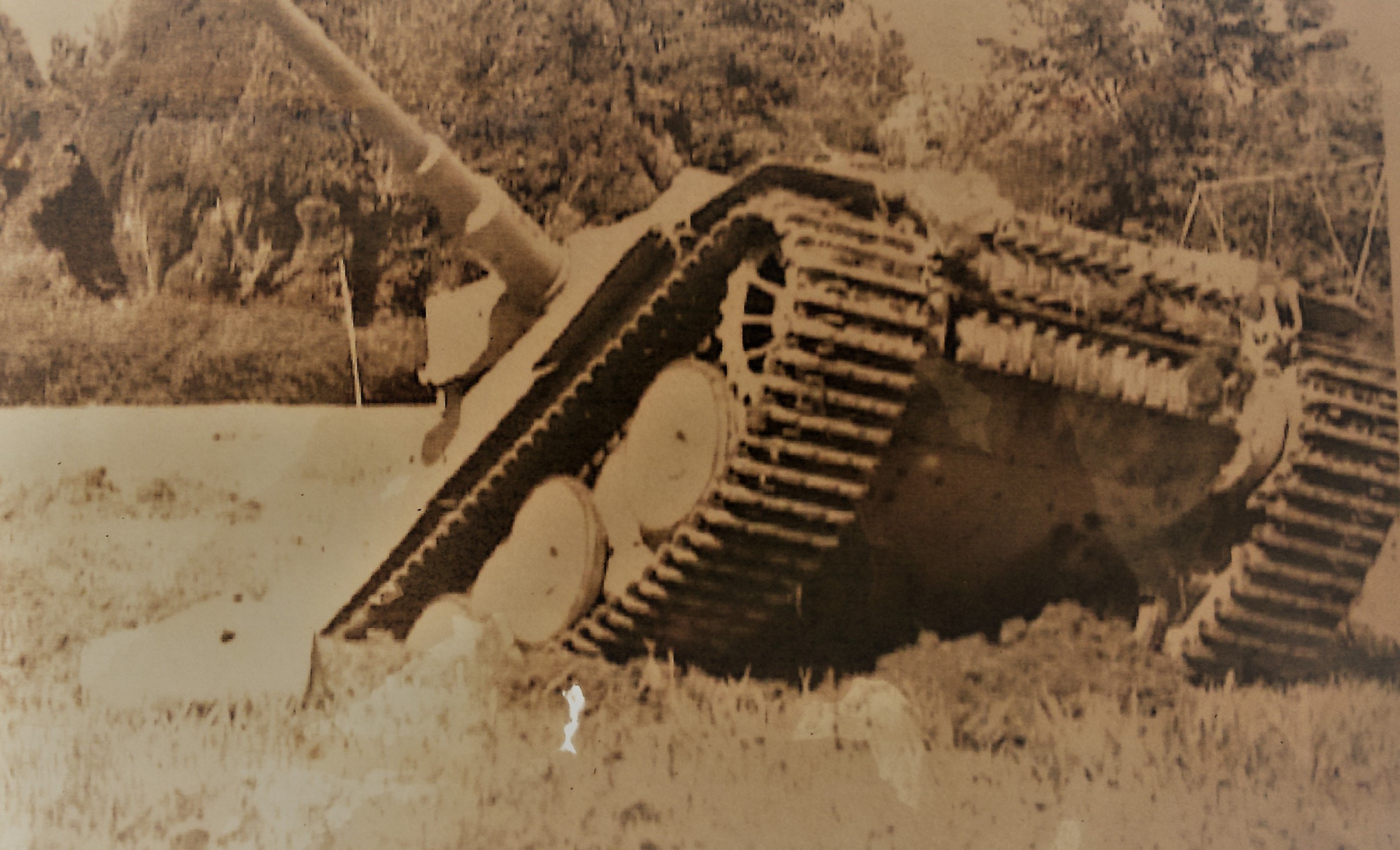

Some Stills taken from the last video shoot, also some recovery subjects to think about.
How the hell do we recover that?
A fairly straight forward recovery? As Stephen says "pull them out the way they went in" but the shell crater has steep sides and the rear plate will dig in, so we will drag it out forwards.

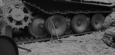

The guy with the hammer is concentrating hard but still looks like he has sh.t himself !

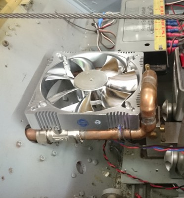

The Bergepanther is such a busy vehicle, there's so much going on..tons of kit, tools, spares everything your going to need to work in the field.

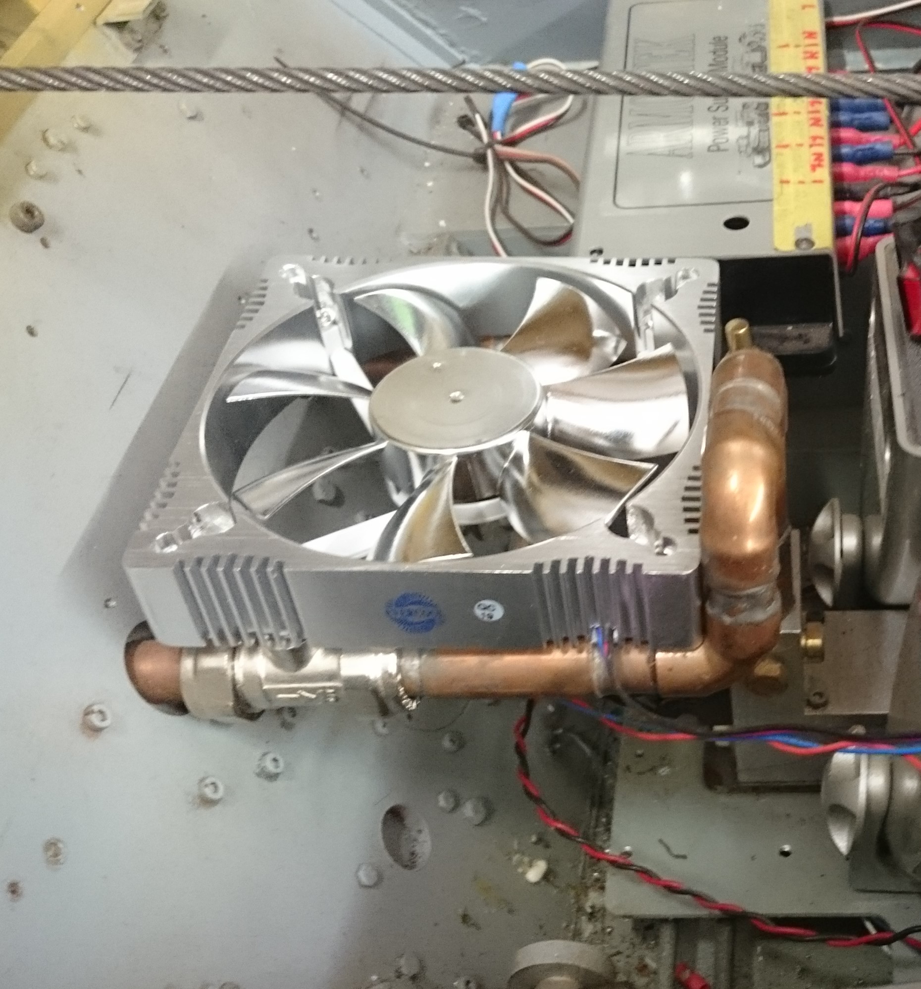

Now that's a fan
Now that's a fan

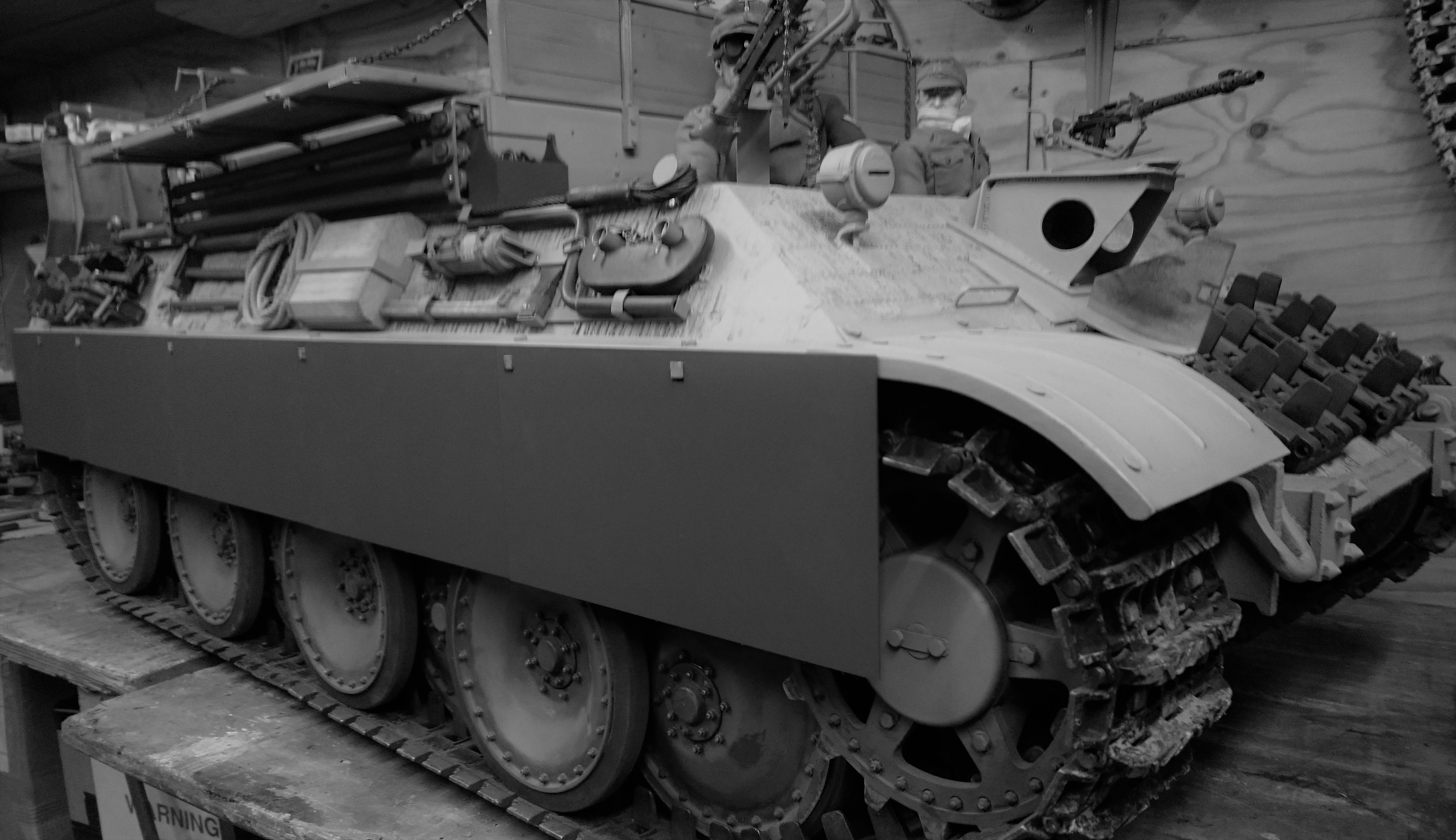

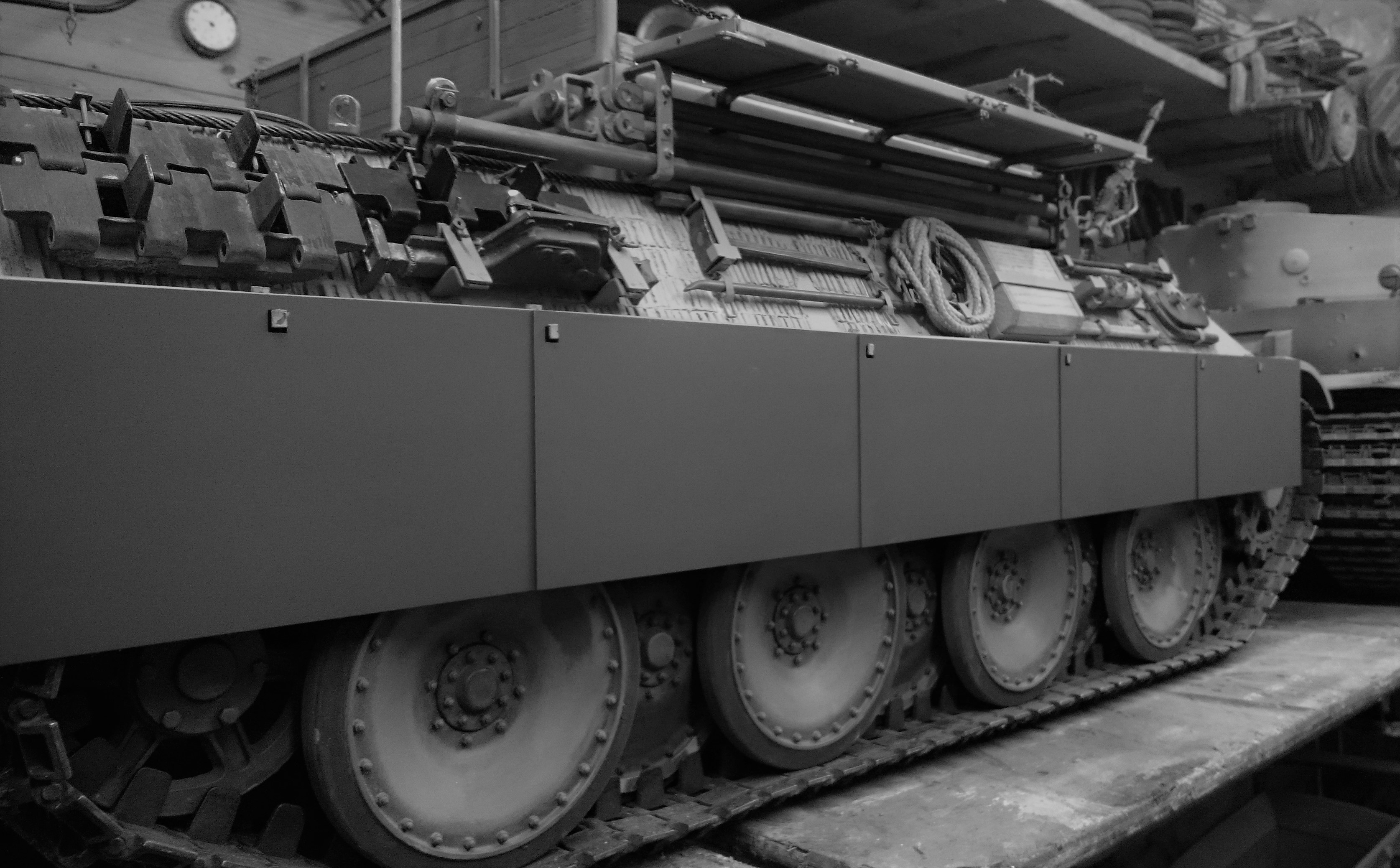

It all looks a bit to fresh and new at the moment so weathering to commence soon

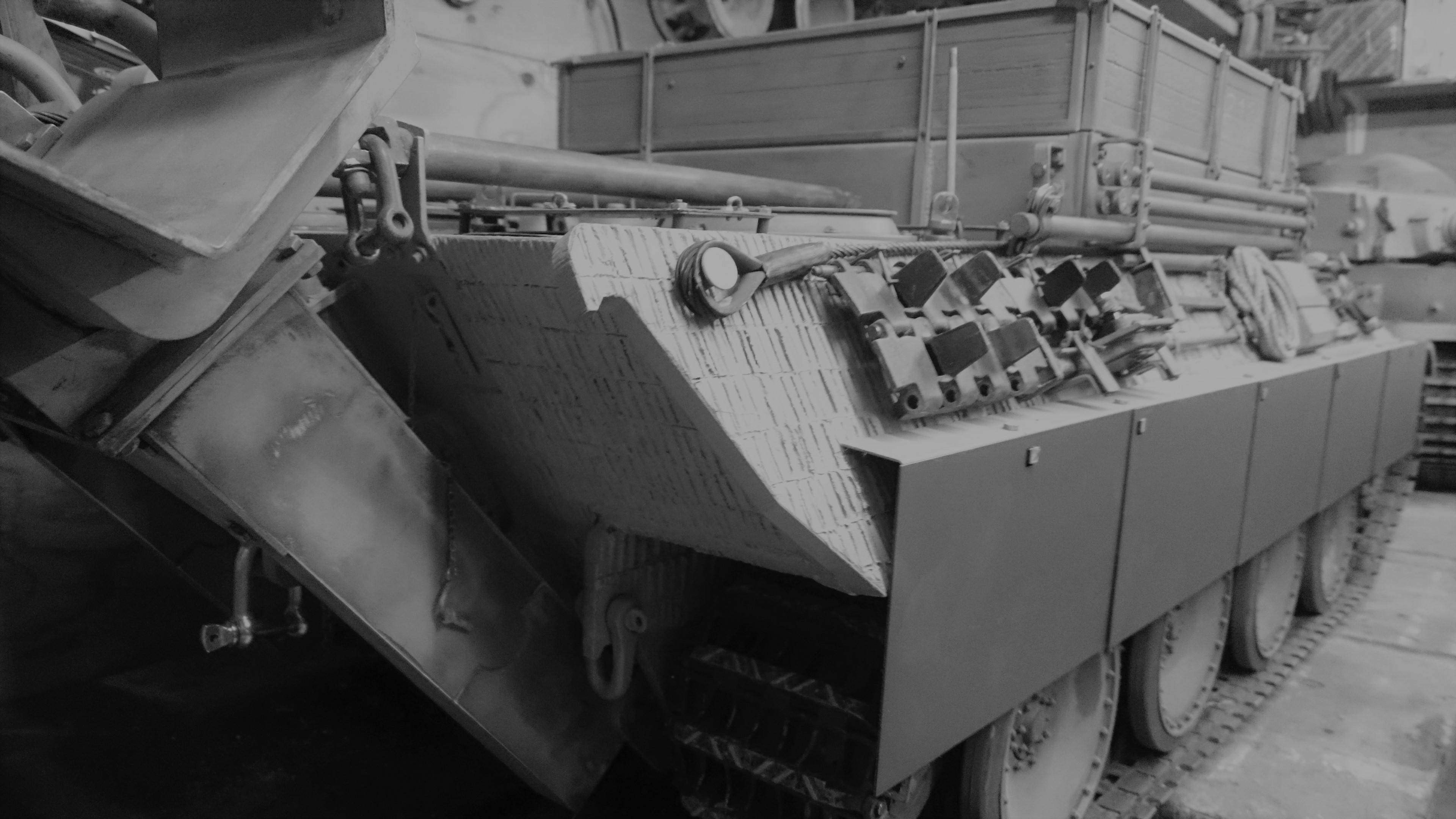

The bazooka plates are far to clinical so lots of work there

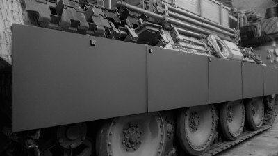

It seems to me that most people prefer to leave the plates off so that the running gear really stands out and I agree it does but I prefer the look of the vehicle with them in place , I may remove one or two just to make it more interesting
I also like the way the plates swing about when we are filming the vehicle

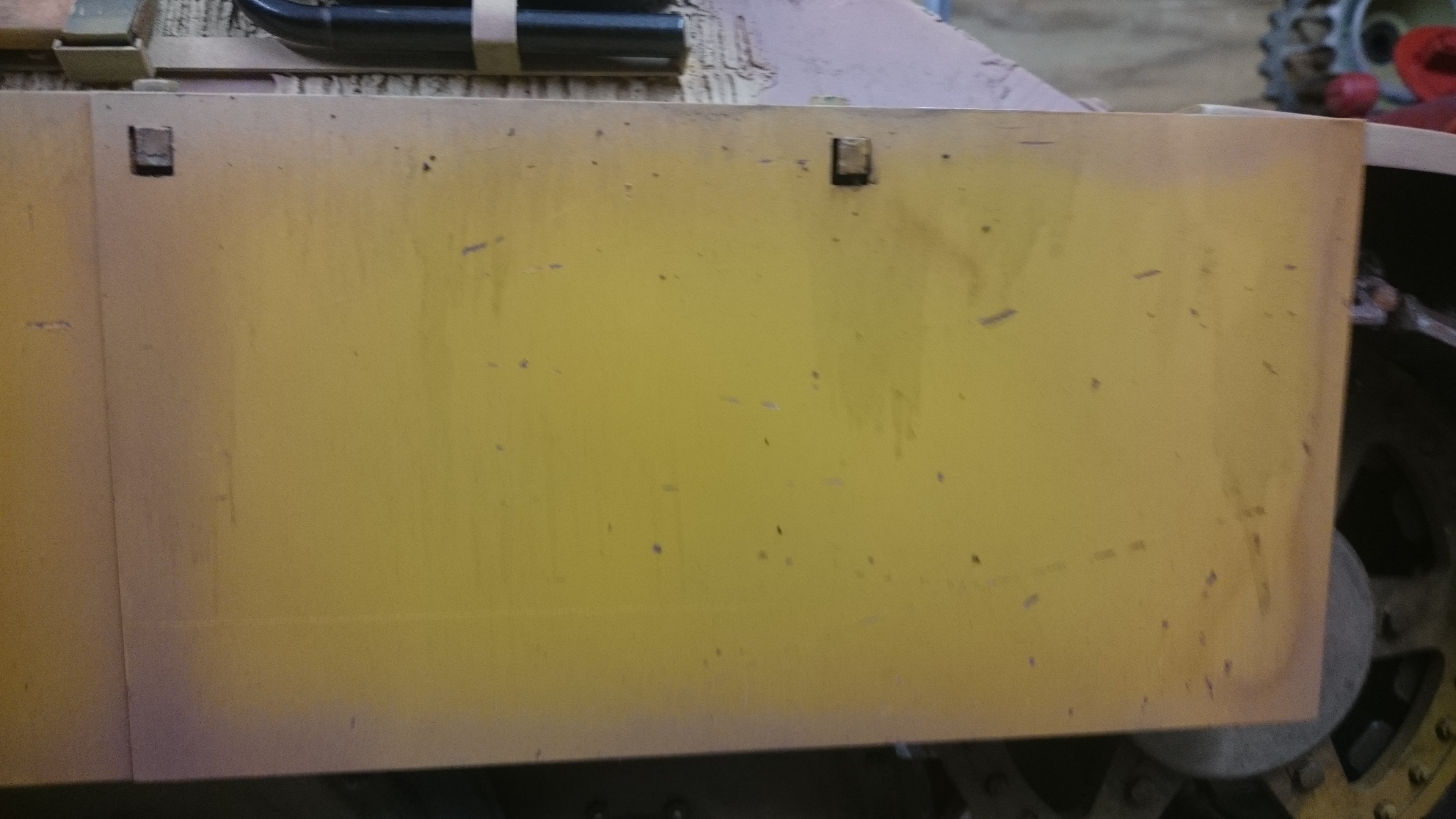

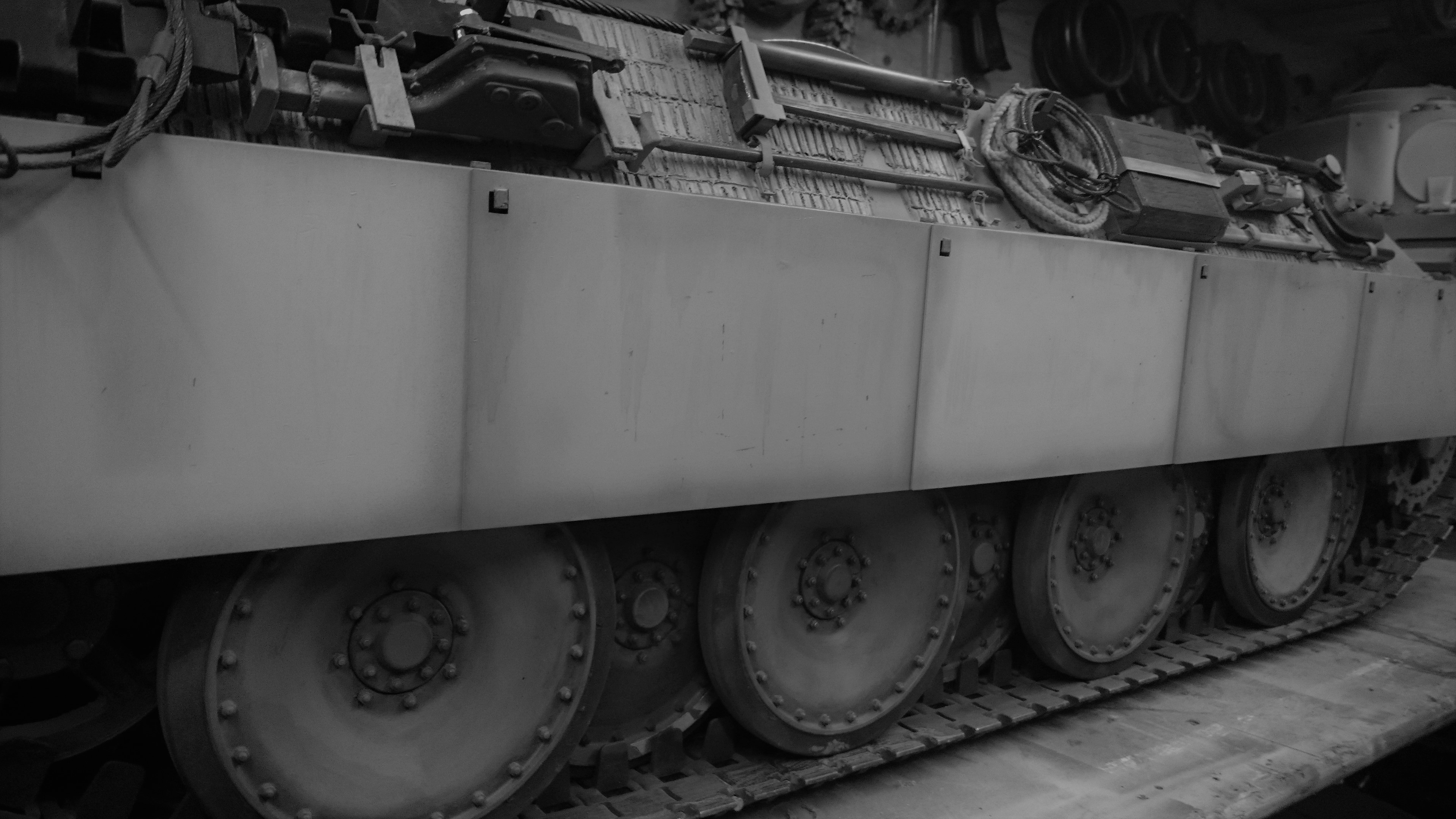

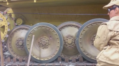

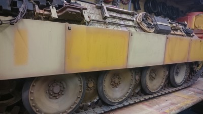

Basic initial weathering adding staining,chipping and scratches the odd colour contrast will become relevant later. I may leave the plates out in the rain for a couple of days to allow some authentic rust from those chips and scratches cheers Phil
