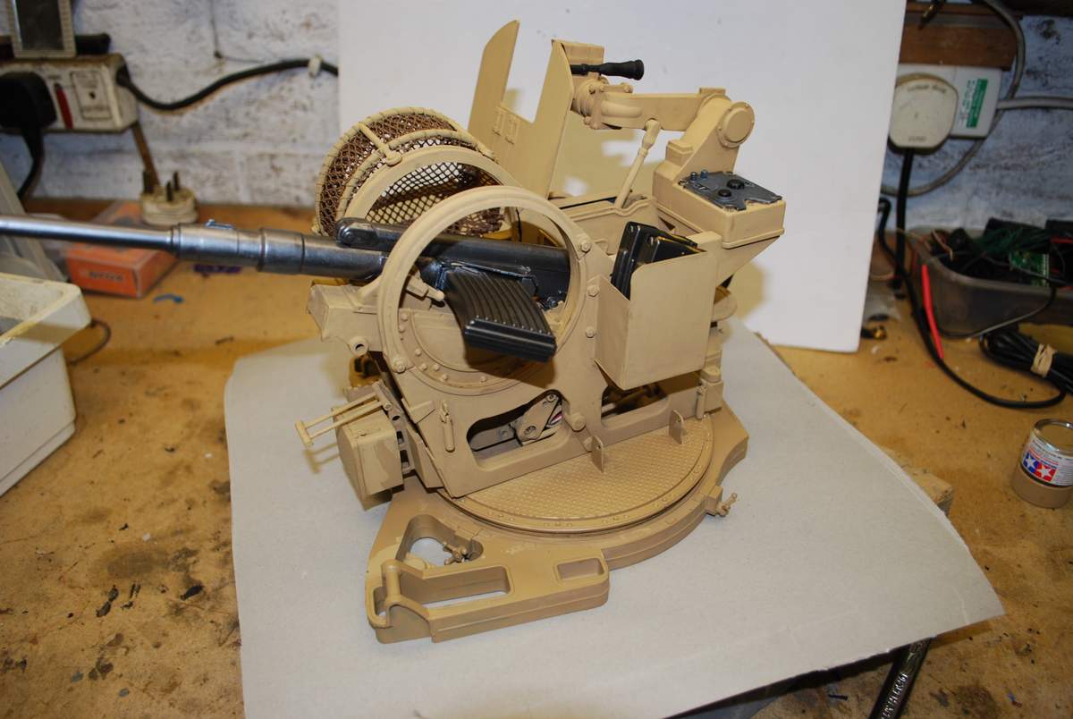

The Flak 38 was given to me by one of our Club members. It is a Dragon 1/6th scale in plastic. It was all in bits and the gun elevation mechanism was all seized up so I had to do a bit of dismantling to get it all working.I don't think Dragon make the kit any more but I did see one on a site in the States but although it was $50 they wanted another $50 to ship it to the UK. I would have liked to scratch build one in metal but it would be quite a job especially without plans. You might find one somewhere.

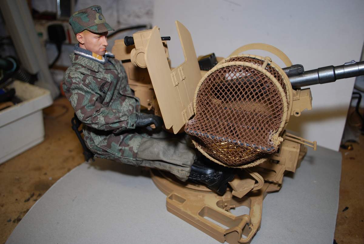

Change of colour for the gun and now that is finished I can concentrate on the rest of the build.
