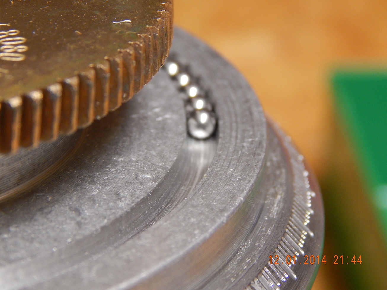

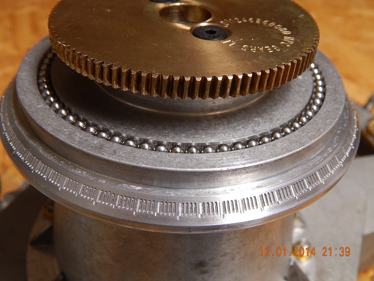

I've made today some functional improvement on the rotation of the Flak on the base.
Have had a turret of the 1:10 Panther in my hands and got an idea :idea:
So I made a kind of ball-bearing system to ease the rotation of the more and more heavy Flak.
Some details:
On a diameter of 88mm (cool value, isn't it) I made a slot by 4,0mm wide and 3,4mm depth with an 4,0mm radius mill cutter (and the WD40 :lol: )
Put in 3,965mm steel balls, 70 pieces of I think an Inch dimension just a bit smaller than 4,0mm
It works that good that you can rotate now with just the little finger alone :D
Greetings from Cologne to all watching my build :wink:
Uwe

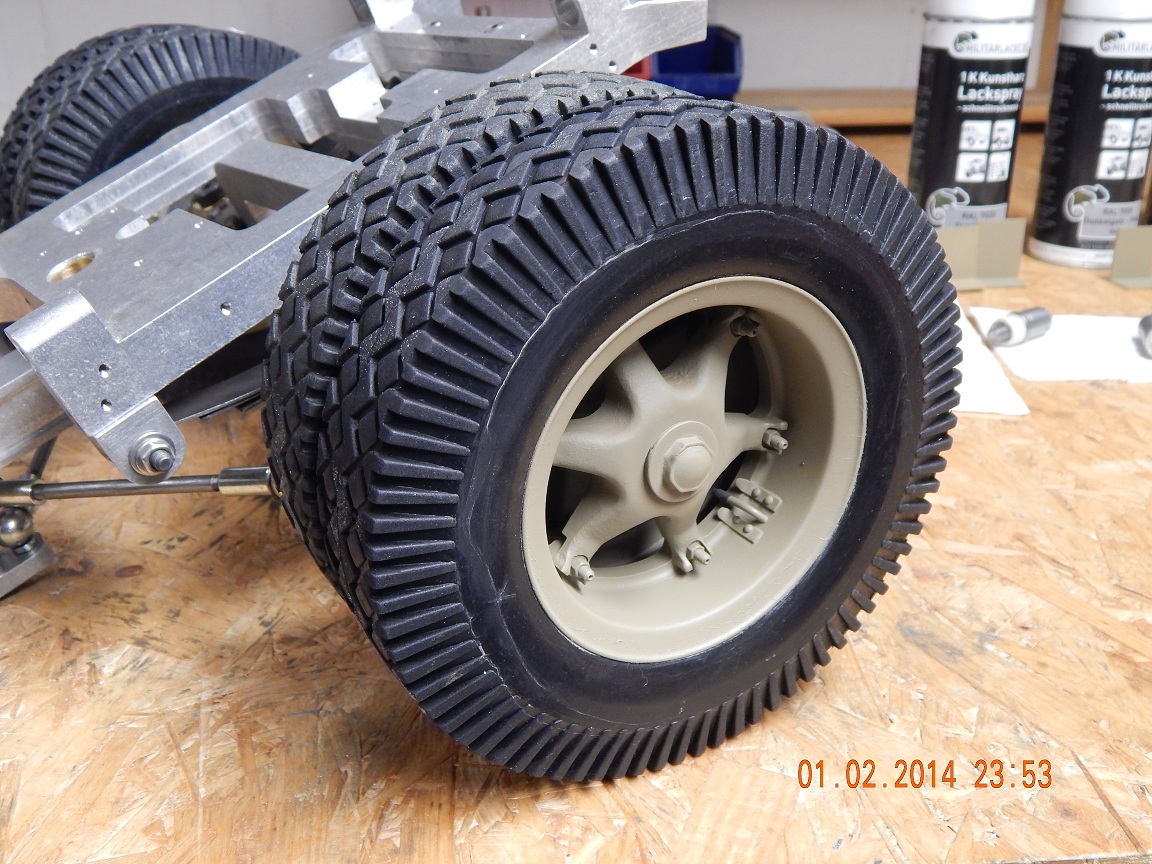

Quite busy again but had at least the chance to "fight" over the last days a few hours with my wheels :shock: :roll:
After the first failed trials to get the tires on the rims I've been obviosly a bit
frustrated , so I got "Mr.Frusty" from my wife :wink:
"Better to smash him to the wall than the tires", she said :lol:

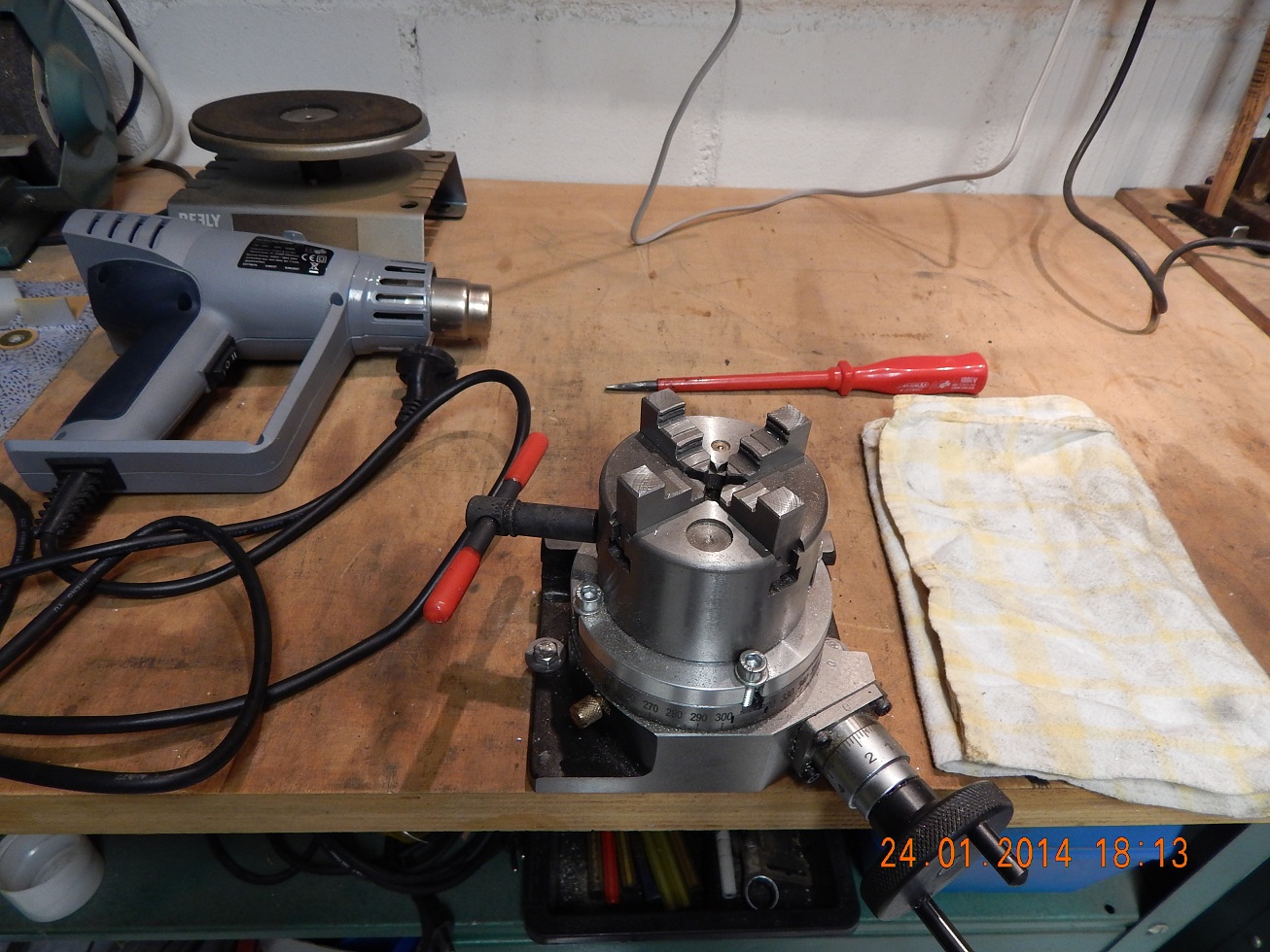

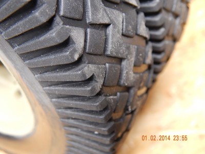

So I thought it's maybe helpful for someone to show what I've done to get it fixed.
Rule No 1 : No mercy to the tires, go up in smoke or fit on the rim :twisted:
Rule No 2 : Forget any high paint efforts before the tires are on the rims.
I bolted my small spacer on the workbench to really fix the rims.
I took my heat gun, second position (roughly 600°C power) and rotated slowly over the tire in distance of 30mm, changed the side two times to heat it through properly for about five minutes in total...
Don't stop at one point with the heat gun :!:
I took the best dish-towel of my wife 8) :lol: , since the tire is pretty hot but now flexibel enough and pressed it as much as possible on the rim.
Any grease or "Flutschi" is contra-productive and will just kill your nervs !
The last centimeters I convinced the tire with an old prepared and rounded screwdriver just with brutal force cm by cm to hear the desired "plopp" :wink: :roll:
The last and final setting again by hand to get the tire properly seated on the rim :D
I've got all eight wheels done within less than two hours. Some rework on the first layer of the base paint is acceptable I think
Hope its helpful for another "Newbe" like me with this massive tires :)
Uwe

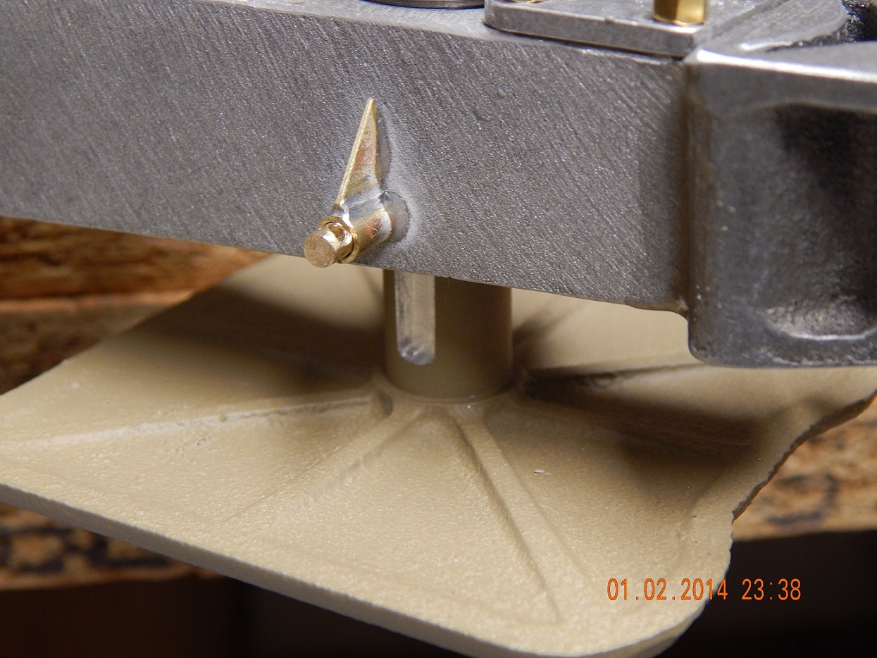

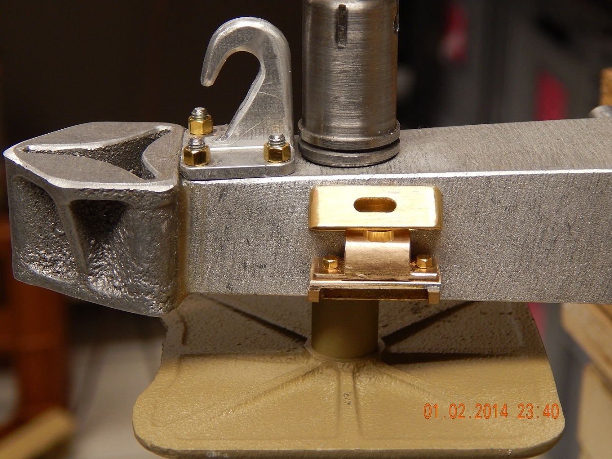

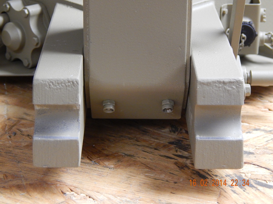

So over the last few hours available for the Flak I could do some little progress again on the cruciform and the wheels :)
I made the leveler with its brackets and protection-covers for the arms,
the first one fitted today and I'm quite happy with the result so far :D
Some mods on the upper edges of the cruciform and the "guide pins" of the jack-pads (hope that is the correct word for it ?? :oops:) have been realized.
Close to the hooks I've replaced their fixings as well.
On the jack pads I made the co-relating grooves to avoid rotation while leveling up or down.
On the wheels story I've got a quite hot finger removing all the residue on the outer profile blocks with my little quarter-file, but looks much better now for me :shock: :lol: :D
Cheers :) ,
Uwe
My "long lasting" Levelers  ;-)
"Guiding pin" made for the jack-pad and fixings improved for the hooks

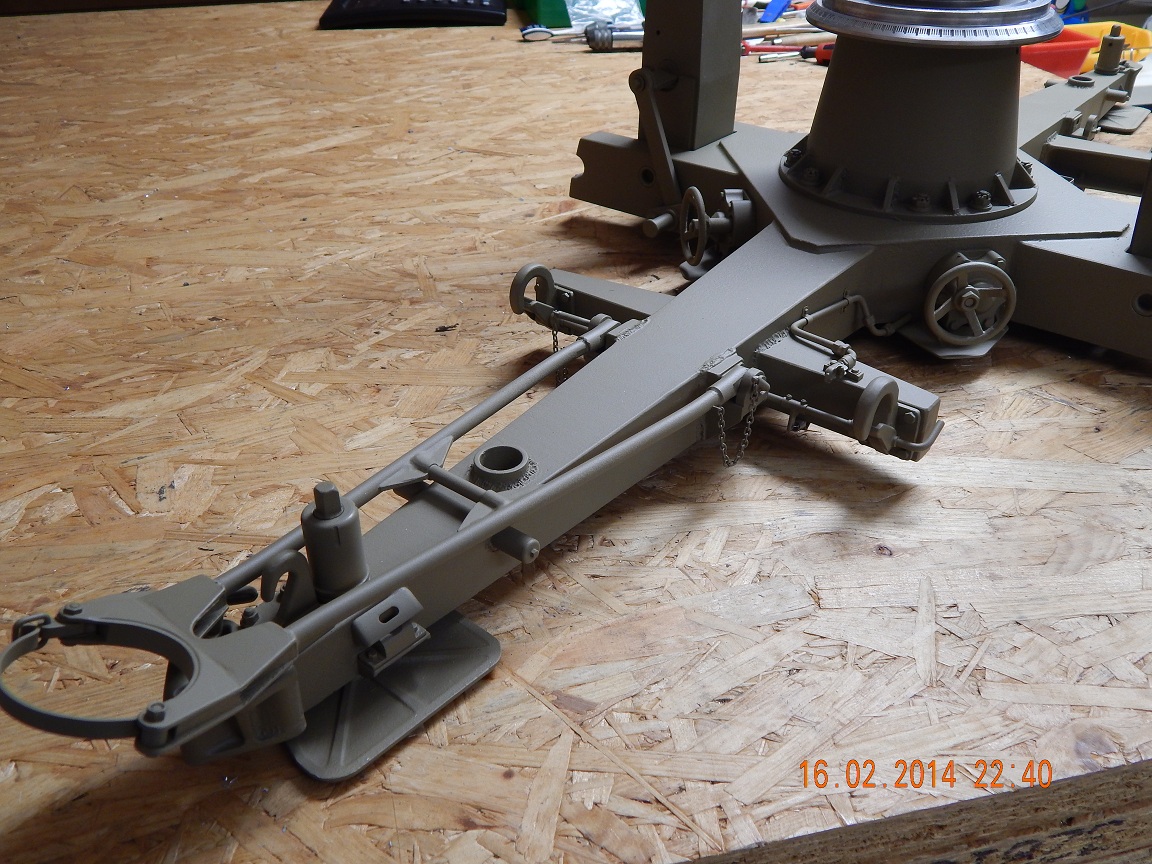

Uwe Gerstenmayer
Posts: 224
Been liked: 72 times
Re: Uwe's 88
Post by Uwe Gerstenmayer »
Hi Paul,
hope you're doing well and come along with all your "projects" :wink: :lol:

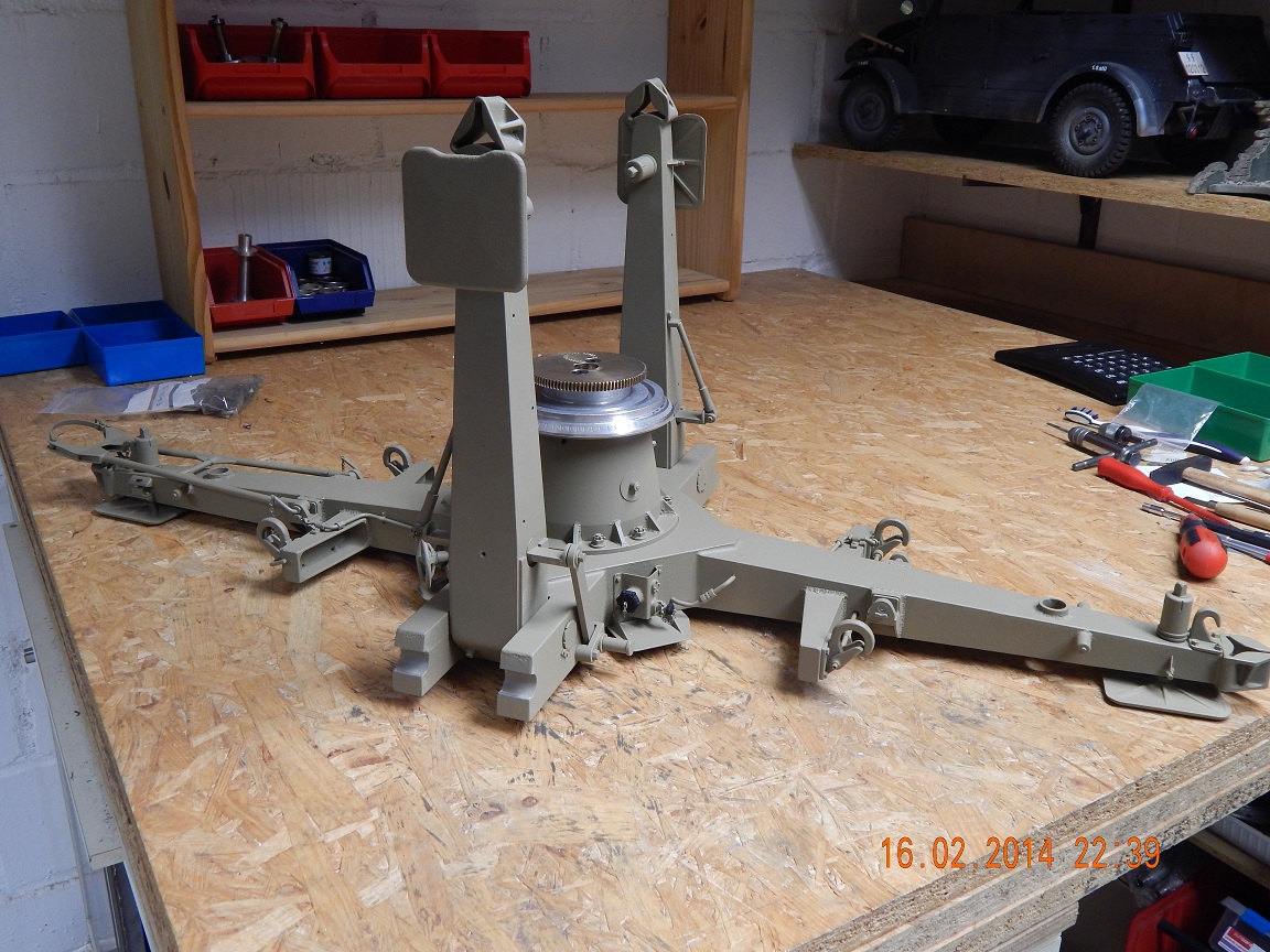

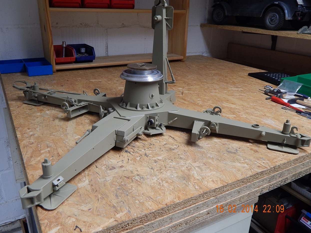

I've been a bit "out of order" the last days but could realize some small bits and pieces on my Flak again.
The cruciform is at least base-painted now, on the dial I tried myself with wipe painting :shock: .
The levelers are all complete and mounted and the grease-ports for the folding arms have been added.
The remaining details on the folding arms are still on the "workbench" and will be mounted once completed.
Now I'm really looking forward for Tims fantastic "little Masterpieces" to be added to the gun :wink: :D
cheers for now,
Uwe
Cruciform base painted now
Dial wipe painted
Dial wipe painted
Grease-ports added to the folding arms
1:16 Models: Kingtiger
