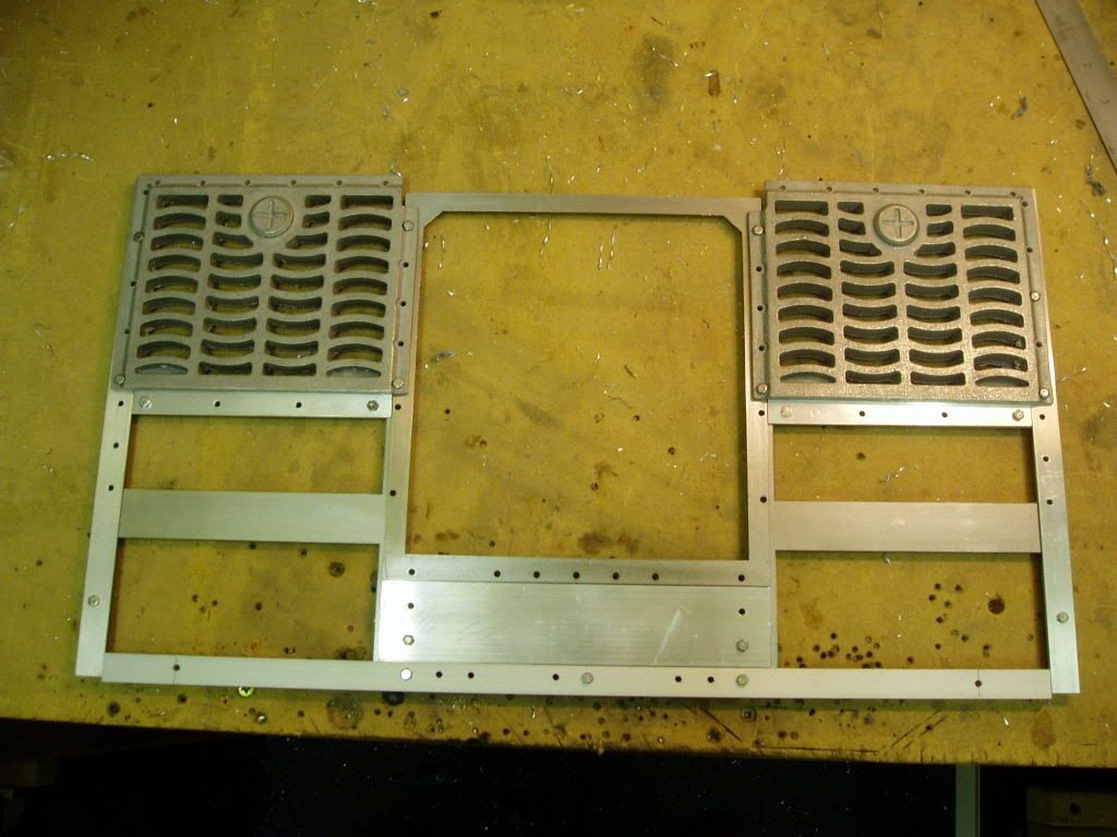

After taking a break from building my Tiger, I'm back working on the tank. The biggest hurdle is to complete the rear deck lowering. At first I was going to build up my own grille support but have now used the remaining original back section. A 1/2" angled steel was welded to the leading edge to help support the weight of the grilles and to replace the edge that was lost when the rear section was cut off. The engine hatch had no support so I welded up a box out of 1/8" x 2" steel that fits inside the opening. Now the 1/8" edge supports the hatch nicely. A small rubber seal will fit into a groove for hatch to rest on. The reason for the 2" box depth is I'm planning to build up the top of a Maybach engine that will fit inside. The entire assembly is removable for access to the rear hull interior.

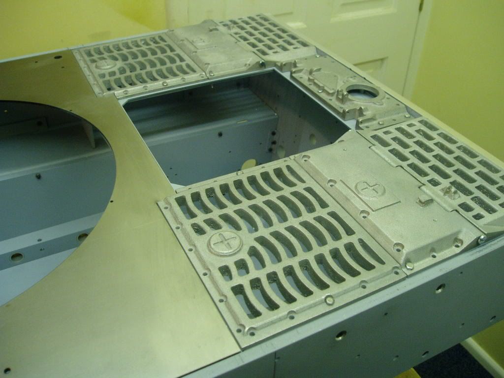

You mentioned that an unpredicted bonus with this mod is that the front of the rear deck is held under the rear of the forward deck.
I see the fwd grills rest on top of the deck supports. Is it the engine hatch support that is held under the forward deck.
I saw that you sold your tiger. I'm watching your progress with the panther. Really nice.
Thanks for your help with this.
John
Steve Norris
Posts: 1231
Location: Manchester
Has liked: 8 times
Been liked: 701 times
Post by Steve Norris »
Hi John.

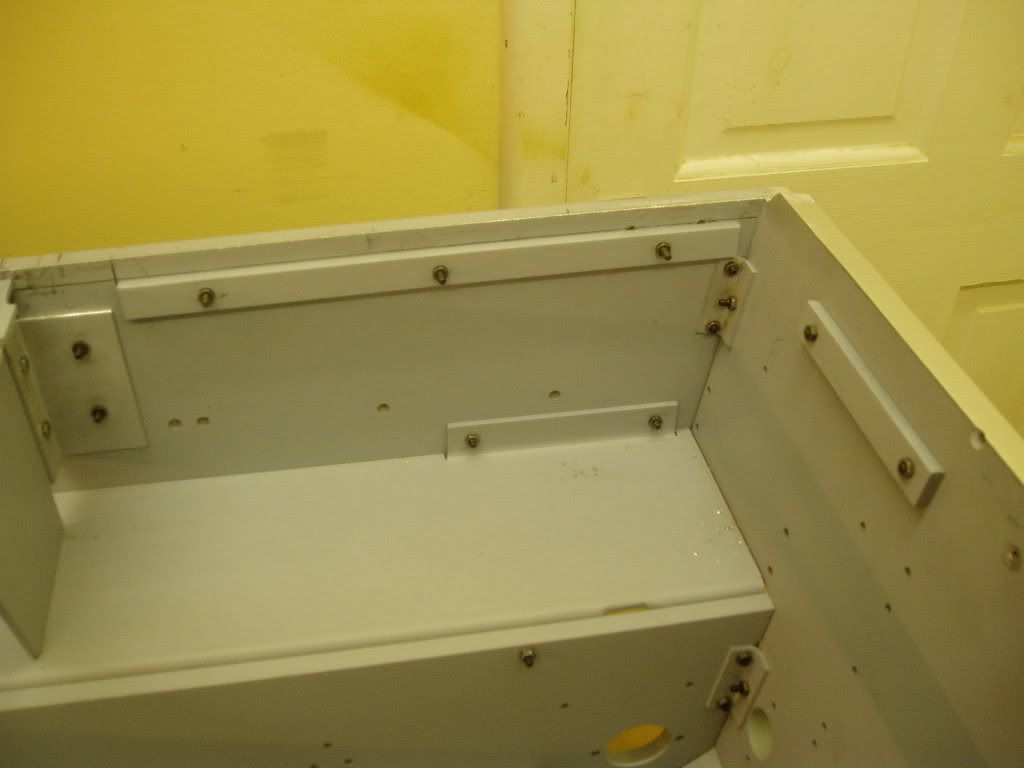

Yes you are correct, The forward edge of the engine hatch support fits under the rear of the fwd part of the hull top. sounds complicated but i think this shows what i mean.
Heres a couple of shots showing some of the mods to the rear deck and packers used to get everything in the right place.

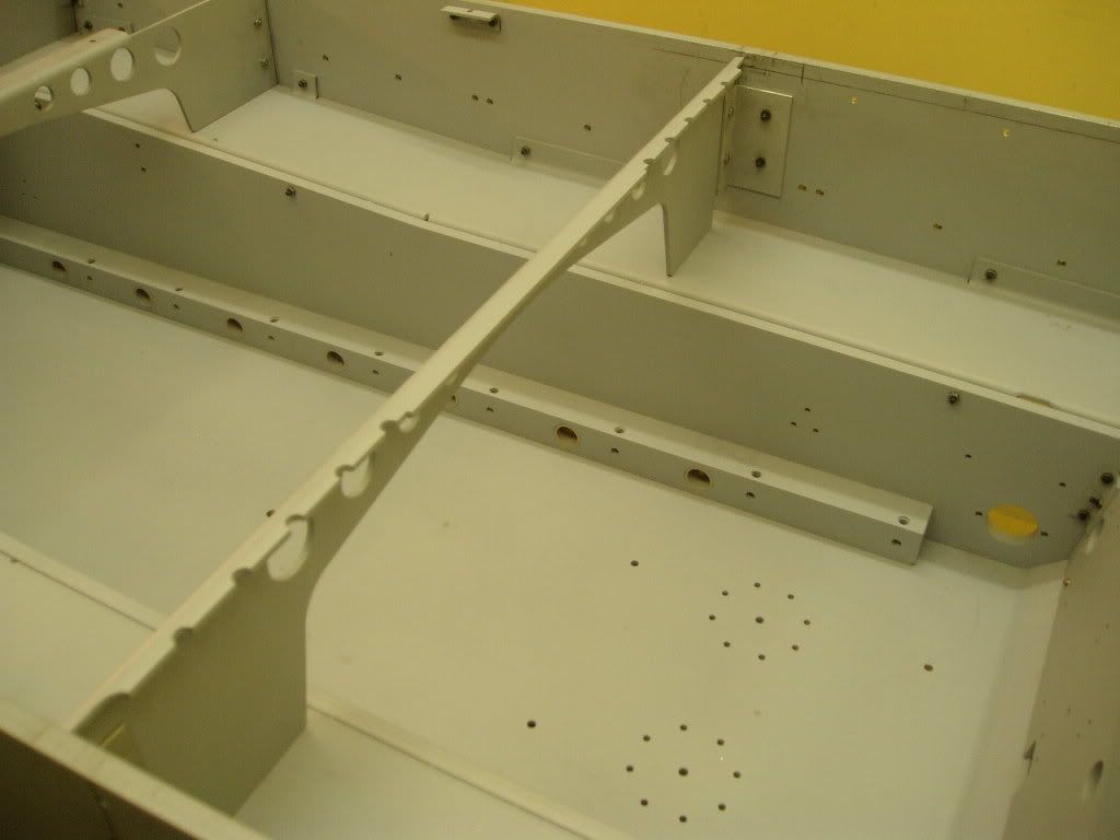

One final shot showing the deck supports required

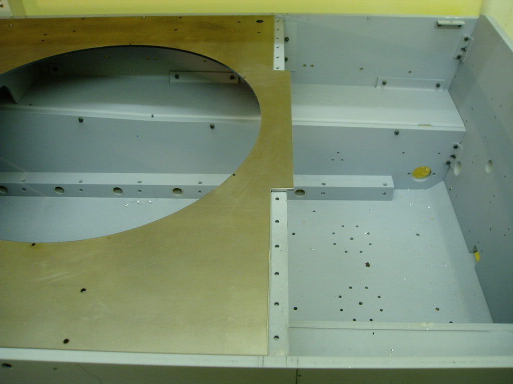

Just realised that the shot of the rear deck support shows a initial set up, i found later that the mount bolts for the forward edge of the air intake grills fouled the deck support, the easy solution was to drill and scollop around these fasteners, this photo shows what i mean.

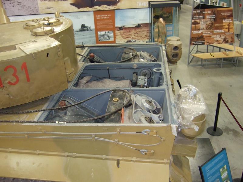

Just thought I'd add a tail piece to this thread, seeing as Bovington have the engine bay exposed on Tiger 131.
Tiger Engine Bay.jpg (65.66 KiB) Viewed 3624 times
And this shot shows the top edge of the back plate slopes in line with the angle of the plate, rather than horizontal with the engine deck.
Rear Hull Plate.jpg (41.23 KiB) Viewed 3624 times
