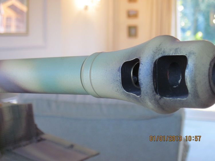

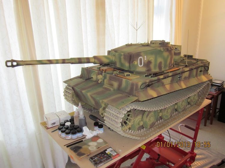

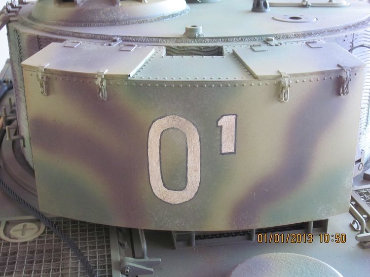

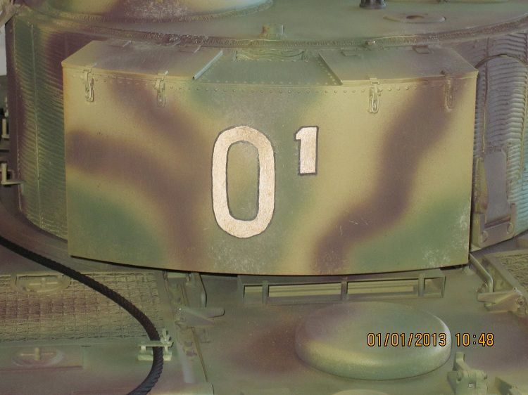

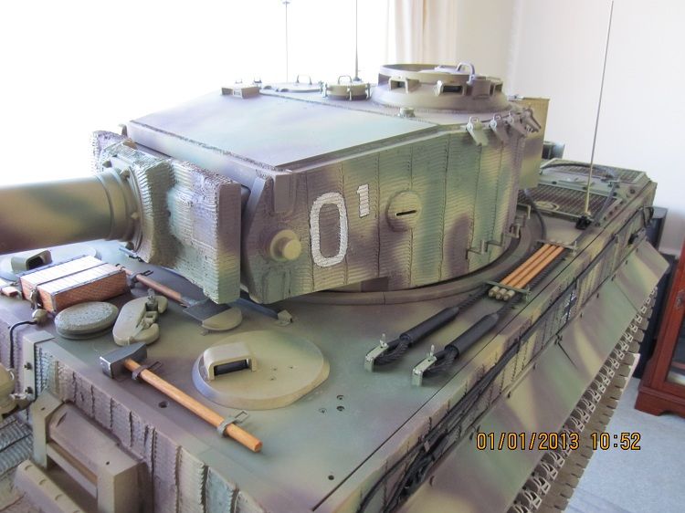

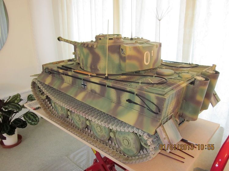

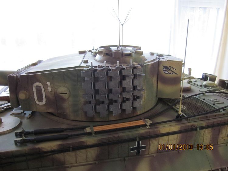

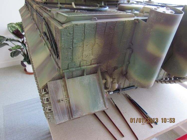

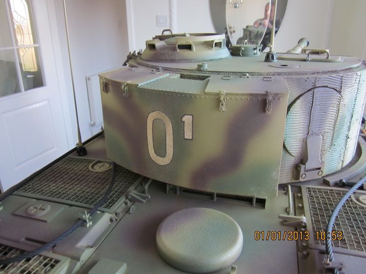

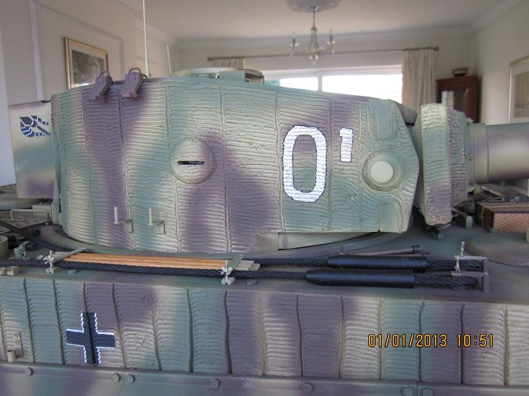

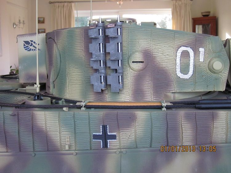

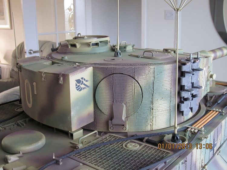

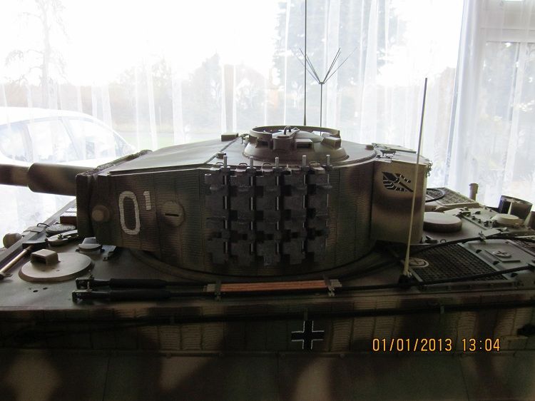

Going round with a bit of Weathering,dust and dirt,calmed my Tank numbers
down a bit

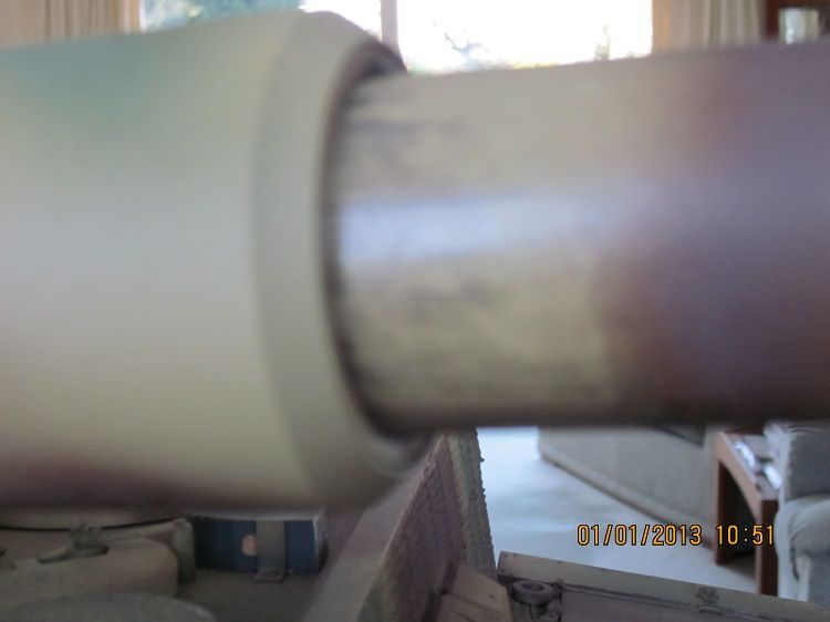

Can just about see Mike's barrel Rifling

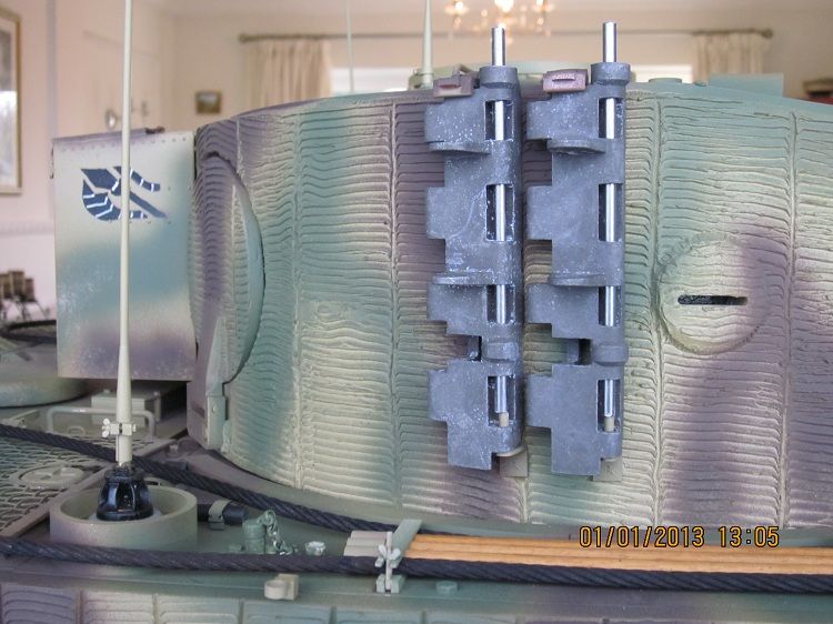

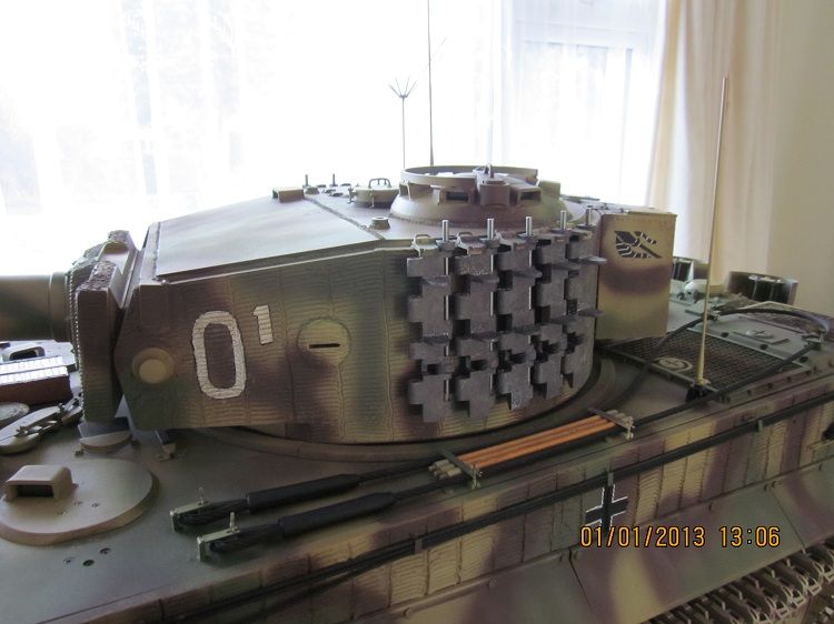

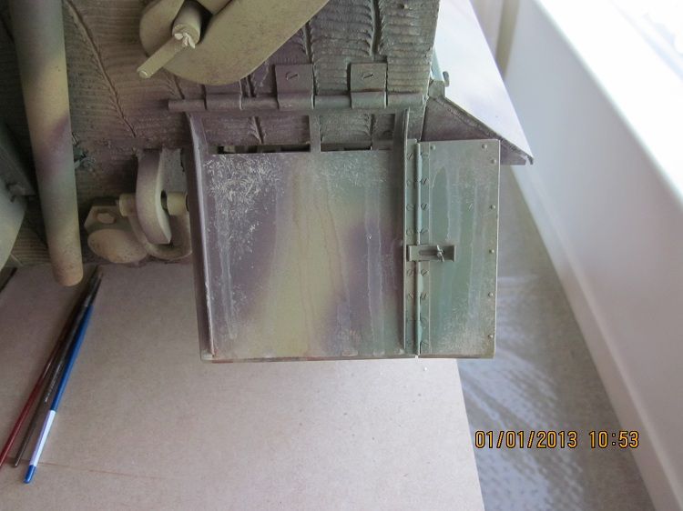

Spare Track Links and Pins

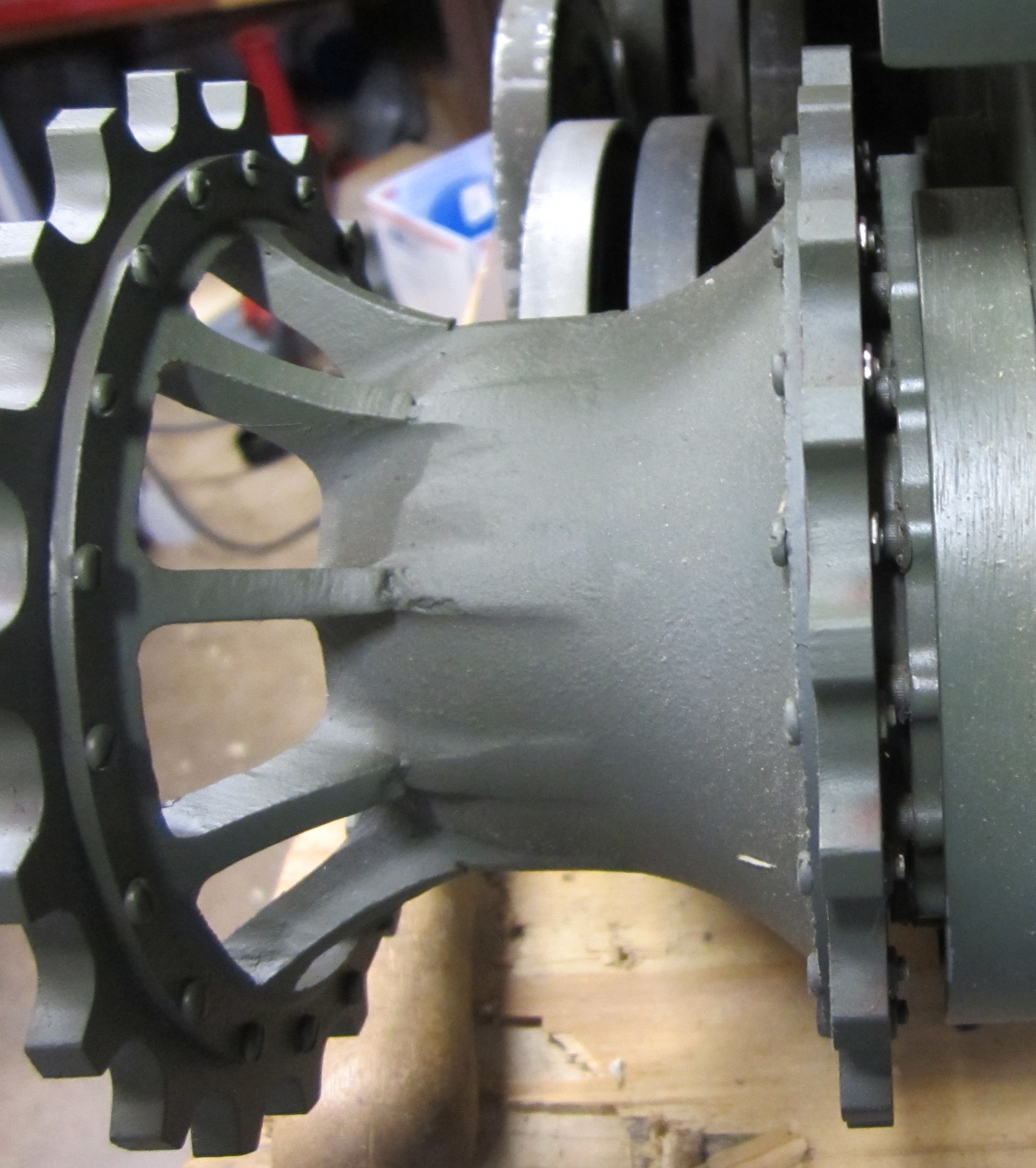

Hello Phil,

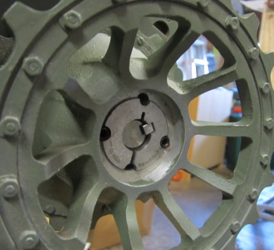

Your built looks nice, I don't remember the deck being in two parts, But there has been a lot of time go passed since I put mine together.My book says to have a gap of 16.5 mm, My micro is in dec. I have to conver mm to dec. to. I was going to use a feeler gage to measure ttat gap.But these are all too thick.The thinnest one being 254mm =.010 thousands.So 16.5 must be very thin. My drive sprocket will be out passed the drive shaft by 1/8" or more.How did you hold the cone bolts in ? The cap just sits there right ?
And the lift that you are using is a trans. lift ? One of those would be so nice to have.
Greeting from Dan
John Fitzsimons
Posts: 1871
Has liked: 6 times
Been liked: 822 times
Re: Late Tiger 1 Ausf.E/s.H.Pz Abteilung 504
Post by John Fitzsimons »
Phil's tiger is the new release Tiger. Since the 2010 mid tiger the kits come with a 2 piece deck. The 2007 release Late tiger and previous tiger releases had a one piece deck. The rear hatches just fitted on top but were then too high. Many have split the rear deck and lowered to the correct position. There is a detailed post on the subject.
phil fitzpatrick
Posts: 2020
Location: Sambourne uk
Been liked: 223 times
Post by phil fitzpatrick »
Hi Dan
Like John said there is quite a few differences with the 2012 Tiger1
After lowering my rear deck supports,I kept my 2 parts of the Deck fixed together
so it all lifts off in one go.
The measurement of 16.5mm you mentioned is just over 5/8.
Your Sprocket looks about right in your photo.
The shaft on the 2012 Tiger1 is drilled and tapped,so I just adapted the screw to
look like a cone bolt,it is just pinched up and a bit of"Marmite"on the threads as
a mild retainer :)
My Lift is a "Clarkes Strong Arm",When Launch day comes,I will turn it round towards
my patio doors and drive off down the slip way,sorry I mean ramps :)
Phil

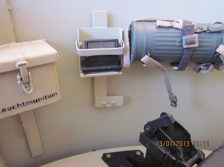

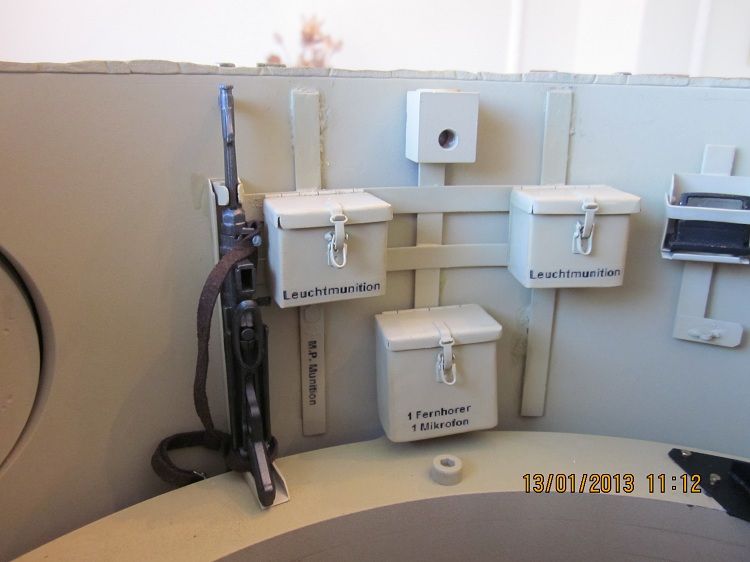

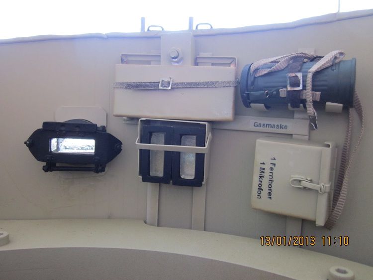

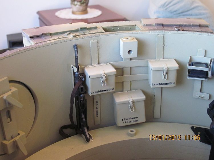

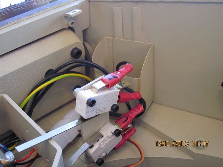

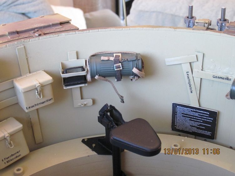

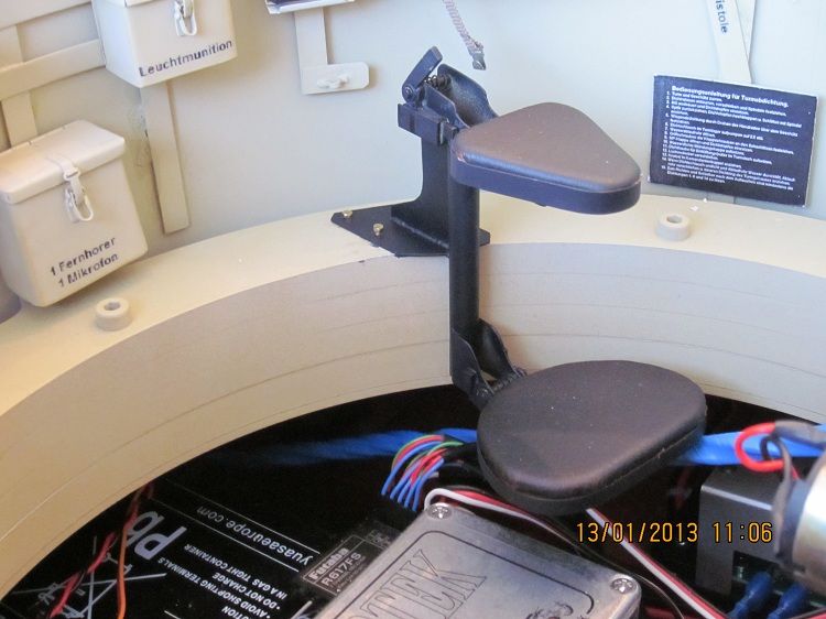

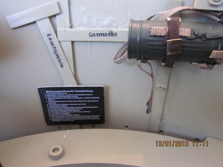

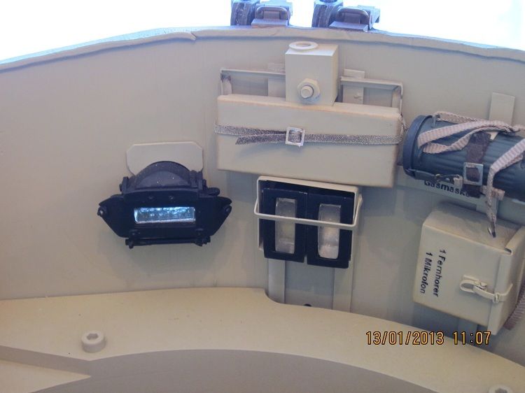

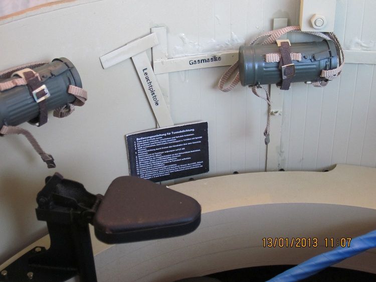

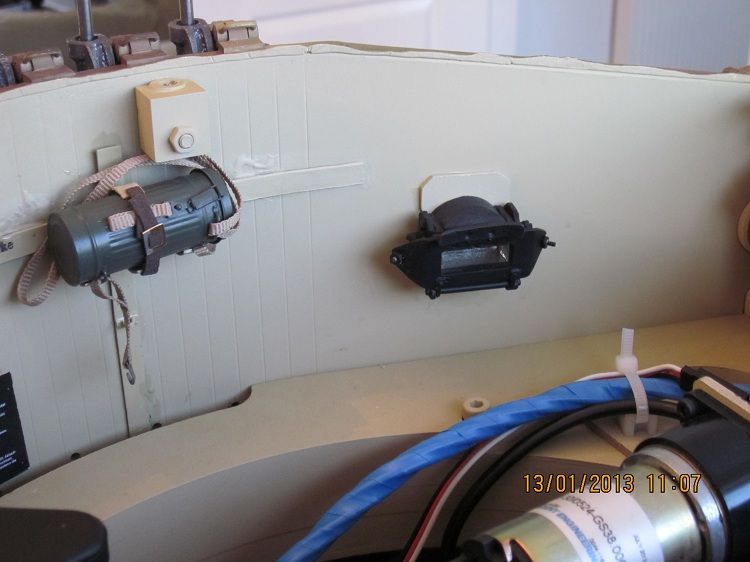

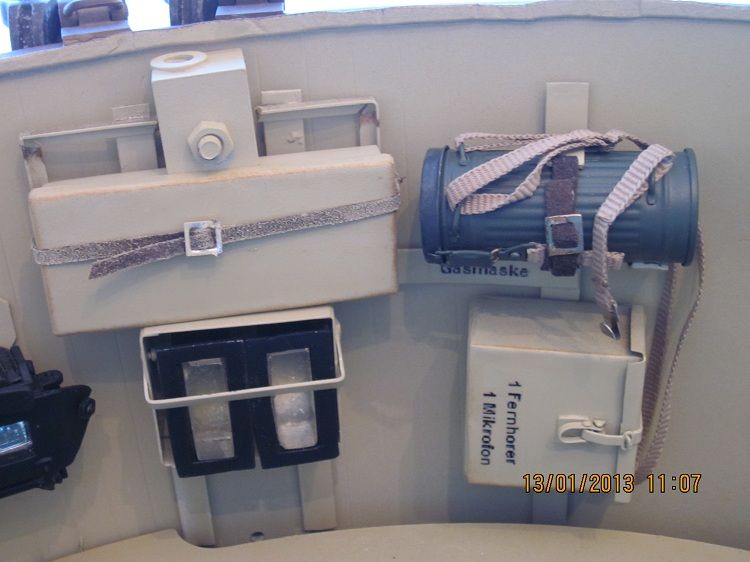

Turret Interior so far.
Using Johns Tiger1 Interior parts.
Waiting for my Panzerwerk Radio parts.
Post by michael hilton »
Lovely work as usual Phil, I have added some of Steve Winstone and Dave's parts, makes a great visual improvement......Mick

phil fitzpatrick
Posts: 2020
Hi Mick and John
Thanks for that :D and thanks for those great parts :D
Phil
Günter Gäbelein
Posts: 162
Joined: Fri Sep 16, 2011 4:48 pm
Location: Germany
Has liked: 41 times
Been liked: 195 times
Post by Günter Gäbelein »
Hi Phil,
your details are looking very good! A shame that you can hardly to see them later.
Kind regards
Günter
Bodo Langbehn
Posts: 109
Joined: Wed Jan 06, 2010 11:07 am
Location: Germany Black Forest
Been liked: 25 times
Post by Bodo Langbehn »
Hi PHil,
wonderful details you have added, especially the ammoboxes are looking good. Maybe an acrylic glas turret roof to display these details is an option :!: :!: :!:
Bodo
phil fitzpatrick
Posts: 2020
Hi Gunter and Bodo
Thanks for the nice coments :D
Yes its a shame to cover them,but on the good side,you can see a lot through
the Cupola and loaders hatches,without the crew there.
John took some photo's of his,from inside the turret and with the roof on and it looked
very good.
I will have to have a go when I have it all fitted out.
