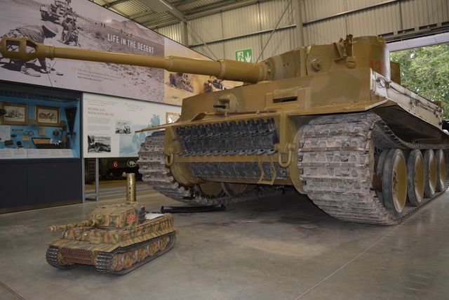

Just found some photos taken beside 131 at Bovington.

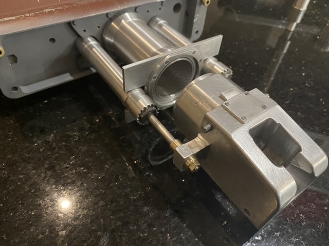

It's been a while since I posted anything here but very busy at work and at home and difficult to make time at present.

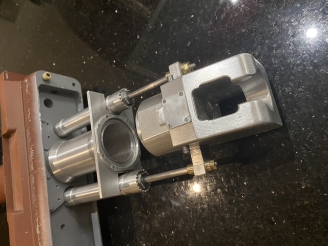

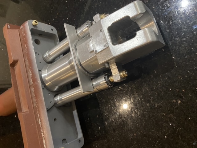

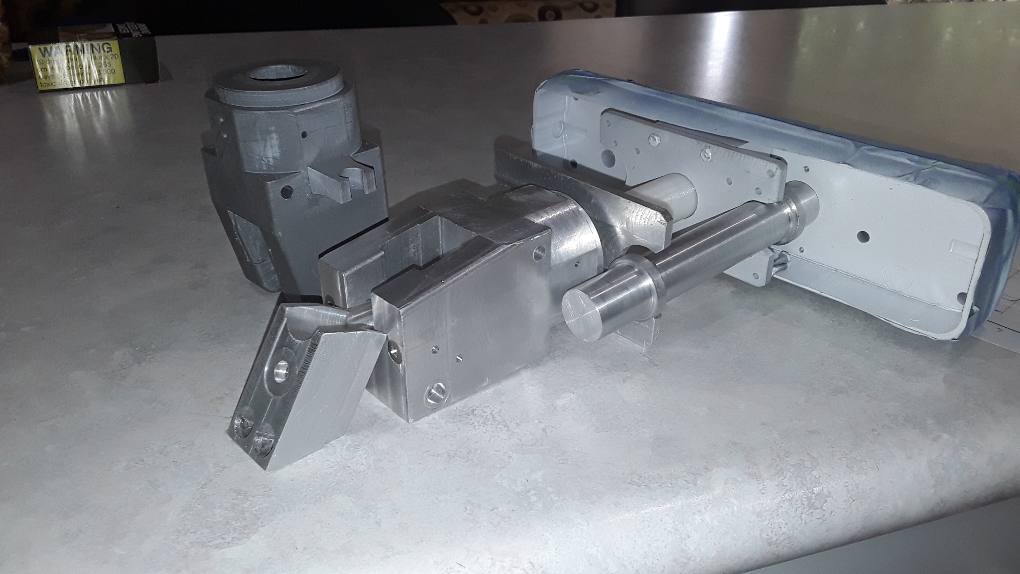

Here is something I'm working on at present.

Is that brass or just the lighting? Very nice John. 8)

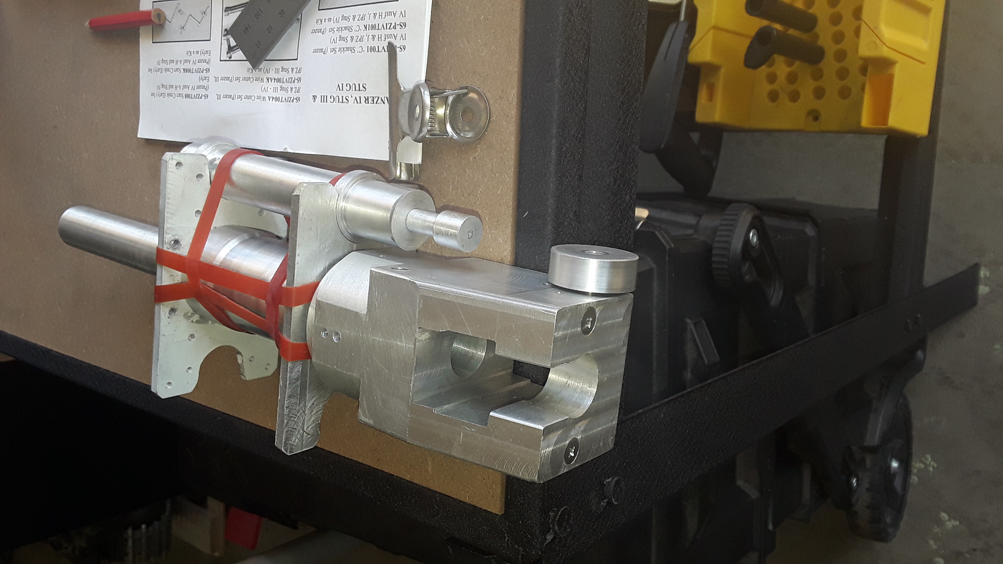

Phil, must be lighting. It's mainly aluminium. There are a couple of brass rings on the recuperate /
recoil cylinder housings. This one is the one I'm using to work out how it will all fit together.
Not sure yet how detailed I will go. So many excellent build going on at the moment. Great inspiration.

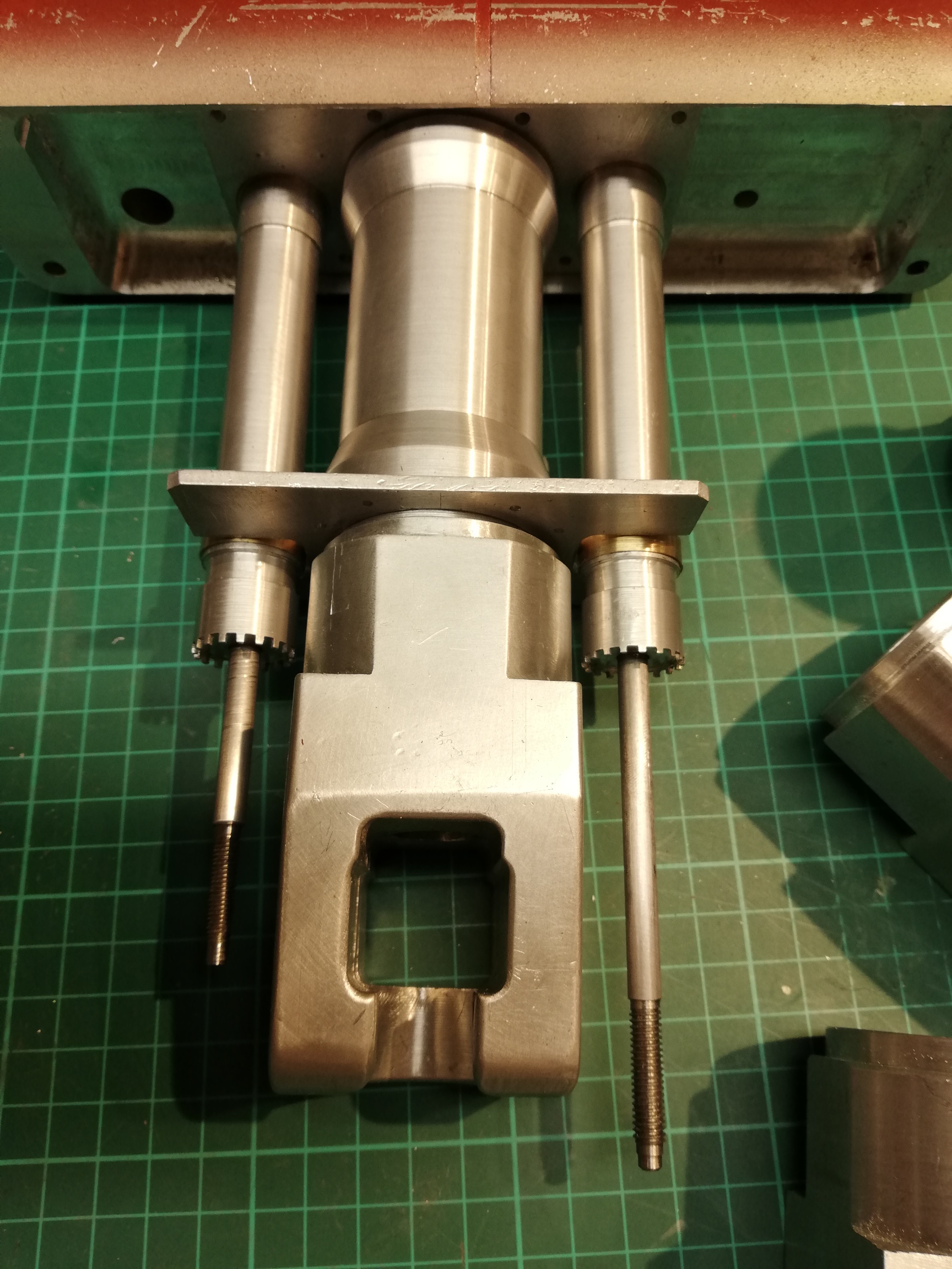

G'day John, long time no hear.

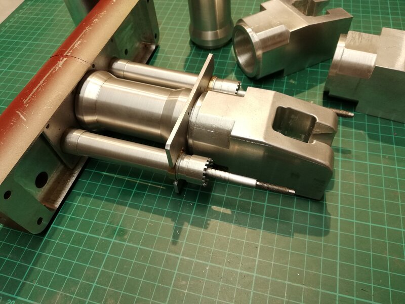

I started this same thing ìn 2016 but got side tracked. I do mean to finish it, one day. With your skills yours will be great I'm sure. Here's a couple pics of where I got to. To get the sharp breech area edges I had to screw the rear of the gun onto the body as you can see. All the best. Ray

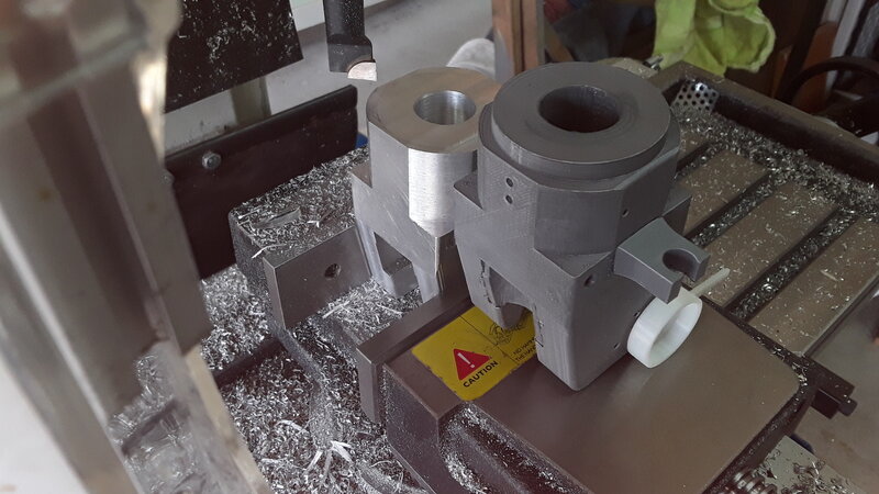

I initially 3d printed it then machined them.

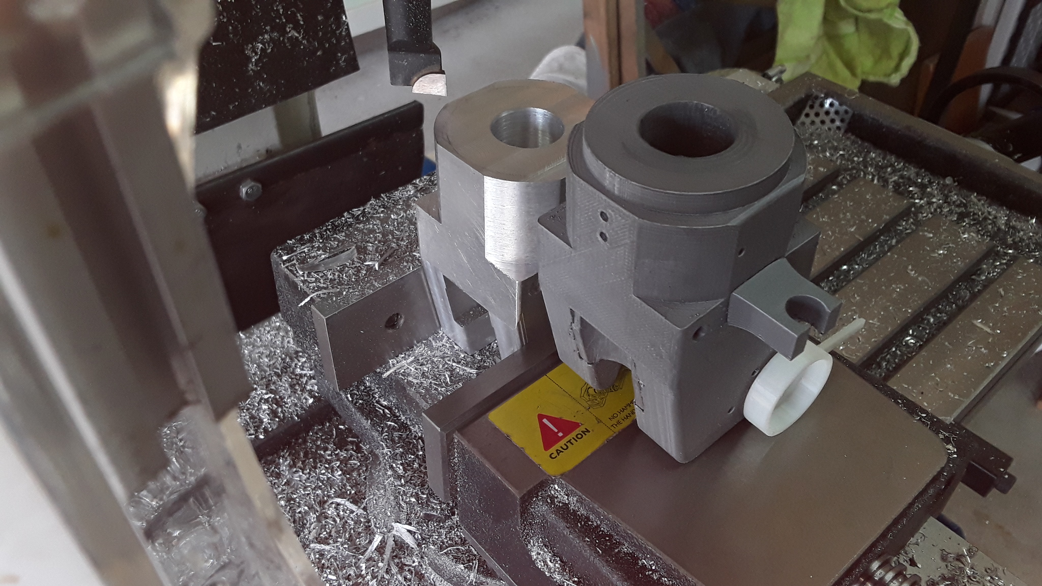

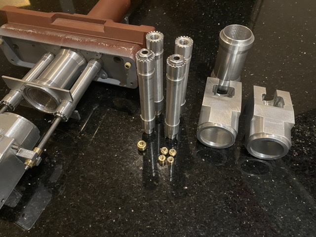

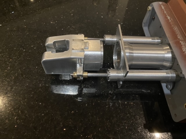

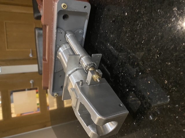

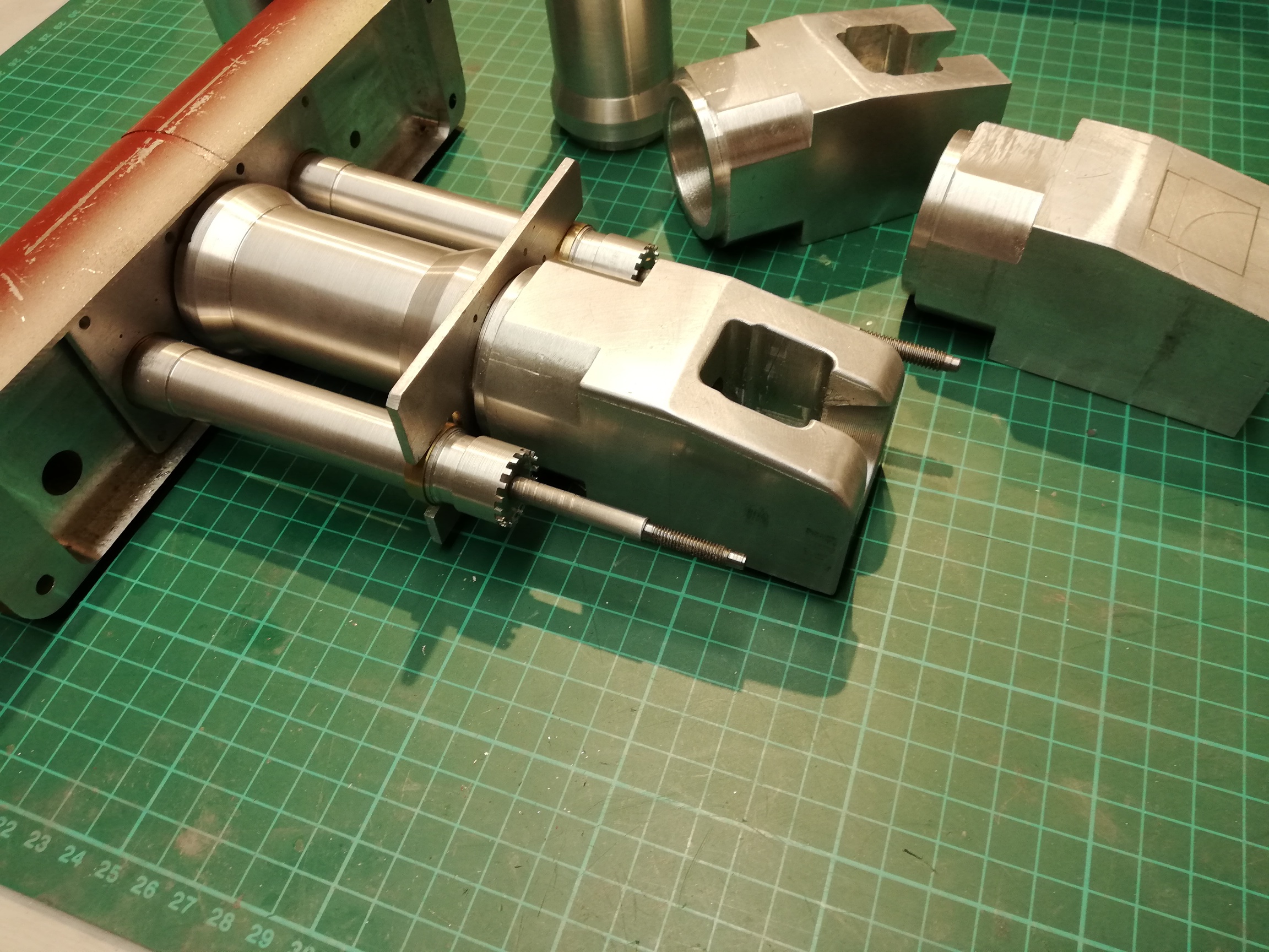

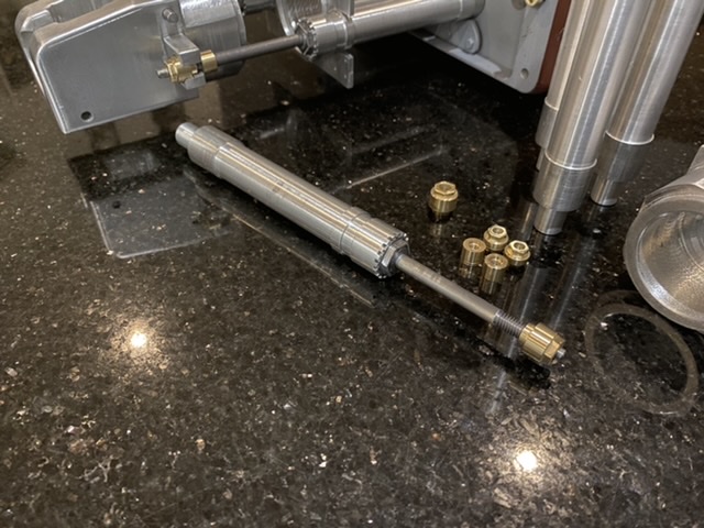

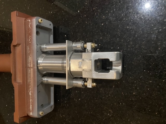

Here are some photos of progress on Tiger 1 breech project.
Working on three units now.
open position. Inner tube to be added.
