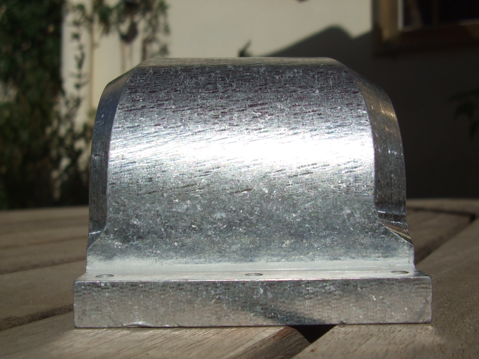

So, basically, the front, left and right side of the hull has all the work completed and so I thought that I would start on the rear part. Started taking the parts out for cleaning and deburring when I noticed something with the exhaust armor.
As you can see from the above photo, the chamfer on the right side is wider than that on the left side. This is true for both of the exhaust armors. Could somebody tell me which way up should I attach the parts? Should the wide chamfer be on the top or is it the other way round? I could not find the answer in the diagram of the assembly manual as in the diagram they both seem to have equal chamfers.

Looks to me as though they ought to be equal in size.

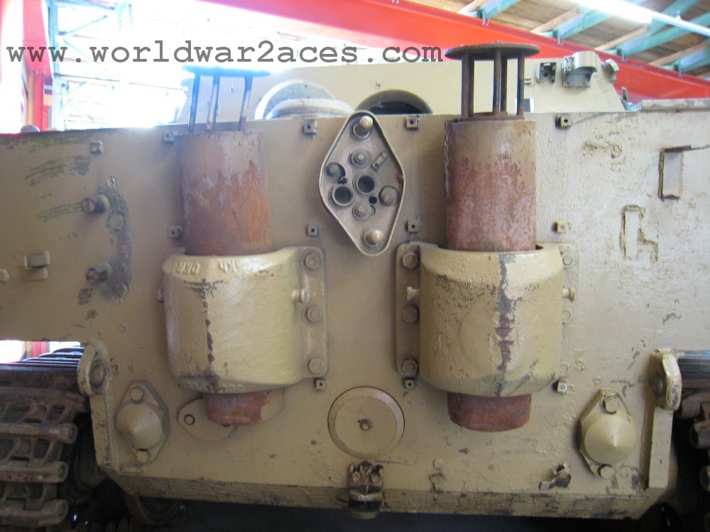

Looking at that photo, I get the impression that the upper chamfer is wider at the top. It could also look like that due to the rear plate being not vertical but at an angle.

I contacted Kian about the exhaust armor and he said that the wider chamfer should be at the bottom. He also told me that the chamfers will be hidden with the heatshield.

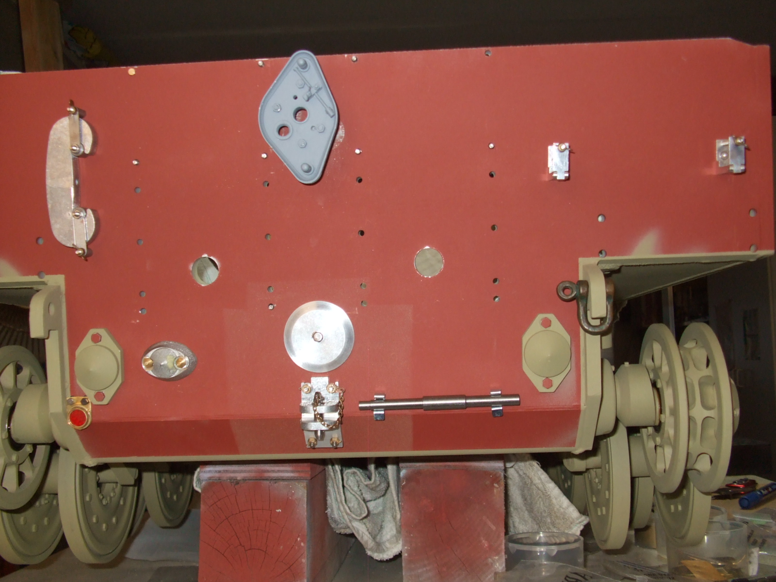

All the bits and pieces of the rear plate have been put in place. The only parts not there are the exhaust parts and the mud flaps.
Plan of action:
a) Idler Tension Covers are finished.
b) Heater port (6th Scale Icons) only needs priming and painting.
c) Steve's Reflector will be re-positioned lower and 2mm bolts used. Spacer to go between reflector and rear plate. Prime and paint.
d) Tow bracket finished just needs priming and painting.
e) Might change fixing of Starter Access Cover to a cone bolt. Prime and paint.
f) Machine flat the button head screws of the starter shaft brackets. Prime and paint.
g) 'C' Shackle. Still not sure about these. Might get after-market ones.
h) Steve's upgrade to the Armortek starter plate is complete. New holes already drilled and old holes plugged. Just needs paint.
i) Might cut a slot in the Jack bracket upper flap so that it can be opened. Assemble Jack. Prime and paint.
Am I missing anything?

This is exactely how rust is made haha! Real rust...Vince Cutajar wrote: ↑Sun Aug 19, 2018 8:48 pm...My only concern using this method would be rust...
You could always try to fake rust using weathering-techniques?
