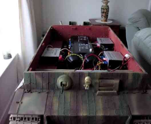

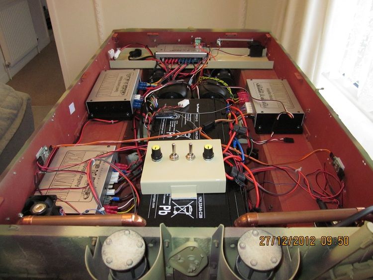

Hi Phil
your tiger is looking excelent and the electrics look like there well on there way .Looks like theres a lot more room for them in the tiger ,the shelving you have instaled is great keep the pics coming . Merry christmas to you and family,all the best
nick
nick

Re: Late Tiger 1 Ausf.E/s.H.Pz Abteilung 504

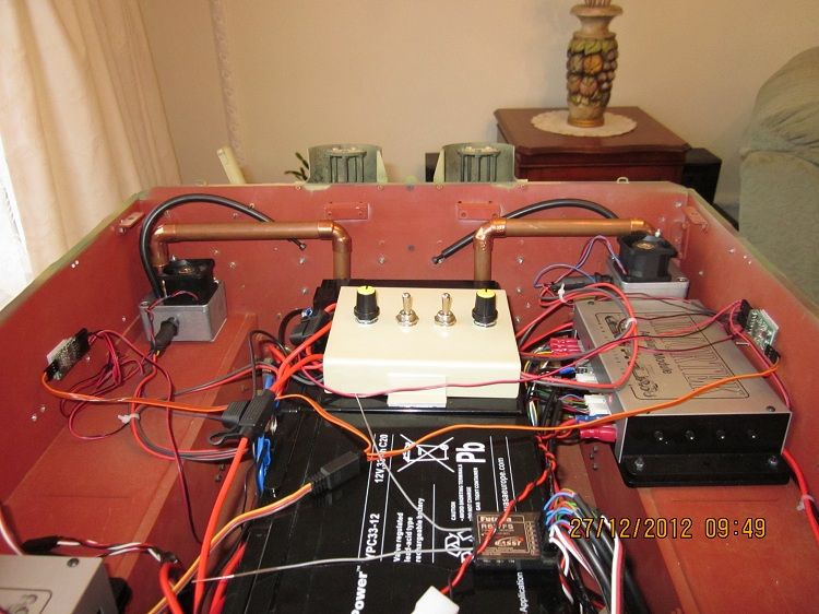

Nice layout with the electronics Phil. I enjoyed this part of a tank build. As Nick said, plenty of room.
Merry Christmas mate, and thanks again for your advice......Mick.
Hi Nick,
Yes there is loads of space in the Tiger to work with,even after my big batterys
went in
Just finished off my MG Traverse and wired up the flash,much easier to on that
with the space and deck off.
Have a great Christmas.
Phil
went in
Phil
Hi Mick,
Yes I like kitting out the inside with the electrics aswell.
I think you will have a lot of space to work with on your Jagdpanther
and I hope you and the Wife both have a great Chrismas time.
Phil
Phil

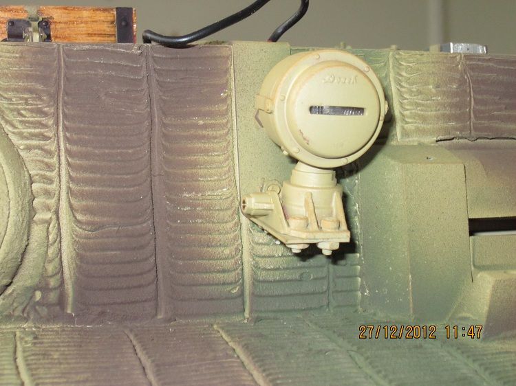

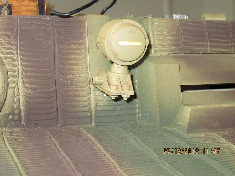

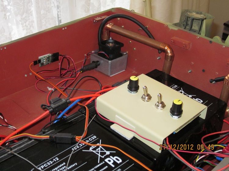

More progress on my Hull electrics and exhaust installed
Light ON
Light OFF
Exhaust installed and controls

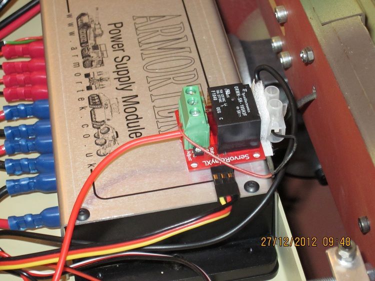

Light Relay
Light ON
Light OFF
Light Relay

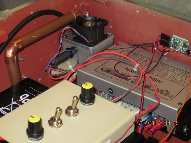

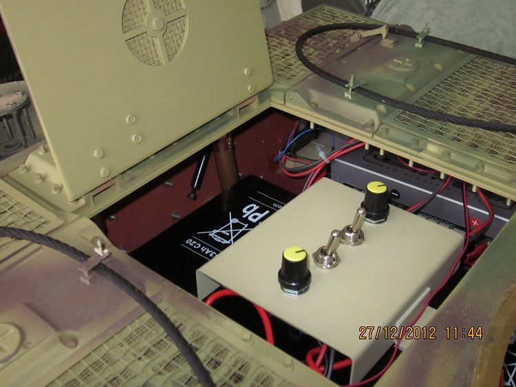

Hi Phil, what's the box with the switches for?
- Posts: 2020
- Location: Sambourne uk
- Been liked: 223 times
Hi John
Twin exhausts,Richie Wignal's version,switches turn the elements off
and the knobs control the fans.
Phil
Phil

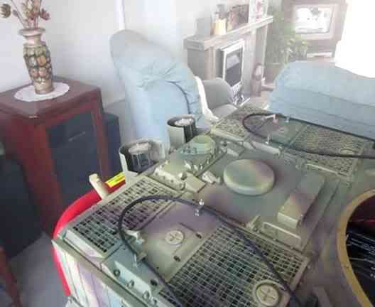

Nice one Phil, even made me cough....and I'm miles away
I see you have a 'smoker' for each exhaust stack. I like your layout, soon be time to go outside.
Best wishes, Mick.
Best wishes, Mick.
- Posts: 2020
Thanks Mick
Yes it will look better outside and I will do another vidio then.
The smoke wont hang arround the Tank,like in the living room and the fans were only
at 50%,so plent of power left,so should look good in the wind.
Phil
Phil
Looking forward to seeing your weathering. I got some dvds from MIG and AK interactive but they did'nt do anything on weathering zimmerit.
How does the light relay work and is it rc. Does it operate the convoy light also.
- Posts: 2020
Hi John
The relay is radio control,you can see the servo lead in the pick,common,N/O and N/C
contacts.
I used a Y lead in channel 7 and asigned switch G on the Futaba 7.
I have saved the 3rd channel relay on the Auxiliary Module for spare.
Yes the relay will operate the convoy light aswell but only at the same time.
Phil
contacts.
