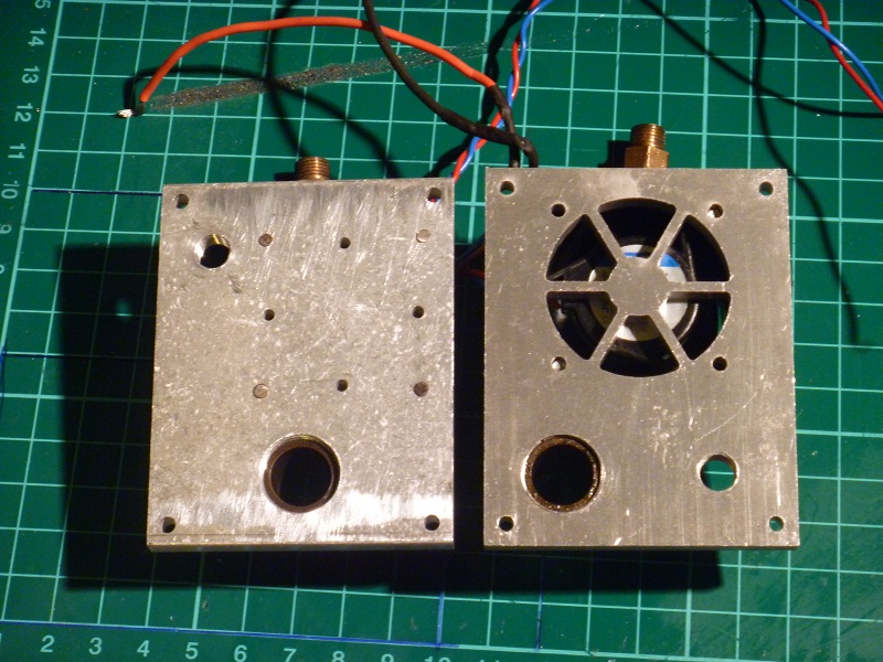

> I wonder if Adrians unit will work with my smoker.
It looks like one of the older style smokers, so my unit should be suitable.
> Not overly impressed with the amount of smoke produced.
But it won't increase the smoke output. To do that, you need to increase the airflow through the lid. Here's a new lid I had waterjet cut:

I think smoke output might be normal but smoke comes to the top of the exhaust stack then is deflected downwards by the exhaust top cover. There are just 4 small holes in the top plate of the smoker through which the fan can pass air and these are partially blocked by the fan spacer. Would it be better to make bigger or additional holes. Looking at Adrian's videos his smoker is a bit more vigorous. Maybe better brand of baby oil.

Thanks Adrian, I might cut out a new top and experiment with vents.
Keep your unit in mind. I have a couple of these smokers.
