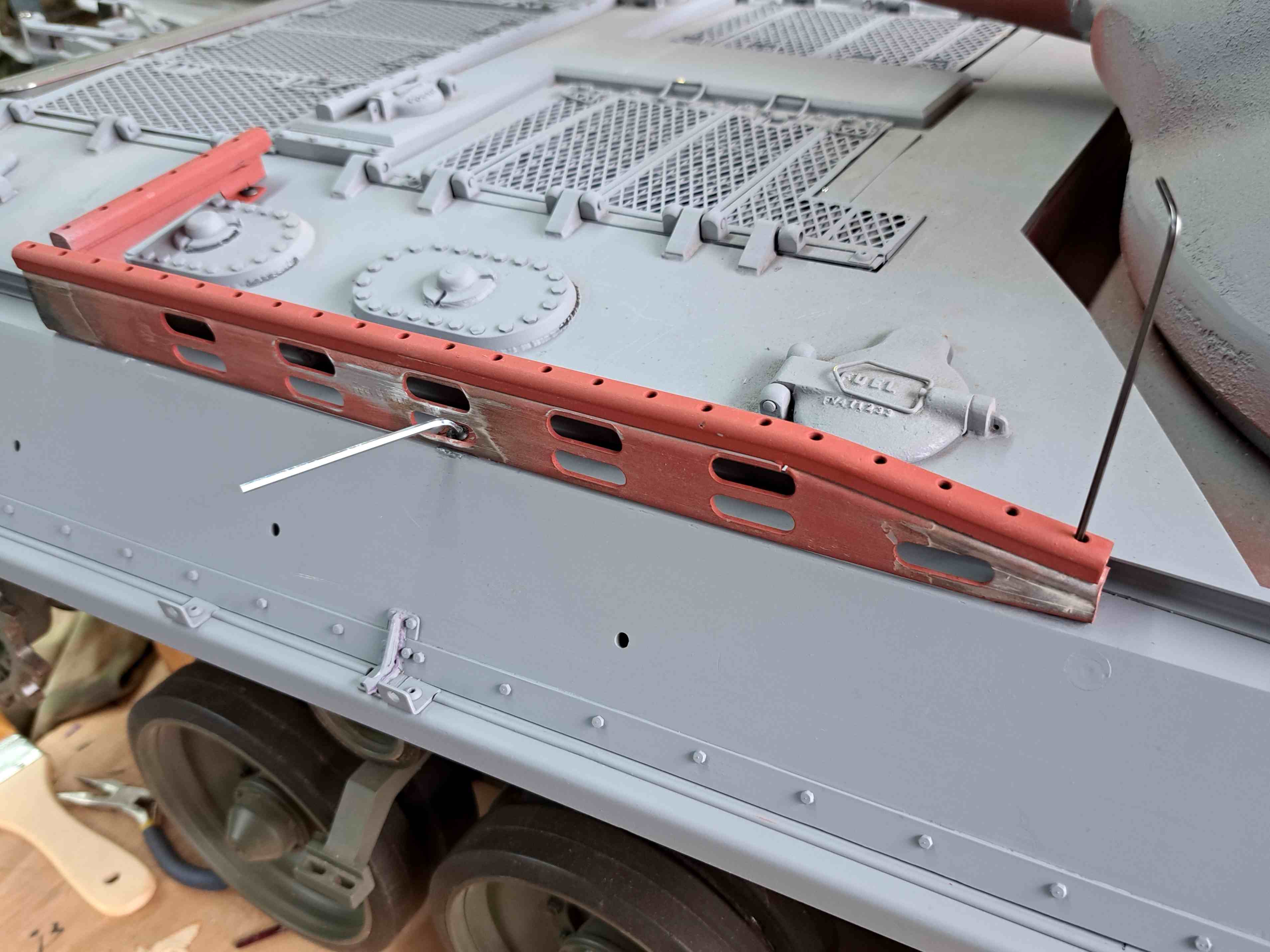

A very clever and subtle mod there, I've looked at the post several times and only just realised what you've done - swapping over the bump rails neatly hides the mounting flange, puts the vertical face in the correct position relative to the deck and gives some proper clearance to the wade rail as would be needed for fitting the waterproof covers - nice one.

The supplied kit rail is too big, the reversal mod shown by Charles certainly helps the look but it's a tight fit around the turret area as he's stated. I opted for trimming down some channel brought from B&Q. similar to Greg's mod, love to hear more from Greg too. I've still got a bit of chopping to do myself.

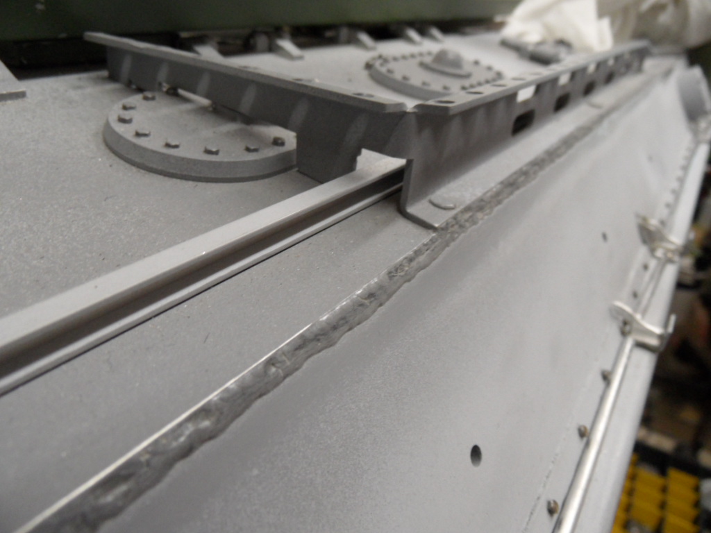

Hopefully fixed the first Gun bump rail in place.
I have managed to fix it with 3x screws directly into the hull:- I have moved the long part of the gun bump backwards by about a 1/4" overall. At the forward(fwd) end I drilled another hole in the bump guard (allen key is the clue) put an insert into the hull, tapped and used a M2.5 button to secure that end.
M3 button used on the other two and the now separated cross piece.
I hope this makes sense. Just need to look at some weld and perhaps a bit of filler.

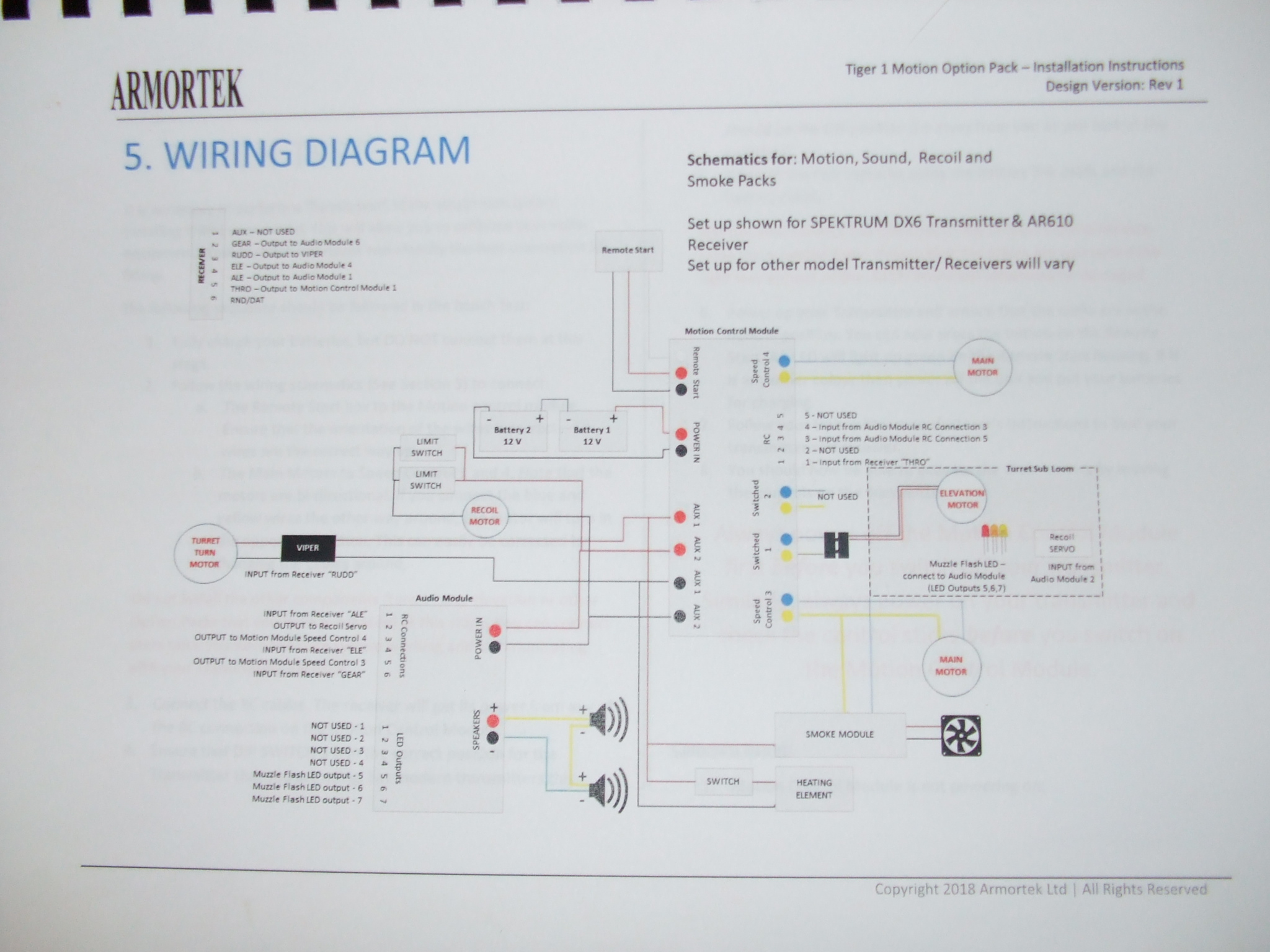

A coloured filter should improve the situation by reducing the brightness and giving it some colour.
On my 2017 Tiger the barrel light came with the option packs and it consisted of three coloured LEDs as you can see from the wiring diagram.

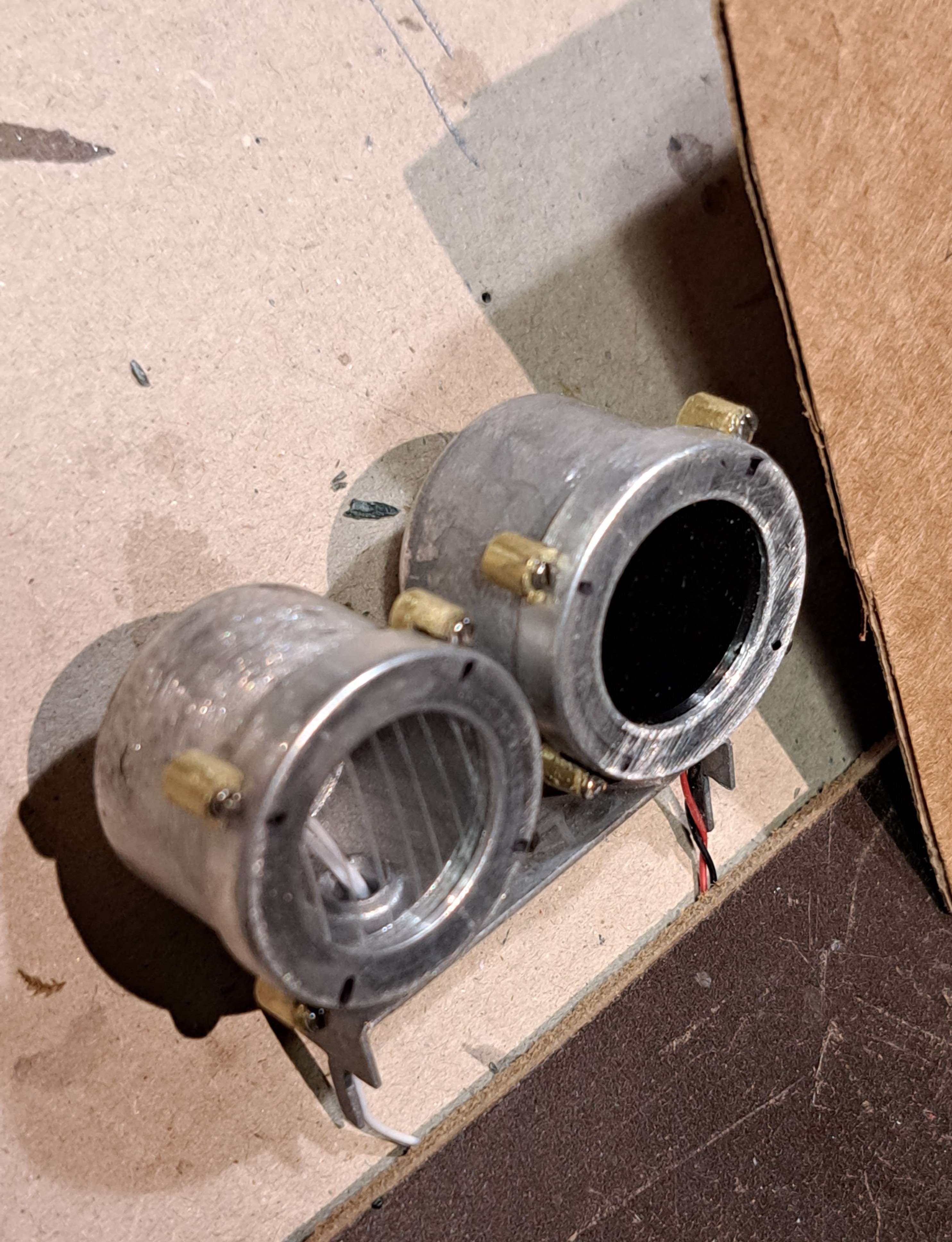

Evening all.
Managed to get my head round this small, arsemungeringly fiddly project. True others have mastered it before I, well done, my respect.
I have made new brackets too, pinched that from Phil's build, hope you don't mind. The wires are going to go into the hull through the mounting holes and false braided cable fitted to the back of the light units once mounted, well that's the plan
Take care.
Charles

Hi Charles,
Nice work on the headlights the bezel fixings really improve the look, I've just being doing the same detailing on mine and agree with your assessment - very fiddly.
Like you I've also gone for dummy cables coming out of the back which I recon is about 1/2" or 2mm in scale terms - have you or any other builders been able to find a suitably looking 2mm dia. braided cable to use here ?
