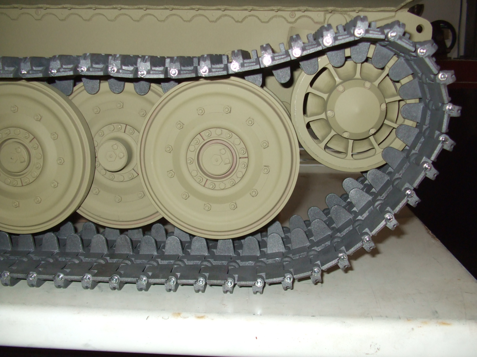

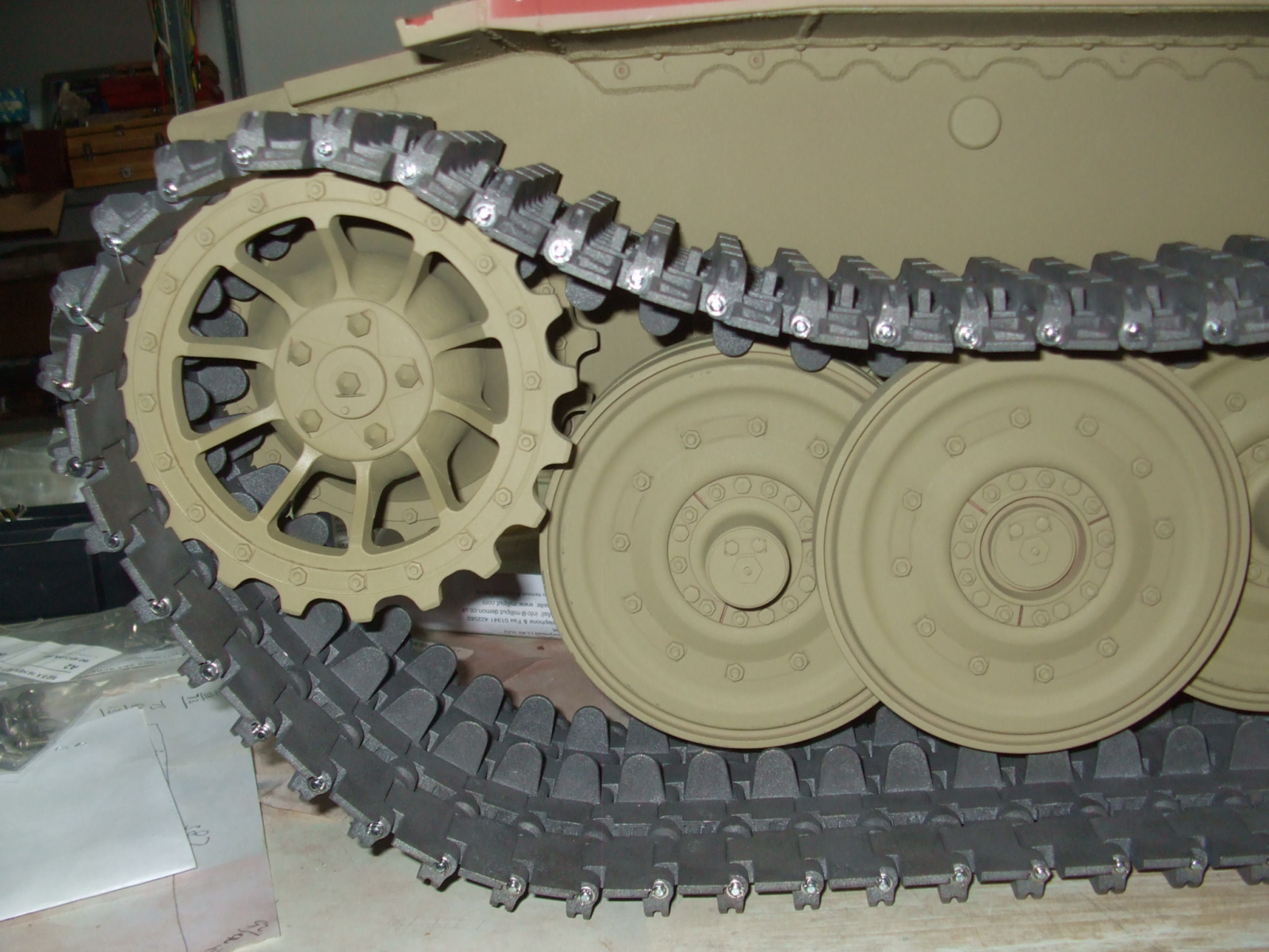

Sorry guys, but I could not resist it. I installed the track loop on one side just to see how it looks.
The track loop has 96 links and some of the links have to be removed in the future.

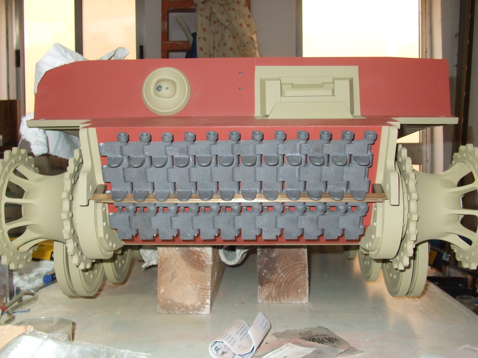

The plan now is to work around the hull and test fit all the bits and pieces and making modifications as required. As I already have started at the front of the hull, I decided to continue in that area. Fitted the front spare link holder and put some tracks in it.
At the moment, the links are very loose. When I made the spacers for the holder I made them longer than required to cater for the zimm thickness.
So here is a question for anybody who has built the Tiger 131. The front spare link holder was part of the kit. Could you tell me if the spare tracks are loose, or does the holder pull them tight to the front of the hull? Could somebody measure the distance between the holder and the front of the hull for me?
Thanks in anticipation.

Vince your tiger is looking great. Don't foget the ground clearance will decrease when batteries, motors and packs are added. This will drop the height a lot. It looks like the tracks need a link removed. Enjoying your progress!
- Has liked: 793 times
Thanks Bob. That's what I am banking on; that the height will reduce further as the weight increases. Yes, tracks will need to be removed but I thought I will wait a bit more until it gets heavier.

It looks Great Vince,your posts will really help when I start putting mine together.Silly question but can you remove a single link or do you have to remove 2 like in a motorbike chain?

That is correct Glen. You can add/remove single track links from the loop.

I have decided to defer the decision about the front spare track holder to when I have applied the zimm in that area.

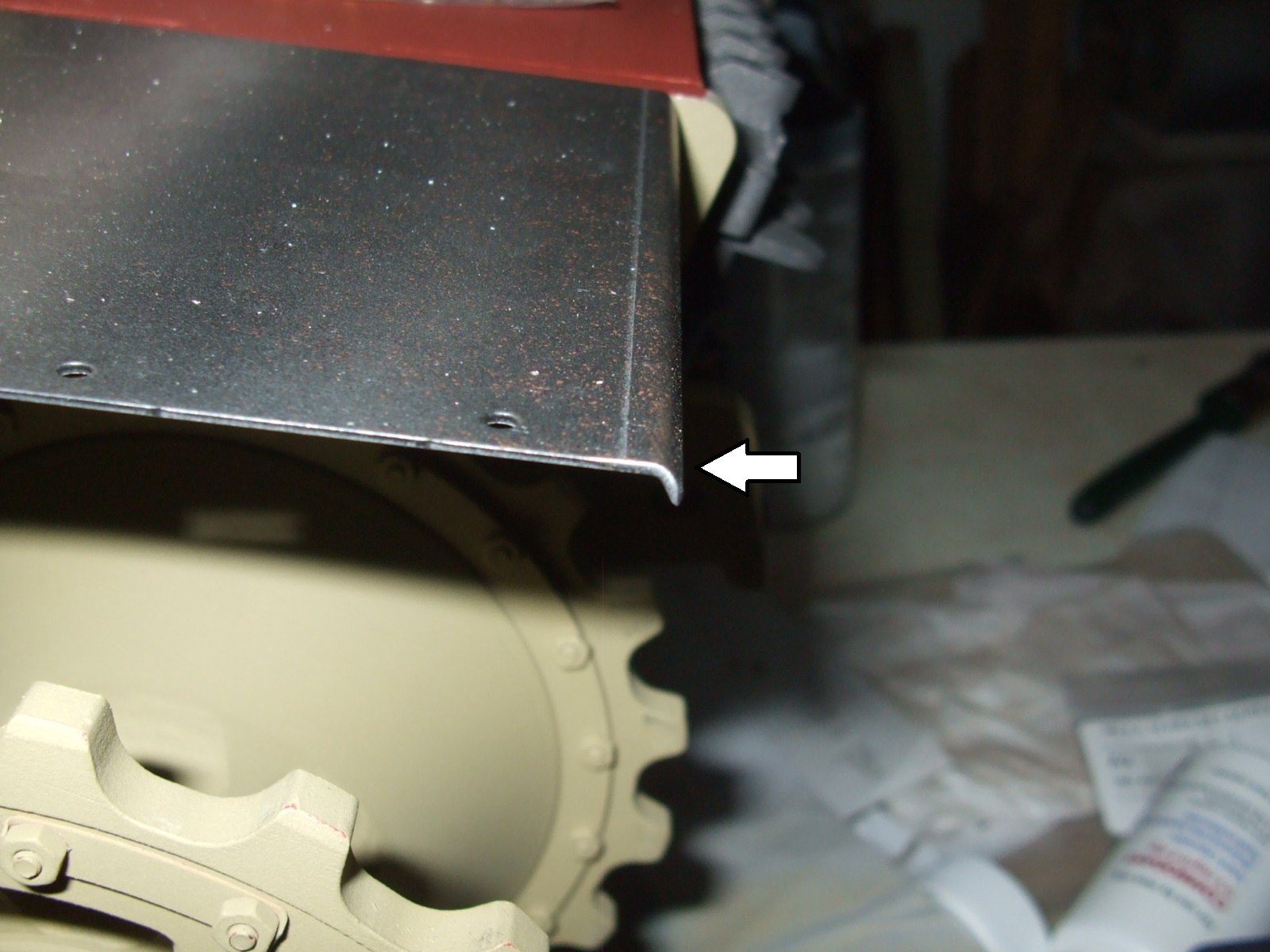

I am at the moment working on the headlamp assembly and also thinking about how to improve the looks of the front mudguards. I am planning on using nearly all the kit parts and adding some others. I would like to straighten the bends that the mudguards have.
I wonder if it can be done using a big milling vice. Has this been done before?
p.s. Finally managed to get myself "The modeler's guide to the Tiger Tank" book.

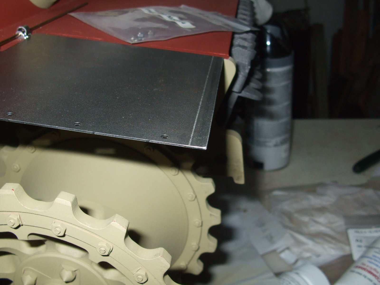

Finally took the plunge and attempted to straighten the bends in the front mudguards. I am happy to say that the experiment was a success.
Used a 5" milling vice with smooth jaws to do it. I haven't removed the 90 degree bend on the long side of the side flap as I suspect it will become too wide. In that case I might mill it out. Have to think about it.
