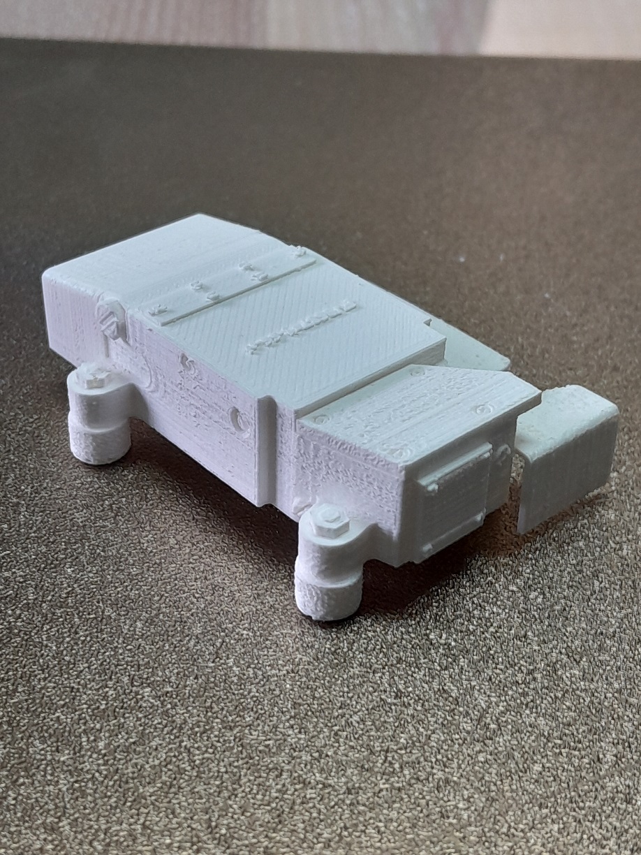

I think it's finished. Still need to run a final test print but not sure if I will be doing it today.

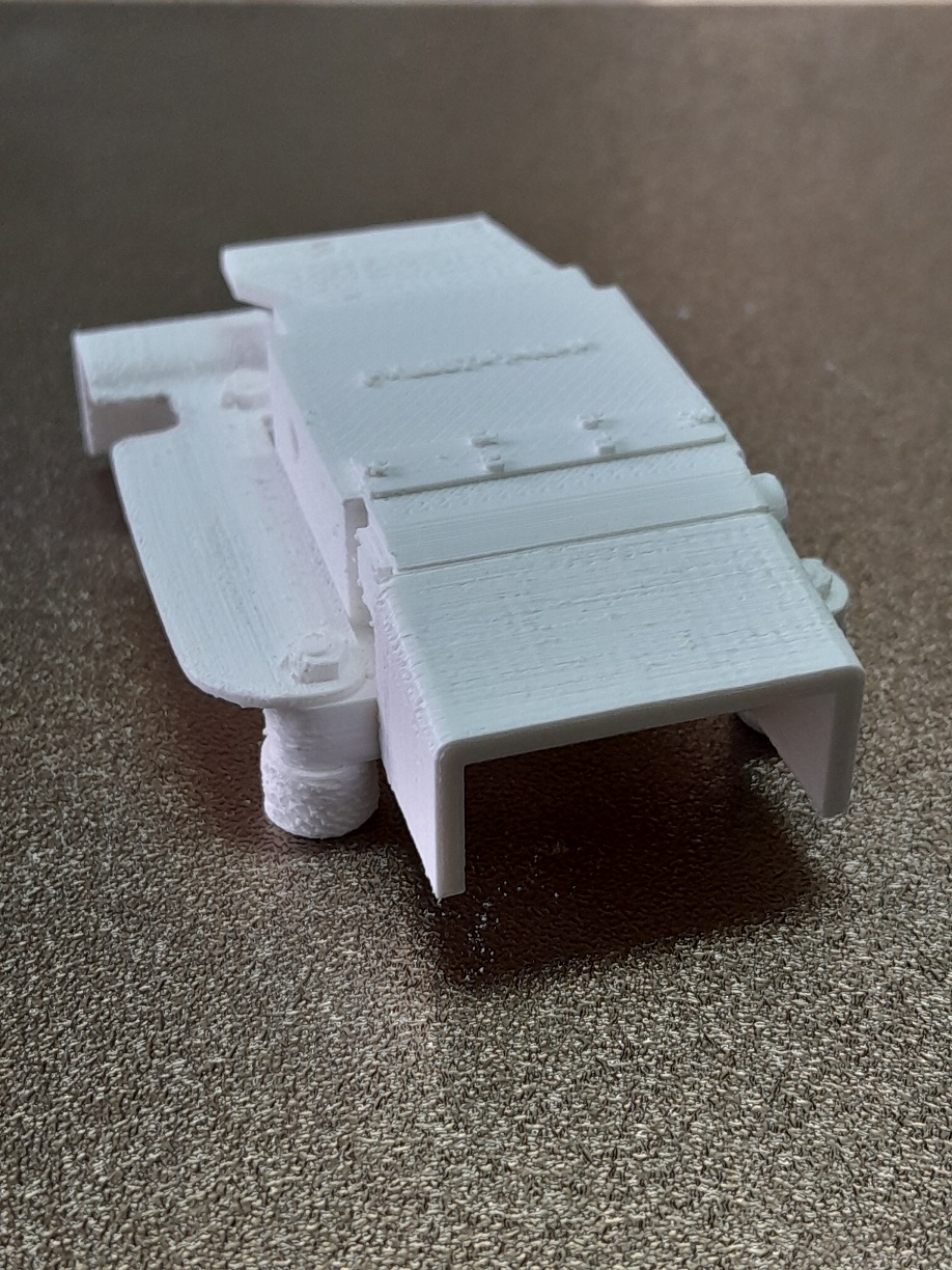

Has liked: 794 times
Re: MRS 3D model
I am calling it finished. Used a little sandpaper for a little cleanup. Still not up to scratch but better than nothing. Ideally a liquid resin printer should give better results but as I do not have one I did not try it so can't really say how it will end up.

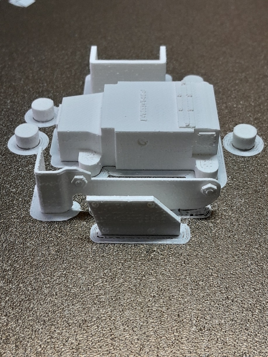

Parts on print bed.  As you can see the top cover and thin side cover were printed vertically. They gave me a lot of trouble and at least with my printer printing them like this gave the best (not perfect) results.
Parts on print bed.  The bottom part is the front part (hood) of the MRS which has to be glued on.

Not up to scratch :?: :?: :?: Fan bloody tastic I'd say, A month's work just to get close to it, a pack of files and a pack of those silly little plastic letters that cost an arm and a leg and are probably(2mm type) obsolete now.

Forgot to add that those were printed with a layer height of 0.05mm

I made another two MRS prints. One with a layer height of 0.1mm and another with a layer height of 0.2mm.
The one on the left is 0.05mm layer, middle is 0.1mm and the one on the right is 0.2mm.
For sure the one on the right is the worst one. I am not sure about the other two. Some parts look better in a particular layer height whilst others are worse in another layer height.
So I learned that maybe printing different parts in different layers could be helpful.

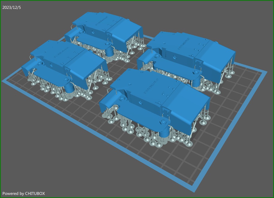

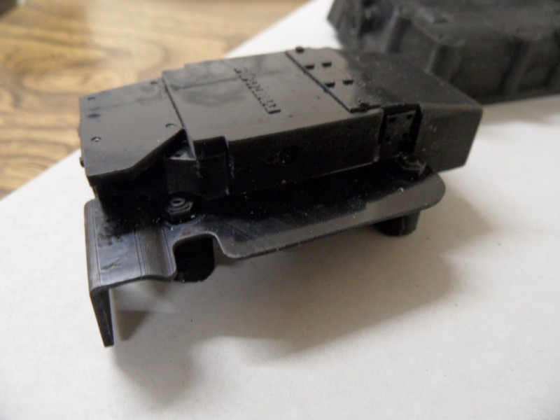

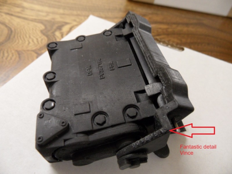

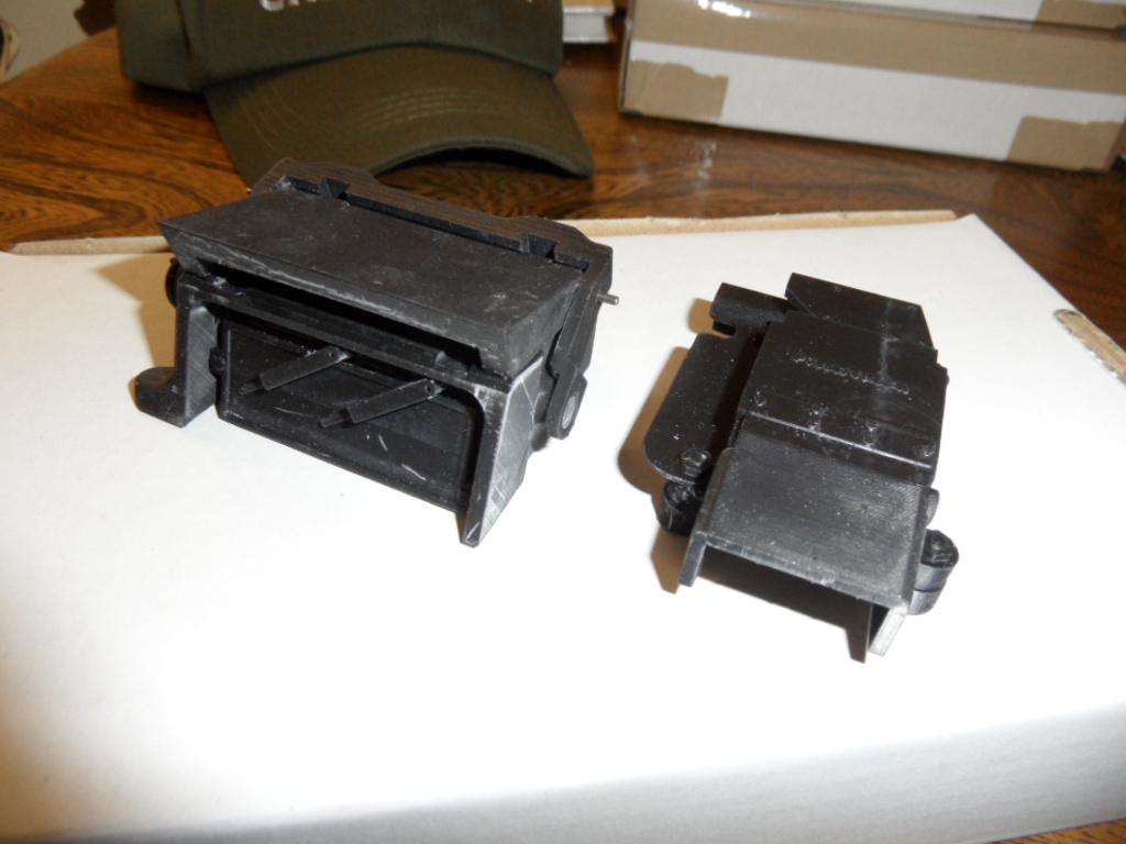

These are Vince's beautiful sculptures when printed with a resin type printer.
There's some fine detailed small cover disks to be fitted to the armored visor at a later date.
This amazing work done by Vince and Mark, I had nothing to do with it :D
Re: MRS 3D model
OMG, if I'm allowed to say so myself, those came out really well. What a difference a resin printer makes. All those pesky layer lines gone. All those minute details came out perfectly. You made my day John.

Re: MRS 3D model
John
If you find traces of unwashed resin clean that area with isopropyl alcohol.
If you feel the surface a bit tacky put it under a UV light or in a sunny spot outside to cure that area.
Posts: 1693
Been liked: 1842 times
Re: MRS 3D model
Their frighteningly good Vince and better in real life. Mark says he washes them with alcohol, then UV lamp and finishes them off with sunlight for day or so to harden. The surface marks are not indentations, more like light stains from the process.
Their heavy because their solid, but not as heavy as solid resin cast, detail is mint.
Magical :mrgreen:
