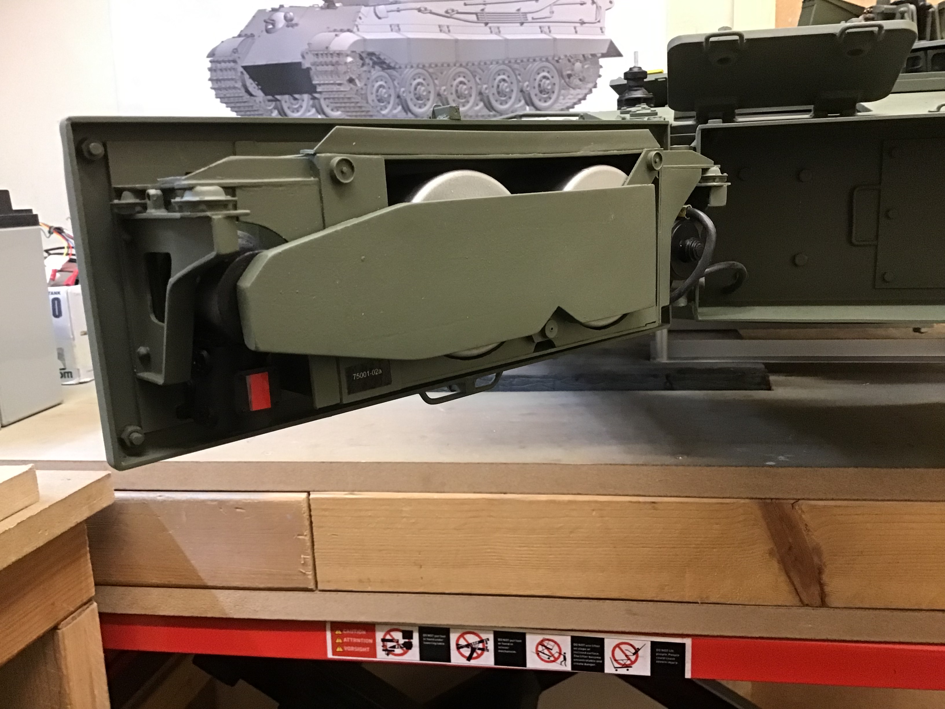

Hi Charles.
Thanks that’s very useful, I have shots from the other side so with yours I should be able to make something fairly convincing.
Just need a photo of what’s under that left hatch now.

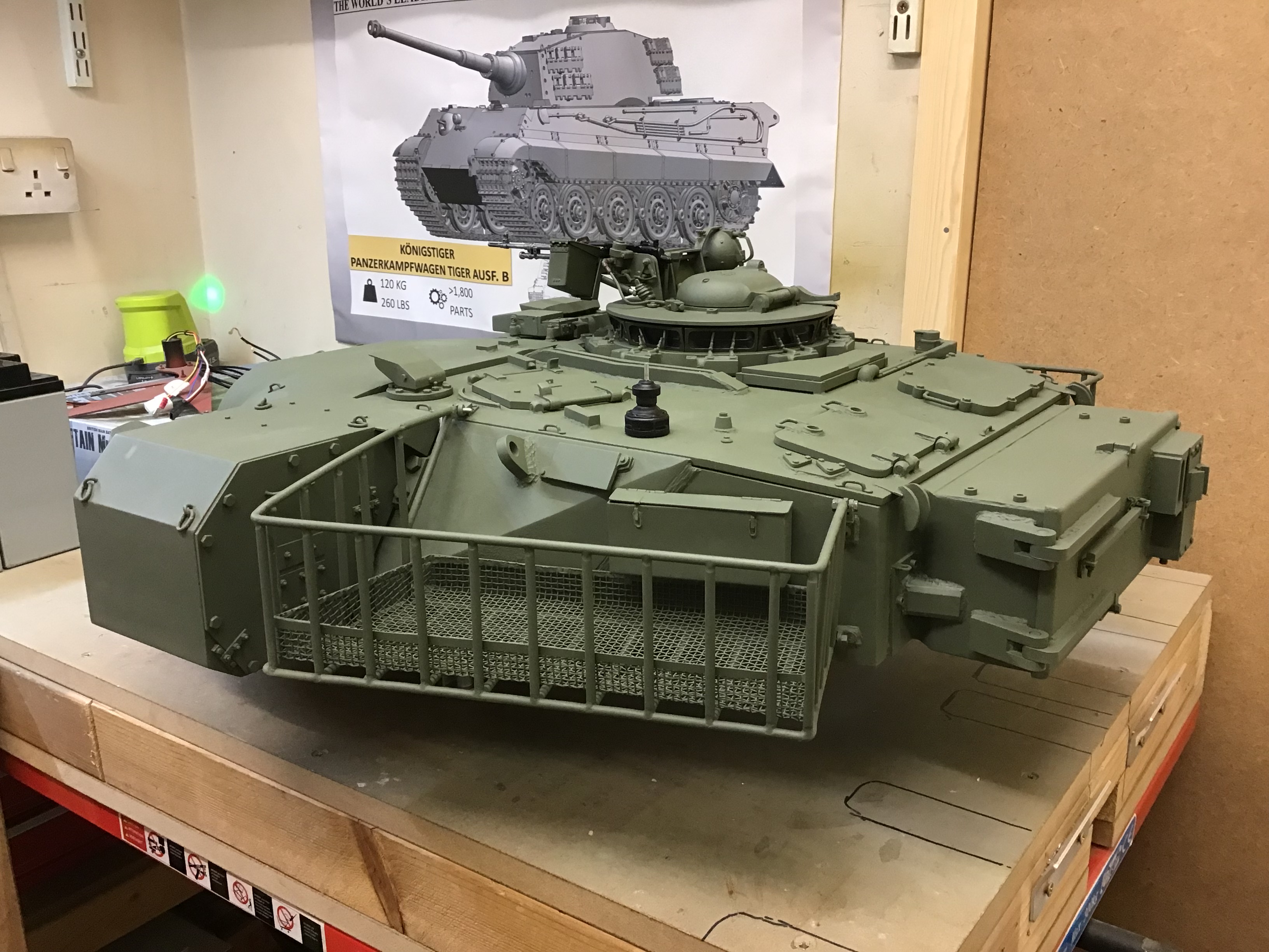

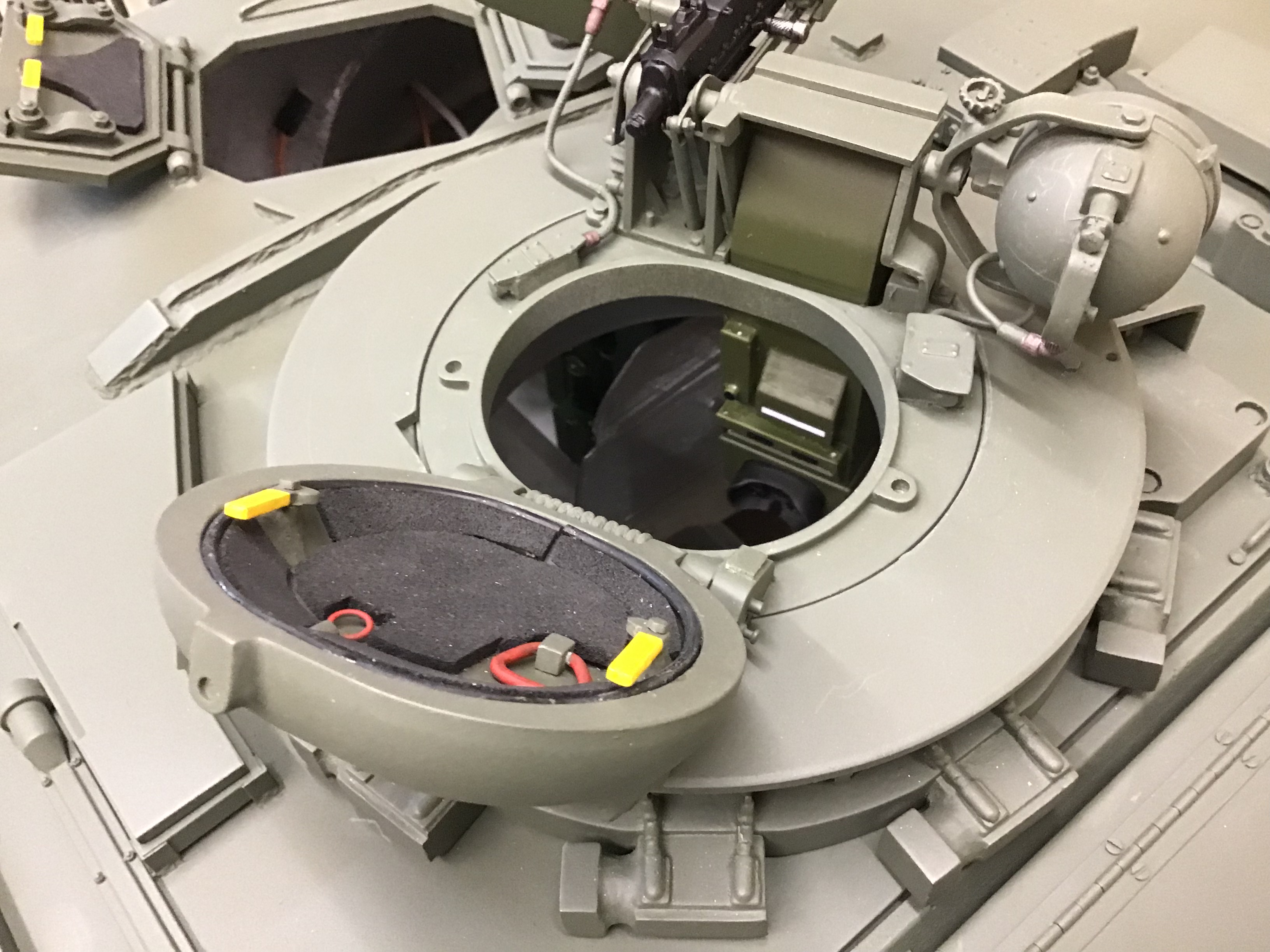

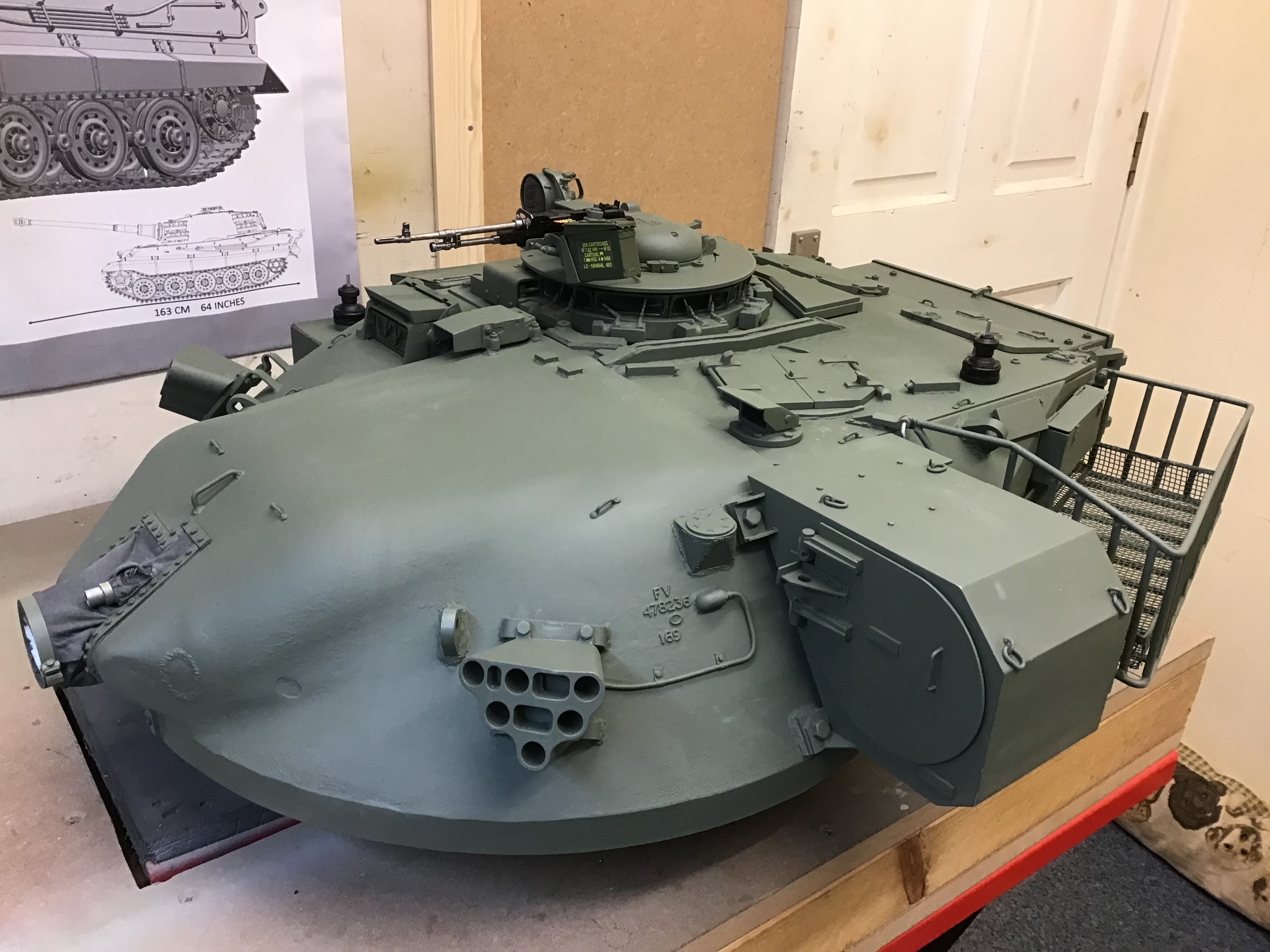

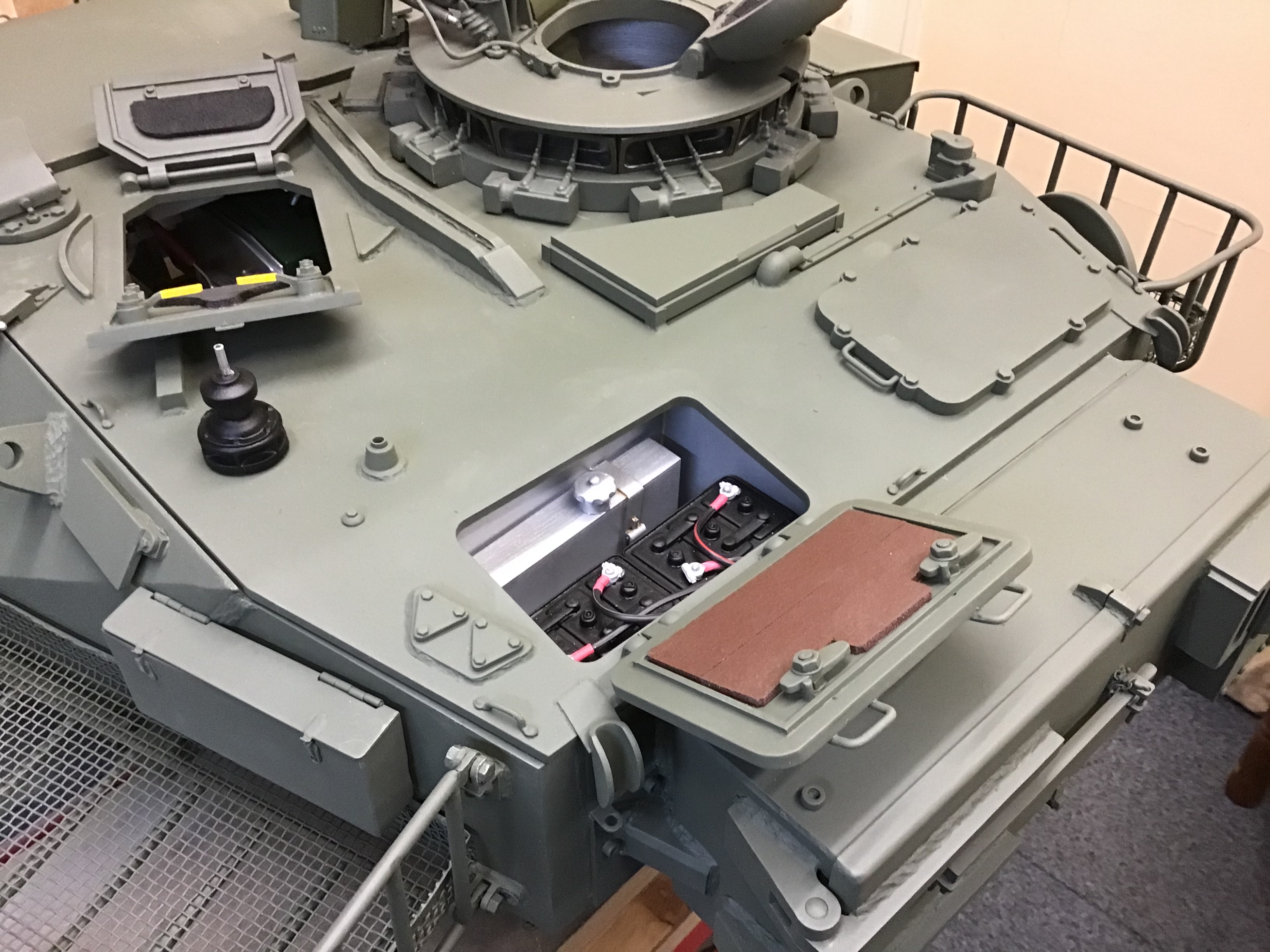

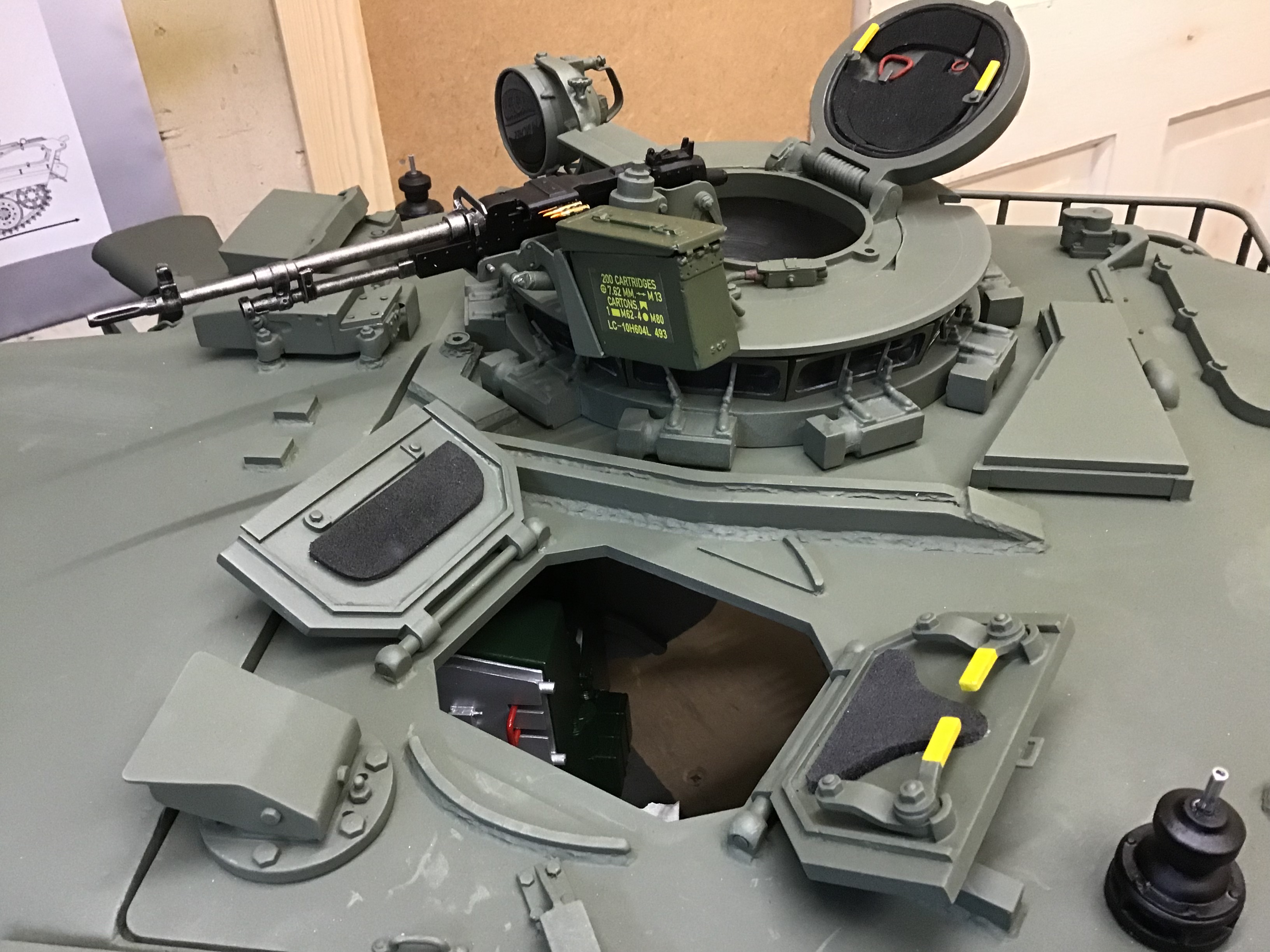

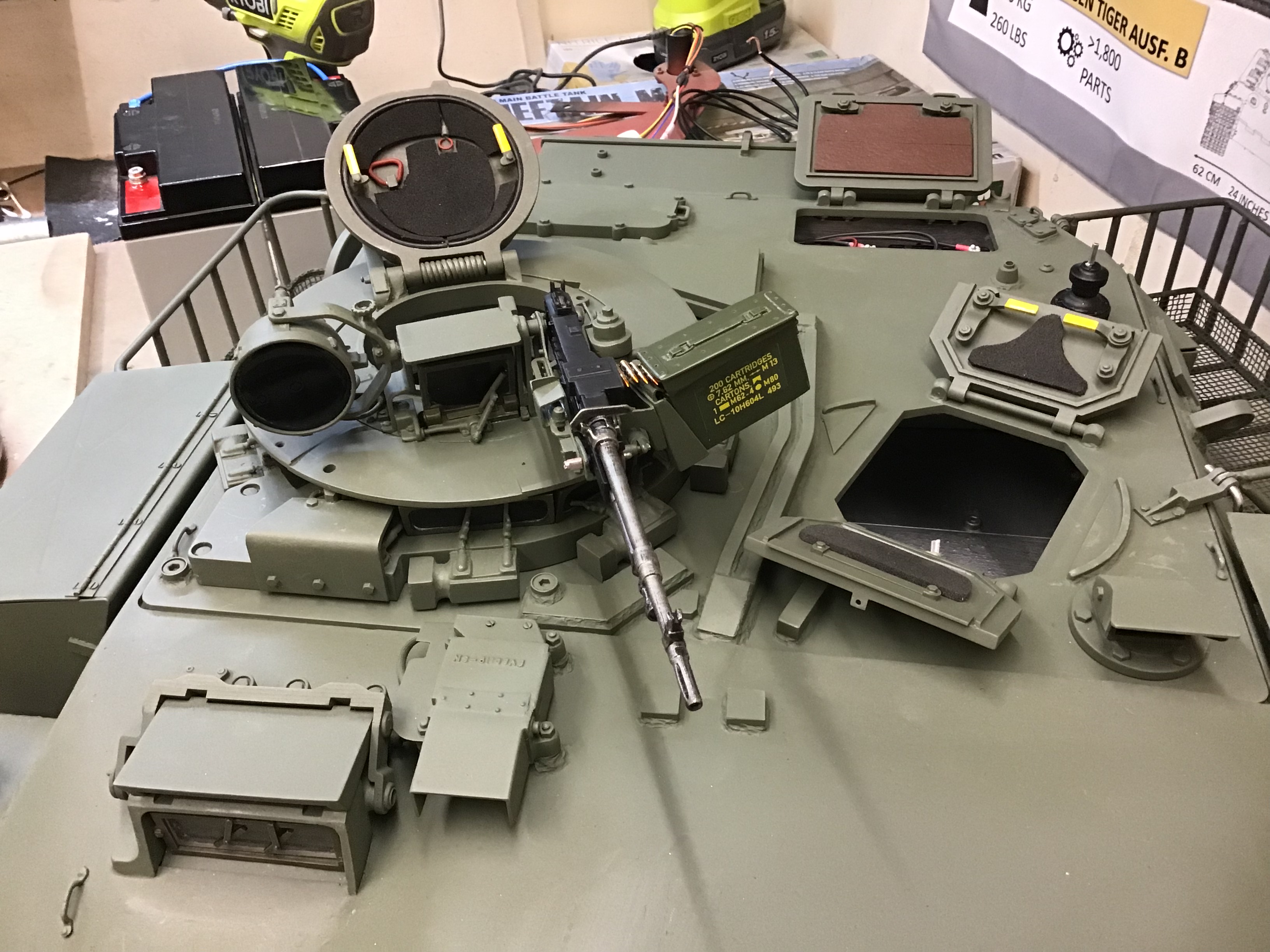

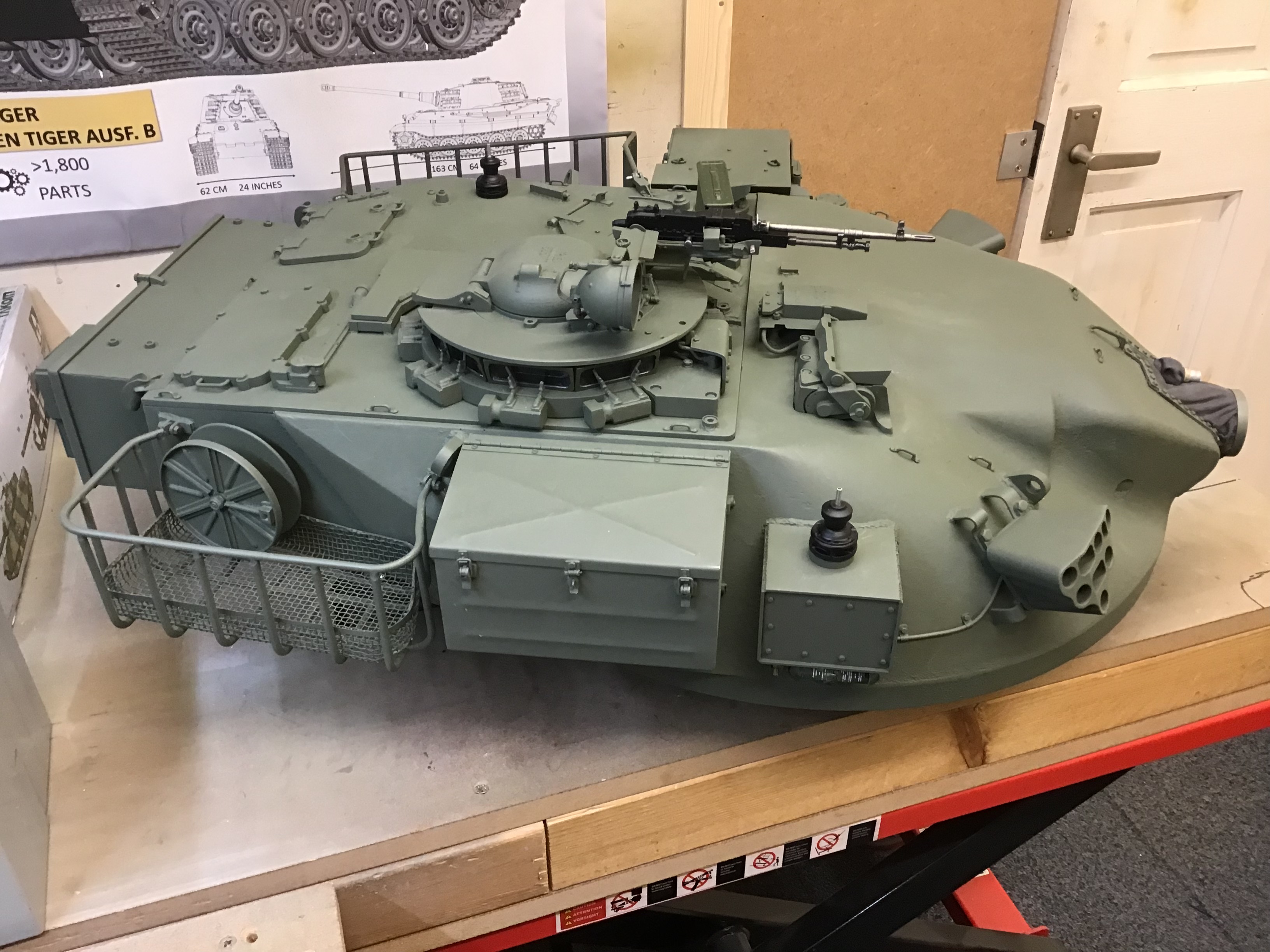

It’s been a while since my last Chieftain post and things have moved along with the build. The turret is now complete with the exception of some internal wiring and the final camouflage which will have to wait until the hull is done.

Hi Steve,
That is looking really good, excellent detailing.
What colour green paint are you using ?

The paint is Fosco English Green

Beautiful work Steve
DB
Posts: 2062
Re: Steve,s Chieftain rebuild
Lovely build steve, the details look superb, a lot of effort on show and skill, regards simon.
Posts: 1693
Been liked: 1842 times
Excellent work Steve. :mrgreen: lovely pictures I'll be coming back to these pictures in the distant future.
And worthy reference material it is, Vince's prints filling in the details beautifully too.
Well done. 8)
Posts: 2355
Has liked: 163 times
Been liked: 849 times
Extraordinary detail. Fantastic looking. Nearly 1:1.
As always, amazing work Steve.

Fantastic work Steve. I would imagine they’ll be a few using those pics as a reference including myself!

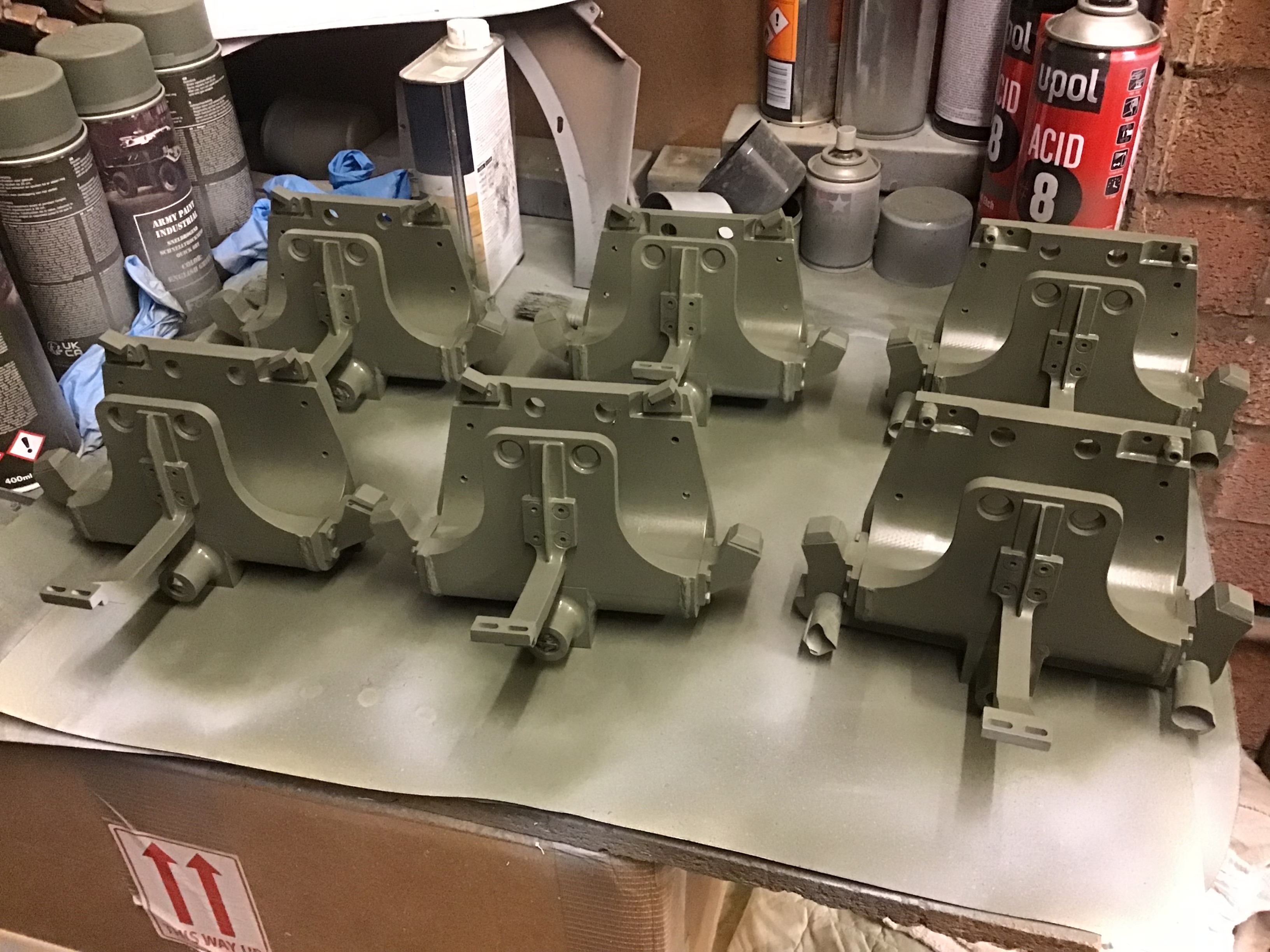

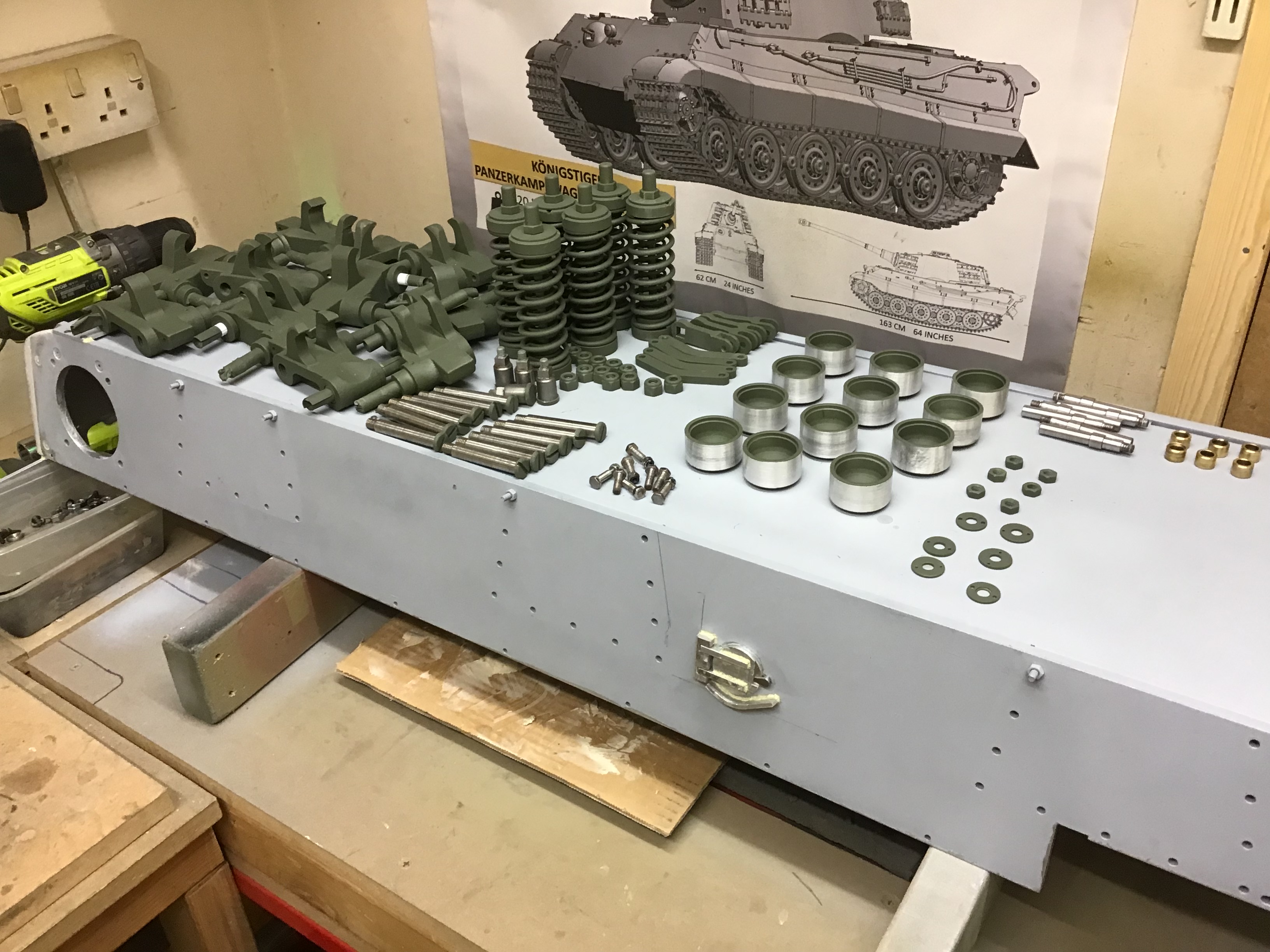

Suspension components awaiting assembly and suspension housings being painted.
Hopefully I will get this lot assembled in the very near future.

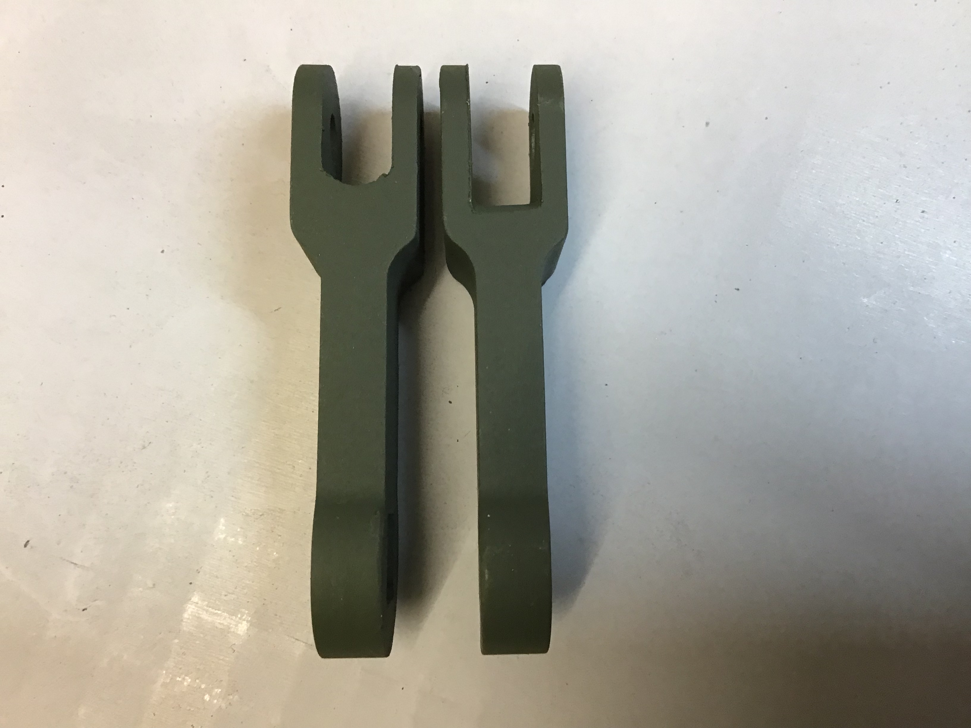

The damper arms require some material removing to prevent them binding up as the suspension arms move. Left arm is unmodified and the right modified

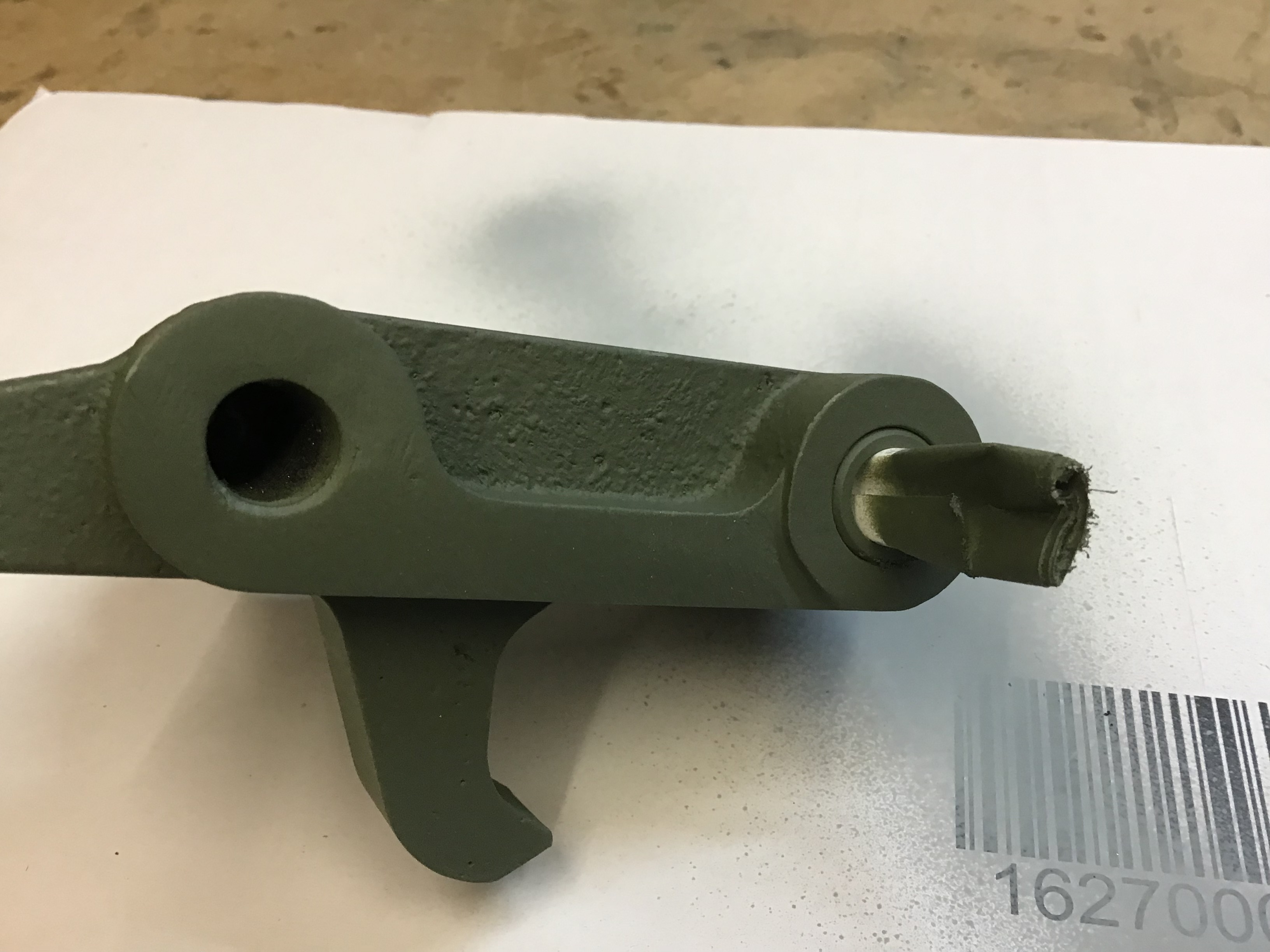

Each swing arm has had material removed along the back edge to prevent it rubbing against the suspension housing. Rather than remove material across the complete back edge and the adding a spacer I have left some of the original material

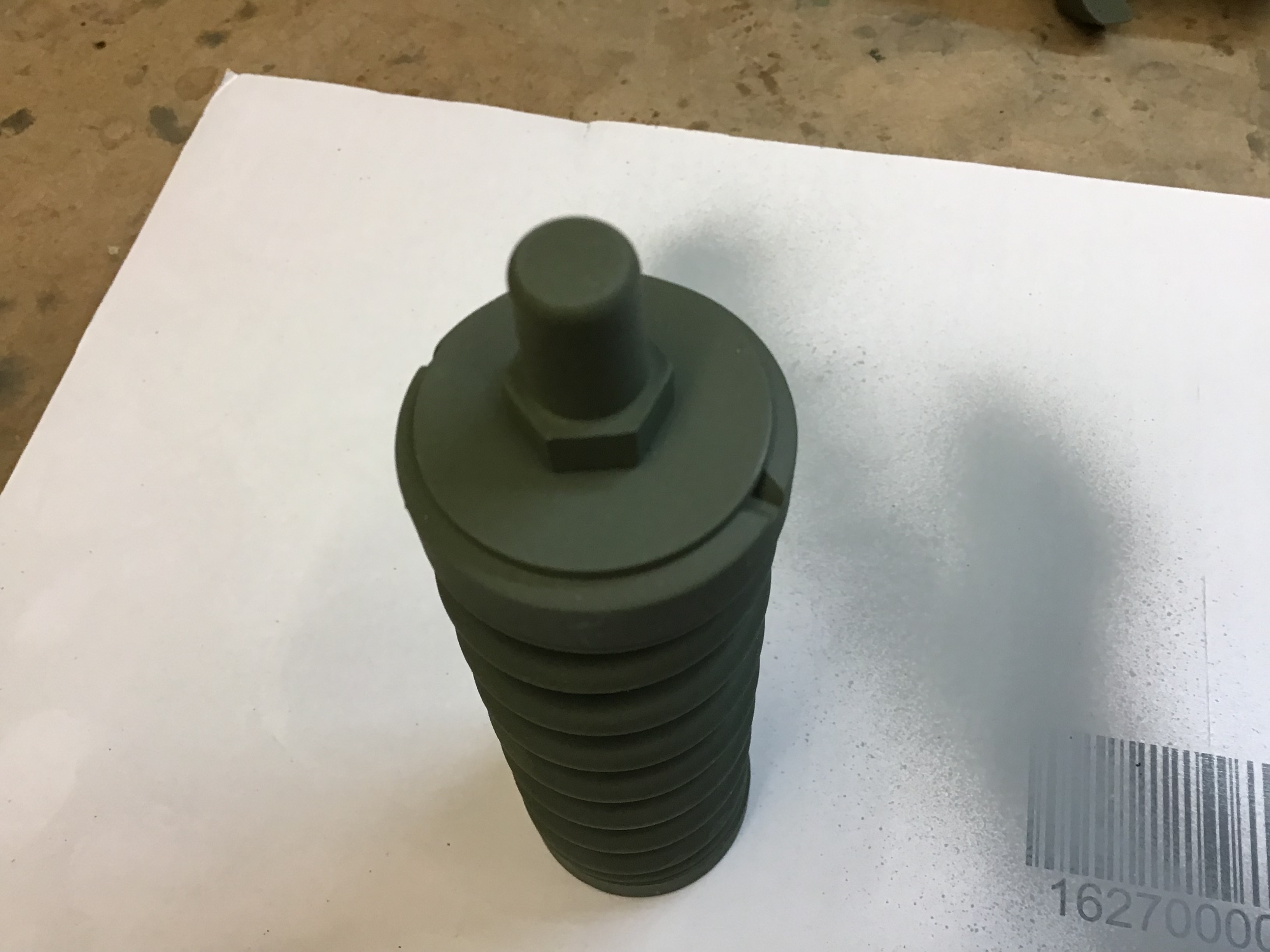

I have added a steel washer over the notch in the spring housing at both ends, the idea is to allow the spring housing to float between the swing arm prongs. By doing this i am able to get full travel of the swing arms without having to remove huge amounts of material from the suspension housings
The other end of the spring assembly. The washer at this end is held in place by the nut and as such easily removed if I find the mod does not work, the other end is glued and may take a bit more effort to remove if required
It will be a while before I can test the spring mod but hopefully it will work, one other advantage of this mod is that I don’t have to worry about the spring assemblies falling out of position when the weight comes off the suspension units.

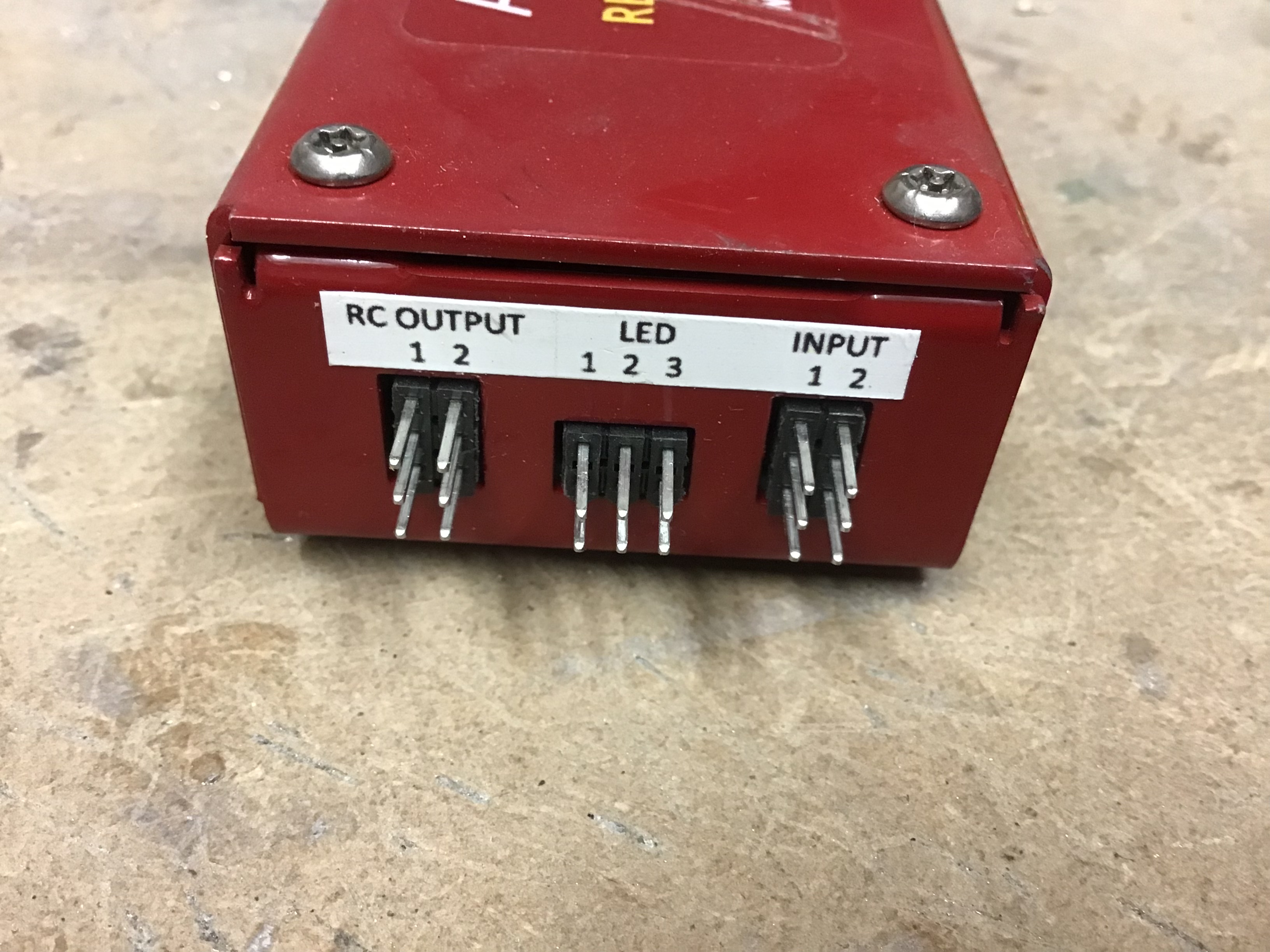

Continuing with the planning for the wiring, does anyone know if one of the LED output’s can be used to power the headlights .
One LED output is needed for the recoil flash
