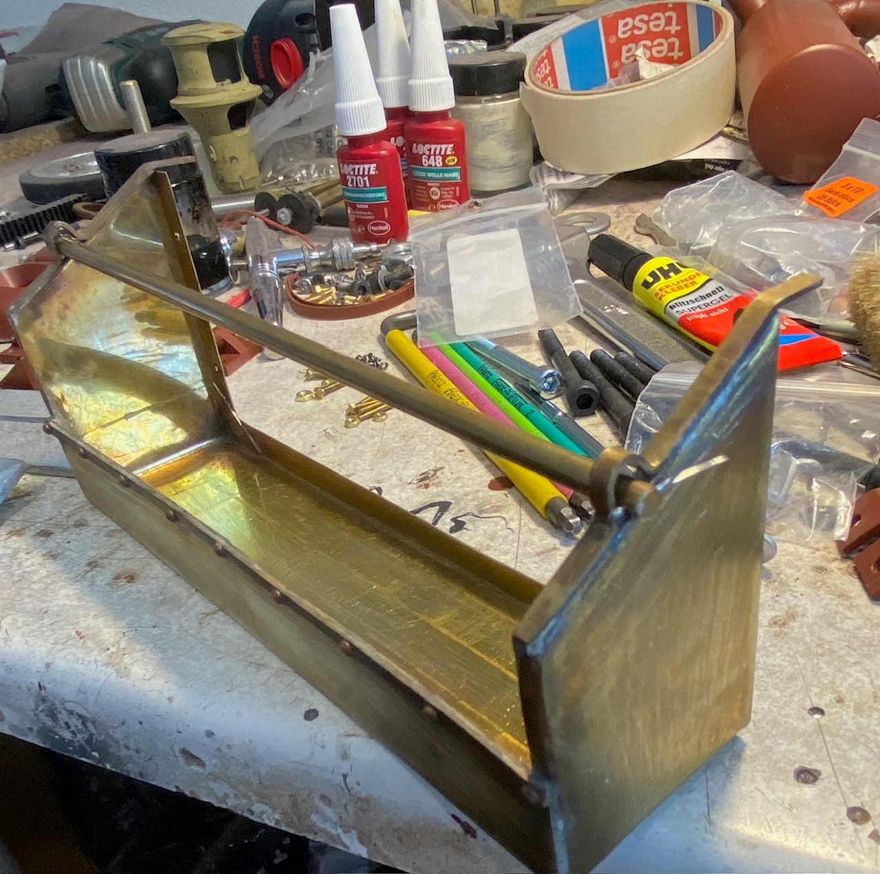

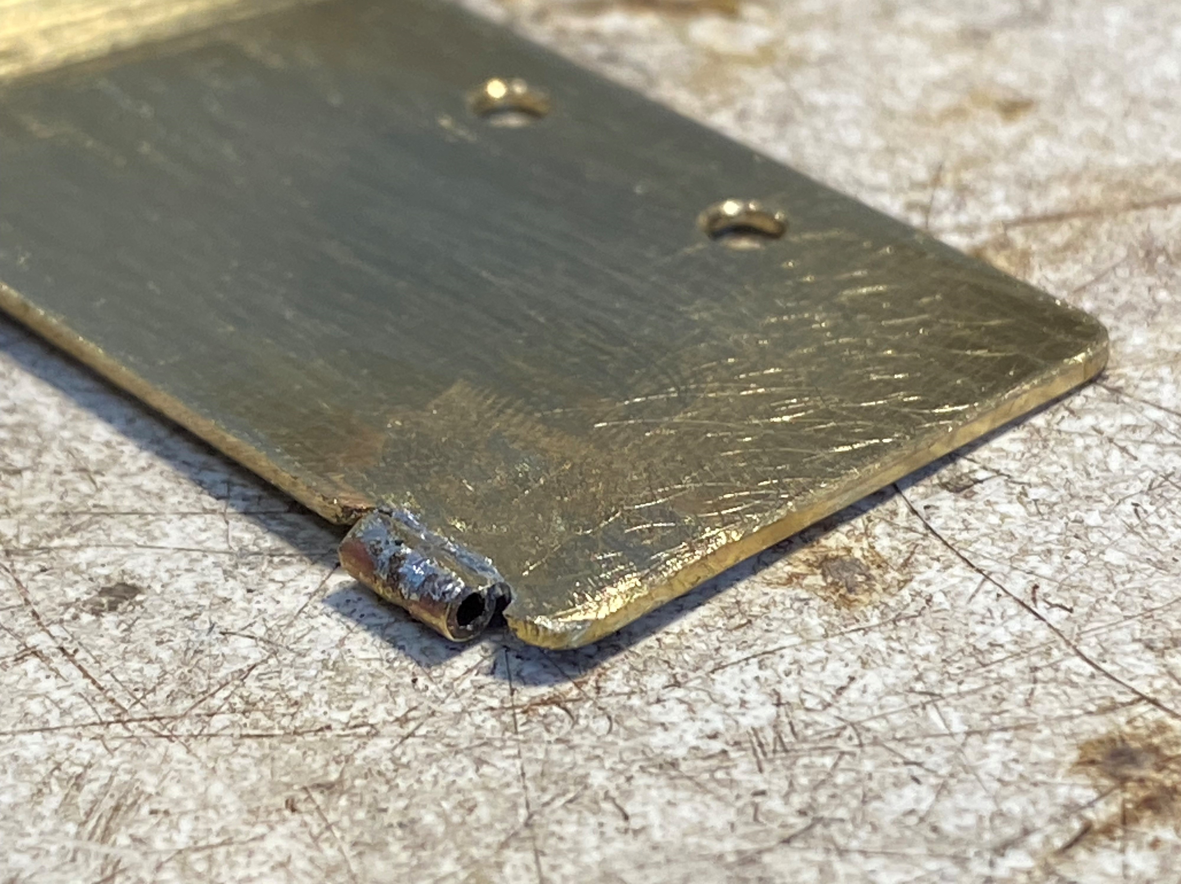

thanks for your nice words. Here are some more progress of the details for the mud guard.
Regards Martin

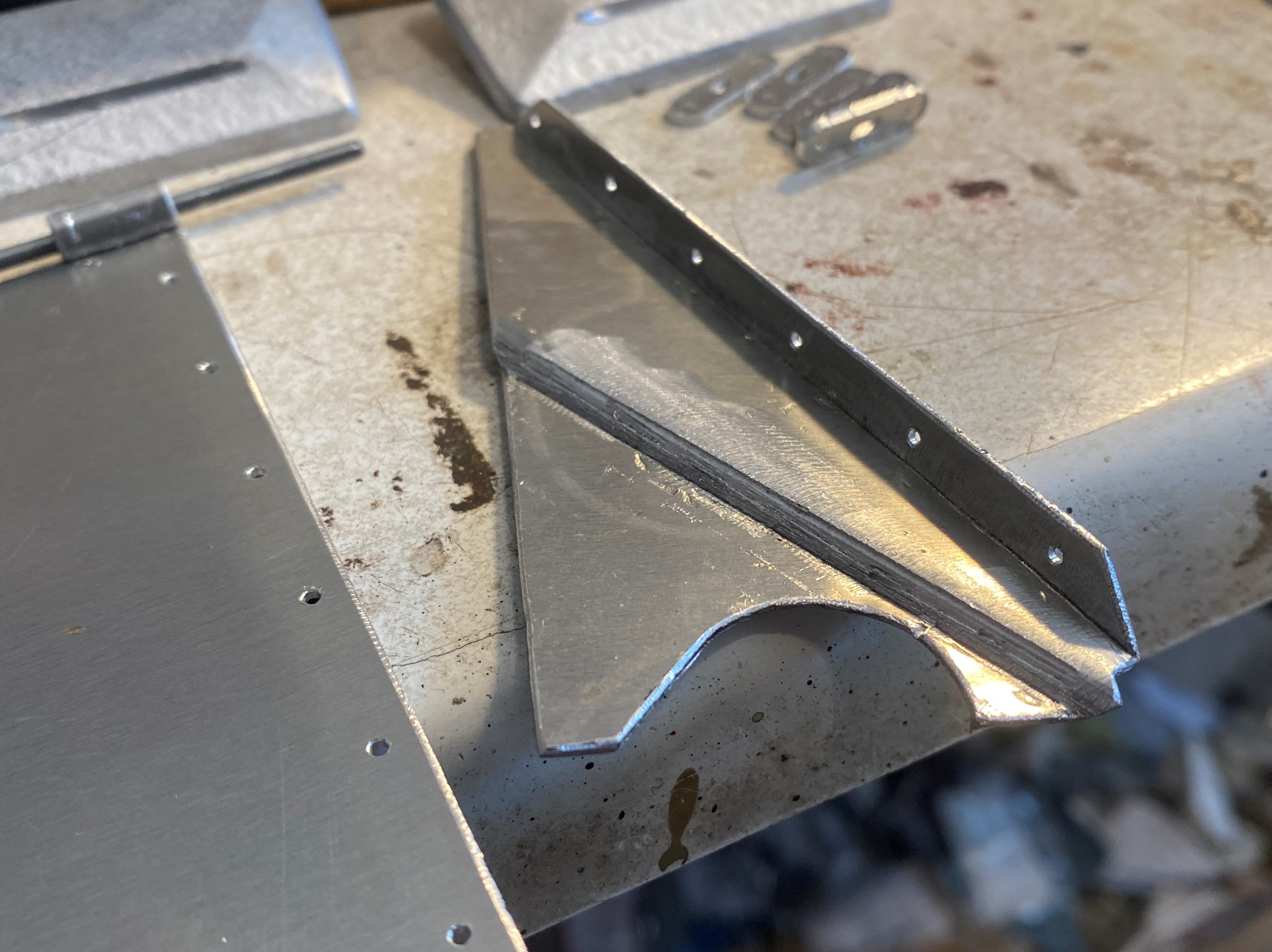

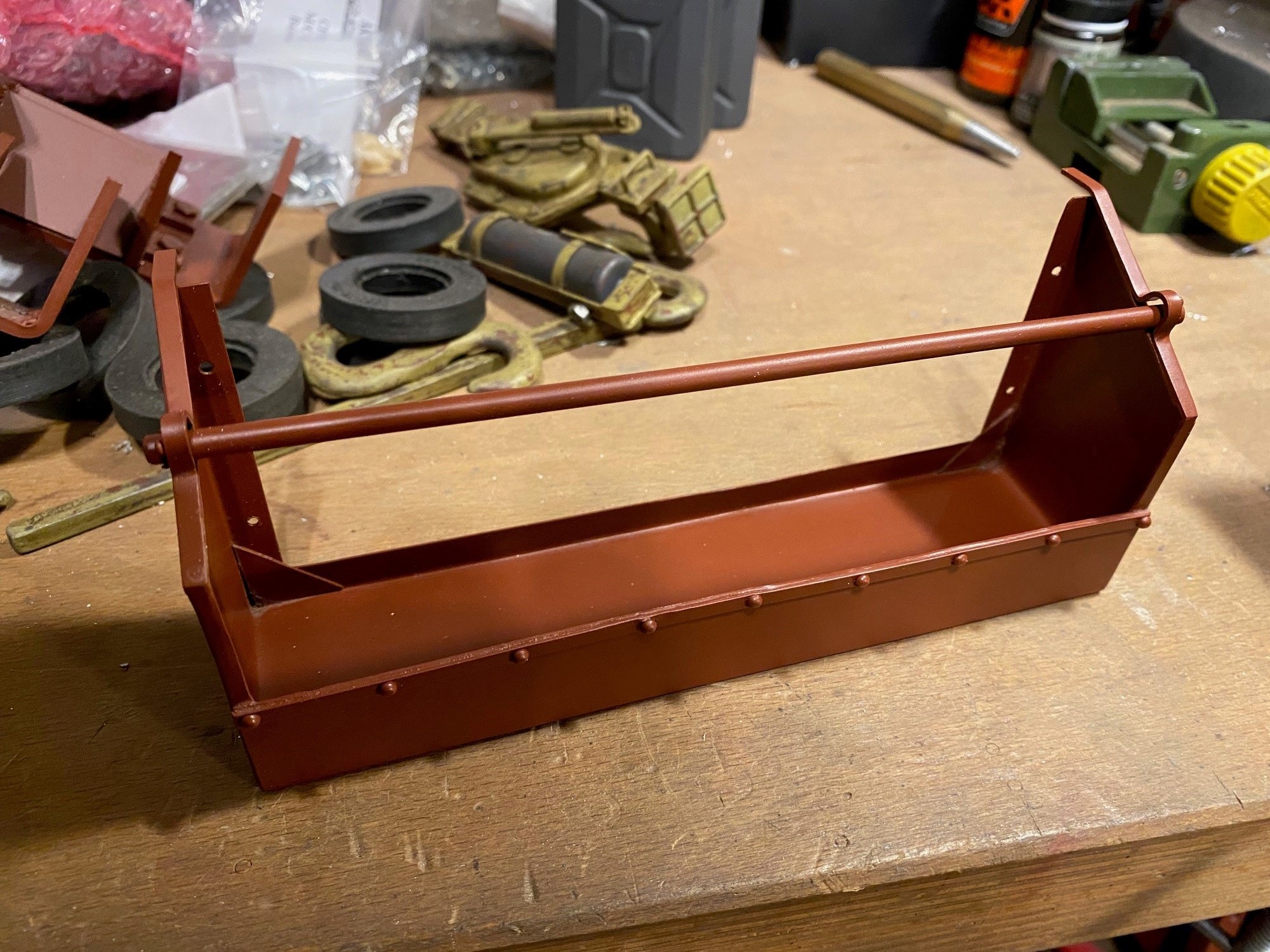

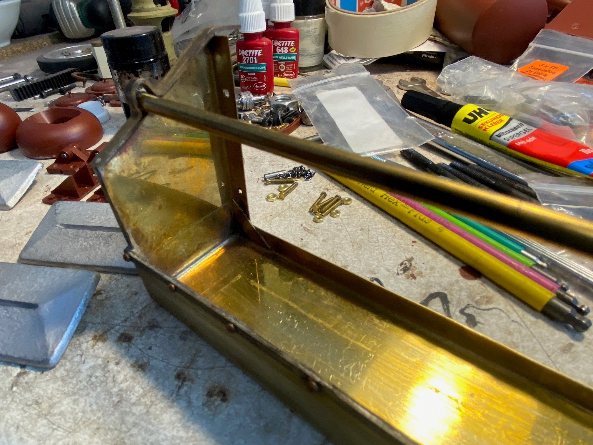

Post by Martin Hofmann »

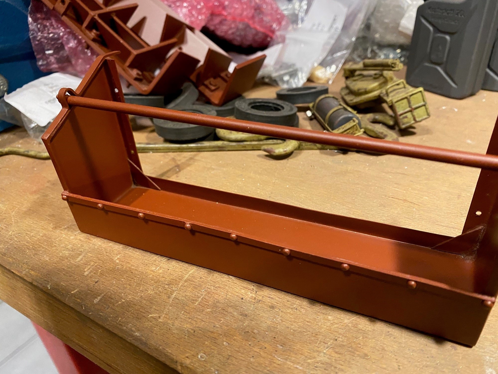

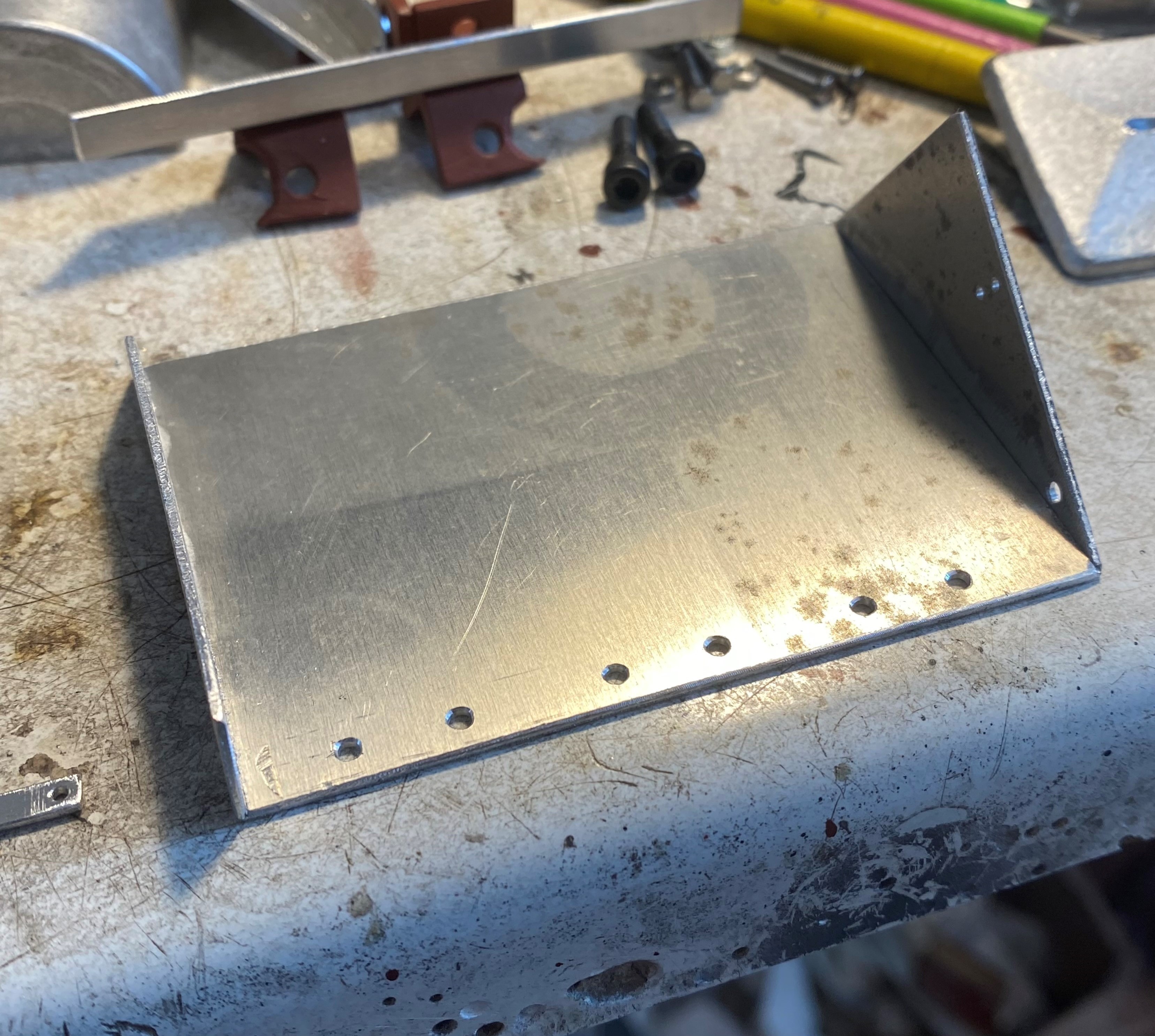

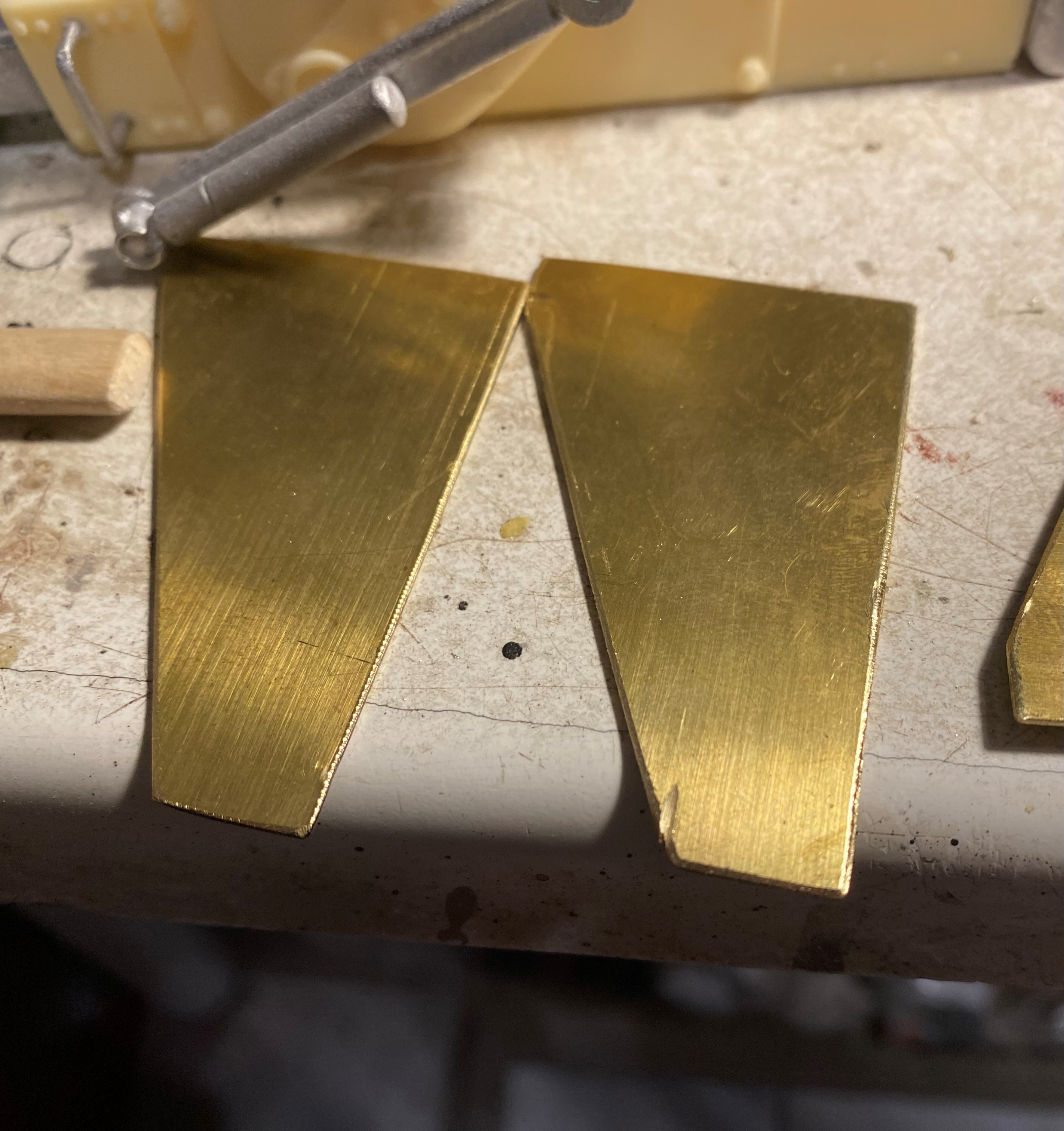

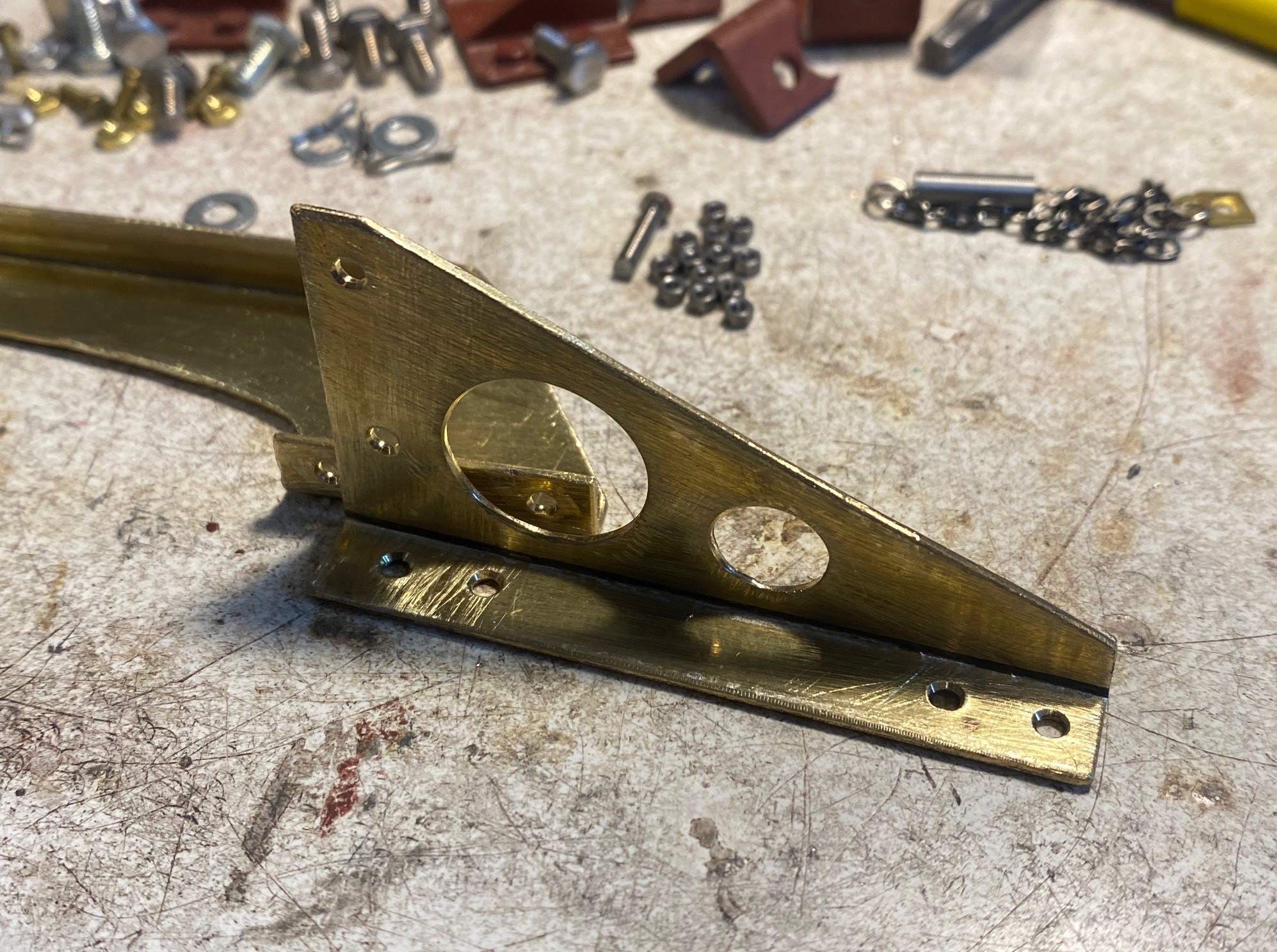

Here a short update before Militracks starts.
Now the mud guards are started.
Regards Martin

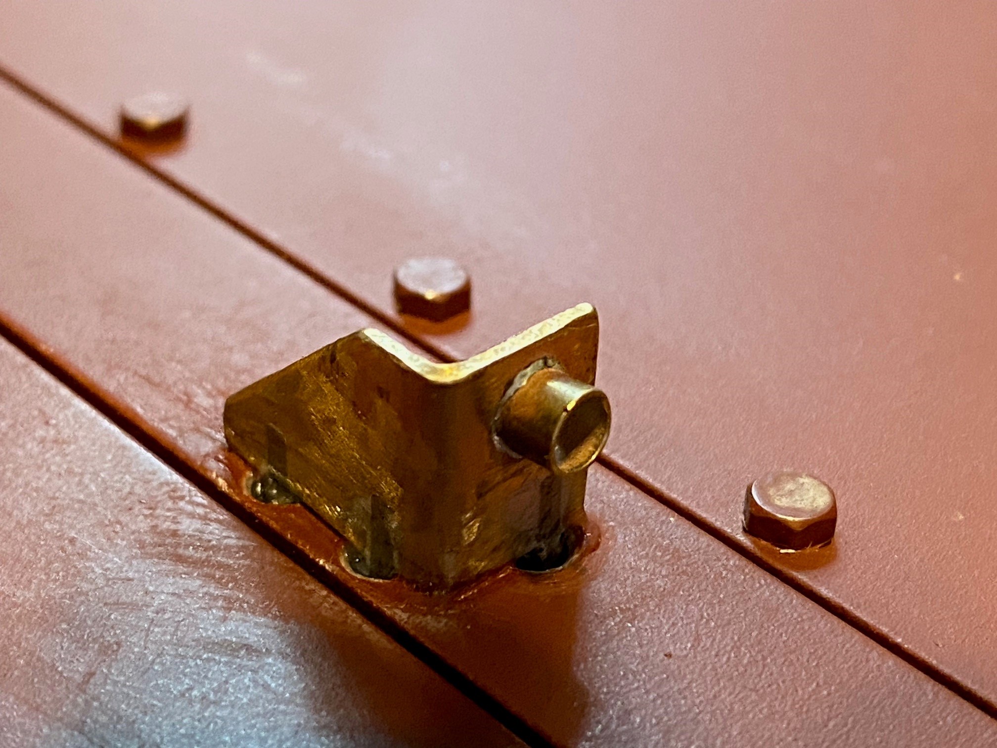

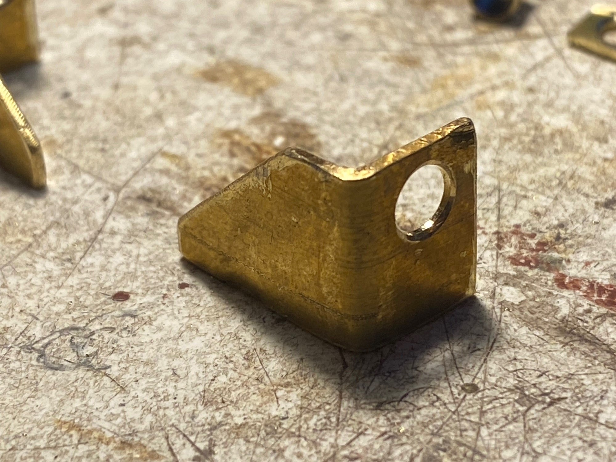

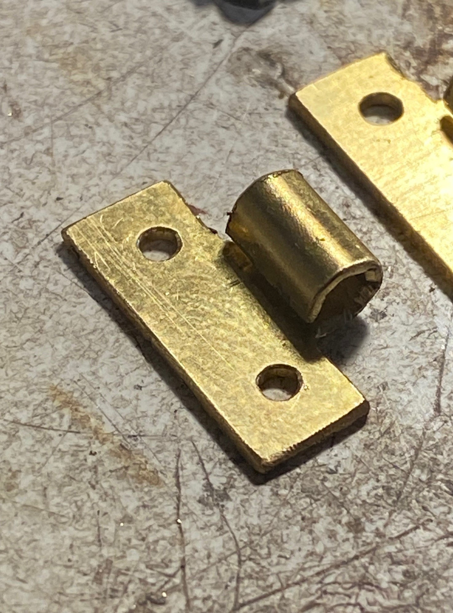

Hi Björn,
thank you for the comment. Was very nice to meet you in Overloon, so i have a face to the nice words.

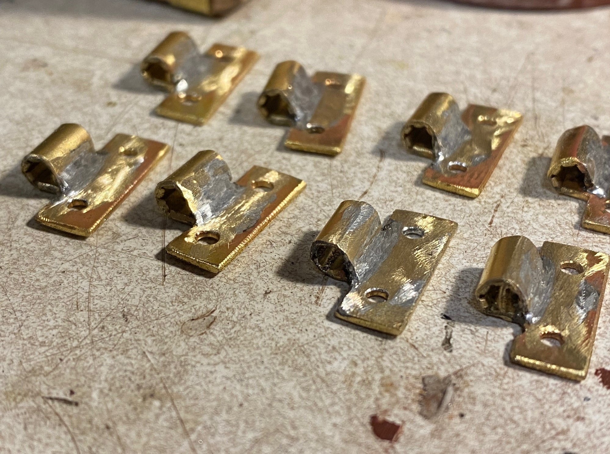

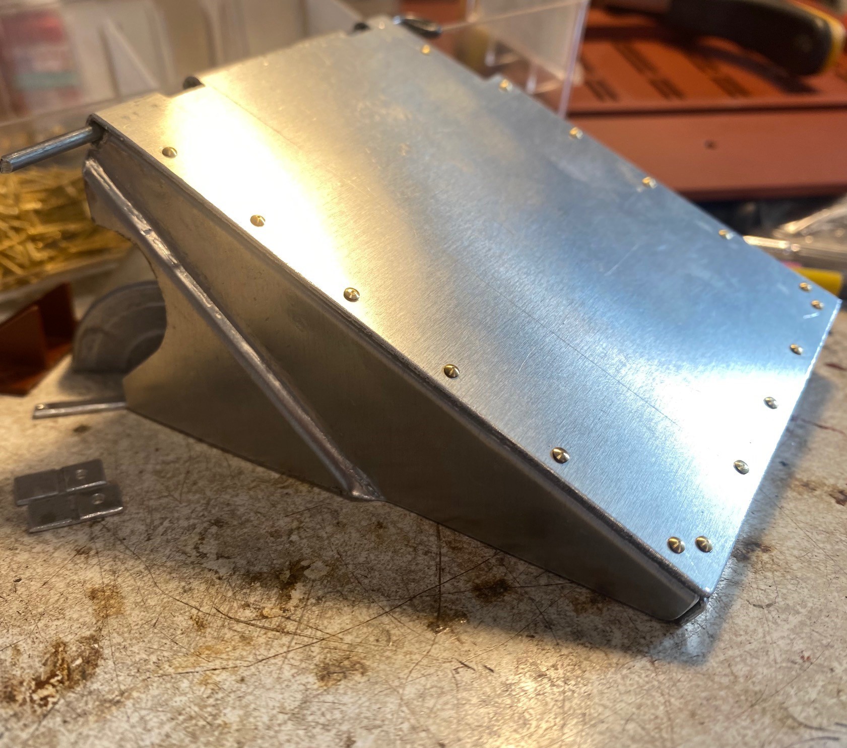

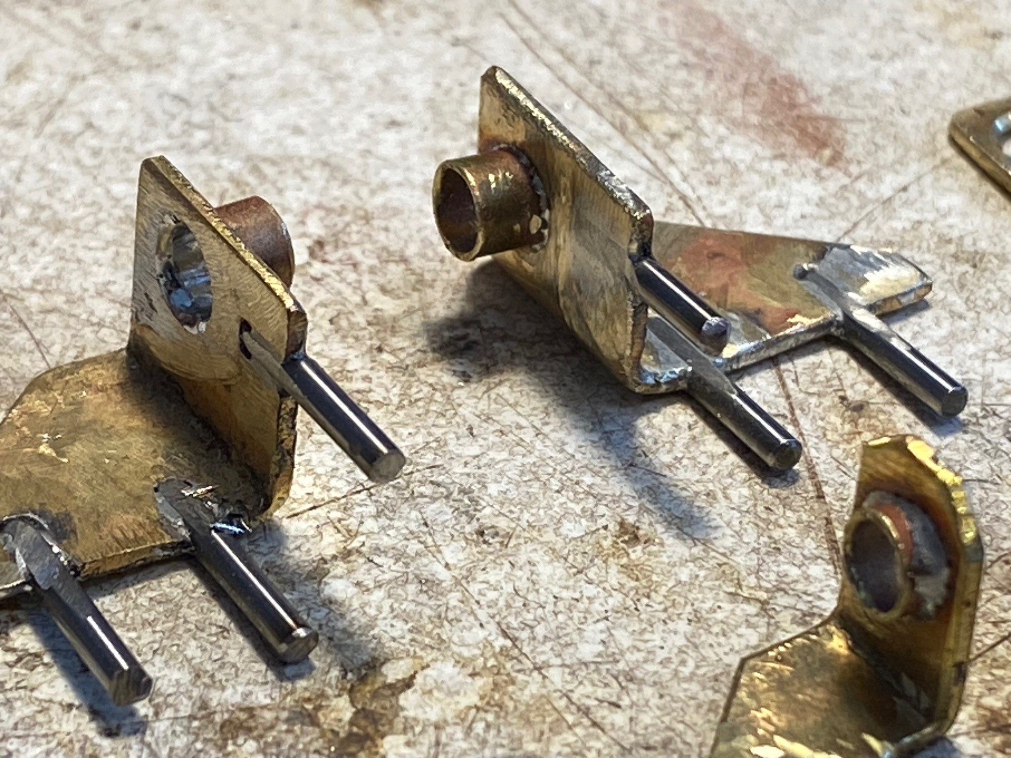

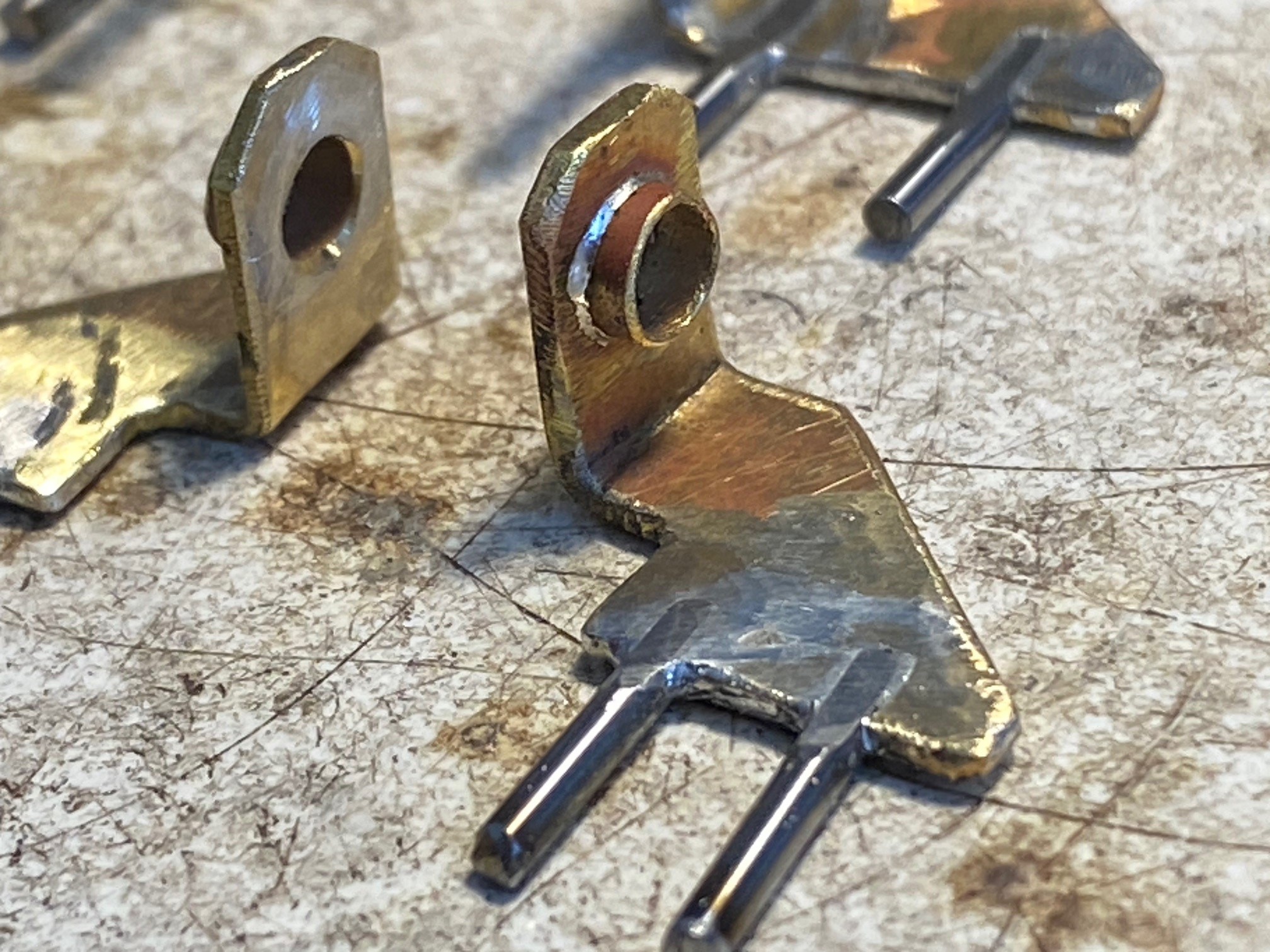

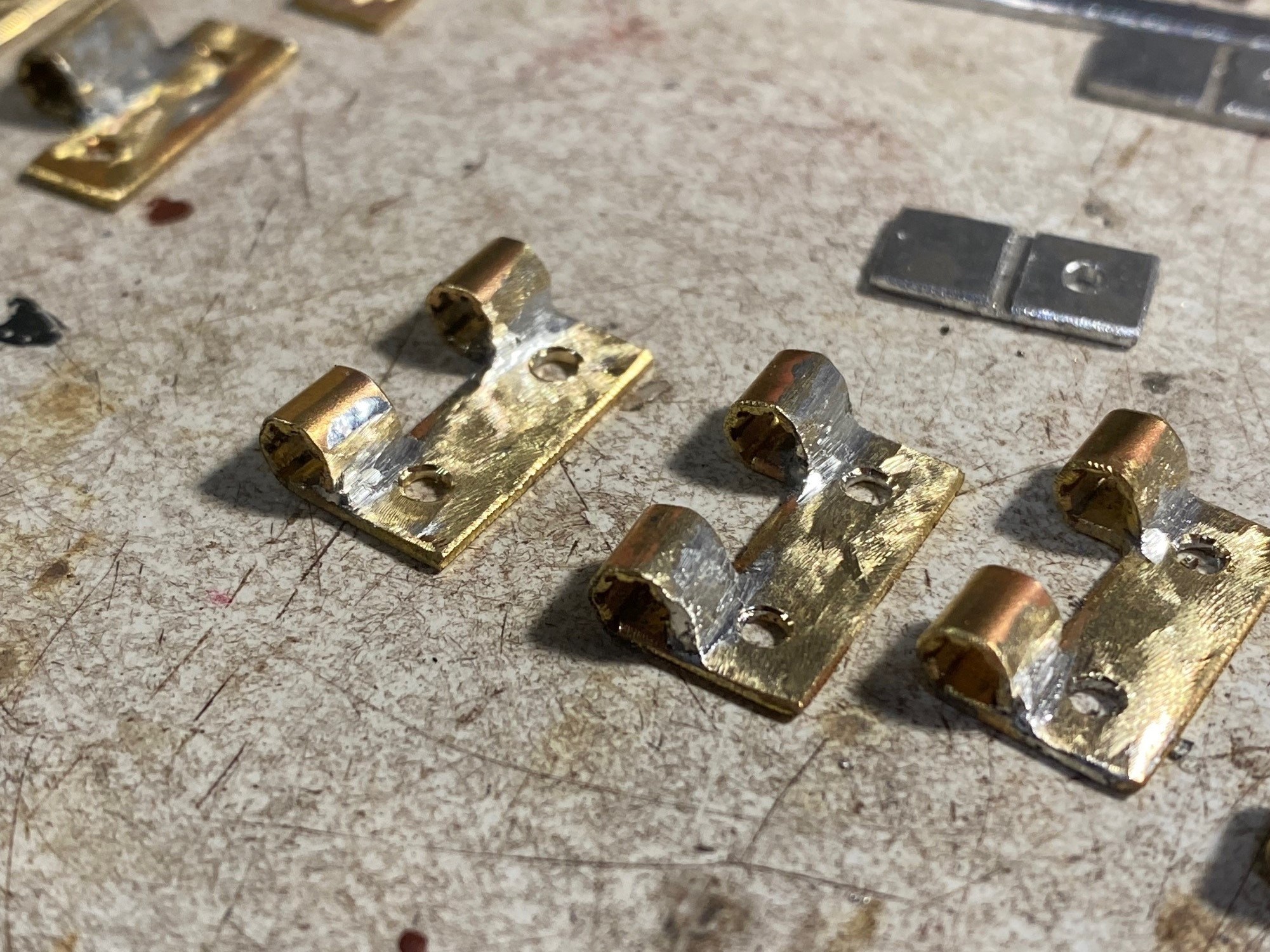

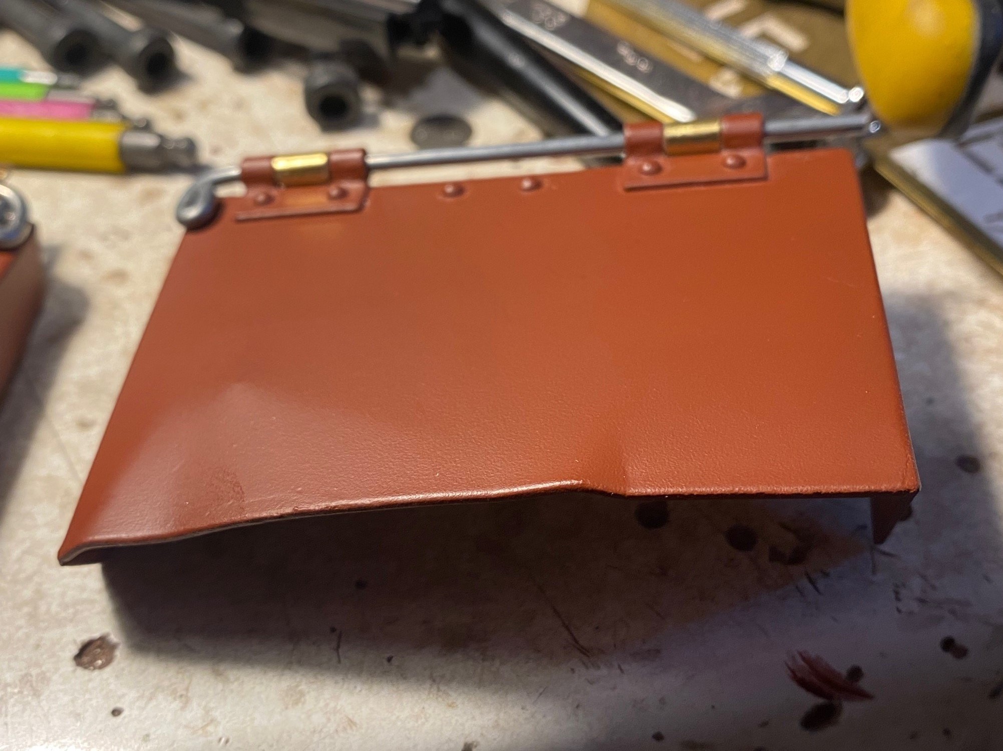

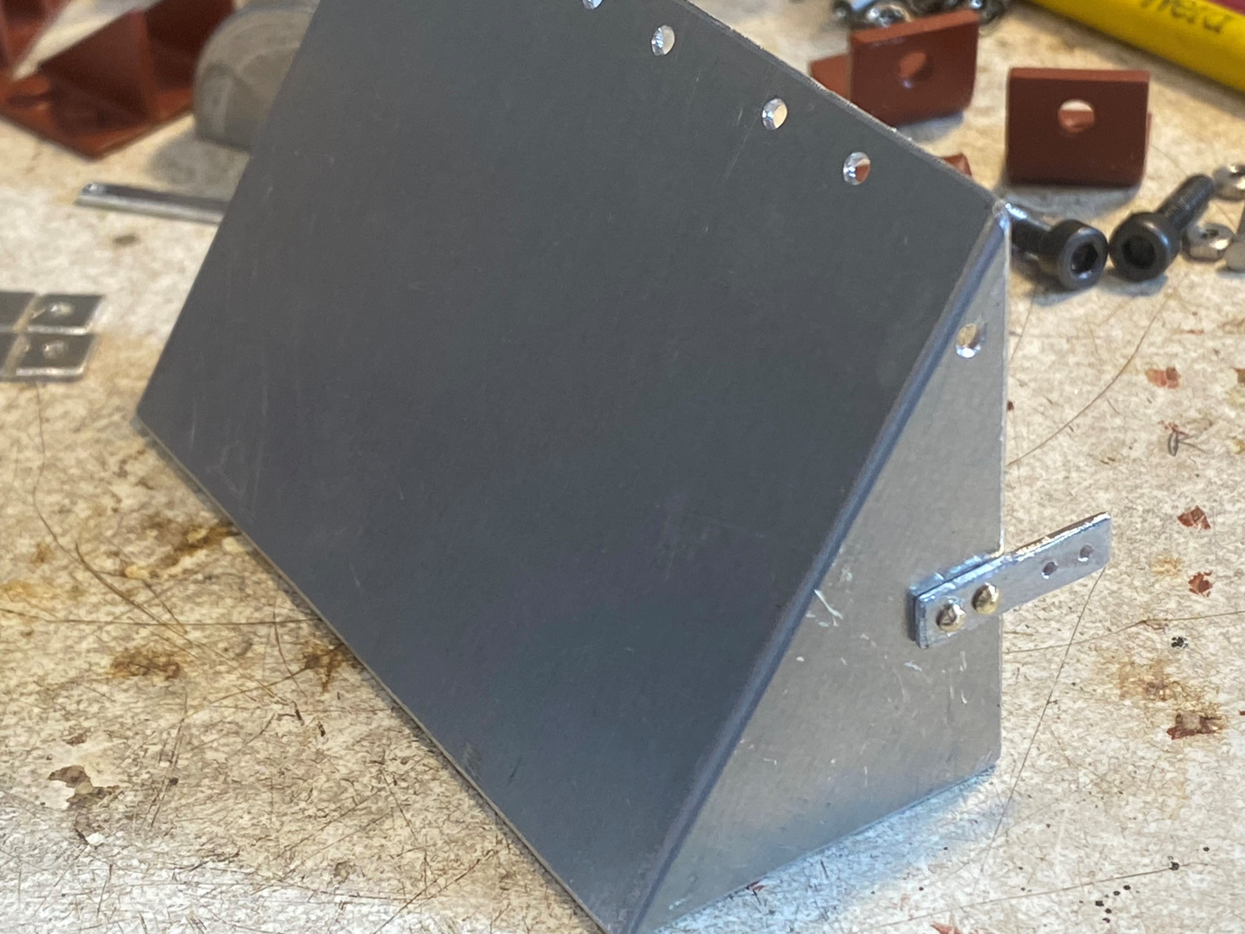

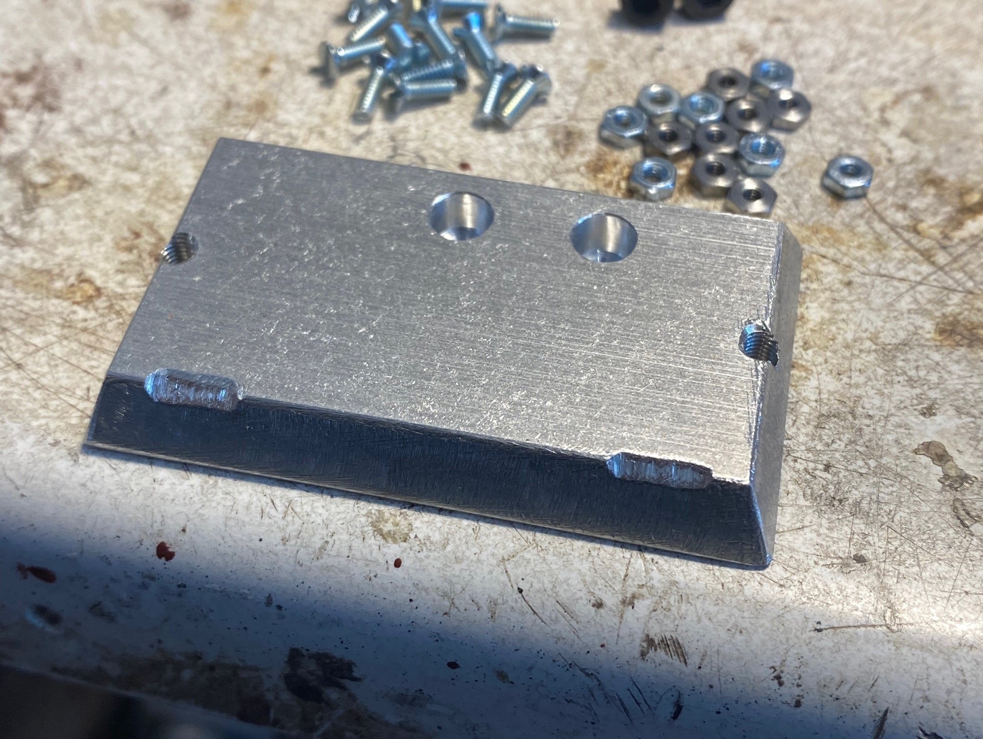

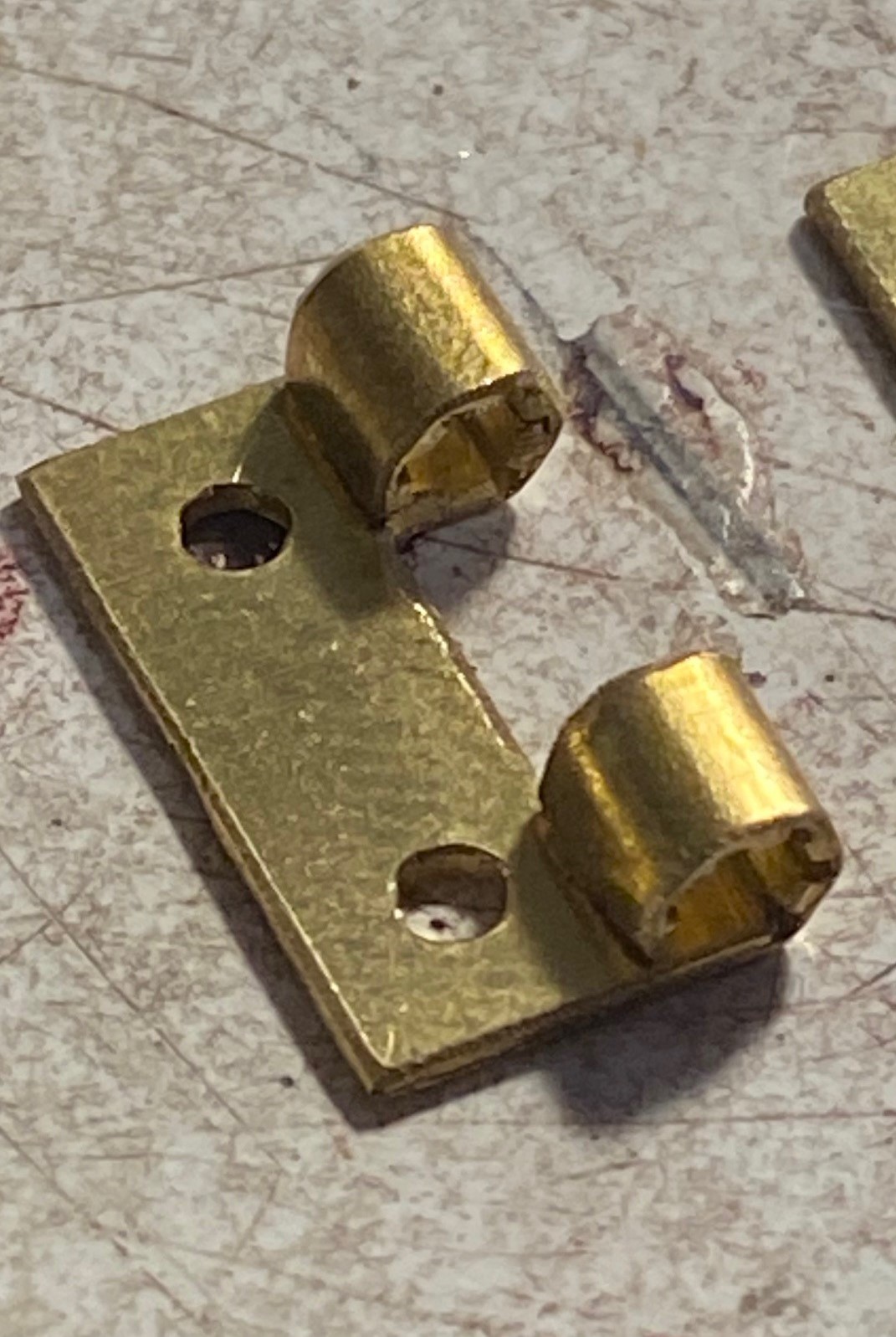

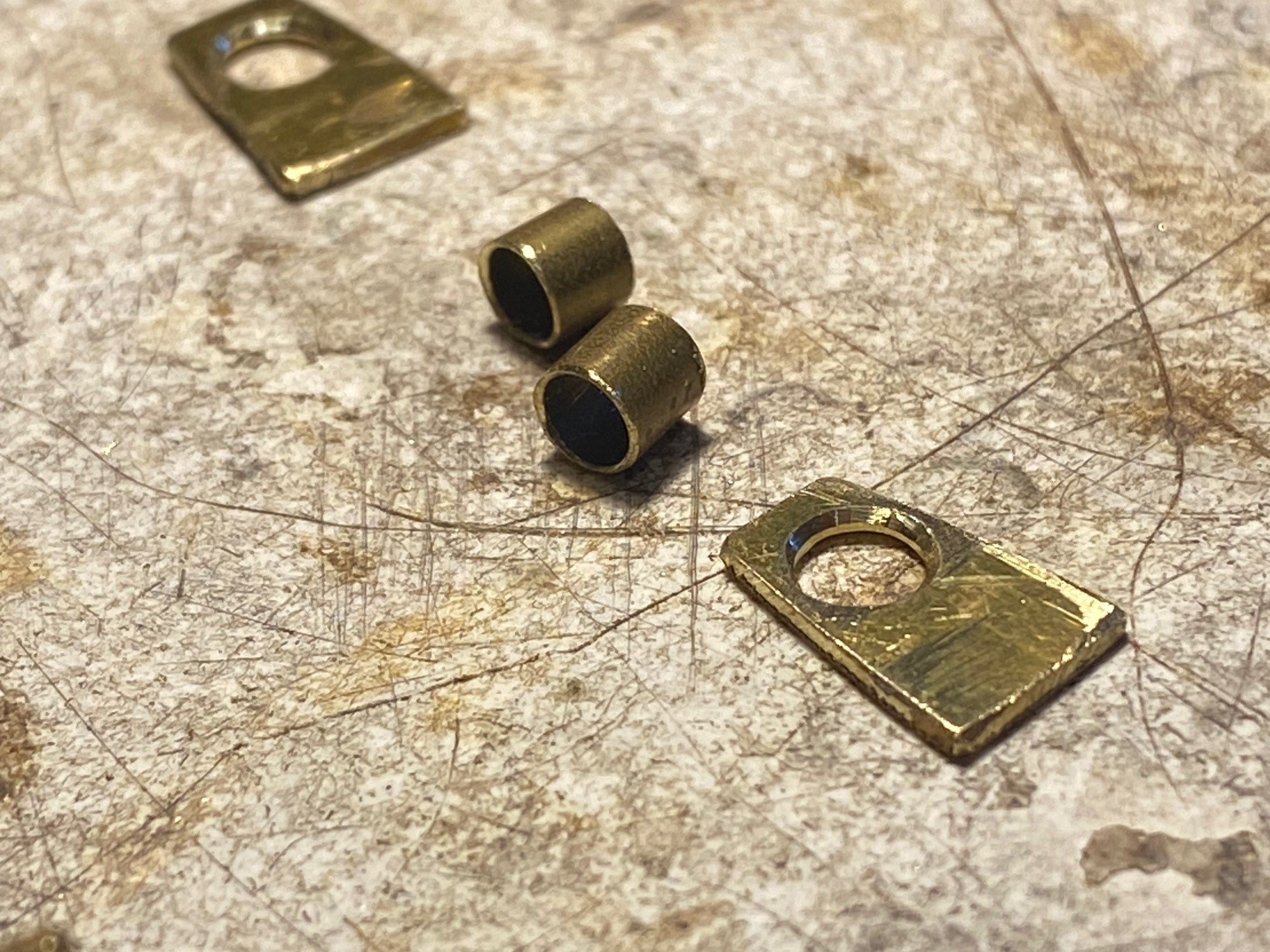

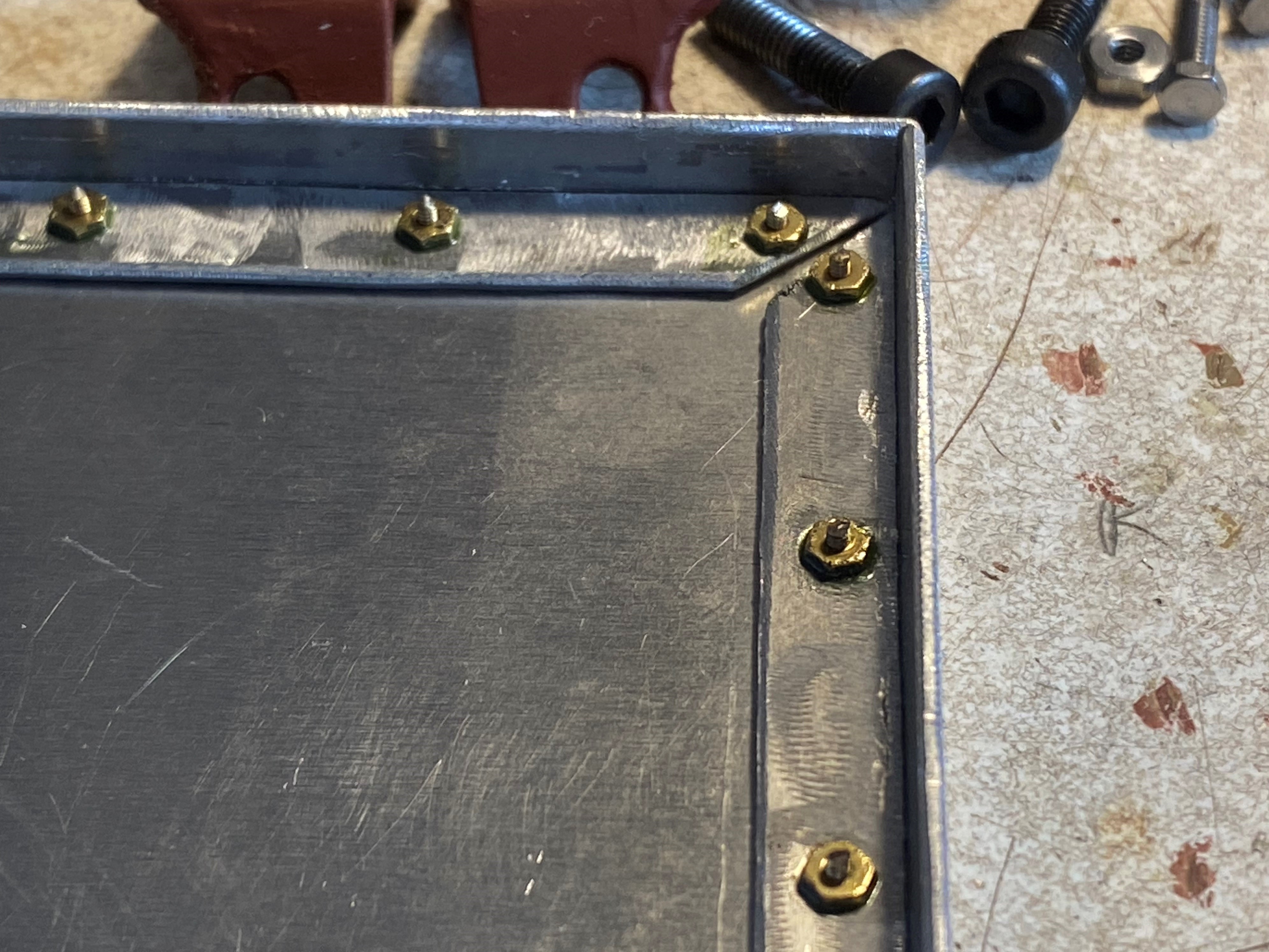

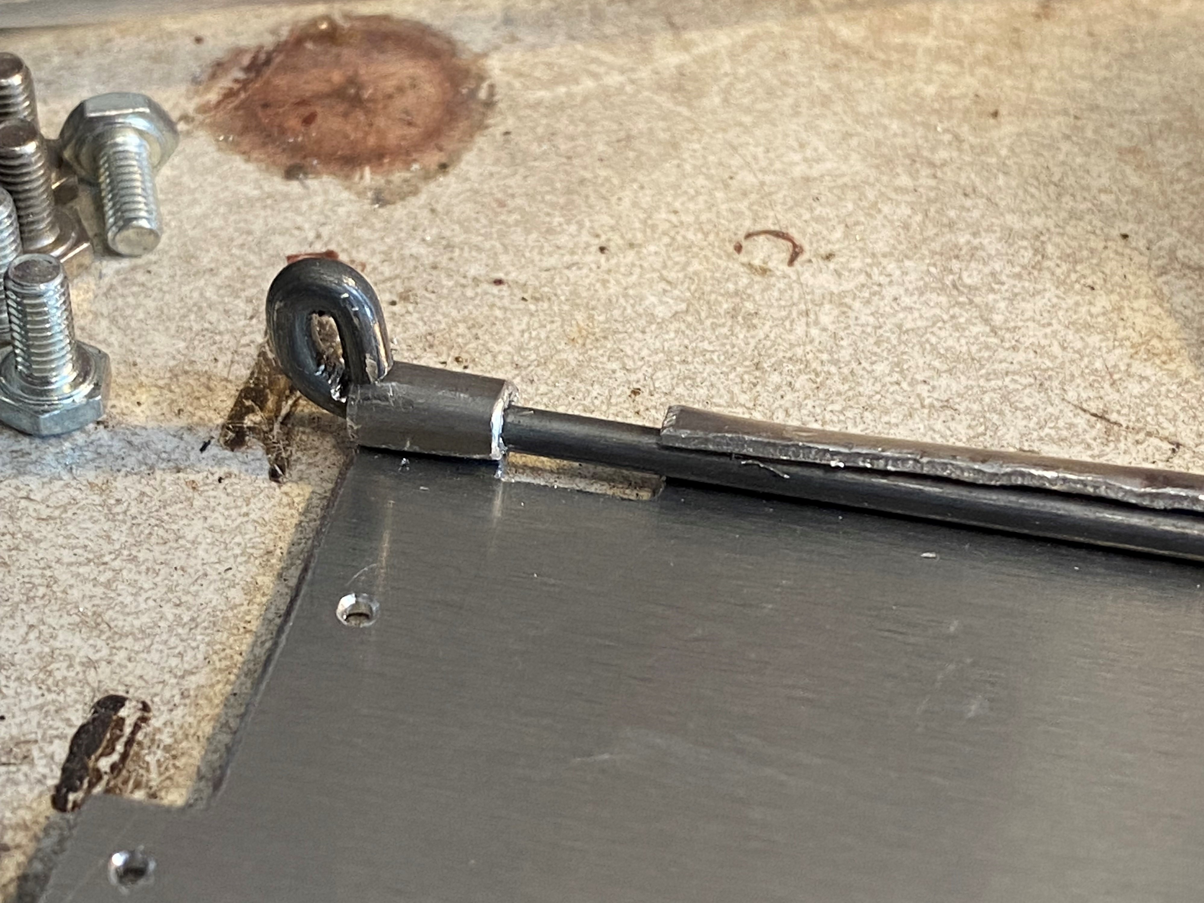

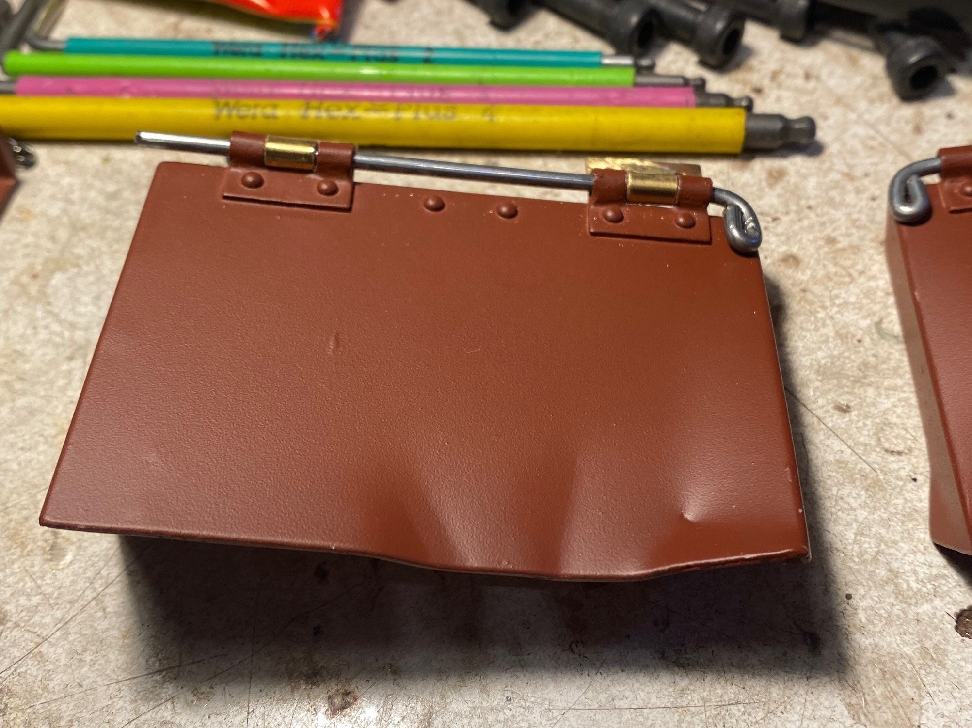

Here are the next photos of the mud guards and also the self made hinges. The rivet screws are M1 with nuts!!
Regards Martin

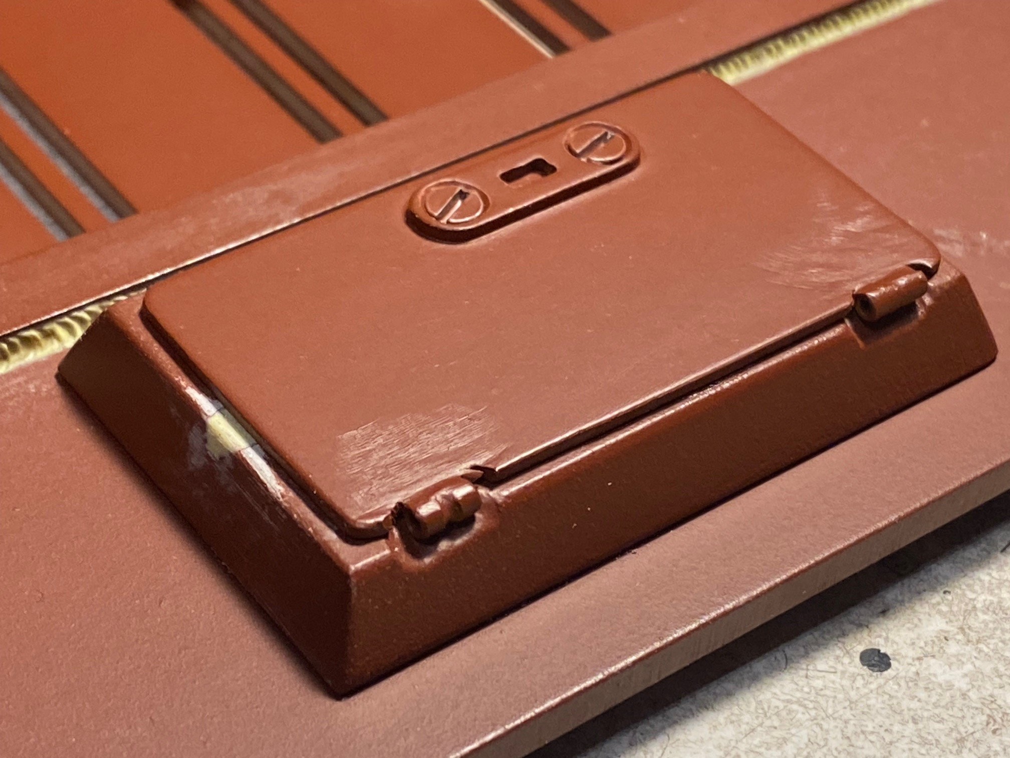

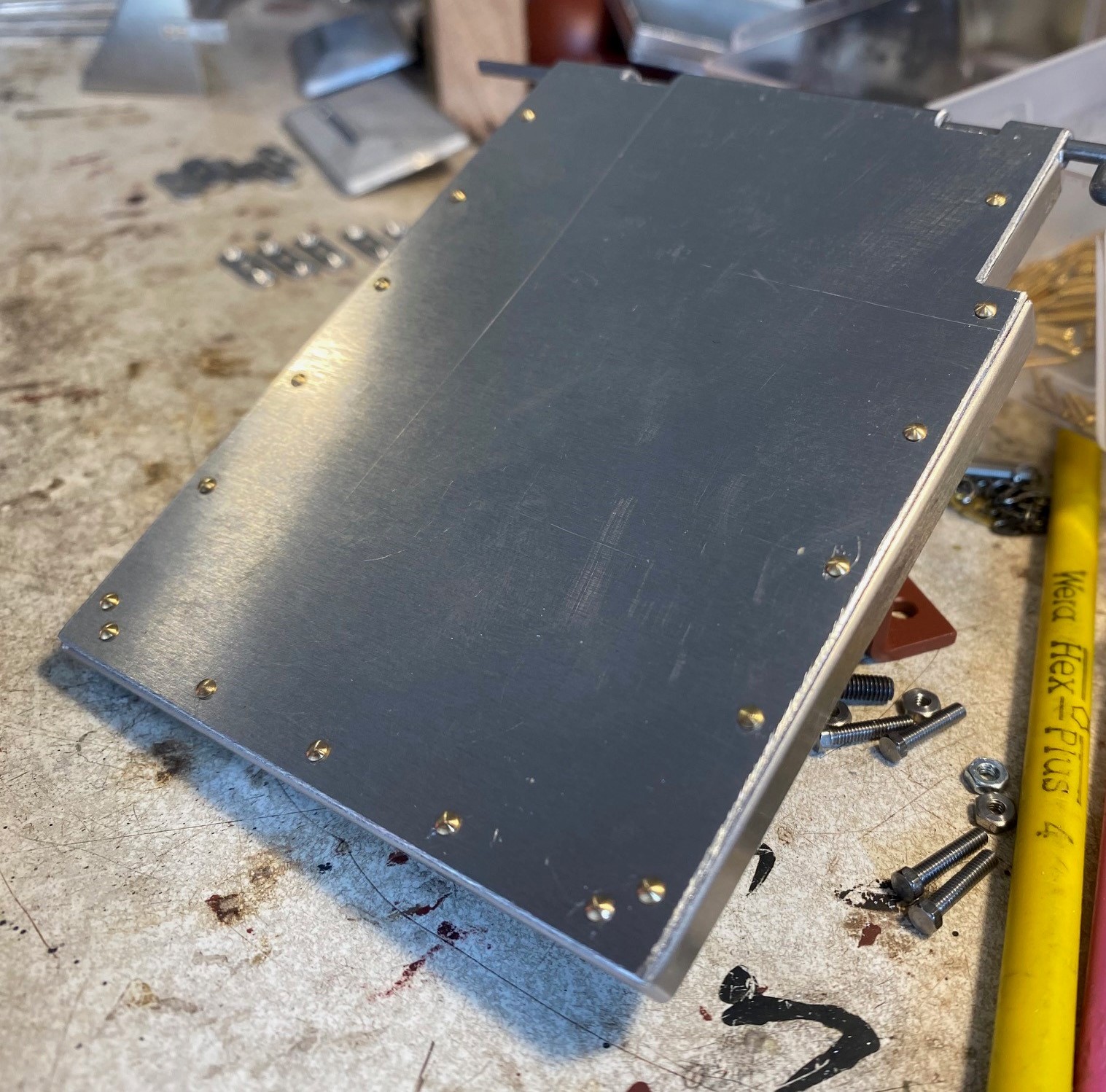

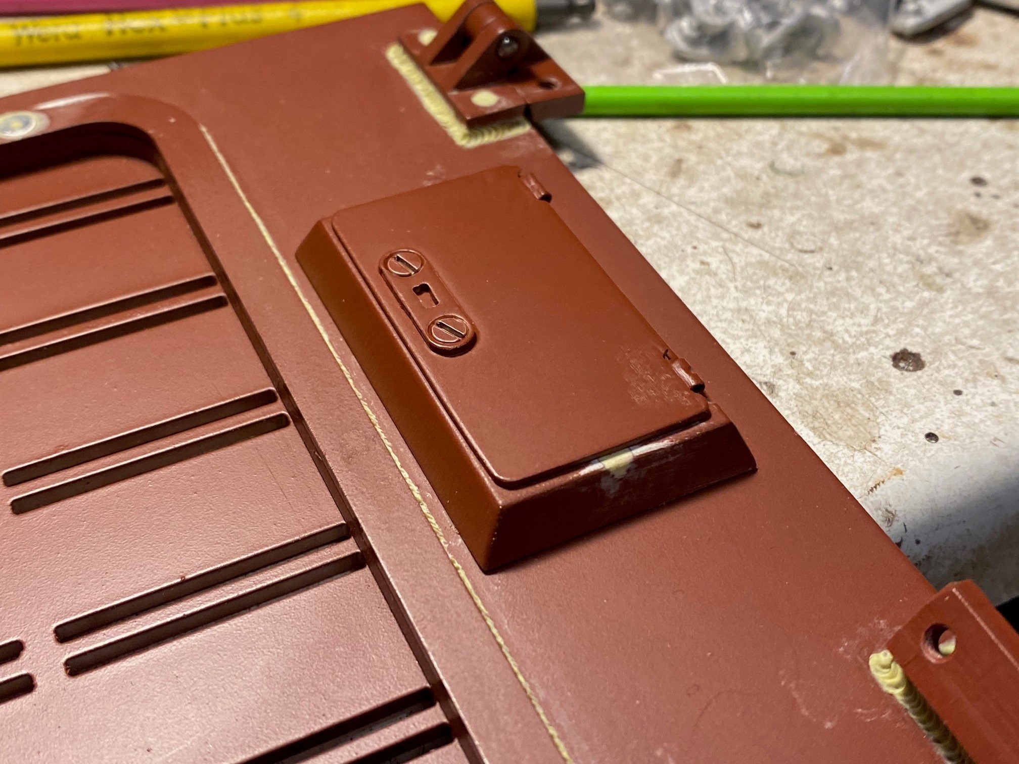

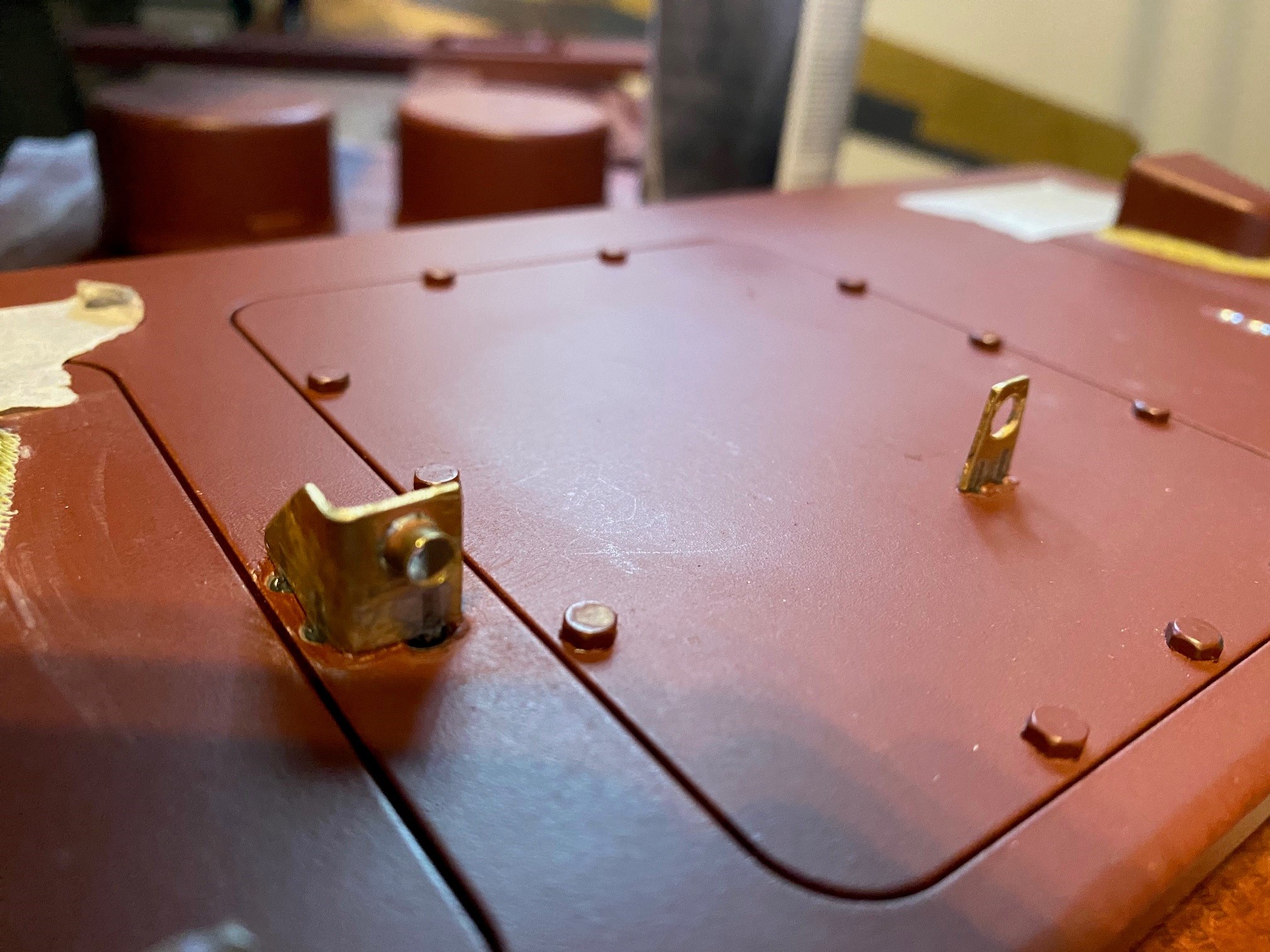

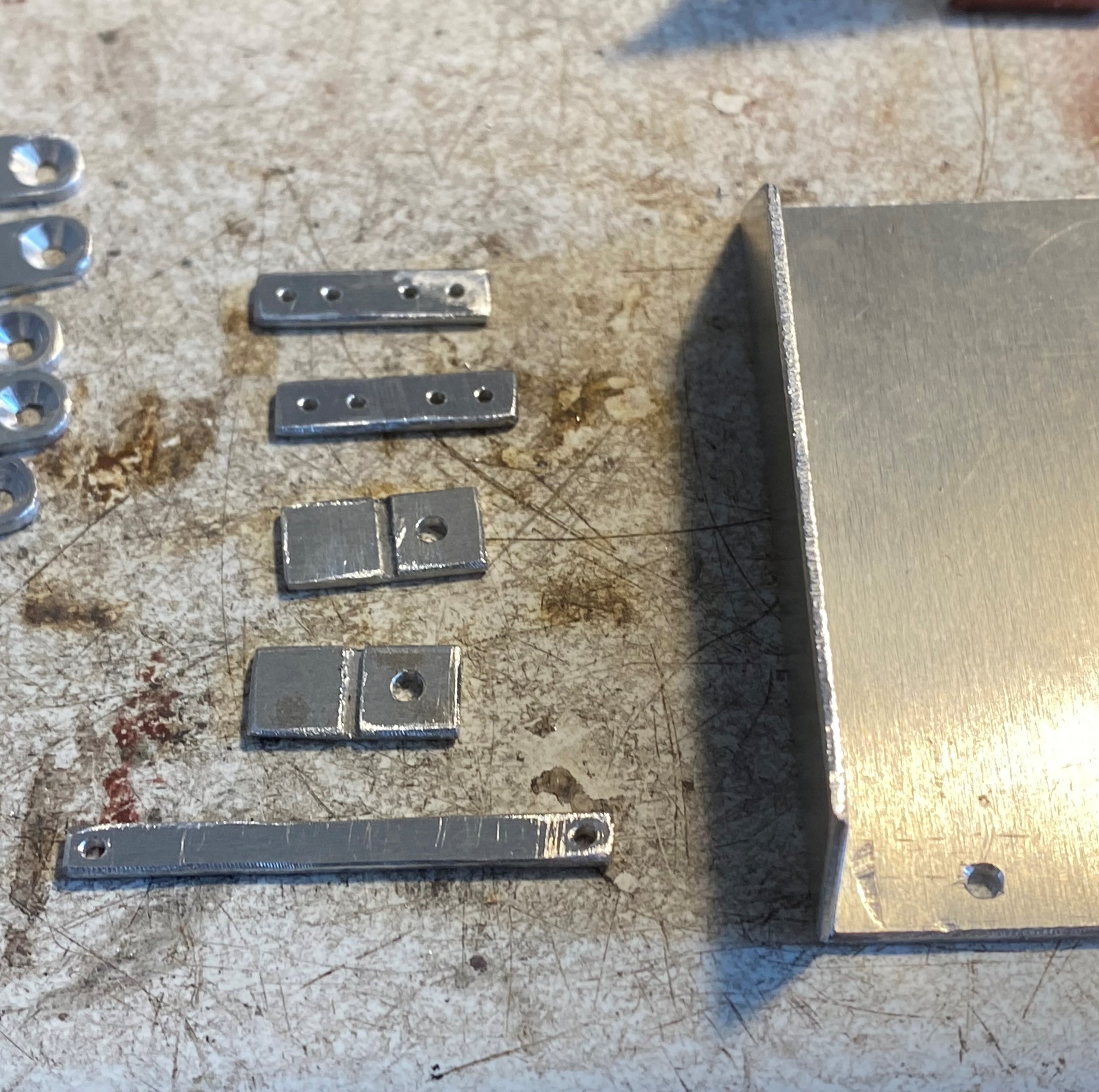

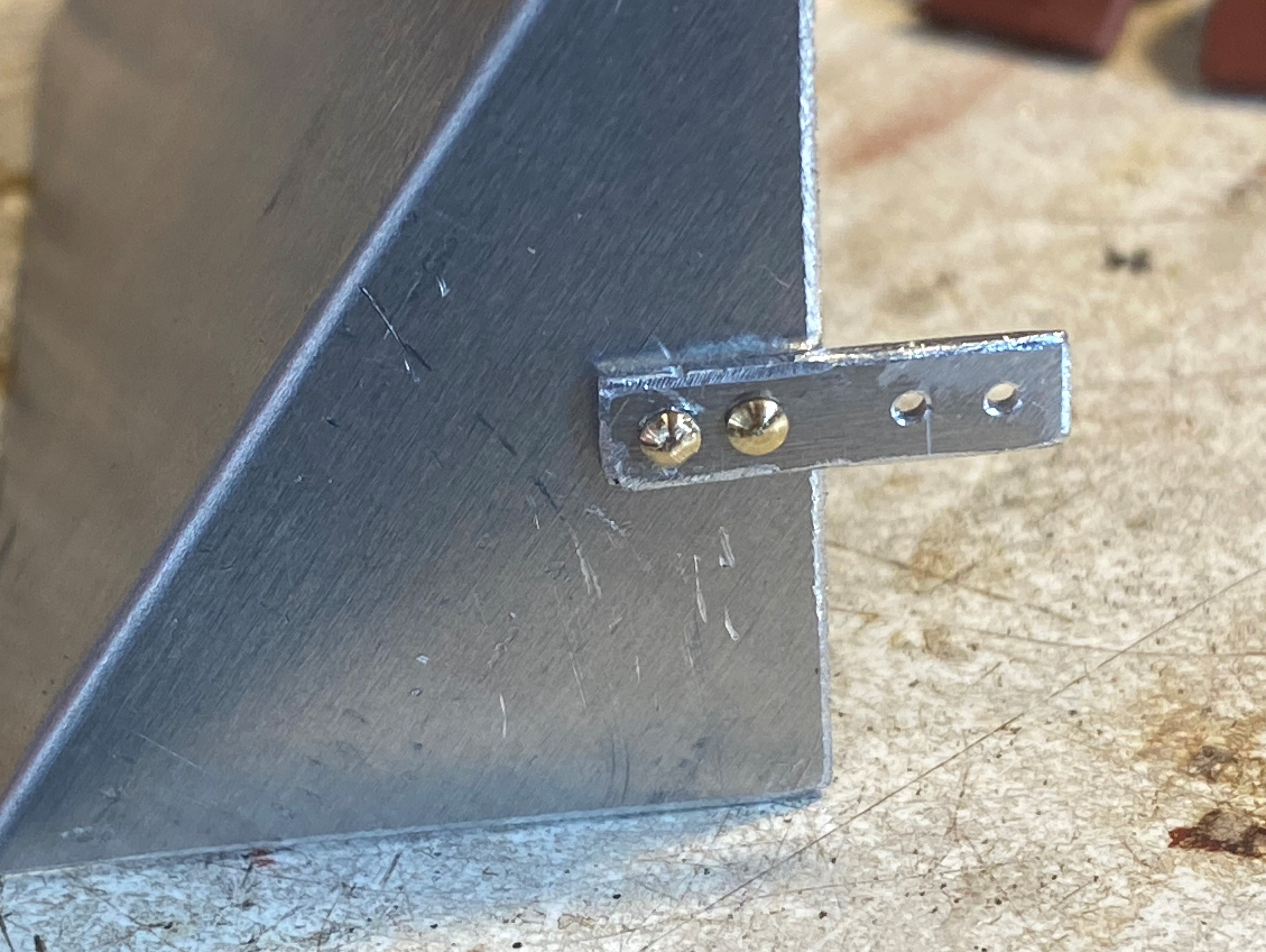

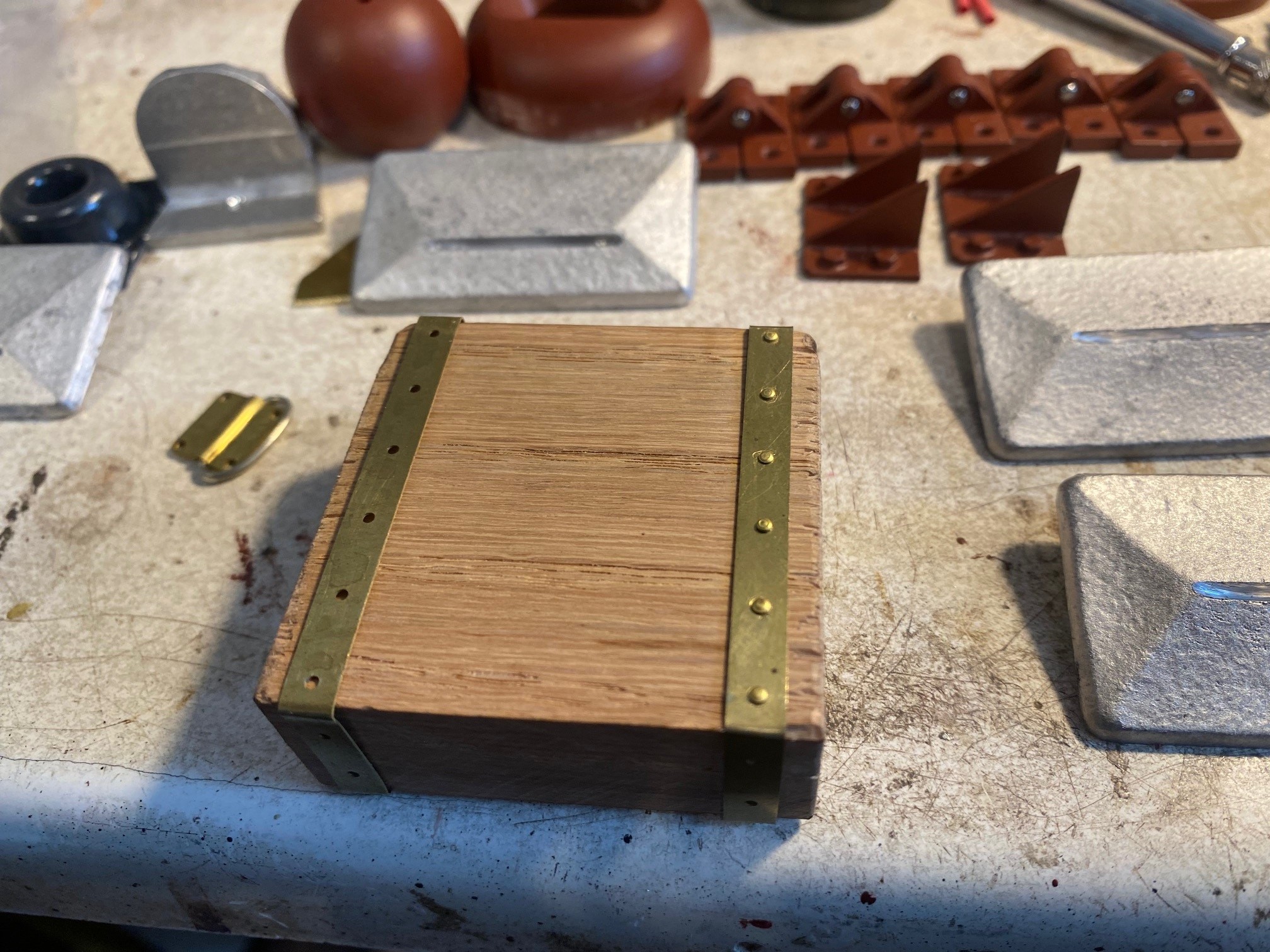

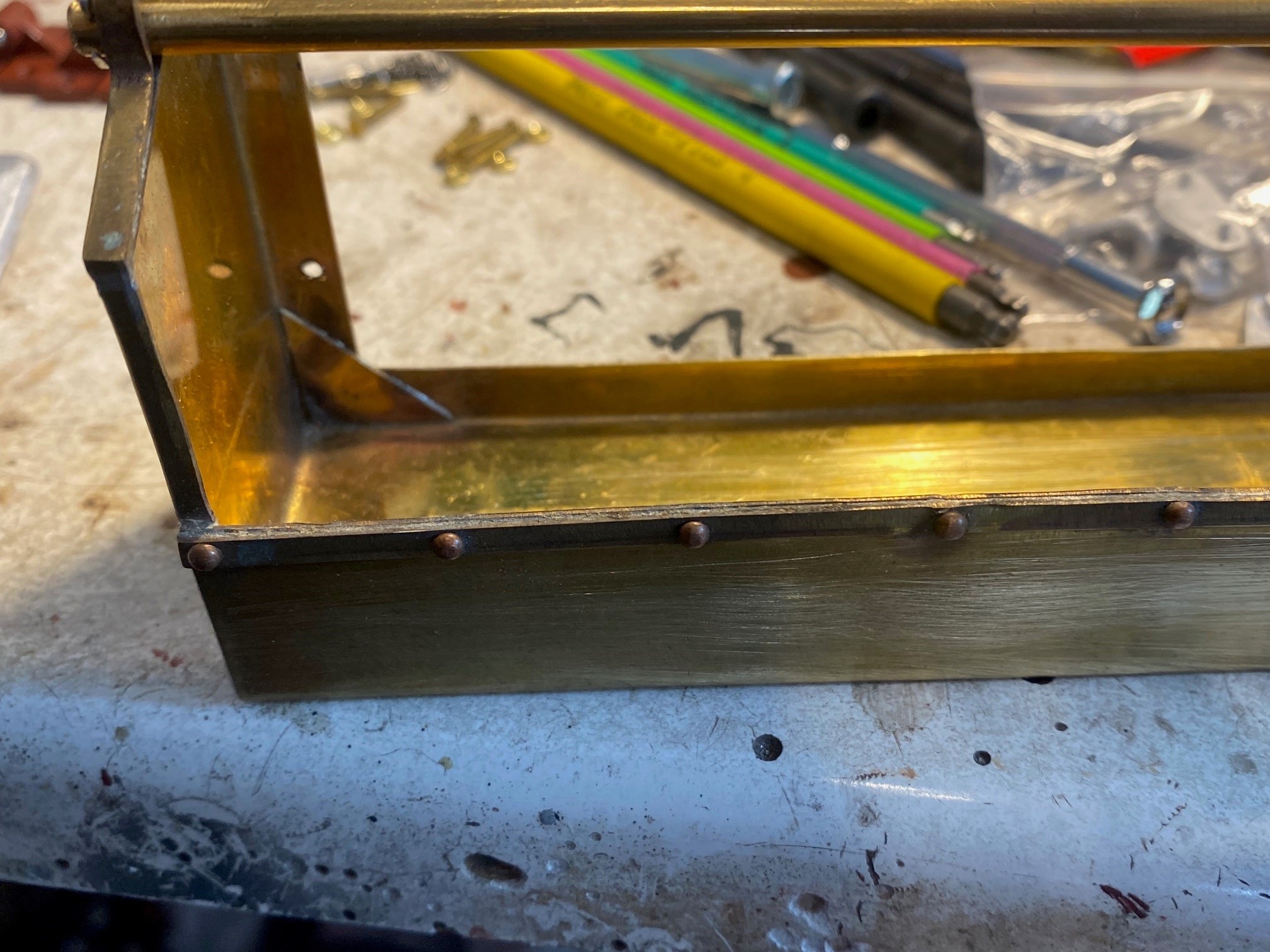

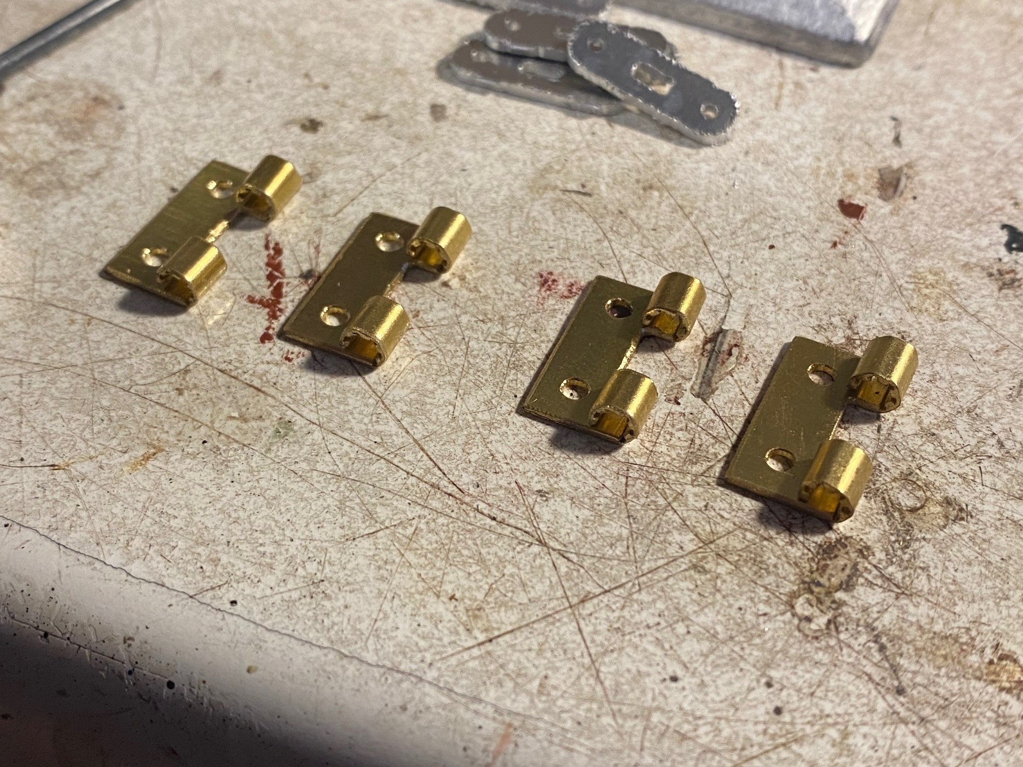

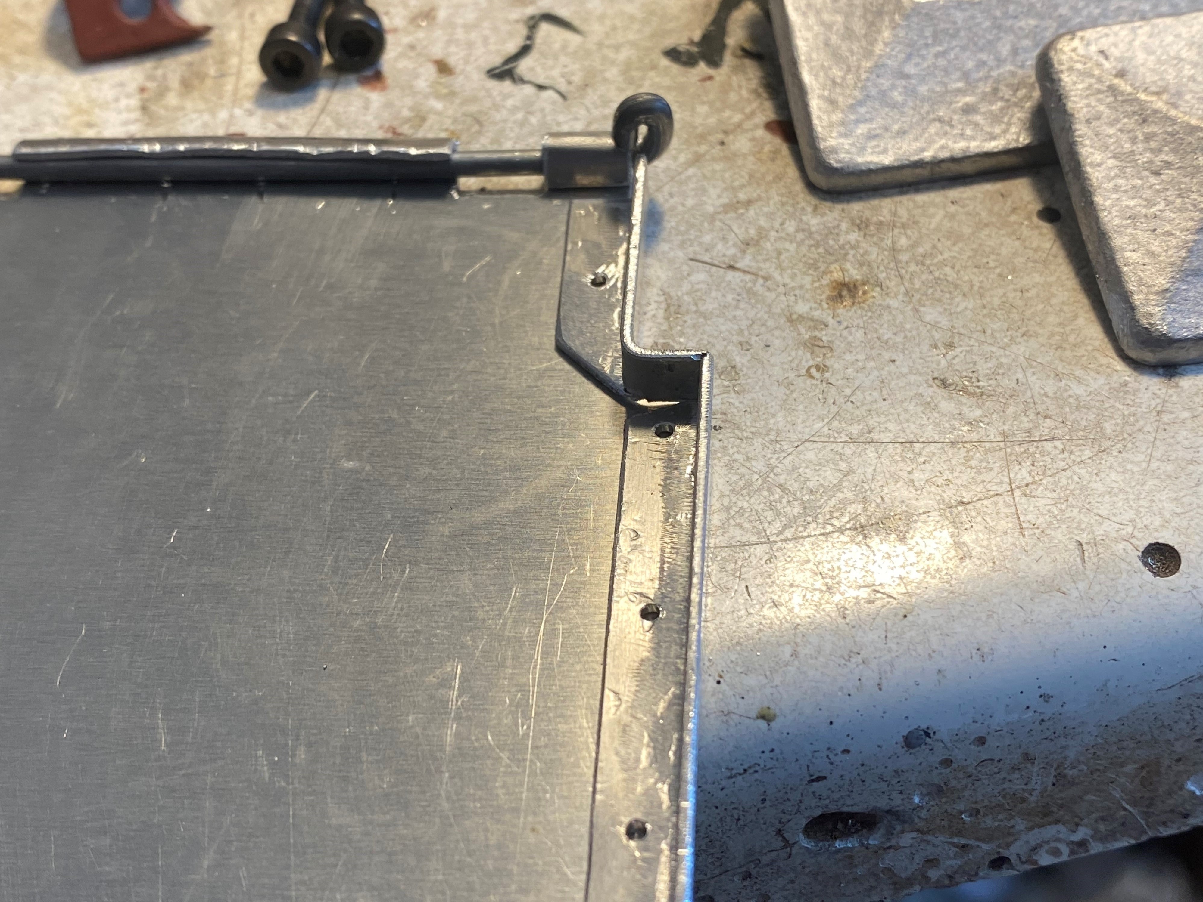

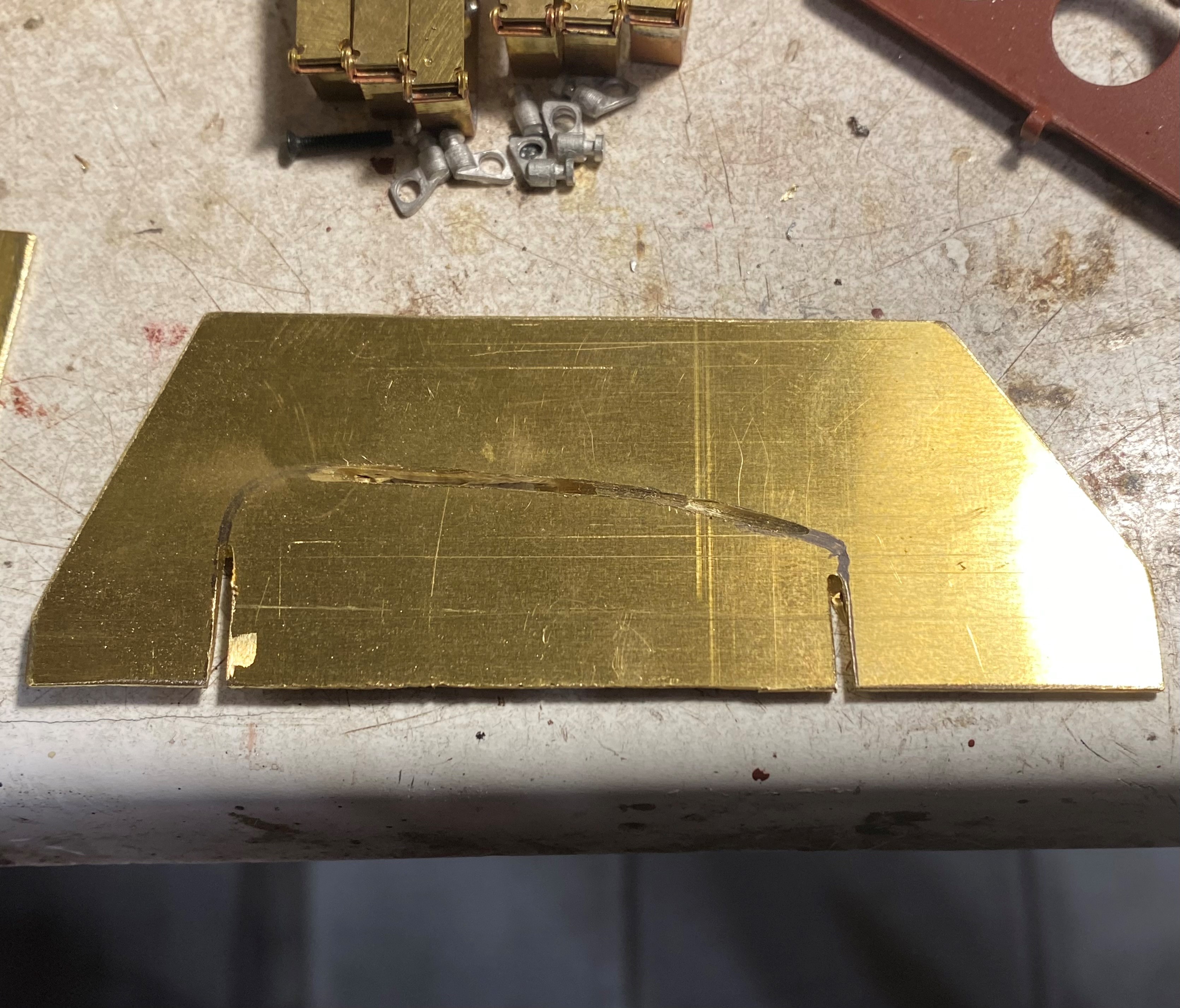

Now the hinges are soldered and the box of one of the rear cover is modified. The weldings has to come soon.
Regards Martin

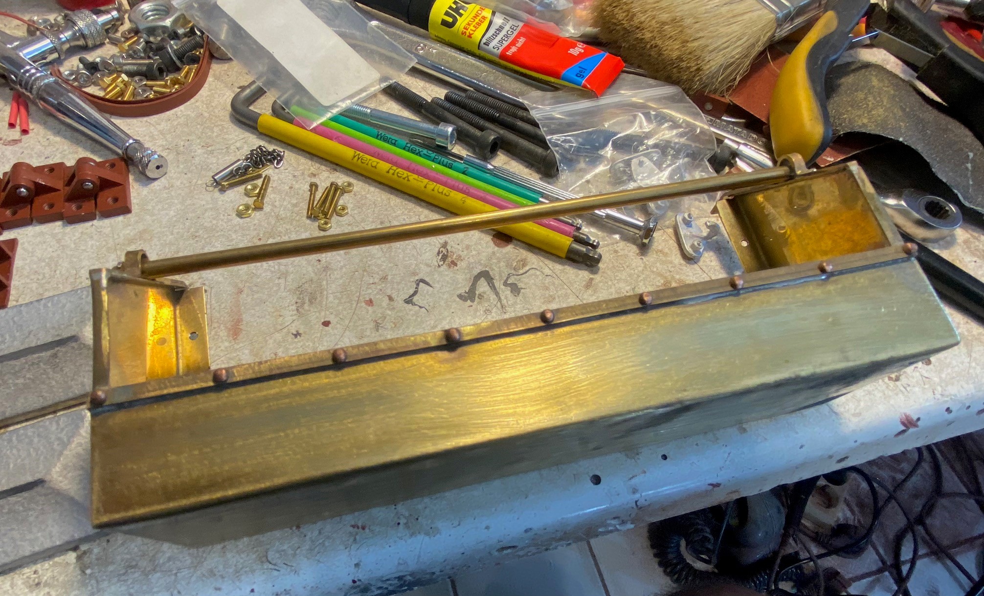

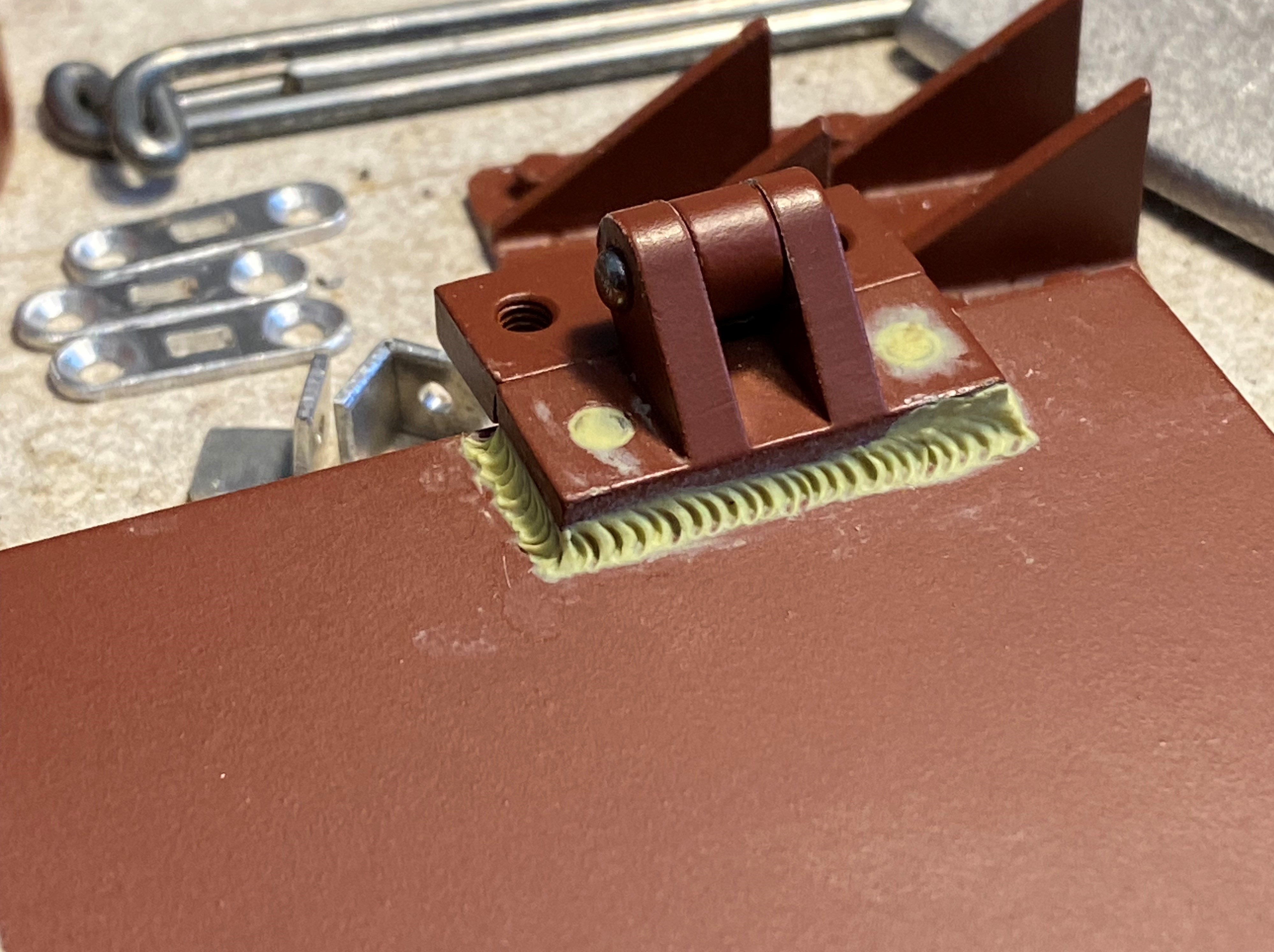

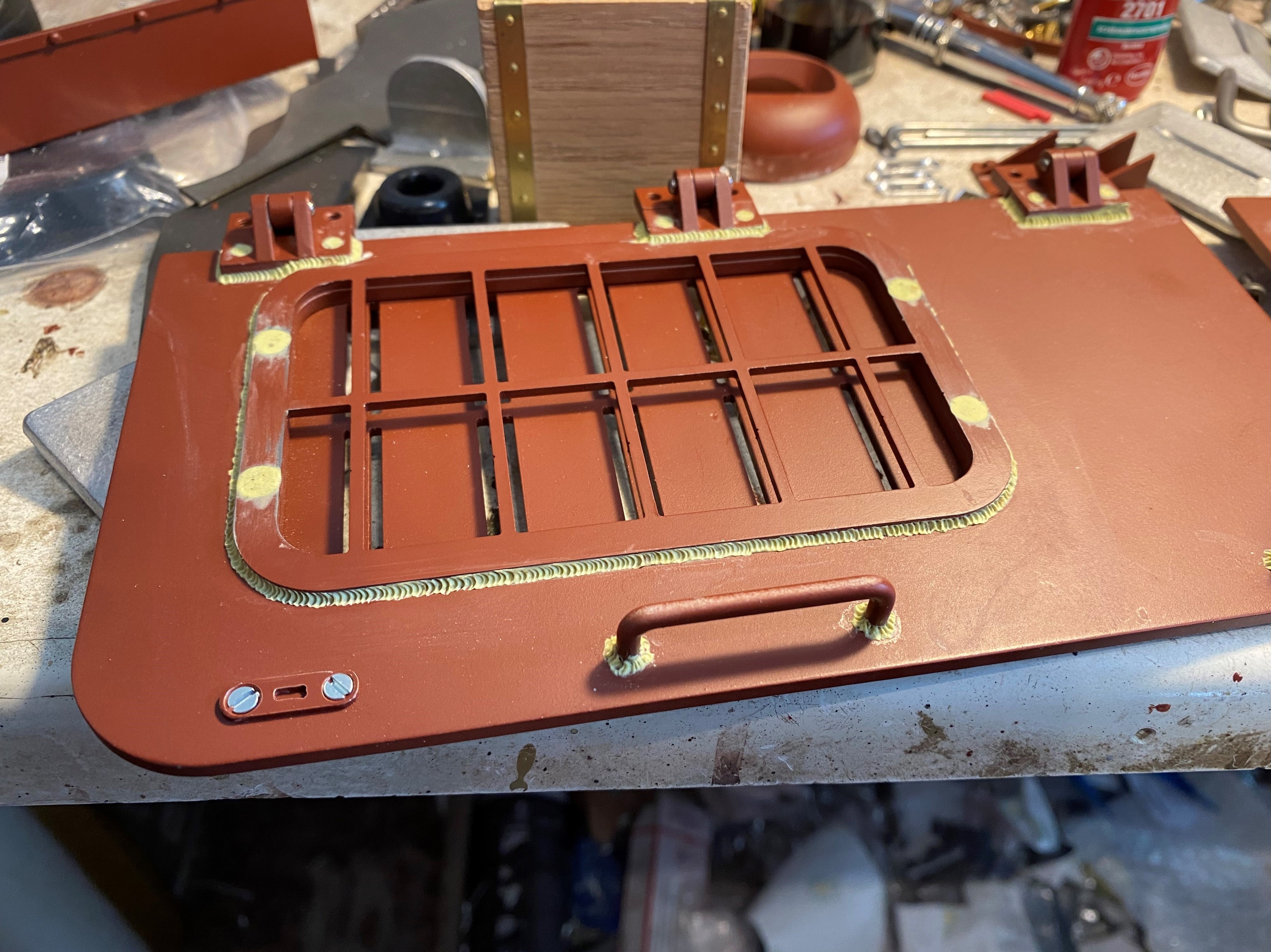

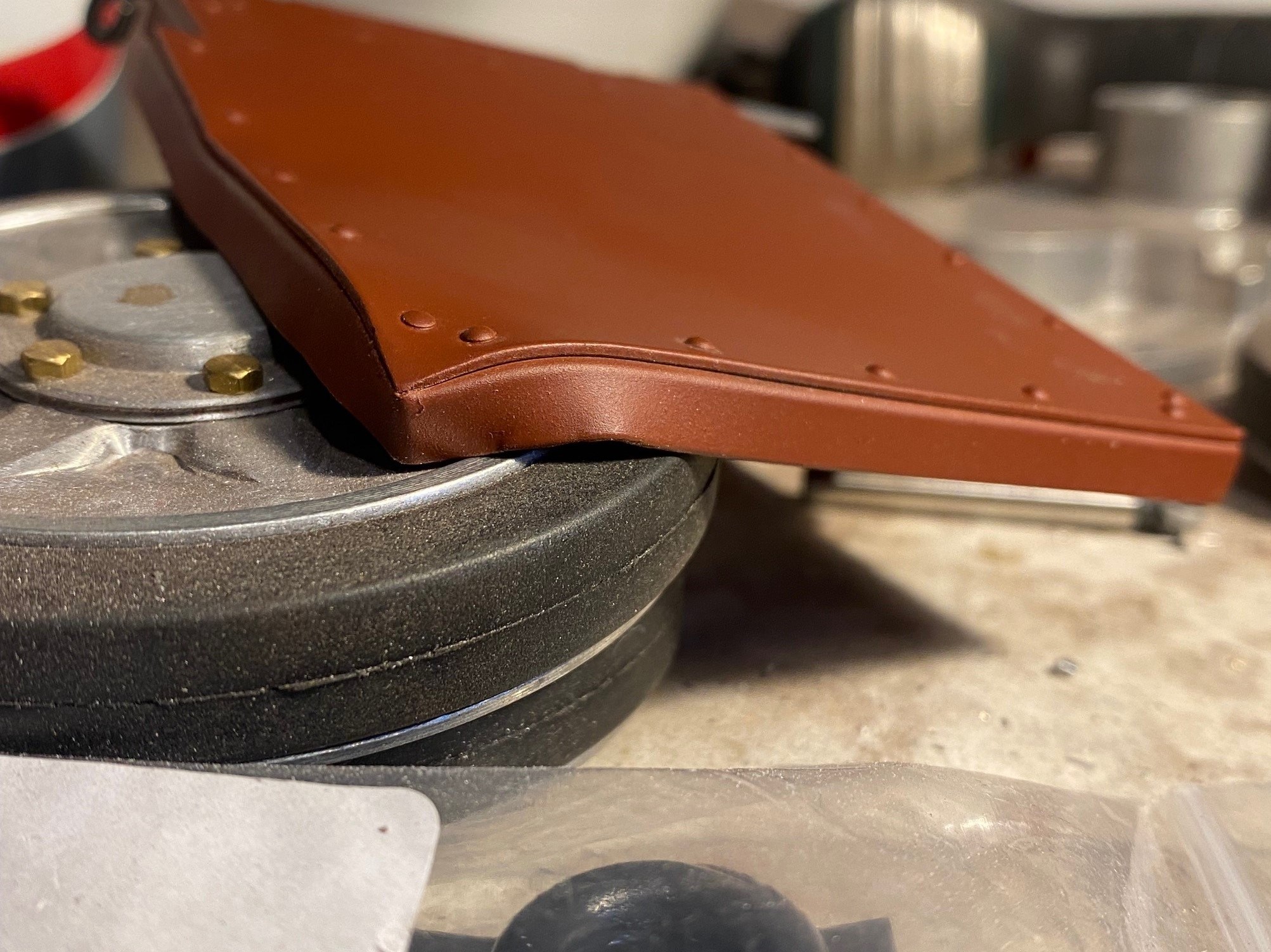

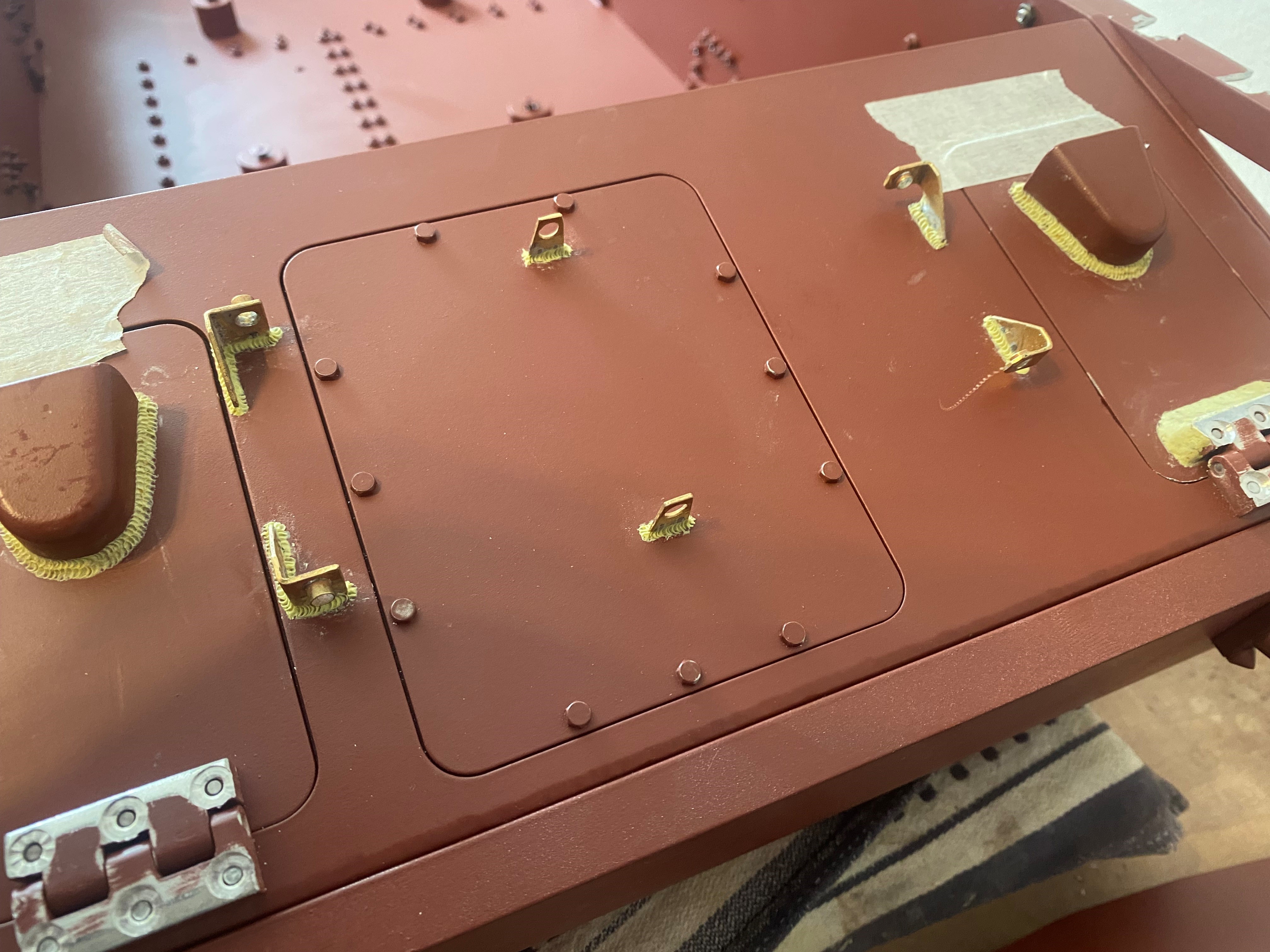

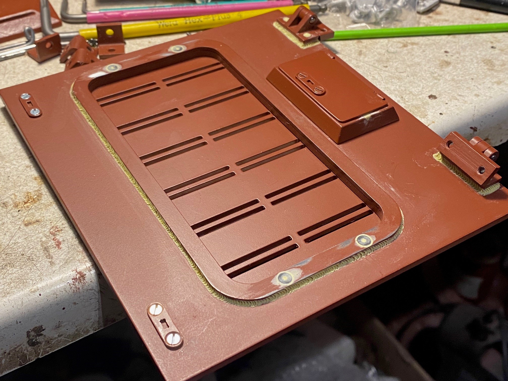

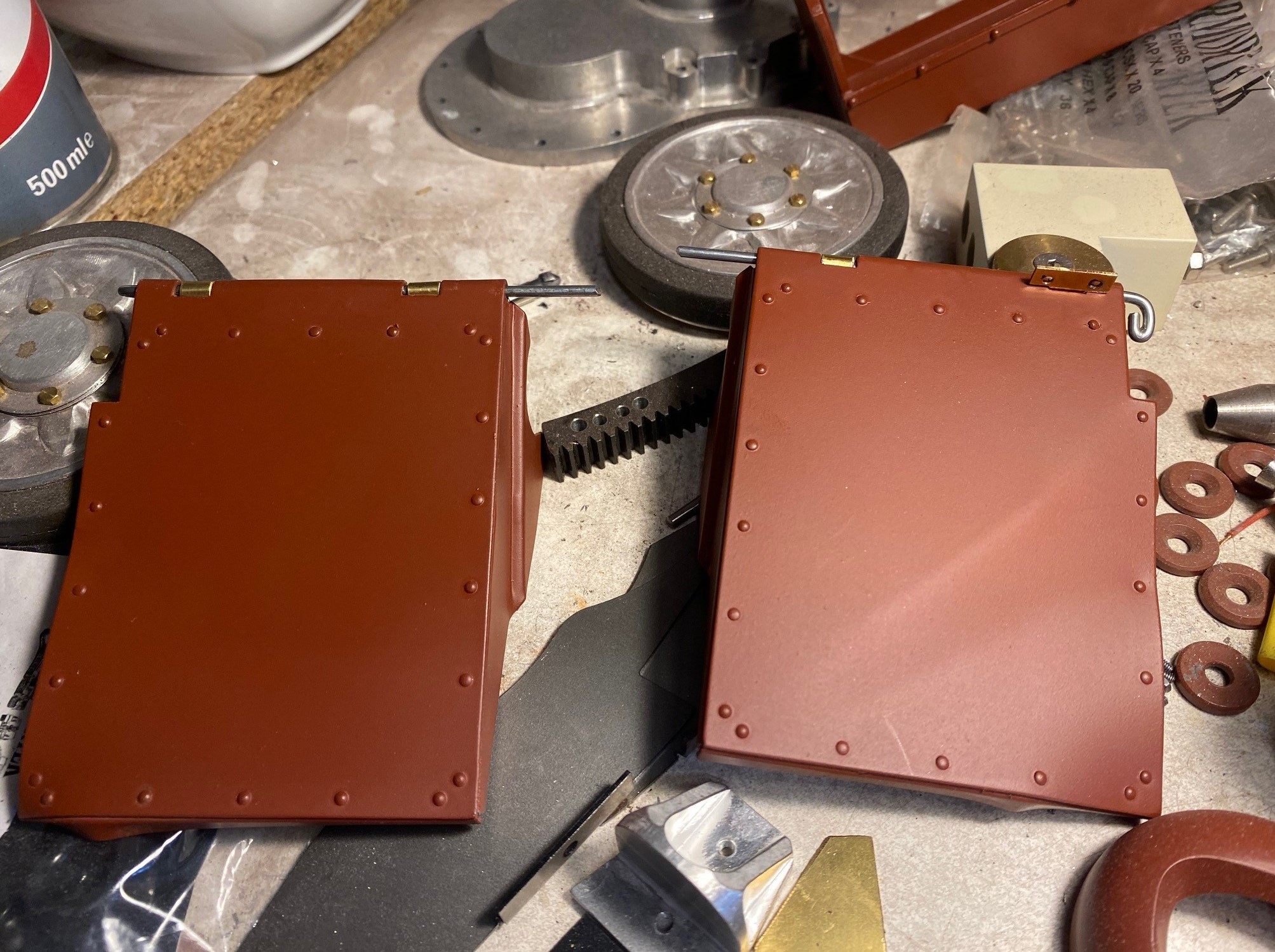

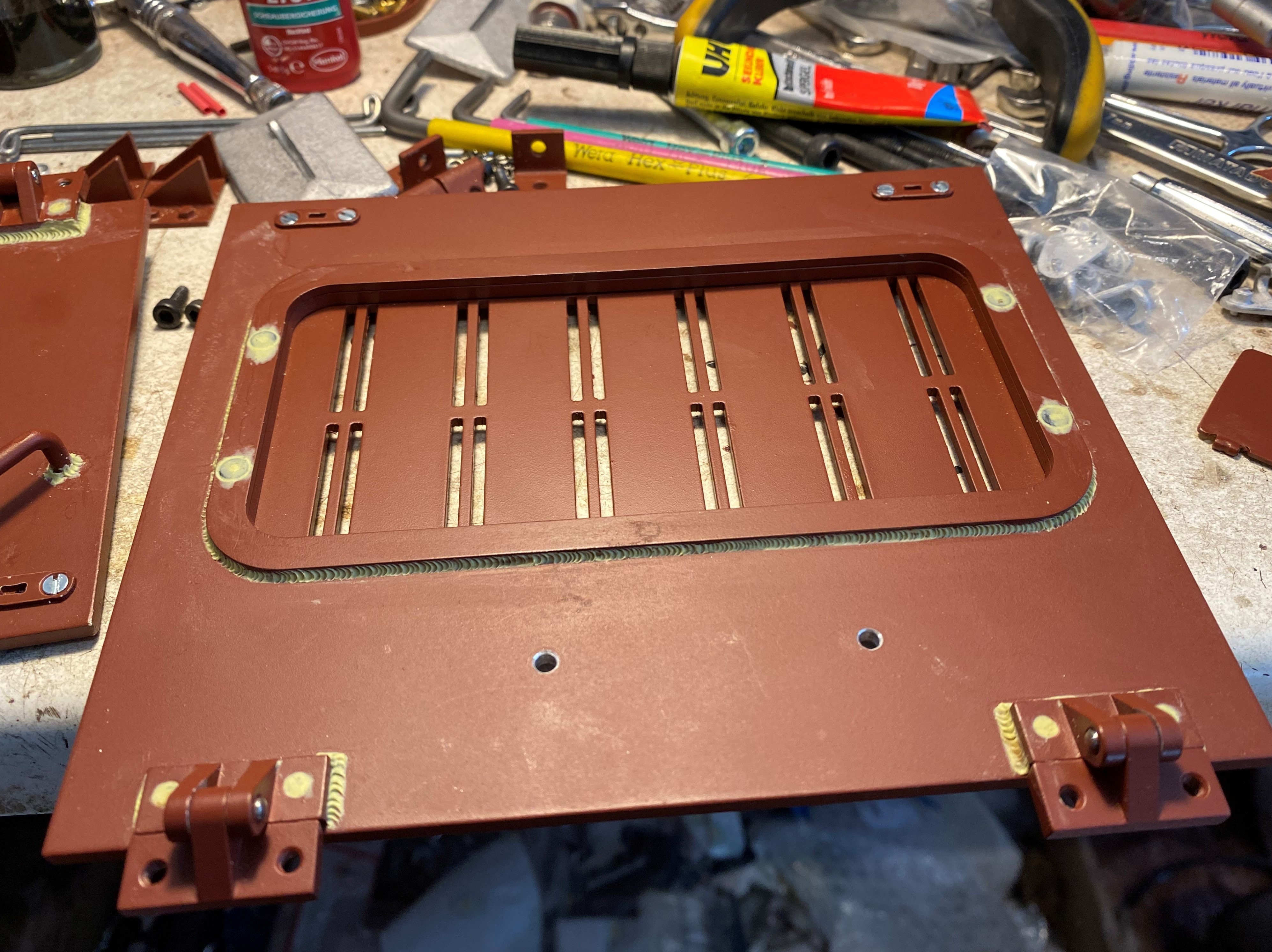

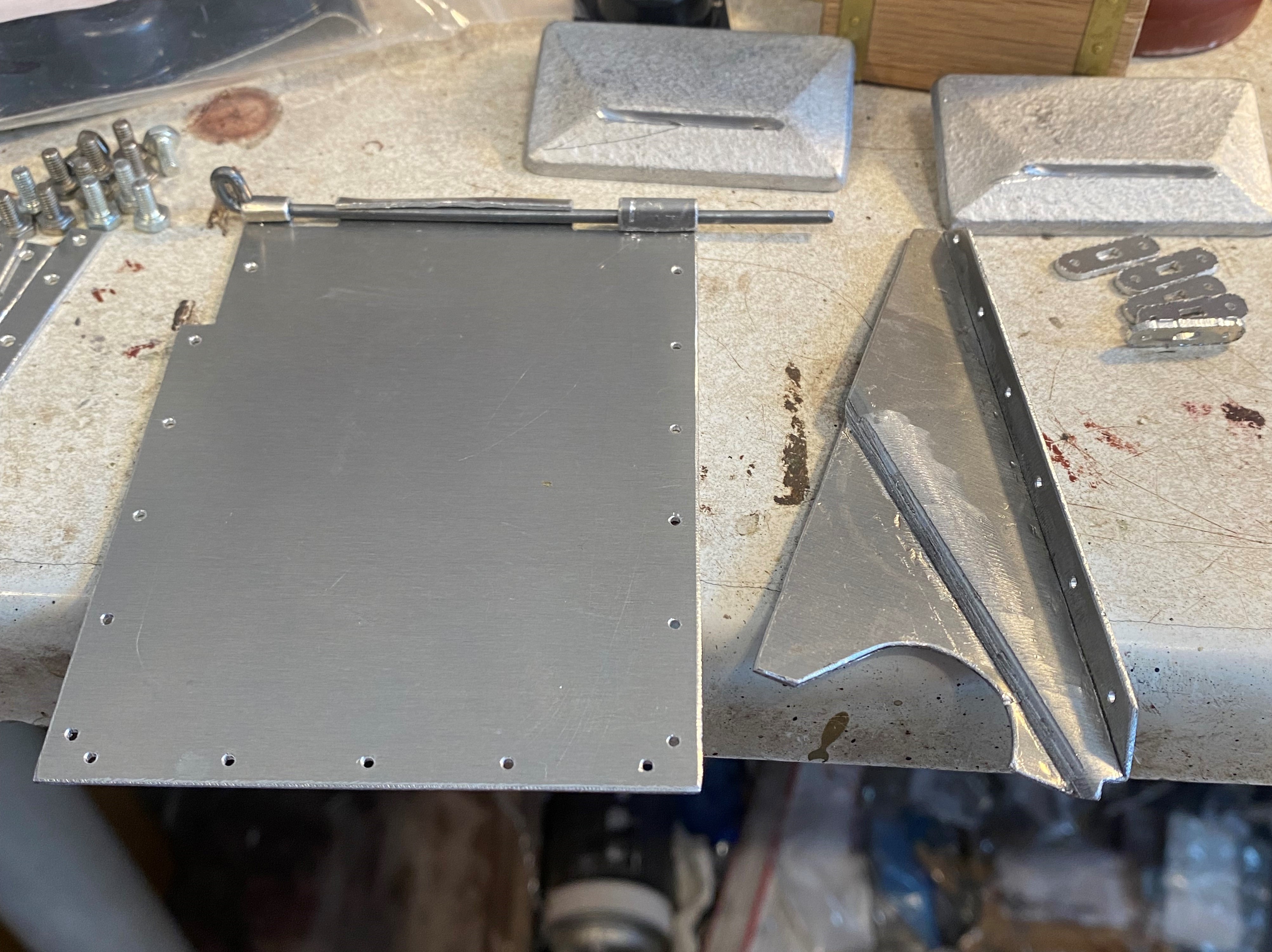

All welding seams are done onto the covers for the motor room.
In the mean time the mud guards got some dents and after this i etch primed and primed all the parts.
Regards Martin

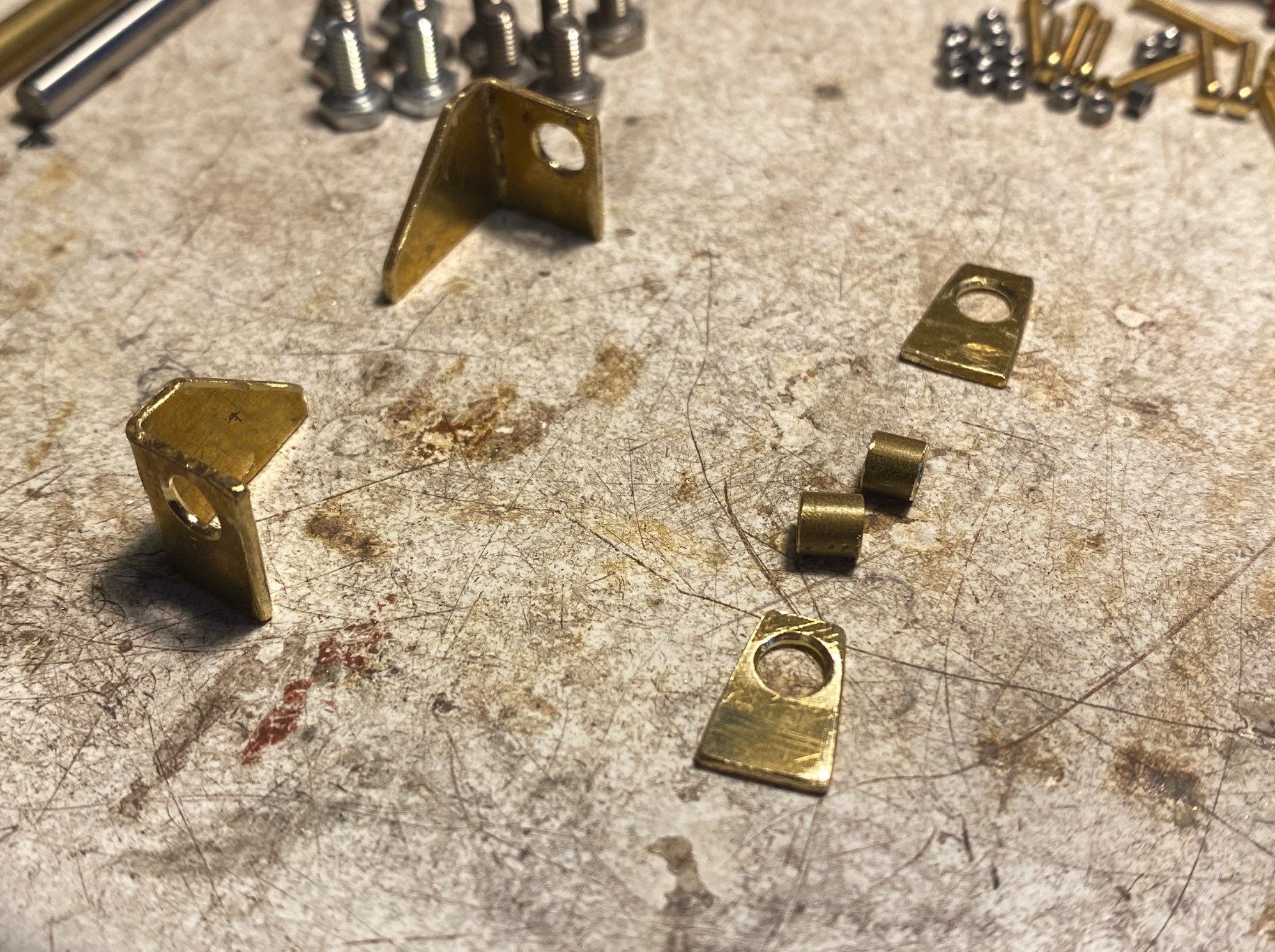

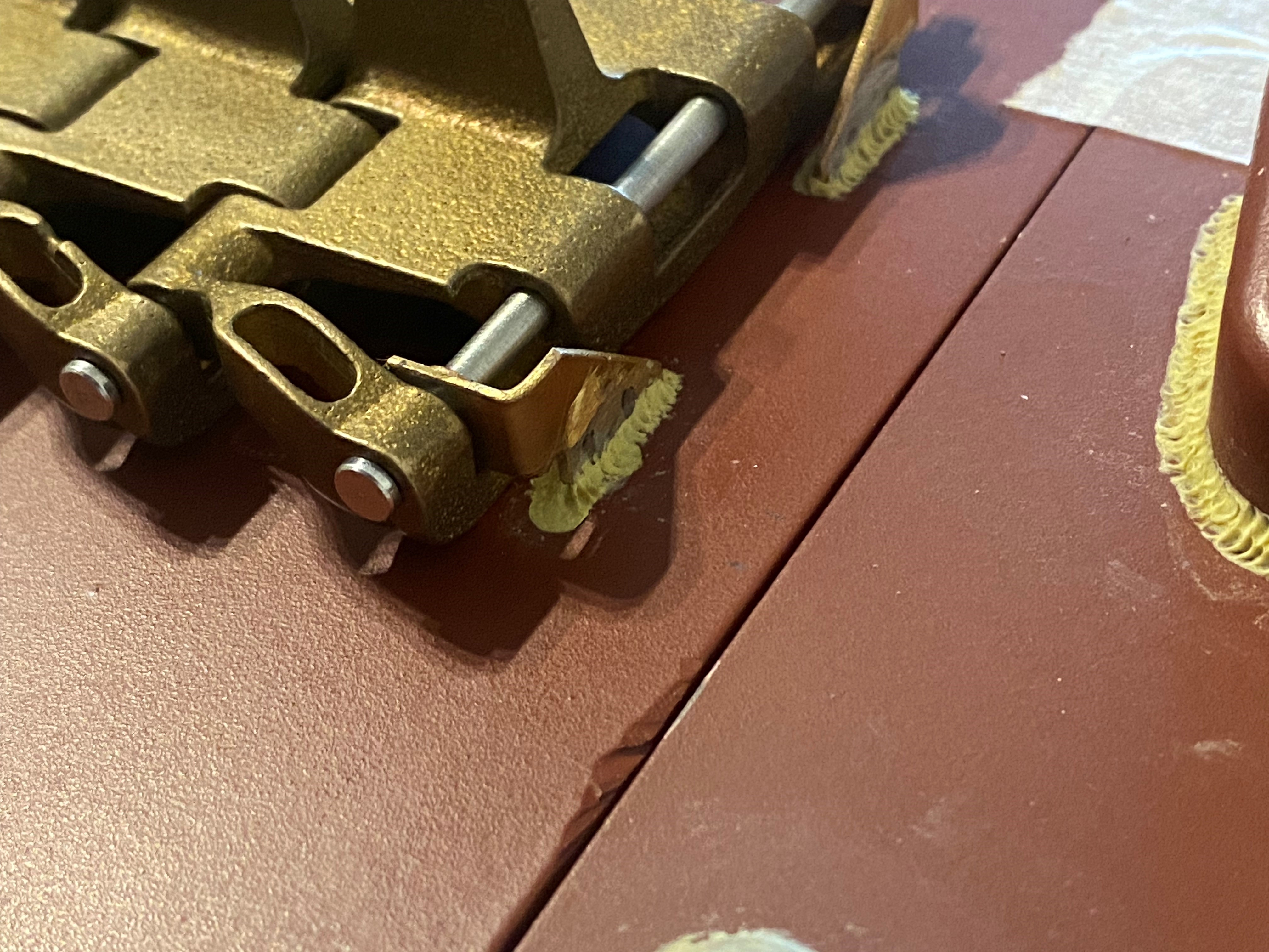

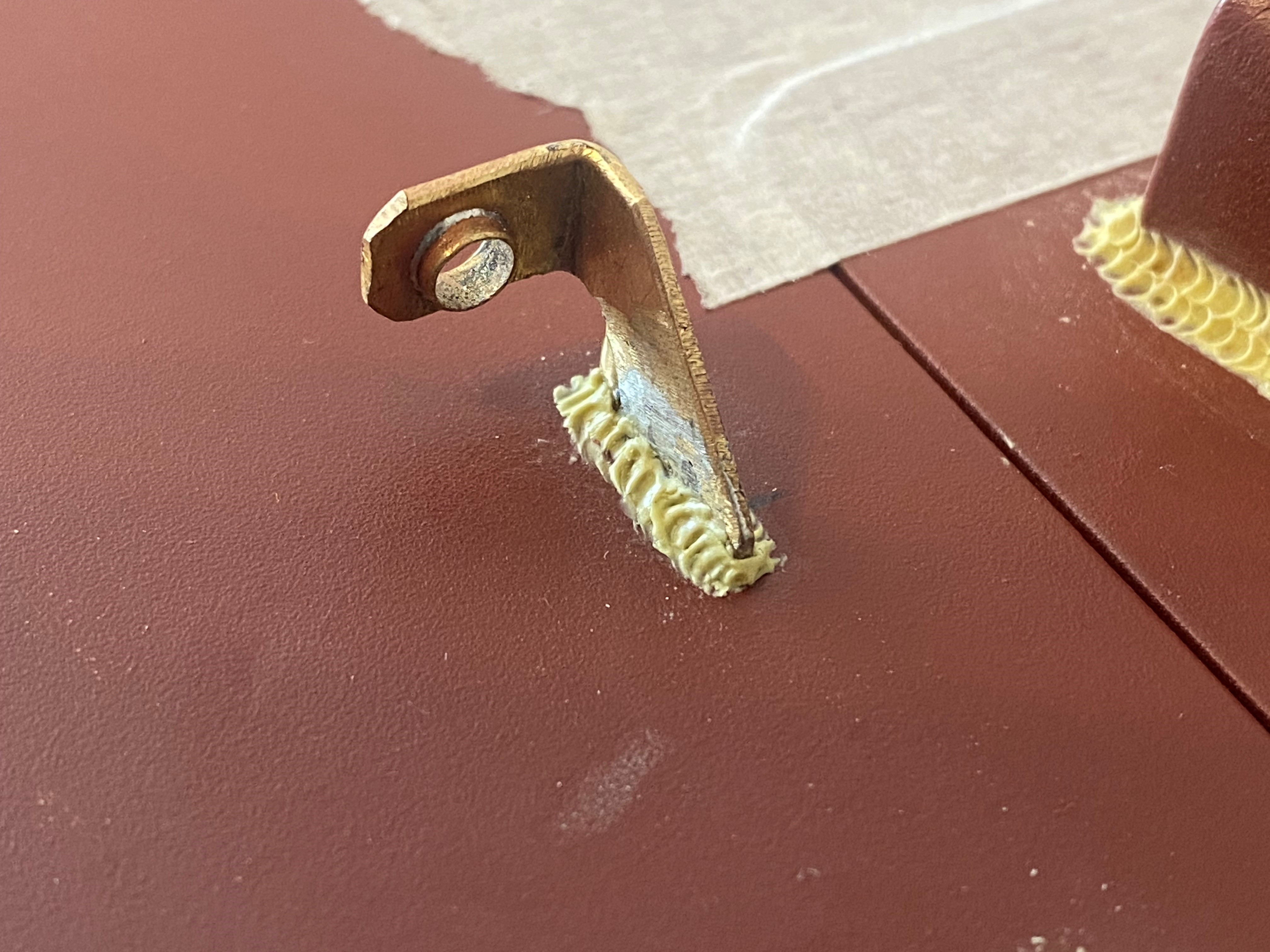

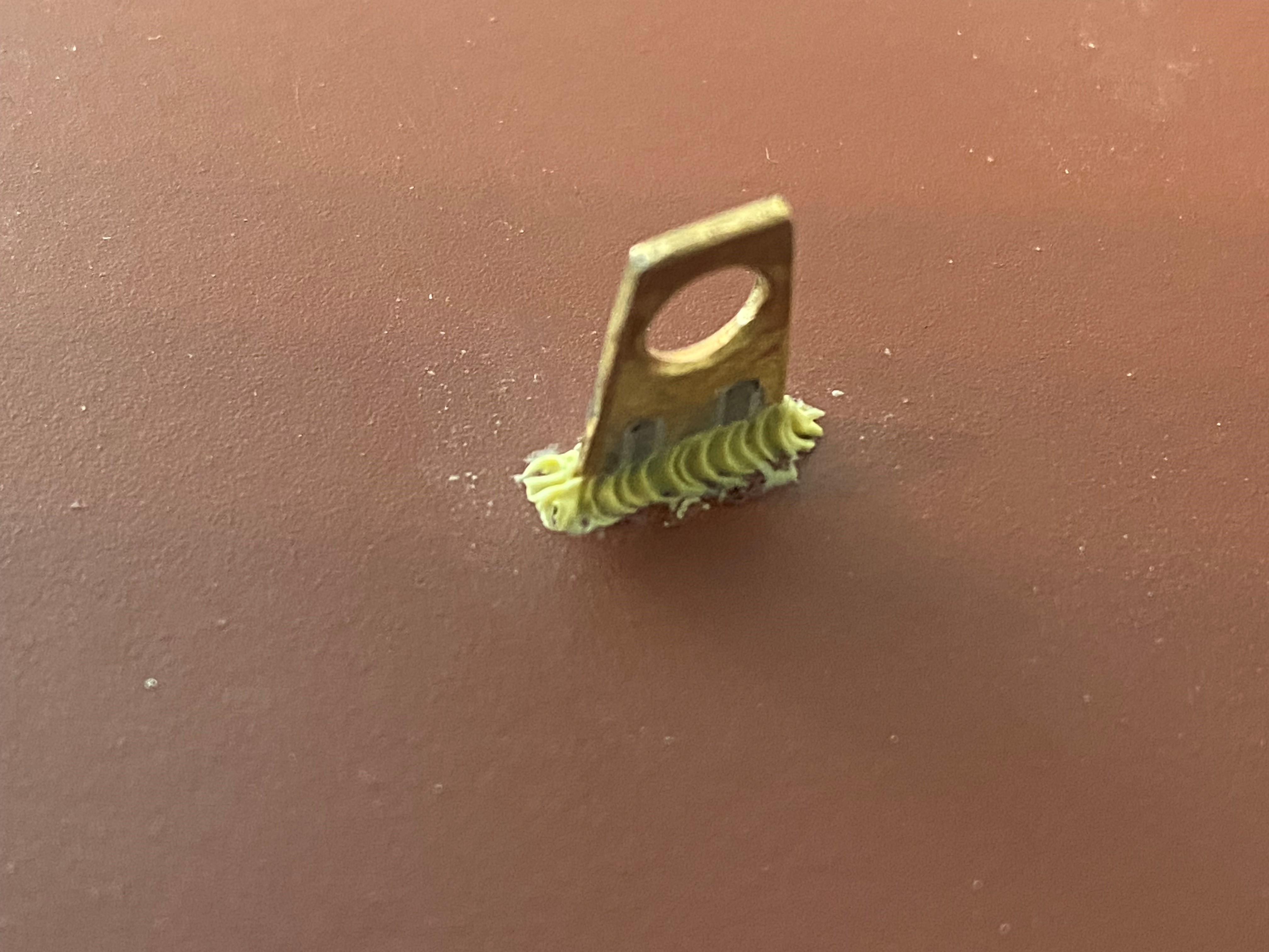

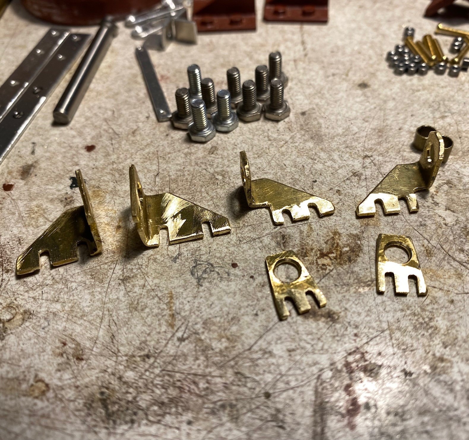

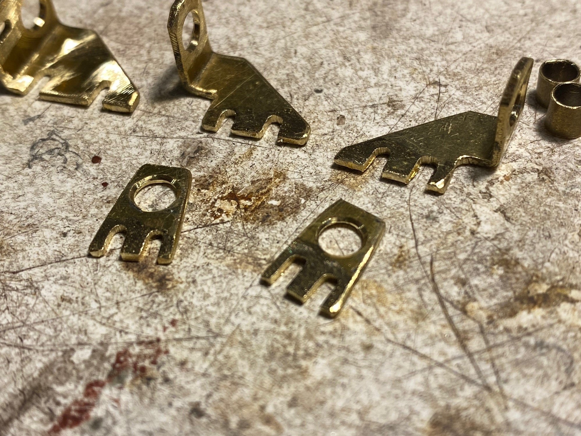

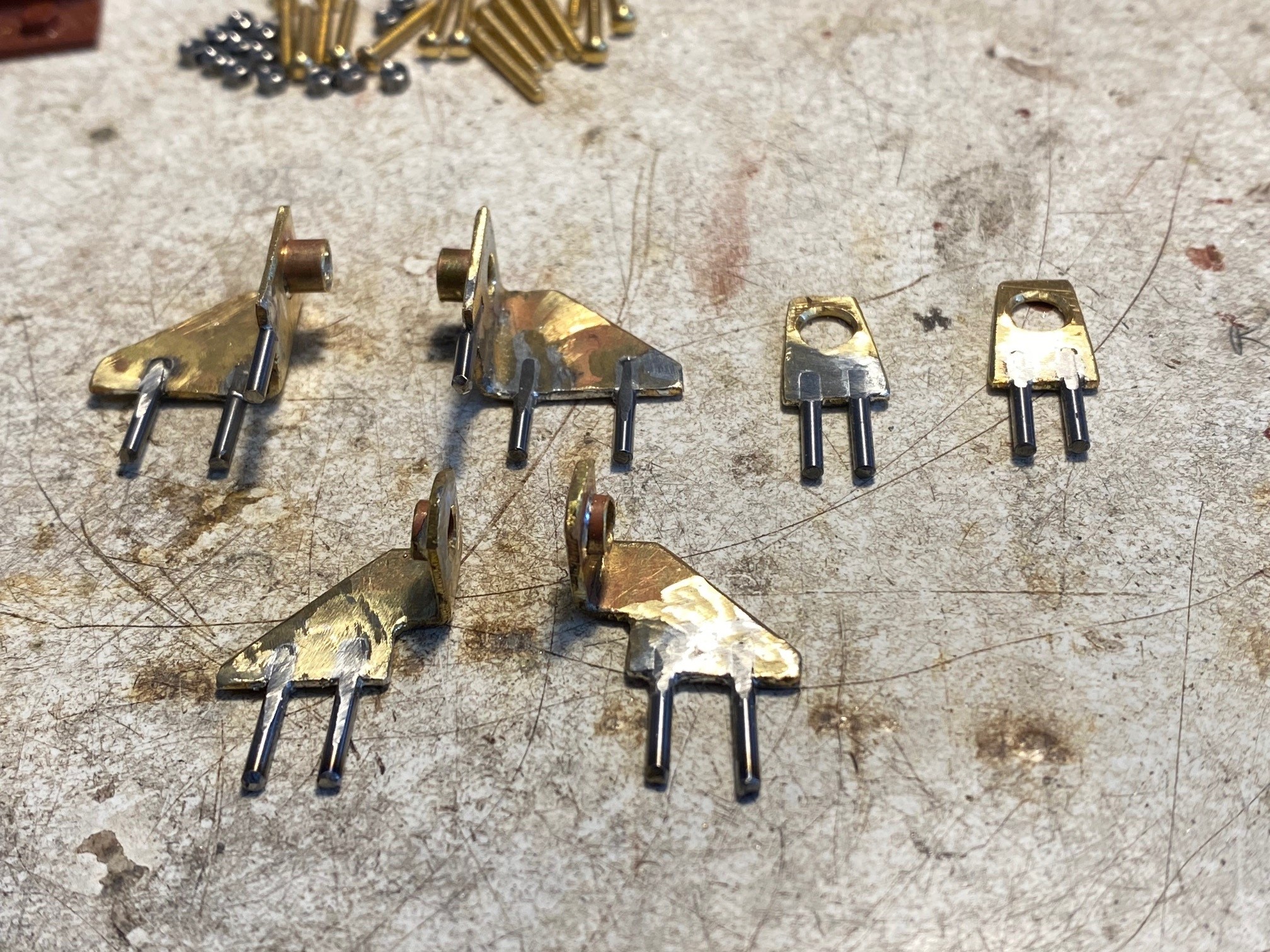

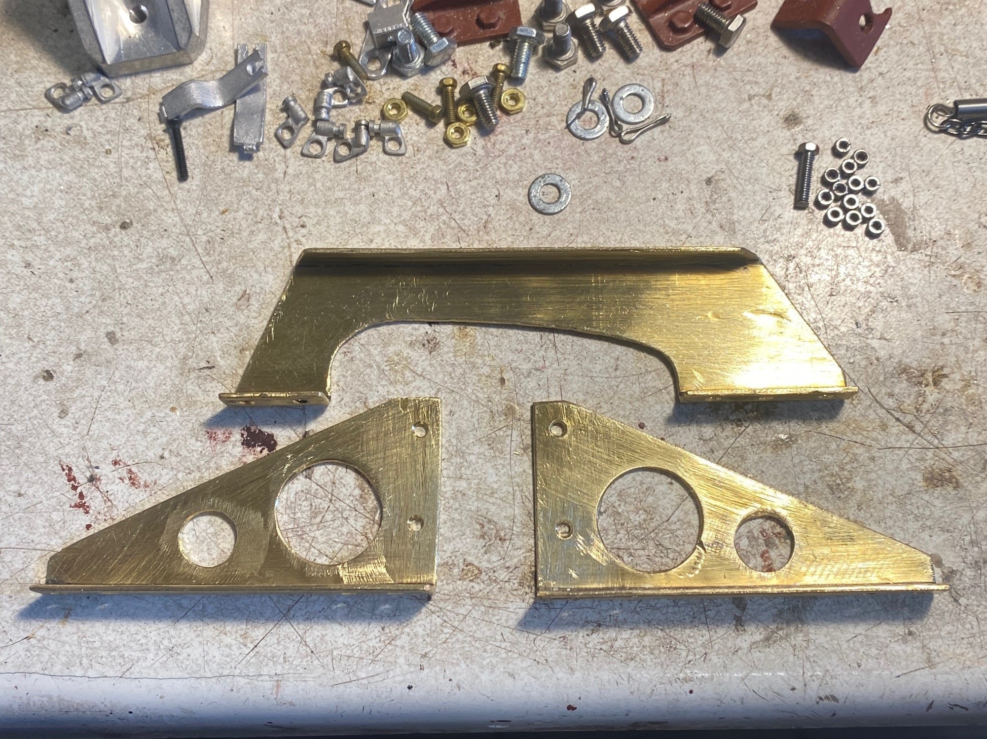

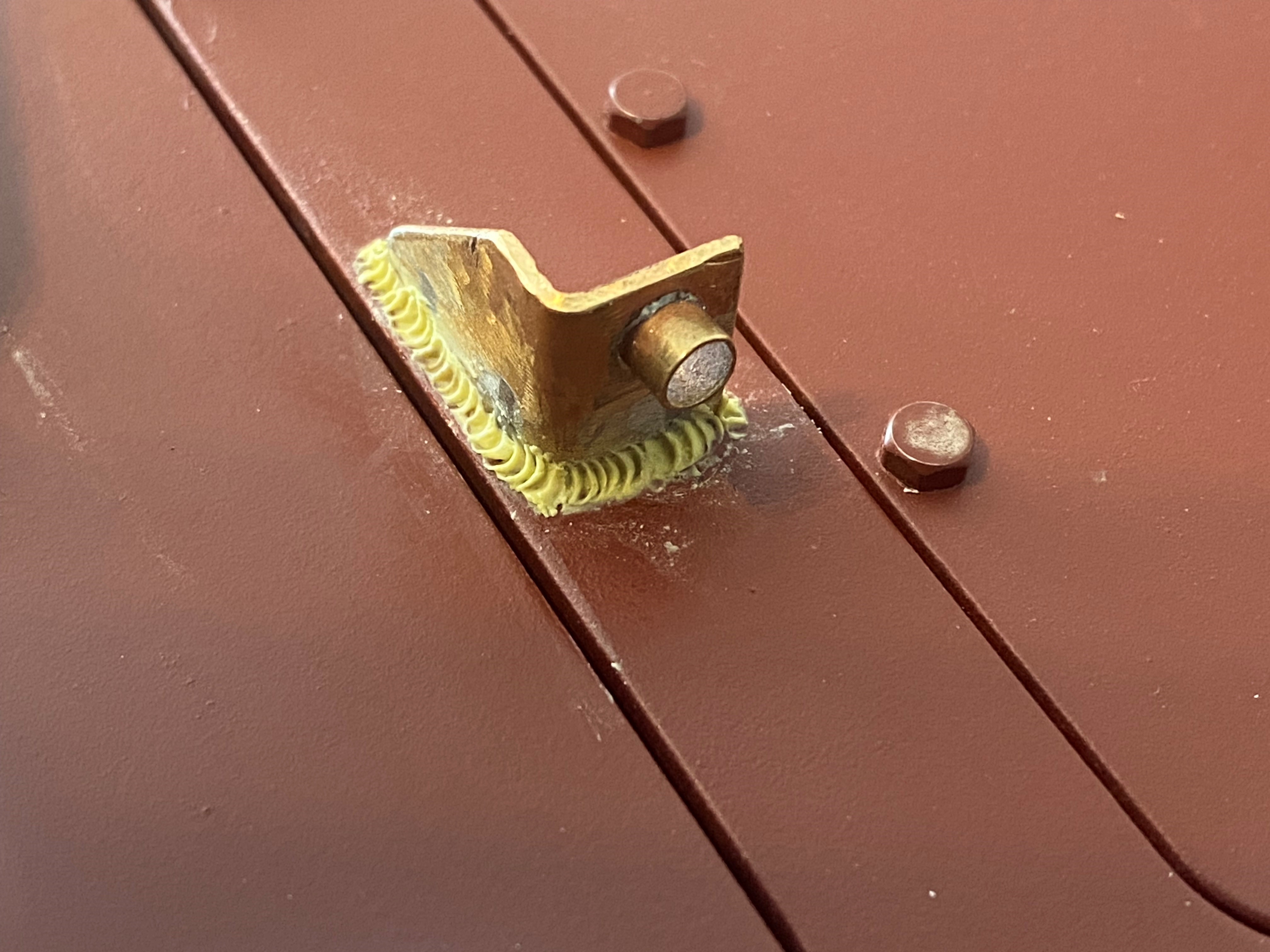

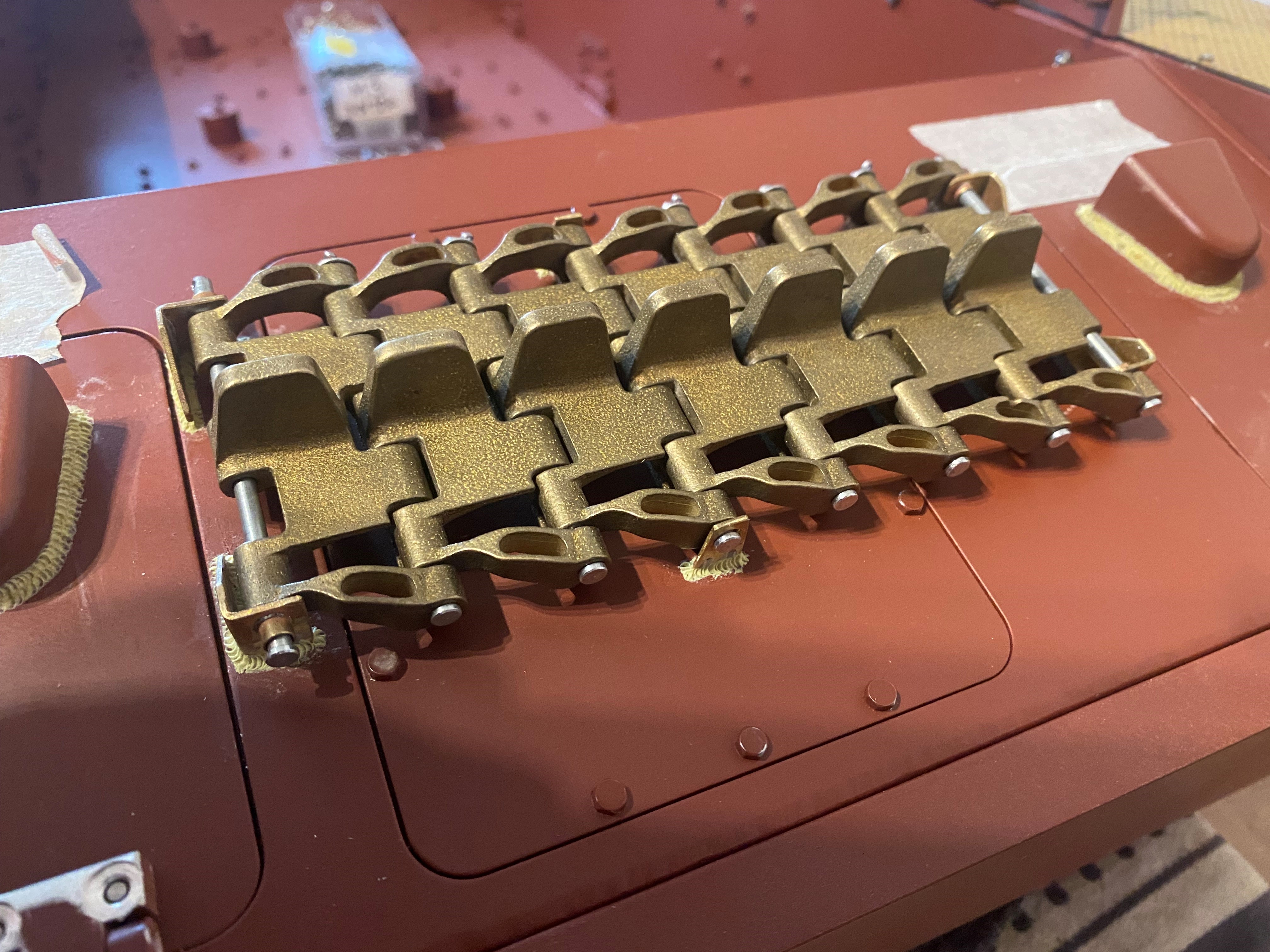

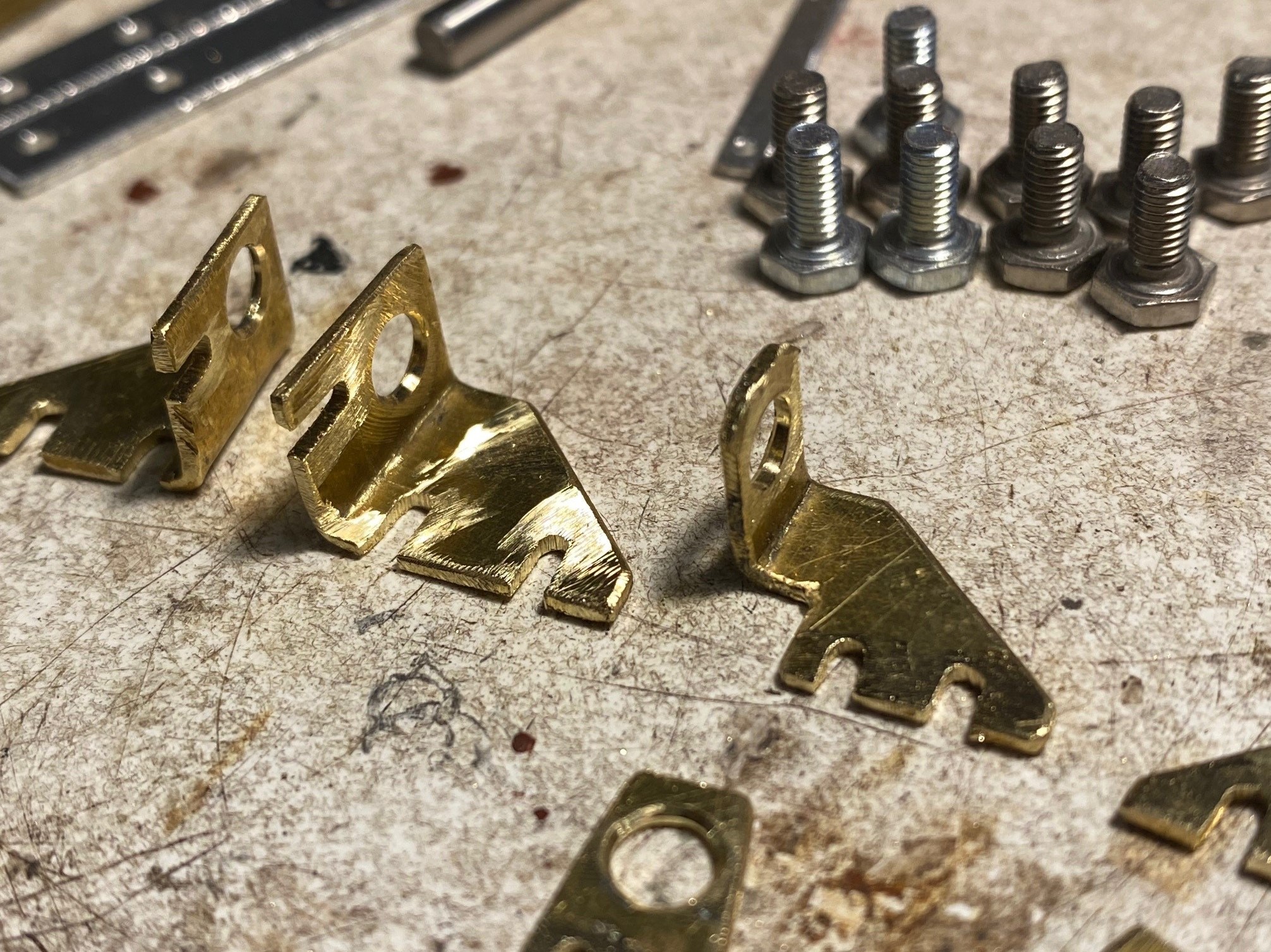

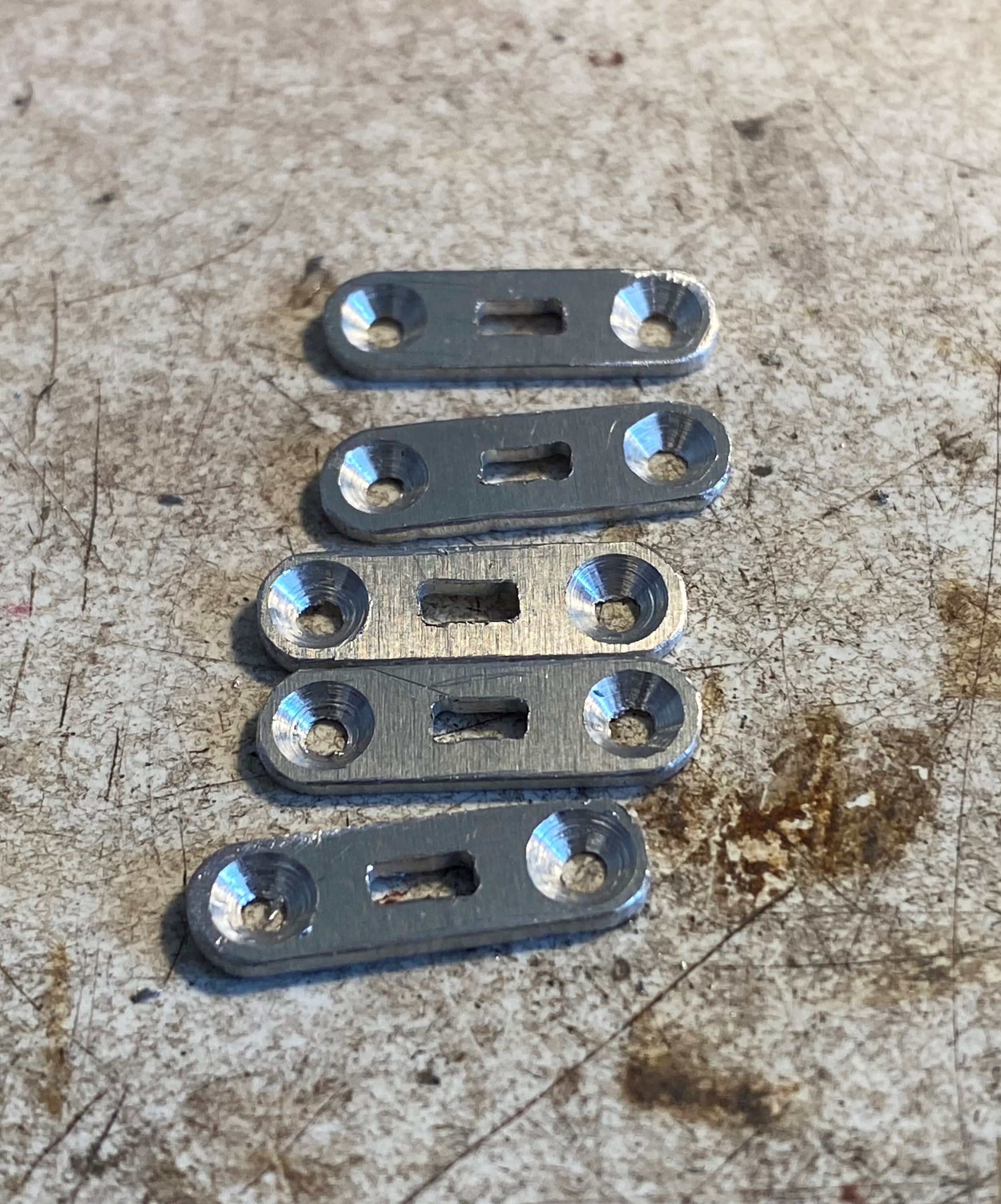

Here i made some holders for the tracks on the front plate. For more strength and better hold i soldered pins into slots of the holders and glued them into holes.
Regards Martin
Hallo Uwe,
vielen Dank für dein Kompliment.
Hi Uwe,
thank you for your nice words.

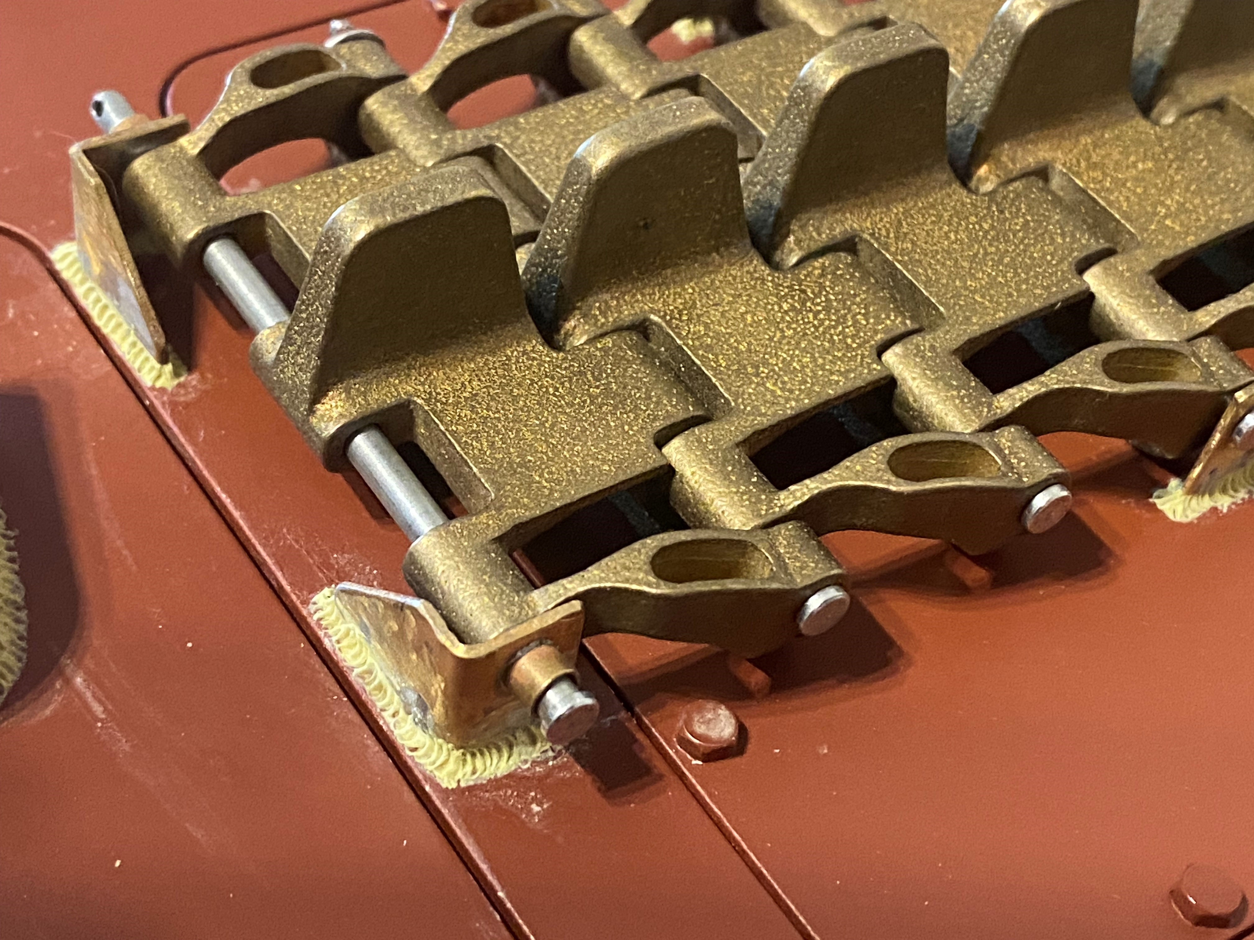

here are the holders after welding and with tracks on.
Regards Martin

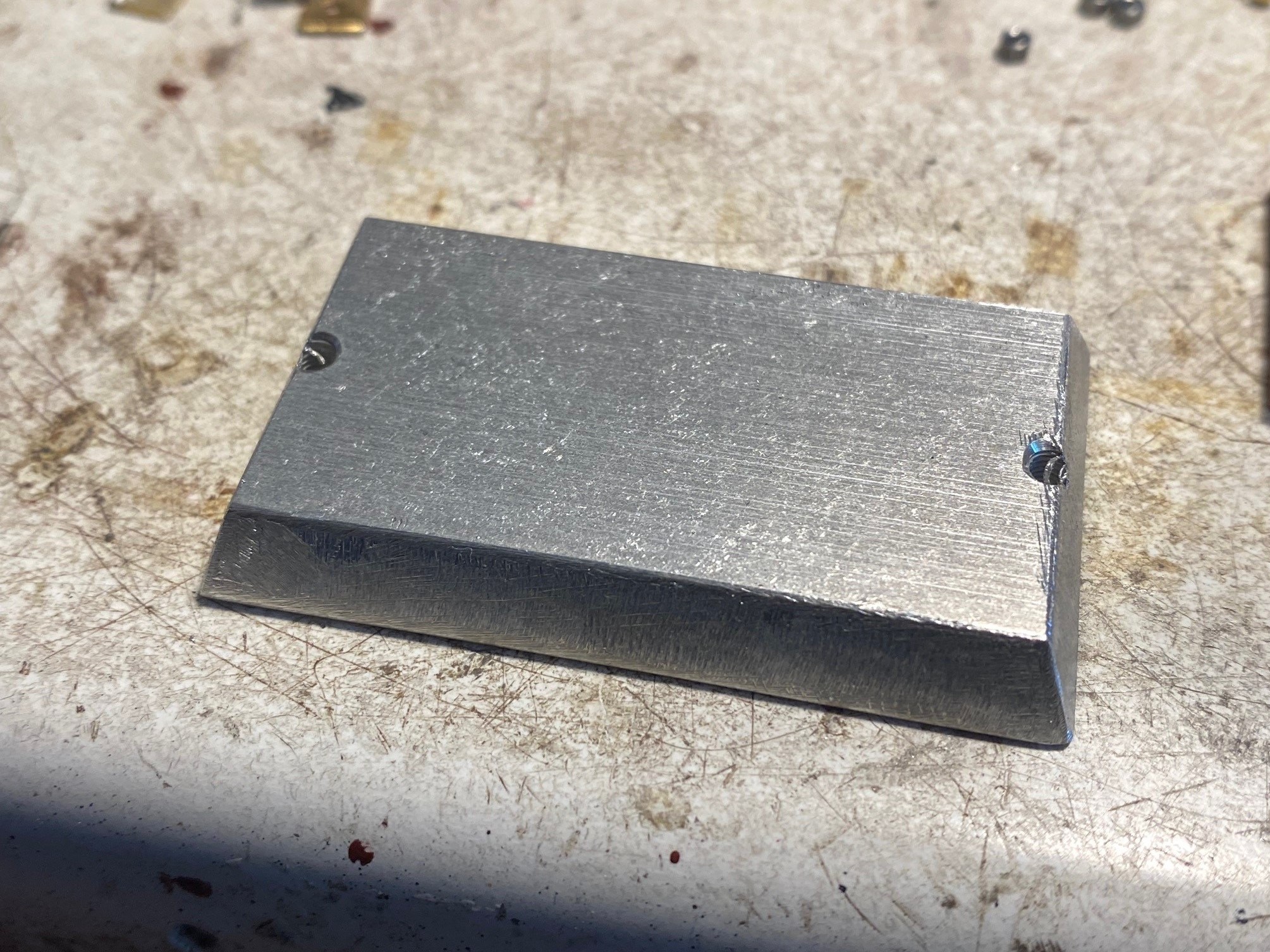

Re: Martin's Panzer IV

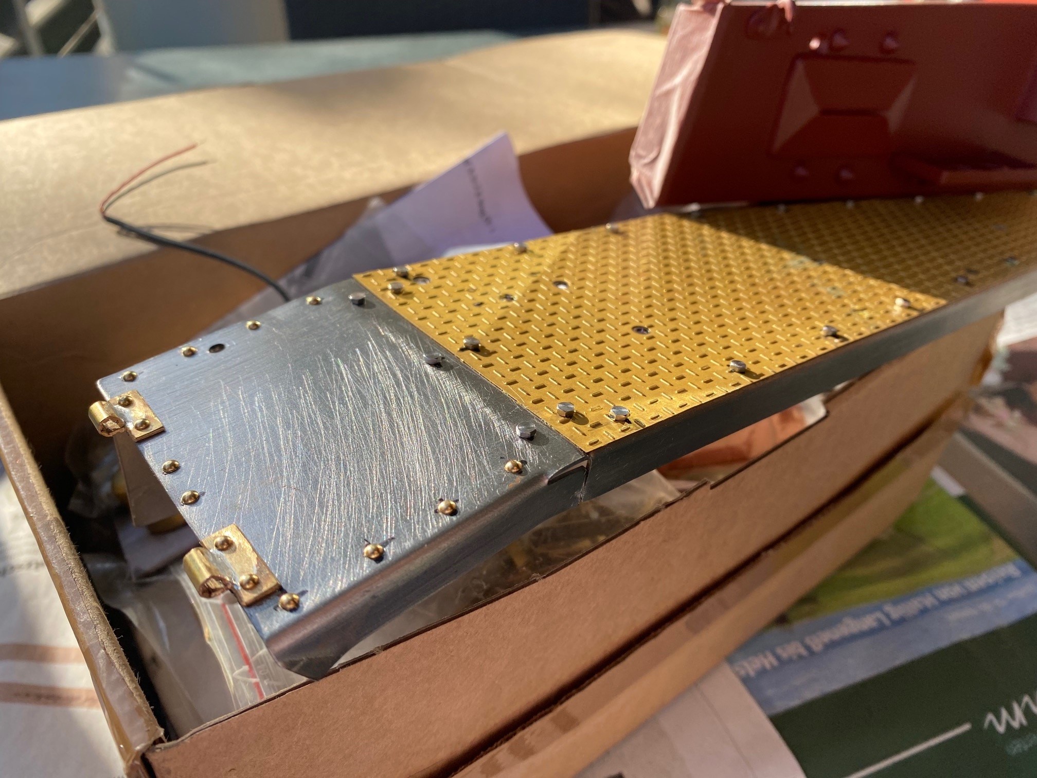

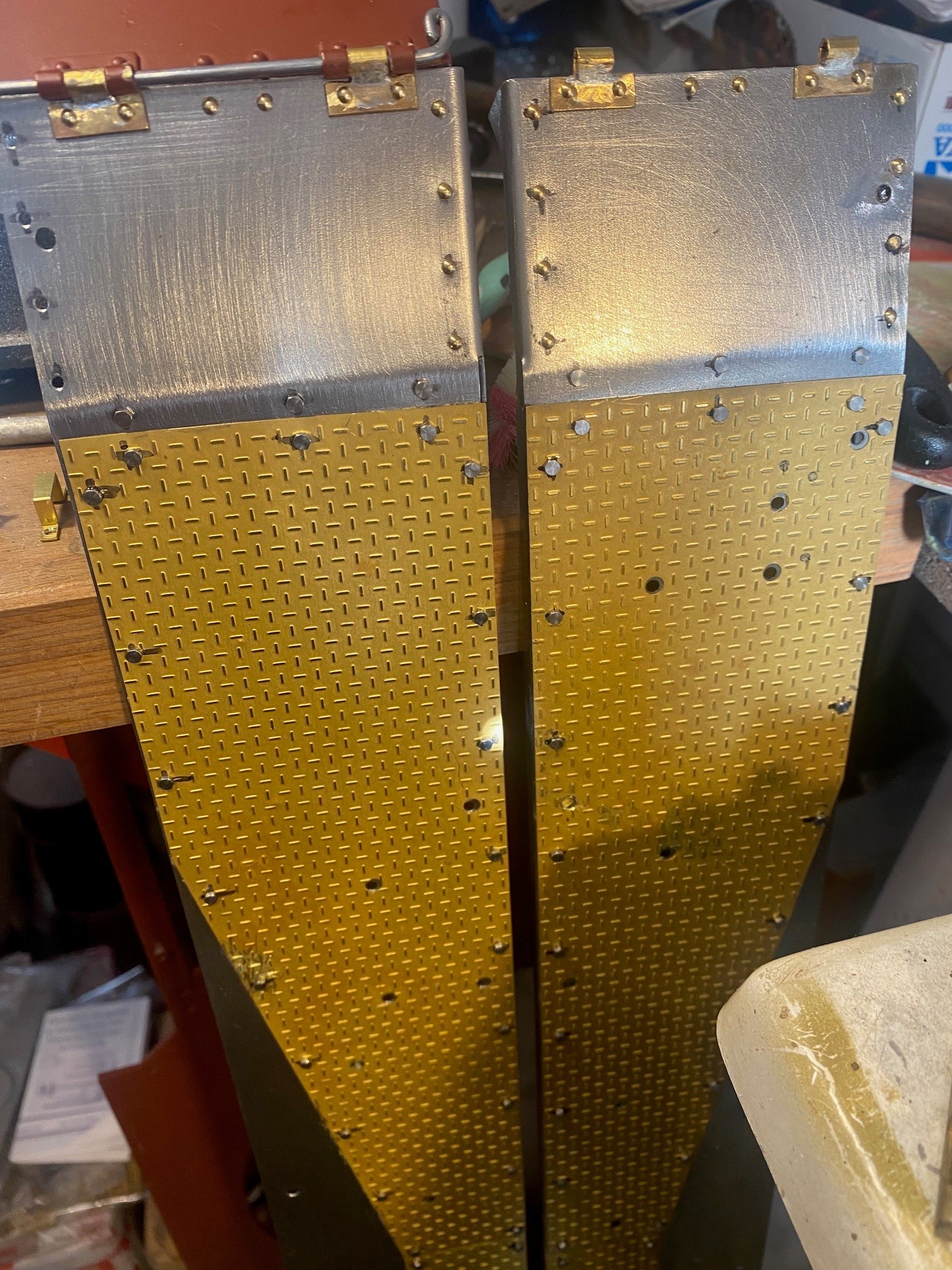

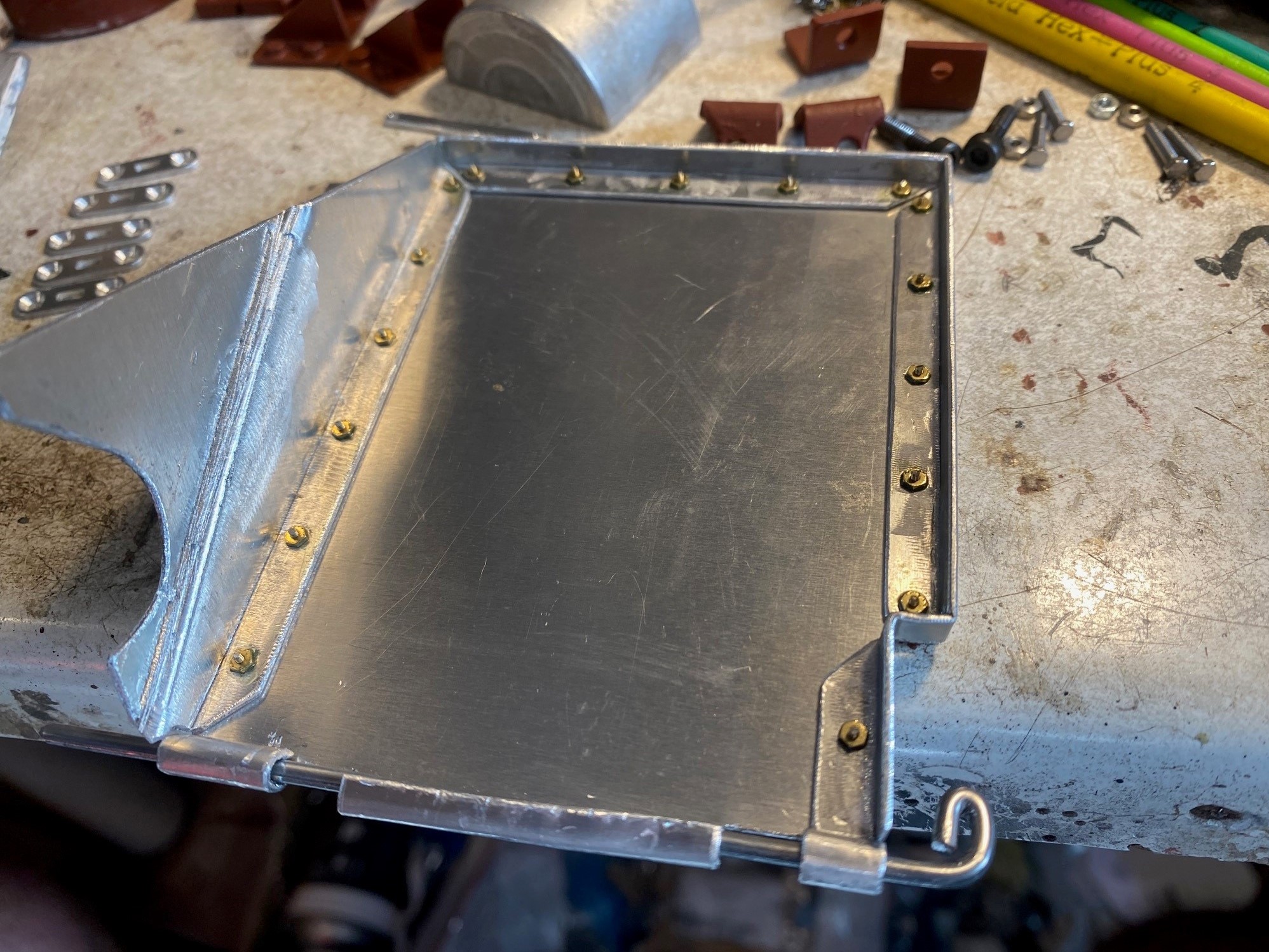

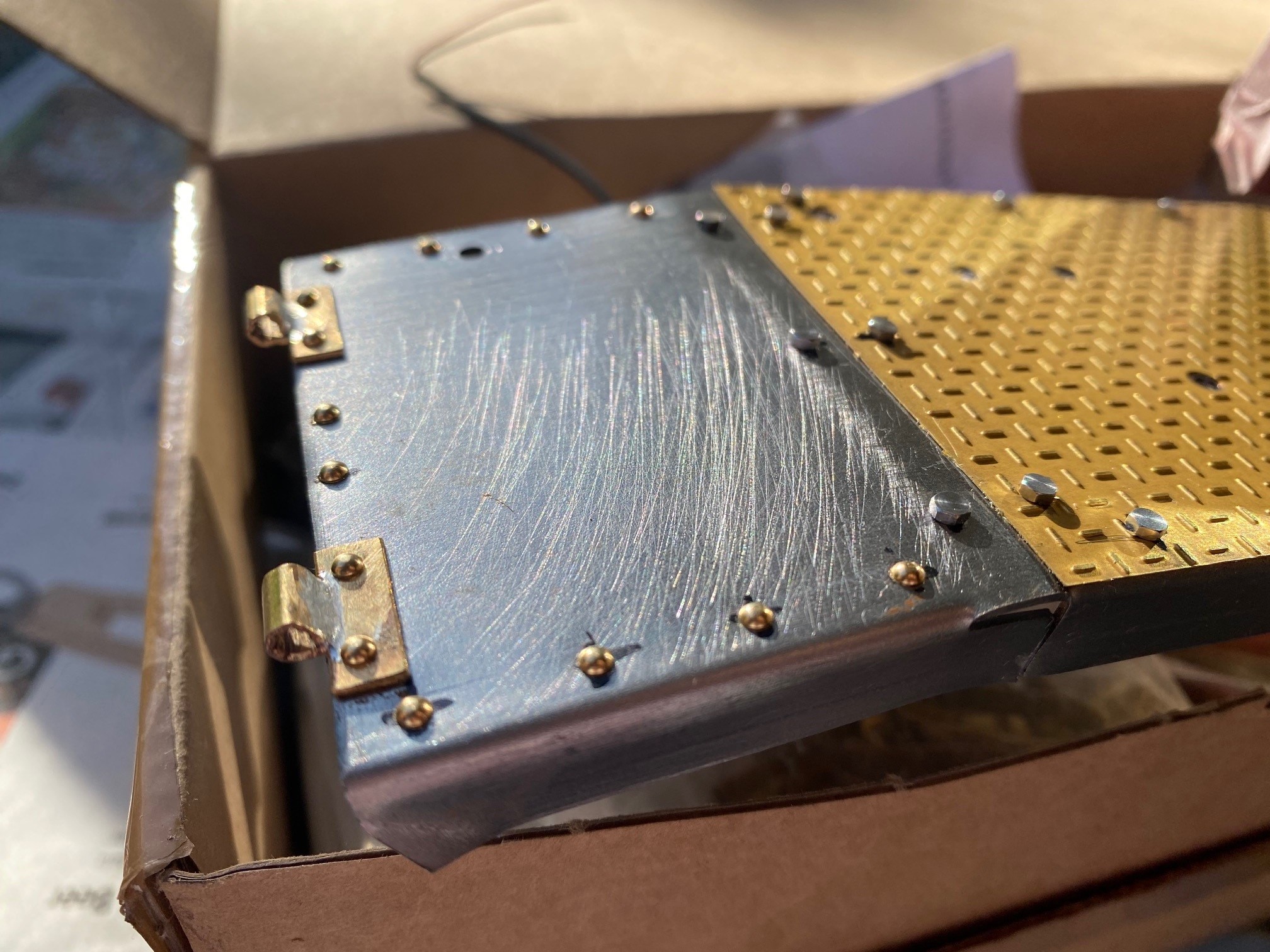

Hi Derek,Robert and Dave,
thank you all for your compliments.

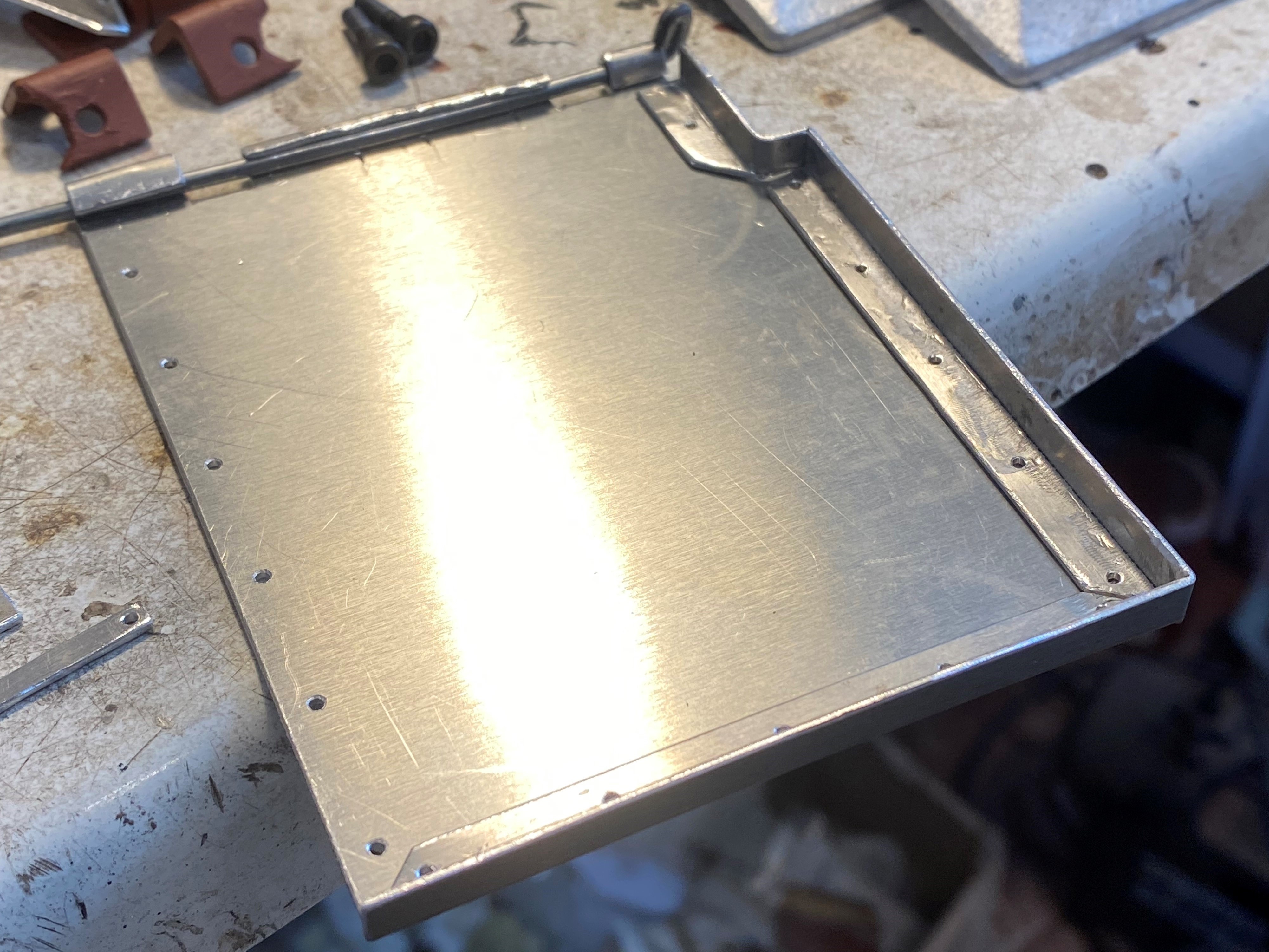

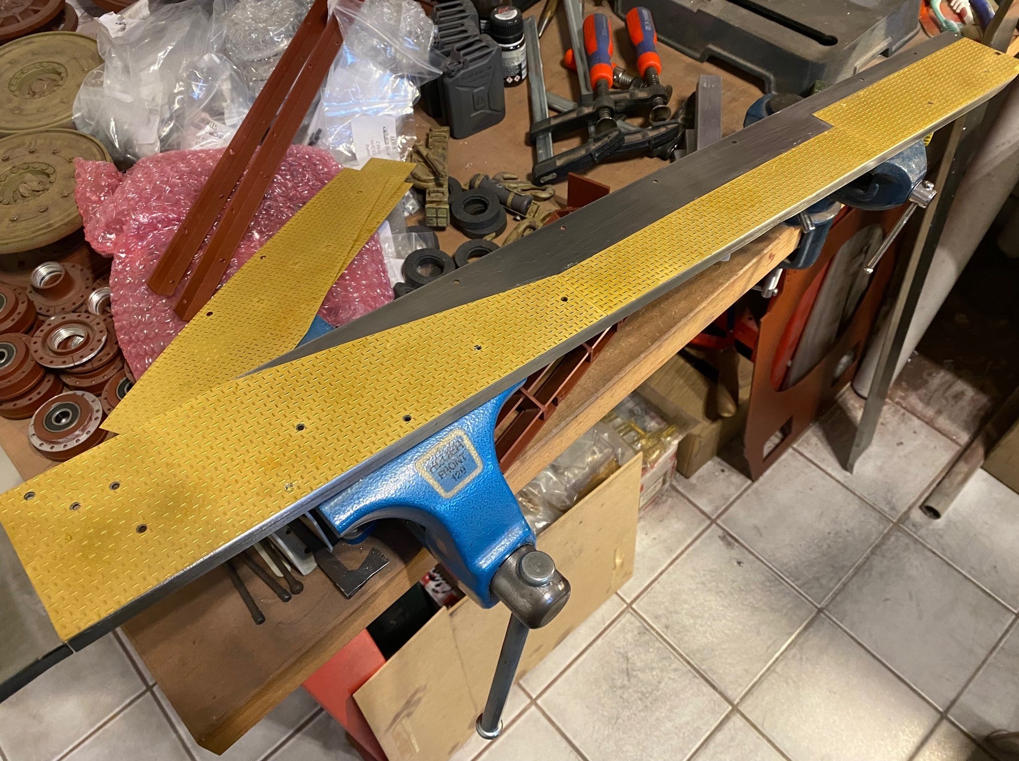

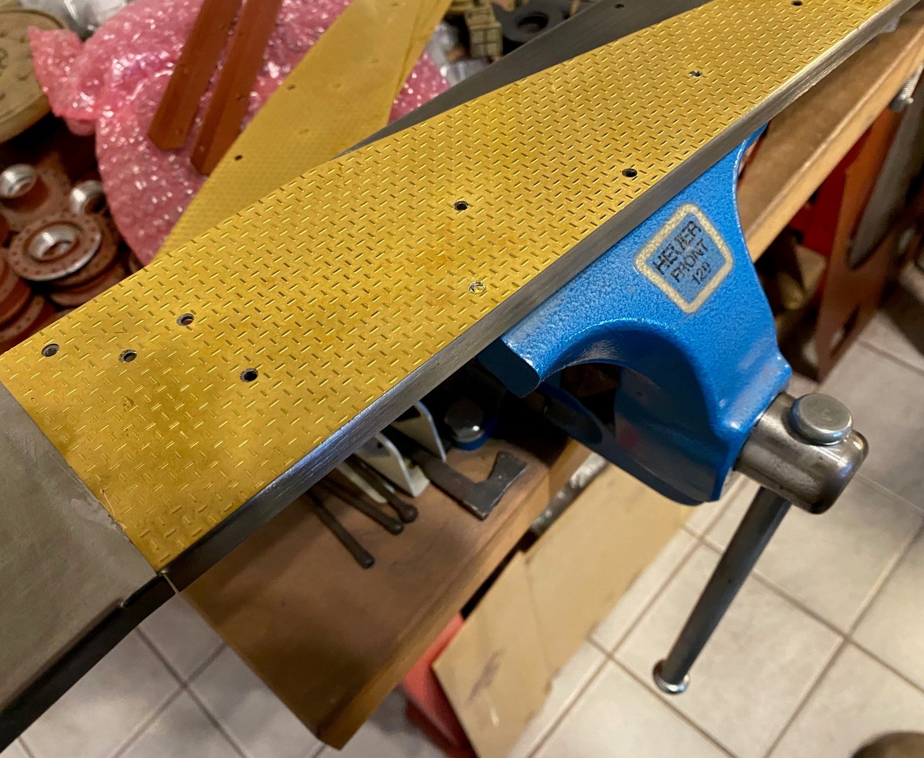

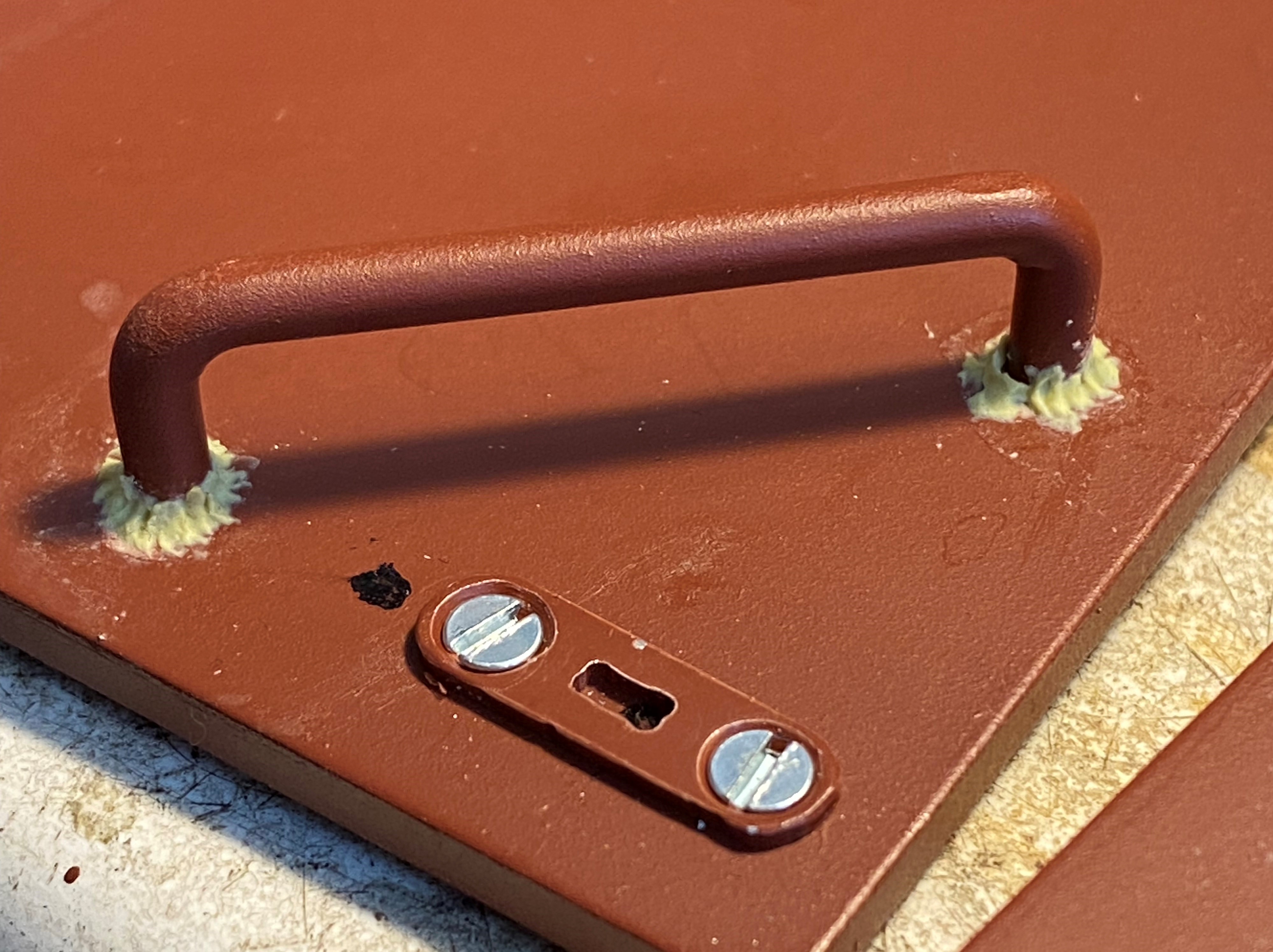

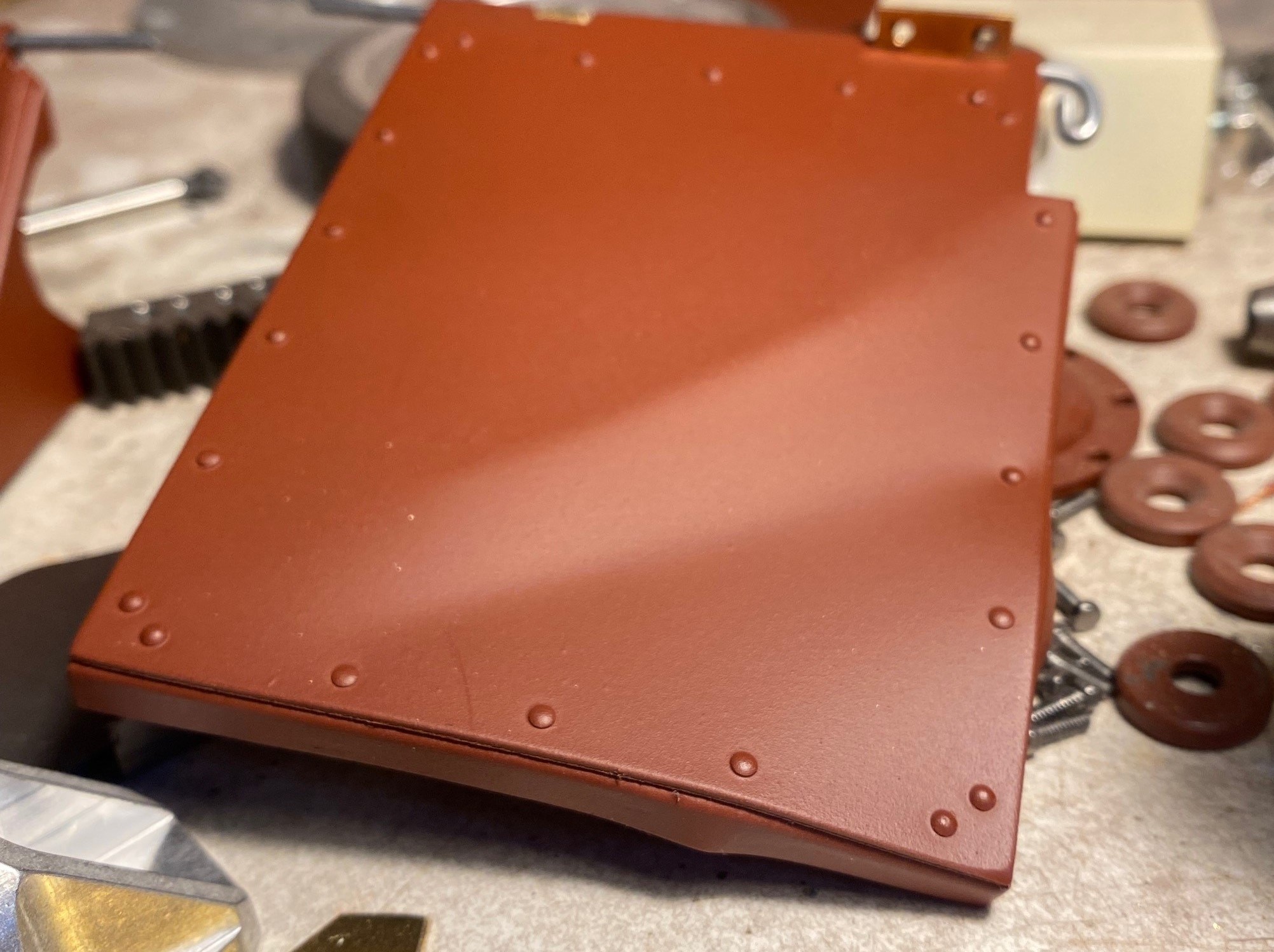

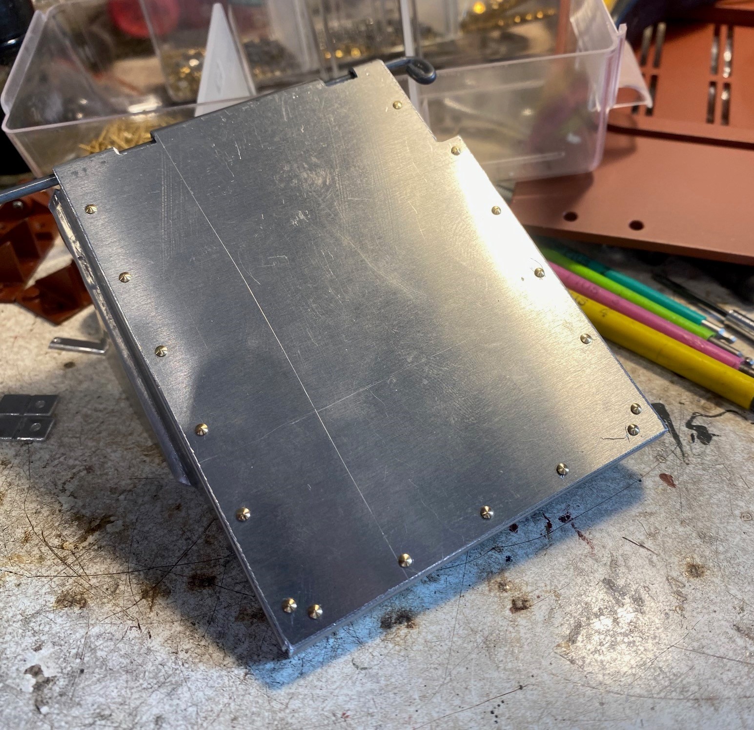

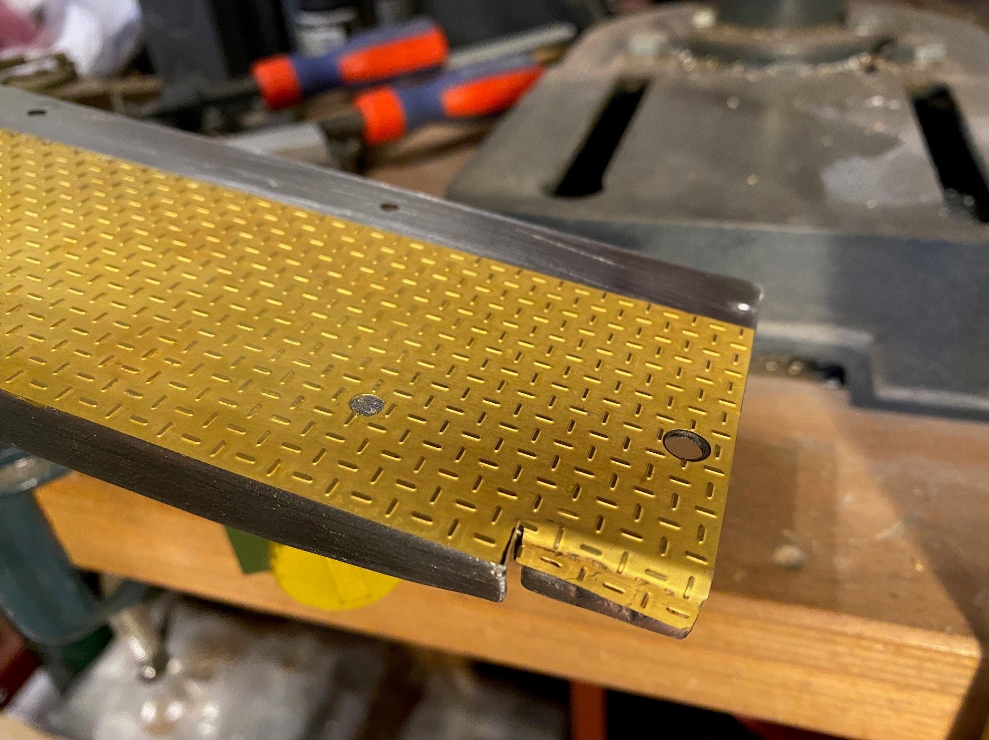

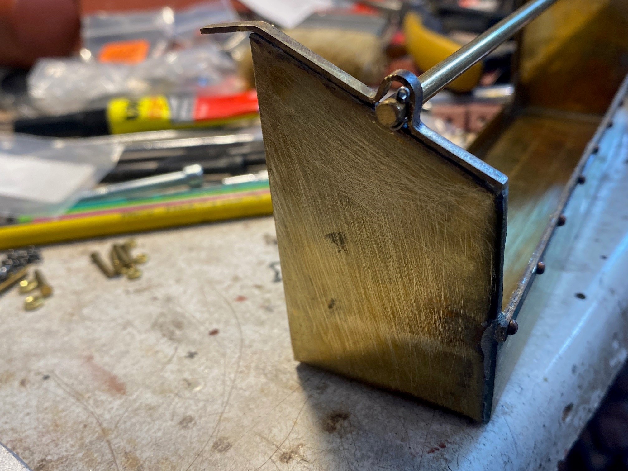

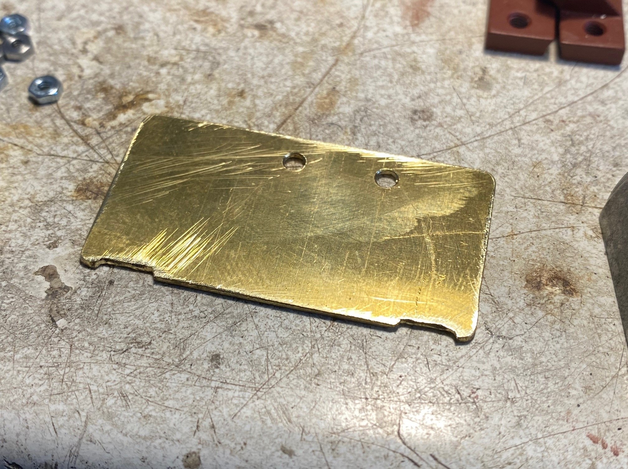

The next are the mud guards. The checker plates are glued on and than the holes for the rivets and screws are drilled and afterwards are mounted.
The halfes of the hinges are mounted and also new holders for the mud guards are built.
Regards Martin
