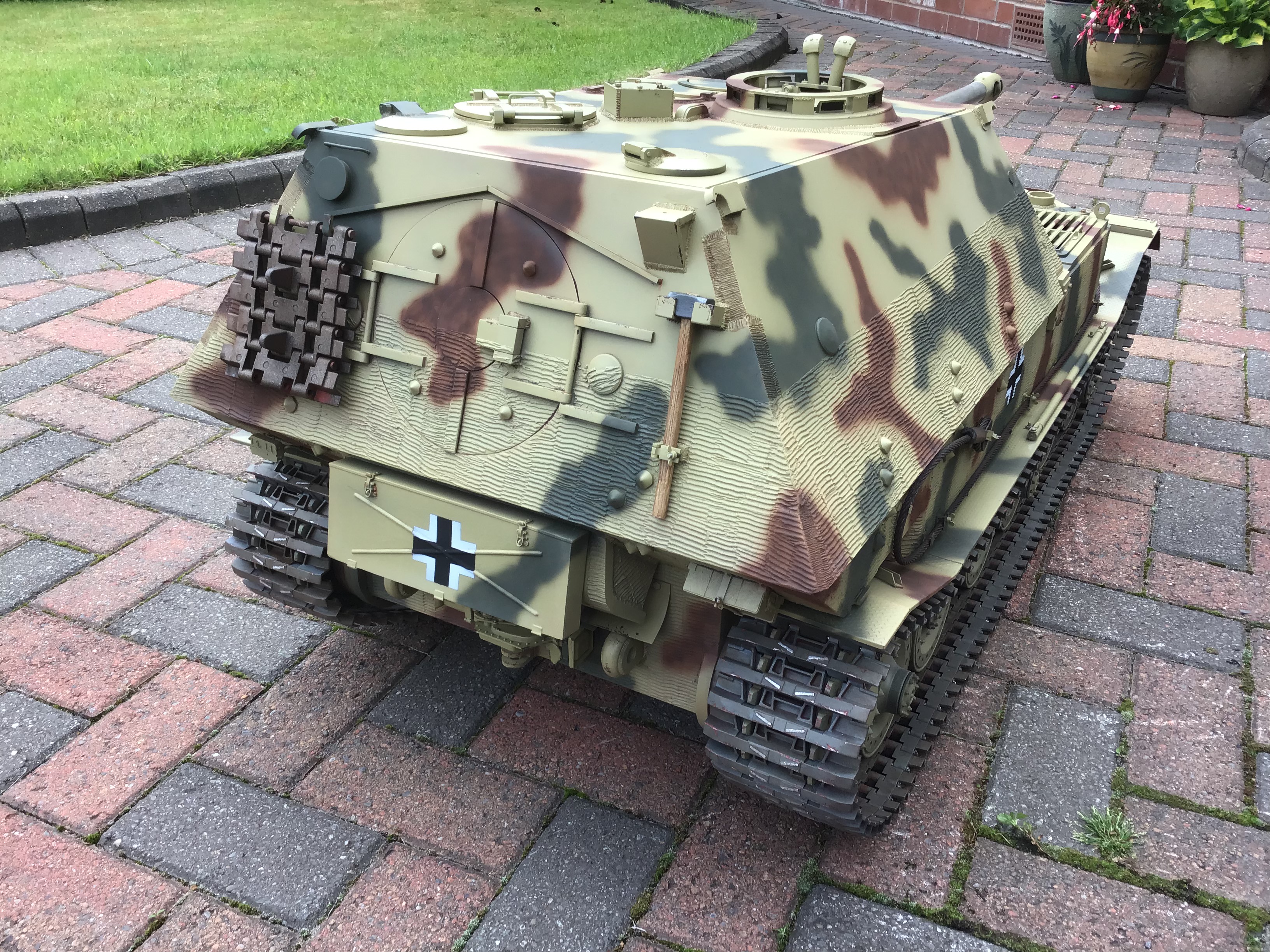

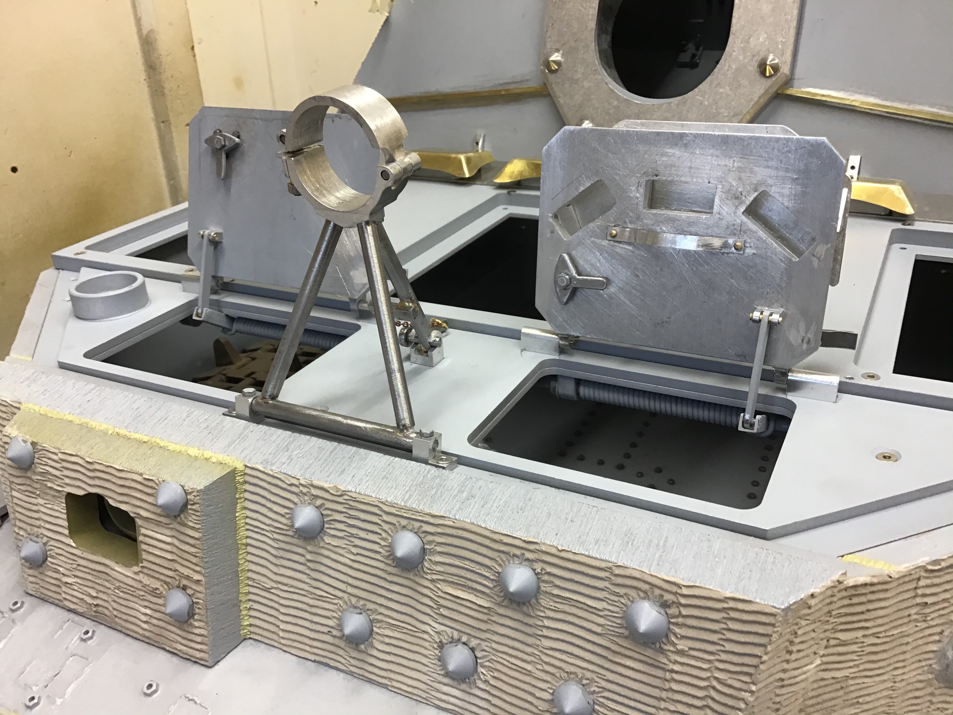

Another update
Rebuilt drivers hatch and gun travel lock
Drivers and radio operators hatches interiors
Overall view of engine deck including air intake covers added at back of deck

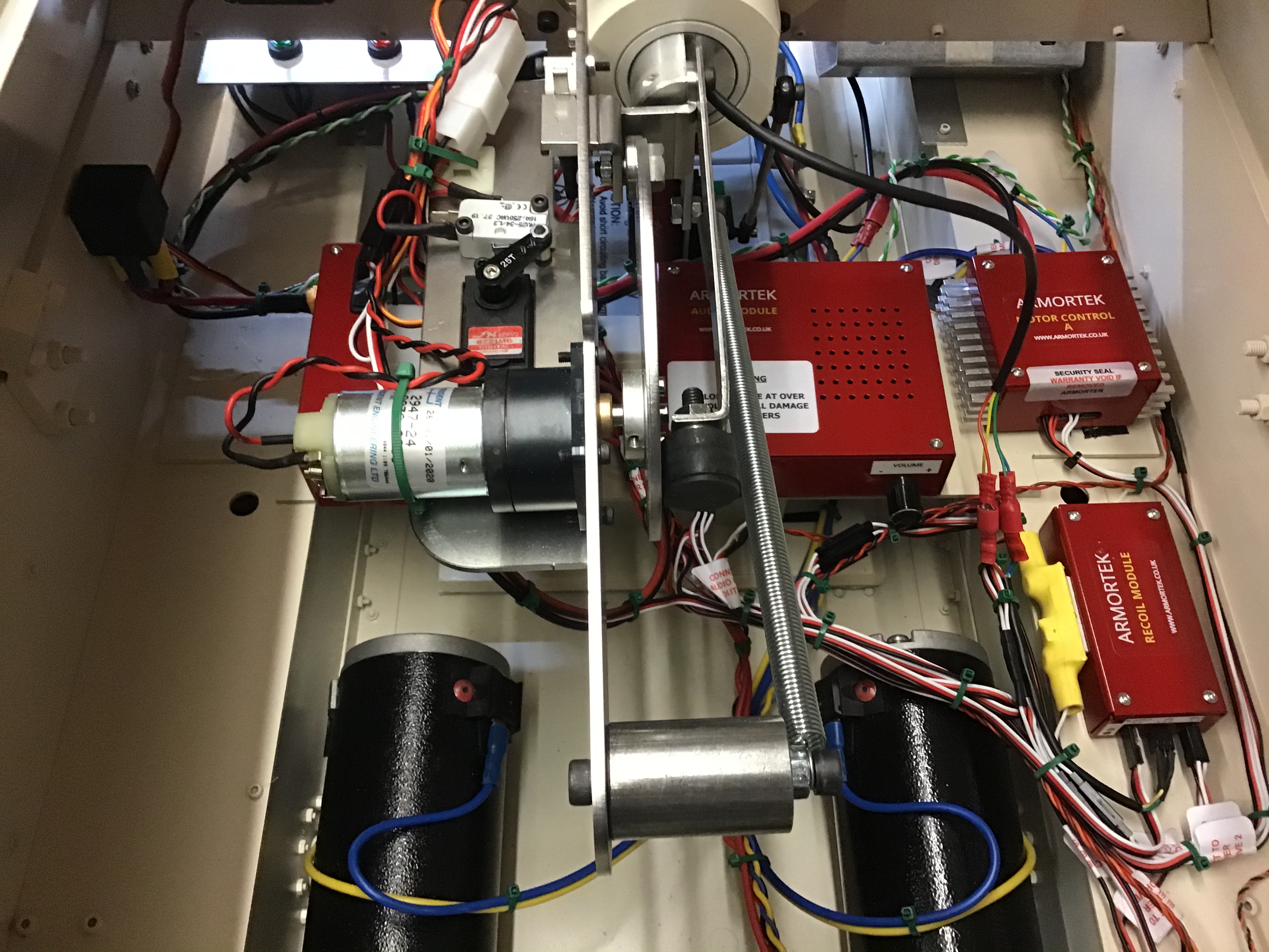

Internal layout and wiring is now complete, just the smoke system plumbing to sort out and the paint.
The plumbing for the smoke system still needs adding

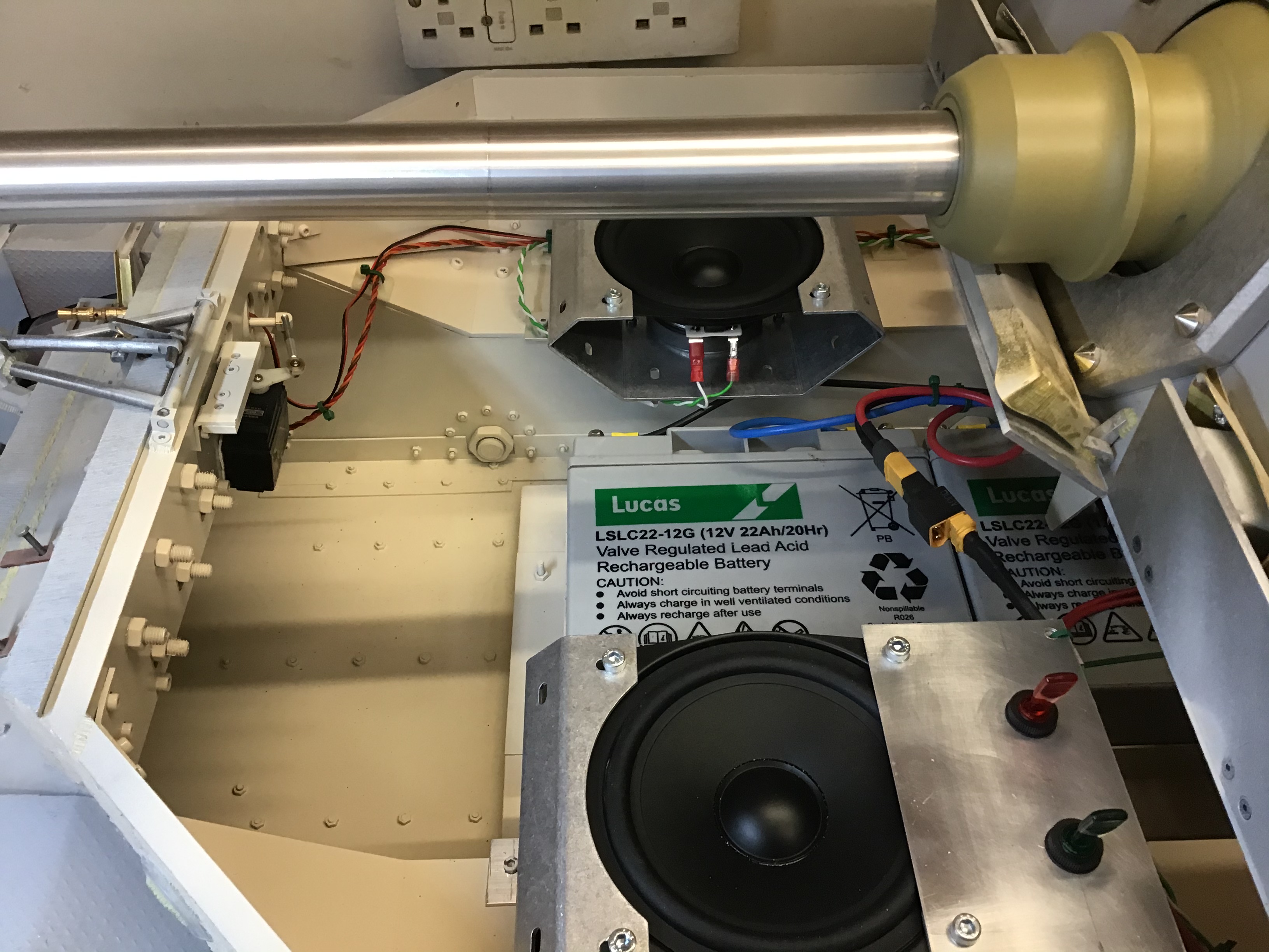

I have left space forward of the batteries so that a drivers and radio operators compartment can be added

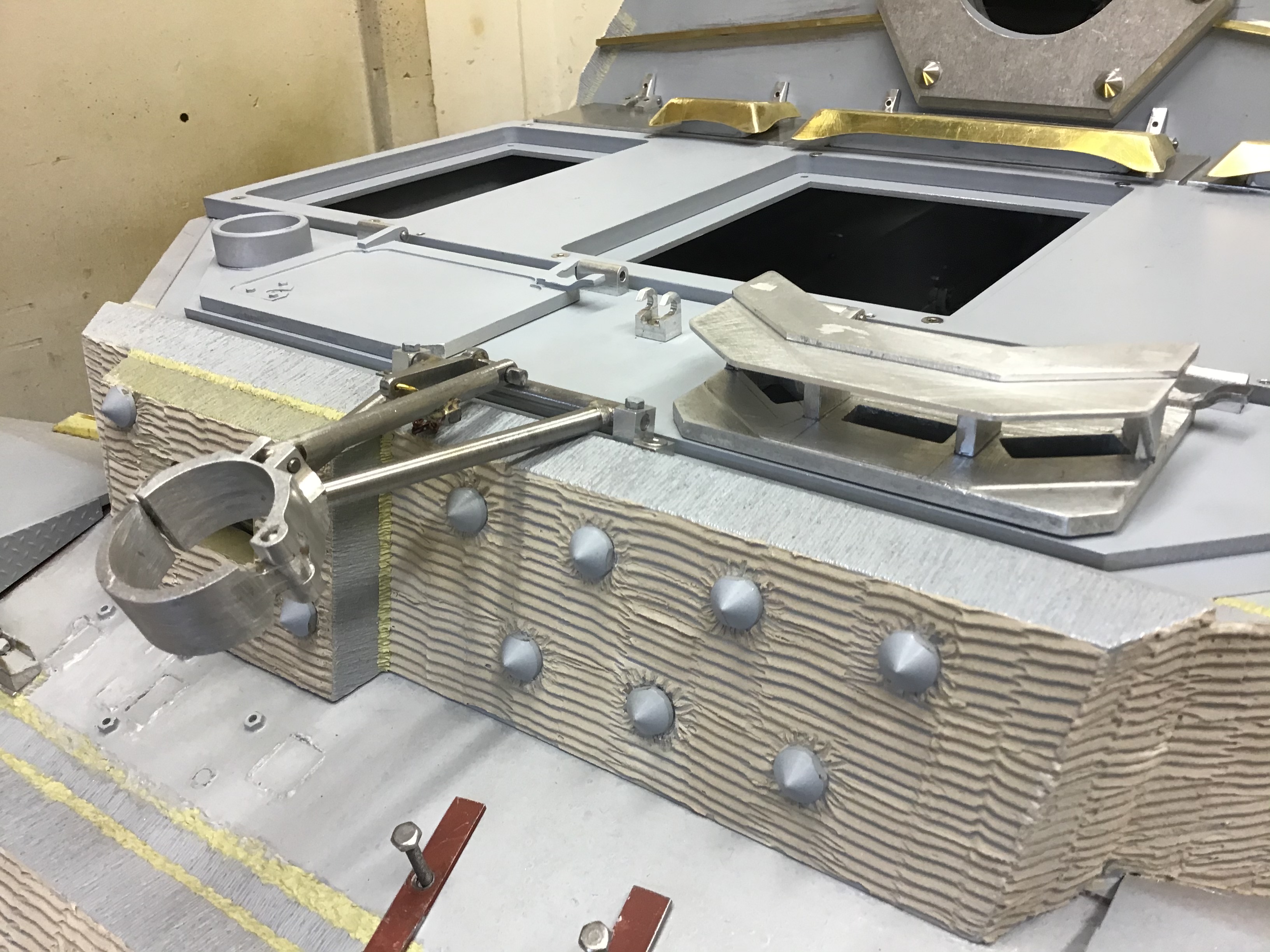

How do you create the flame cut edges? They look very good
Steve Norris
Posts: 1231
Location: Manchester
Has liked: 8 times
Been liked: 701 times
Re: Steve does another Elefant
Post by Steve Norris »
Hi David
Thanks glad you like it. The flame cut edges are done using a dremmel and square edged grinder.

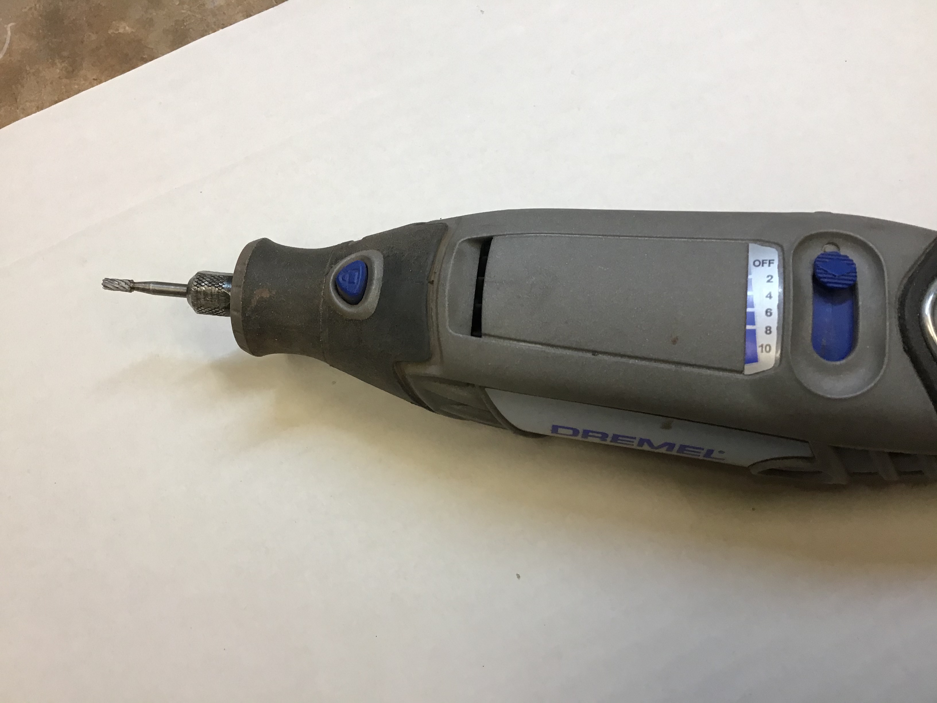

Thanks Steve if you get a second post a picture of the tools/ attachment used

Here we go Dave

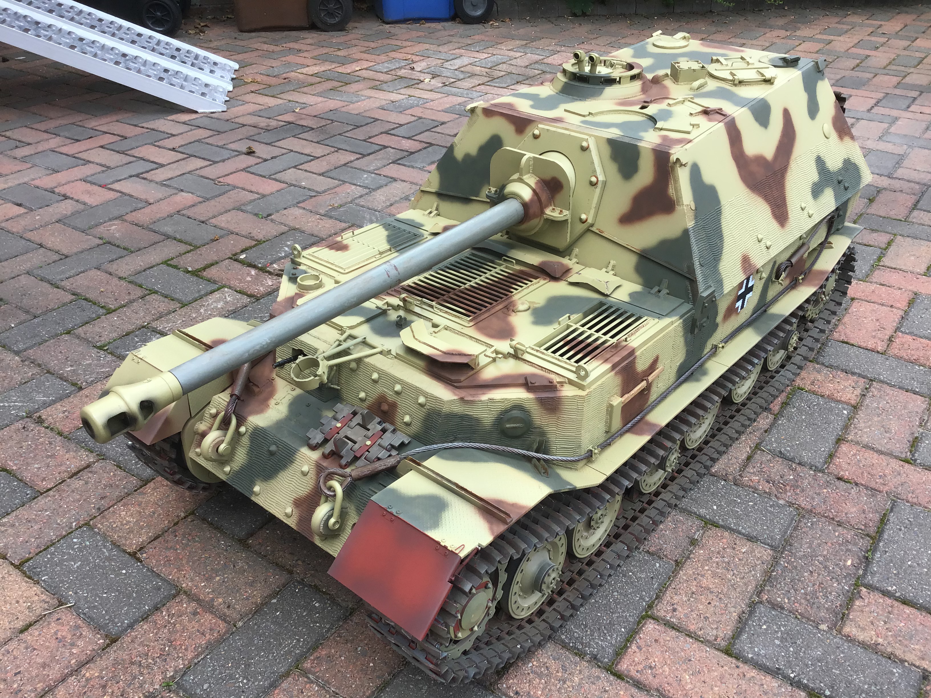

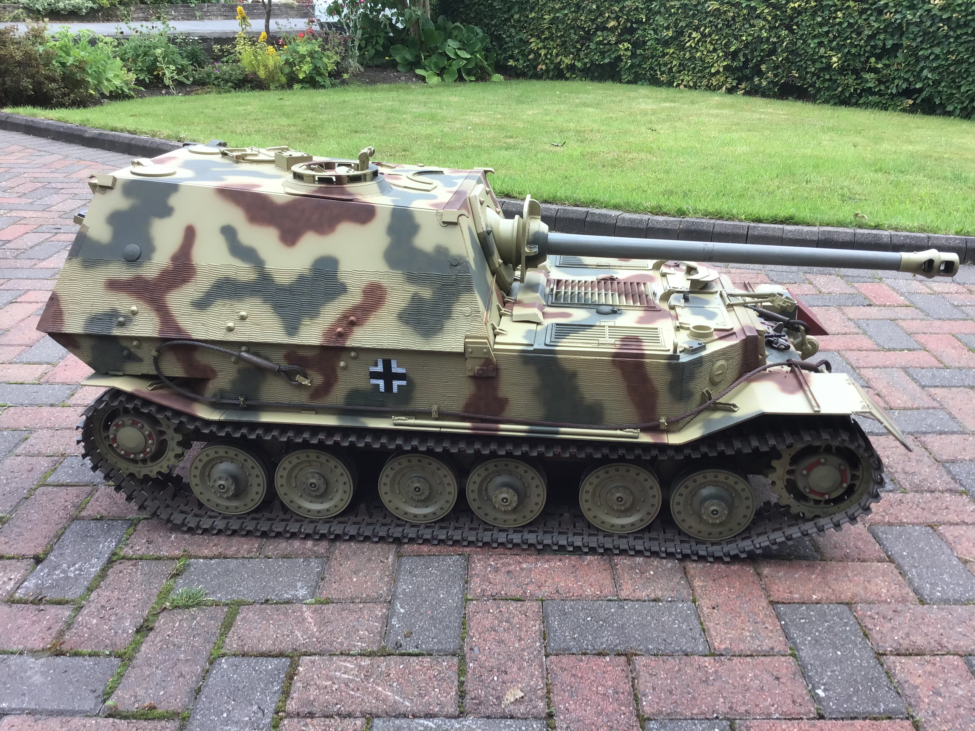

The Elefant is now complete.
On with the Universal carrier now

Looks really good Steve.
Nice job as ever, just the weathering now then? 8)
