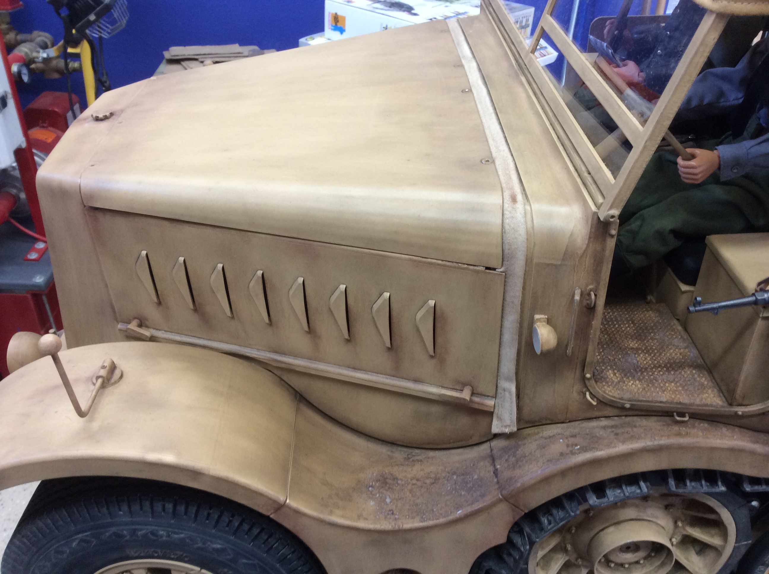

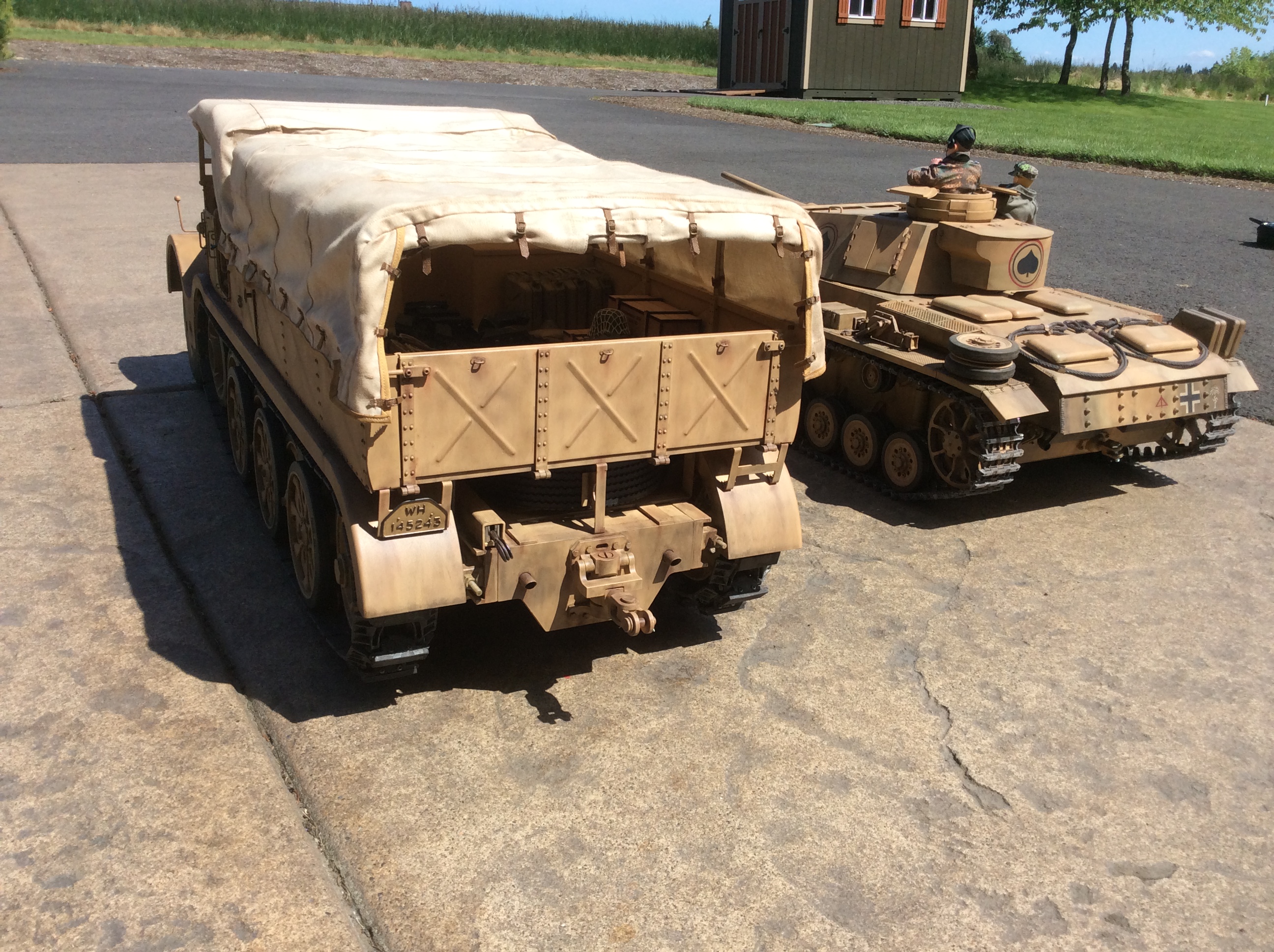

The tracks took 3 days to get running correctly. This model does not run as smoothly as the Panzer I built. The track links are so large they do not like it when you try to make a turn. They try to climb off the drive sprocket. Careful alignment of the road wheels, idler and sprocket are necessary. Further, I had to file more clearance on everyone of the 98 tracks links. The model now runs better but still is not happy when making turns.
I was hesitant to weather the canvas but finally decided to use weathering powders not textile paint. It is hard to see in the pictures but I am happy with the results.
The German figures and supplies in the cargo compartment really give the model the "real" look and the kids love them.

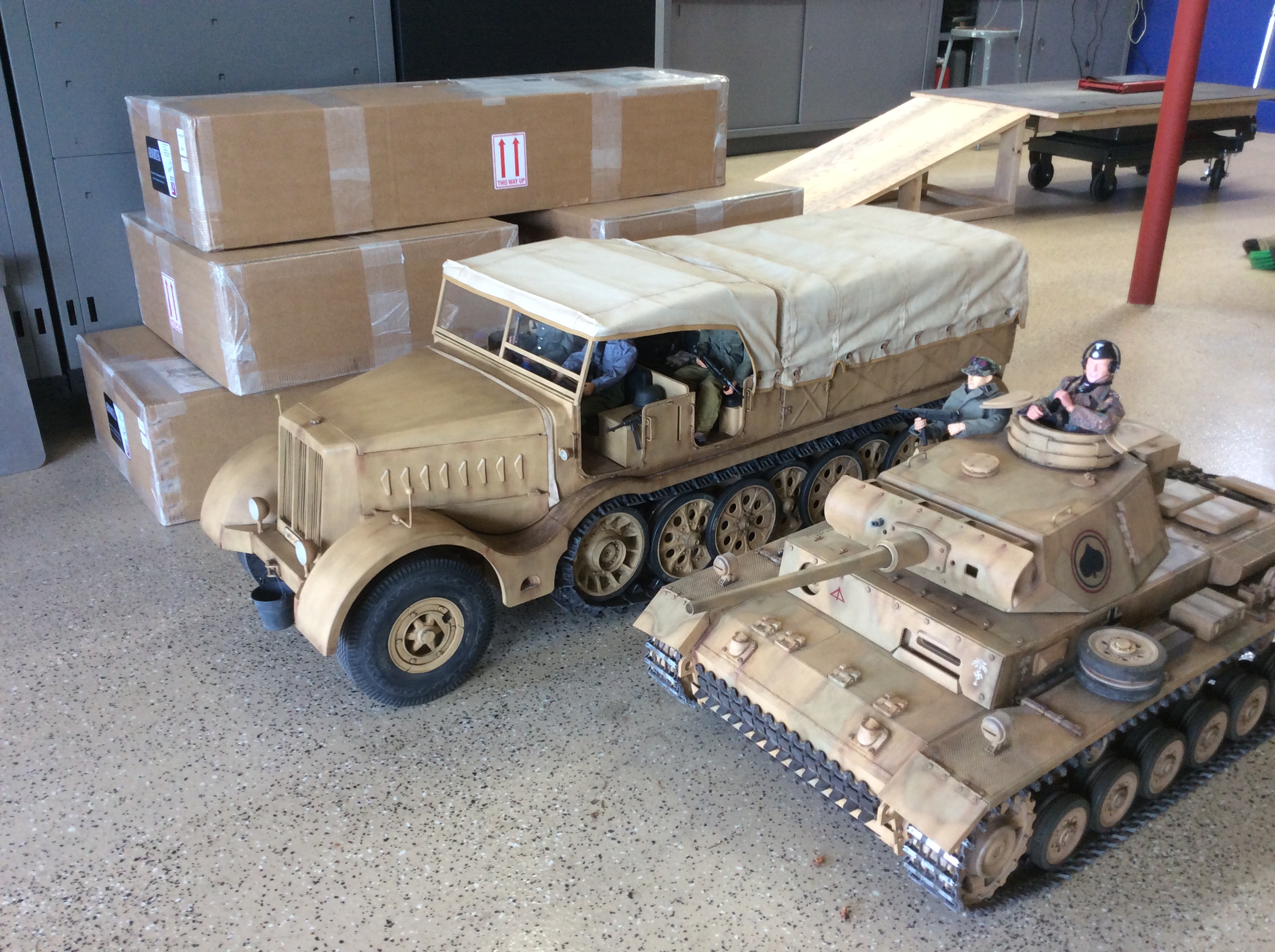

Now it is on to the King Tiger.
Here are a couple pictures of the Panzer, FAMO and the unopened boxes of the King Tiger. In the last photo you can see my lift table and ramp in the back round.
Big day today opening the KT boxes and dealing with all those packing peanuts.
