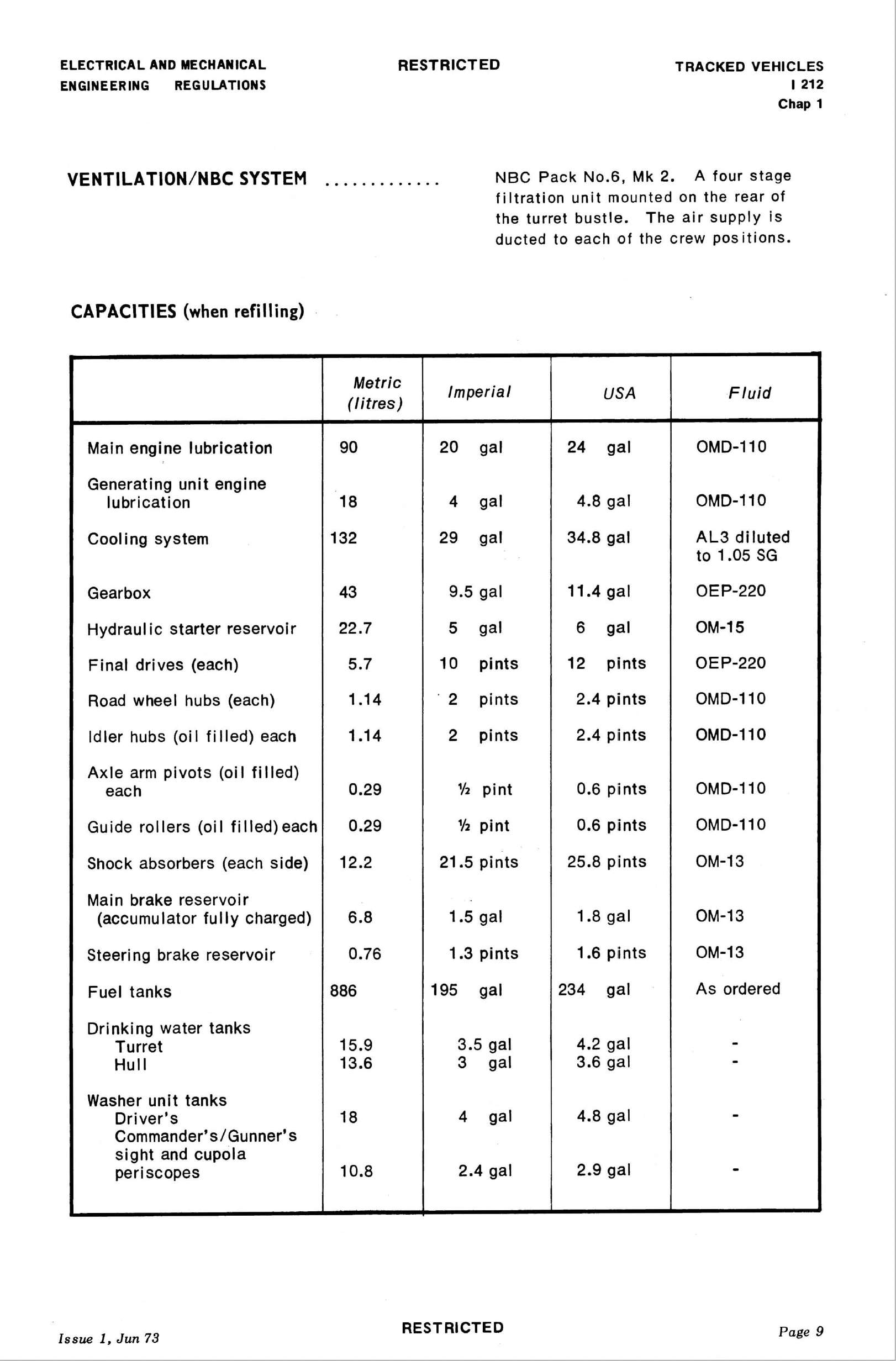

OMD = Oil, Mineral, Detergent. The sequence of OMD oils was 75, replaced by 110, then 80 and finally 90. It would not be appropriate to replace an OEP (Oil, Extreme Pressure) with an OMD. OEP 220 remained in service throughout Chieftain's career and is still available.
The Mk 1-3 and 5 User Handbooks both have capacity charts:
220 and 110 both appear, under their appropriate use.
The User Handbooks are silent on what POL should be carried. I do not recall any of the relevant RAC pamphlets specifying standard POL loads and no oils are mentioned on the Chieftain stowage diagrammes. It was left to regiments to decide whether to issue a Standard Operating Procedure for carriage of POL. In Fourth Tanks, we had an SOP as I stated.

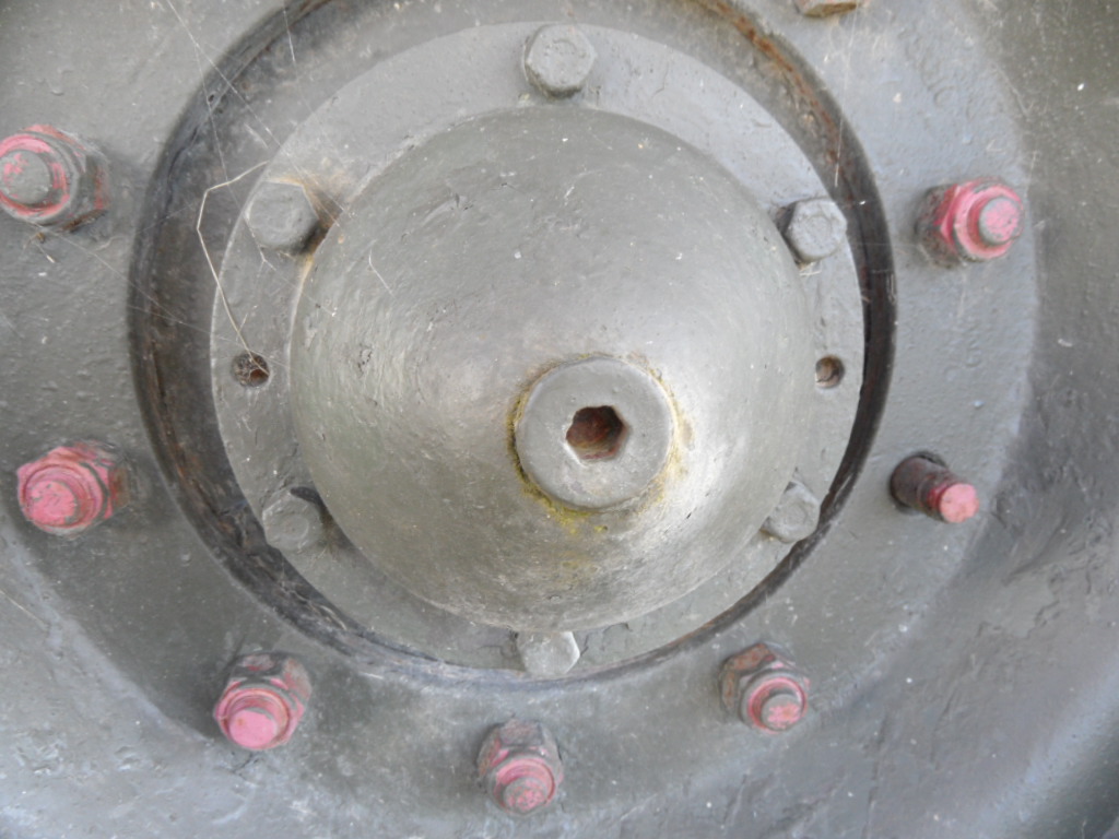

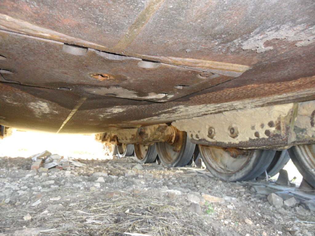

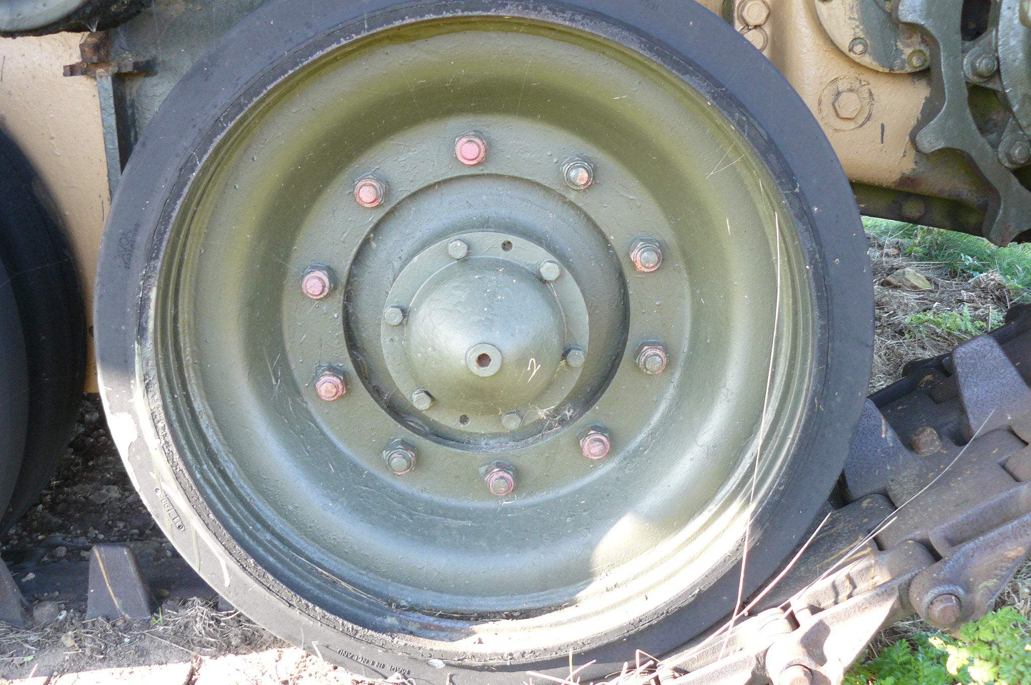

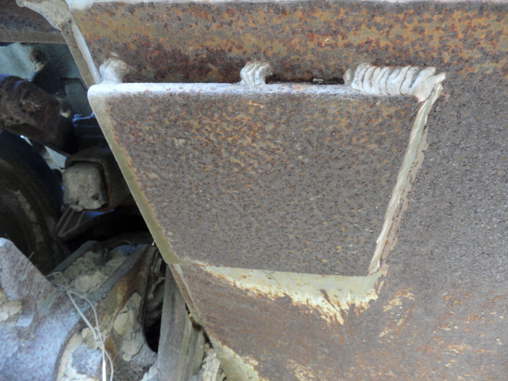

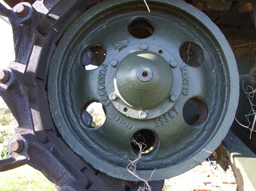

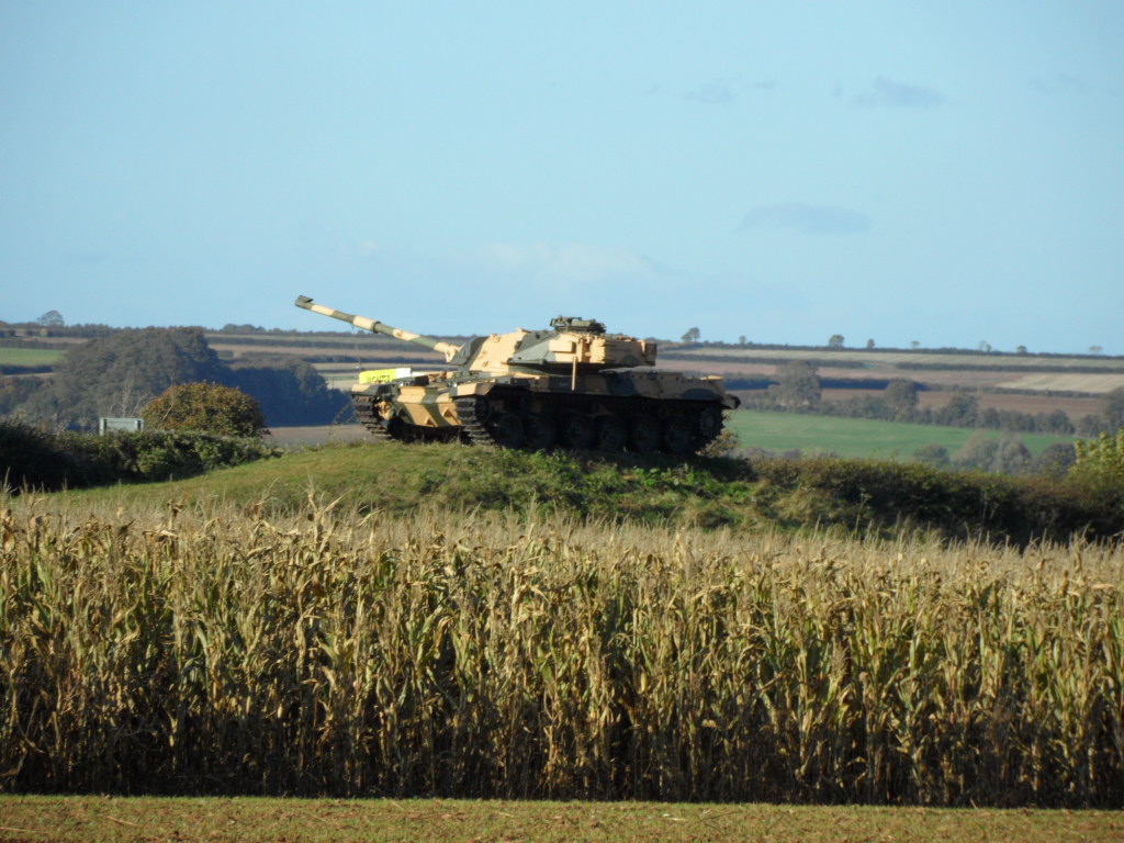

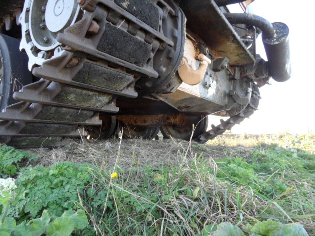

Went to see an old girl sitting on a mound, in the middle of a field, in the middle of nowhere.
Warming herself in the autumn afternoon sun.
Checking out the wheels, the belly plate and the famous rear end.
Some wheels have holes and some don't.
Got a chance to do a Chieftain crawl
The famous rear end
Those jacking points are actually square, dont let the photo fool you and a lot smaller than expected.
The hubs need a lot more work, with a pair of jacking holes to boot.
A grand day out 8)

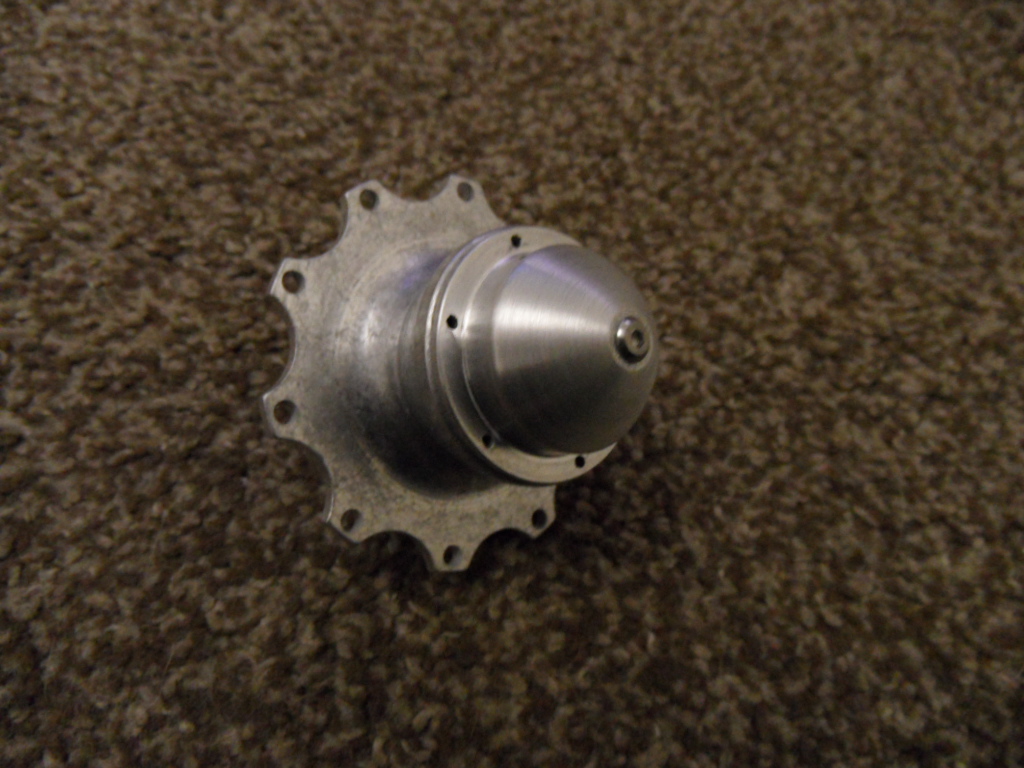

With so many excellent builds in the offing it was difficult to know where to start.
It's very cold and the work bench is in the shed somewhere. Belly plate wrangling seems daunting
So I thought I'd start on page three.
The road wheels.

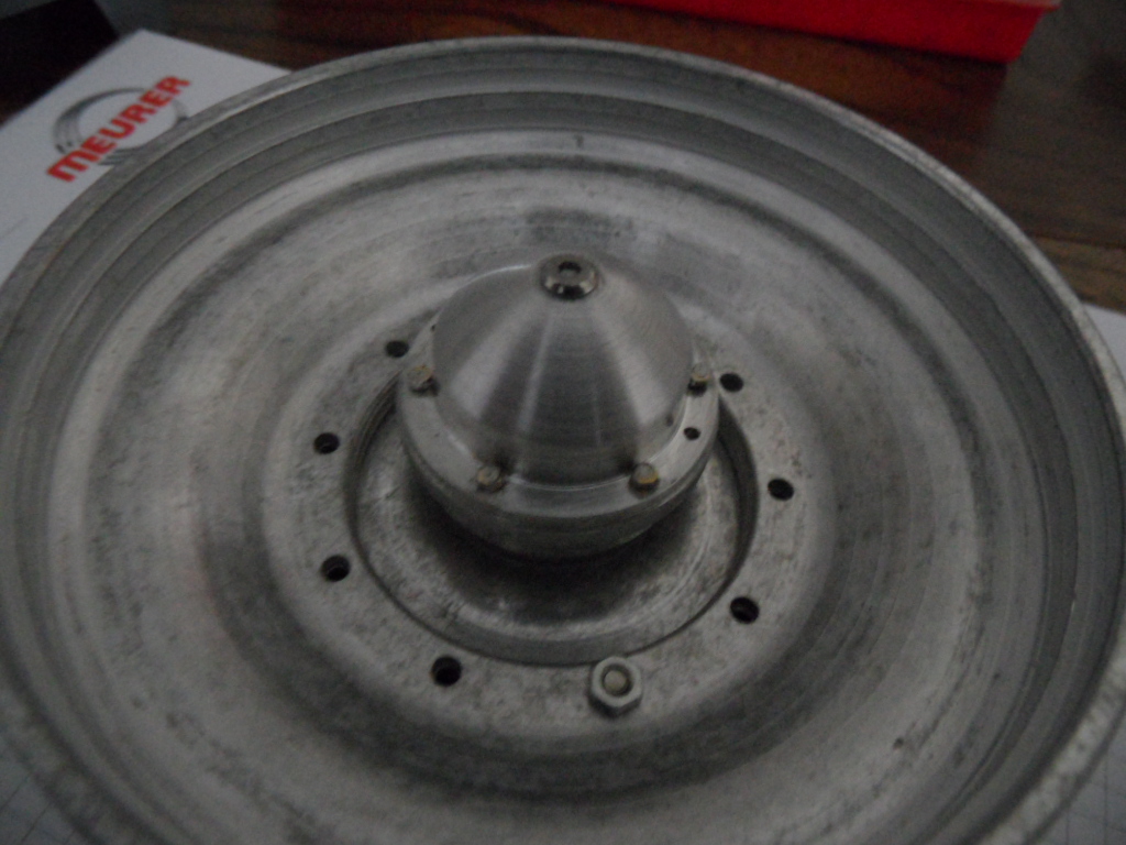

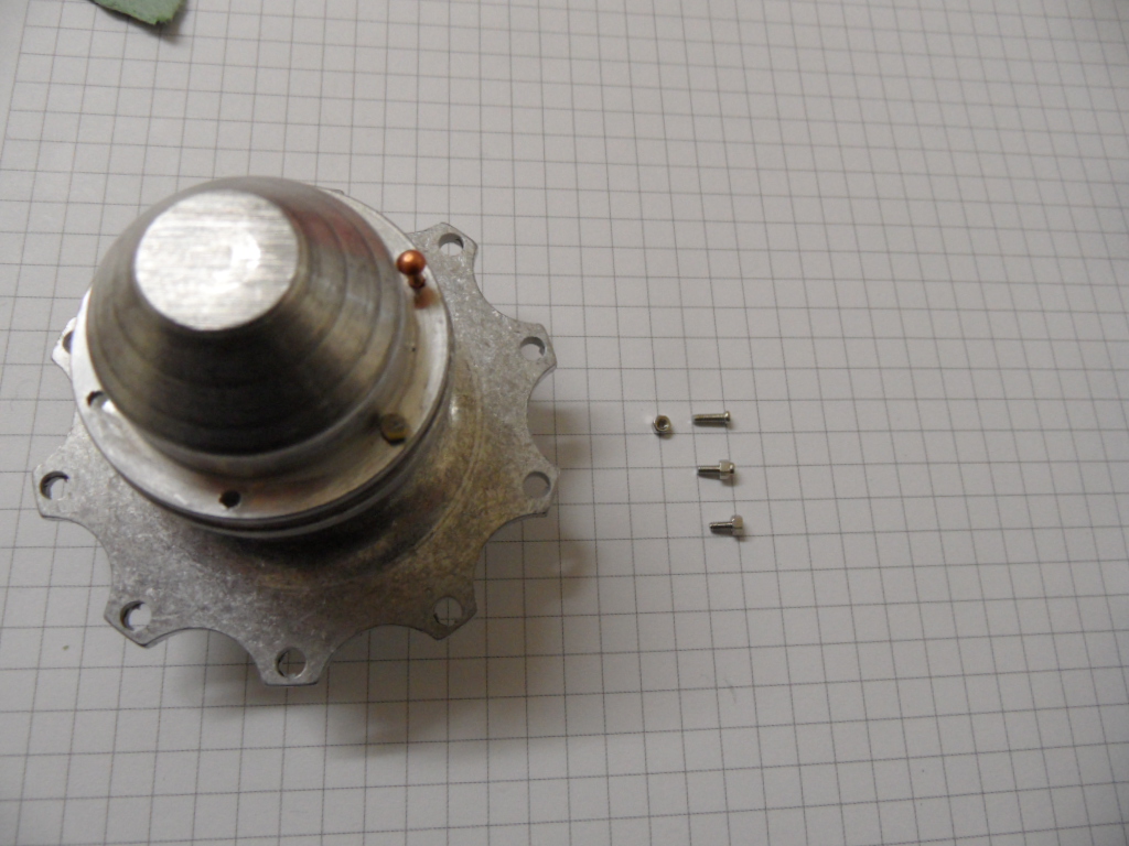

Having visited an old girl recently and took a few pictures, I wondered if I could do the cap hubs slightly differently to the kit. A challenge as everything would be done by hand with a spinning machine.
Then add to that, some detail with bits I haven't got and have to make.
I'm making M1.4 studs bolts for the hubs from spectacle screws and nuts (84) and bit of grinding, saves on the rivet counting :lol: (10BA screws were just too big).
The center lubrication nut/thingy from M3x10 button set screw. Grinding the head down flat but keeping just enough the hex socket to represent the original.
The hub inner thread trimmed so that the hub cap can sit flush. Once painted it should look about right.
Thirteen to go.

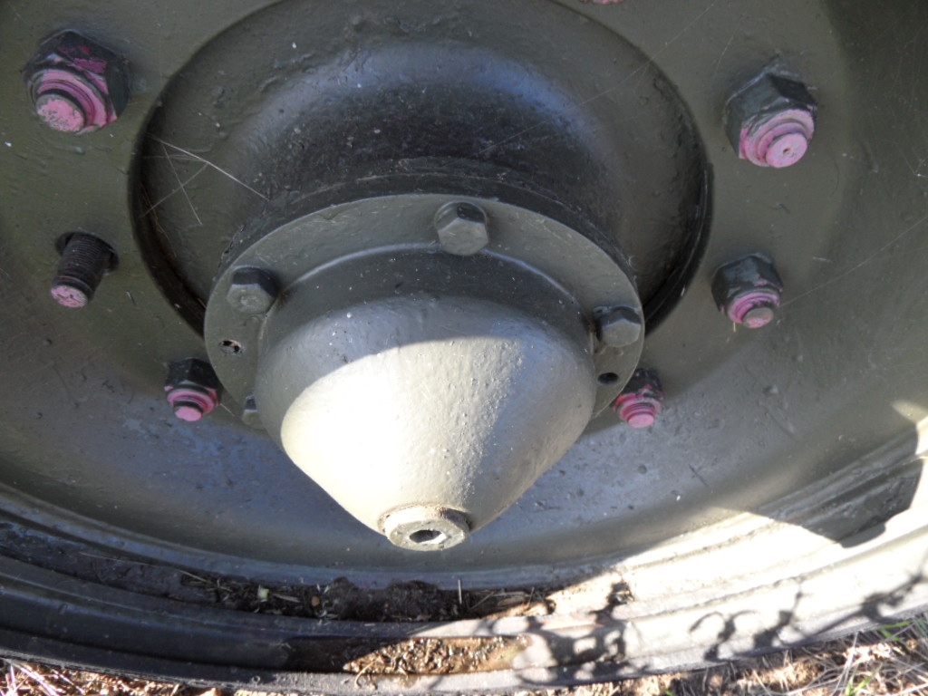

Cheers Vince, though it might be the only one. Times like this wish I knew how to drive a CNC "thingy me bob"
I'm using the button head set screw as the guide, drilling and tapping the center M3 first.
The original hub is slightly sharper in profile.
But taking it easy, it's always harder add material than remove it. :lol:

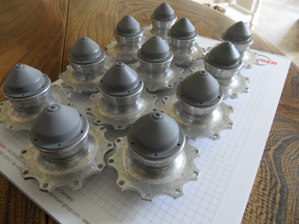

With all the finesse of a wood worker (I've got a wood work O level), chiseling away, I've knocked out 14 hub caps.
I changed the cone angle slightly to 45' to keep the straight portion visually correct (to me).
Original pictures make it difficult, especially from different angles, every time I look at something I tend to see a different aspect.
Grinding the button heads by hand is tricky, too much and you loose the hex, too little it doesn't look right.
Painted them so I can see where to drill the jacking threads.
I suppose I've ruined my full money back in original packaging exuding P&P guarantee :lol:

Nice work John but sadly you made 2 too many - no wonder it took you so long :-)
Keep up the good work and witty comments make for easy reading and put a smile on my face :-)

Sorry Andy, what about the hunks of beauty. :lol:
Can't wait for the days of graft getting those letters right :cry:
