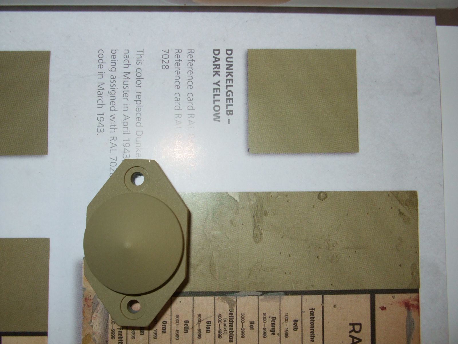

Also the child in me couldn't wait to see some colour on the wheels.Spraying the grey was fitting a bit monotonous.The paint went on very nice but once dried it looked quite green.I thought it may be because I sprayed it over Grey but I also sprayed a suspension arm which has Red Oxide on it.....it still looked greenish.I did a second coat and it didn't make any difference.
It is what it is I suppose,it's got the right paint code.I suspect once the other Camo colours on it will tone it down.

I don't want to open Pandora's box but I think for a 1944 Tiger it should look greenish.

It is a can of worms Vince but it looks close enough to the pic of Tiger 222 for me,its subjective anyway.It is Ral 7028 Dunkelgelb so that's going to have to do.

Yes Glen, it's not perfect but I am happy with it. I took the book to a local car paint specialist and using his RAL paint strips I chose a matt RAL 1020. This was the best solution for me in my circumstance.
