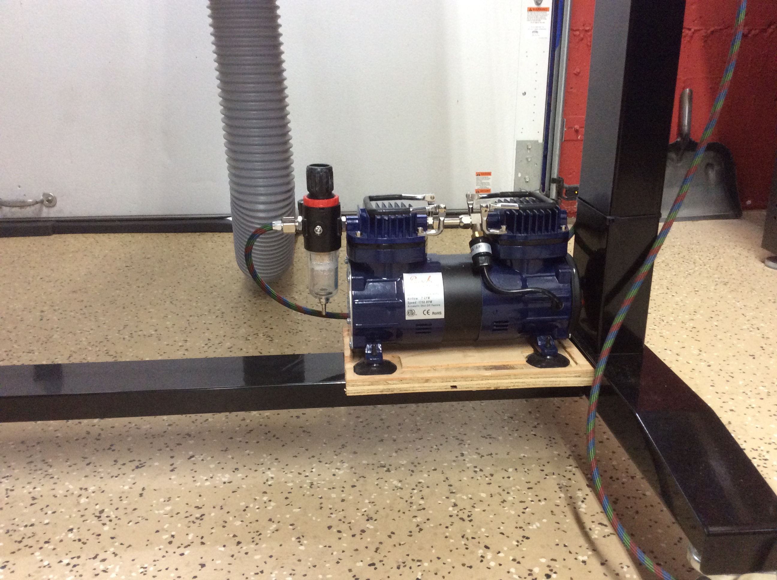

Hi Adam,
I followed your lead and bought the same paint booth you have. What a great addition to the shop. Much better than painting outside.
In the pictures you will see a turntable (lazy Suzanne) I bought on ebay. Really great for getting to all sides of parts. It is 11" in diameter. I bought some 12" diameter cake plates on Amazon to keep it clean.
Also notice the vent system. I found the fitting with the flat end that fits under the garage door or in a window on Amazon. Beats punching holes in the wall. The table I got at Home Depot. It cranks up and down so I can paint standing up or sitting down. It also has wheels so I can move it around the shop or outside on nice days.
Thanks for the info on the booth.
Tom
