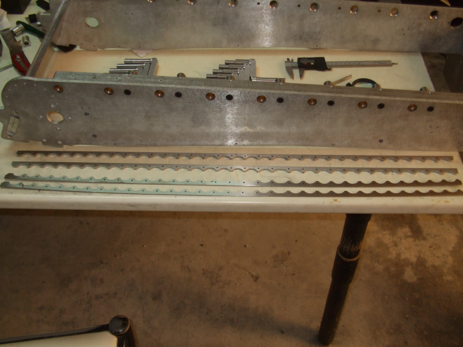

Also today I assembled the axles.

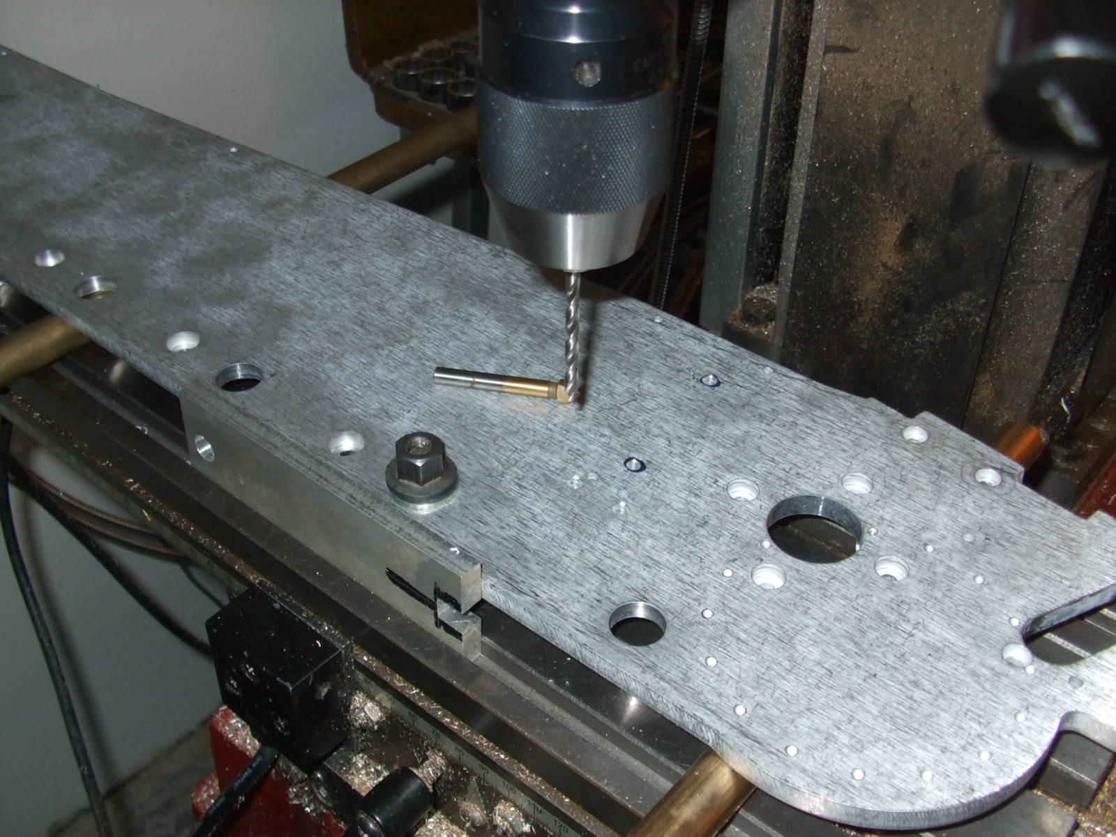

Disassembled everything for the last time. Drilled holes for bump stops, shock absorber mounts and track deflector assembly. Plugged the unused holes.

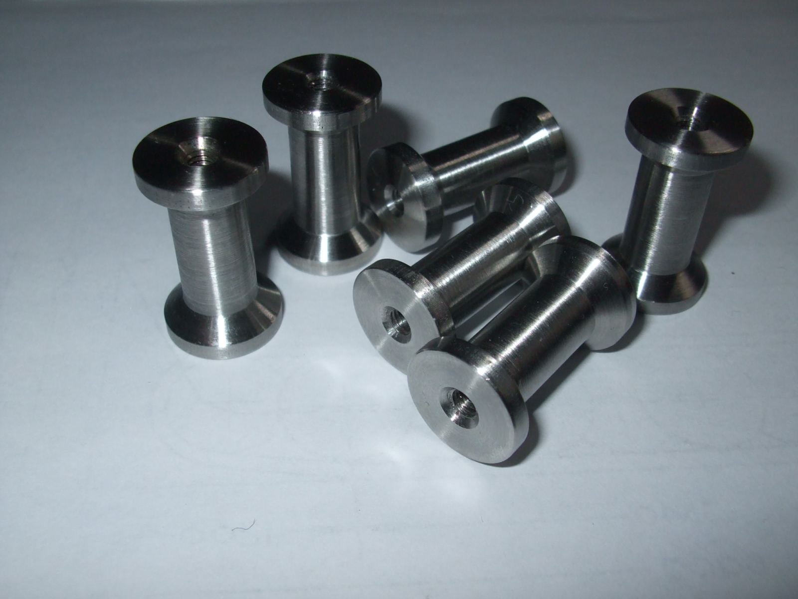

As I need the pillars for the battery tray to be tapped as opposed to having a through hole I made a new set from stainless.

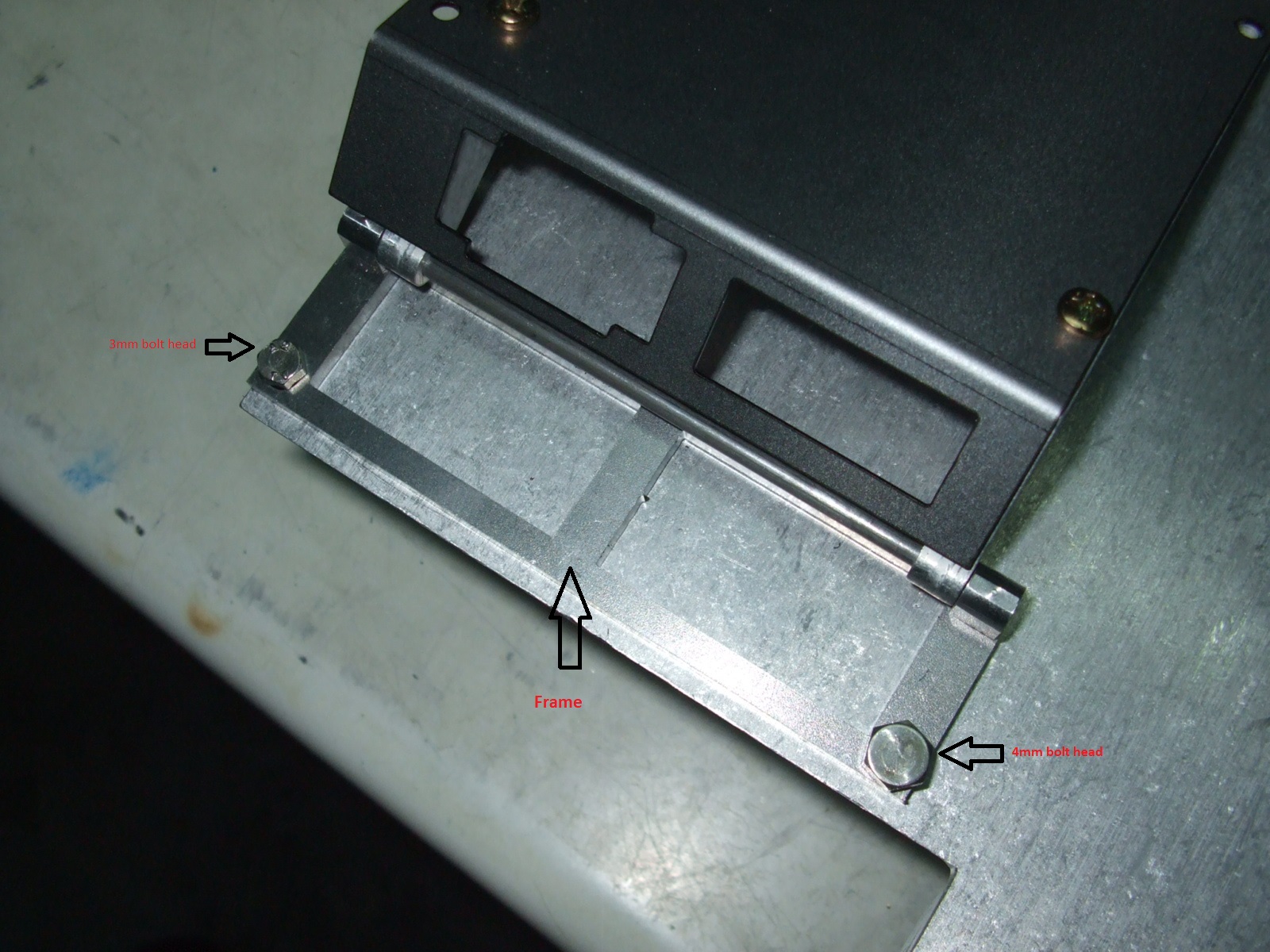

At first I noticed a 4mm bolt would not fit in the threaded portion of all the mudguard hinge blocks (CE0327).
After a measurement of the thread it was found to be oversize. Used a 4mm die to get the proper threads. As this part is made in aluminium, I took extra care that the die picks up the old thread.
Next thing I noticed was that the lower bolts in the frame might be a bit too large.
I can solve this by either using a 3mm bolt instead of the 4mm one or else use a 4mm bolt with what is called a one-size smaller head.
With this configuration, the convoy light is bolted to a small plate which is then bolted to the frame. What I am suspecting is that this configuration is for an early or mid Tiger. From the limited resources that I have, I think that on the late Tiger the frame is not used and the convoy light is bolted directly to the rear plate. I had a look at Tim Bowman's build, and it looks like he got an after-market rear mudguard and I cannot see the frame.
Could anybody kindly confirm this.

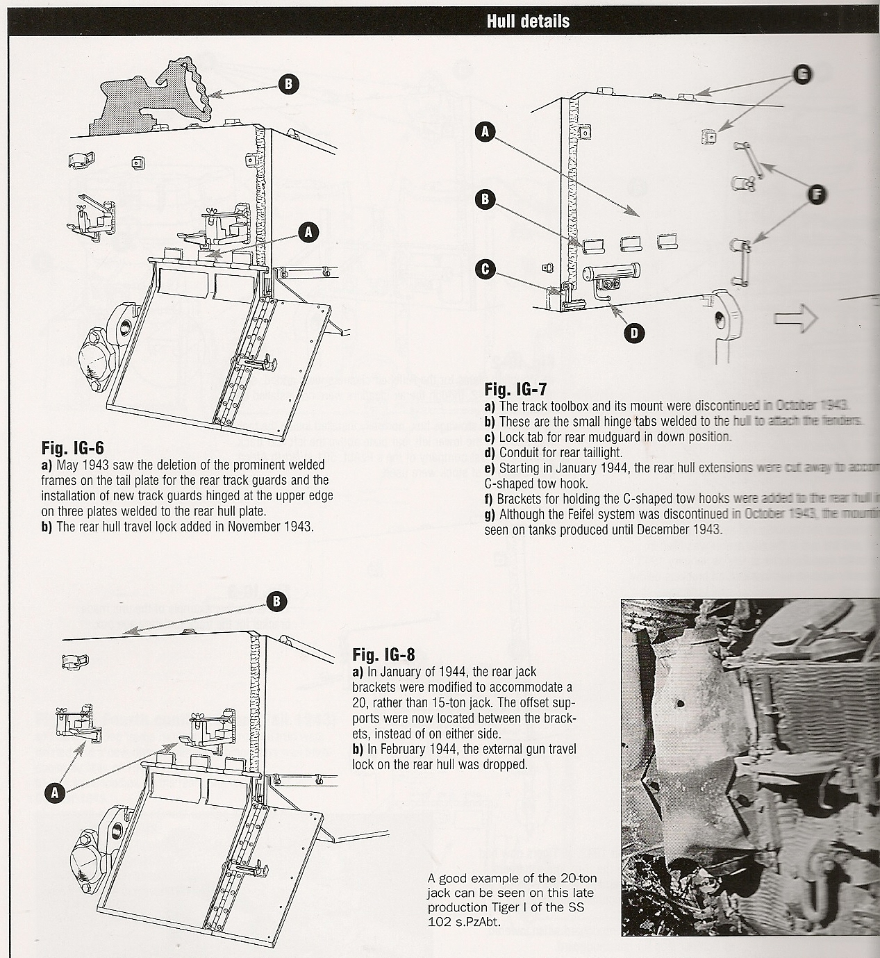

- Has liked: 1038 times
Vince, to quote Jentz and Doyle:
"In May 1943, the frames welded to the hull rear as a base for the rear track guards, were dropped. They were replaced by new hinged rear track guards (with cut-outs for the convoy light), supported by three hinge plates welded directly to the hull rear".
I haven't forgotten your reference for Dunkelgelb.
- Has liked: 790 times
Thank you Stephen for coming to my rescue. So, it is as I suspected. I have the book "Germany's Tiger Tanks" from those two authors but I could not find that page. Is that snapshot from some other book?
The kit mudguards are beautifully made and it is a pity not to use them. I will have to investigate the possibility of maybe modifying them. Failing that, I will have to see if after-market rear mudguards for a late Tiger are still available.
In this case I will start with the final assembly of the lower hull and take a decision on the mudguards later on.

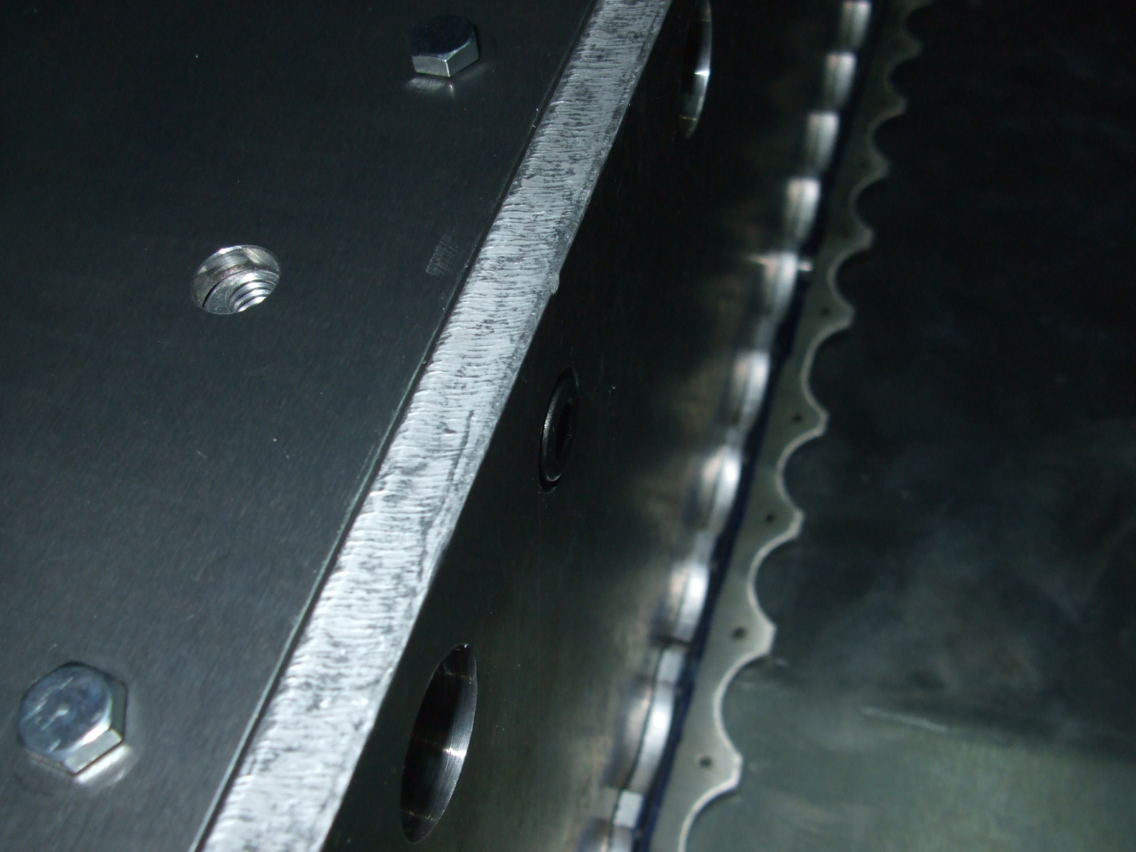

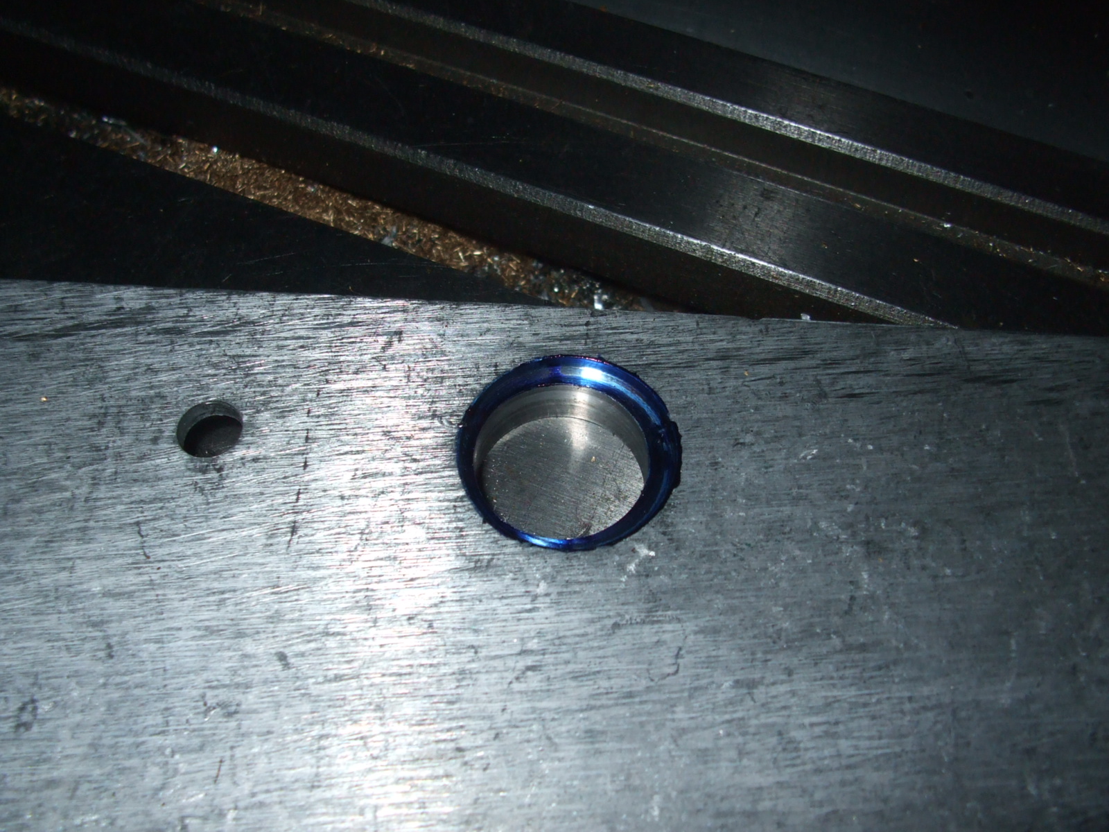

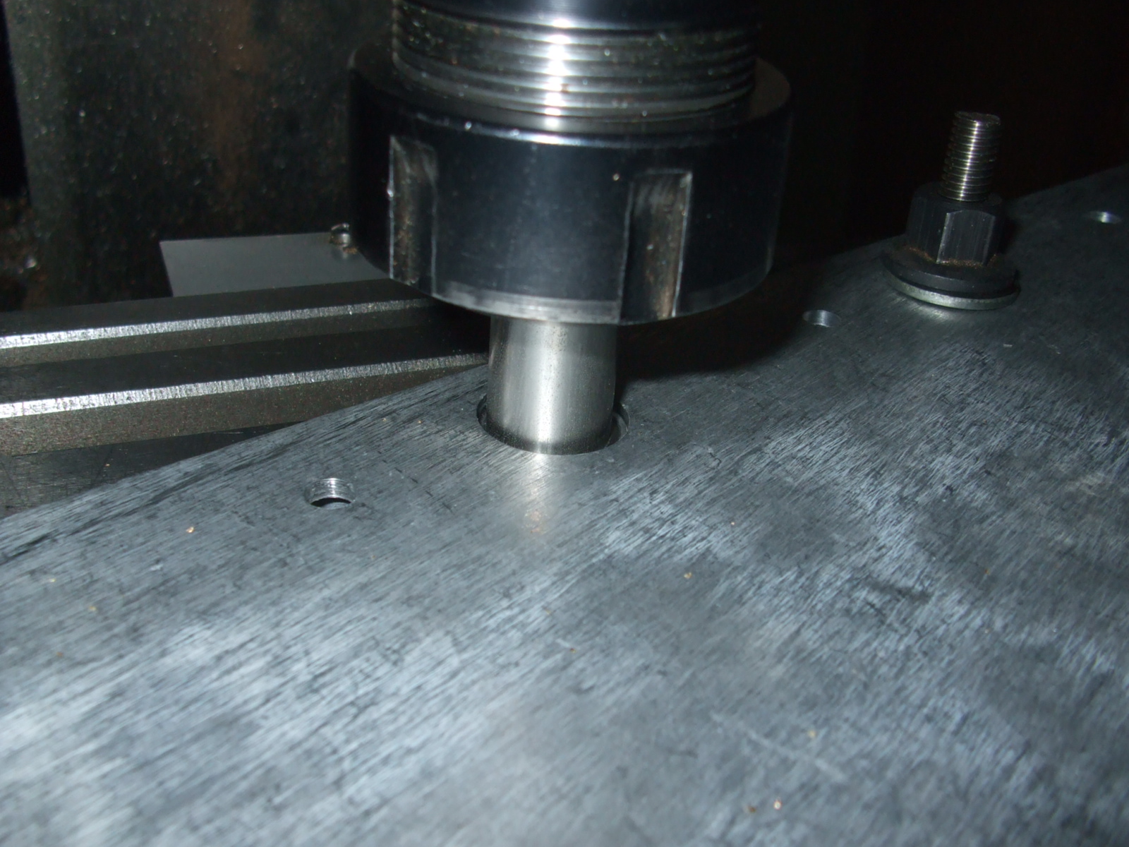

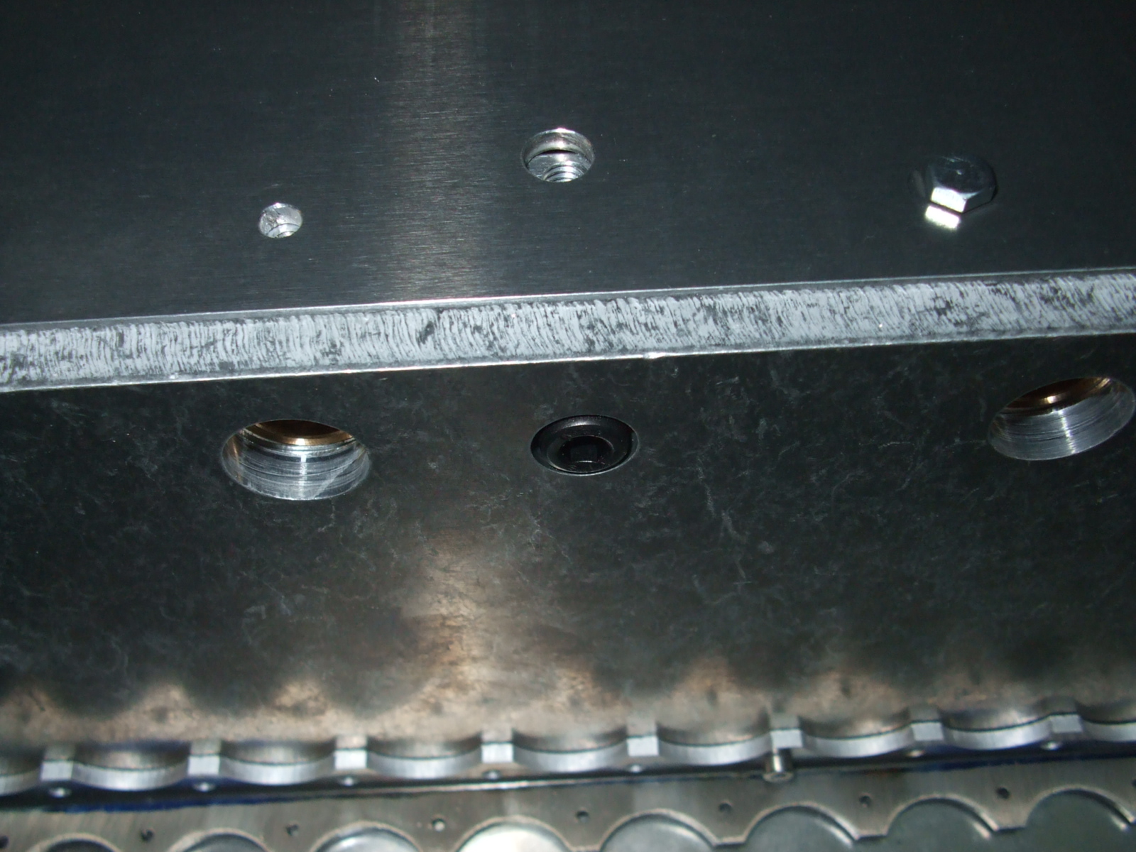

Yesterday I finally started the final assembly of the lower hull but ran into a problem.
I decided to fit the O rings also when bolting the suspension bar to the side of the hull. Just by chance I thought I would try one of the assembled swing arms in the various holes to see how they fit. One side of the hull was not a problem but on the other side, the swing arm would not go in as much as the other side.
Had a look inside the holes with the problems and saw this:
Dismantled everything and found the reason for this problem. The counterbore for the O ring was not concentric with the shaft hole. Discussed the situation with Kian and eventually he suggested two options:
- Leave the O ring out
- Counterbore the holes and use a different thickness of ring
I advised him that prior to considering any of those two options I was going to try centering the counterbore with a boring head. This morning took the boring head out but was not looking forward to setting it up. I had a look in my box of milling cutters and there it was at the bootom of the box. A 19mm end mill. The diameter of the counterbore was measured to be around 19.5mm. No harm in trying 19mm with the cutter first and see how it goes.
Another trial fit with the swing arm. Perfect. The other seven holes took less than 30 minutes to correct.
