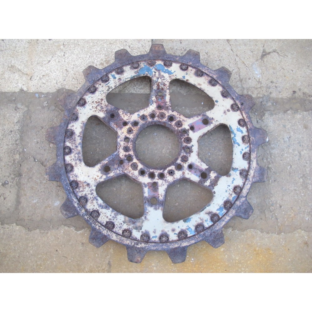

Hi Martin,
Wow! That is some impressing work, my hats off.
Is this steel sprocket someting you might consider offer selling to us other Panther/JP nuts, specially us with Vincents steel tracks?
I have one minor observation if you dont mind me asking....the outfit of the six hole in the outer sprocket ring.
I showed how I changed my own size of them many years ago here on the forum:
(scroll down a bit)
http://www.armortek.co.uk/Forum3b/viewt ... 3&start=15

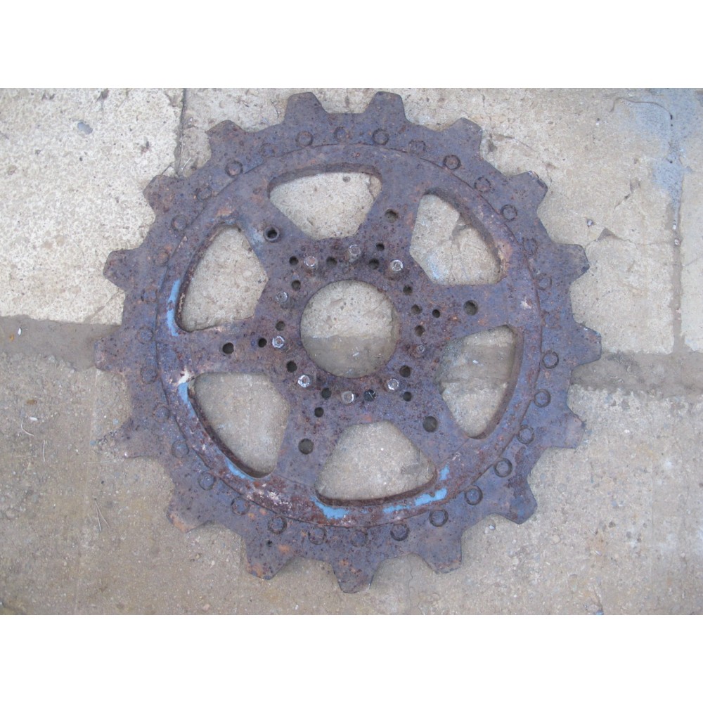

Also add some picks of the real thing below.
Keep up the good work, very interesting to follow.
(scroll down a bit)

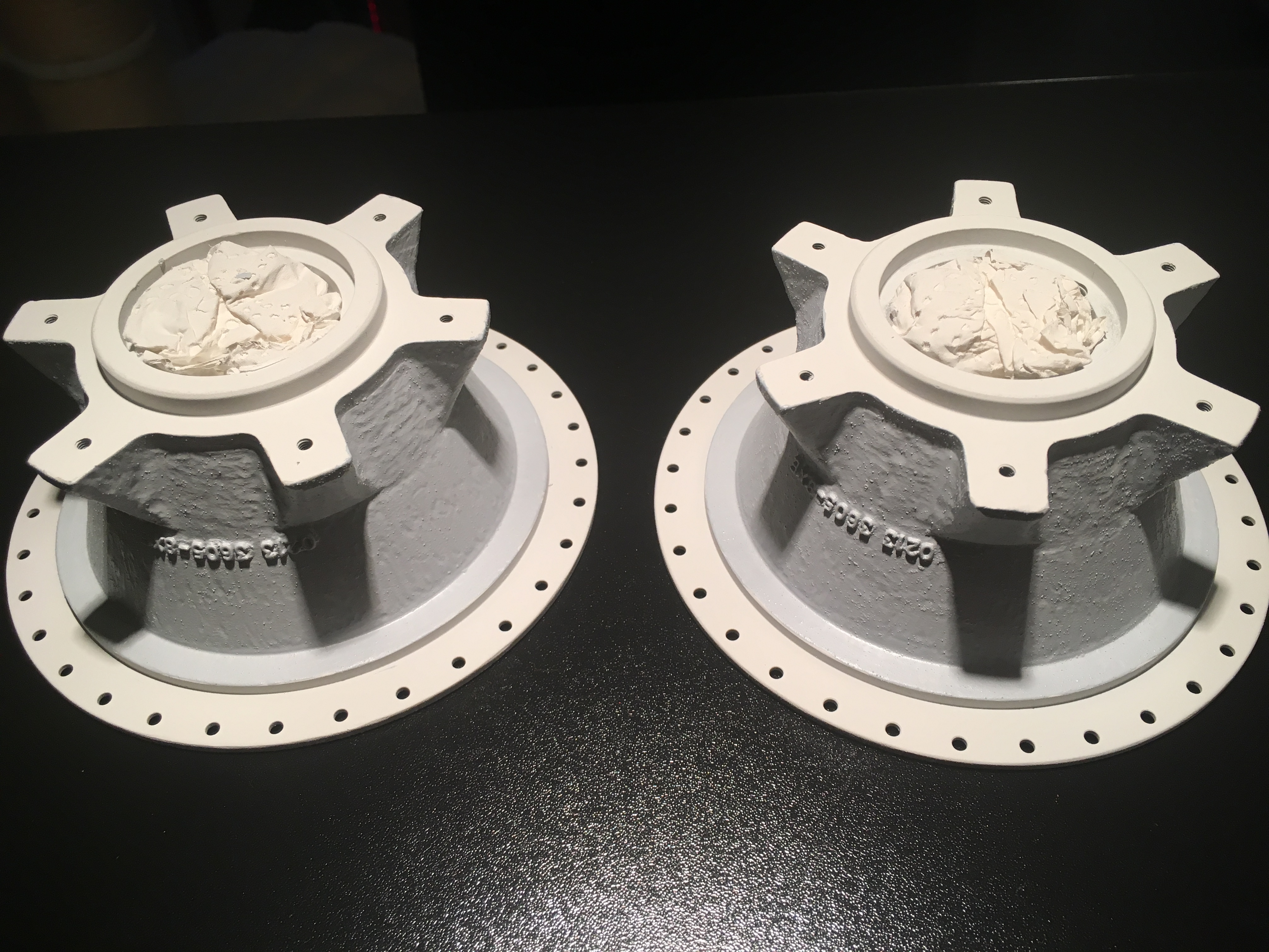

Re: Martin's Jagdpanther

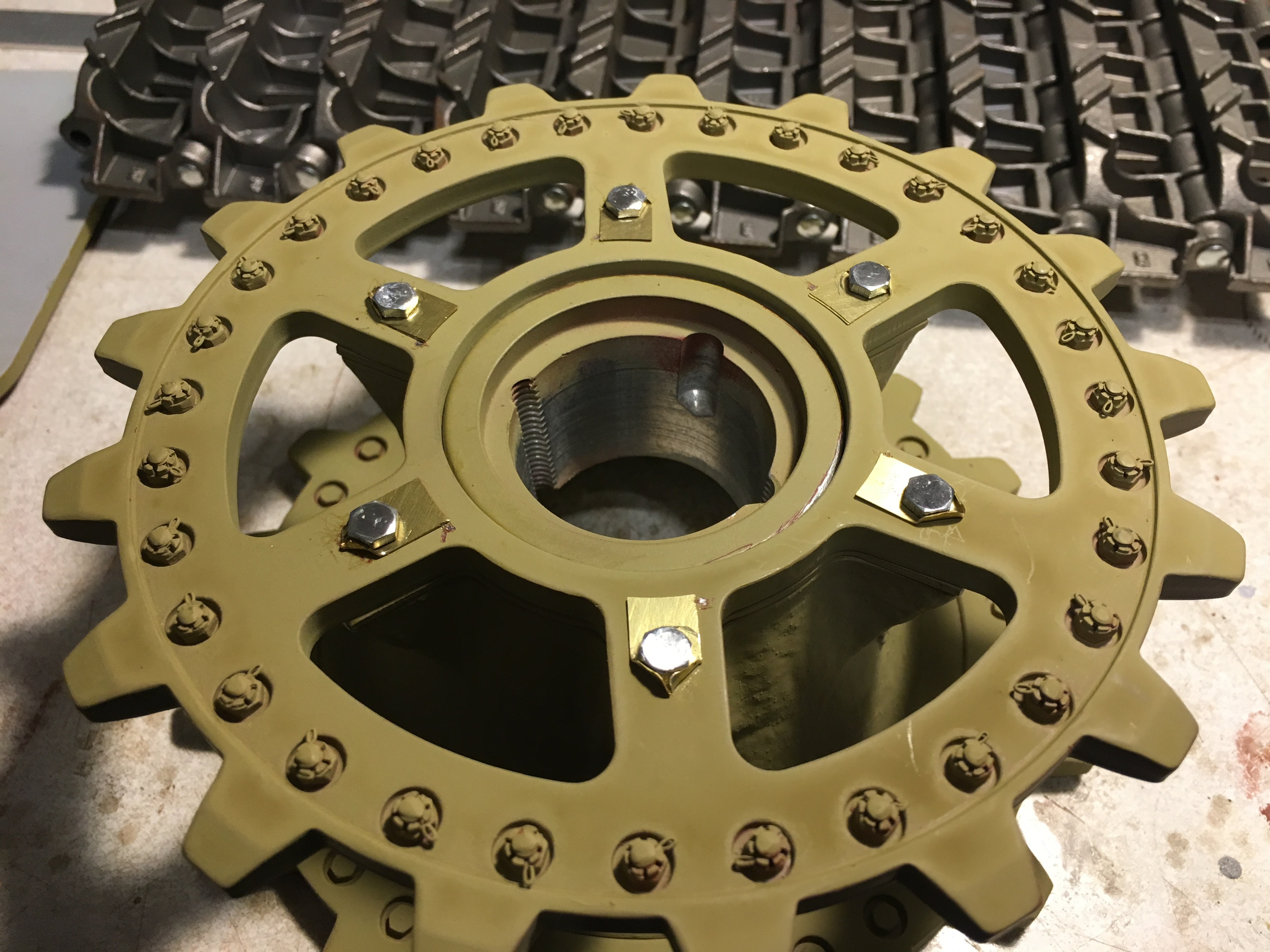

Hi Kent,

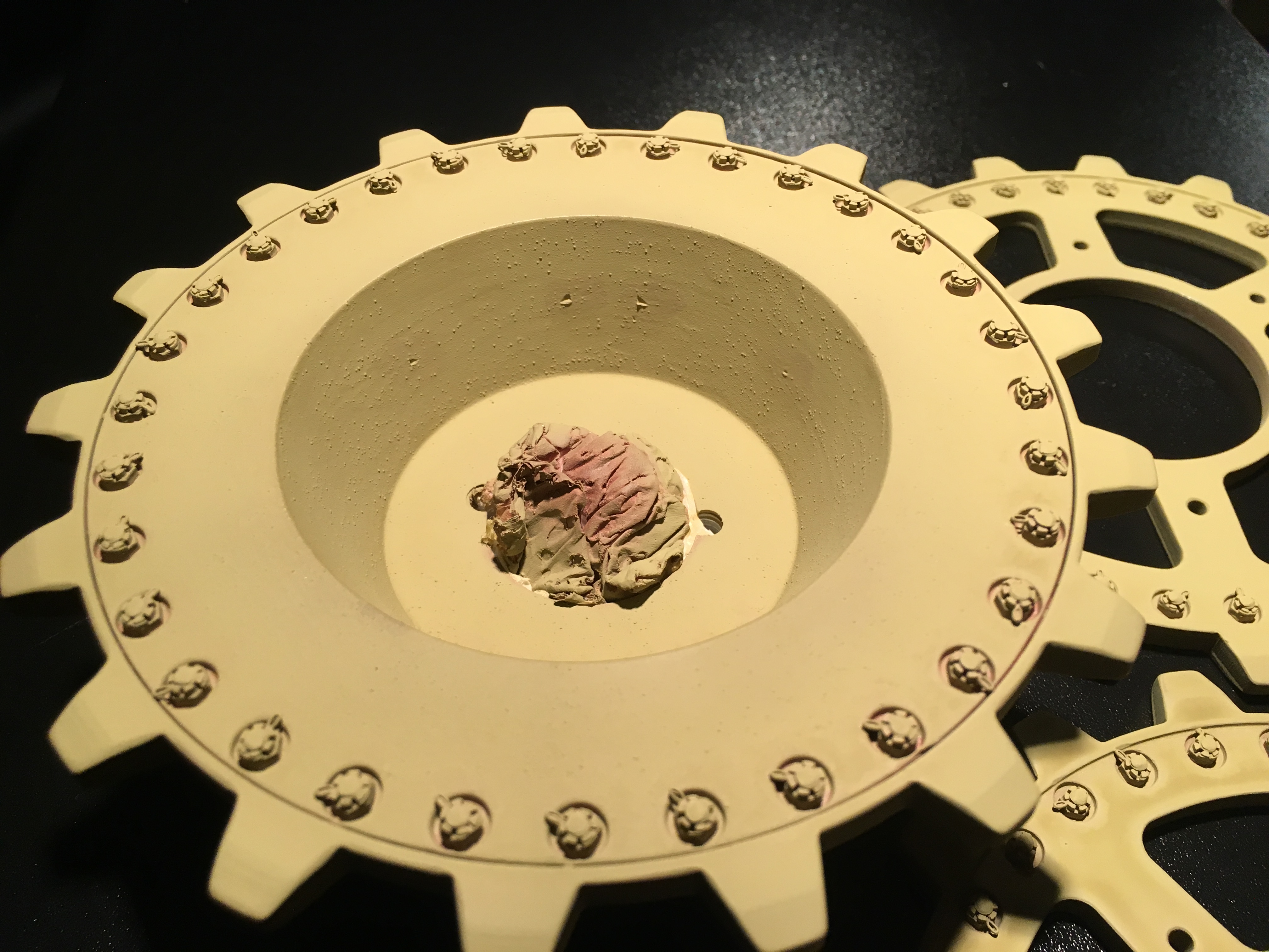

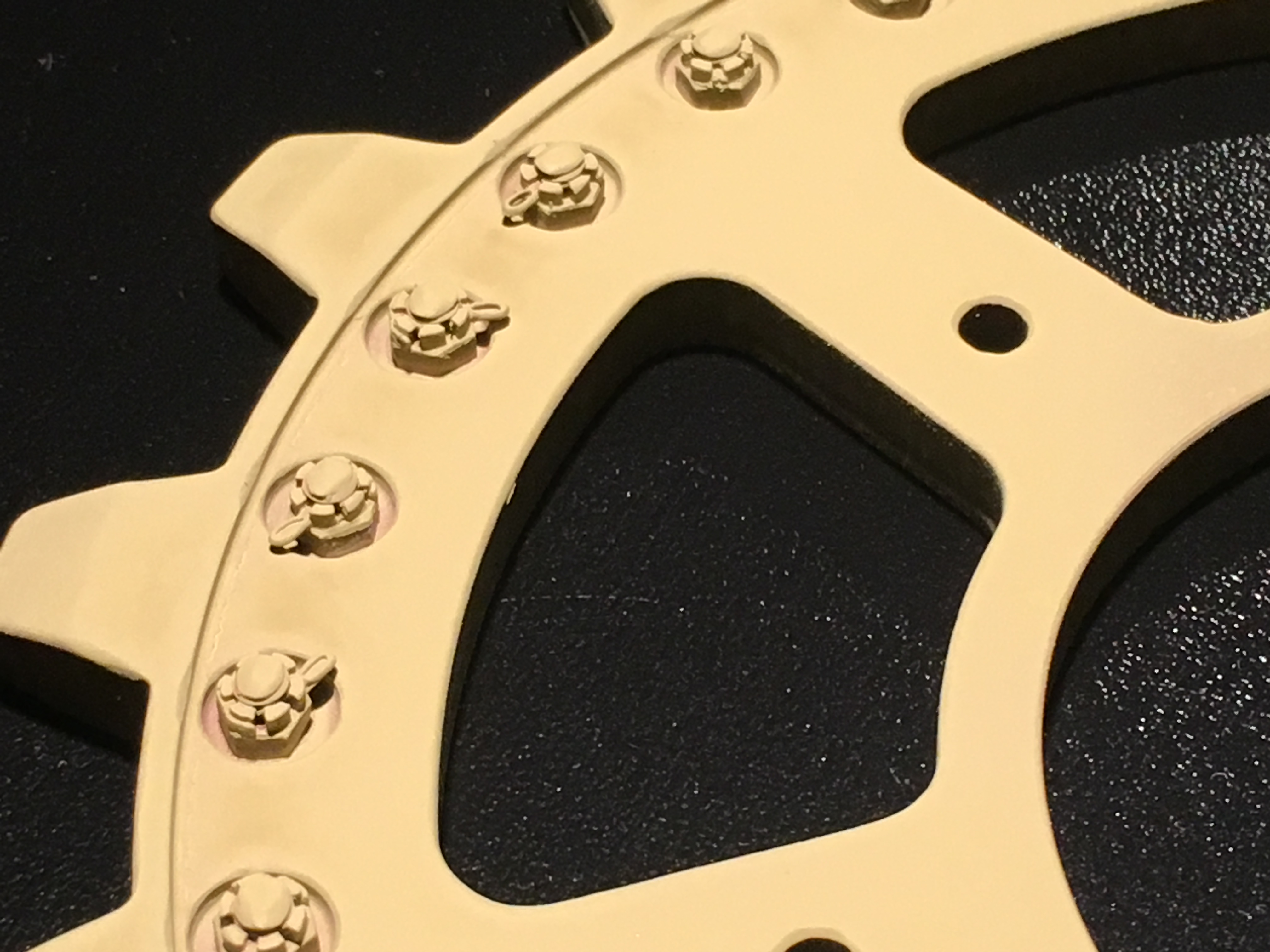

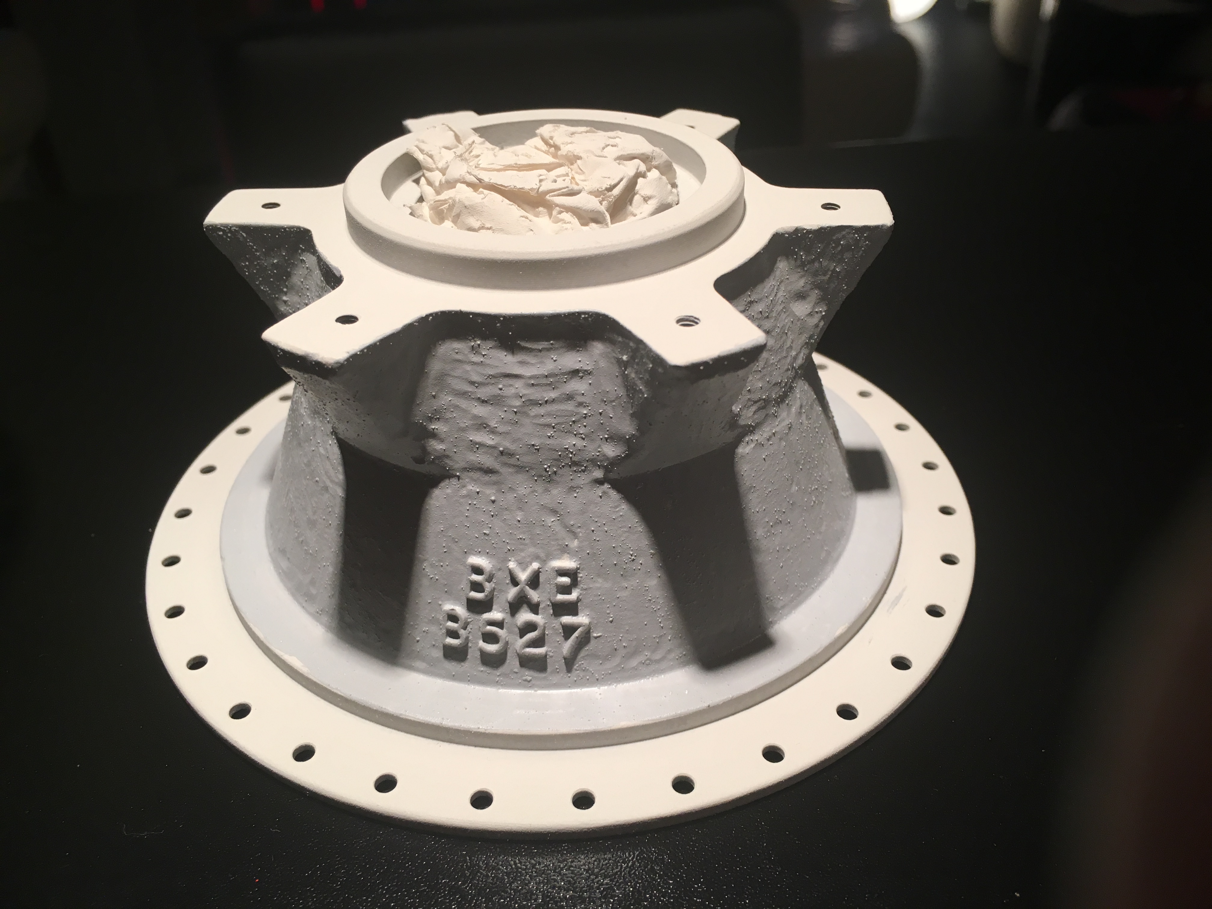

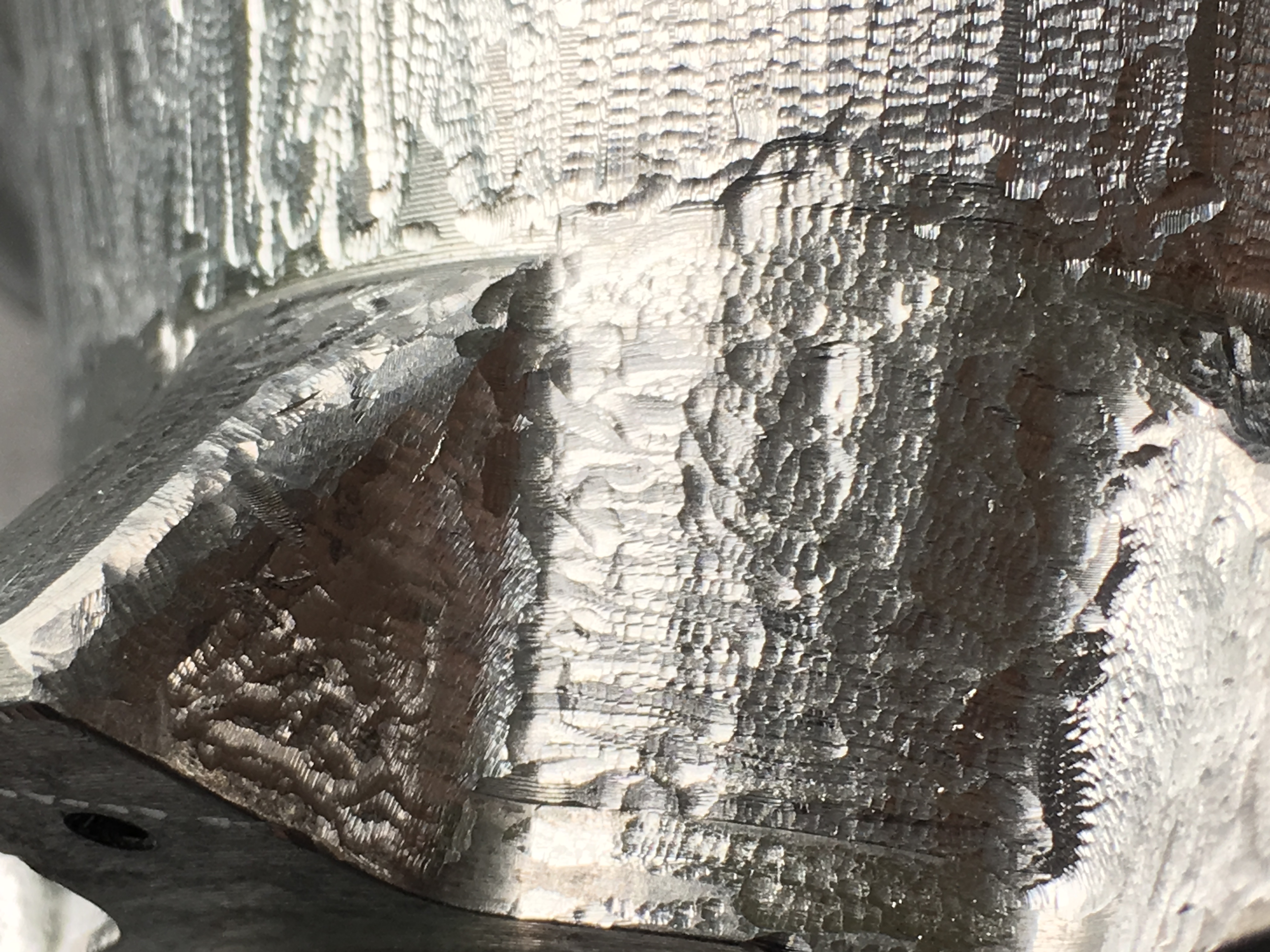

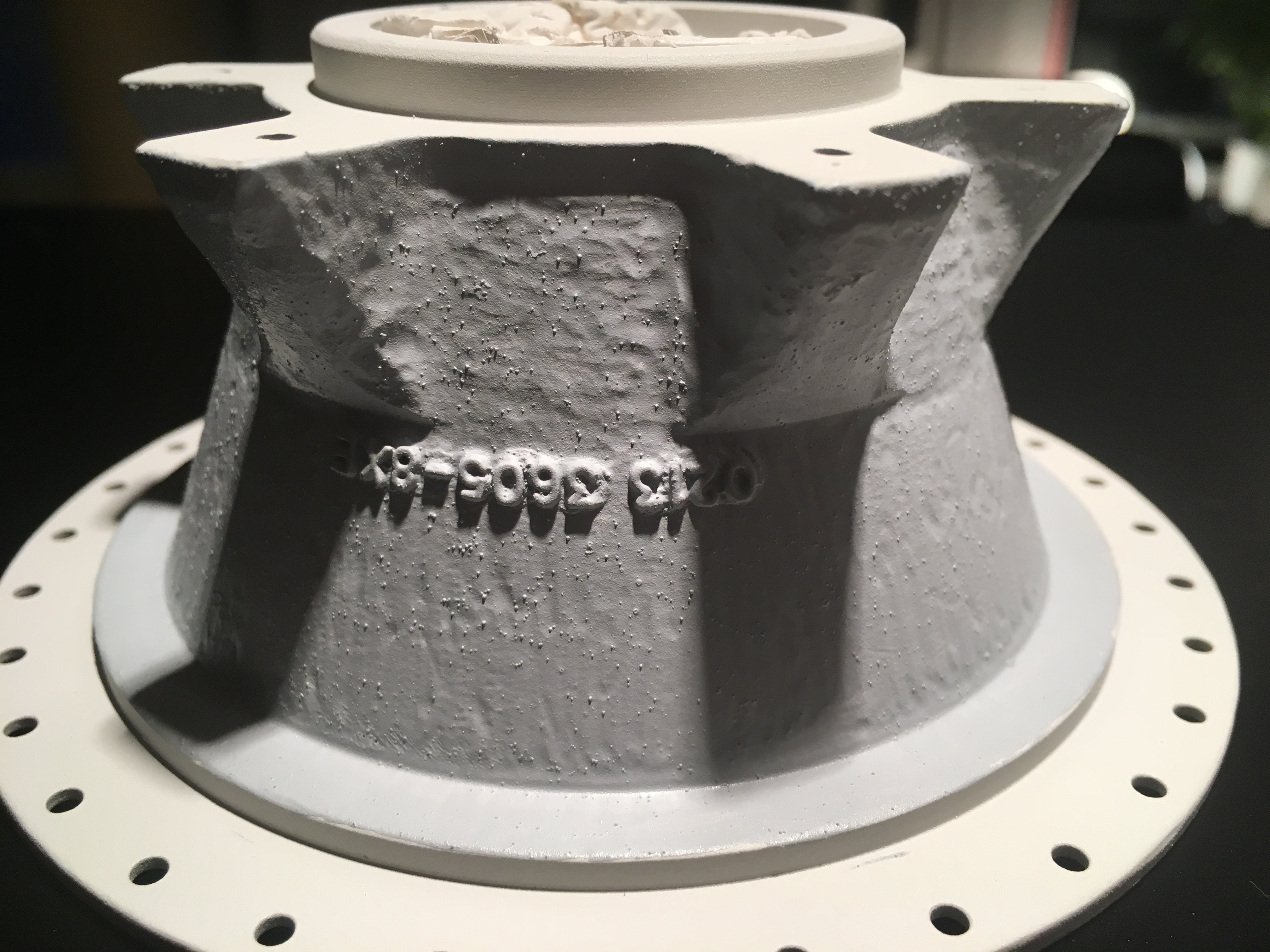

thank you for the nice words. I am sorry i do not sell any sprocket rings or sprockets made from steel. You can get the drawings for machining from me, so you can order some laser cutted parts ( drawings also here ) and find a shop for machining - or do it by yourself. Please send me a pm if you are interested.

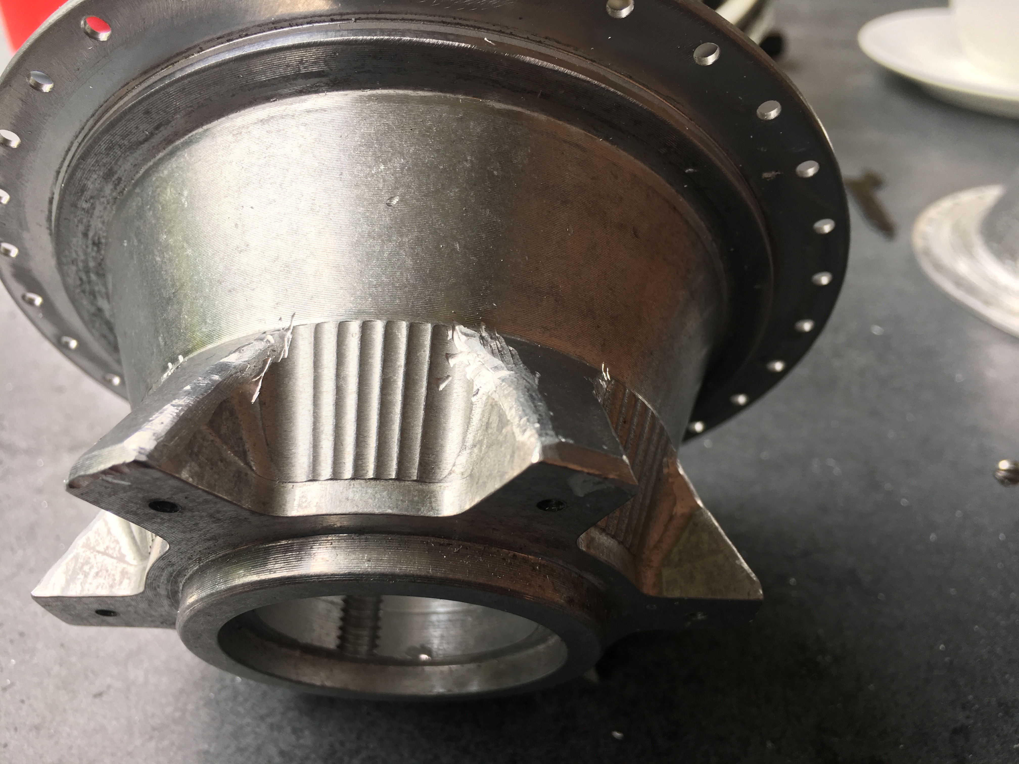

Here comes the next photos of the sprockets with some casting surfaces, destoying milling grooves and some casting numbers.
Regards Martin

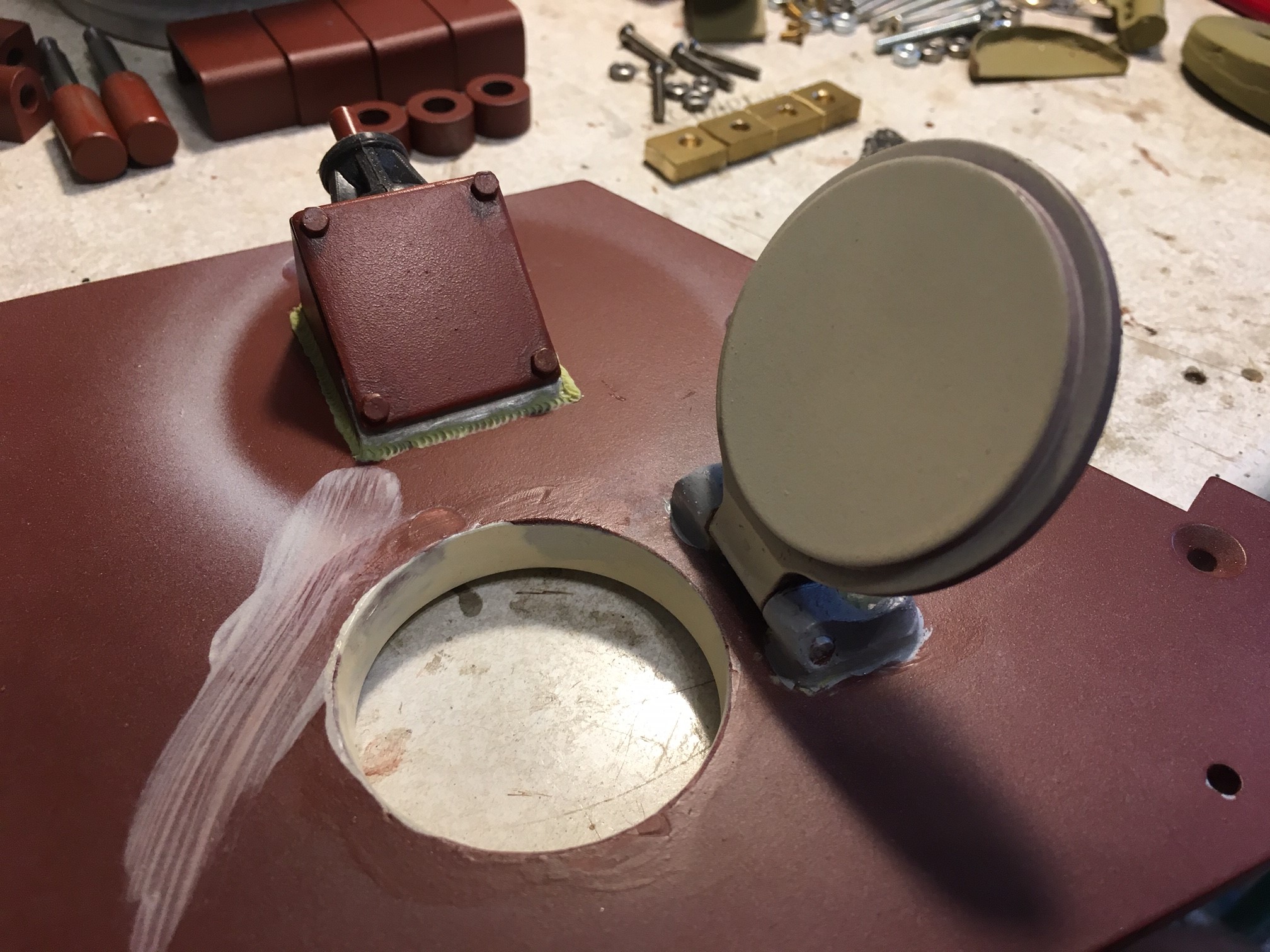

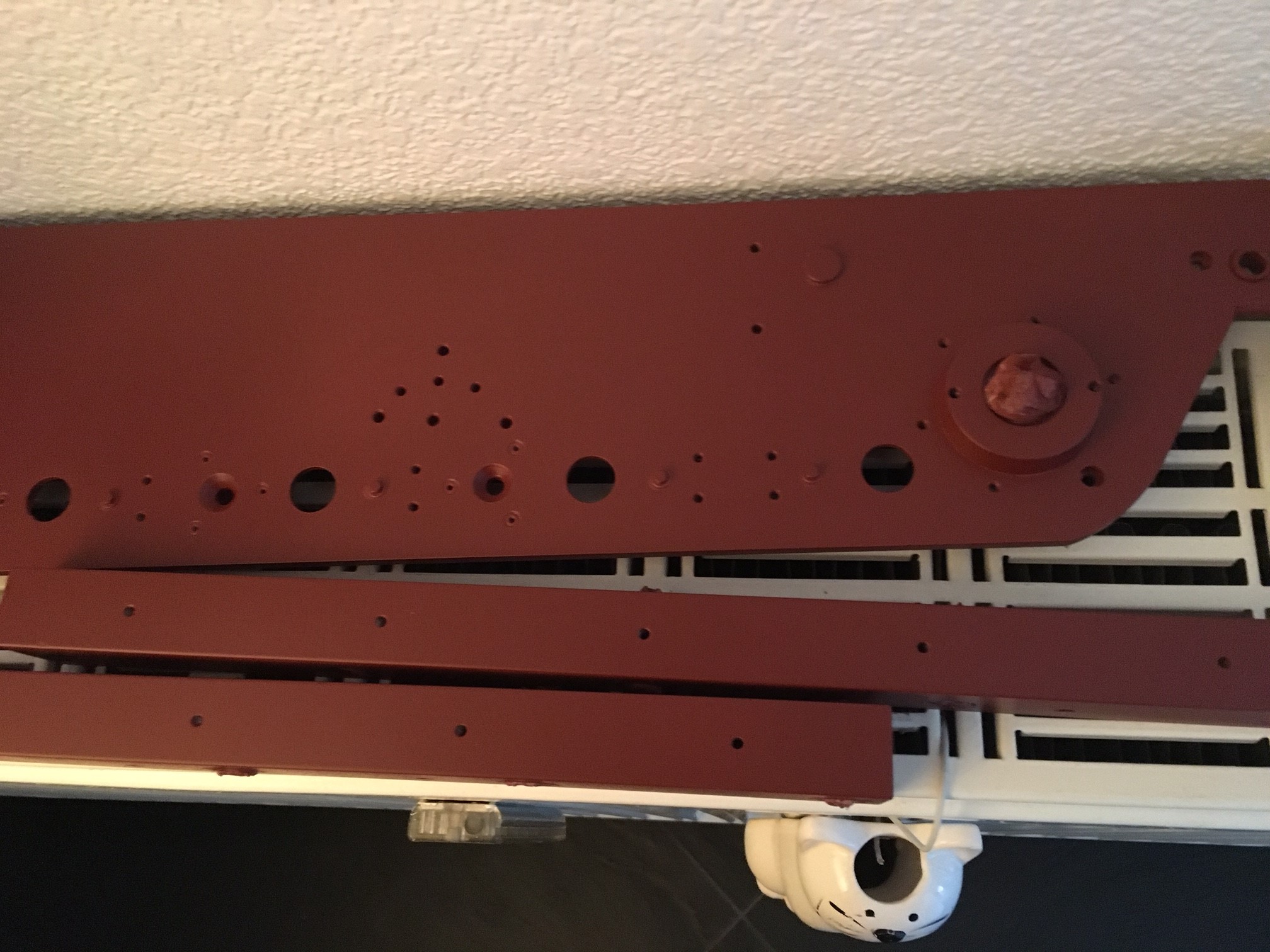

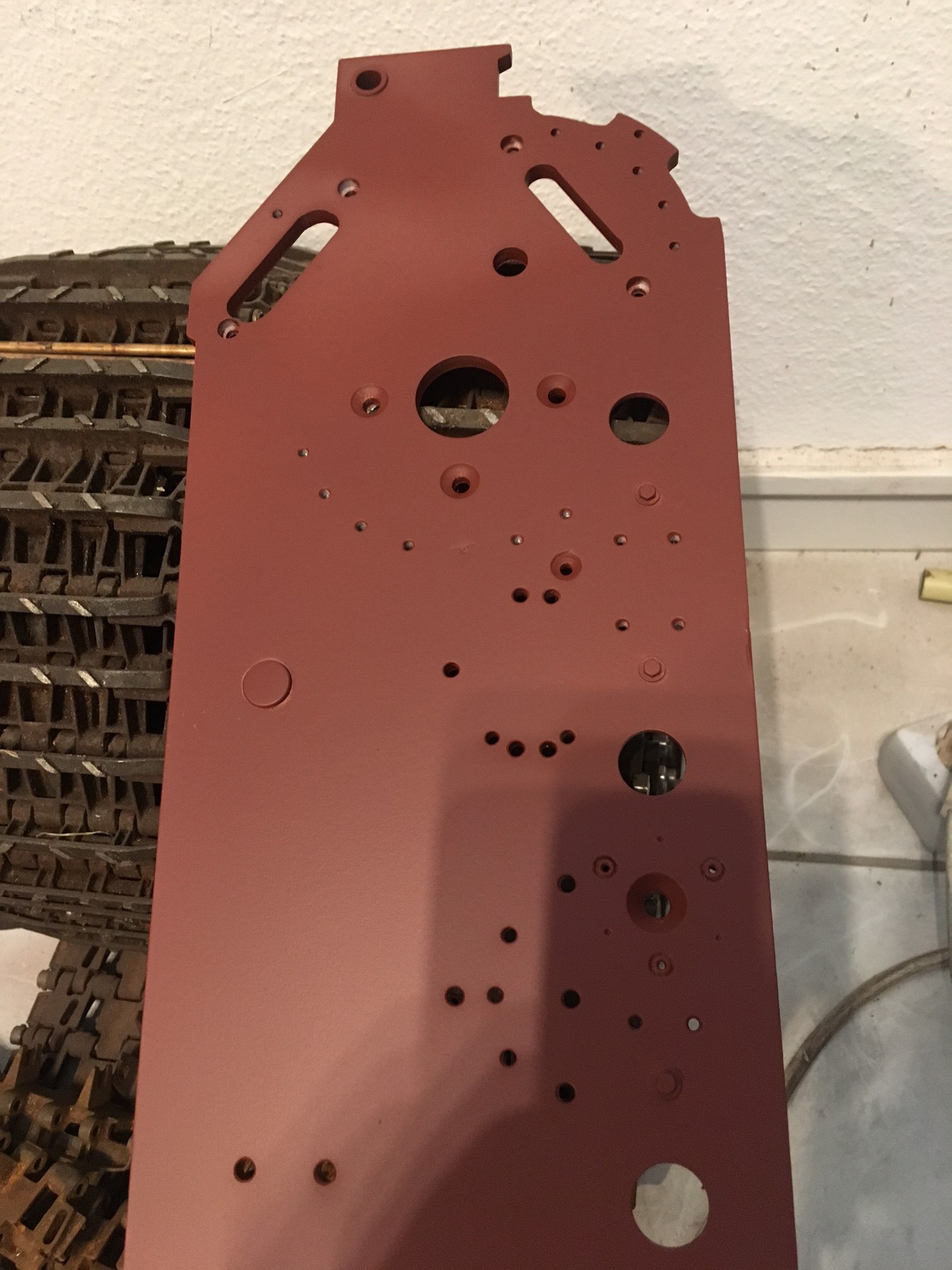

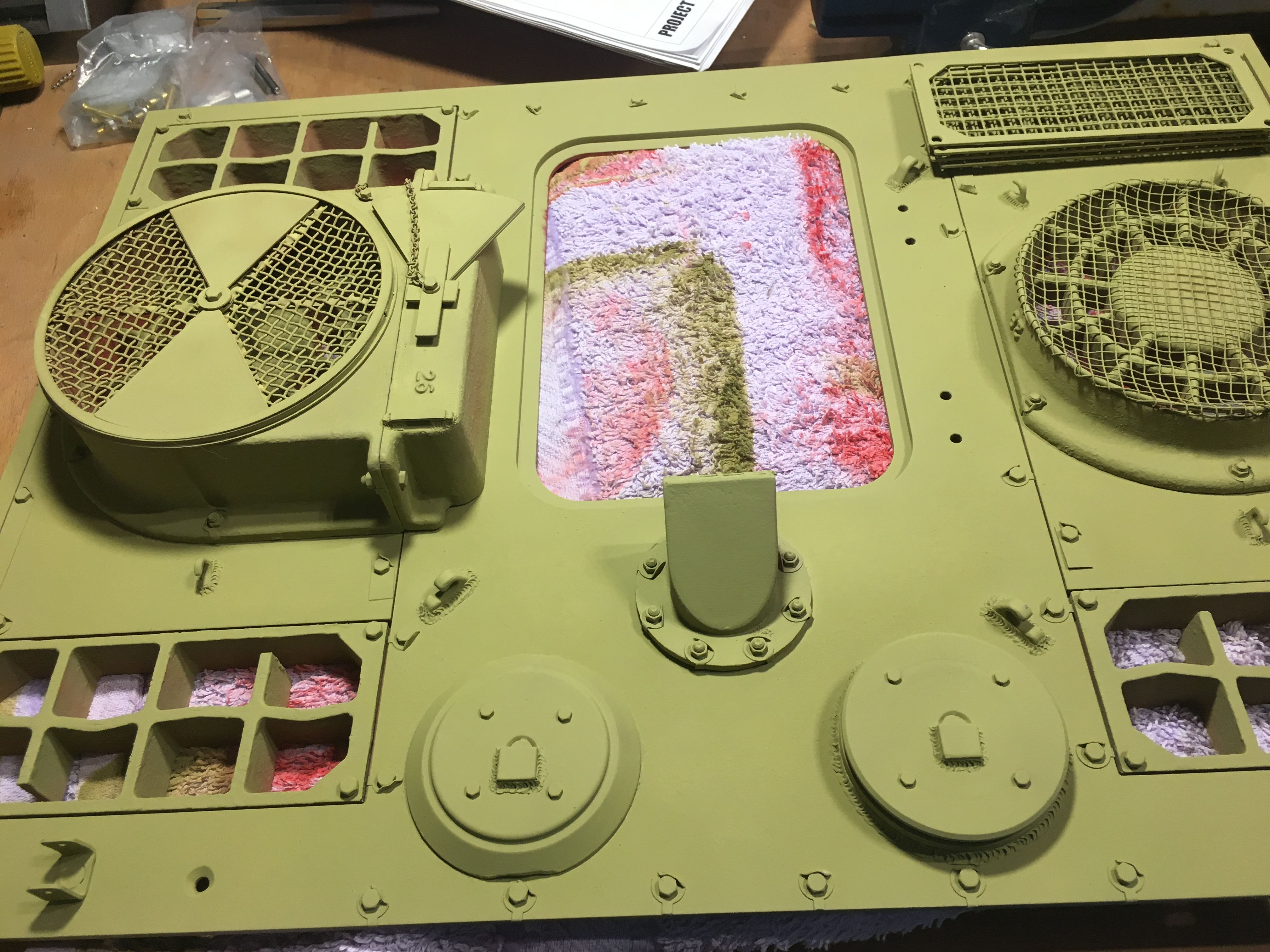

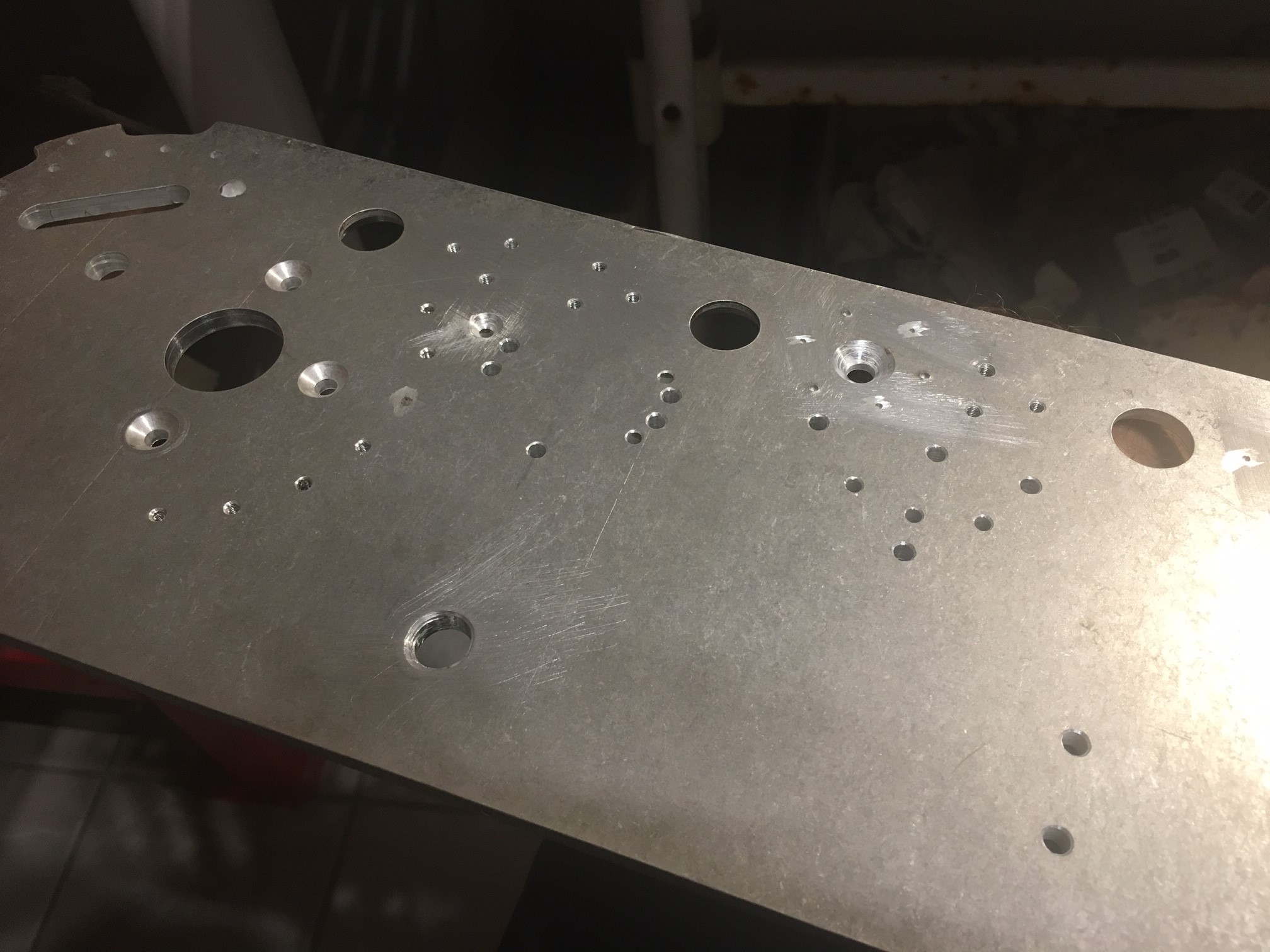

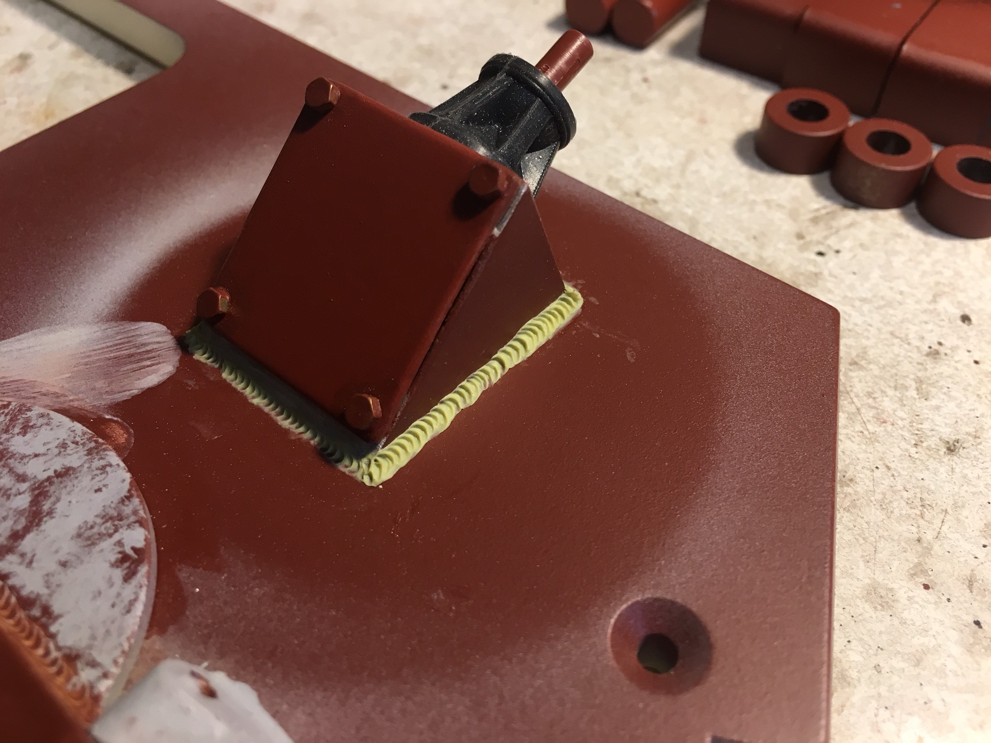

Now i have made more progress on the back plate and the ventilation grills.
Regards Martin

Excellent Dremel work on those Sprockets. Looks like real cast surface. Very cool work!
The steel sprocket rings are works of art! Beautiful.
Hi Phil,
hi Bob,

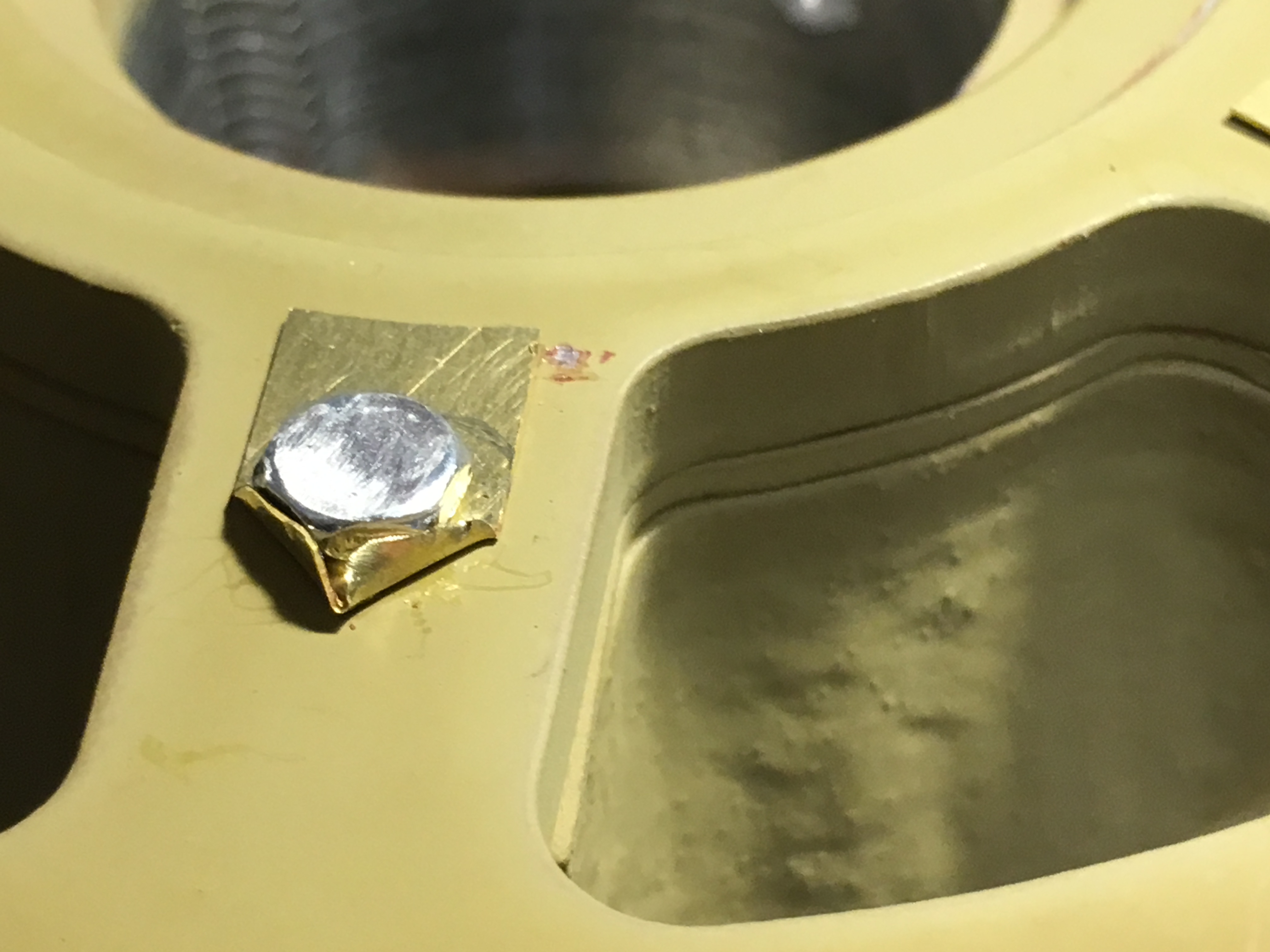

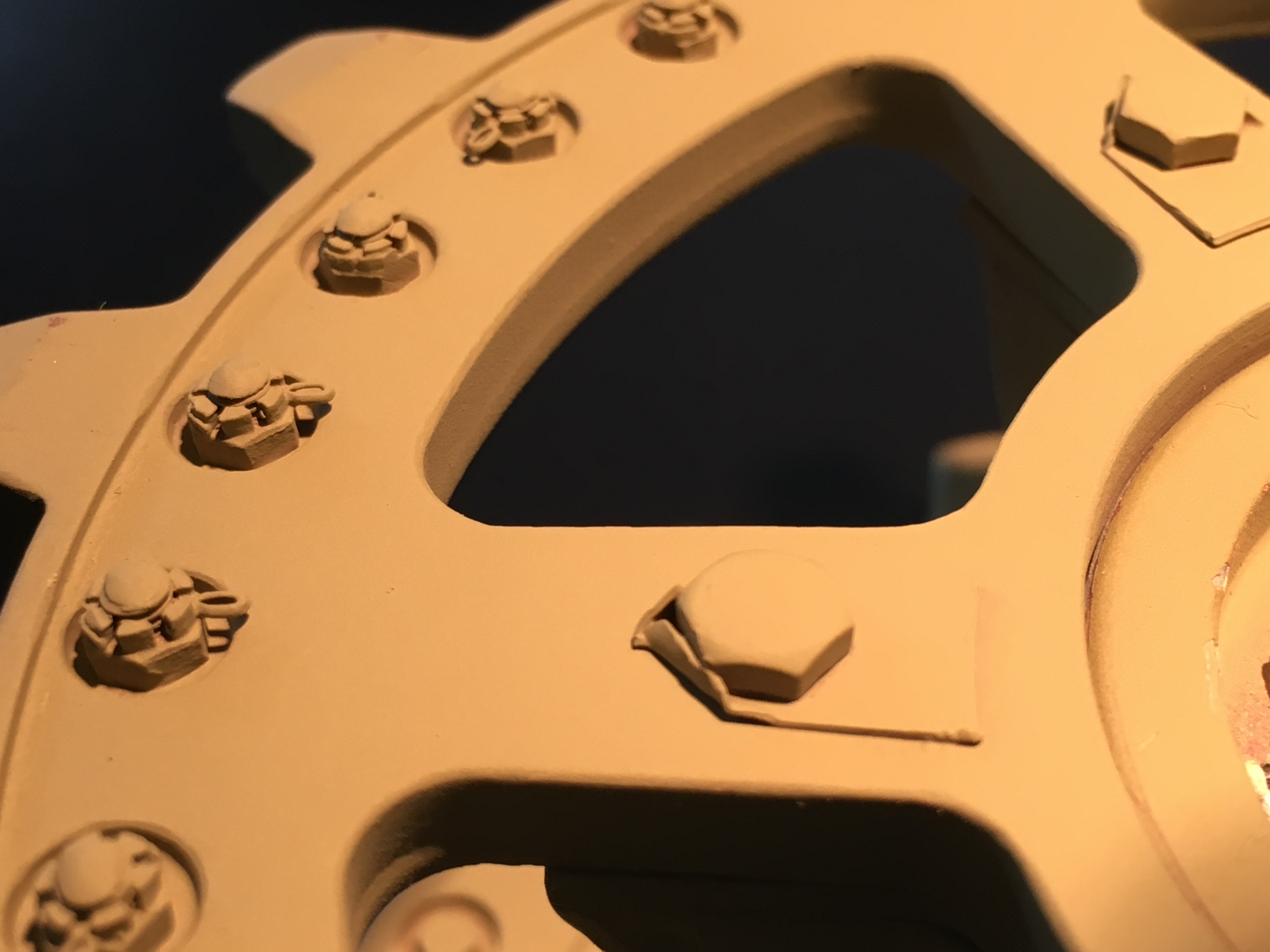

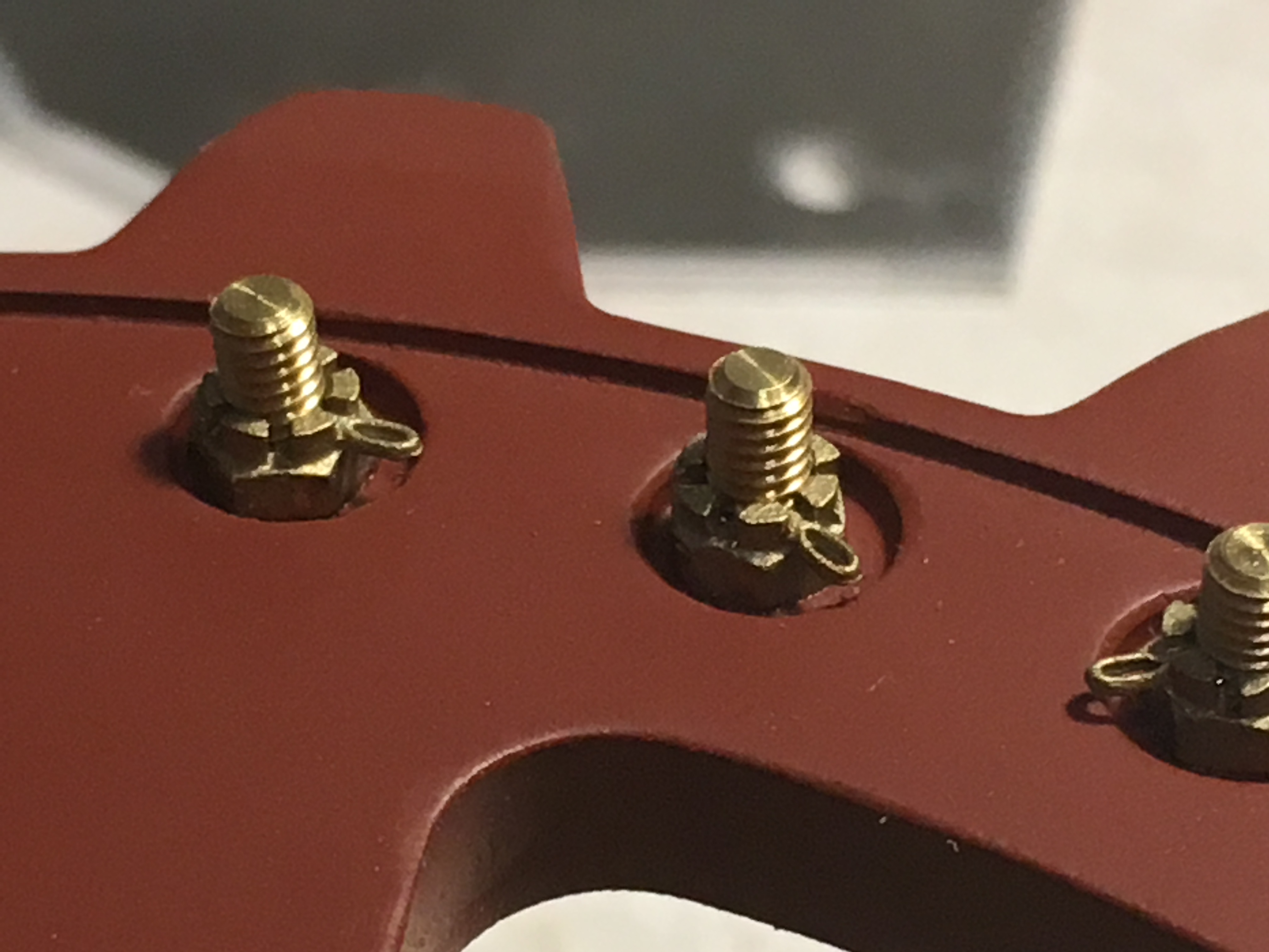

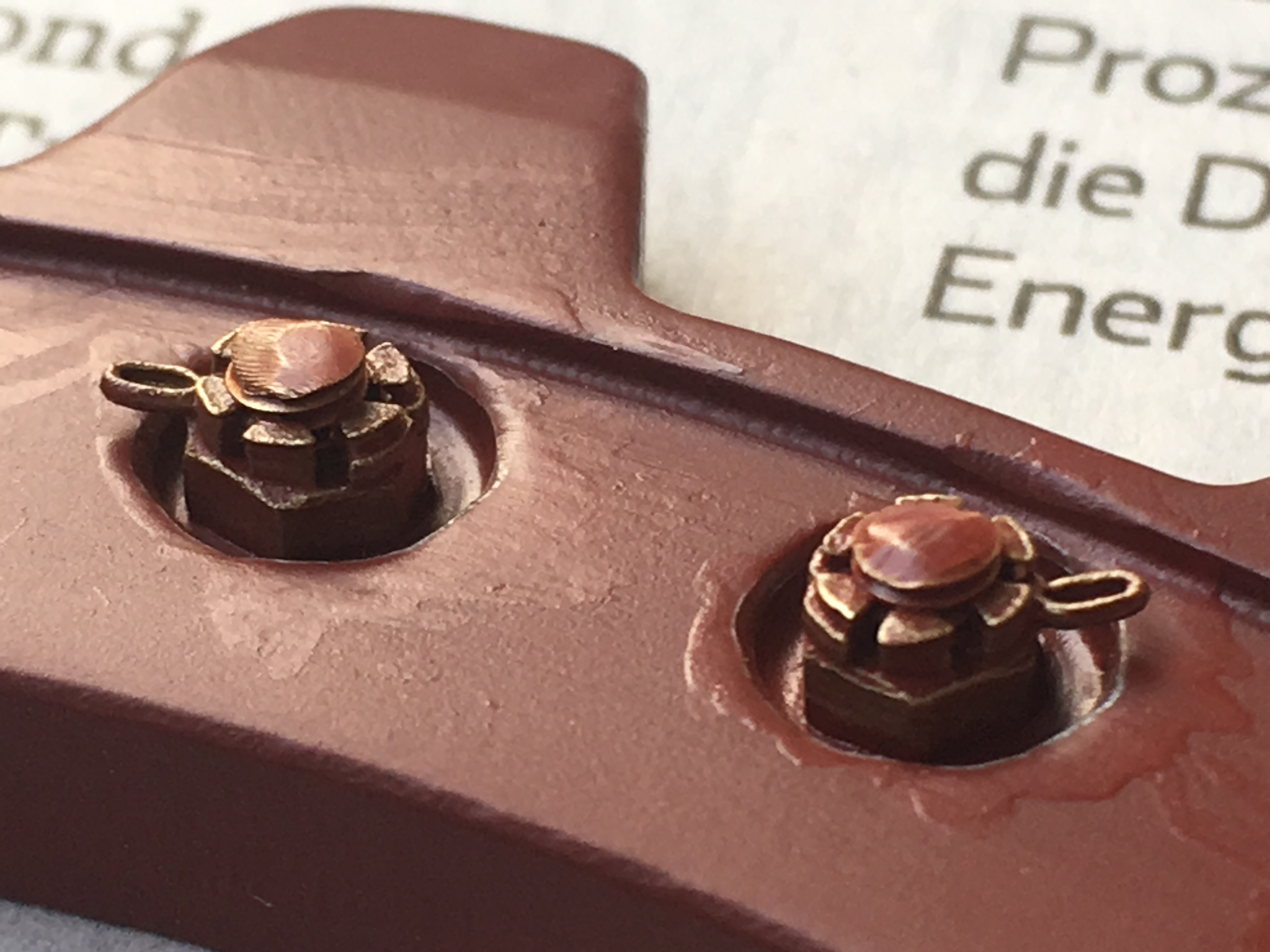

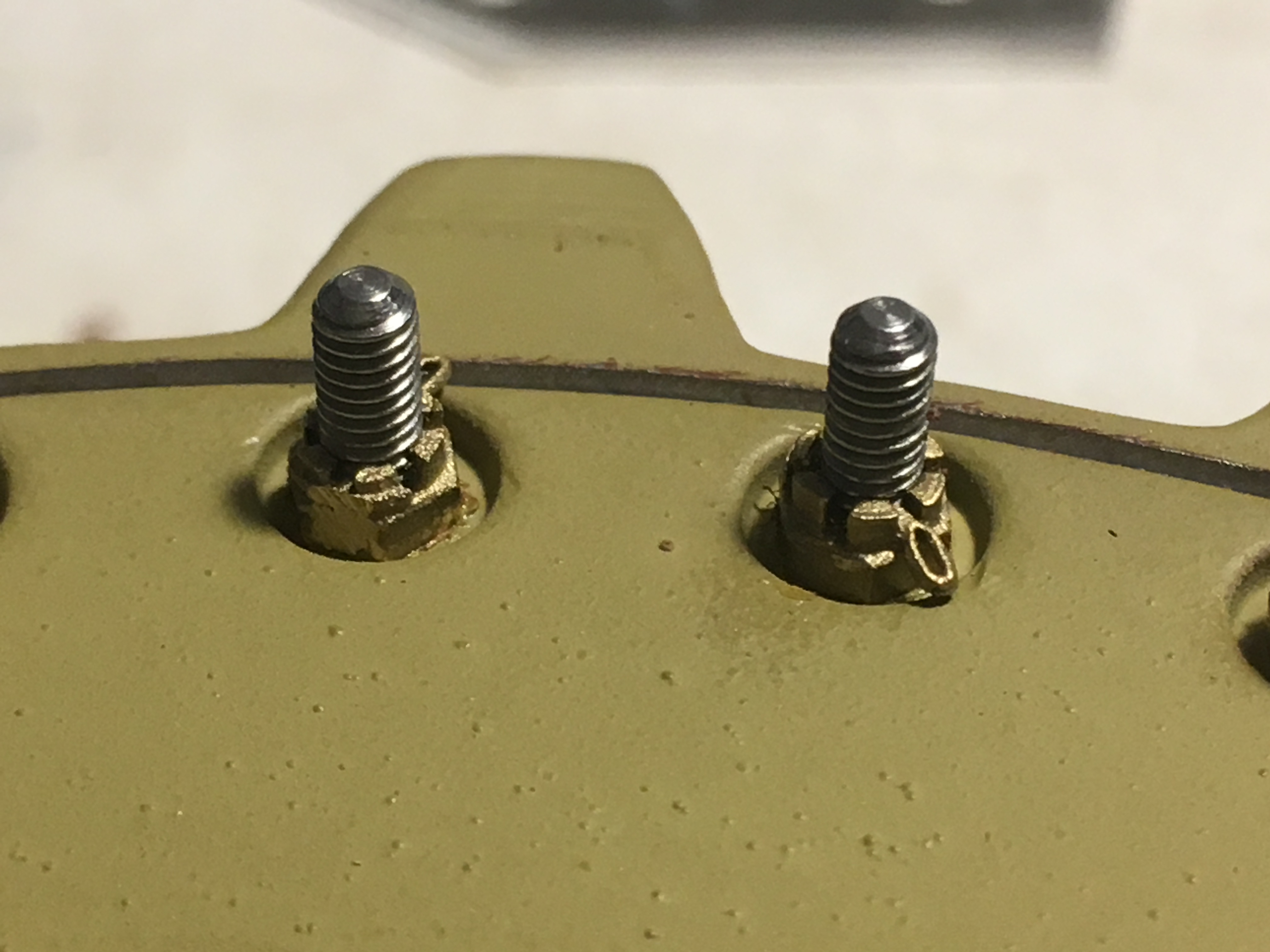

thank you for the compliments. Here are the next photos of the sprockets and the rings with all the screws and castellated nuts - also shorted to the correct length ( hard work to mill and deburr after without touch the nuts )
hi Bob,
Regards Martin

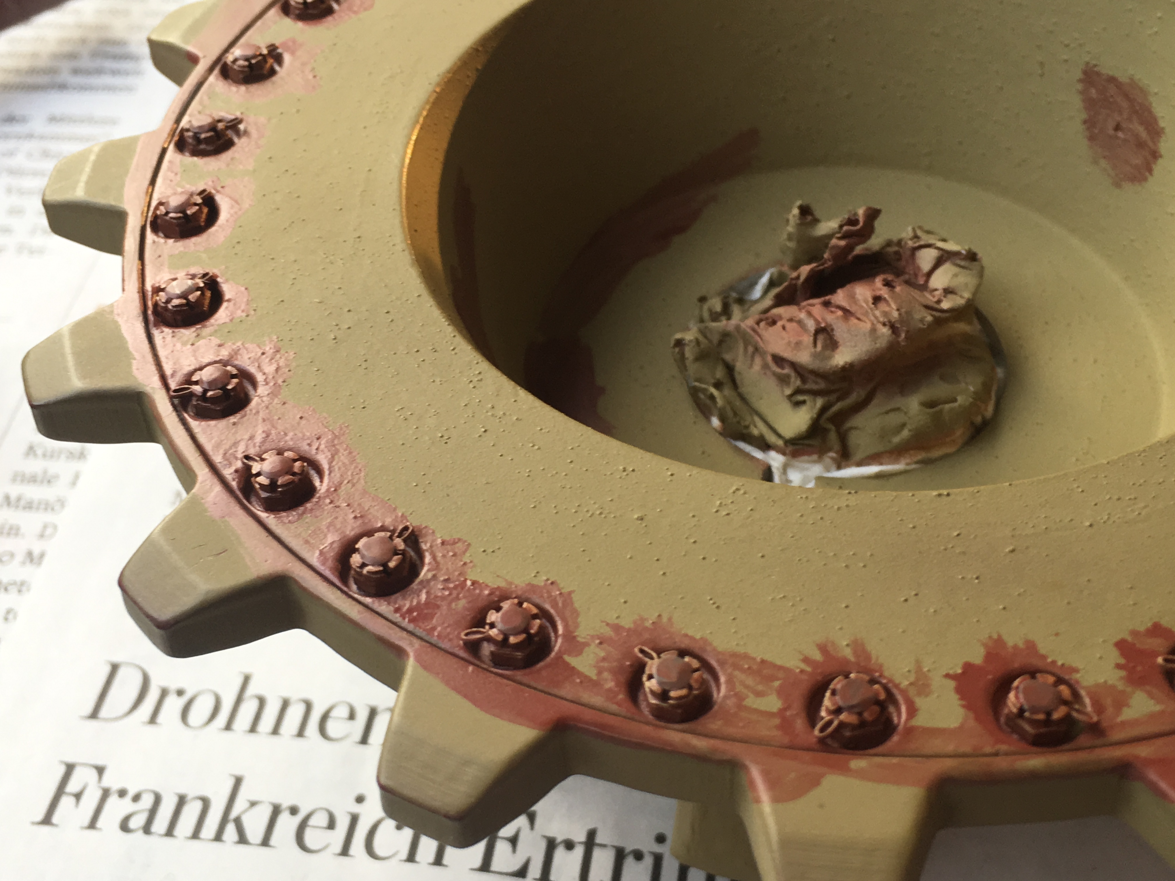

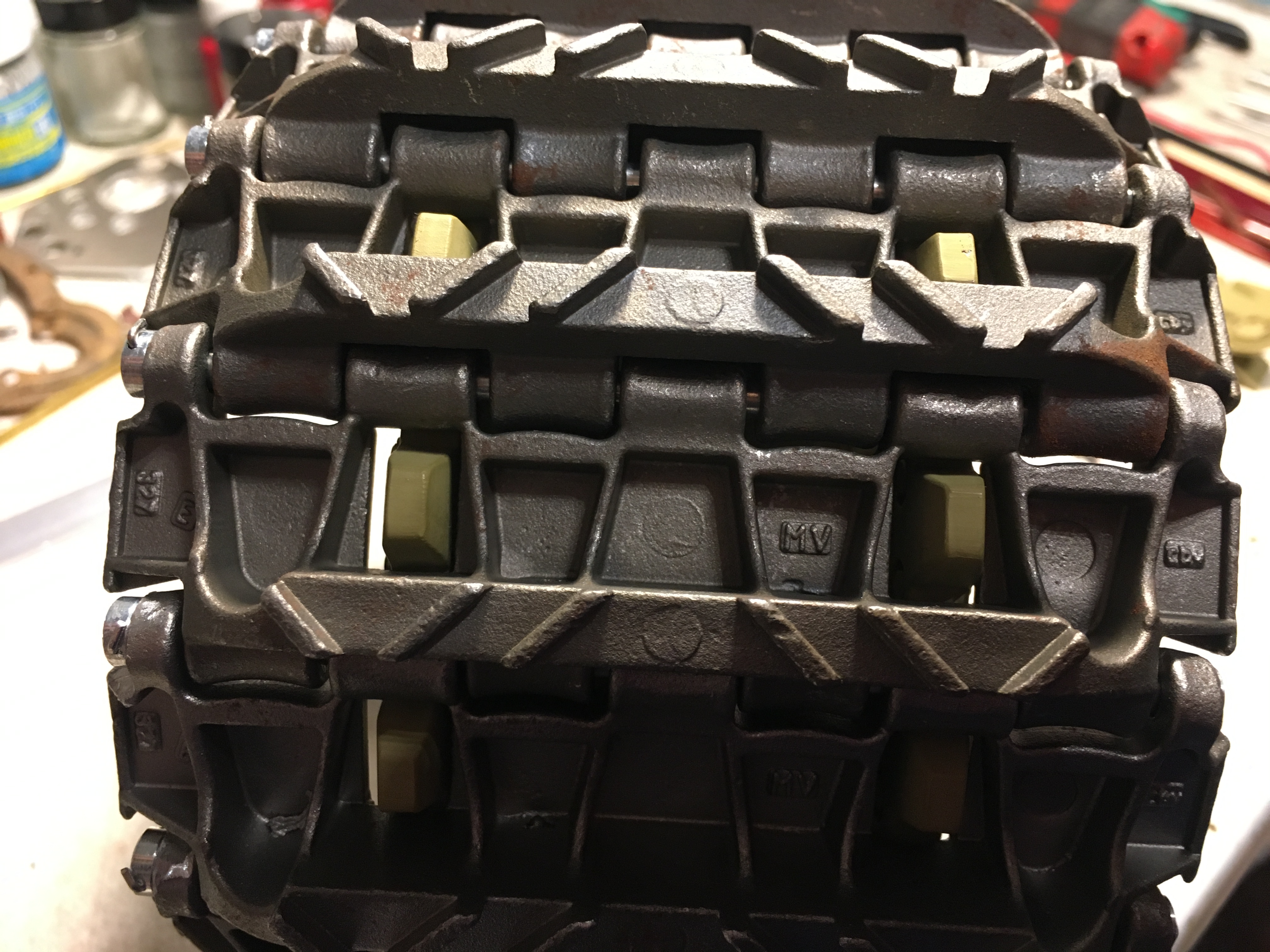

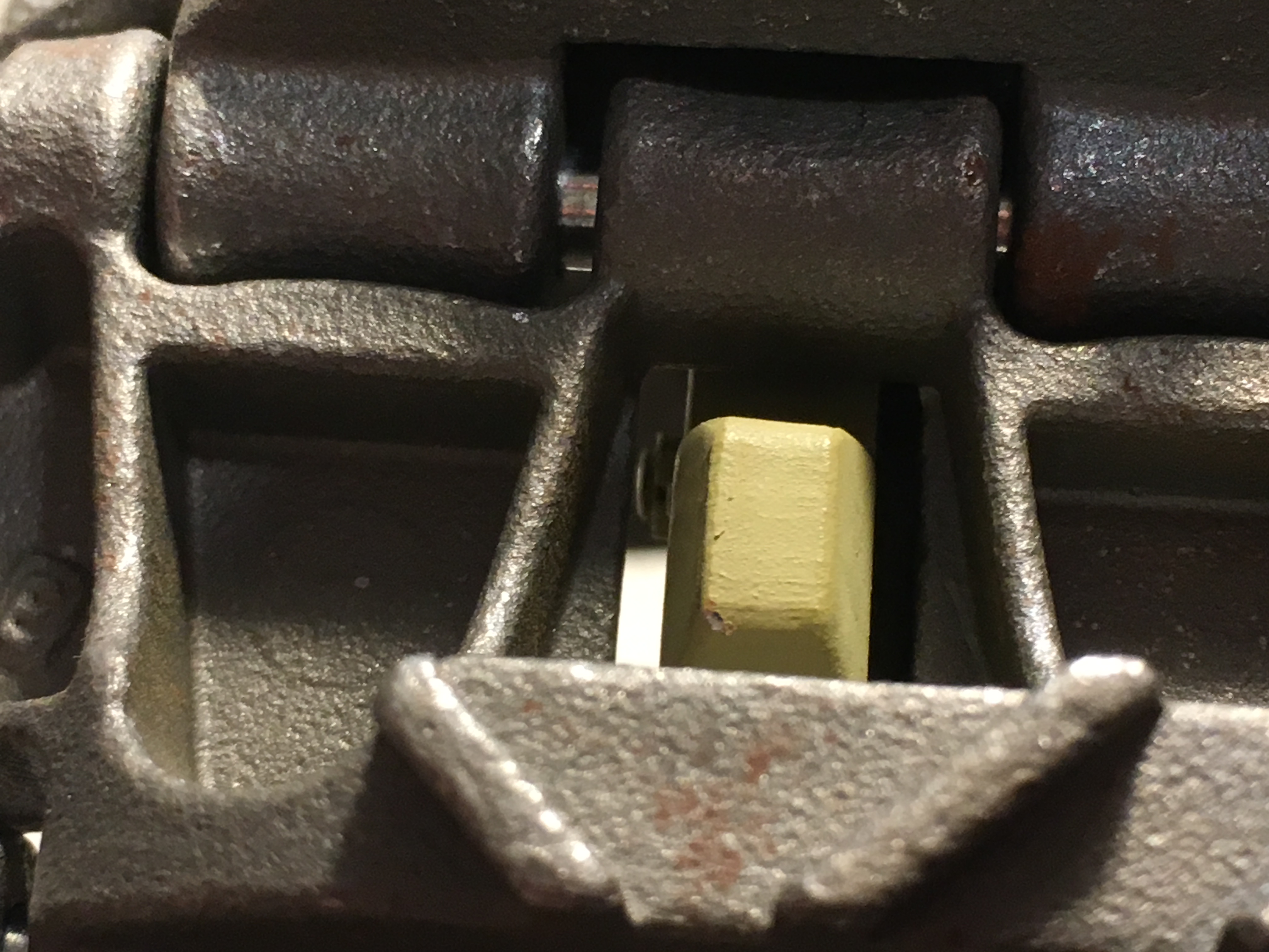

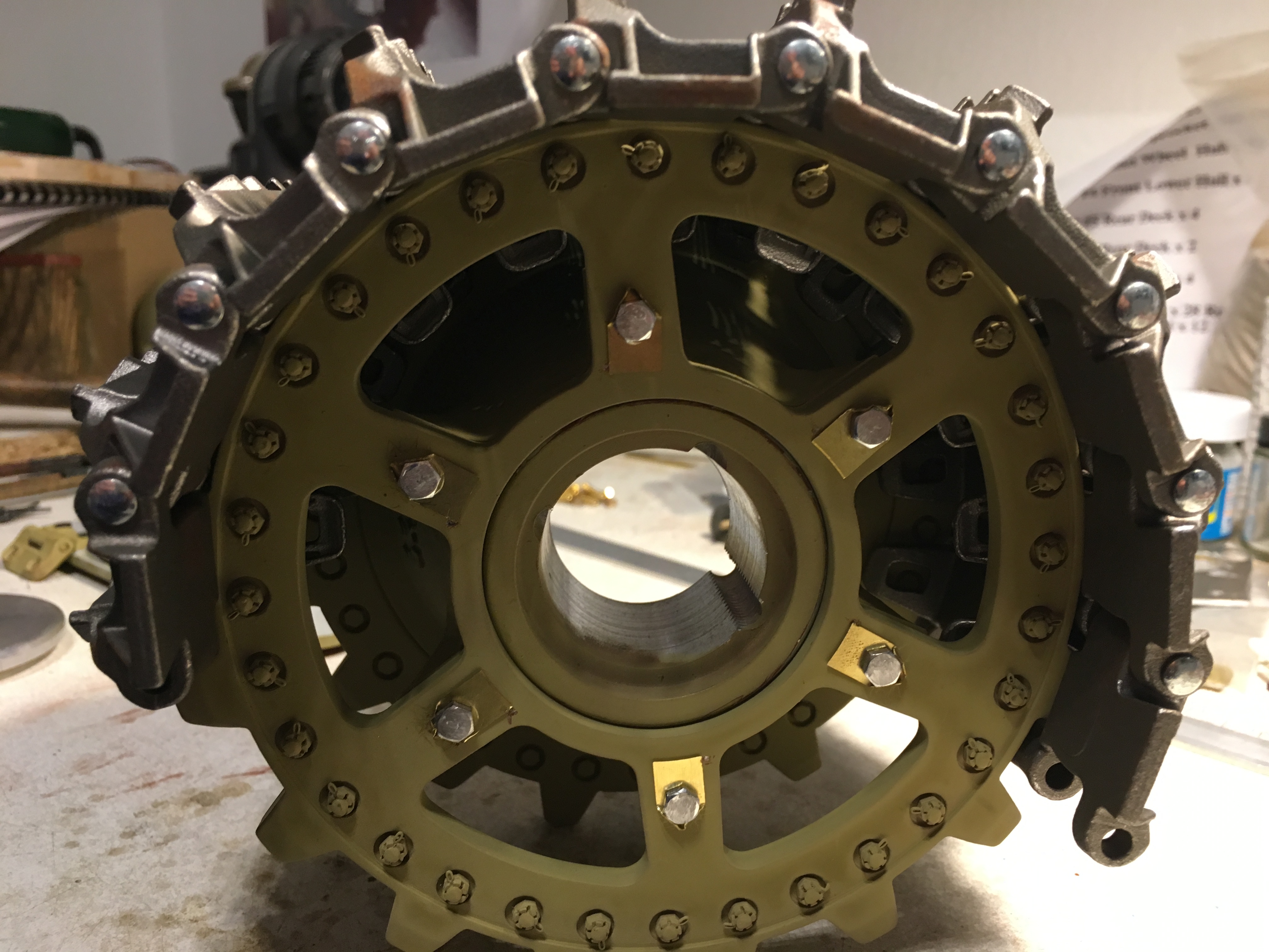

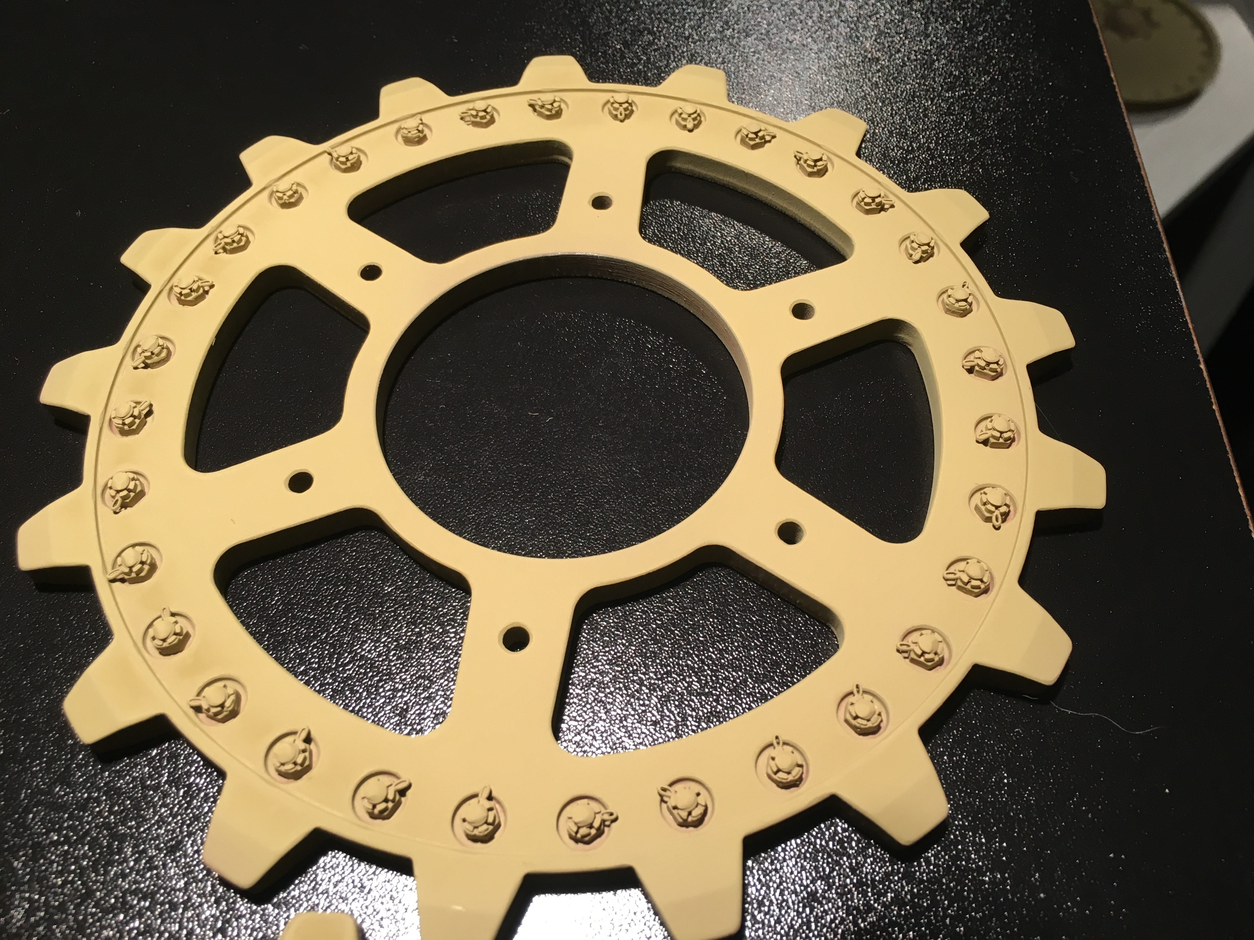

Here comes the painted sprocket with the mounted ring and the track links.
It fits very good - the same space between all sides to the teeth.
Regards Martin

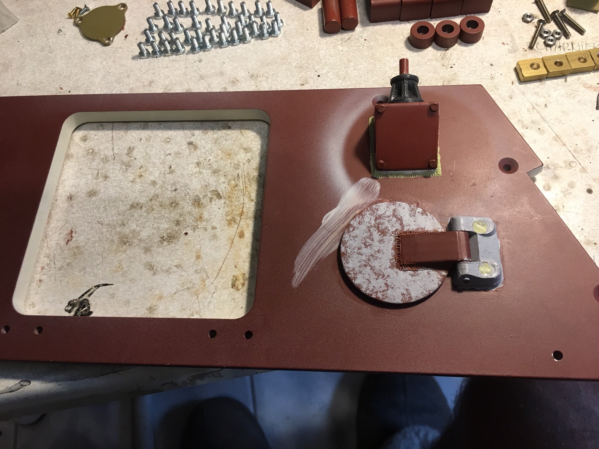

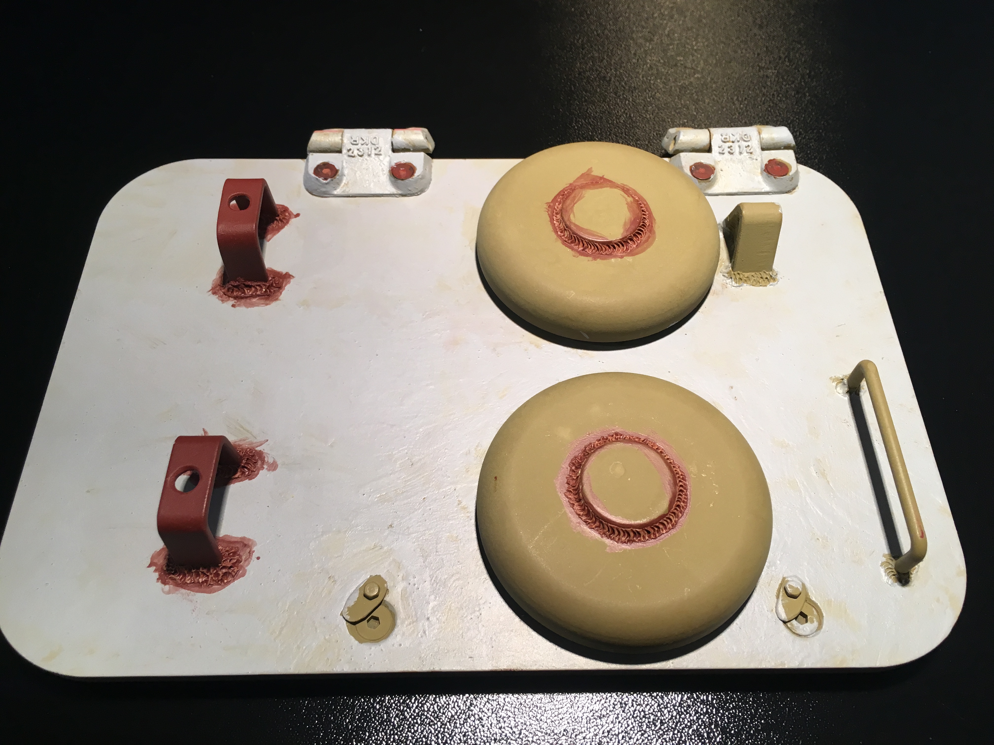

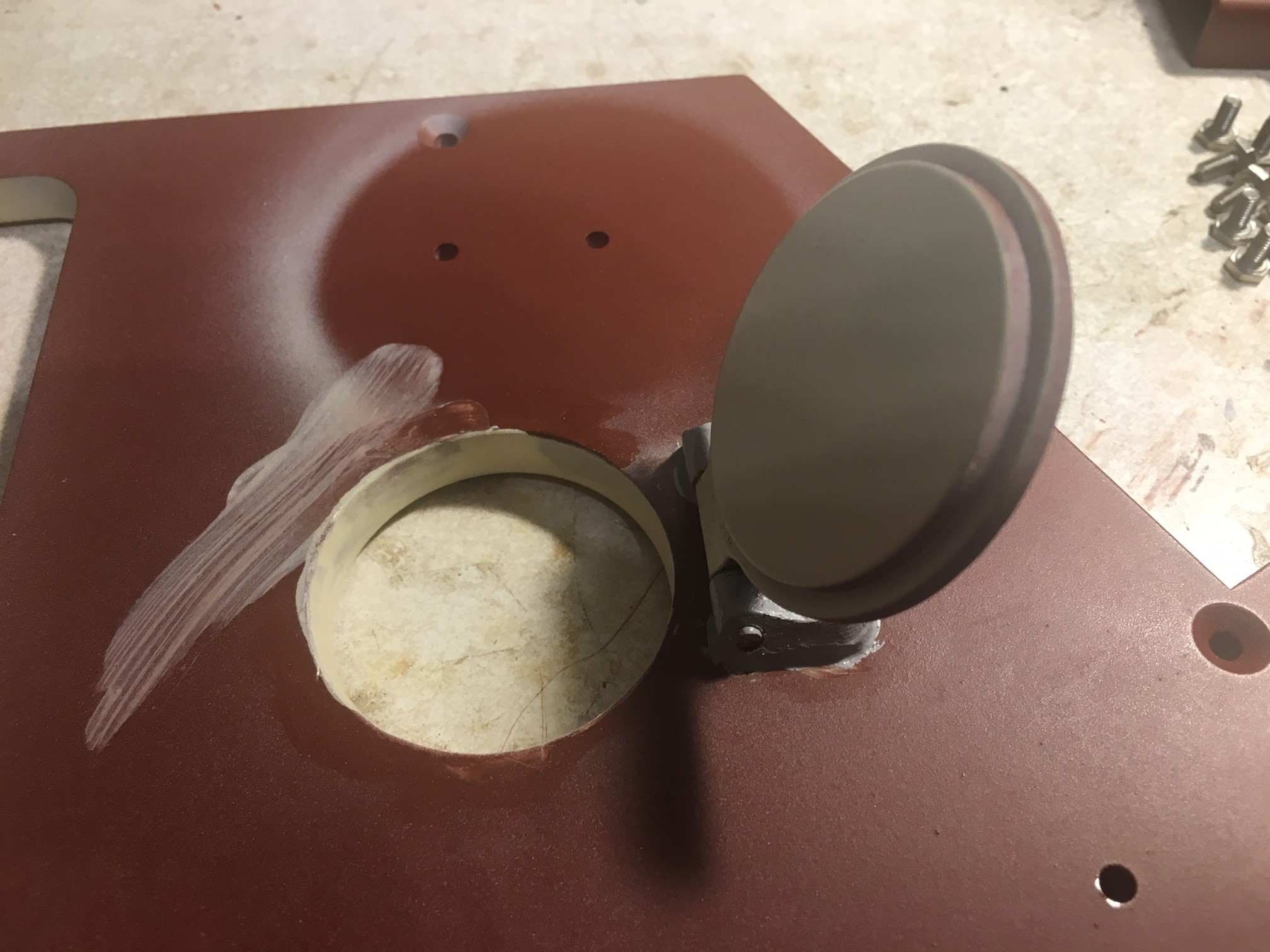

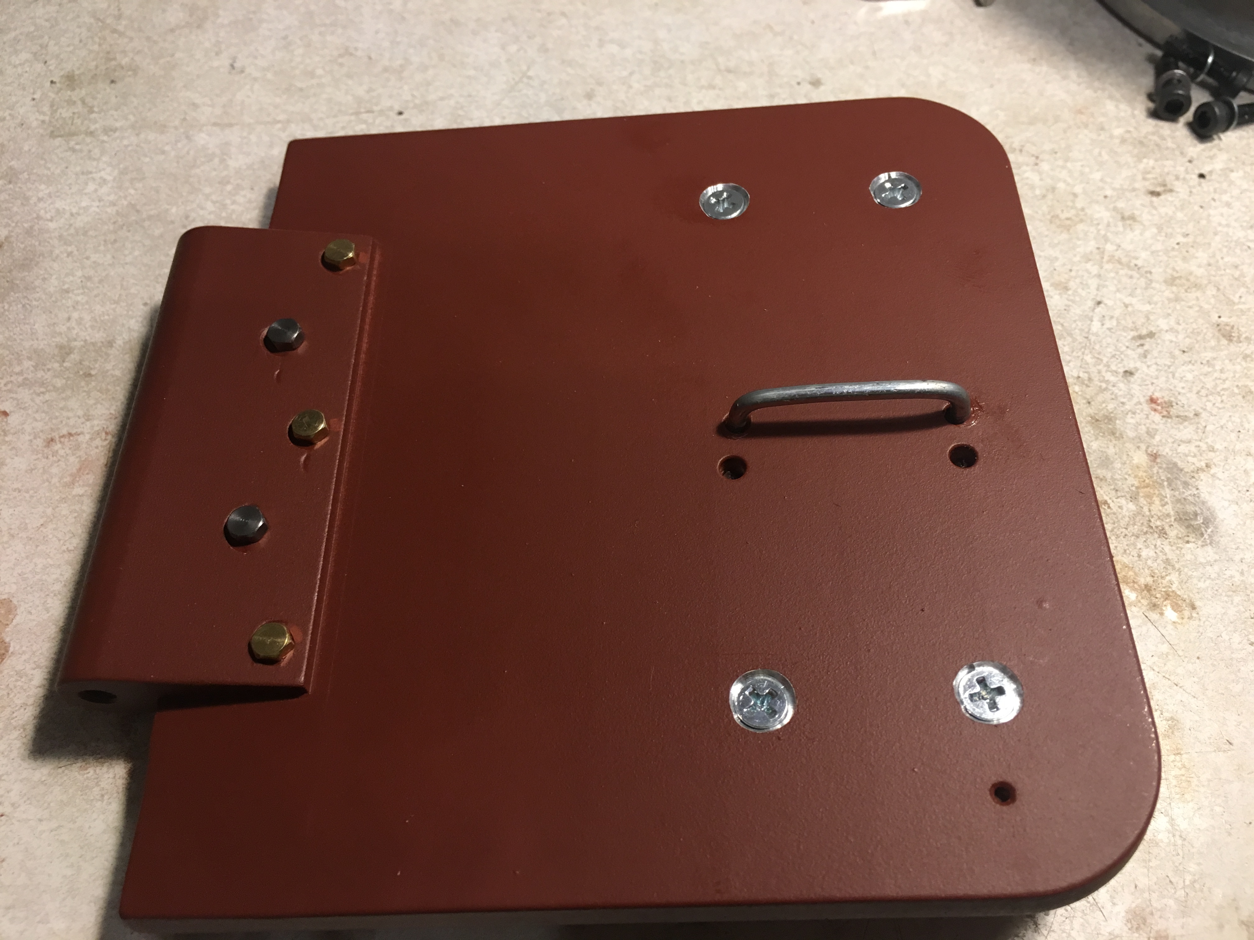

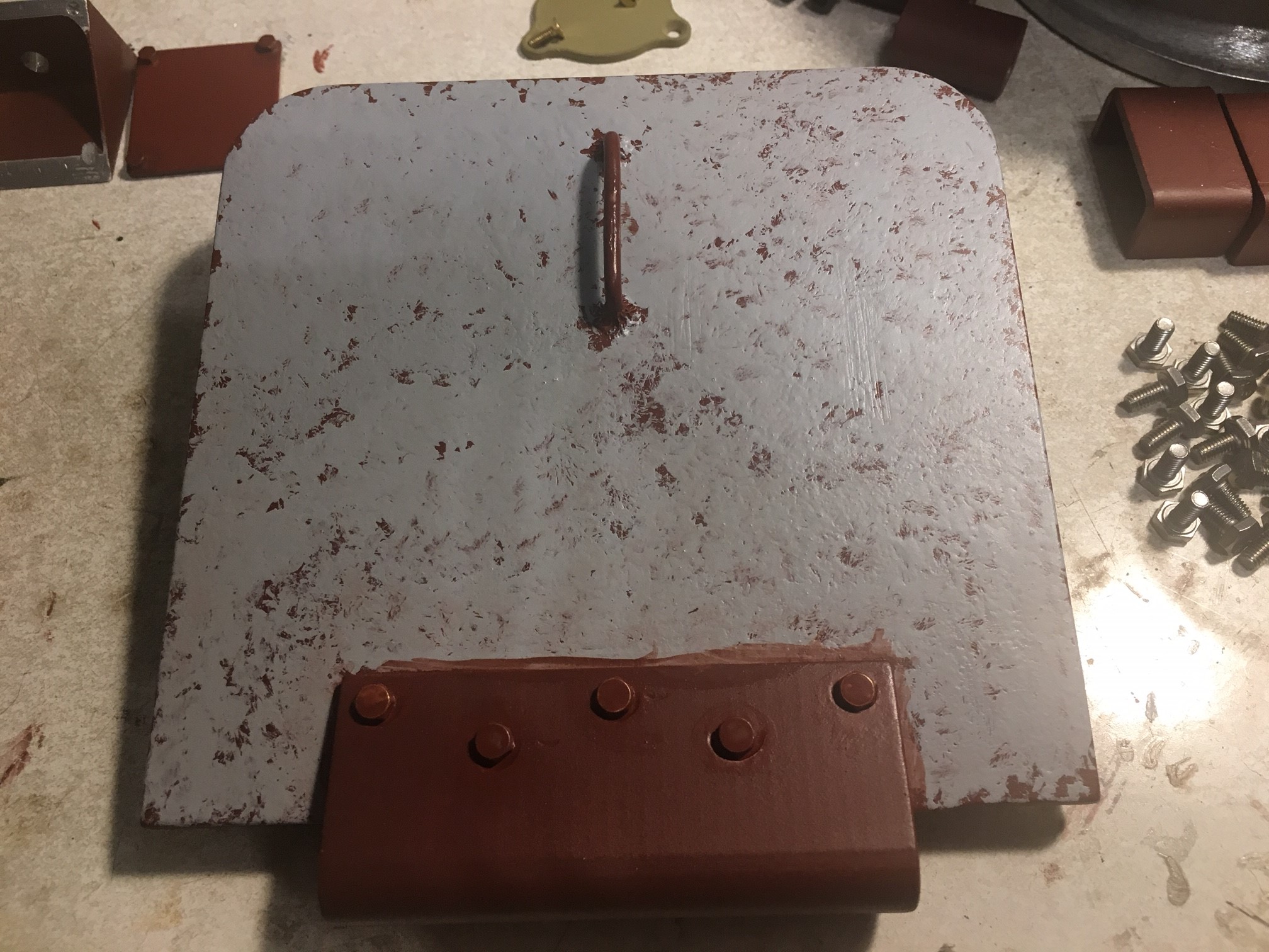

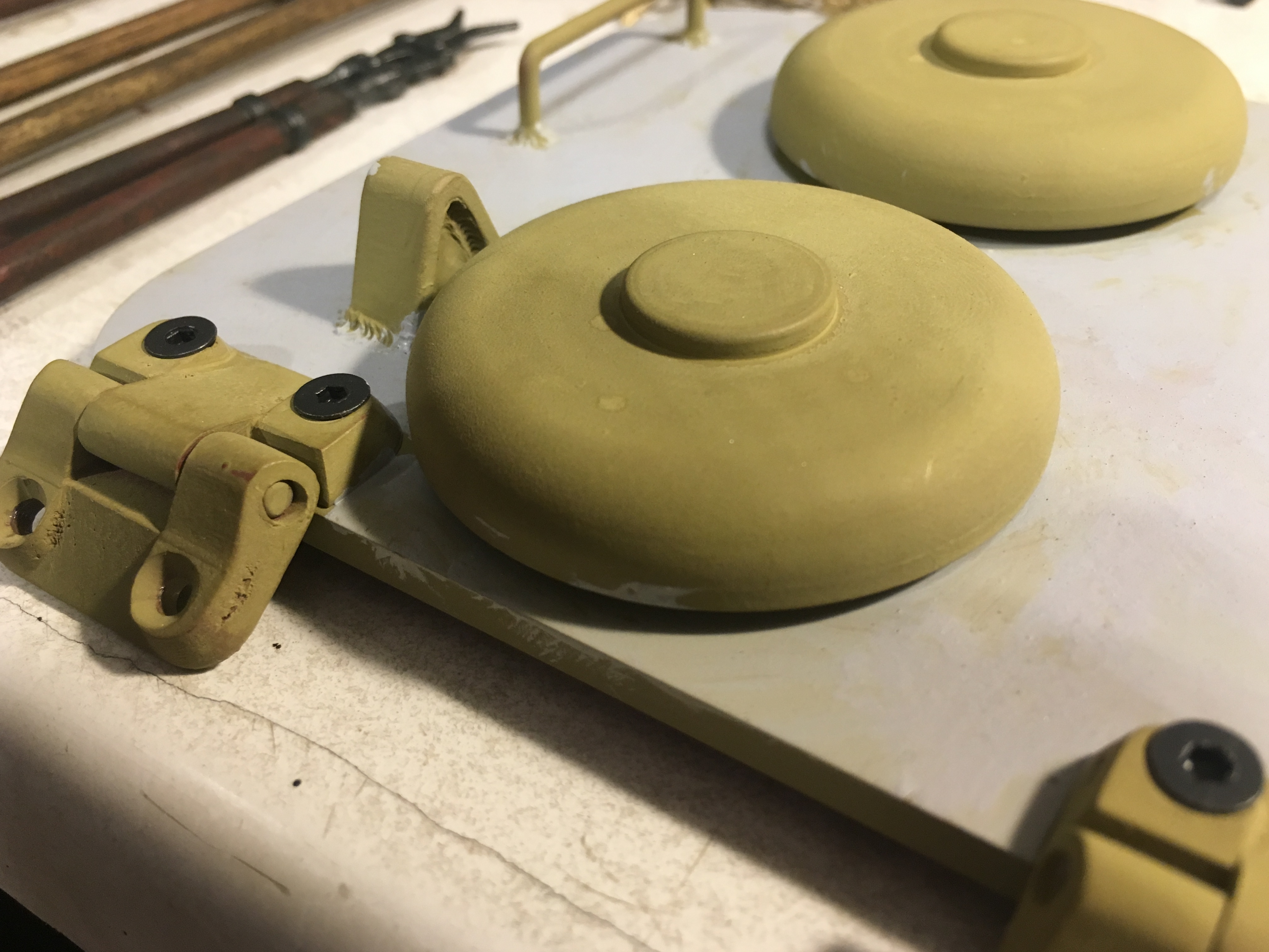

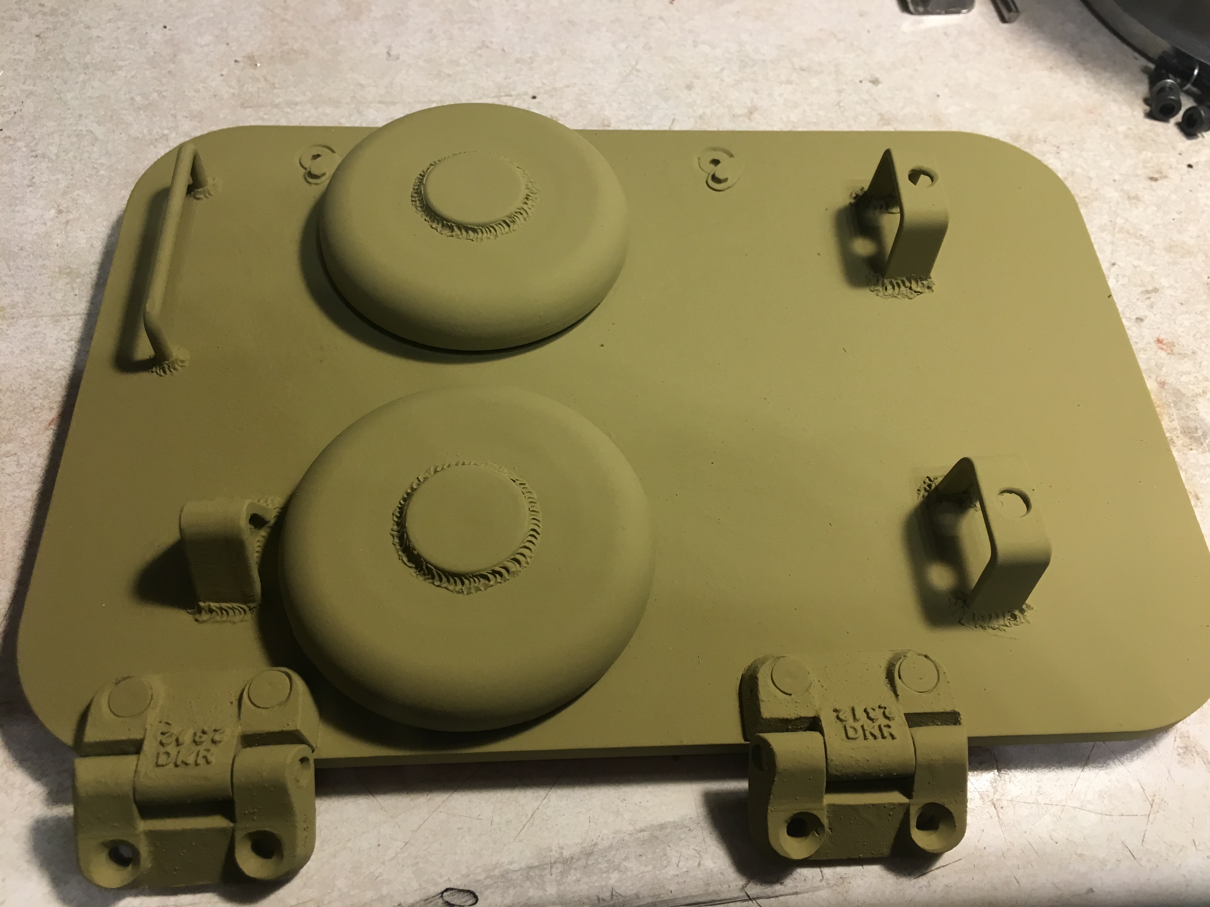

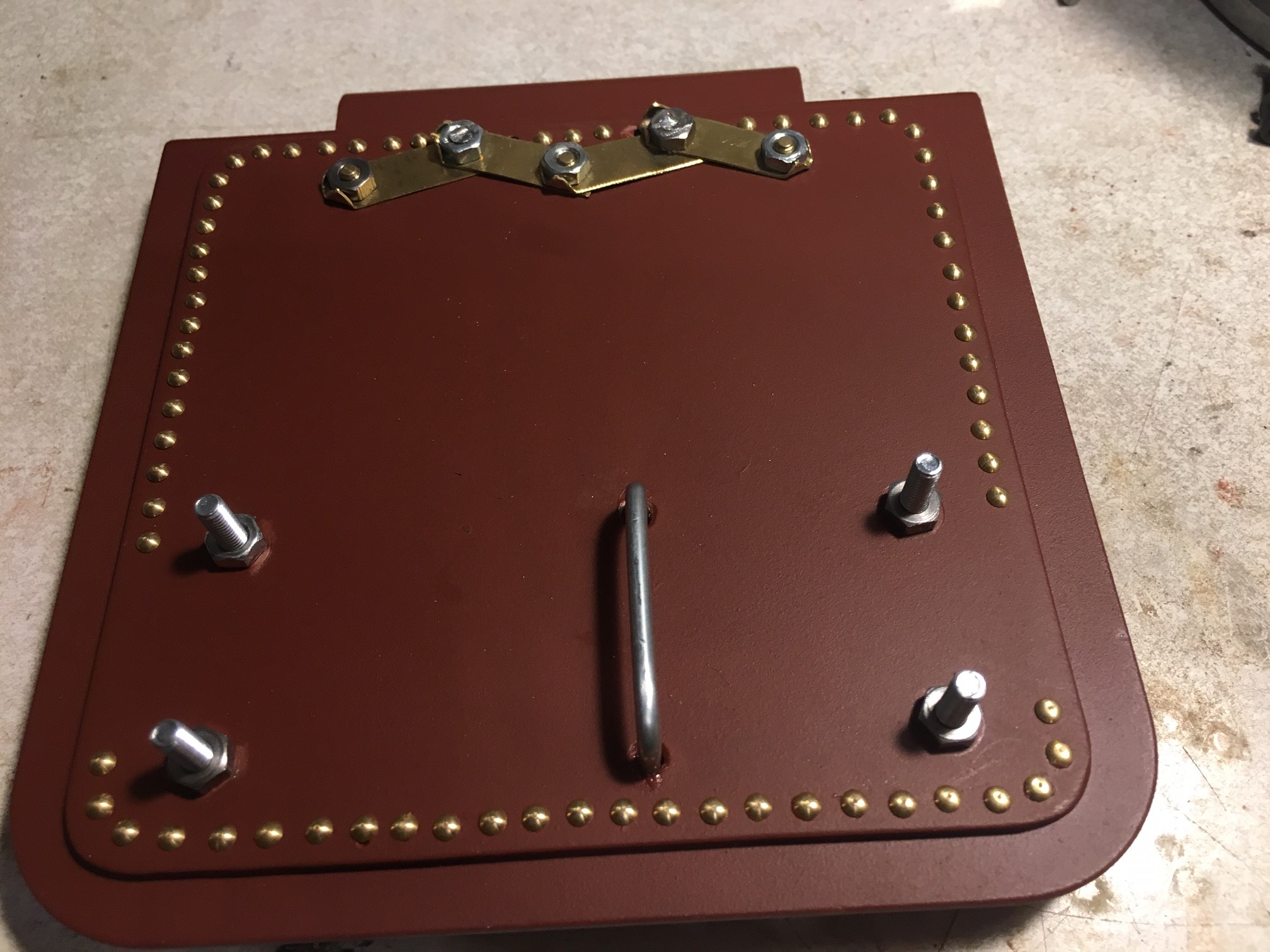

there are some new photos from the cover on the rear plate with some weldings and casting numbers on the hinge.
Regards Martin

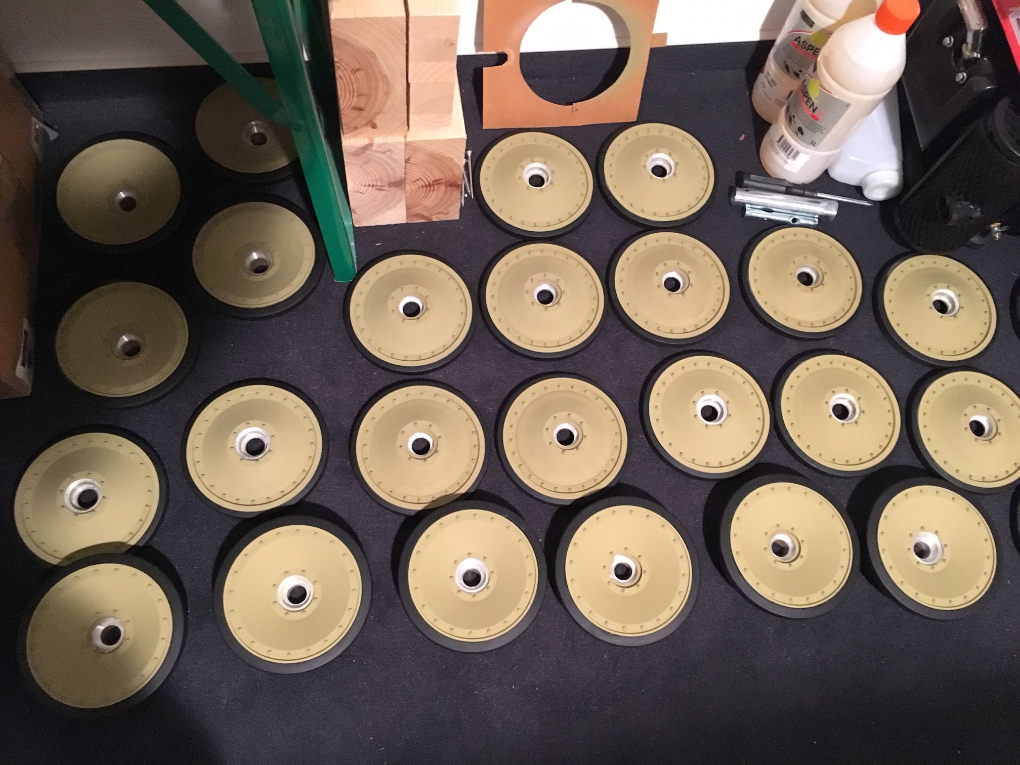

After finishing to glue the rubber rings onto the roadwheels they are ready for weathering.
Also the sprockets are finished for mounting and weathering.
Regards Martin

Here are the next photos of the hatch door and Steve Winstone's perfect bins with some weldings.

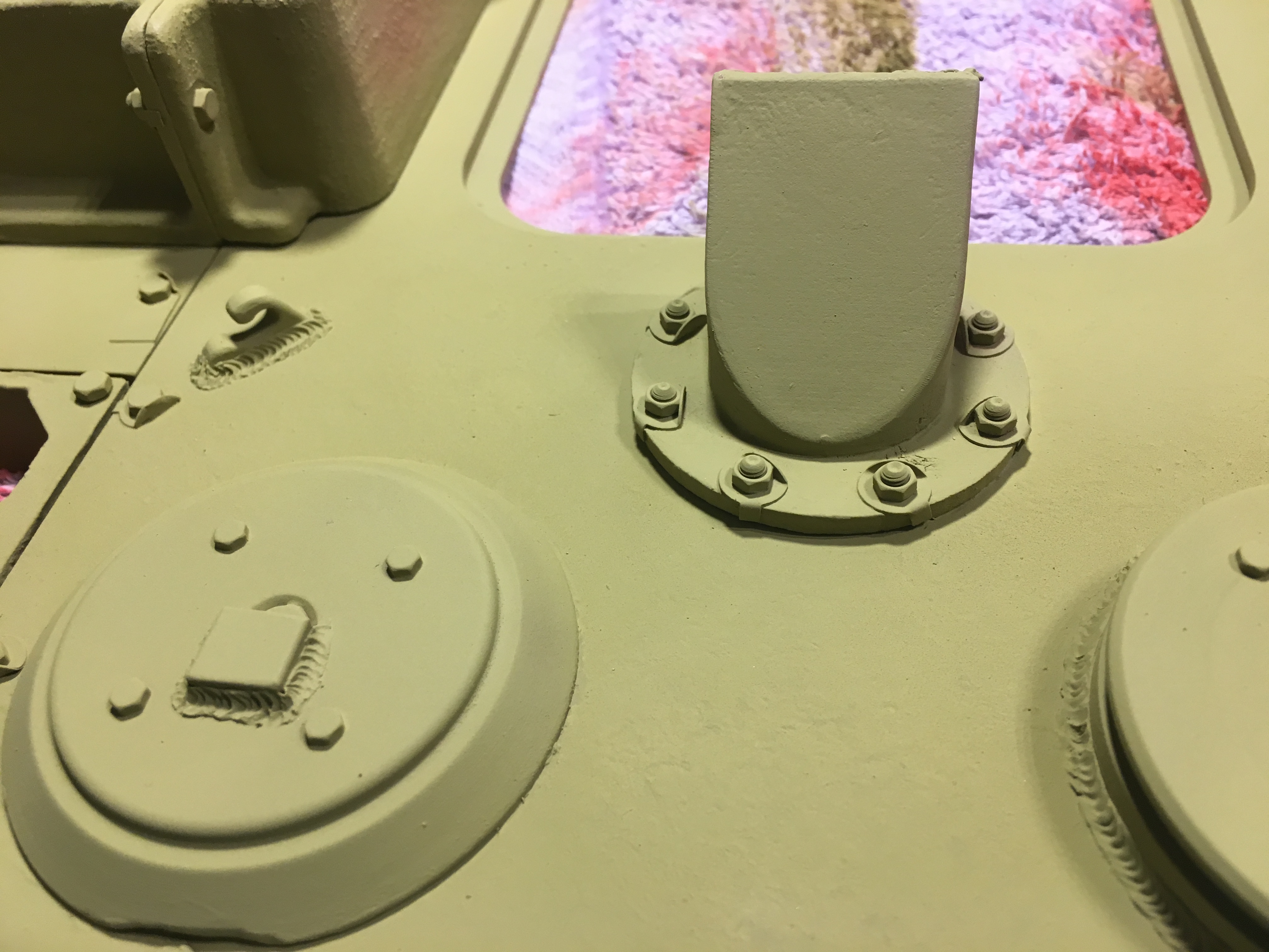

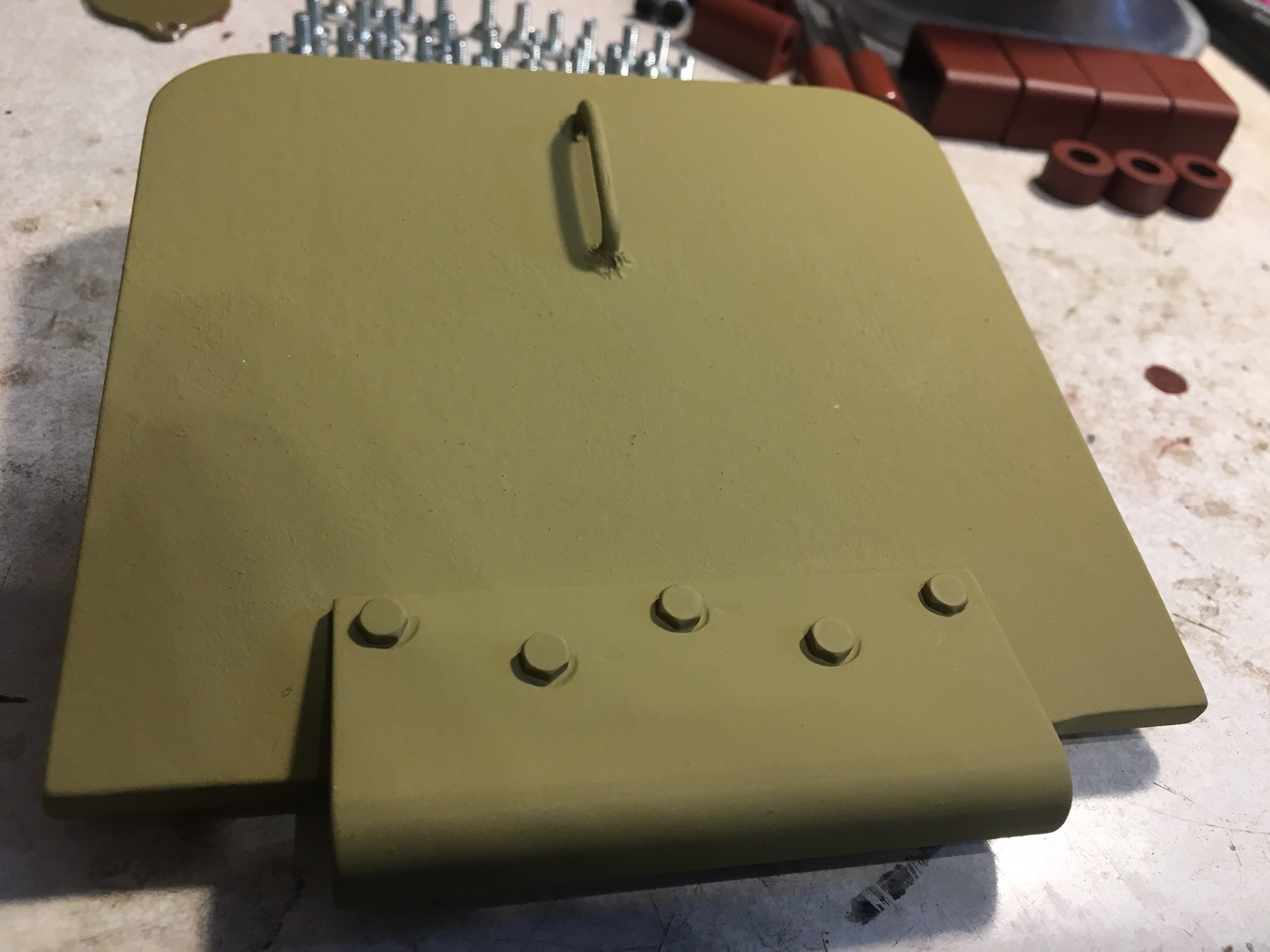

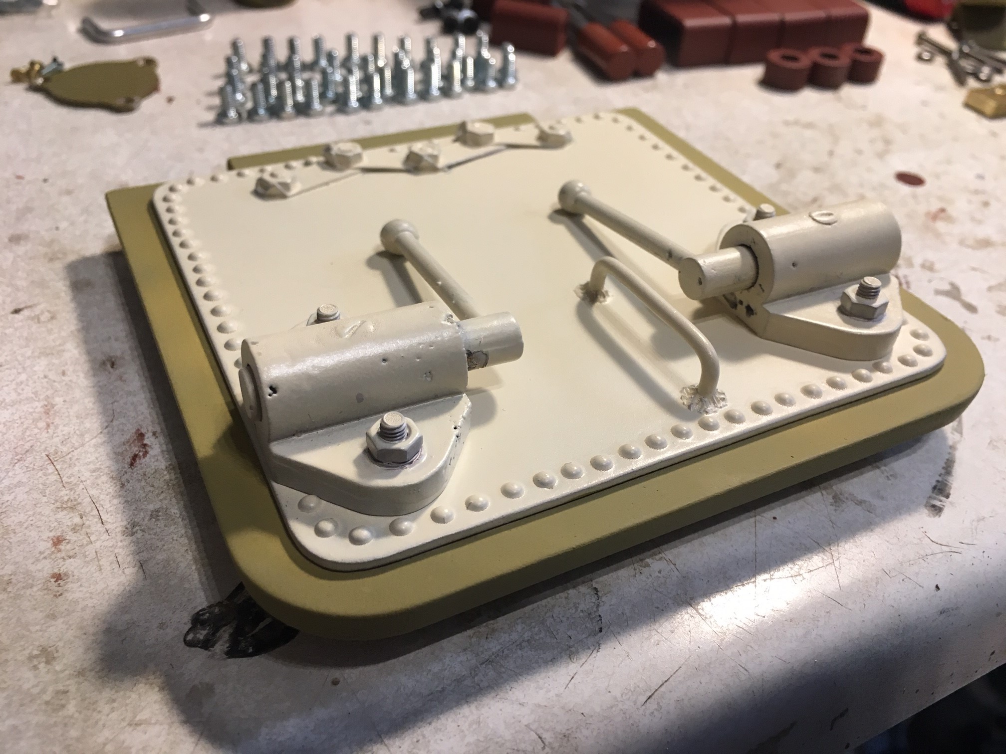

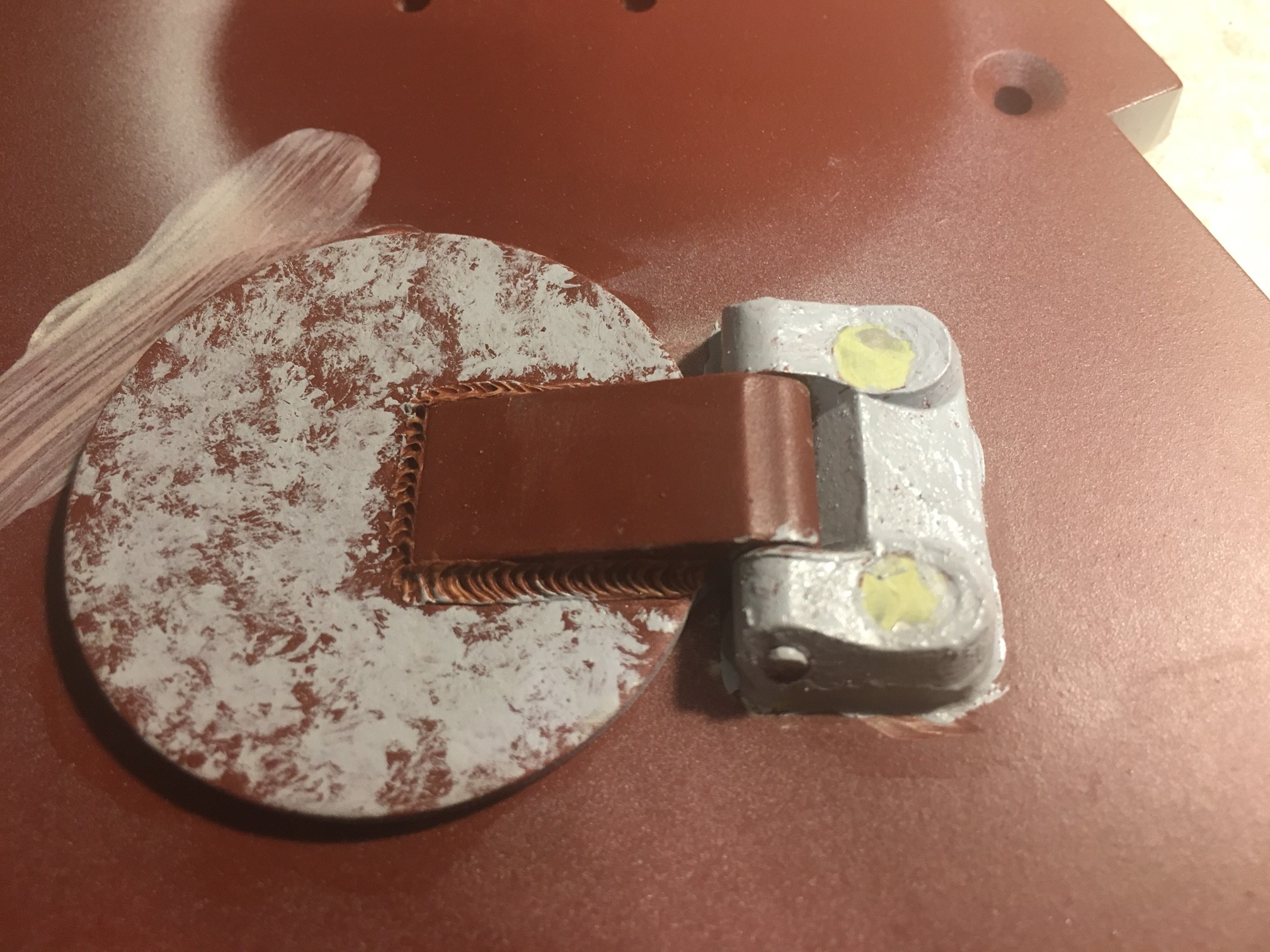

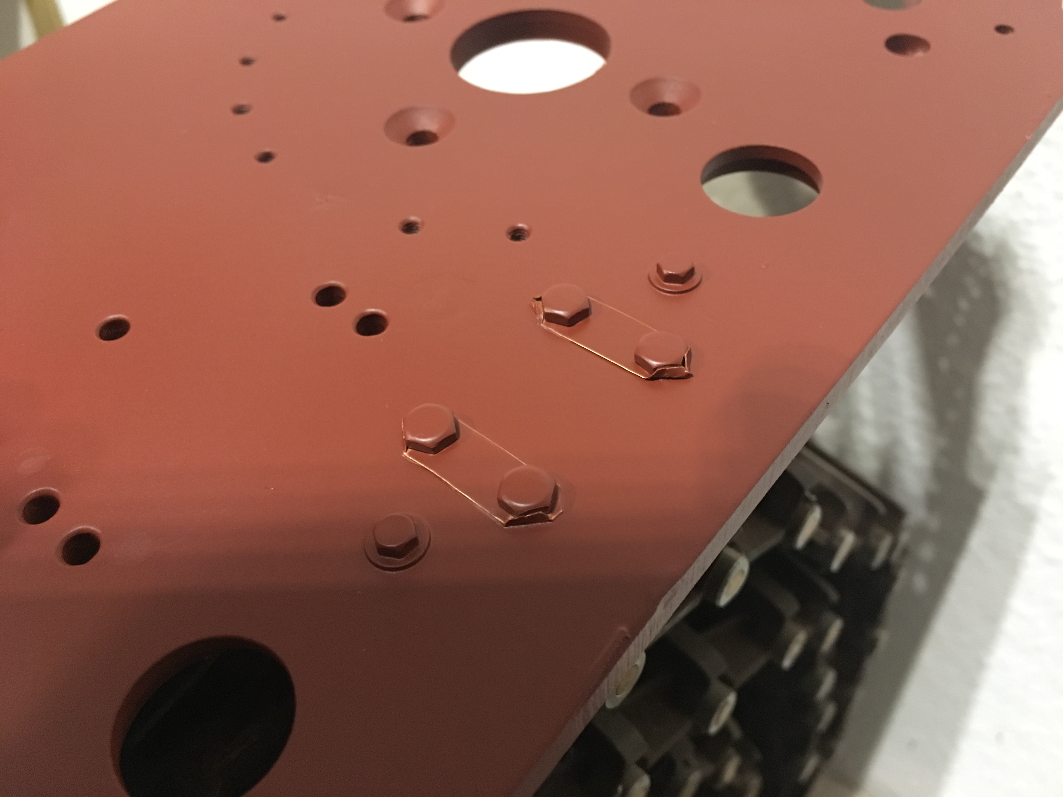

There is a small progress of the rear hatch and the antenna base from Australia!
Regards Martin

Very nice work with lots of good ideas for detailing, was the KT rear hatch riveted in the same way?
keep it coming Martin! Regards Phil.
Thank you Phil for the nice words,
yes i like it very much for detailing. Sorry i don't know if the hatch of the KT was riveted in the same way, but maybe Kent - he is very good in these theme.

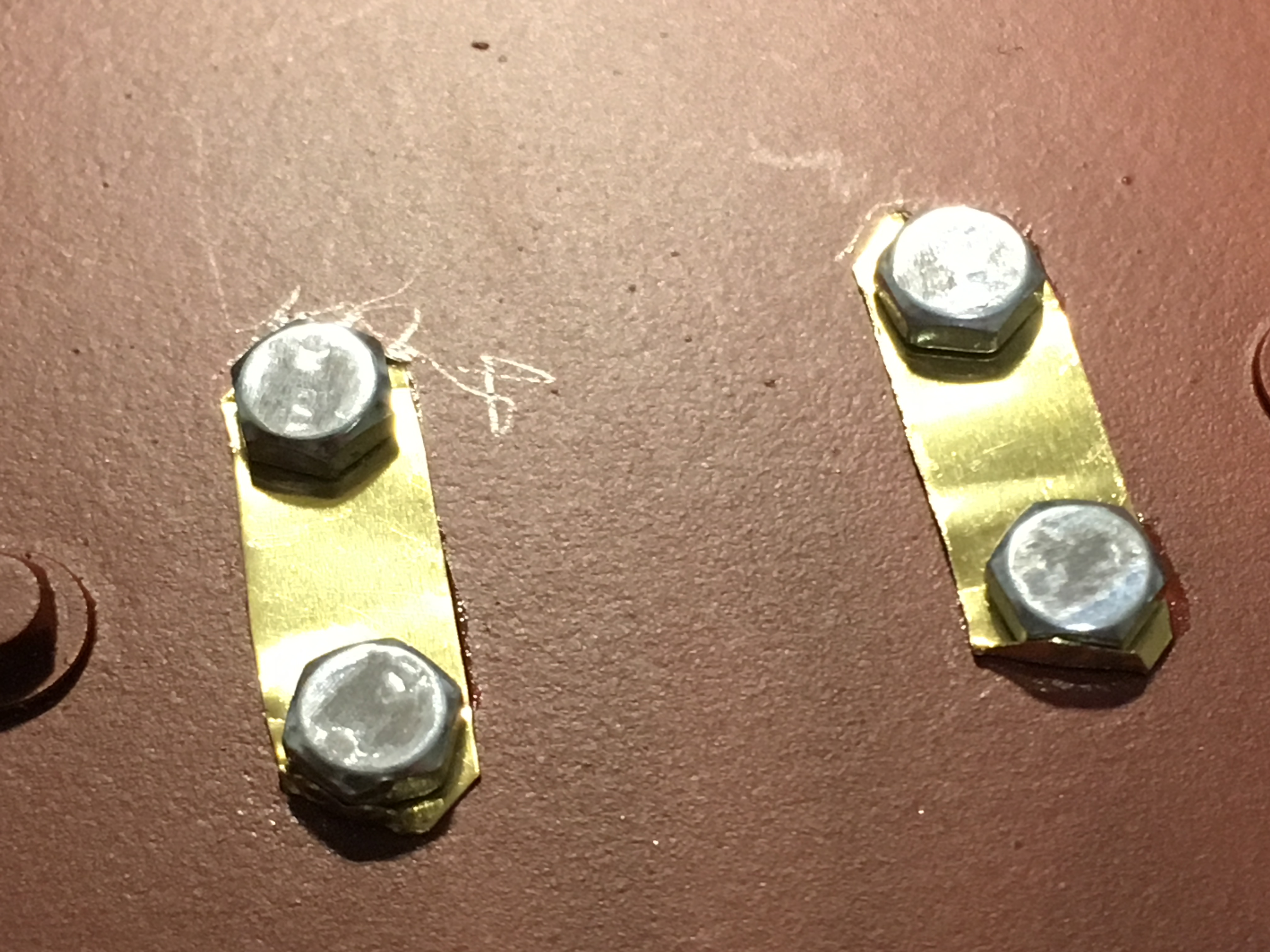

Here are the next details of the side walls.......
Regards Martin

Hi Martin and Phil,Martin Hofmann wrote: ↑Thu Sep 21, 2017 5:11 pmThank you Phil for the nice words,
No the KT tear turret hatch was not riveted:

- Posts: 153
- Joined: Sat Jul 12, 2008 12:01 pm
- Been liked: 1 time

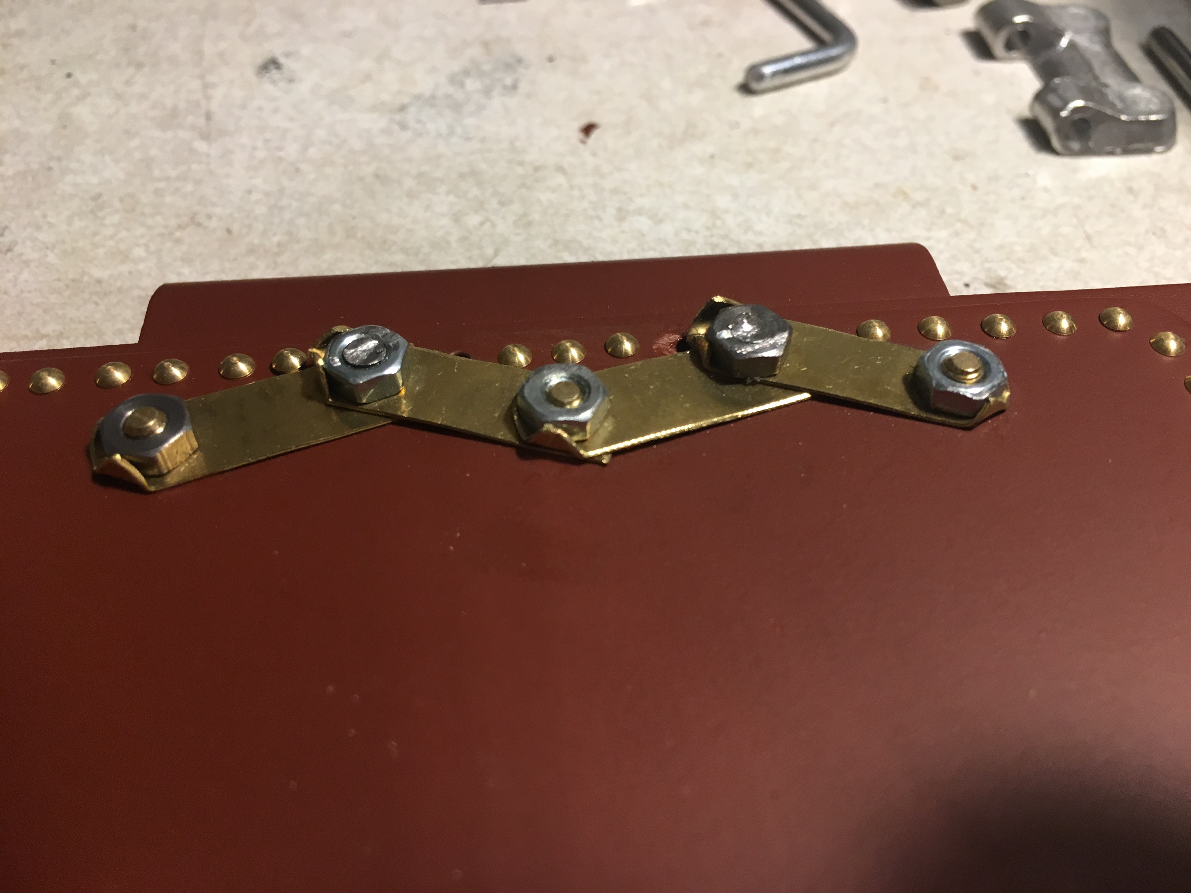

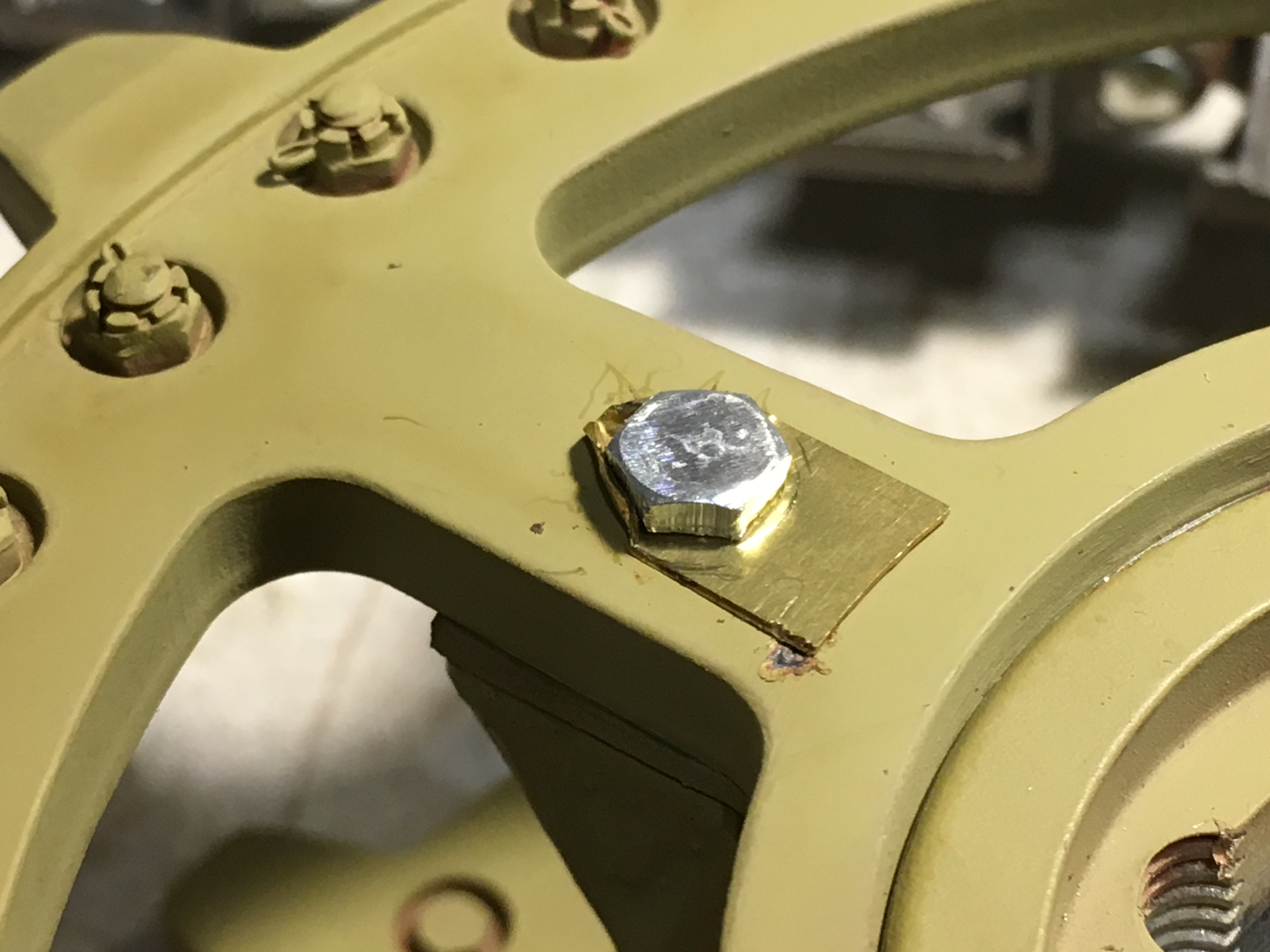

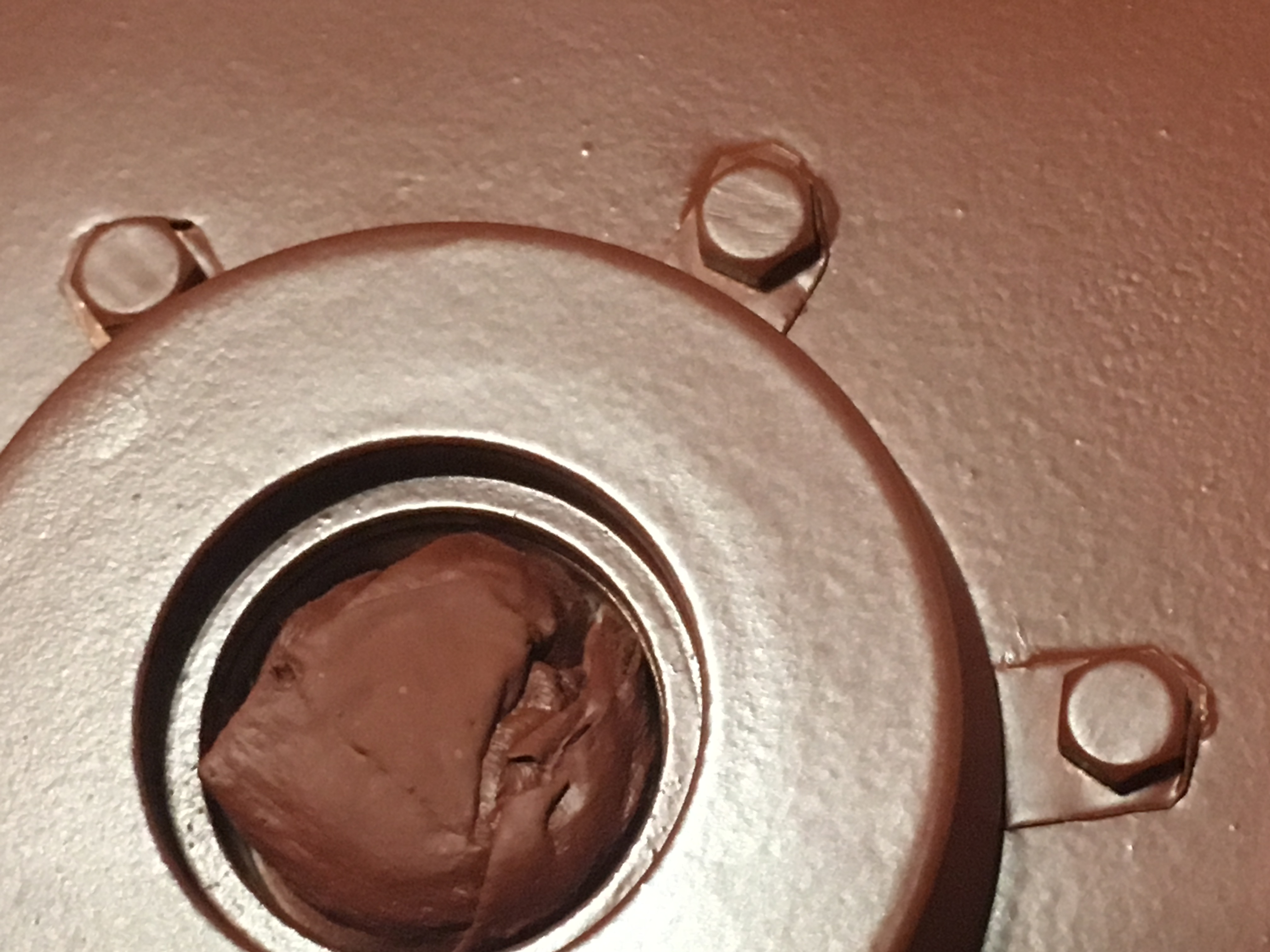

Hi Martin,
To late now but the there are no rivets on the inside of the Jagdpanther rear hatch. In fact, there are spot welds that hold a thin metal strip which in turn keep the rubber seal in place - it might look like rivets but it´s not. On this hatch the rubber seal is on the hatch.
On the Tiger II turret rear hatch the rubber seal is in a U-channel that are milled and fixed in the rear armour wall so on this hatch the rubber seal is not on the hatch but on the rear wall.
Kent´s link to Liejon´s 1/16 Tiger II model is nice but not 100% correct. The locking bolts´s outer end has a smaller diameter and is offset so that when one pushes the levers (the ones with the balls at the end) upp towards the turret roof, the offset presses the hatch closer to the wall making it water tight. It works the same way on the Jagdpanther rear hatch.
Hope it of some interest.
Per
