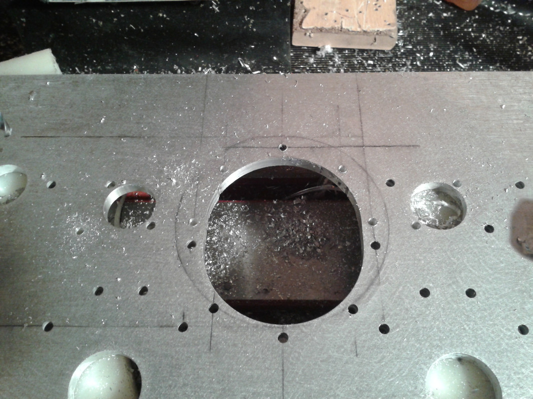

The turret hatch was a lot of work, but now i am happy with it.
The book i use is Panther Abteilung 502 external appearance & design changes
by Roddy Macdougall & Martin Block.
Thank you Robert for the info on the MG mantled.
Here are some new pictures, re-work on the rear plate and on the front plate
i did some work on the MG mantled.
Best regards Yves

The Panther A didn’t have the bullet traps this was introduced during the G production still they can be filled in or buy the first batch Kugleblende this is fine for the job.

Hi,
Hallo Mark, Robert told me also that the panther A dont have the bullet traps,
so i'am gonna remove them, is there anyone who has a picture how this looks like?
Thank you all for the good advice, it is much appreciated.
Best regards Yves

Hi all,
Both the Panther and Tiger II used the Kugelblende 80 so the ball mount would be the same size.
Please note the different in front glacis angle, 55 for the Panther and 50 for the Tiger II.
The bullet trap configuration differs between the Ausf G and Tiger II and the Ausf A had only one row at the bottom of the opening, more of less distinctive and sometimes hidden under zimmerit.
Bare in mind all ball mounted Ausf A had zimmerit. Only a few Ausf A was without and they were all early A:s with the letterbox MG port.
Here is a photo of the Camp Borden Ausf A:
Hope this was of any use.
Kind regards
Kent

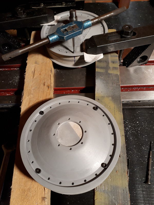

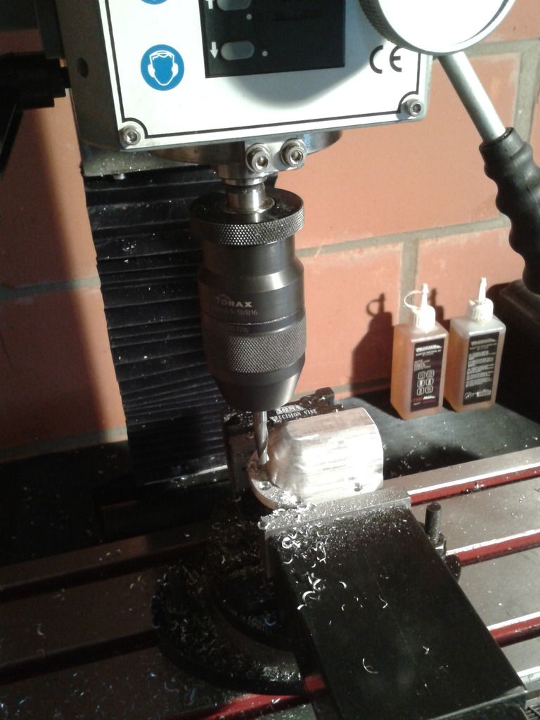

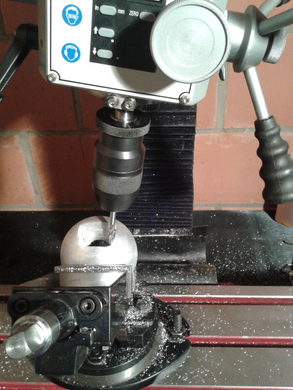

Hello,
Here a few new pictures from my Panther A progress,
first a picture of countersink the bolt from the exhaust system.
Next pictures are from the gun mantled, i remove two bullet traps,
And the last pictures are from the wheels, its a good therapy more than 700 bolts on the wheels, :roll: :roll: :roll: :roll: :roll: :roll: :roll: :roll:
Best regards Yves

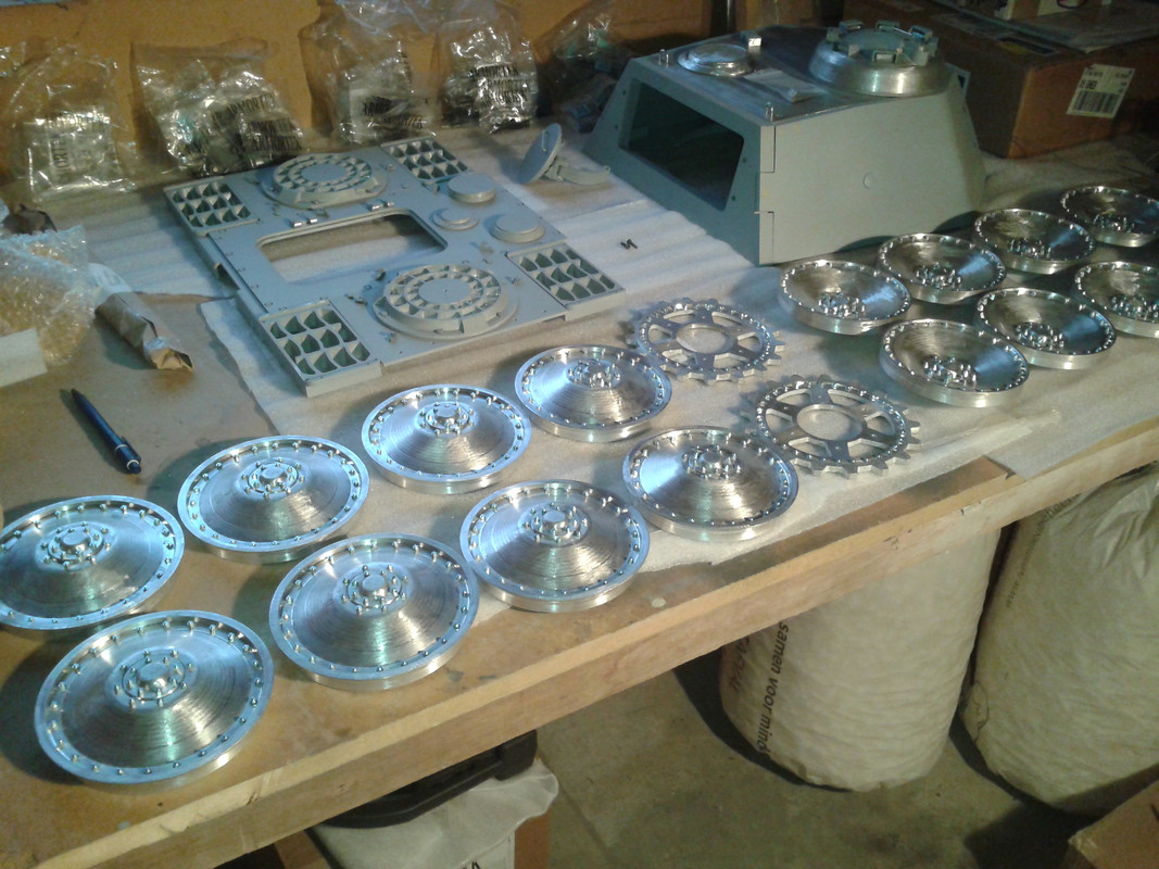

Hello,
This is a picture of my inner wheels ( bolt them together for better fit ) on the axels.
Regards Yves
