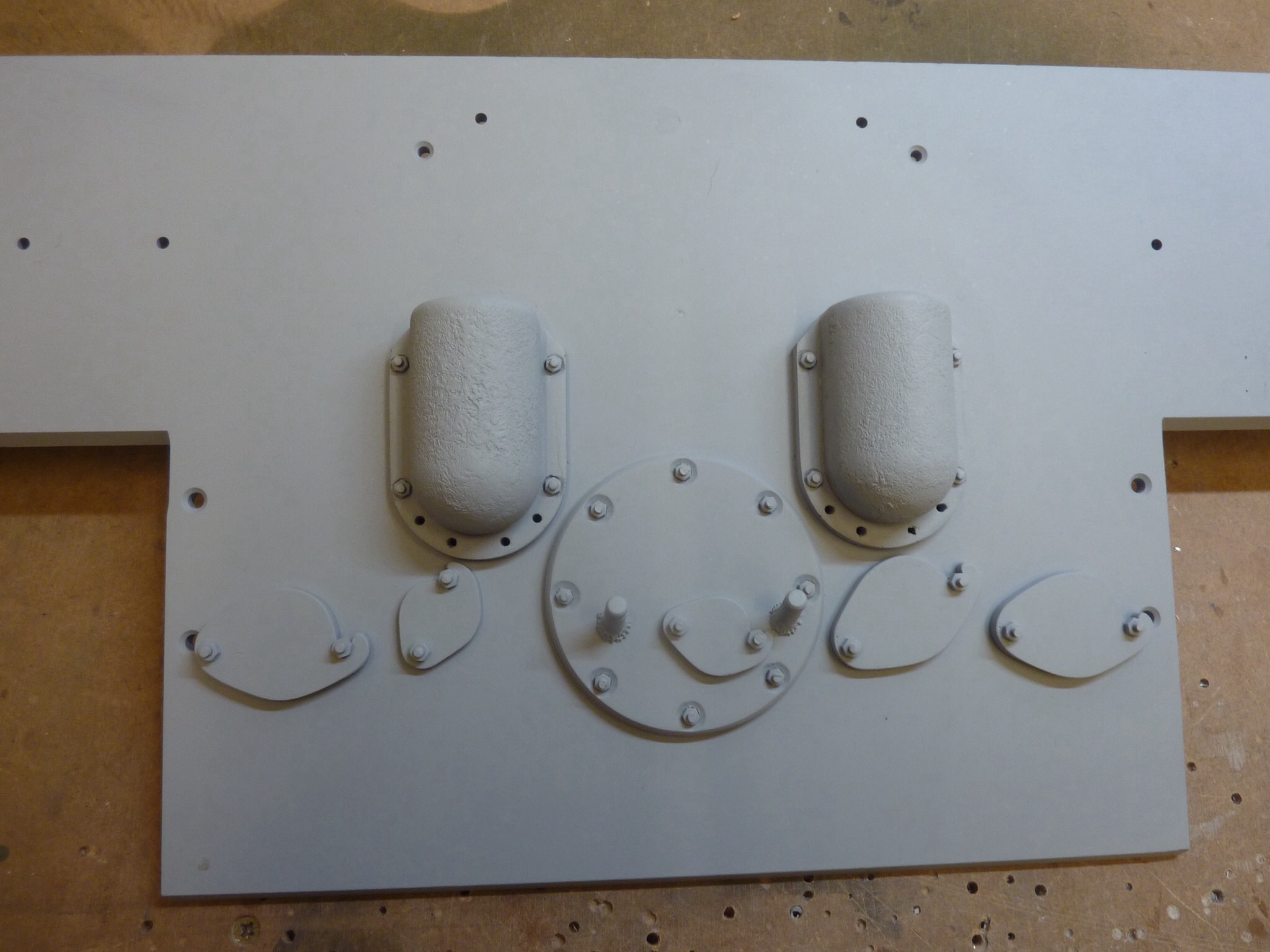

Hi Phil,
Panzer Tracts are ok and best buy for the money but beware as some of the drawings has errors.
Regarding the rear plate the need for corrections was also on the Ausf G kit.
No big deal and here is how my own turned out.
The Ausf A and G configuration is the same regarding where the items are placed.
Got my measurments from the booklet "Panzers in Saumur no2"
The measure is in 1:35 so just convert them into 1:6.
Kind regards
Kent

Hi Kent, I know that the ausf.G is also in need of some alterations but mine was already built when i bought it which would have made things more difficult.
I decided to leave mine alone and concentrated on other areas that were more accessible.

Firstly the references I have used are the Panzertracts ausf a book as Tim stated plus the Panzer in Saumor booklet that Kent mentioned, I also referred back to my earlier ausf G build where Kent kindly supplied some of the required dimensions.
As for the modifications they are reasonably easy to achieve with basic hand tools, no fancy laths or milling machines required.
As for accuracy, the components are being positioned as close as possible to their correct locations allowing for some error in the dimensions of the plate itself.
Kent, thanks for the photo of the rear plate, it's interesting to note that the starter crank cover on the access hatch is at a different angle from that shown in some reference drawings.

The picture Kent shown is an MNH built Panther, don’t forget they in-turn were supplied armour from various other factory’s so don’t be surprised if there are slight differences in the location of parts in this case the angle of the starter handle cover.

Well, that Engine access hatch with its cover for a motorized help starter is how they all looked like no matter if it was an NMH, DB, MAN or Demag build Panther. If any drawings says otherwise they are just another victim of artistic license.
Please look at Panzer Tracts 5-135.
However the engine access hatch later on was equipped with a tow coupling and then got a different help starter cover. Late Ausf A and all Ausf G had such.
The Weatcroft Demag Ausf A that have been the inspiration for the Armortek kit (hence the letter box MG port) have now the later tow coupling hatch but was originally equipped with a same hatch as the Camp Borden Panther. The switch most probably took place during her post war service with the French army.

Repositioning of the various covers and access panels is now complete, I am reasonably happy with the outcome knowing that all the components are much closer to their correct locations. I think looking at Kents previous photo it looks pretty close, it's even the same colour.

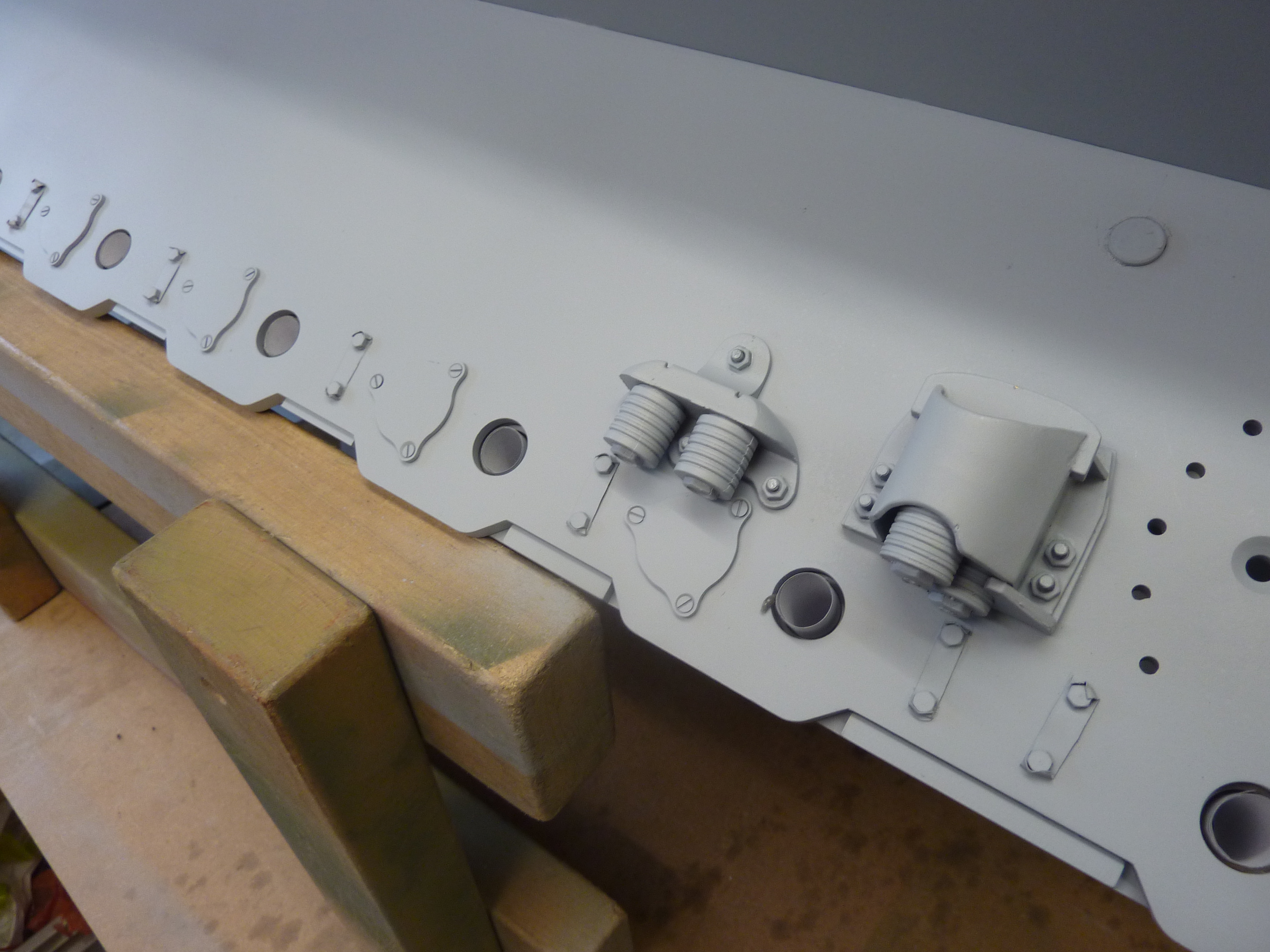

The hull is now assembled and detailing of the lower side plates has been started.
Suspension torsion bar covers and internal fitting attachment bolts have been added
Rear idler mount to be added and detailed.

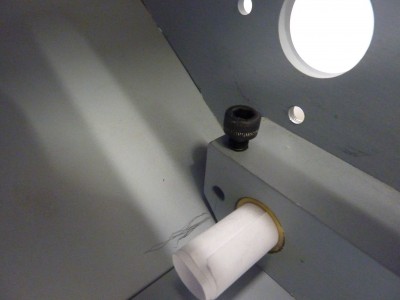

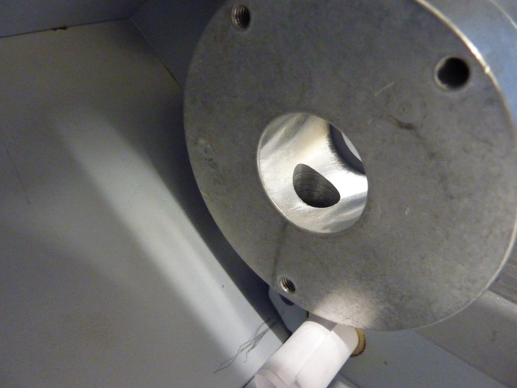

A quick mod to the right EMD mount,
As standard if the forward right torsion bar should come loose access to the retaining grub screw is impossible without a major strip down. As this grub screw is below the EMD mount it would be necessary to remove the right track,gear case,motor and EMD mount for access to the grub screw so I came up with this simple mod. It is only required on the right motor mount as the left mount does not block access to the forward torsion bar mount screw. Another bonus is that the grub screw can be replaced with a M6x20 cap head bolt like the rest of the torsion bar mounts.
All that is required is the drilling of a 13mm hole in the EMD mount above the torsion bar grub screw position .
To gain access in service the motor is now the only item that needs to be removed.
Left and right EMD mounts withe the new access hole drilled in the right one
The right forward inner hull with a M6x20 cap head bolt in place of the standard M6 grub screw
The moded EMD mount in position showing how the cap head can be accessed when the motor is removed

i've used this method before steve, its a good idea, i think i got it from you last time, i'll have a look at my sturmtiger. thanks for the refresher, regards simon.

I just used an ordinary hex bolt there on my tiger. It can be reached with a wrench from the side. Don't remember if the motor needs to be removed? There might not be room for it on a Panther, though.
