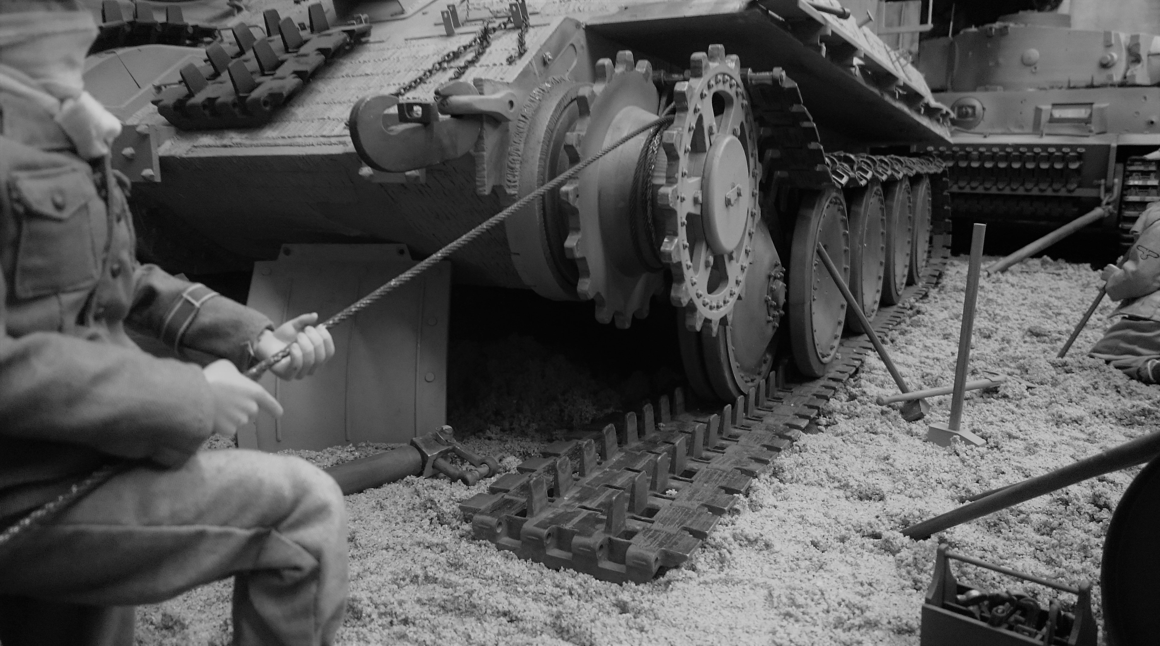

Dont worry about posting pics on my thread im not bothered at all, its all good viewing, as its been raining today i have been shooting some video ...here is a still of the operation regards phil.
Just looking at that photo it reminds me that I must get some weathering on that Berge , it all looks far to clean and there's little wear and tear as it's all a bit new, trouble is once you start on the weathering it just goes on and on.
Just running the vehicle you get nice wear patterns developing...like the odd inner road wheel rubbing against another (just like the real thing) and becoming polished on the outer rim, if that doesn't happen by itself then I would add silver paint.
Our video suite seems to be behaving itself at present so I will endeavour to edit the video and post soon cheers Phil.

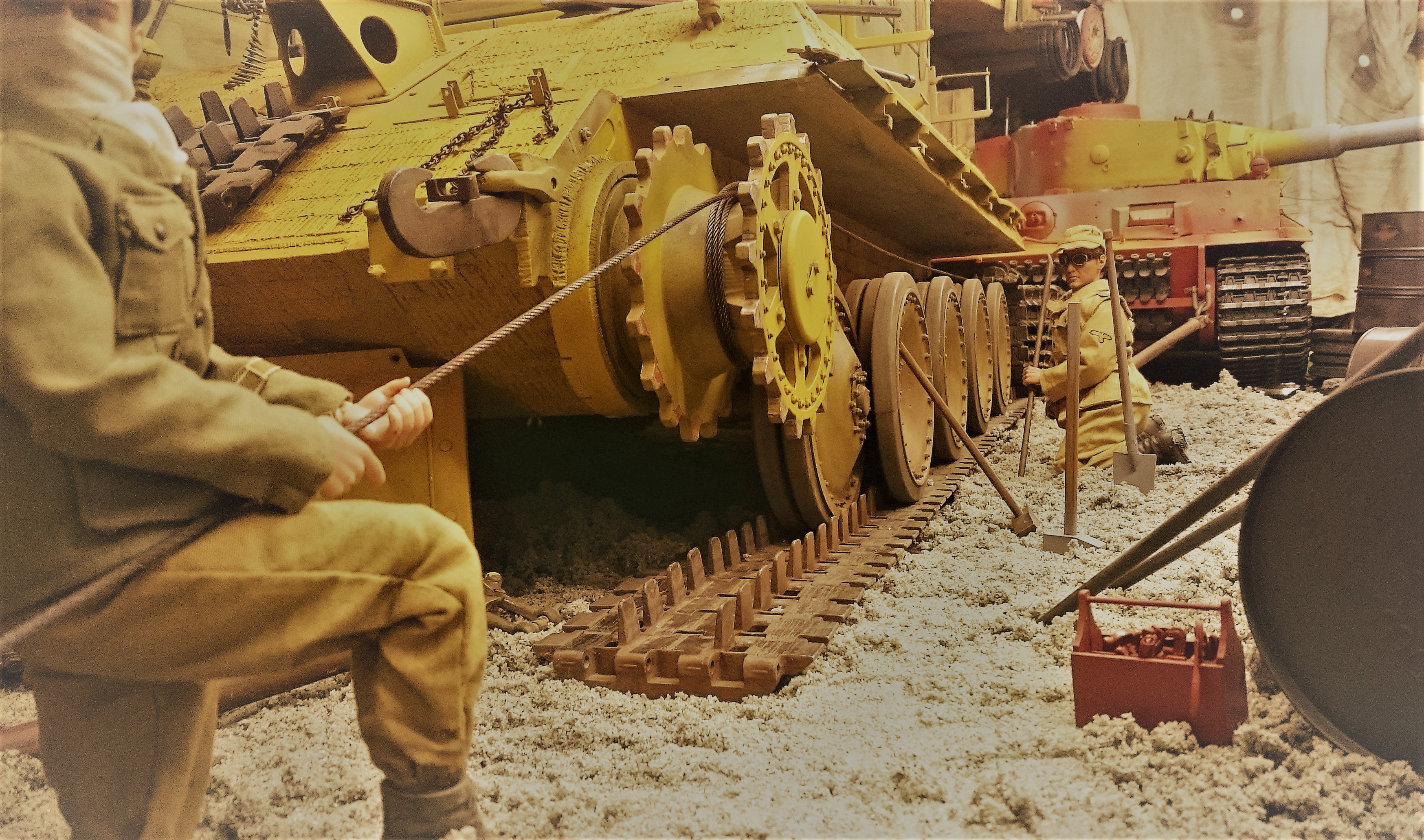

And another in colour. Oh and the track pulling "sprocket capstan" technique really does work quite nicely in this scale!
