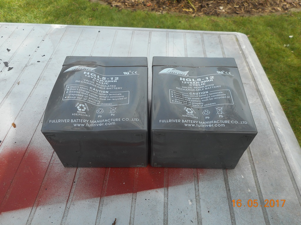

This is an illustration of what can happen when batteries go bad:
These came out of an M2 half-track I'm currently re-animating. I would imagine that they were charged with a charger designed for 22Ah batteries, hence the reason they overheated.
I have a couple of replacements on the way from Hardware Express, but I need to investigate how to charge them, as the maximum rate of the new ones is only 2.1A.
