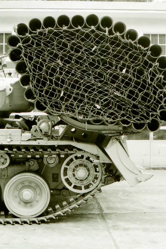

Re: A 47 years old love
Hallo Fabrice
Perfect! This picture I did not found. Do you have a picture which shows the dozer blade on the ground?
Regards Frank
