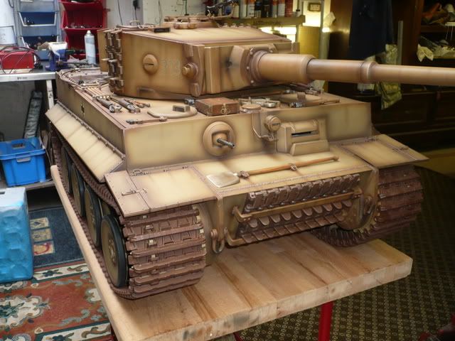

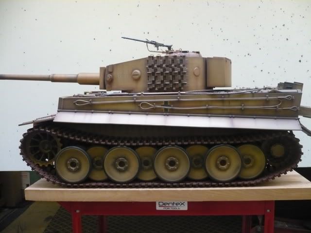

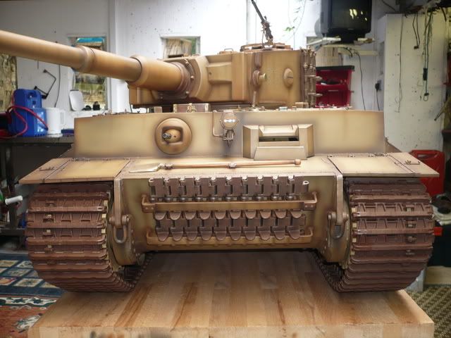

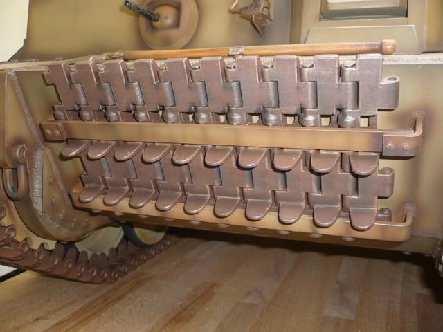

for anyones interest, who may "still" be building a tiger.

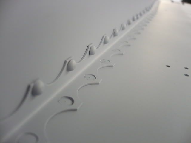

the tiger is virtually complete, minus the electrics. Just waiting for a tow-hitch modification. Also i have included a photo of the early tiger hull fillets, cut and reworked by steve winstone.

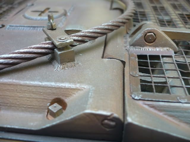

Hi Simon
Thanks for posting the nice pictures. Oh how I wish I could do welds as nice as yours. :cry:
Nice mod on the hull fillet piece. Super reference.

I missed this thread. :oops: I am still building my early tiger, this thread is really eye candy. Superb paint job and modelling skills. :wink:
May I ask what paints did you use?
Peace and take care
"In the end, it is the journey that matters more, than the end itself"
thanks for the feedback,i have enjoyed build photos placed on the forum and have picked up a lot of information. the color on my tiger is toyota biege cellulose 482 matt ,available in aerosole form or 1 ltr tins from auto paint supplies,a cheap revell airbrush and tamiya paints for the weathring.the pannier fillets i noticed in the archive from vince abbott and bovington tiger.the tow hitch i sent to steve winstone,theres not much he does not know about tigers and build details many thanks
