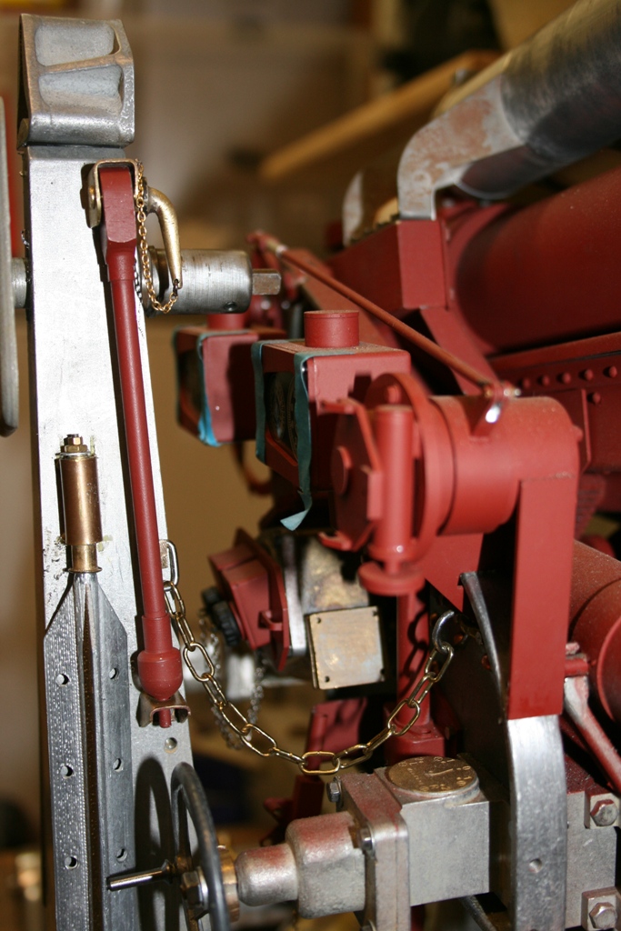

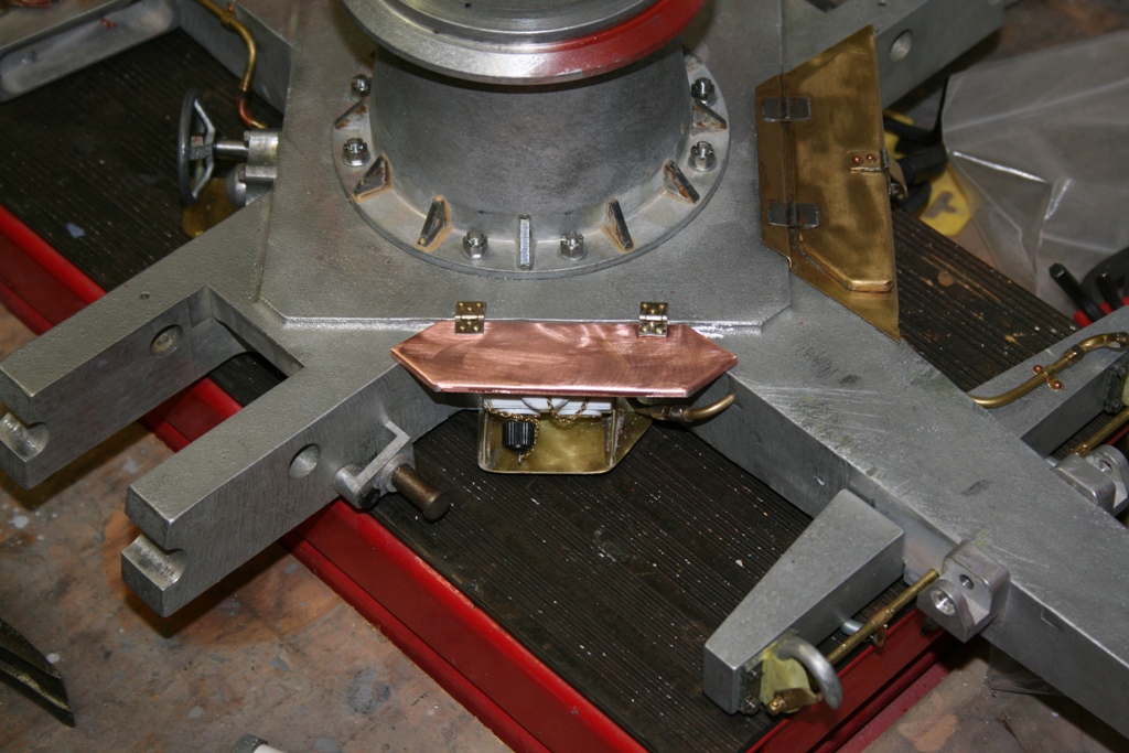

Just made and adding all the fixings to the fold down legs on the cruciform.

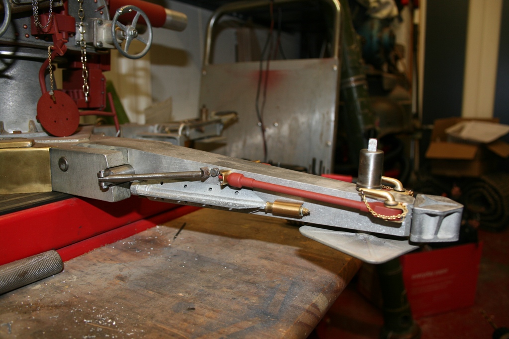

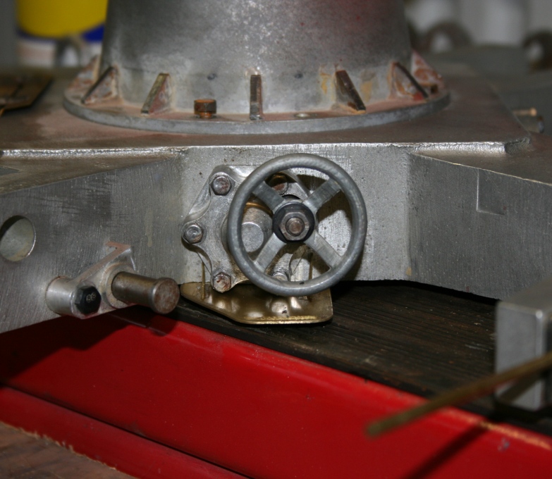

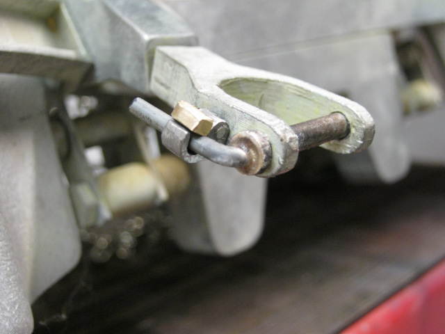

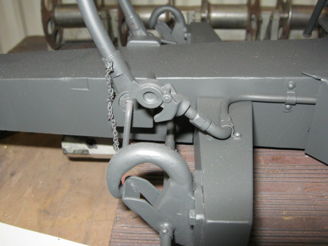

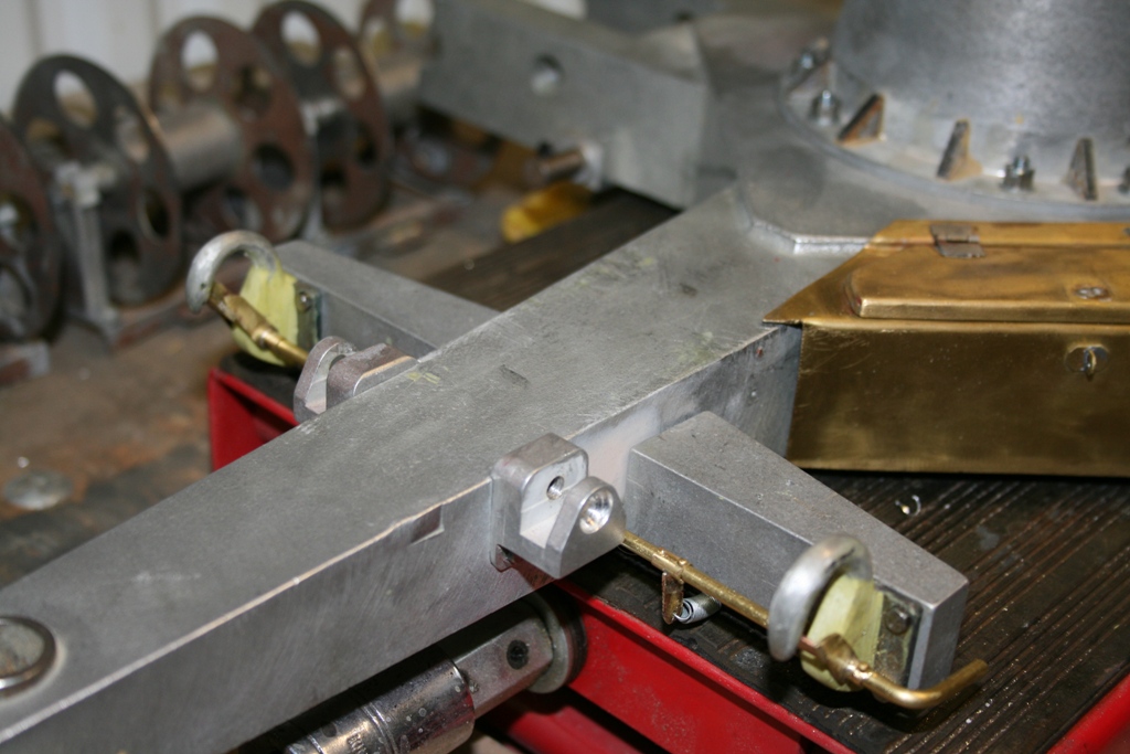

So, after seeing how Uwe had managed to turn the leveling housings round, I had a go myself without the aid of machinery :shock: To my surprise it is quite easily accomplished with just a round file, it took about 2 hours from start to finish.
Housing Wrong Way Round
Housing Right Way Round
original
original

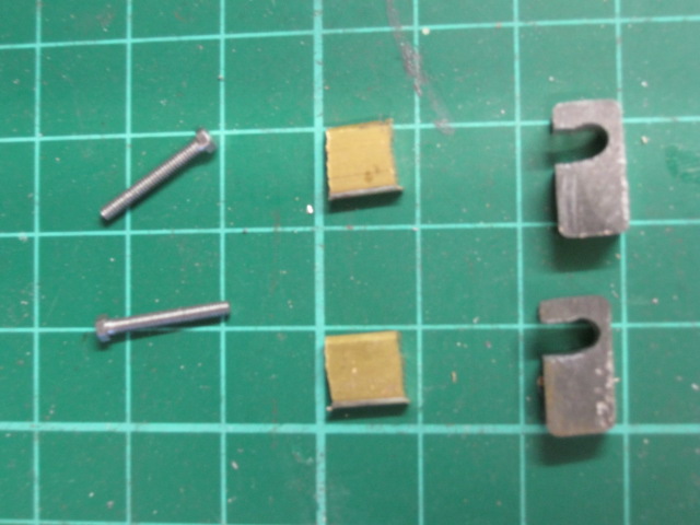

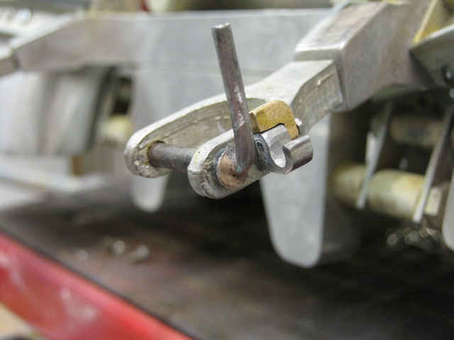

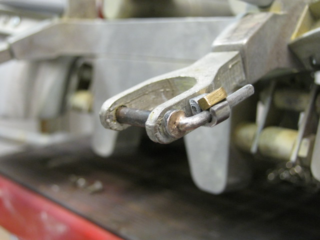

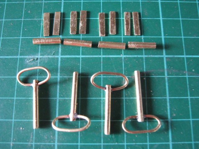

I also managed to complete the bogie hook clips this morning. I used Millput to make the bump out with a brass insert. I know it would have paid to get someone to machine new ones, but as there is no stress on the Millput I don't think it will ever com off.
More tomorrow.
Paul. :wink:

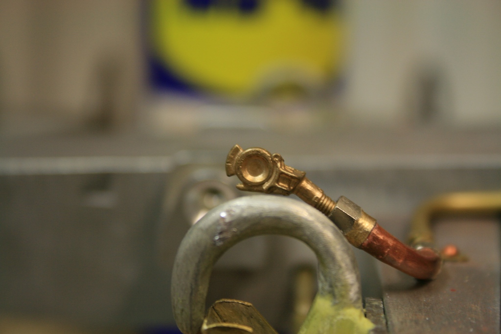

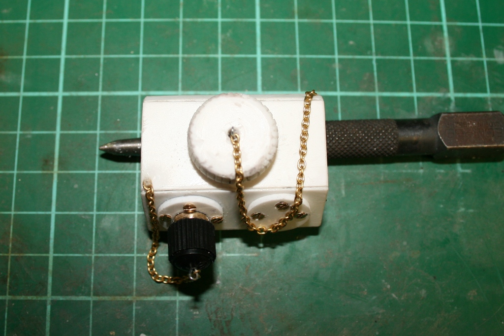

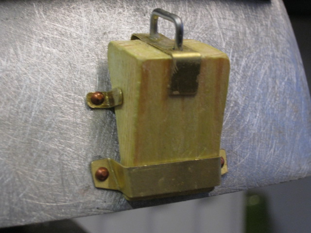

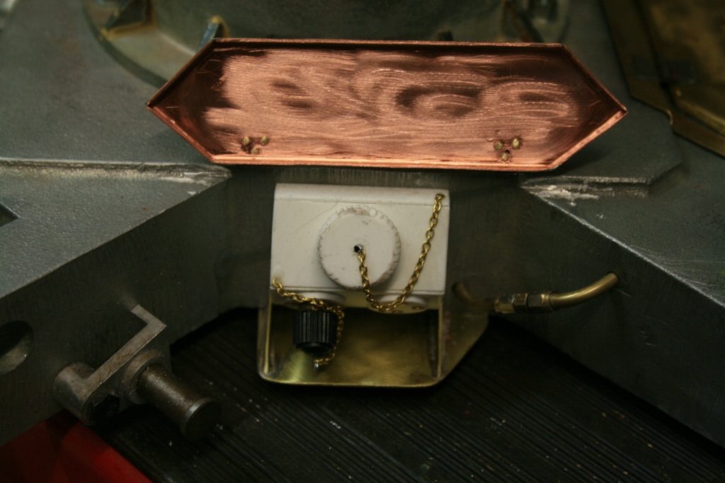

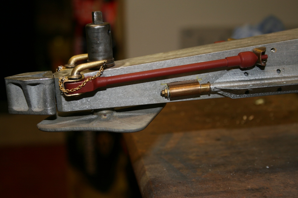

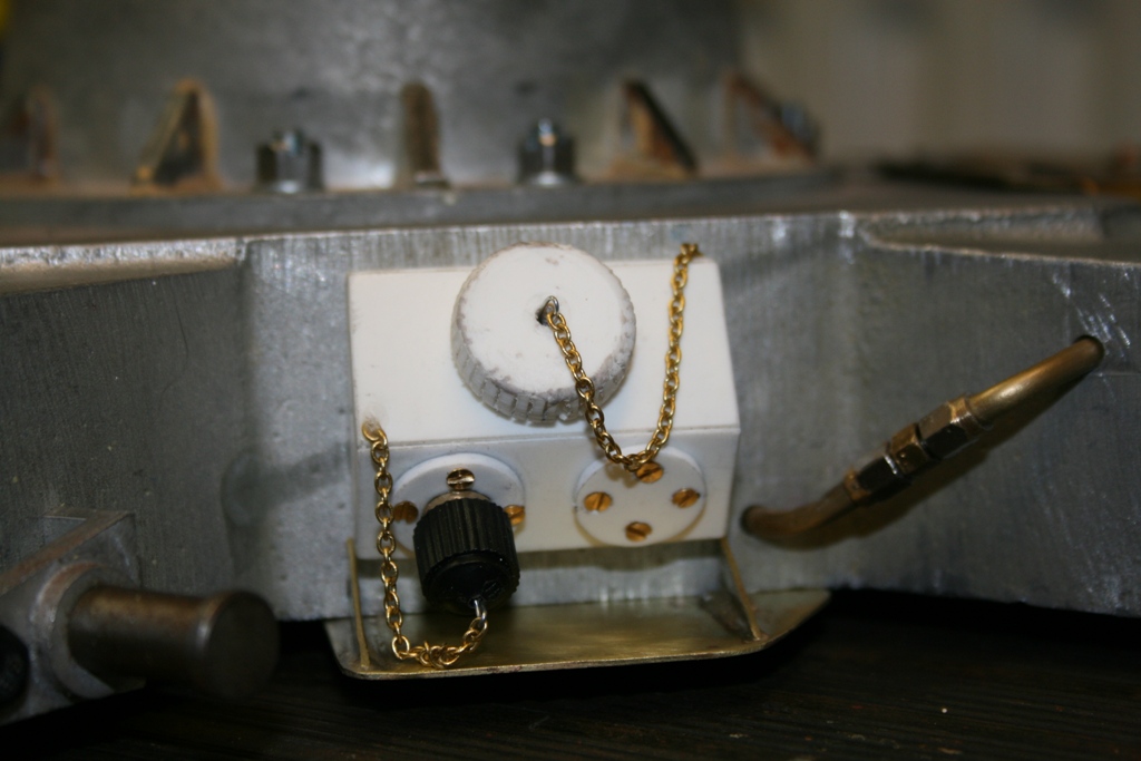

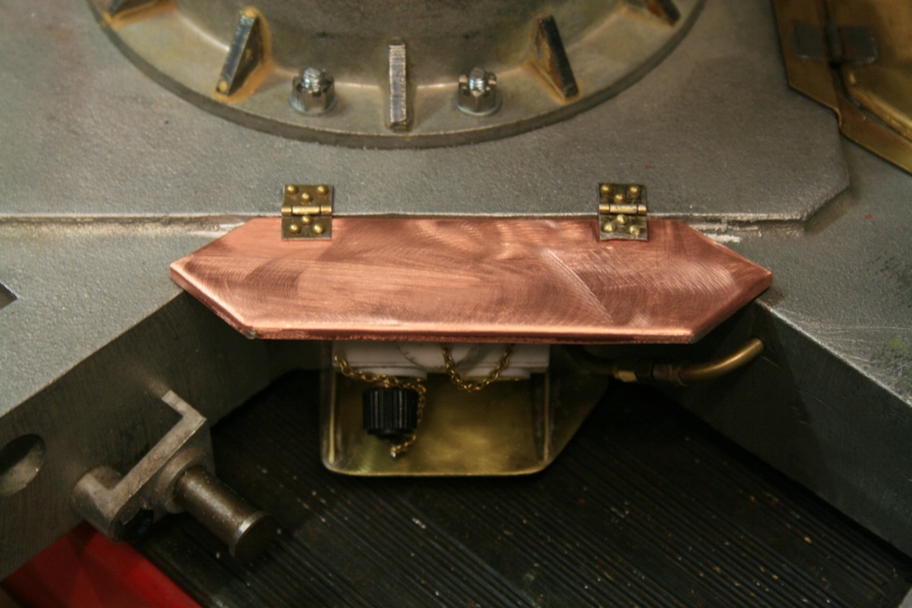

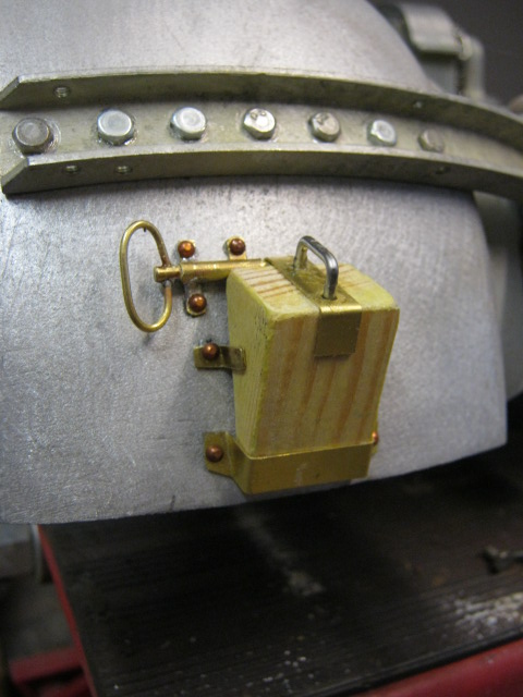

Made the electrical box out of plasticard, base plate out of brass and cover out of copper. I ran out of brass so I used copper on the lid, its easier to work but I couldn't get the crisp lines you get with brass.
Original
Original
Thanks to Uwe for helping me to get these air brake connectors 8) :D
Paul. :wink:

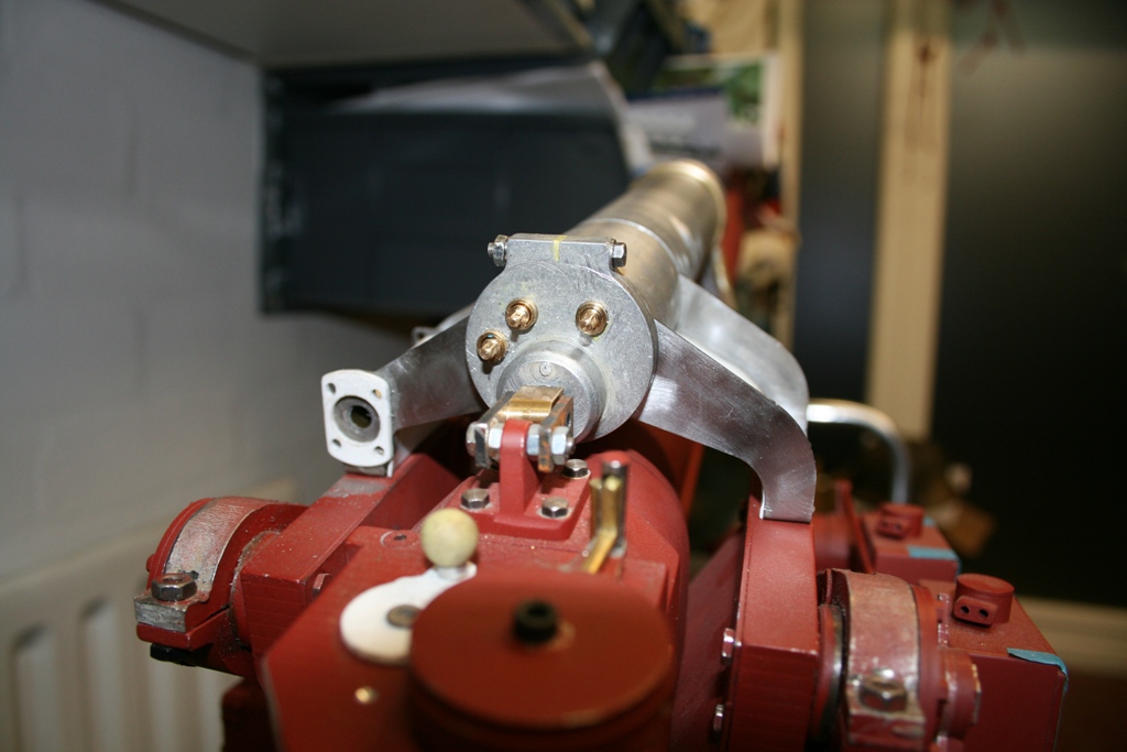

I have managed to get by without the use of a milling machine or lathe on this build, but I have stated to run out of things I can do without them. Thanks to my good friend Uwe sending me a Christmas present I have been able to add some of his detailed parts 8) :D
However, I have reached the point where I cannot do any more to the gun without machinery so I will have to move on to the bogies.
Thanks again Uwe 8)
The other details you can see, mainly in plastic-card are mine :wink:
Recoil front legs reworked
Paul. :wink:

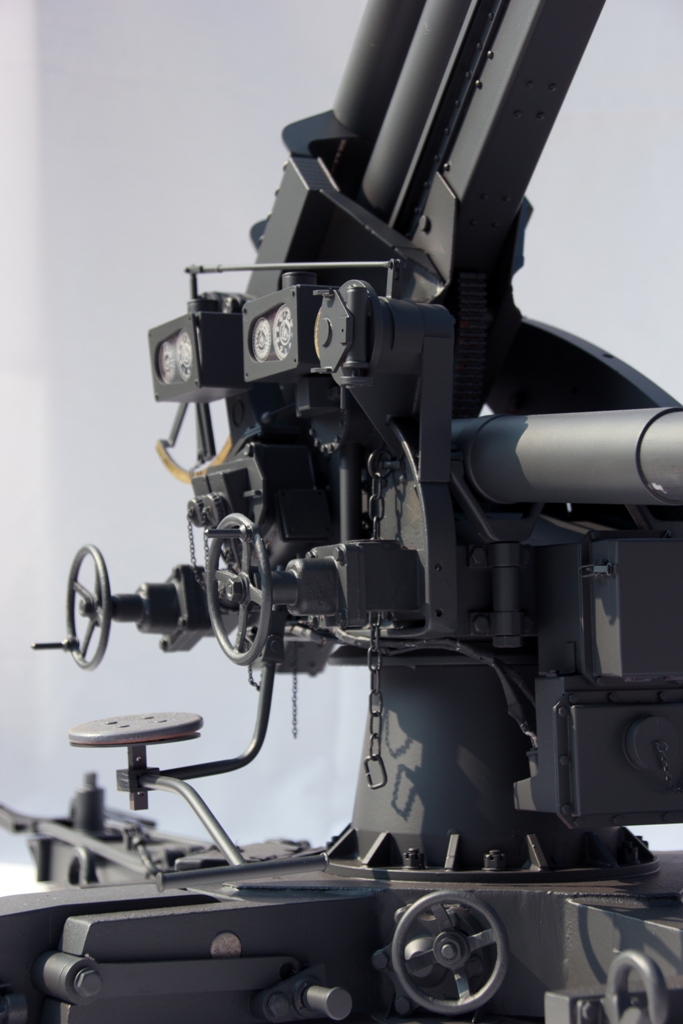

Now that the weather is warming up I can get some painting done.
I am still toying with the idea of adding a Dunkelgelb Camouflage, but I can't make my mind up. My mate said not to when he called round the other week. What do you think :?:
Seen as there's nothing descent on TV tonight, I am sat finishing off the crew. I will post photos tomorrow
Paul.

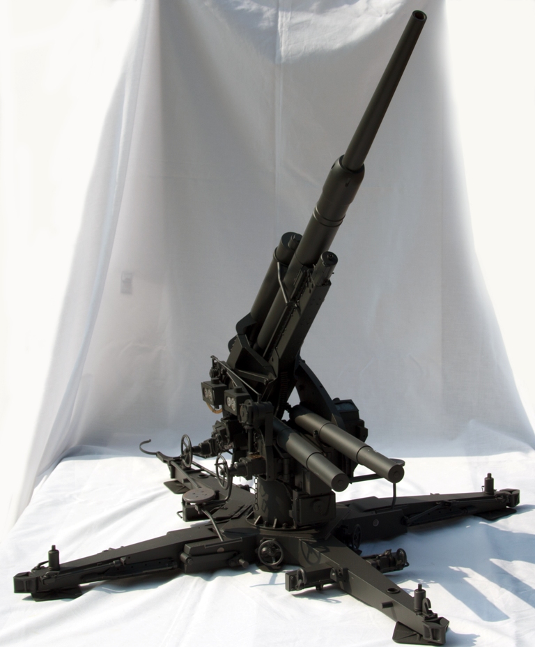

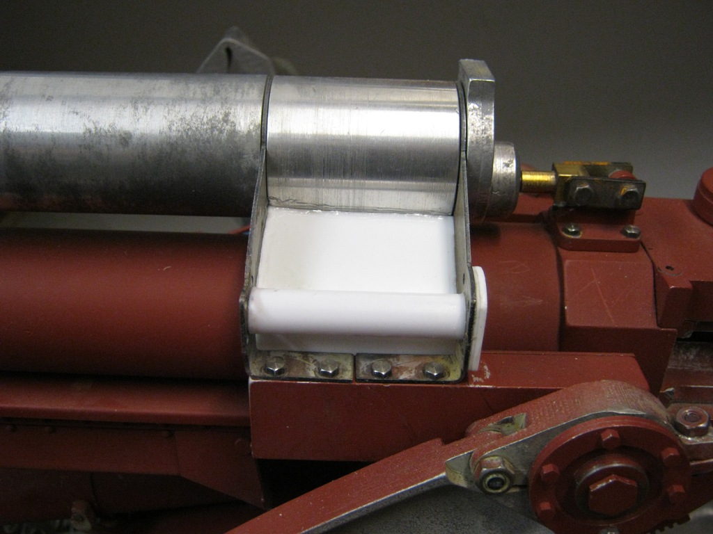

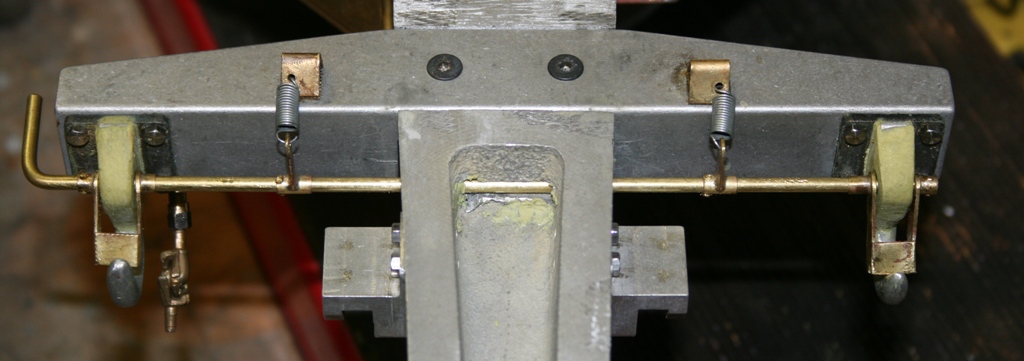

Now I have added Rolf's brilliant air connectors the 88 is finished.
Now its onto the bogies :shock: I've have to admit I haven't been looking forward doing these. Having sold my lath and Milling machine some years ago, everything has to be made the hard way or with alternative materials :? See what you think of these.
Paul. :wink:

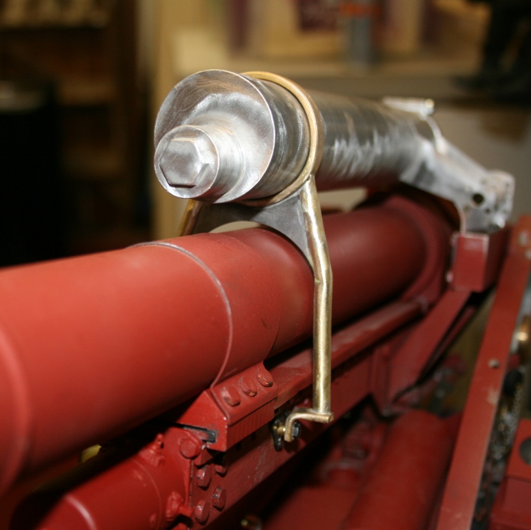

Paul Wills
Posts: 1043
Location: The Lake District
Has liked: 646 times
Been liked: 143 times
Re: Slow build Flak36 88mm
Post by Paul Wills »

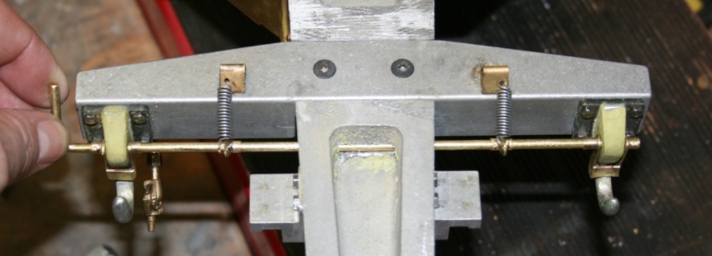

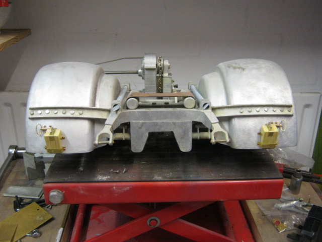

One more detail crossed off the list. :D
All done with the aide of a dremmel, a bench grinder and some silver solder. I can't get much more done this week, its back to reality and work! hopefully I will get time next week to add some more.
Paul.
