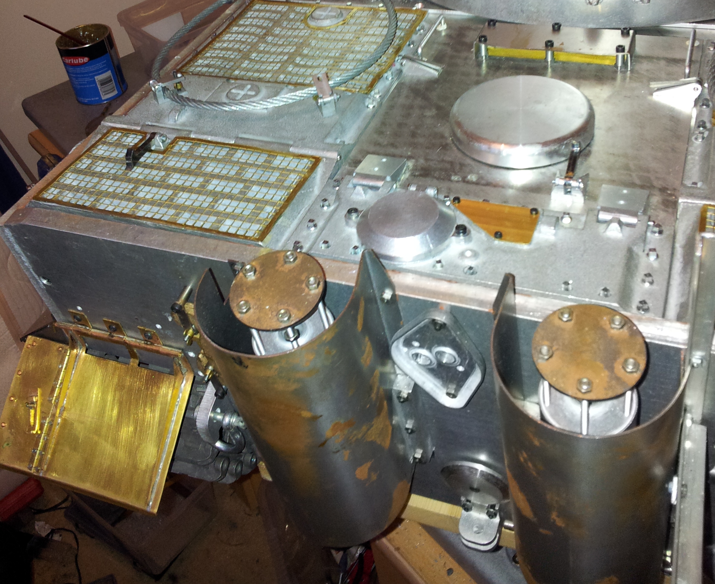

pretty much all assembled. Now to disassemble it and paint it - after i move

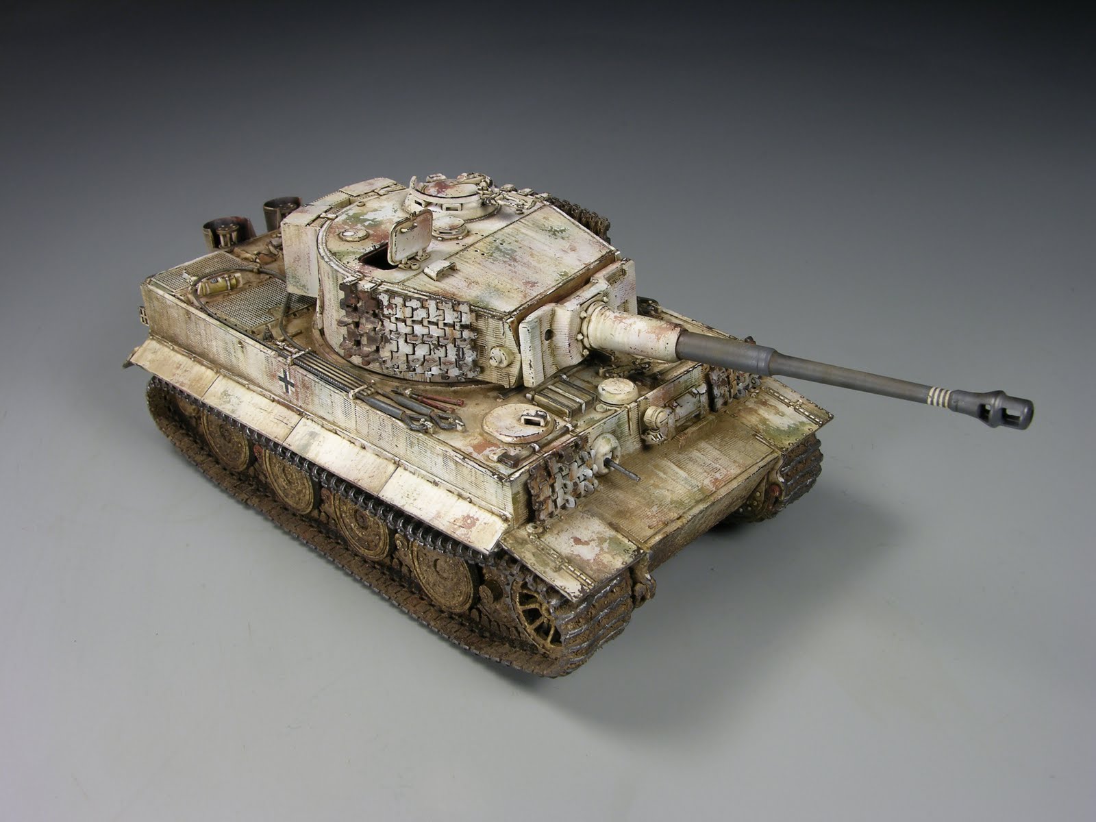

Not many white-washed Tigers around - that might be something different to try ?
Re: No 012 - Bedroom Build
Good idea, will look into it. It will take more work though as white will need so muich more detail on it. However the end result will be good.
Found on the net
Found on the net

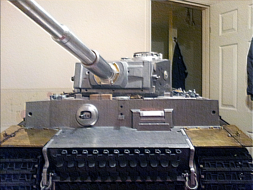

I sunk all the square heads. Looks so much better.

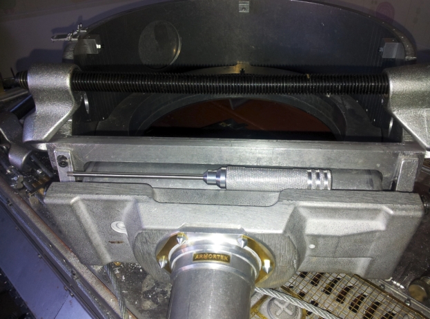

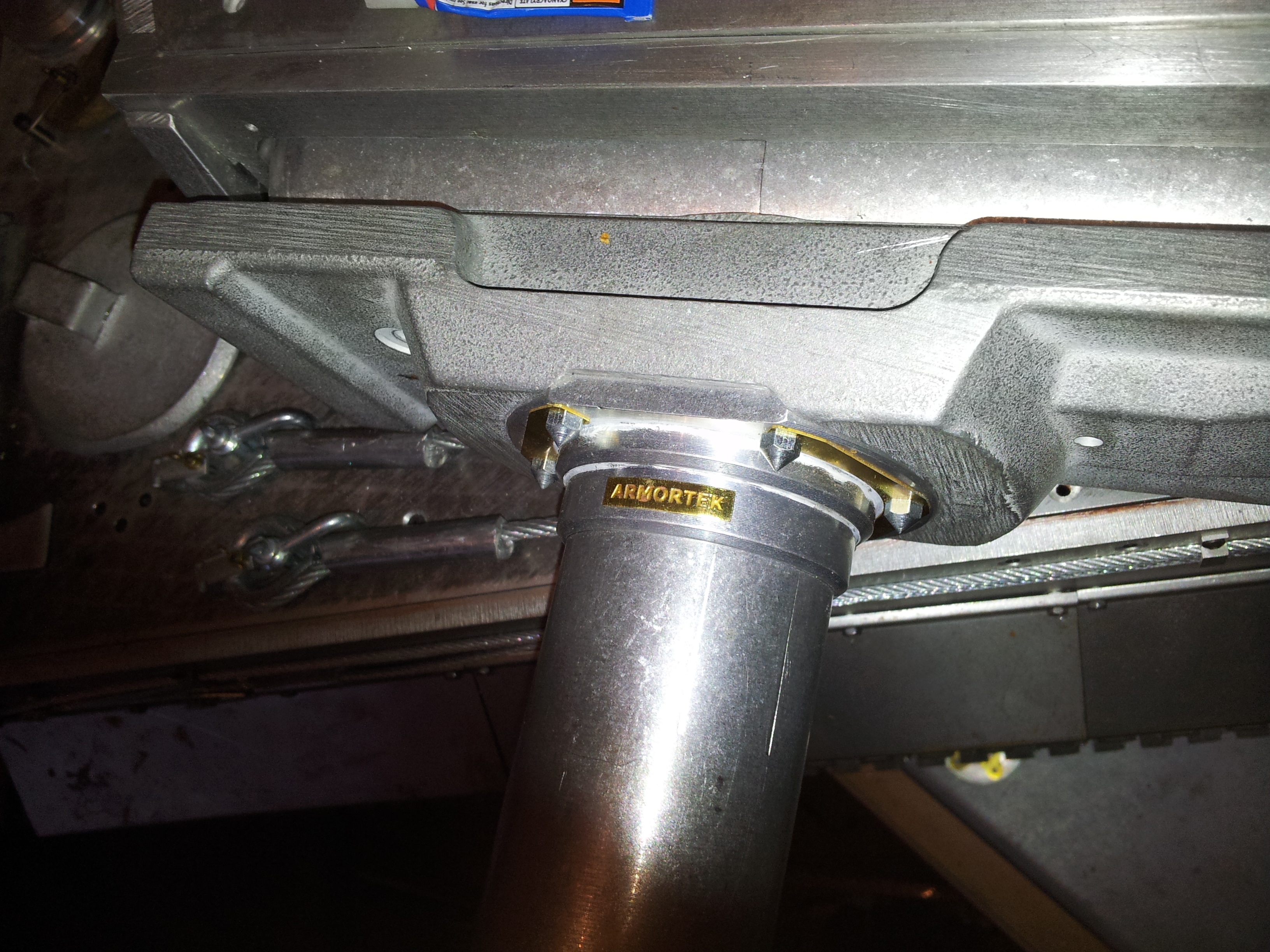

I found i had quite a twist in the turret surround that left the outside wall leaning outwards from the top and consequentially the gun frame and gun sat at a slight angle. Also the gap on the turret roof was too big. It was quite liveable but it annoyed me
So a pair of suspension spring tensioners came to the rescue. I’m gonna bolt in the frame from front then fill the bolt holes, and add a tension bar just bellow the turret top edge at the front of the turret.
