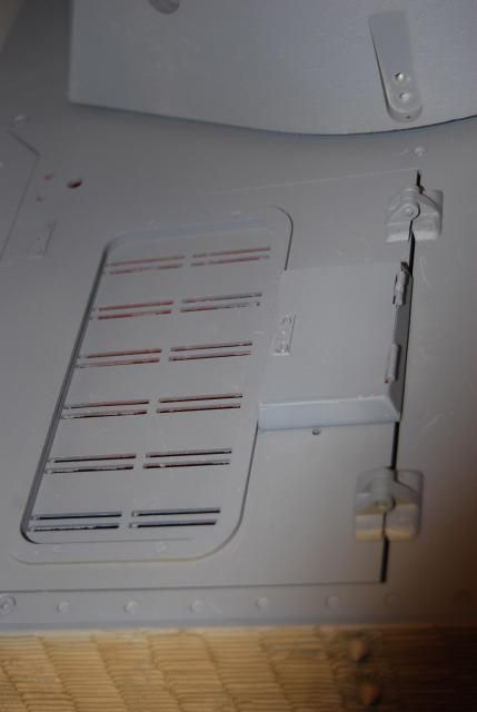

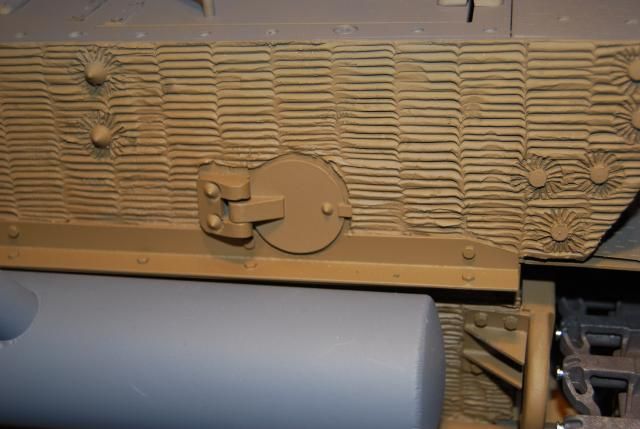

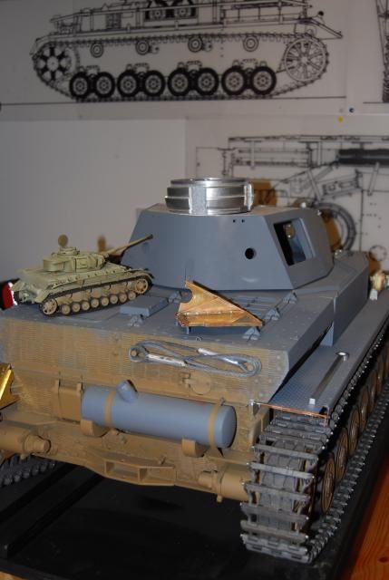

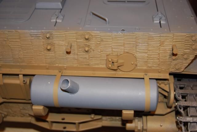

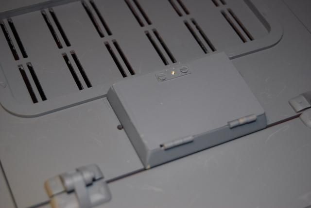

Rear plate port cover fitted. Could be a useful place for a switch.
Forgot to add tow cable brackets. Will have to remove some zimmerit.

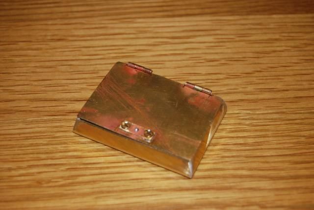

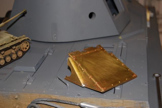

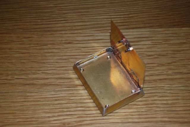

I have made a new water filler cover to replace the block of aluminium supplied with the kit. The lid opens so I might cut through the base and deck for switch access if necessary.

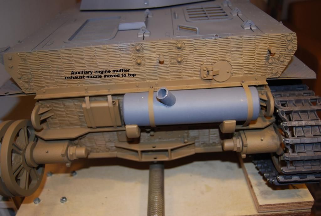

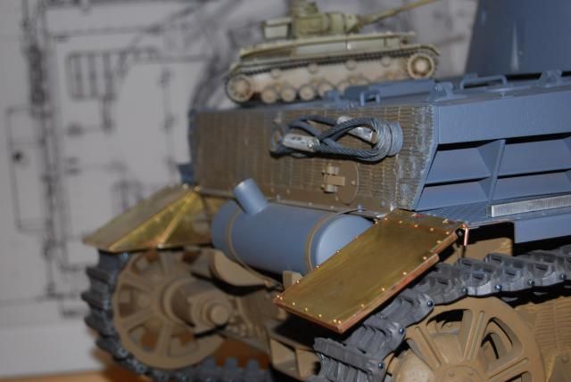

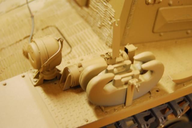

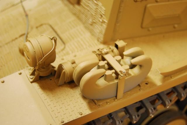

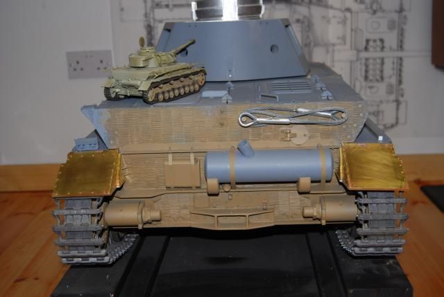

Thanks Phil. A little more progress with the rear. Added the straps to the exhausts and relocated the small outlet pipe to top. Also assed the kit tow rope brackets. The tow rope is I think a bit short.

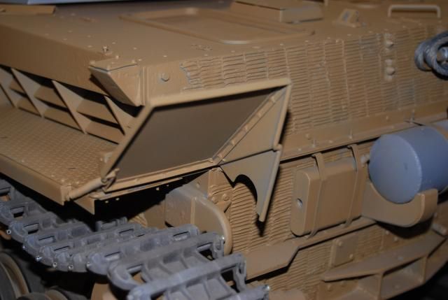

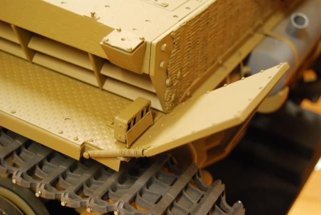

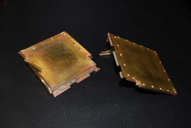

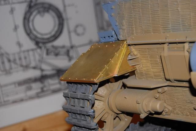

After a long break I am finally getting back to my Panzer IV.

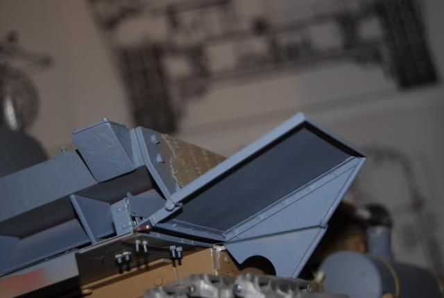

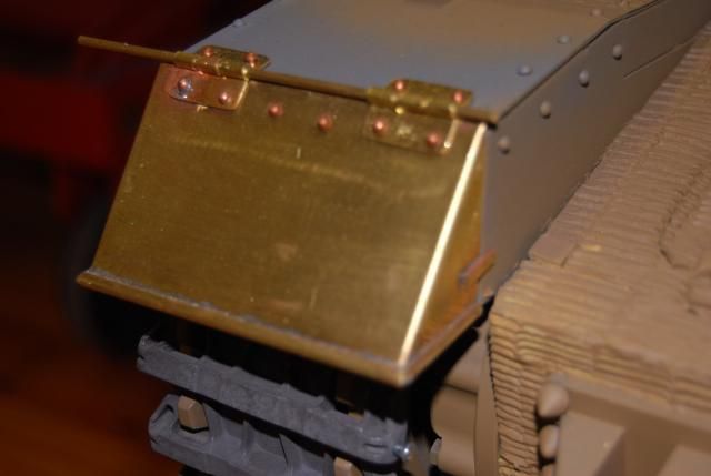

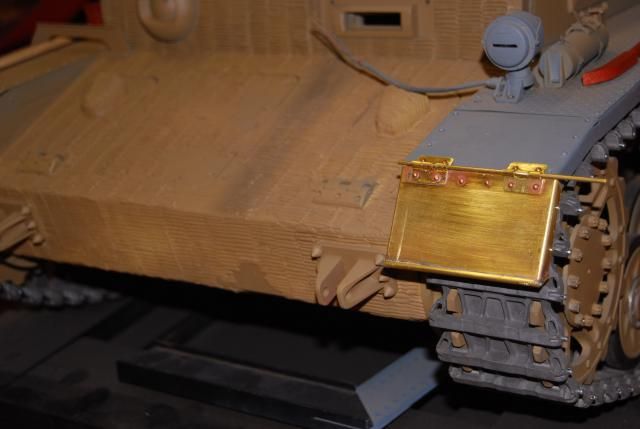

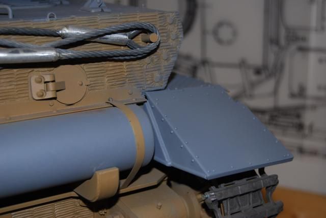

Having first removed the front and rear sections from the one piece kit fender I am ready to add functioning mudguards. I will start with the rear.
To complete, I still need to fit a spring mechanism and reflector

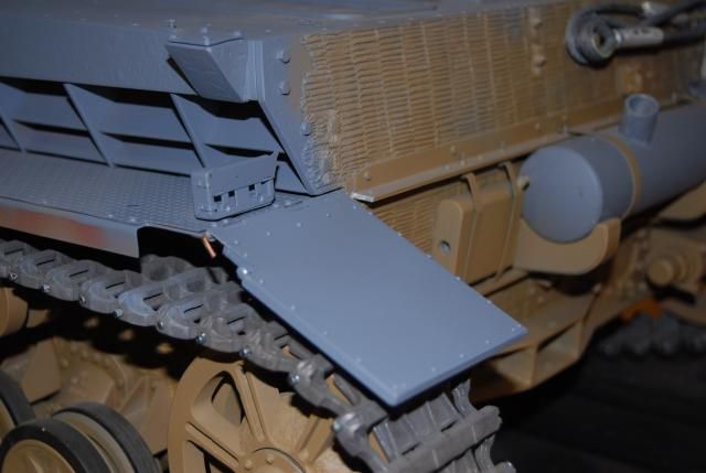

Next to complete the front guards.
Iacopo Di Giampietro
Posts: 226
Joined: Fri May 11, 2012 9:14 pm
Been liked: 48 times
Re: John's Panzer IV no. 004
Post by Iacopo Di Giampietro »
Great work: very interesting and beautiful!
PS: be careful that the rear notek was mounted upside down ....

Lacopo, i will fix the notek. Just loosely fitted to avoid loosing it.

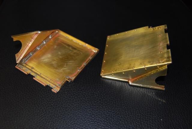

The panzer IV mudguards are quite complicated in shape and kit part was very basic.
Worth the effort.

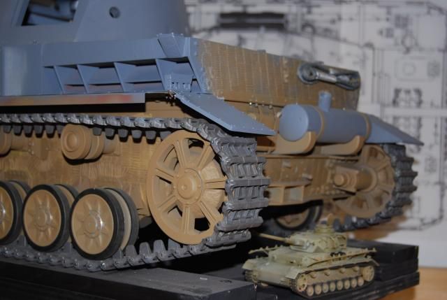

Posts: 2349
John,
The rear fenders are superb! Great addition! Your brass work is excellent.

Posts: 1762
Location: Northern California
Been liked: 177 times
Post by Tim Bowman »
Hi John
Your rear fender/mud flaps are PERFECT! your brass-work amazes me every time you post something new. Very nice!

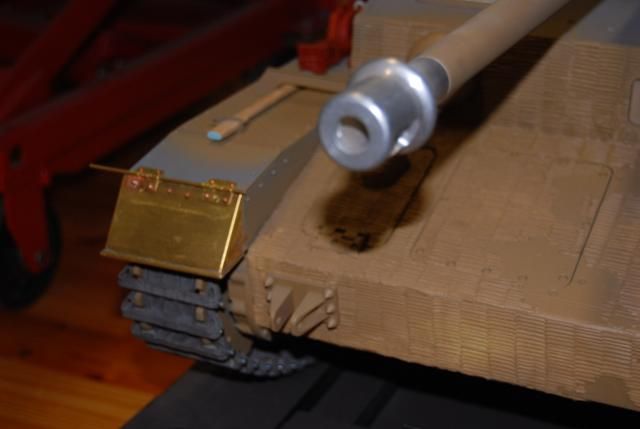

Thanks Bob and Tim. I have started work on the front mudguards also. Still to add the spring mechanisms to both front and rear guards.

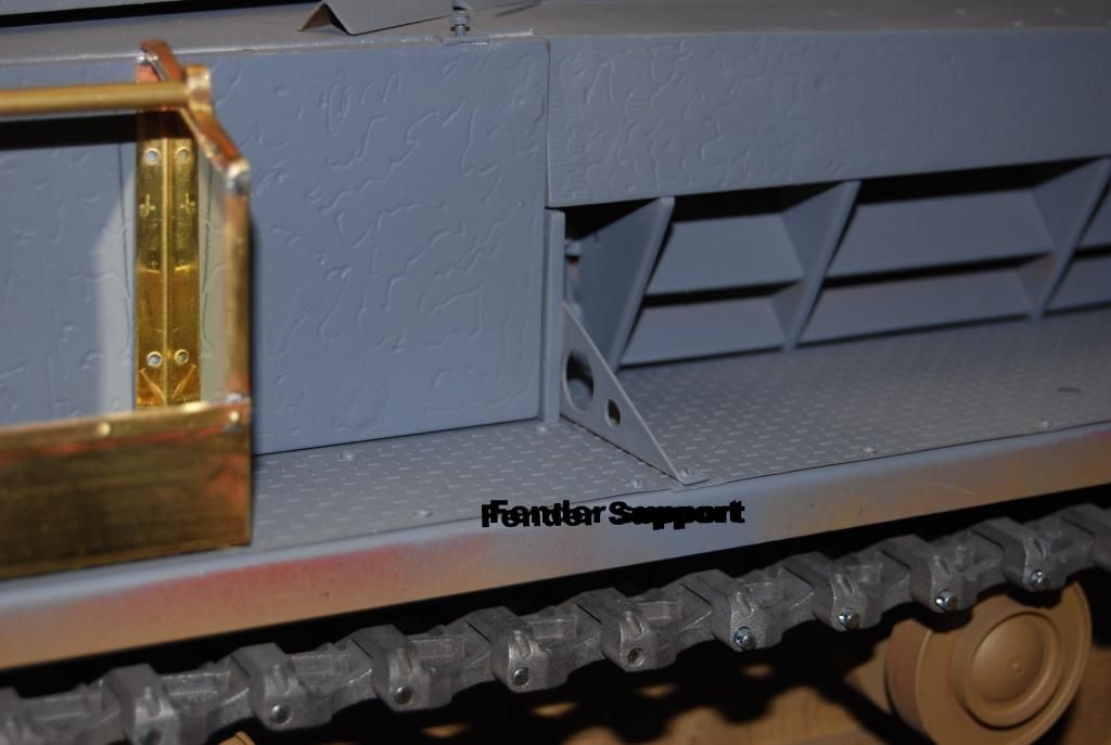

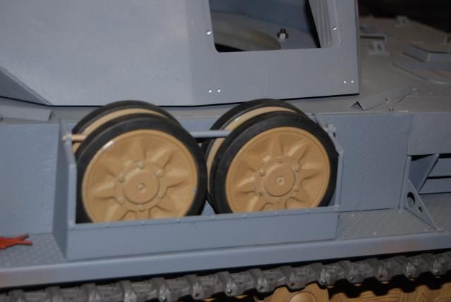

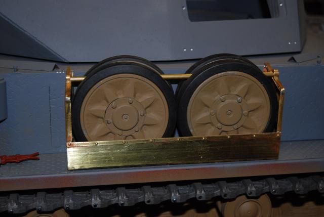

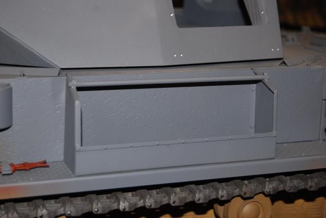

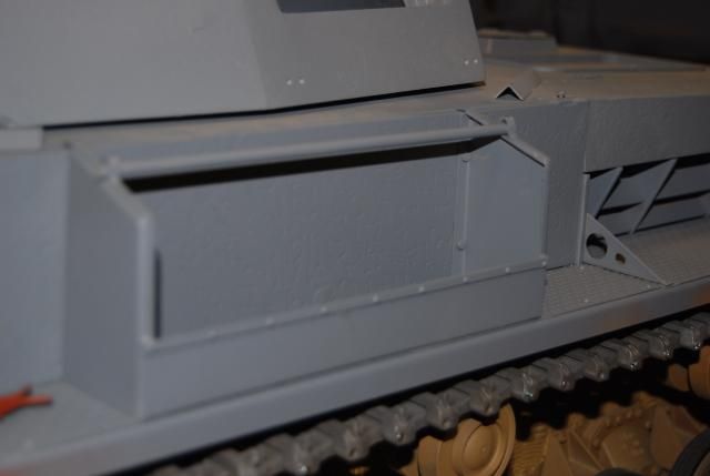

I am replacing kit spare wheel box with my own version in brass. also making some fender supports.

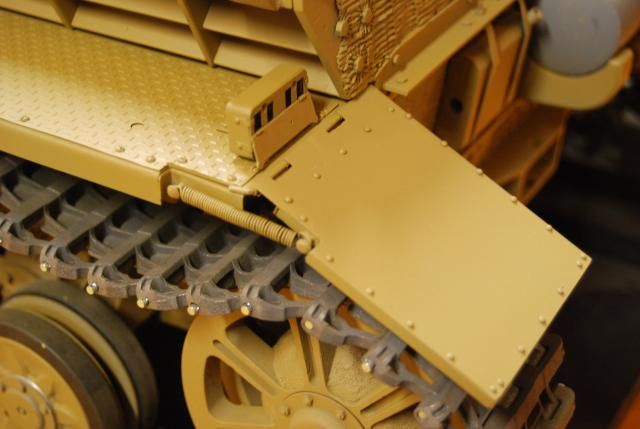

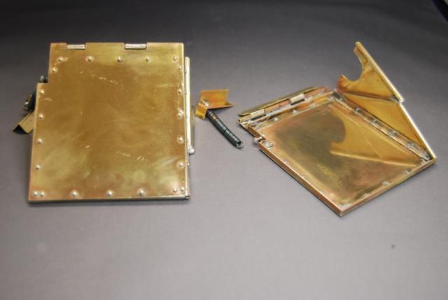

Finished the rear mudguards. Added spring mechanisms. Made my own springs from steel wire. They work nicely now.
Added C hook holder. I used the kit C hooks but reshaped slightly.
