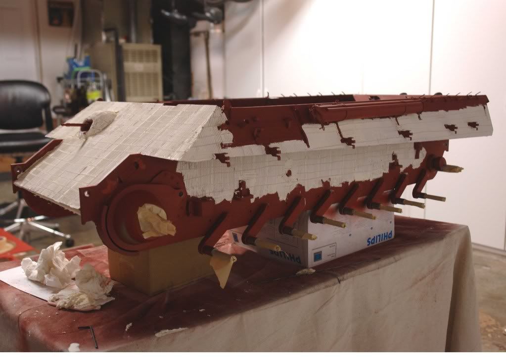

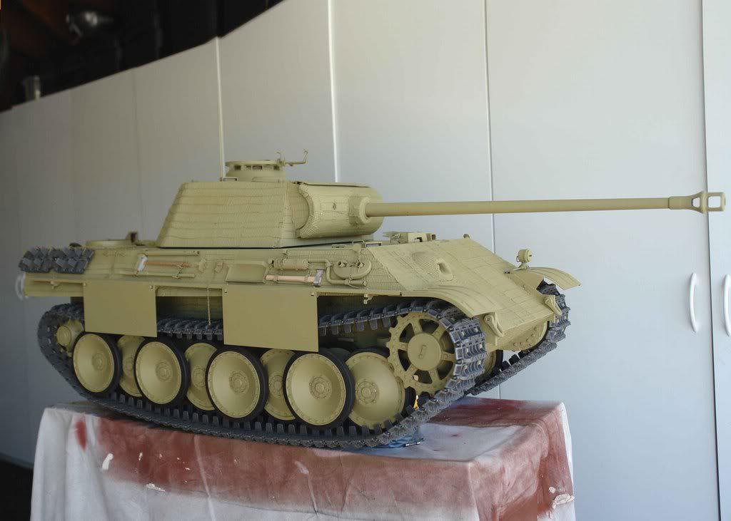

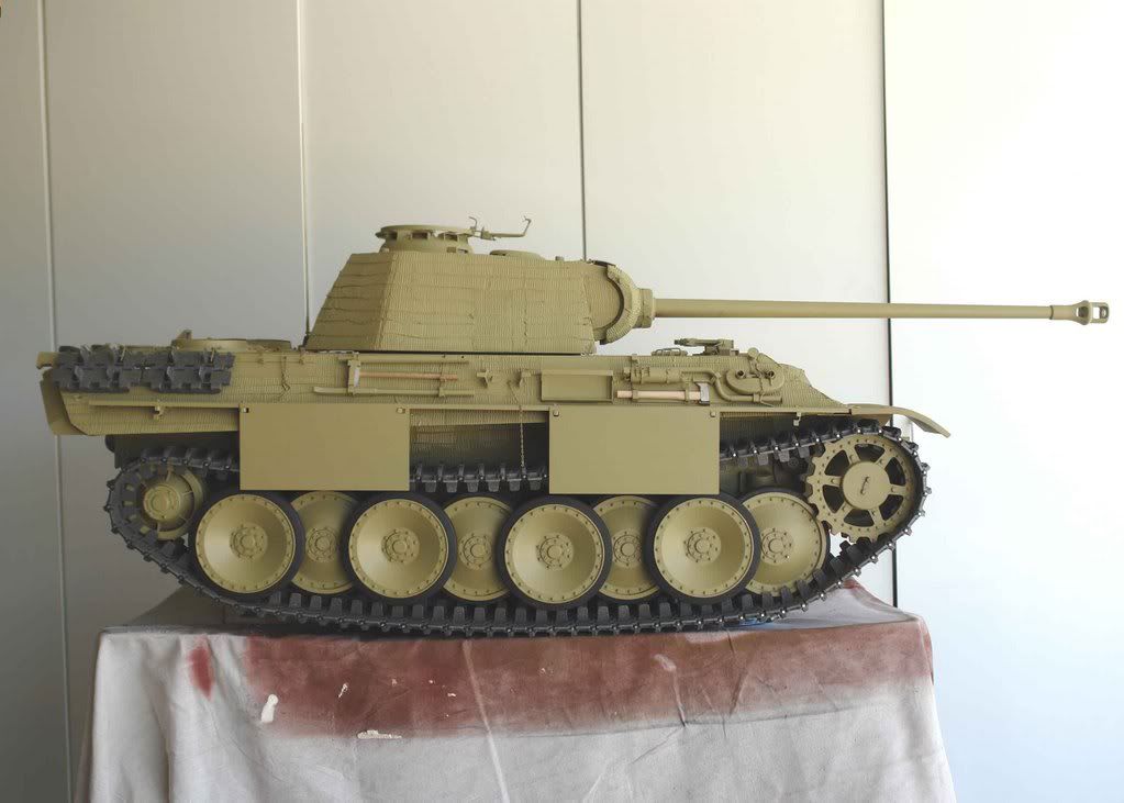

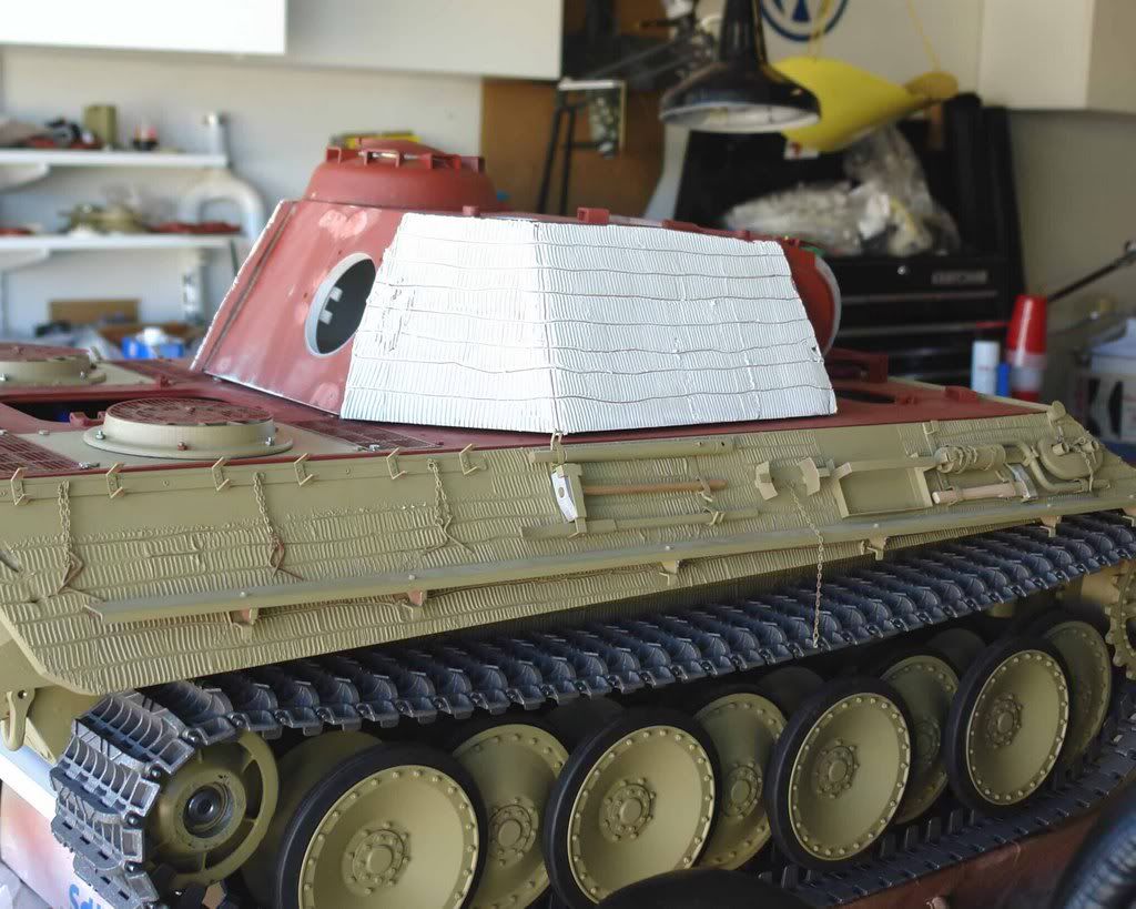

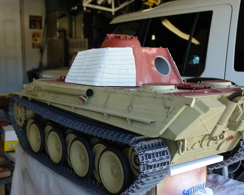

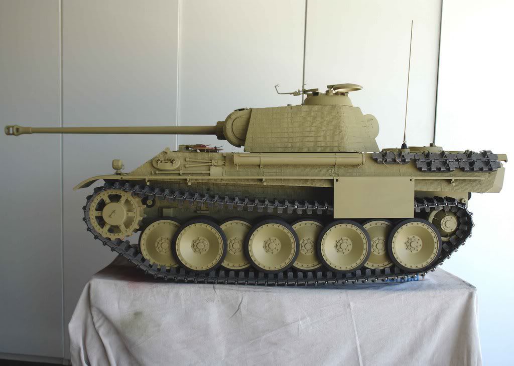

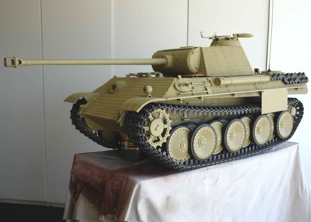

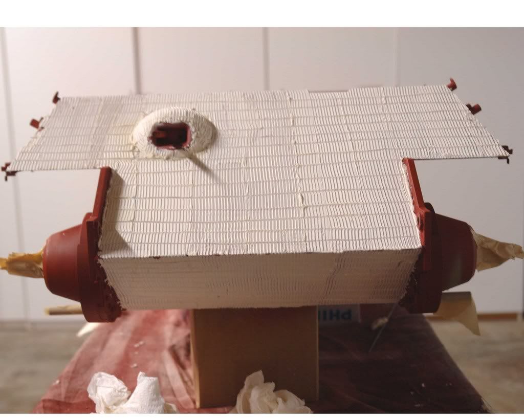

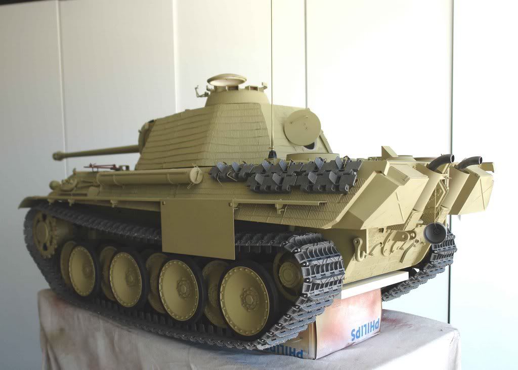

It was my first attempt at zimmerit so I was alittle nervous. I tried several other materials and then settled on this one(see photo). It looked most like the reference photos I had of war time factory applied zimmerit. It is inexpensive and you can find it in smaller containers then this. I was worrieid that my application was too sloppy but once painted, I was quite pleased and again, looking at the real photos, I actually liked the ones that aren't perfect. I'm sure it was difficult to achieve perfection between allied bombing raids in 1944.
The work time with this stuff is a few minutes depending on how thick. The best part is that if you screw up, you can get it off with water and a rag and then redo. I had to do this on the mantel.
I wasn't sure about durability but now that it's been on there awhile and has been banged, it seems to hold up just fine. I figure the real stuff got banged up and knocked off anyways so no big deal.
Some spots on mine are better then others but oh well..good practice for my Tiger
Dale here's what I used and some photos pre paint.
