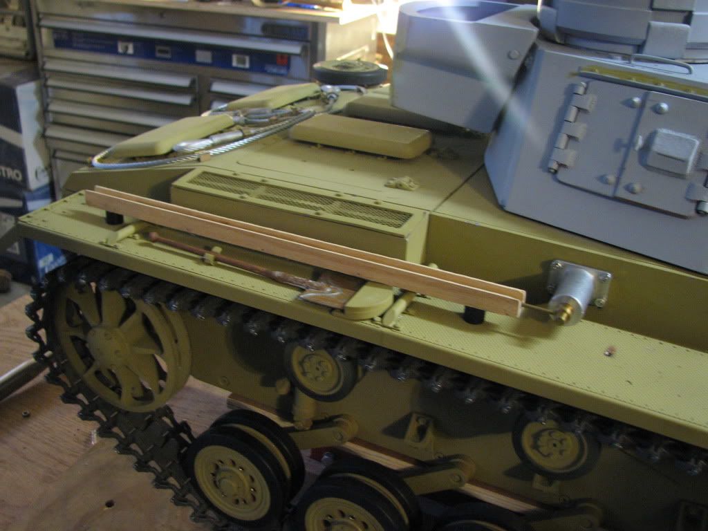

The turret will turn 360 and the elevation motor works fine. I still need to add the servo motor for the machine gun. Taking the speakers apart and soldering the wires out the side dropped them down ½ an inch.

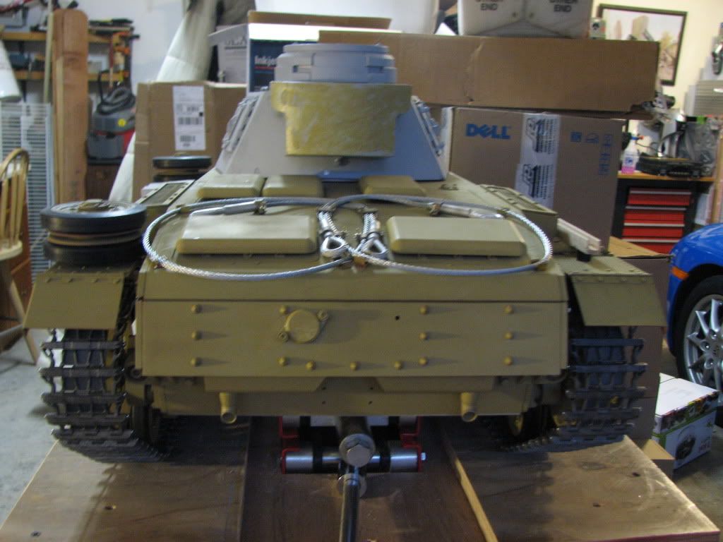

Lift device
Thanks for sharing. It looks as though you've found a lift device that will fit under a Pz III. Can I ask what make it is?
All the ones I've seen recommended so far need to be recessed into the table to get clearance under the vehicle.

Build Log
The stand is from eBay:
http://cgi.ebay.com/ebaymotors/ws/eBayI ... &viewitem=.
I did recess the plywood top on my scissor lift table. Then I added a ¾â€
