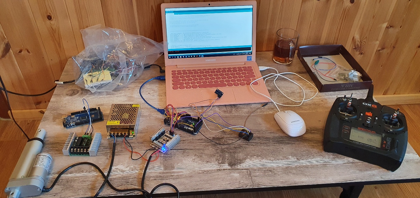

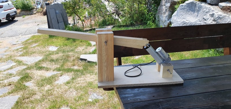

Re: Chieftain kit arrival
Richard Goodwin wrote: ↑Fri Jun 19, 2020 7:09 pmGreat effort YoungJae, well done.
I would agree with the comment made by Vince about having more comments though; nothing worse when going through code and trying to fathom out why you did it that way! I found that comments almost at every step, would allow me to go to the correct area every time and was extremely useful later on if I had to revisit.
I agree with Vince and Richard.
I will use our motion controller to raise the source code to version 2, and attach the notes and the experimental value to all the phrases in version 1 that I posted yesterday.
I will try to finish this series as soon as possible.
However, if the hardware changes, I have to modify the source code and experiment, especially since I have to call a new head-up file.
Youngjae
- Has liked: 792 times
- Youngjae Bae
- Posts: 277
- Location: South Korea
- Has liked: 761 times
- Been liked: 613 times

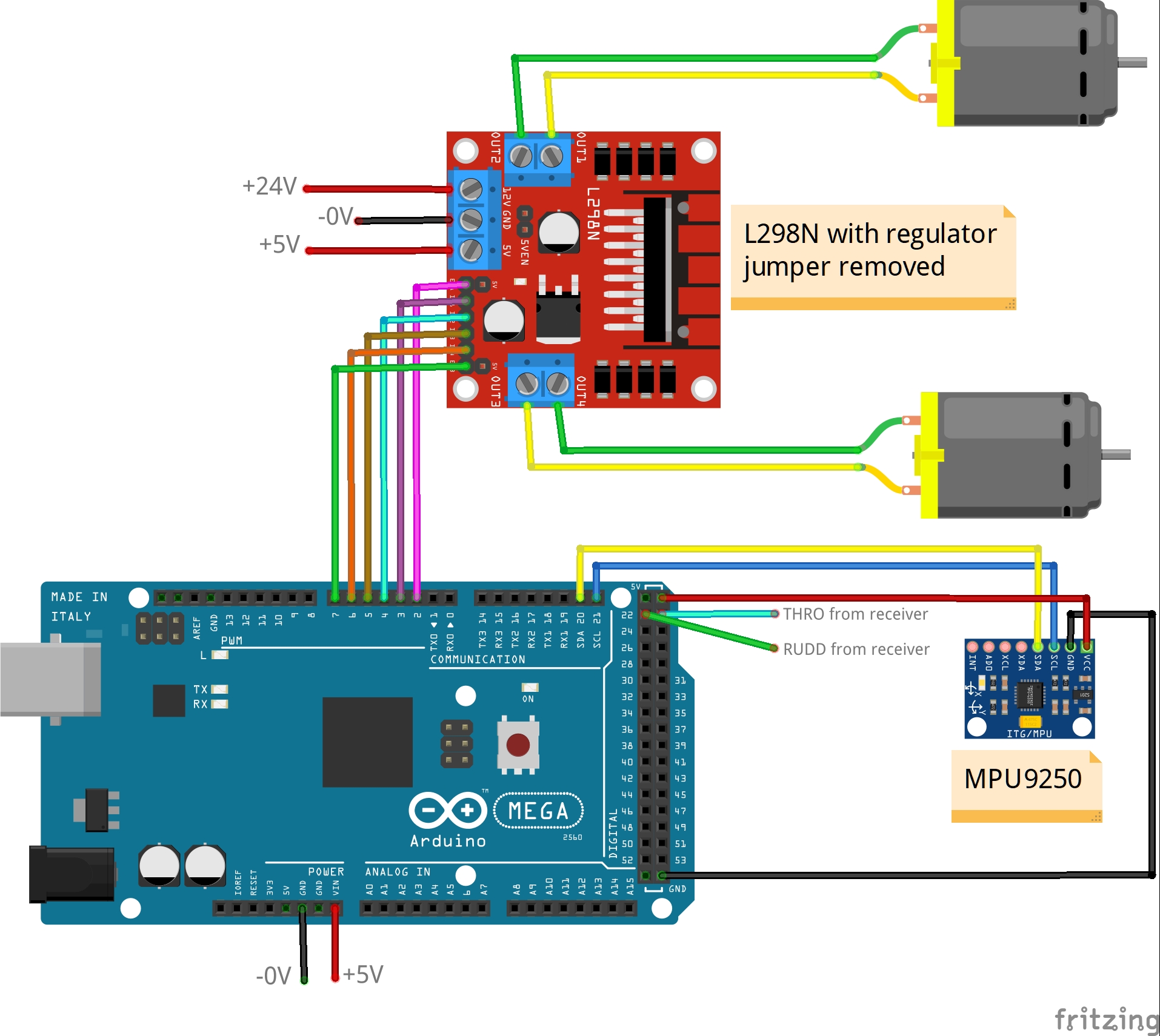

Vince, your detail and concentration are so touching.Vince Cutajar wrote: ↑Sat Jun 20, 2020 3:08 pmYoungjae, is this how you connected the modules?
I corrected some typos and annotated them.
I added the function to fix the turret and main gun by adding the switch channel number 52.
By adding this function, the main gun and turret can be safely secured even when the transmitter is turned off by mistake.
Youngjae

pulse = 0;
return pulse;
* This source code was written by Youngjae Bae to reduce unnecessary elements and stabilize
* the main gun and turret of the big-scale model tank by referring to the code of
* Kris Winer and the condition statement of Vince Cutajar.
* Based on the Arduino Mega, the power of the transmitter must be turned on by dust and
* supplied by the receiver and Arduino, and when switched off,
* the power of the transmitter must be shut off at the end.
* The transmitters and receivers for RC use spectrum DX6 and AR610.
* The motor driver used the SZDLT or L298N two-channel driver.

#define THRO_PIN 22 // THRO PIN IN AR610 CONNECTED TO Aduino Mega No.22
#define RUDD_PIN 23 // Can be replaced with your preferred pins
#define AUX1_PIN 52 // A switch that holds the main gun and turret
// Motor driver pins
#define A1_PIN 3 // Connect to each pin of the Arduino and SZDLT or L298N two-channel driver.
#define A2_PIN 4 // Can be replaced with your preferred pins
#define PA_PIN 2
#define B1_PIN 5
#define B2_PIN 6
#define PB_PIN 7

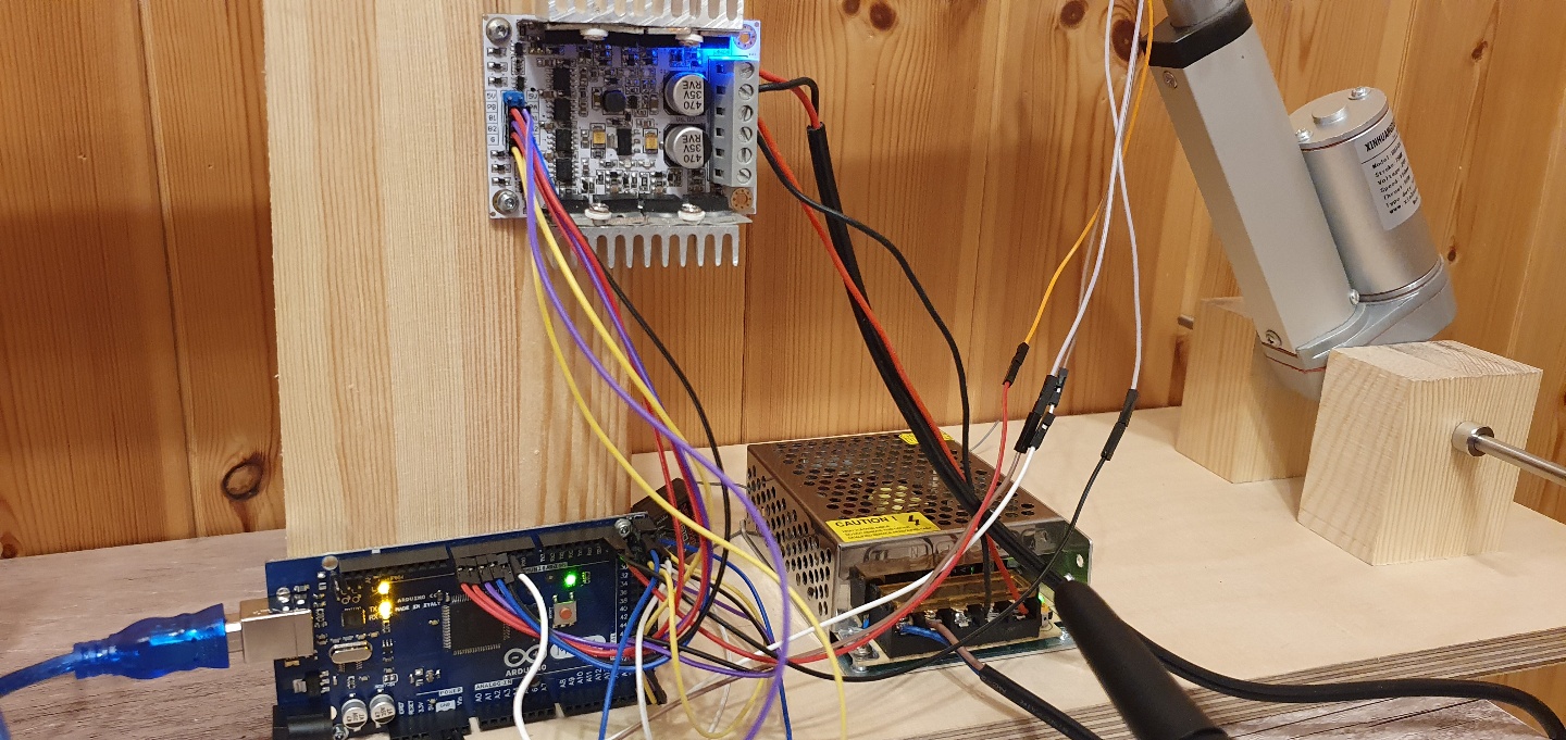

I also share the code for SABERTOOTH as above.
However, SABRTTOOTH has its own signal processing function, and amplification occurs between MPU9250 signals.
I couldn't solve this problem.
However, the two-channel motor driver, which does not have its own computation function, has been directly confirmed that there is no such negative problem because Arduino controls the direction and size.
So I will use this passive motor controller.
I reinforced L298N's insufficient power with SZDLT 2 channel 500W motor controller, which costs about 25USD.
Youngjae

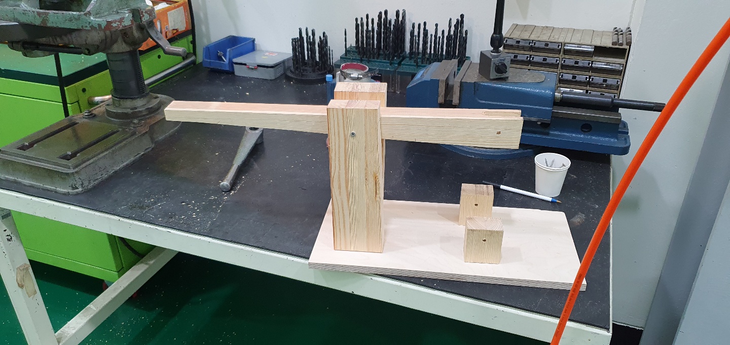

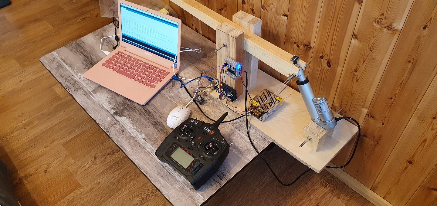

Today, I made a wooden cannon to test the movement.
After work, I will test the range and speed of the transmitter by installing MPU9250 sensor and actuator on this cannon.
After everything has been verified, I am planning to install it directly in my Chieftain.
Youngjae
Youngjae

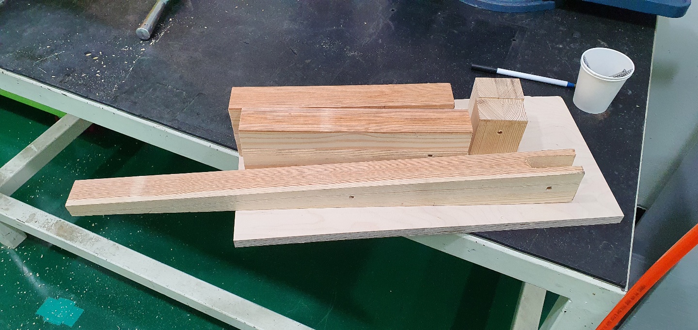

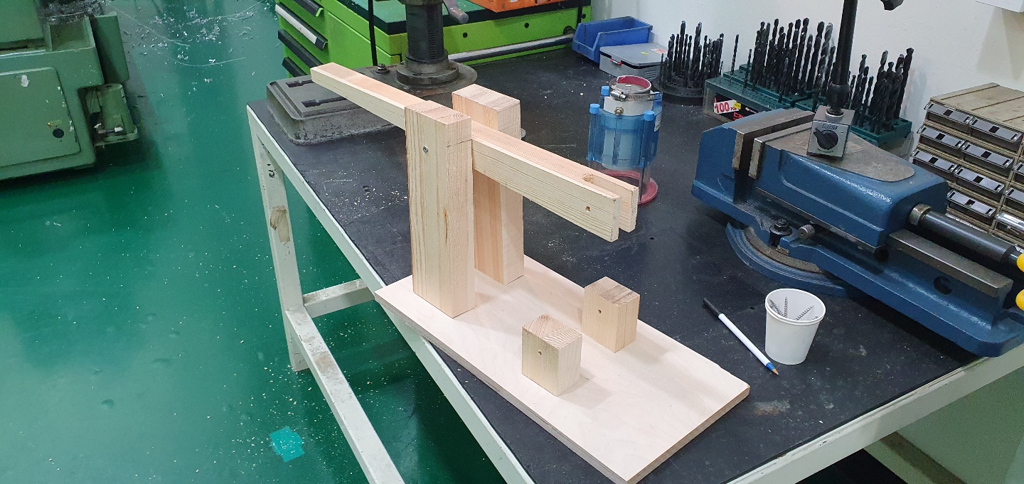

Today I started making a simple model cannon test bed to test the main gun stabilizer.
I installed the sensor and started to find the best conditions for all variables.
These tests will be repeated several times and the most meaningful values will be derived as constants.
I found it very difficult to understand the state of the sensor because it is more sensitive than I thought.
I will be patient and get the best results.
Youngjae
- Posts: 5130
- Has liked: 1481 times
- Been liked: 1687 times
I love the test rig
It looks to me as though the actuator operates much faster when controlled by the receiver than by the Arduino. Do you think that is the case ?
I don't think Google understood what you said here: "I found that sensors are more sensitive than raw giggles"
