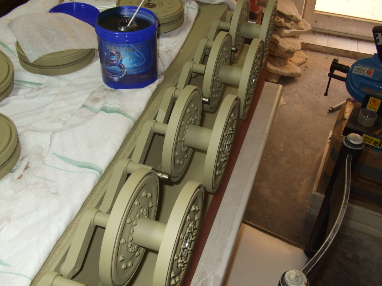

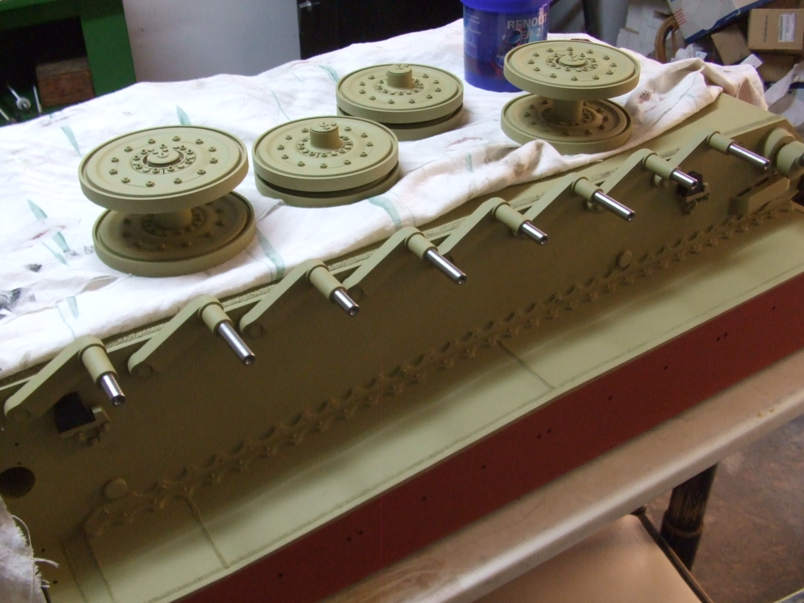

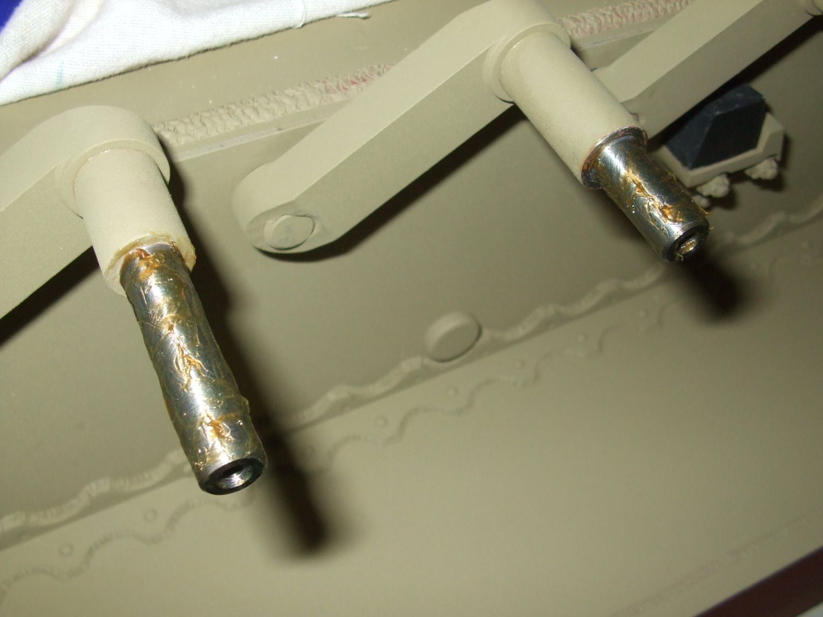

Today I managed to fit all the road wheels to the model. With the swing arms set at 30 degrees it is very difficult to fit the wheels with the tank hull right way up, so with the help of my wife I put the tank hull upside down to fit the wheels. Removed all the masking tape from the axles and with some 400 grit sand paper removed any signs of rust and wiped them with some acetone.

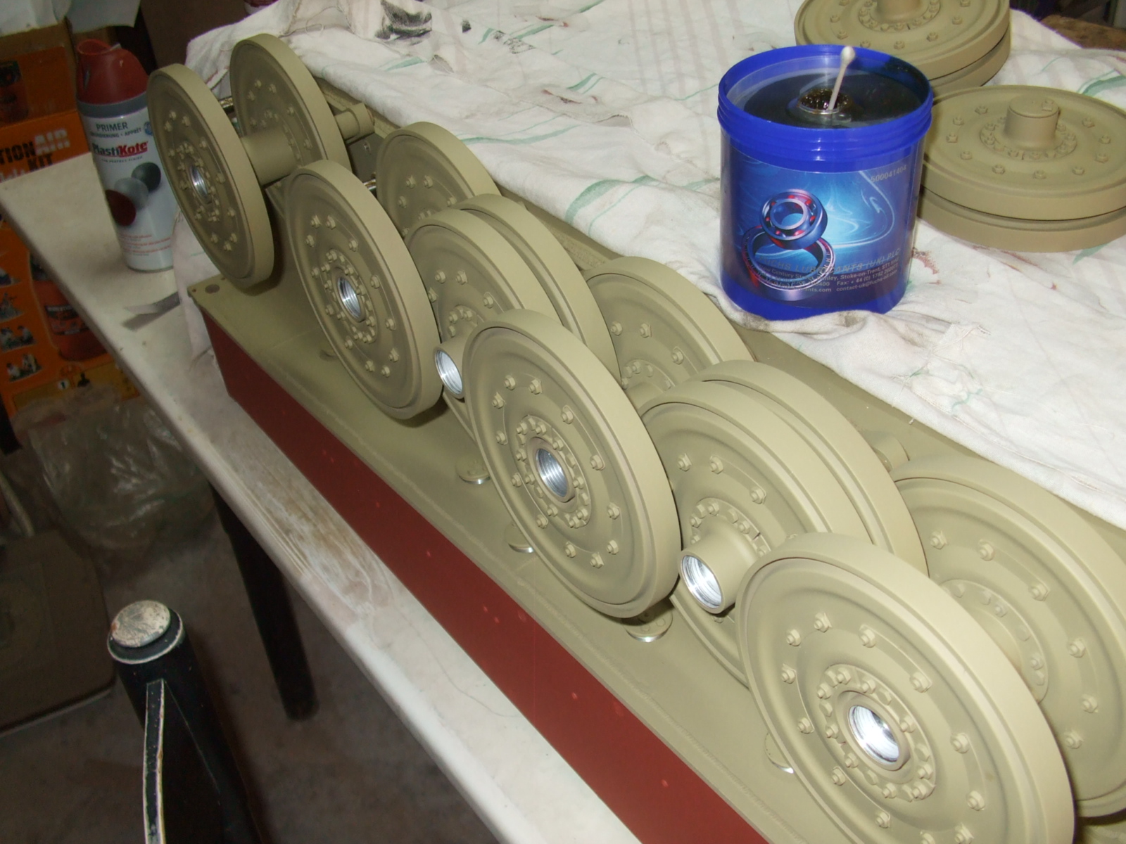

This next step is not recommended by Armortek but I did it for rust protection. I live close to the sea with high humidity so rust is a big concern to me. I applied to each axle some general purpose grease.
Fitted the wide spaced road wheels. At this stage they are just resting on the inner bearing.
Fitted the first narrow road wheel between the wide spaced wheels. This is also just resting on the inner bearing.
Continued with the rest of the narrow road wheels.

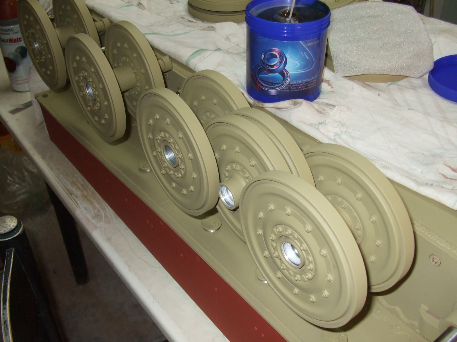

All road wheels were inched inwards until the axle shoulder was reached.

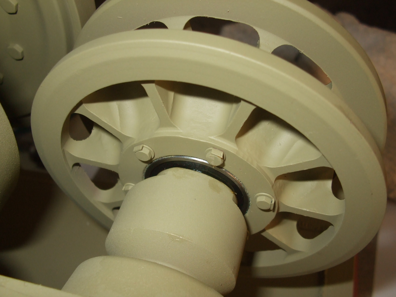

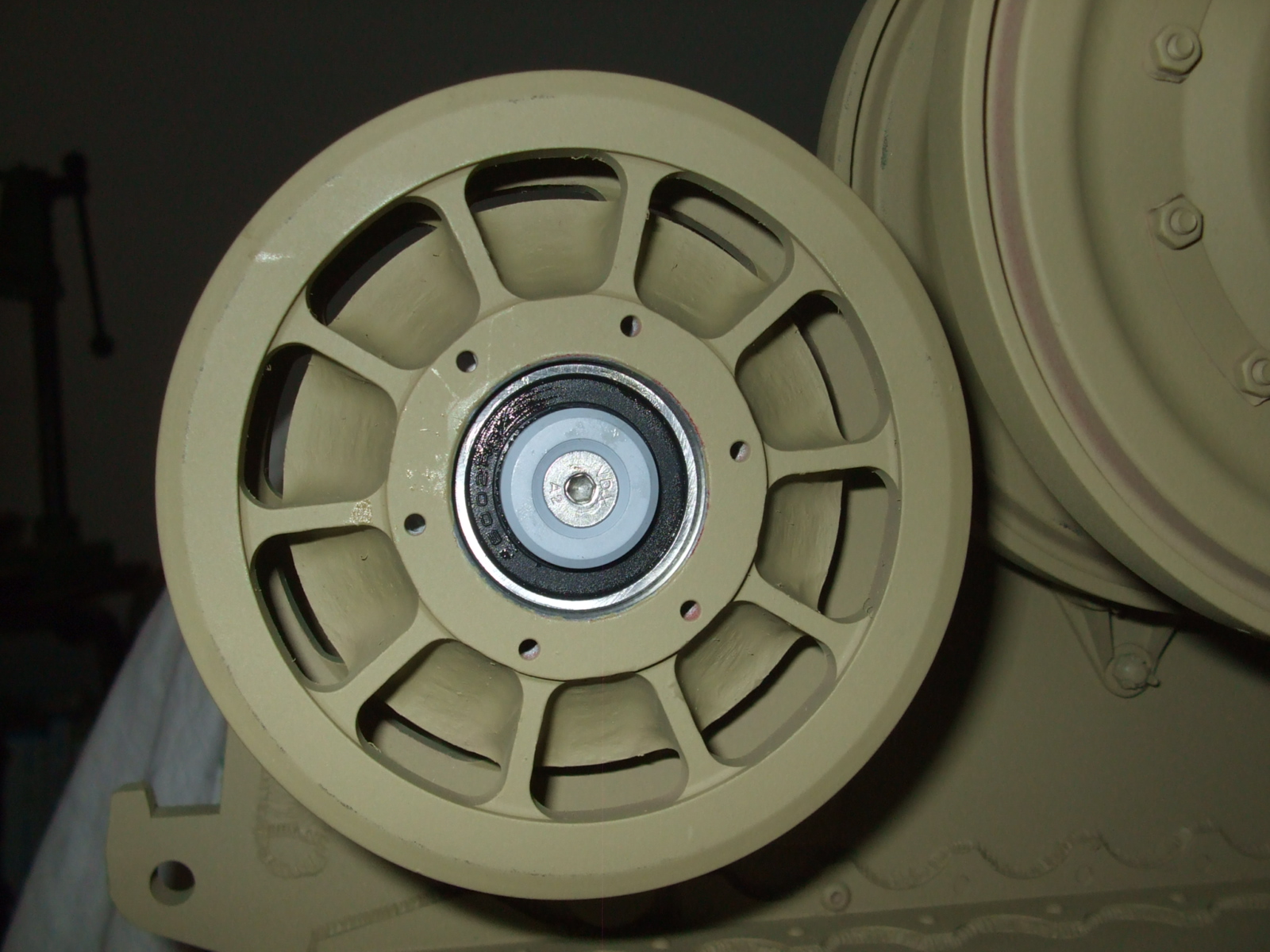

Wheels were locked in place with the kit supplied fittings and using 0.1mm shim washers so that when the screw is tight the road wheel will still turn freely. Most wheels only needed one shim washer but three wheels needed more than one shim washer.
Cleaned any excess grease from the back of the wheels.

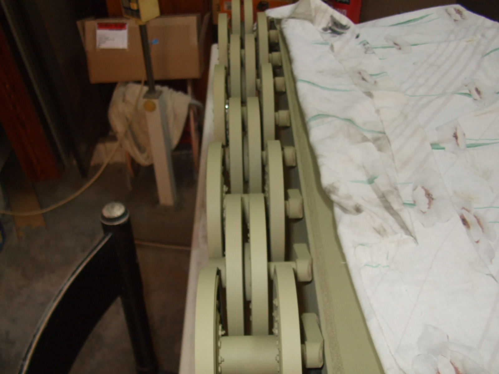

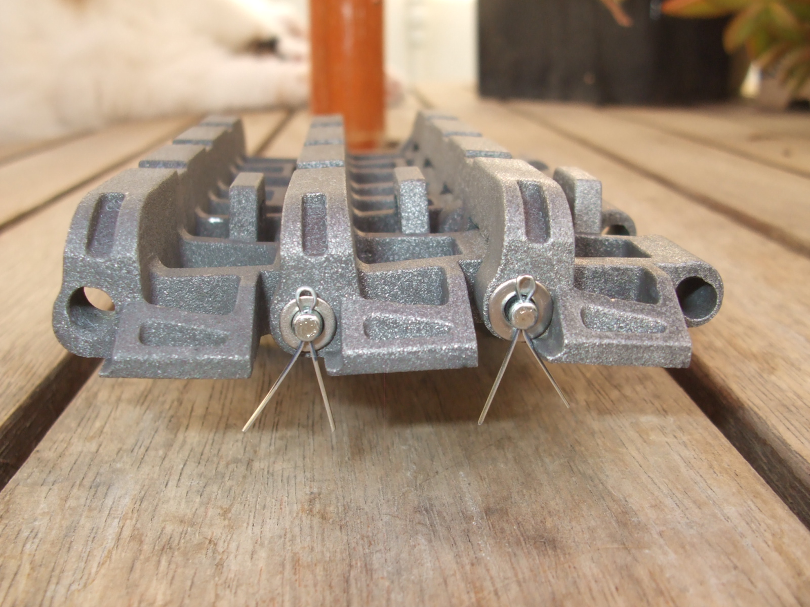

Need to temporarily build a length of track for testing purposes especially for when I put the idler and sprockets on. Today I found some M3 washers leftover from a previous model. They are smaller then the standard M3 washers and I was thinking of using them.
The one on the left is the smaller M3 washer and the one on the right is the standard size M3 washer.
Tiger looking disappointingly at the tracks.

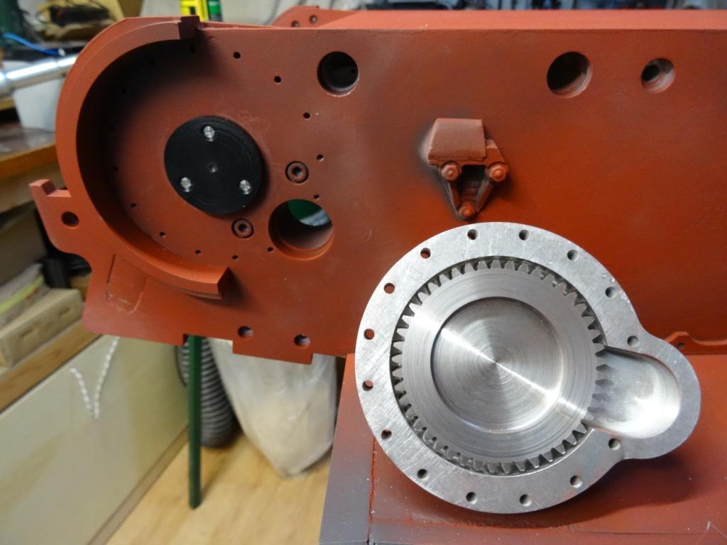

It's difficult to keep up with your posts but regarding your thoughts on fixing the drive shaft, unless Armortek jump in and say to the contrary, I understand that it should be glued in place to the two bearings. As an alternative to packing washers between the taper lock and outer bearing, some builders have cut a groove in the shaft just in front of the outer bearing and used a circlip to fix the shaft in place.
Either way, as per your measurement, the clearance is very tight and as in Adrian's picture even when glued in place , there is often sufficient end-float in the bearings to allow the gear to scrape away at the hull side. As long as the shaft stays fixed, the extent of wear should be limited, but it does still increase friction when rubbing and fill the gear case with alloy filings.
To try and eliminate any contact from happening, I added a thrust pad between the gear face and hull side so that they cannot touch. The pad is made from a hard wearing plastic and screwed onto the hull side. The inside of the gear face is recessed to provide the space needed for the pad. I made the clearance between the pad and the gear recess the same as the original clearance between gear face and hull side, which on my kit was only 0.5mm. Then to make sure the pad comes into play first, I refaced the gear by 0.6mm to remove the lead in chamfer to the gear teeth, which meant that the final clearnce between gear an hull side was increased 1.1mm.
How well this works at eliminating contact with the hull side, time will tell - however, on a dry run assembly before I finally glued the drive shaft to the bearings the sprocket turned very freely even when pushing it hard into the hull side.

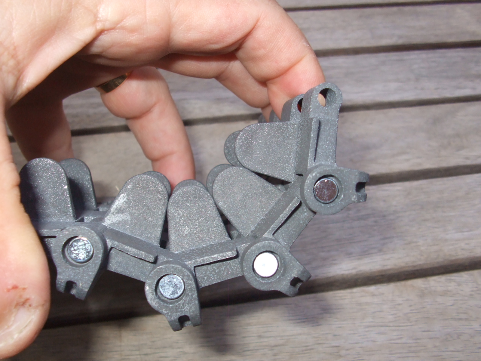

This is for the newbie tank builders (like myself) and hopefully might avoid track problems further down the line. When I was washing the individual track links (actually I still got a few track packets to do yet), I used to do a test assembly with just the track pin being used and I bend inwards the newly fitted track to check for free movement. I wanted to see if the track horn touches the horn of the adjacent track just like the photo below.
I have seen track links which do not manage to do this. No problem. Just put this offending track aside and try it again with other track links. This usually (in my case) solves the problem.

Fitted the idlers and their hubcaps.
Tried the length of track I assembled and it runs freely between the road wheels and idler.

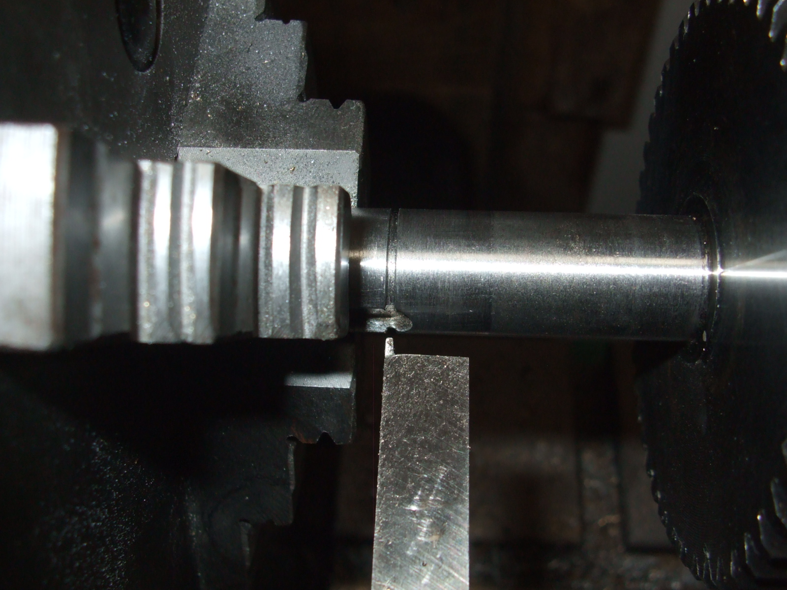

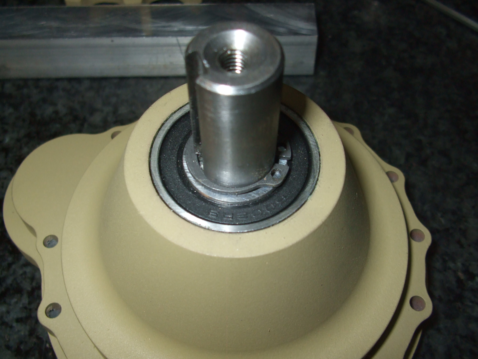

The build was on hold for the last two days trying to decide the best (and easiest) way forward regarding the method of removing the endplay from the driven gear and hence avoiding as much as possible the driven gear from grinding into the hull.
Various methods were suggested to me either here on this thread or via PM and I would like to take this opportunity to thank all that sent their suggestions. Thank you guys. The method I chose was using an external circlip, in fact this morning I bought some 15mm external circlips. This afternoon I did a test run on a piece of 15mm BMS. I was lucky that I already had a custom made HSS tool to cut the 1mm groove for the circlip. I had made it some years ago to cut the piston ring grooves in a model engine.
The test piece was a success, so I decided to do both driven gear shafts. It took less than 30 minutes to do them.
Checking with a feeler gauge there is a 0.1mm distance between the circlip and the bearing. I think I will order some shim washers.
