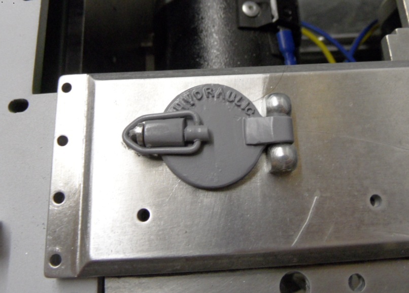

While the files were out I thought I'd have go at making a working filler cap. Due to the shape of the supplied caps some added material was required to add to the over all shape. Spring came from a clipper lighter, push rod boat stanchion, stock brass 1.5mm wire and a pivot block from servo arm connector. Lettering is a little on the large size at 2mm but I only have one pack of 1.5mm lettering and saving them for a rainy day.
I need to make six working caps, so thought it would be best if the parts were easily sourced. Several filing hours later and a sore thumb.
Hopefully the other caps should be easier to make now I know what I'm doing ish. The finished item locked on to it's locking post.
Ahup, spot the stupid mistake !

Ahhh that's better.
I was so busy thinking about squeezing in the letters.
At least Coulent will be easier to spieel on the next cap.

For those who did not serve, A was sprungloaded so that the hatch shut & locked when dropped. B was not a retaining mechanism but a release handle,used to pull A out of engagement & then lift the hatch.
The handle was afterwards normally returned to its stowage position as shown

Mark, you could have used the picture with the correct spelling, I know it's easier to kick a man while he's down, but it's not very sporting.
As for the locking post. I assumed all the caps would all a have the ability to be locked some how, especially in enemy territory. Basing the opinion on the fuel cap and coolant cap pictures below. I did fit a tiny spring to the locking plunger, the boss on the plunger is somewhat bigger than it should be,
but it allows a bit of strength, the swing on the plunger handle and hides the joint within, I may trim it a little when I build the others.
The British seemed to be fond of the padlock or nut and bolt and hasp system, as it can be seen all over the tank, though it must have been an nightmare (or funny to some), if different padlocks were used.
