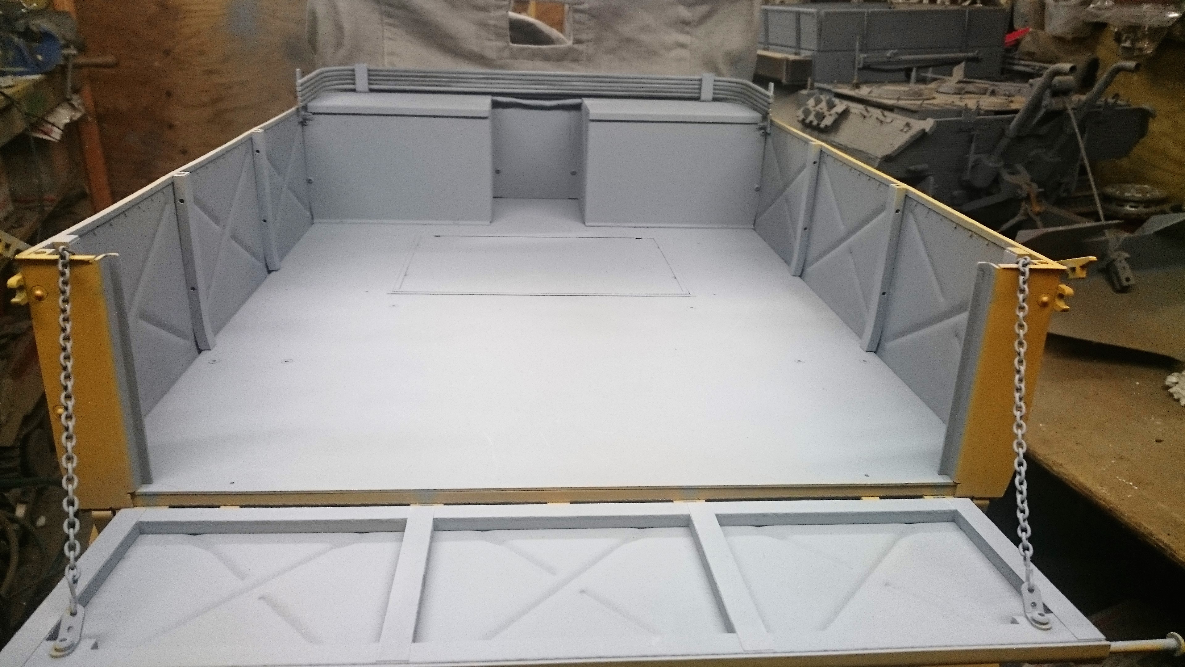

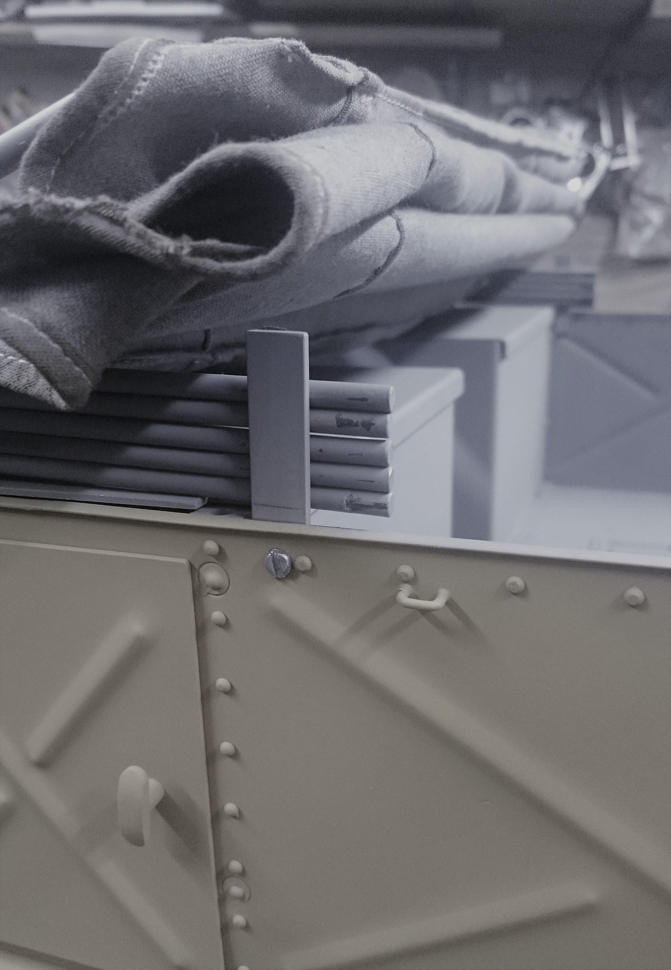

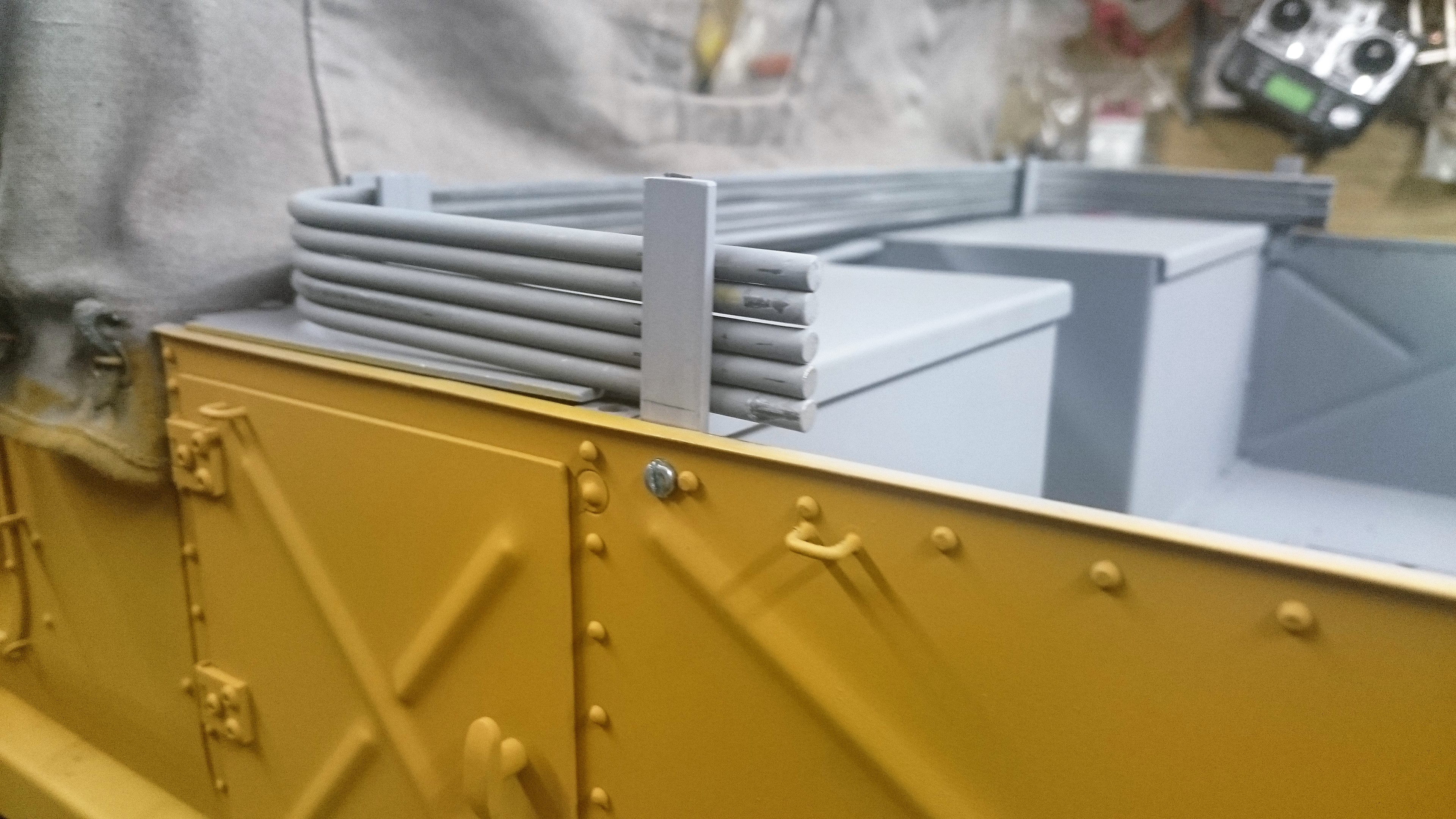

I agree Christoffer it transforms it, Florian the best example of the folding frame (that I can find so far) for the tilt is this one below. Note all the extra webbing over the rear hoops to support the saggy canvas.
I may have a go at a later date with the cantilever hoop system, probably best to make new shorter hoops rather than adjust the kit ones .....Phil.

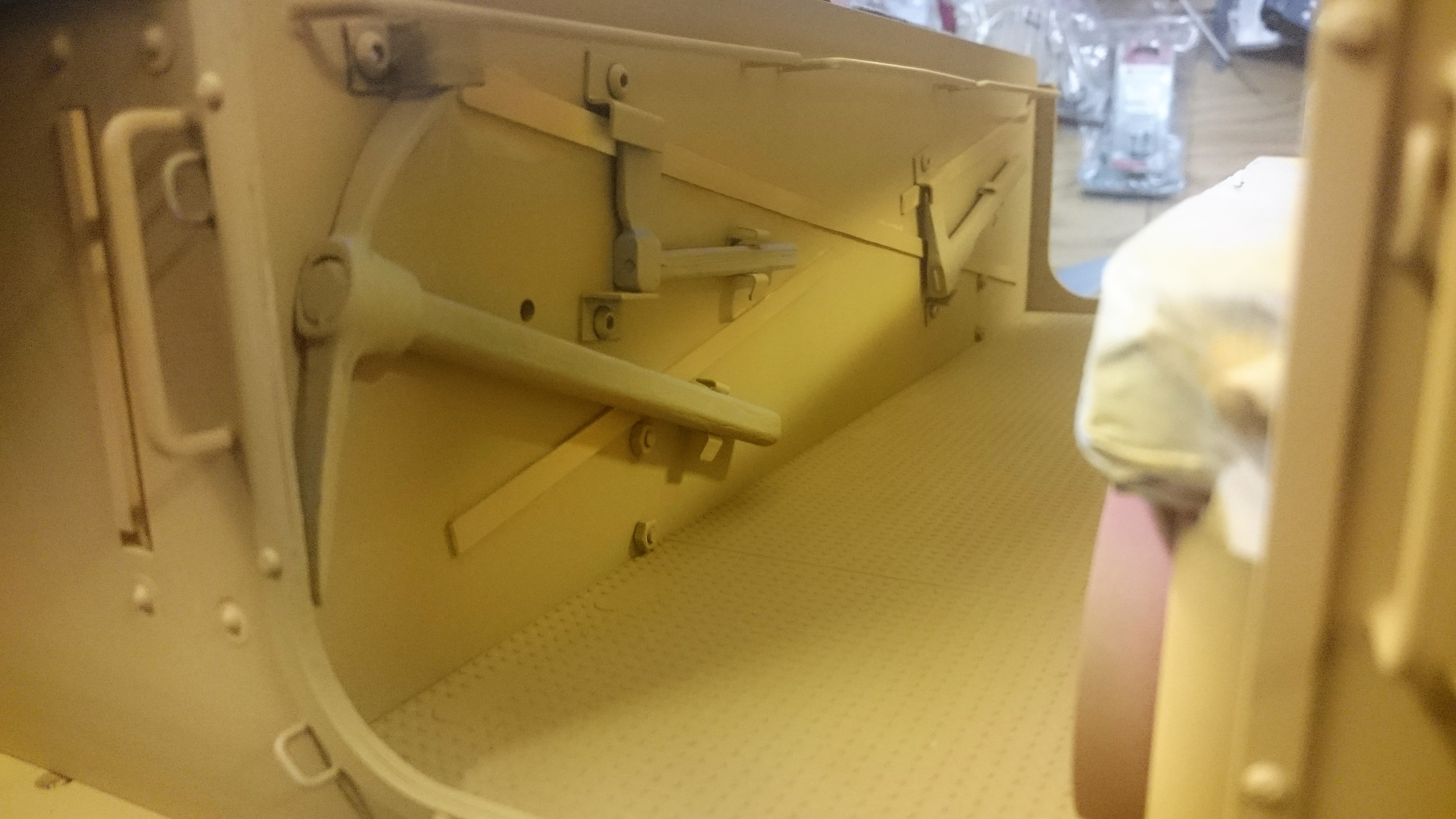

I am not sure what bracket you mean but I see the “roof rack” looks great! You could put all kinds of stuff up there.
Re: Phils Famo build
Hi Brian, the bracket referred to is the top edge angle that I have added, sometimes it gets lost in translation !

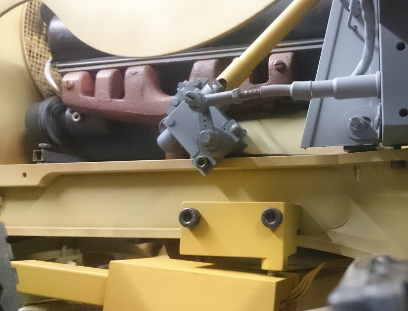

A very important mod I think is a must, so back to the steering and front suspension set up.

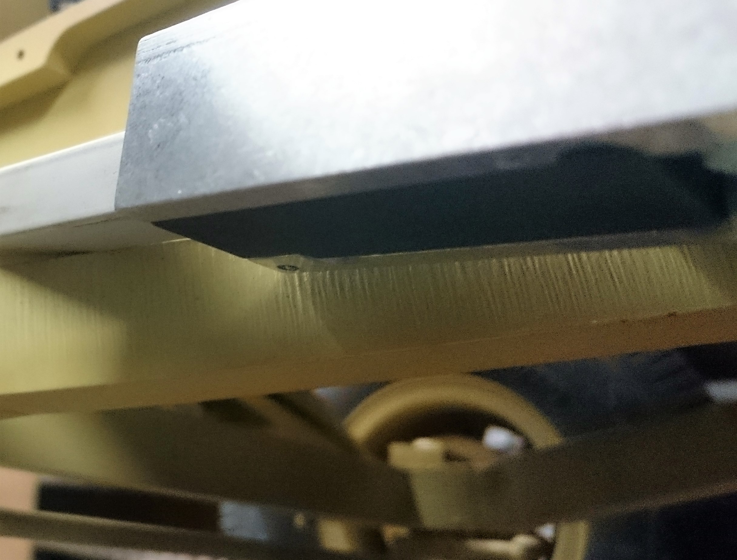

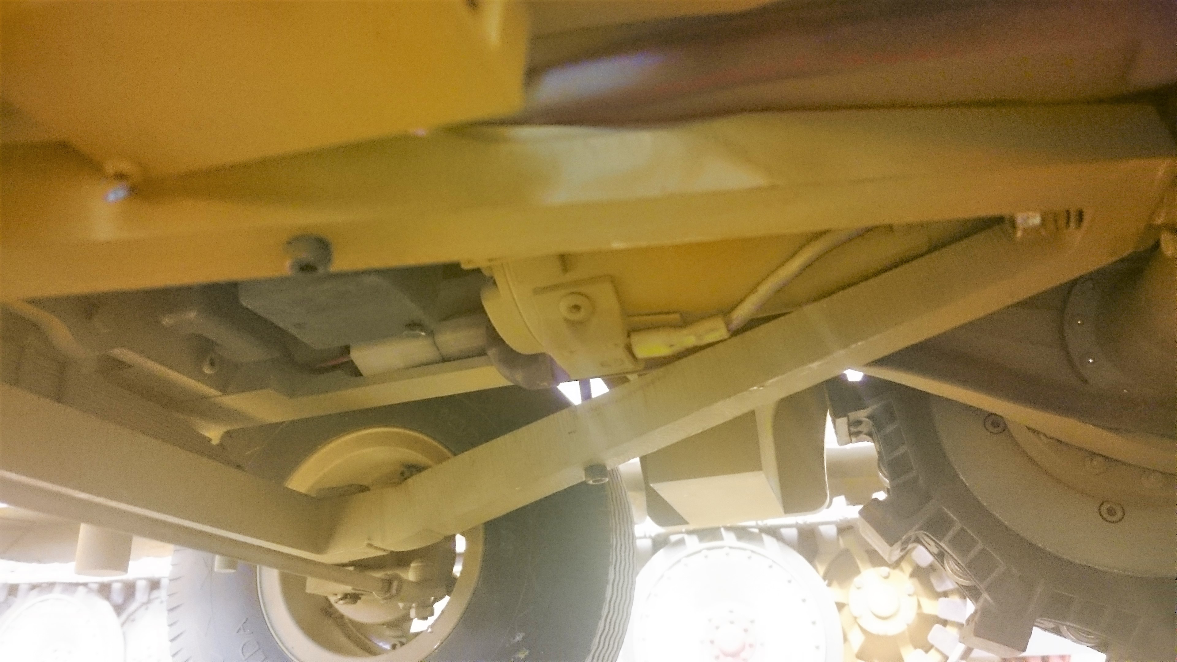

The original Famo had a simple cable loop around the axle and chassis, this restricted the axle travel, most of the bigger off road vehicles have a similar travel stop, some being webbing strapping, a cable loop or a simple bump stop.
Our Famo has copious amounts of axle travel, a little too much maybe for our requirements. The steering actuator could, and I say could be under a tad to much load when the axle is at max travel.
So an easy fix is to add a bump stop. All I have done is drilled and tapped an m4 hole right through the axle triangle strut over the intersection with the chassis rail, (I will take another clearer photo when I get to the workshop later) You can then screw in a m4 x40 all thread (or similar) to give you a simple adjustable stop. You could add a rubber cap but space is at a premium, i dont think that a cable loop would be successful in this scale.

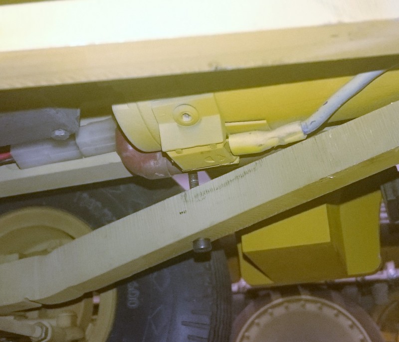

There you go, the m4 cap head all thread screws right through the square section of the axle triangle on both sides, it simply bumps up against the chassis and works a treat.

Thats a good idea Phil.
I also thougth about it, why do AT such a constrution, that the axel touch the engine. I thought about a piece of rubber mounted with glue on the motor.
Well it's quick and robust florian, good to see you building again after the holidays, it was getting a bit cold on my own!

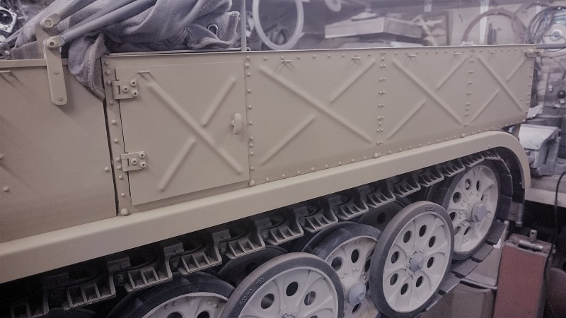

I suppose I'm at the tying up the loose end stage of the build about now, soon on to the painting stage.
- Has liked: 792 times
That's looking fantastic Phil with all the small details that you have added.

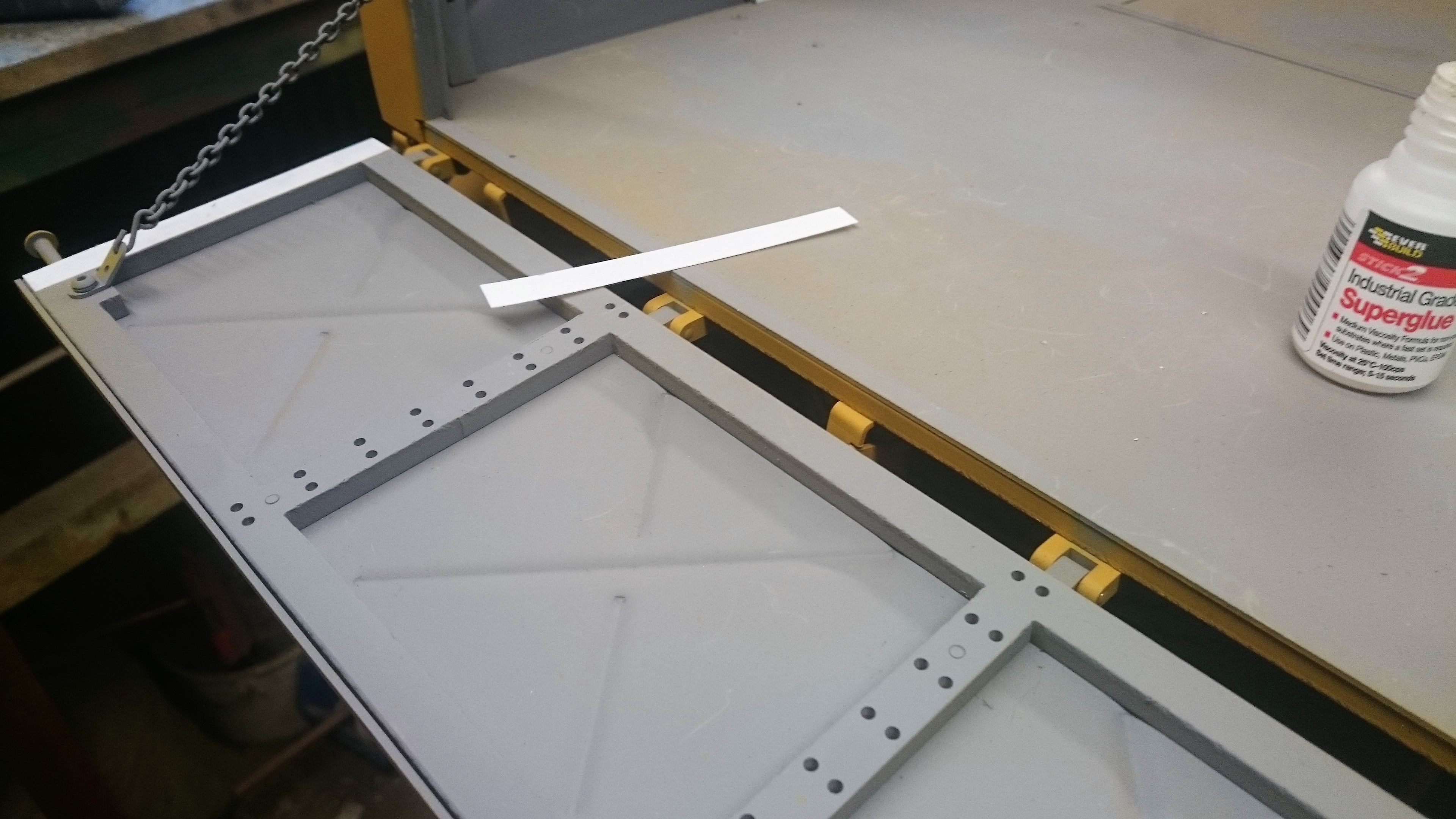

Your sill arround the loading area instead is verry fine, I'll do it your way
