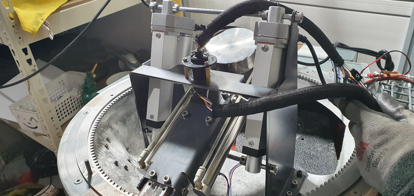

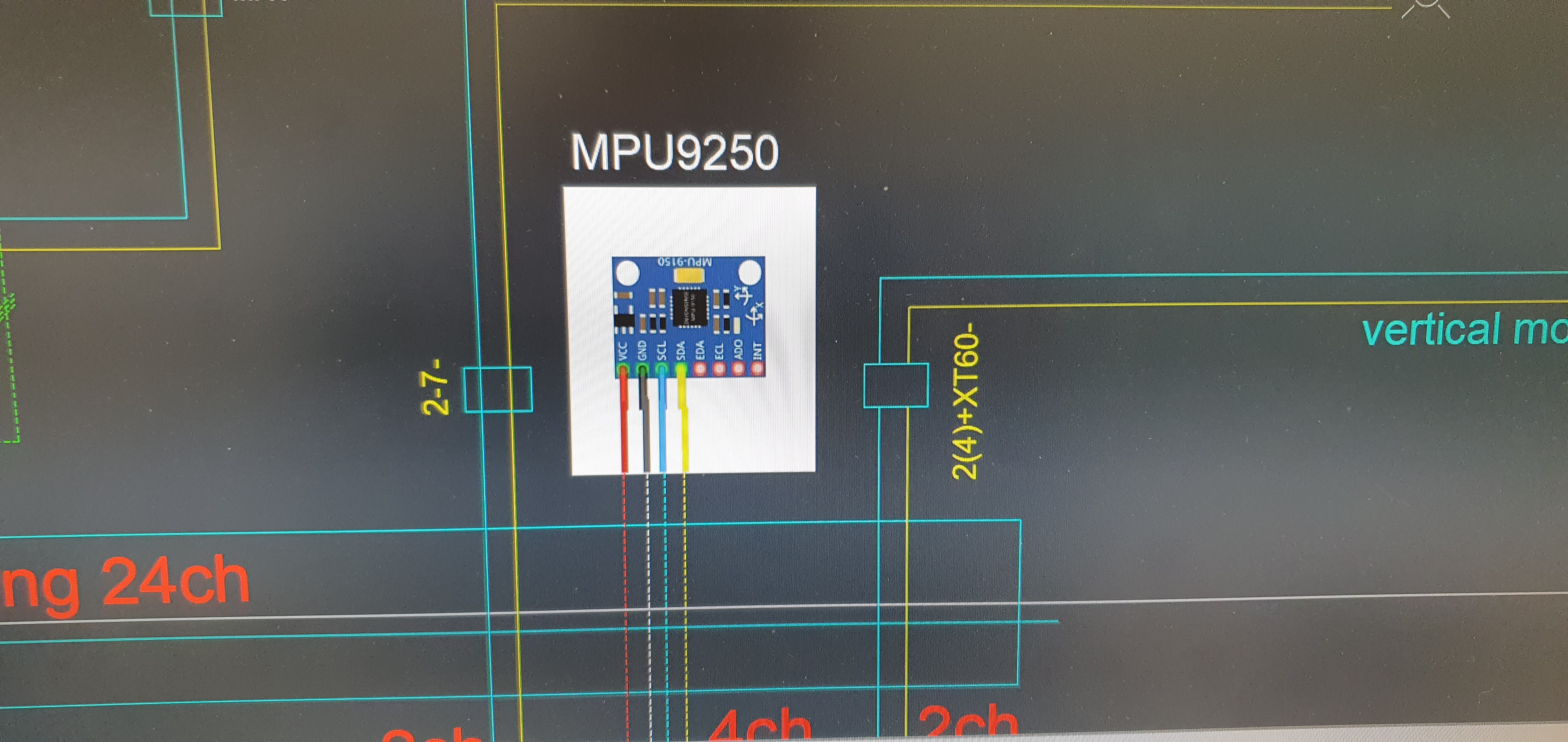

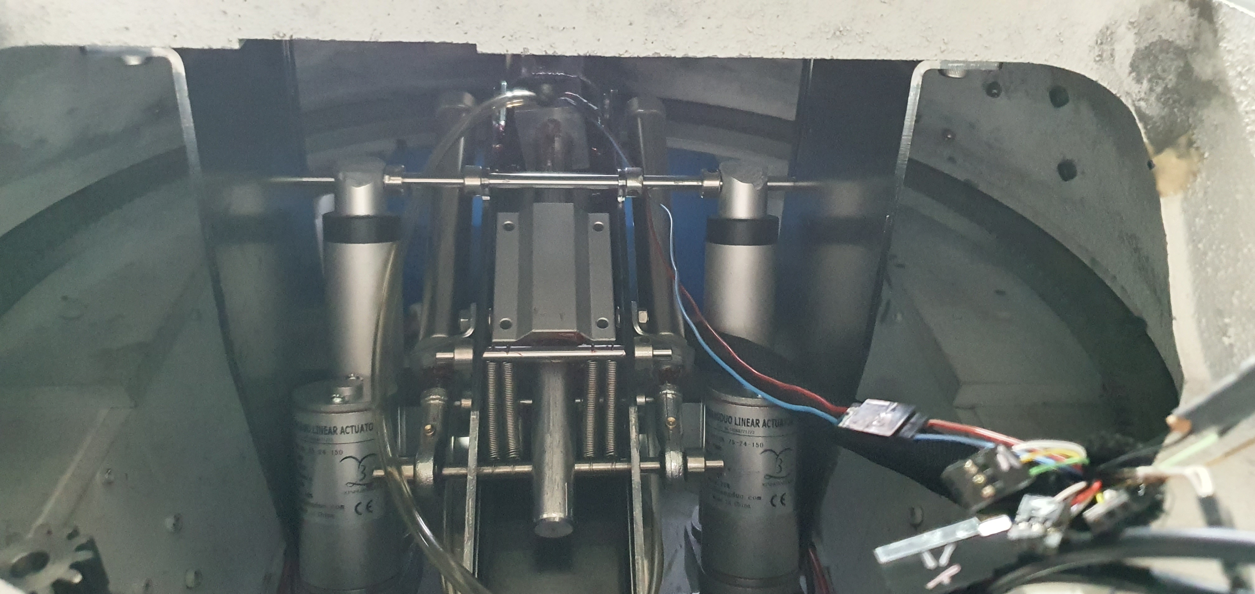

I did an up-down test by connecting the actuator that arrived yesterday.
The speed came out well as planned and I will install it on the turret as soon as possible and conduct a motion test.
The control method for stabilization of the main gun is to be carried out by measuring the angular velocity and converging the displacement to zero, and currently Arduino UNO and MPU-9250, and the arrival of the TCS3200 sensor for collision prevention, and customizing the open source.

Good luck Youngjae. My experiments with the Arduino and the MPU9250 have proven that good results can be achieved.

After watching Vince's experimental video, I was convinced that if the actuator reacted quickly, it would be a success.Vince Cutajar wrote: ↑Wed Apr 08, 2020 12:04 amGood luck Youngjae. My experiments with the Arduino and the MPU9250 have proven that good results can be achieved.
Thank you.
Youngjae

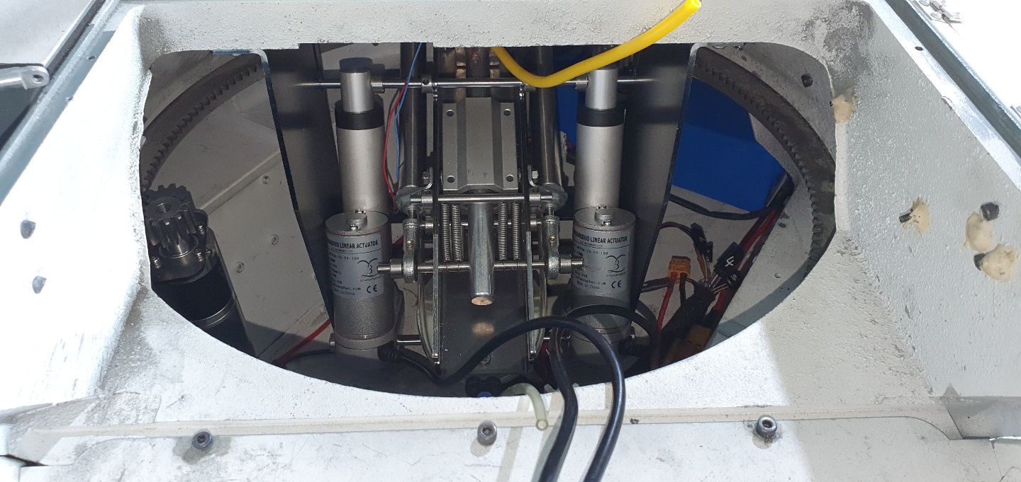

Re: Chieftain kit arrival

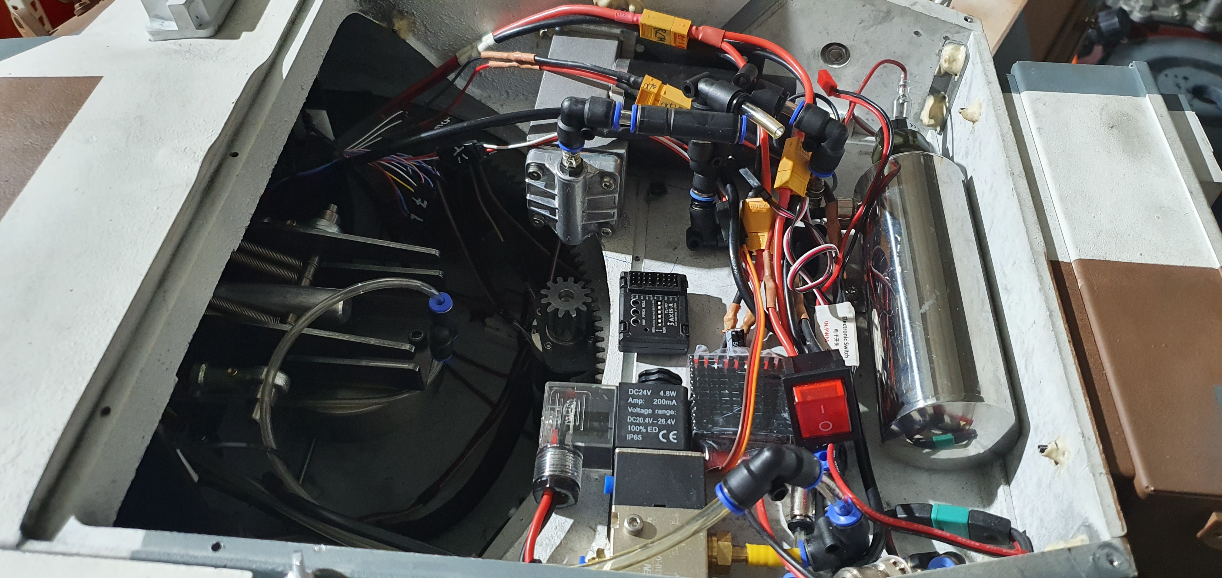

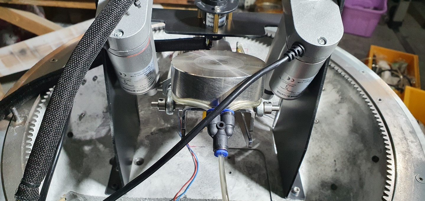

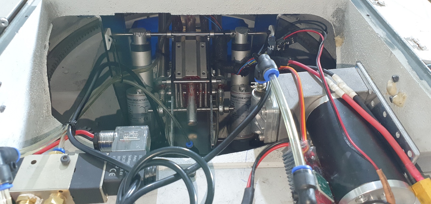

Today, I installed the actuator that I had prepared in the turret and finished the test.
Results respond very quickly as expected.
On weekends, I work on the recoil system and start stabilizing.
Youngjae

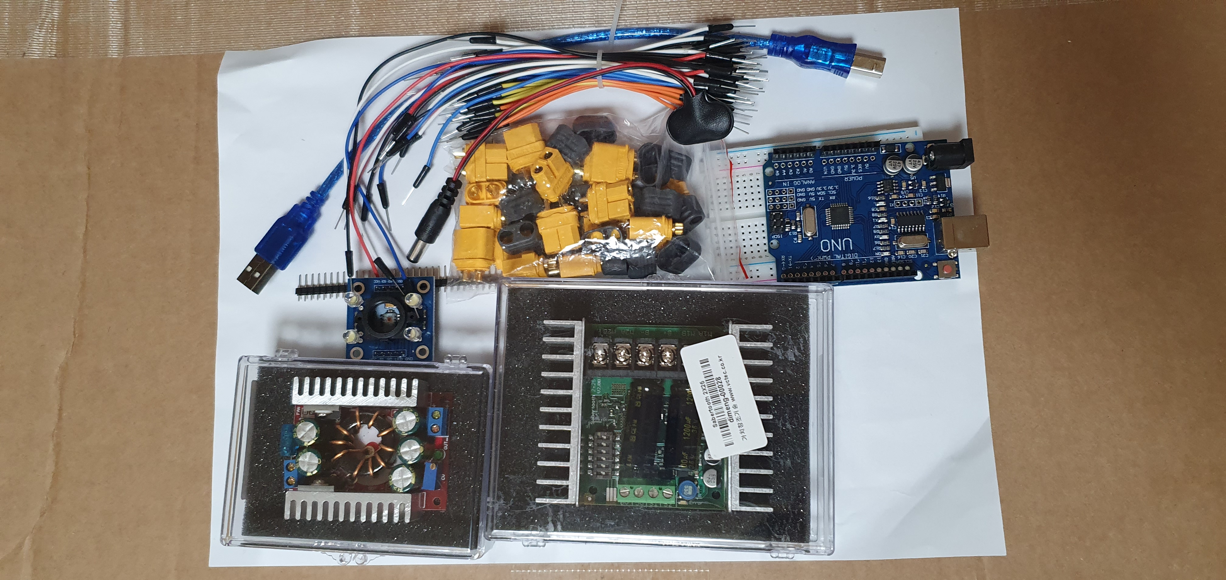

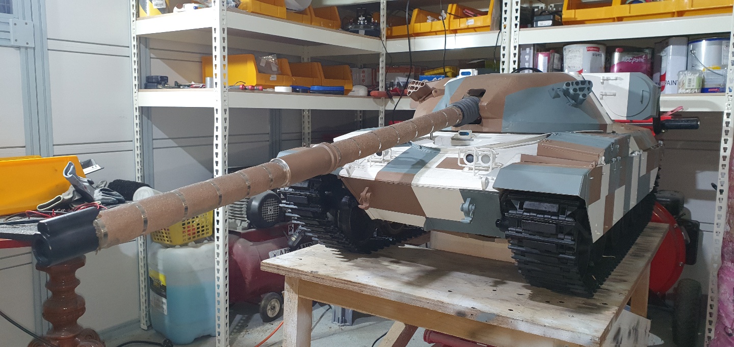

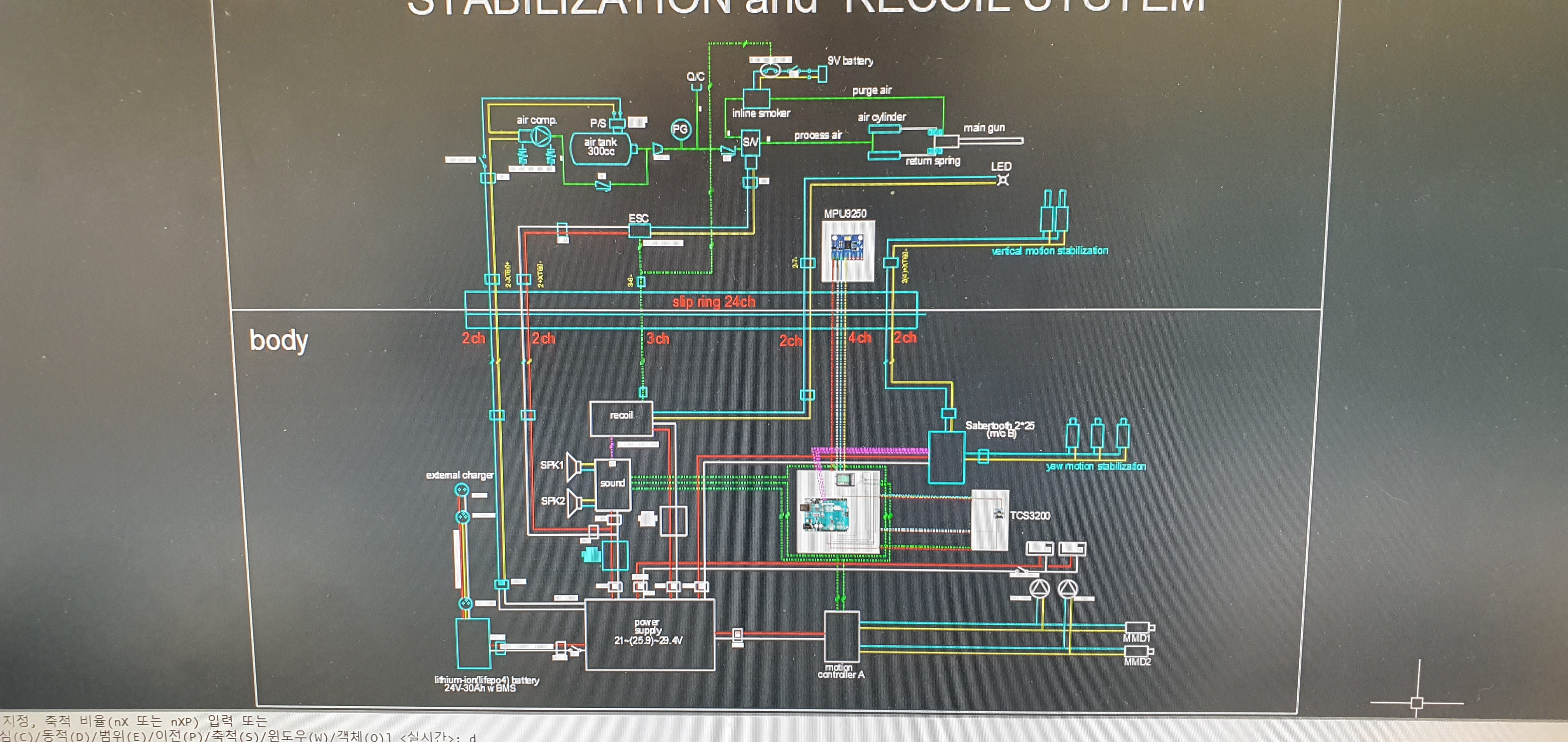

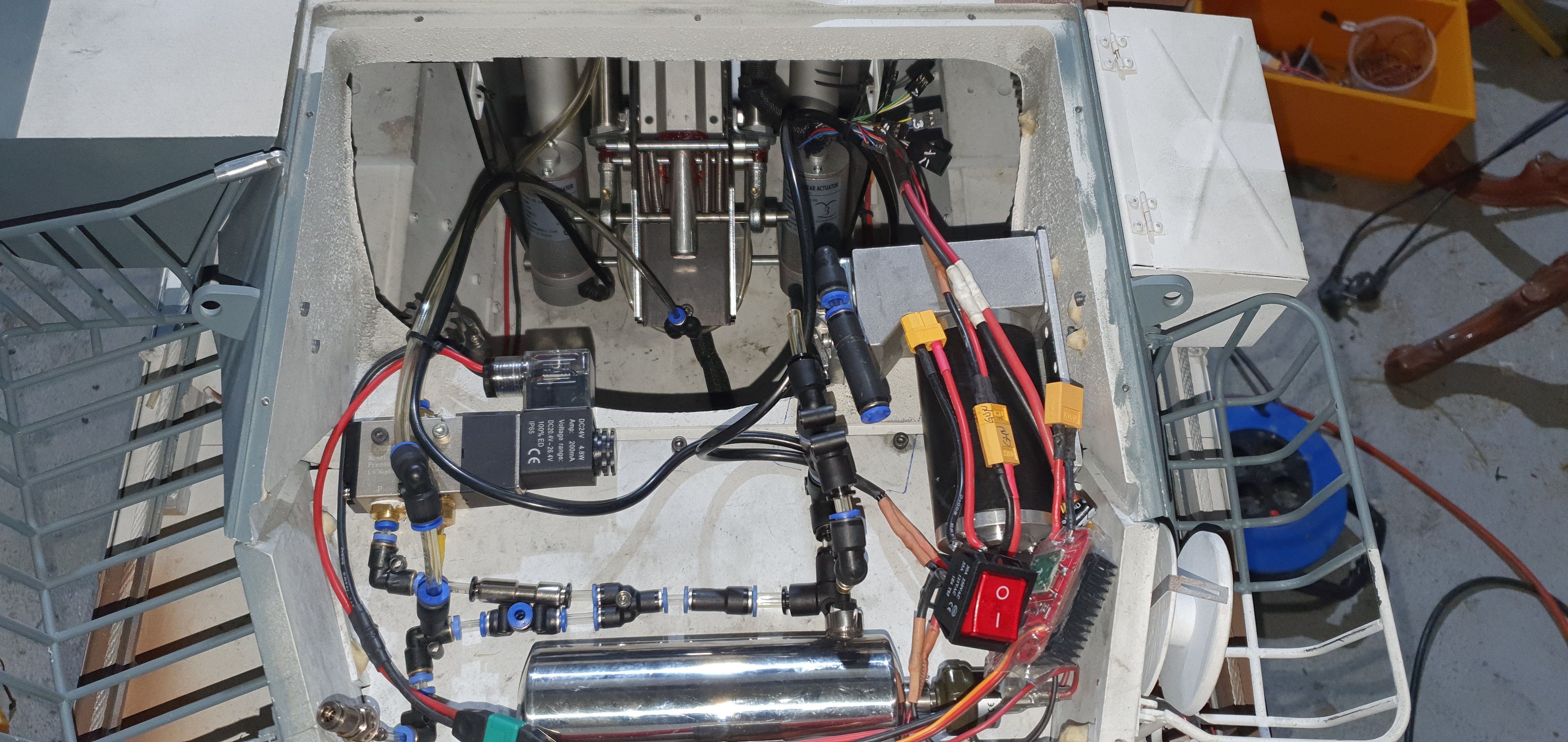

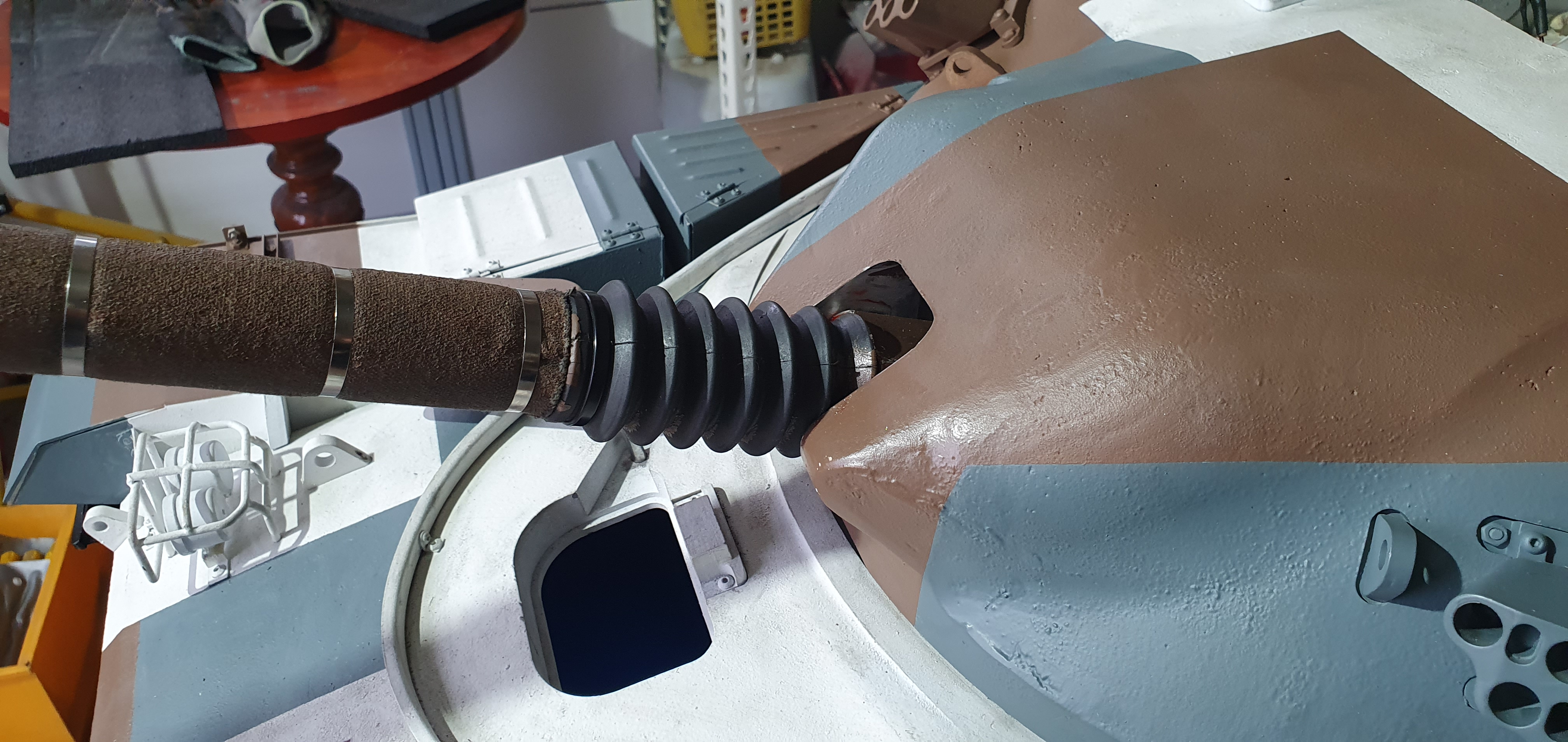

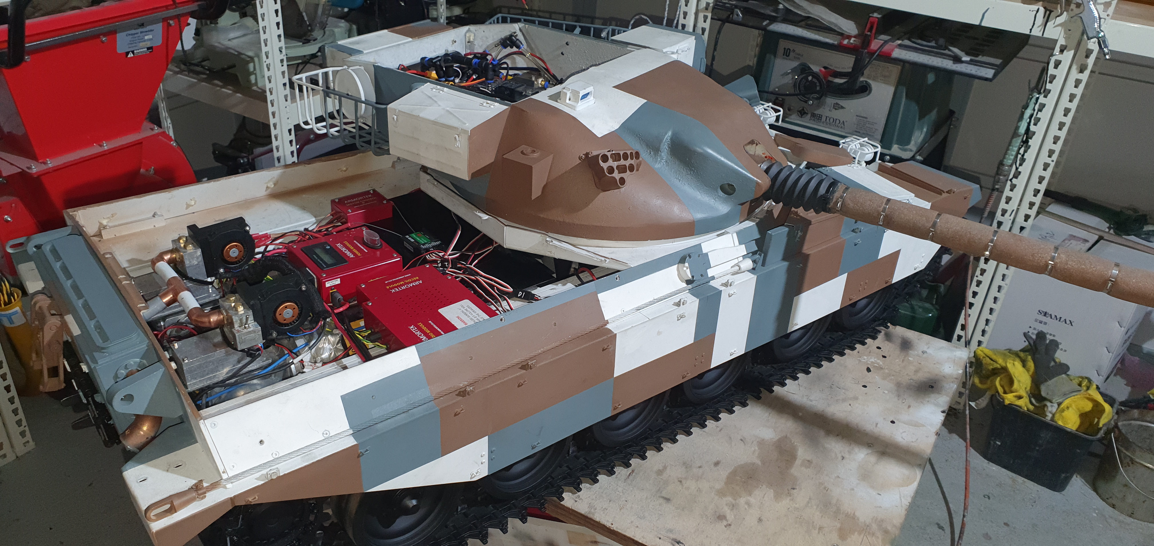

Four months later, I re-installed the thermal sleeve that I separated in January.
The main gun was previously reinstalled with LEDs and a new 6mm hose to export the smoke.
The changed recoil is expected to have a noticeable motion due to its increased movement.
Arduino Uno, that will control stabilization operations, arrived today.
But until the Gyro sensor arrives, the pneumatic recoil is decorated like a P&ID, but I'm waiting for a small vibration mount.
Youngjae

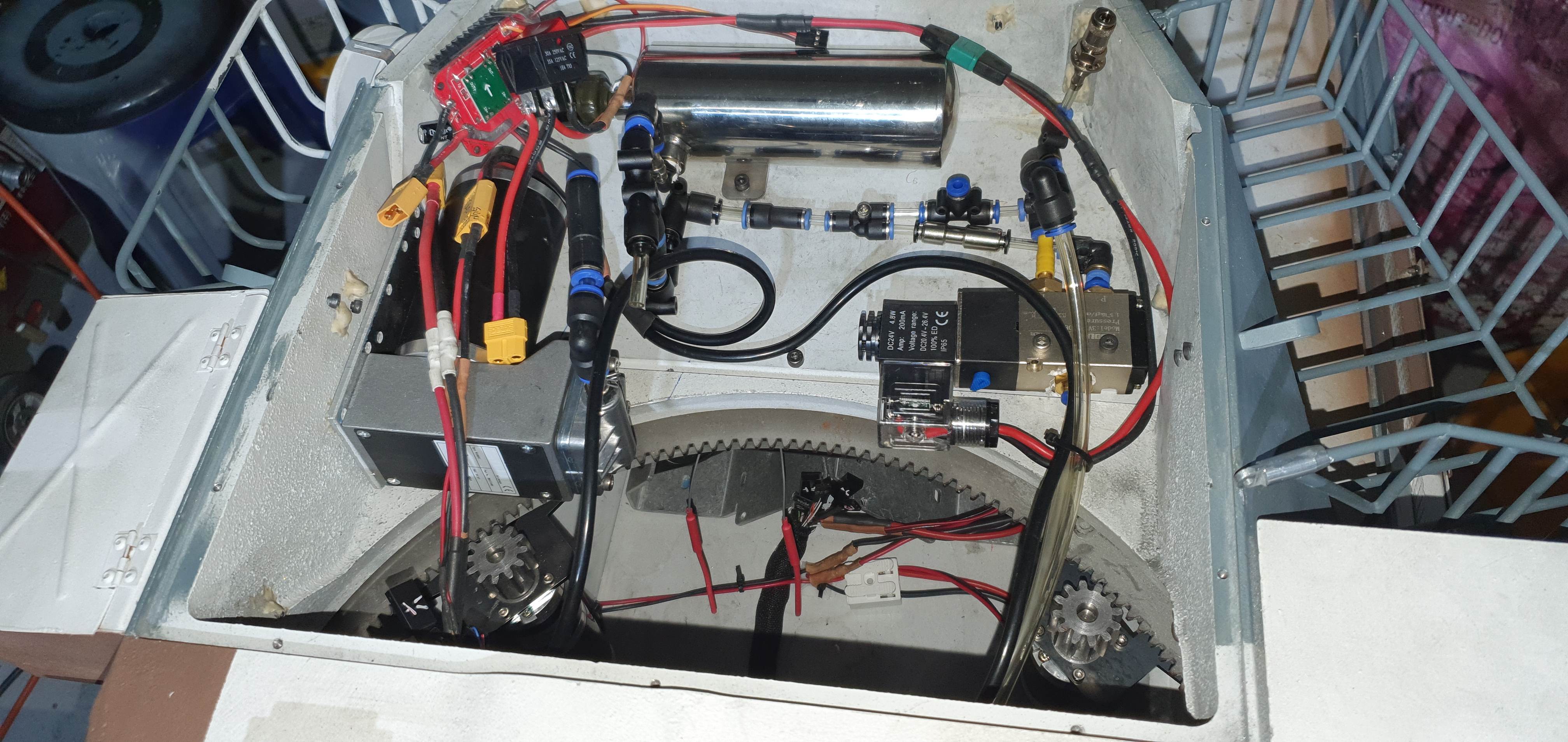

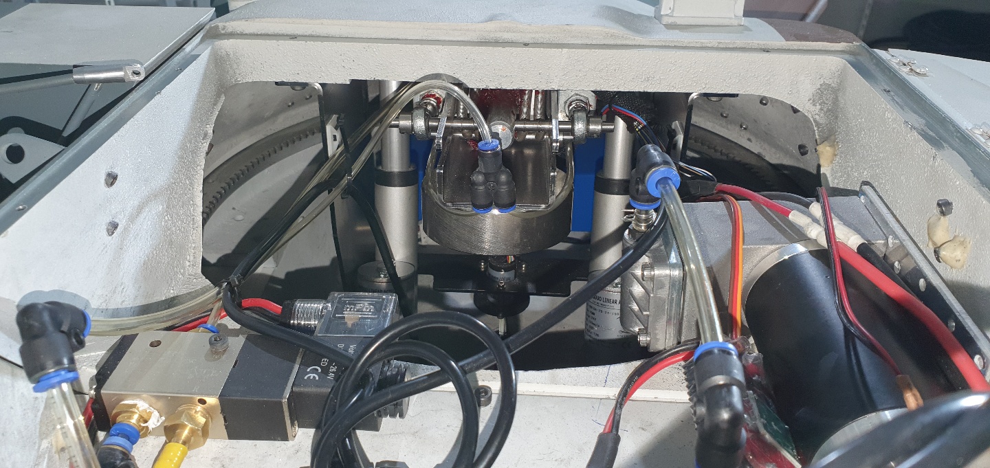

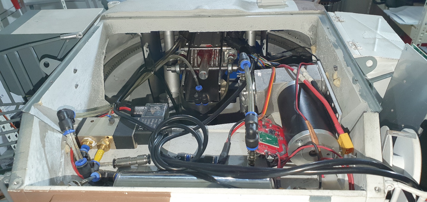

Today, I placed the Recoil-driven Compuressor, Air Storage Tank, and Solenoid Valve inside the turret based on p&id, and checked that there was no interference from the wiring or tube according to the high angle and low angle of the main gun.
There should be a 6mm T fitting and an elbow, and I did the possible work first, waiting for the pressure gauge to arrive.
Youngjae

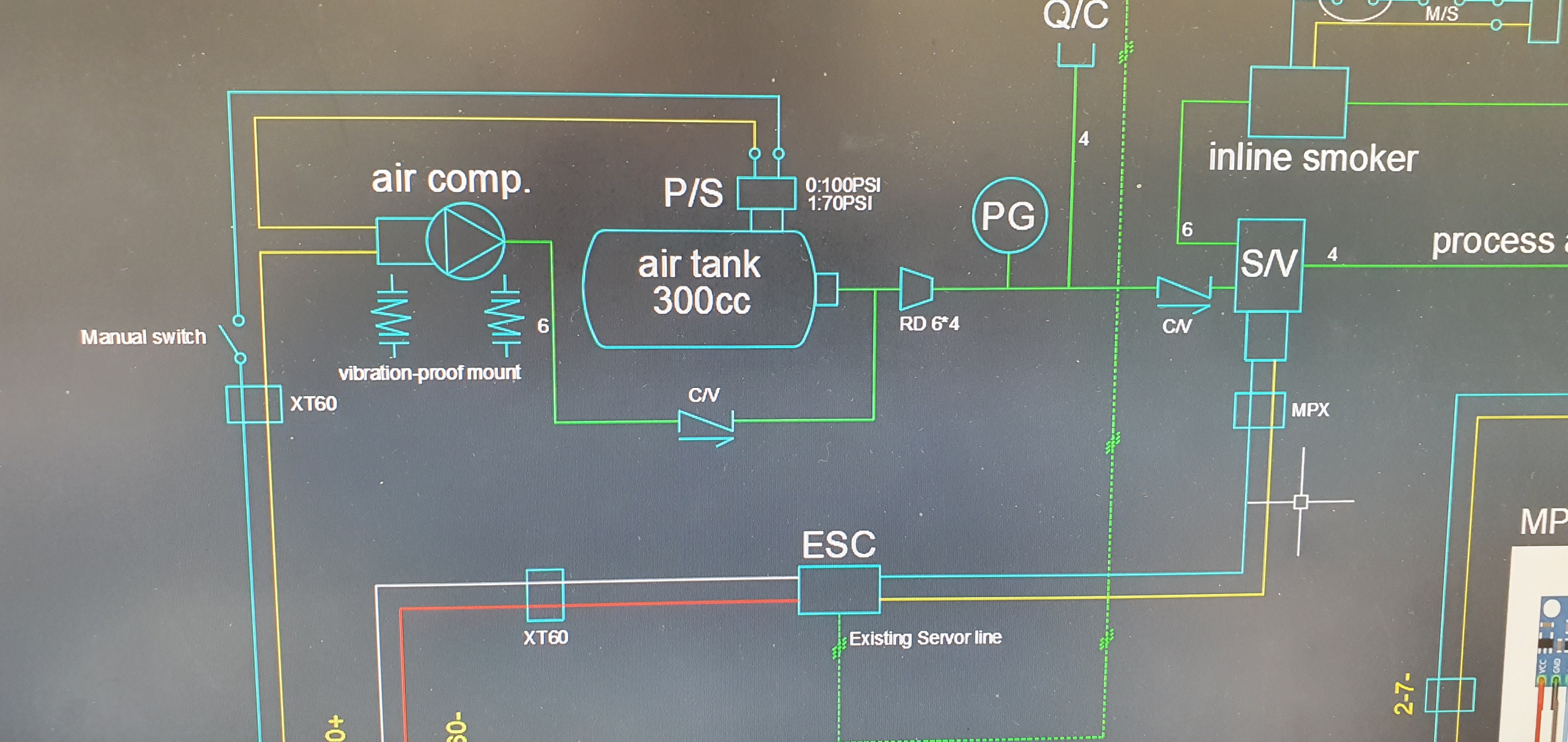

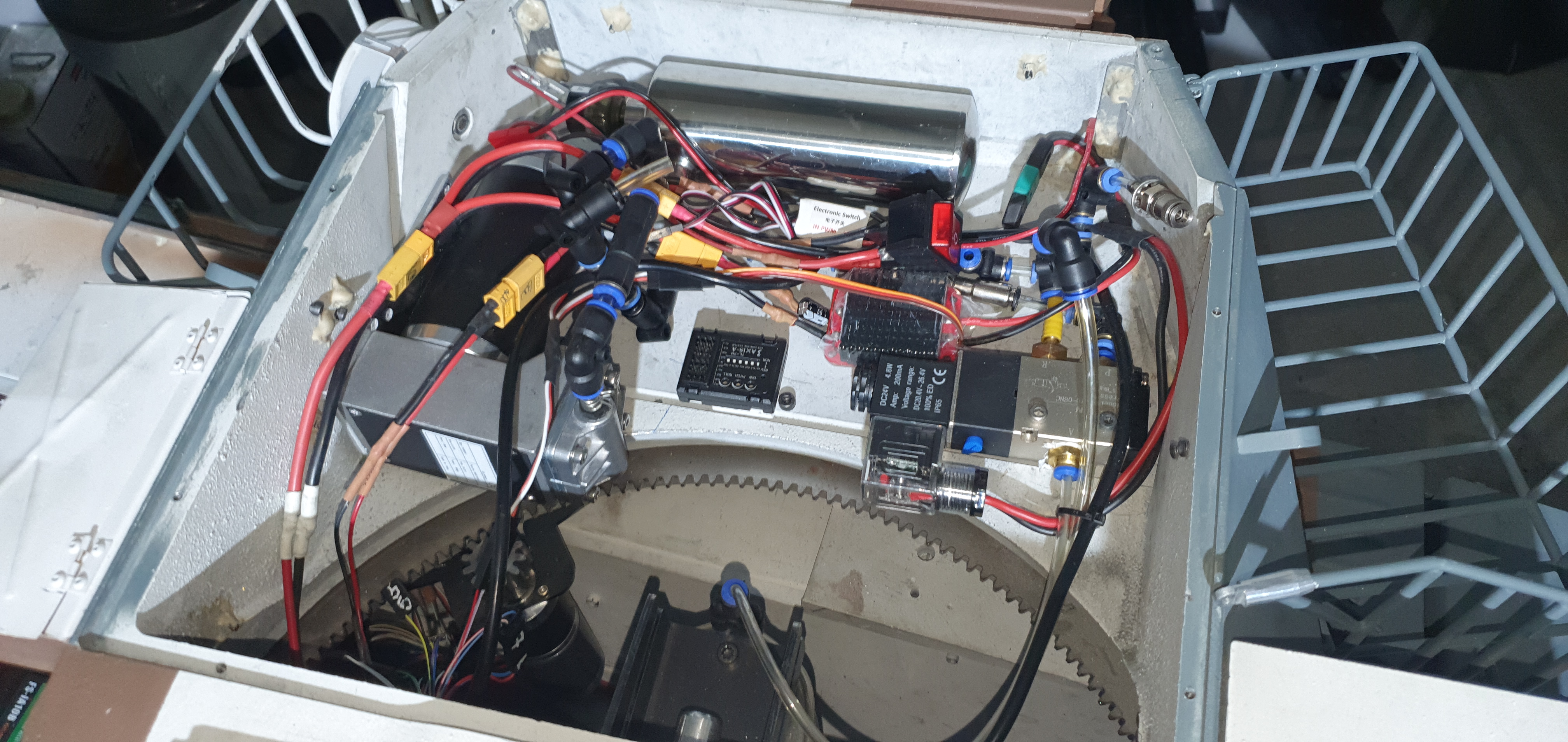

To meet Vince's expectations, I am studying Arduino coding very hard.
Yesterday, I reviewed my P&ID, fixed the internal pipes and wiring of the turret, and made new bolt holes to fix the equipment and air fittings.
It's a mess because I haven't cleaned up the lines yet, but the connection is exactly the same as the P&ID drawing.
A small anti-vibration mount for the compressor motor has not yet arrived and a pressure gauge has not arrived to check the air pressure.
The delivery system is different from the past, so the progress is going very slowly.

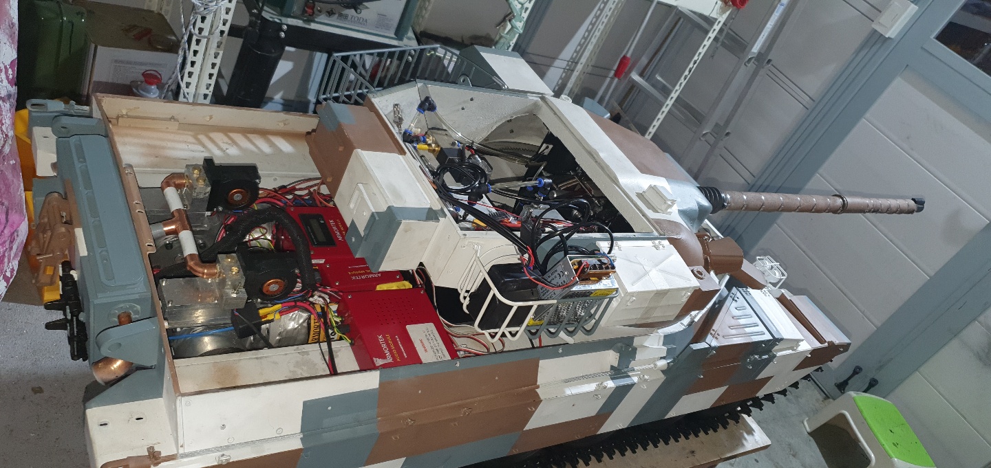

Waiting for the pressure gauge and mount, I am conducting a wiring and operation test again after 5 months.
I'm carefully checking every function and it is very smooth until yesterday.

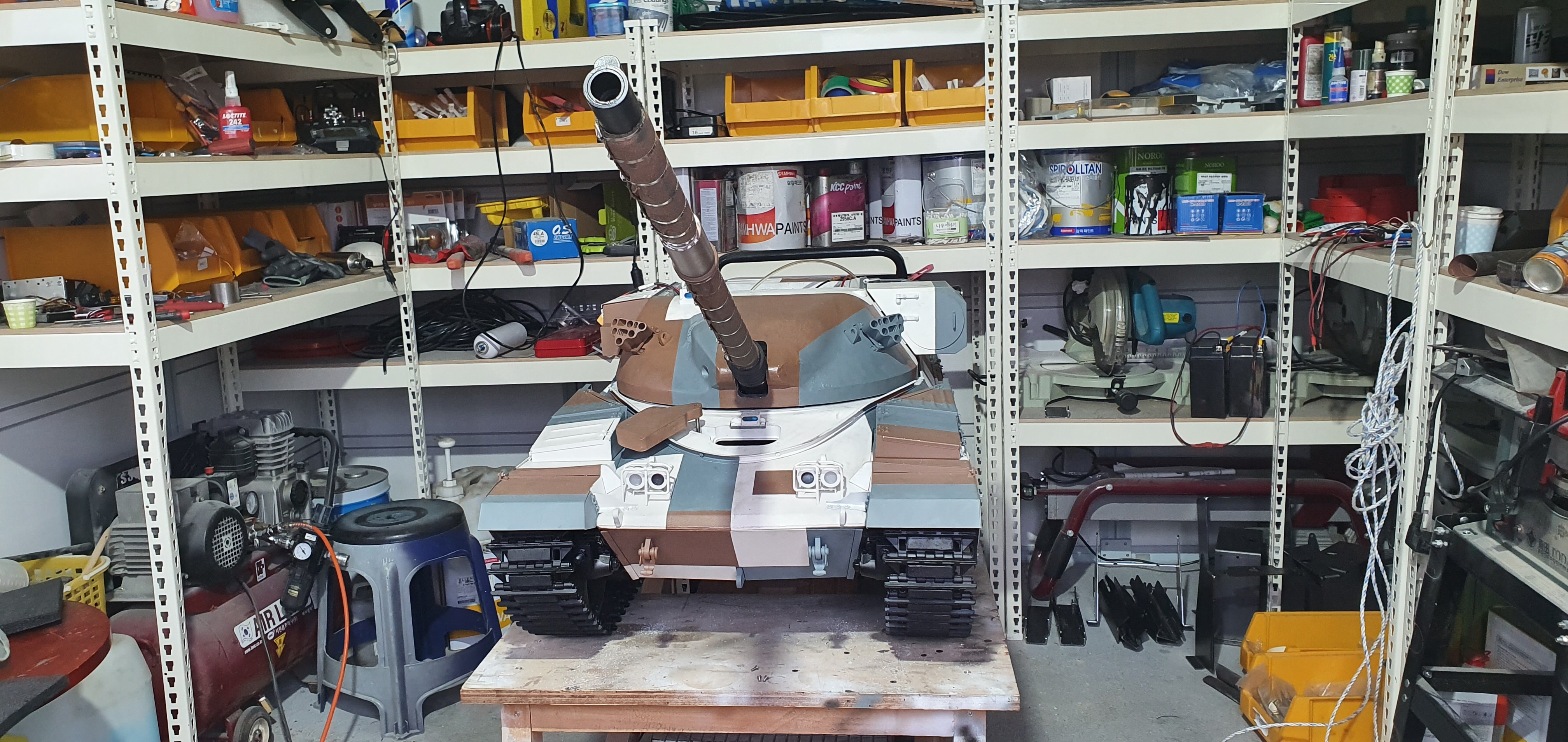

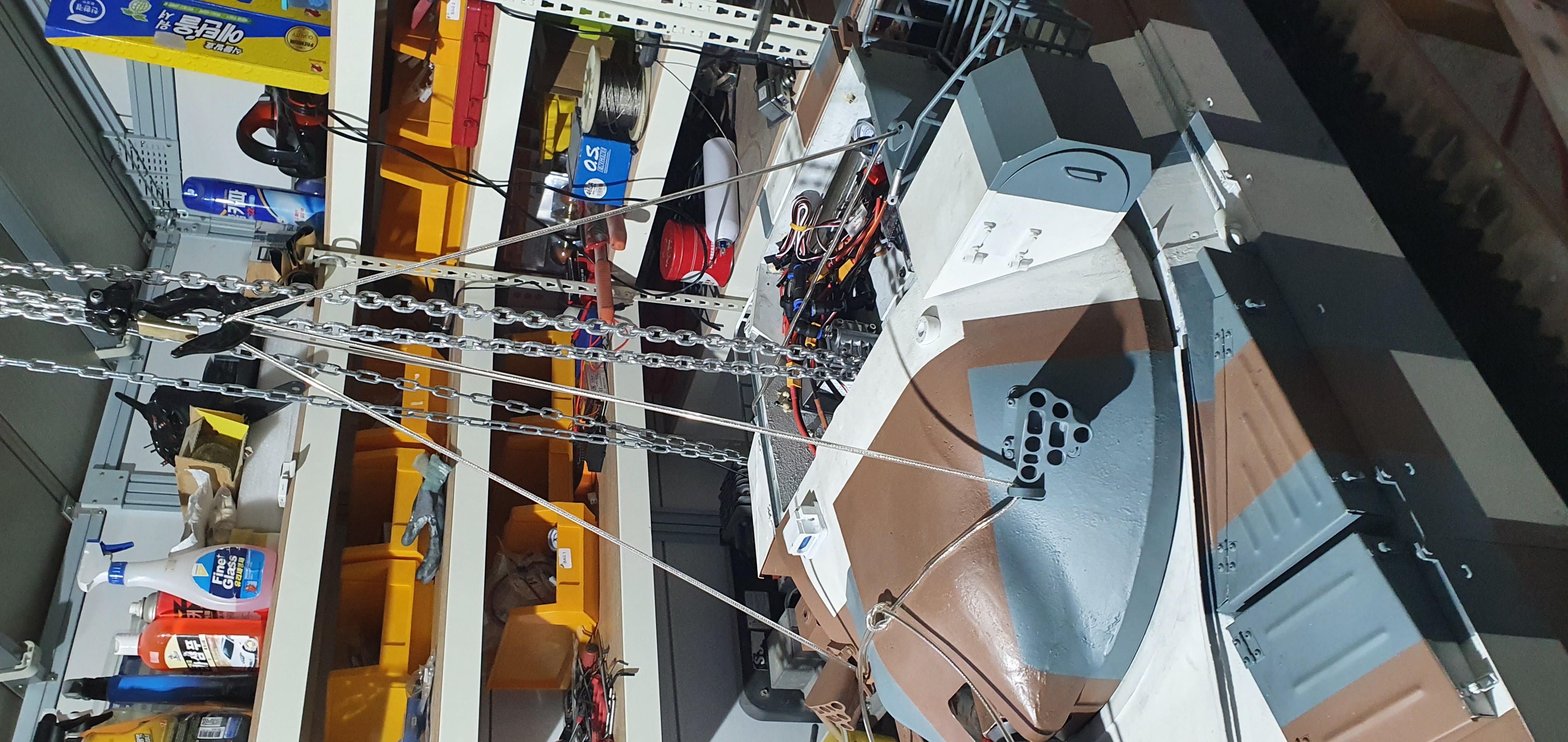

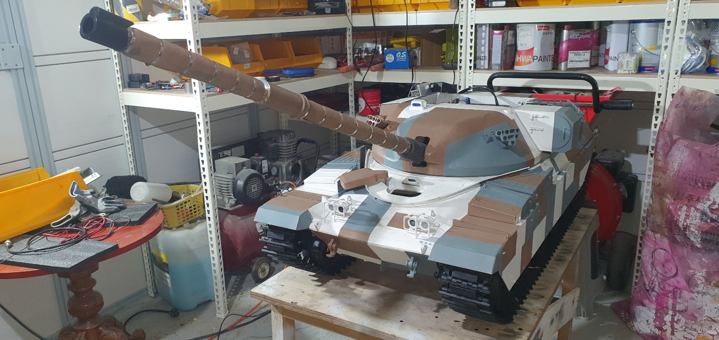

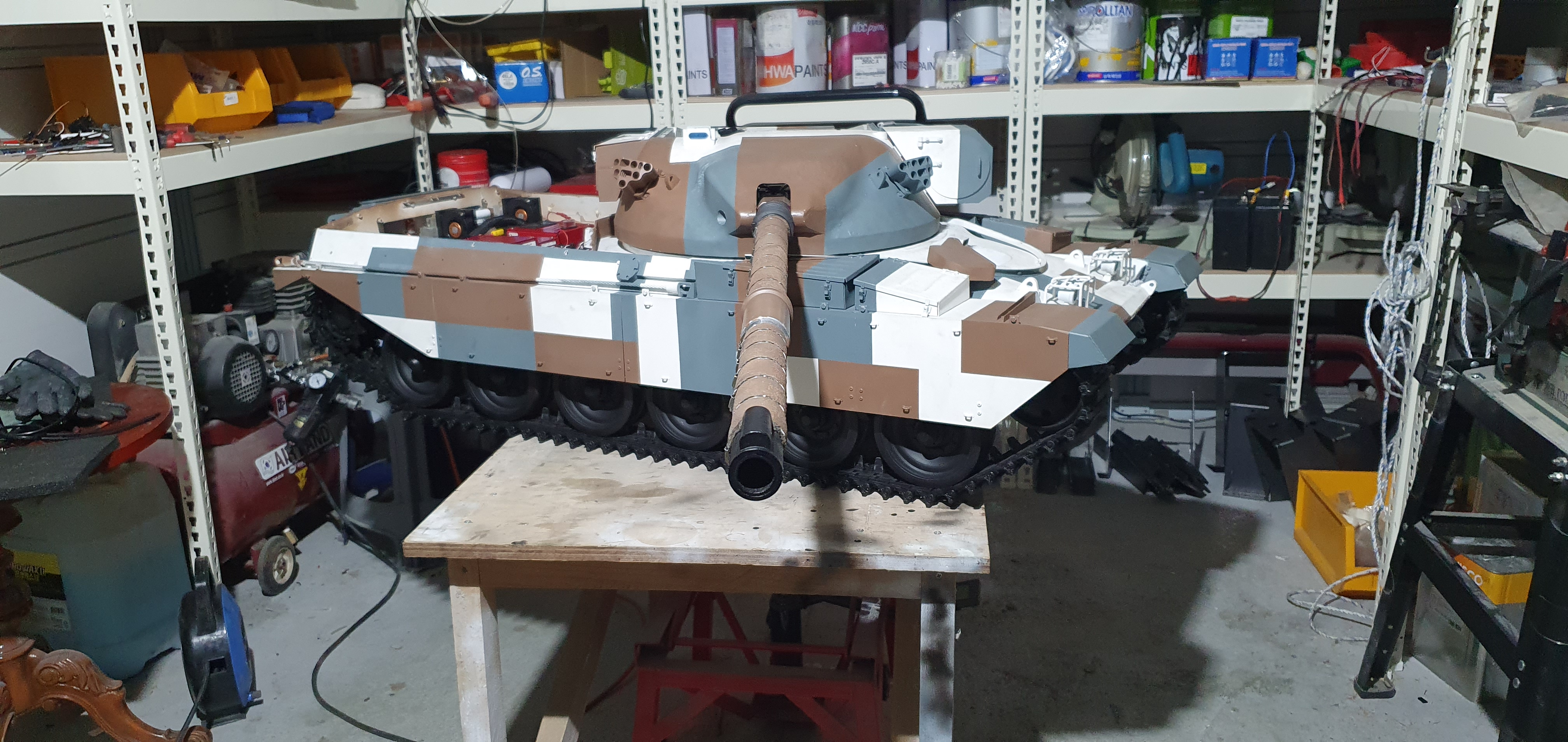

I tried to hang the tank.
From now on, the turret can be easily joined or separated.
Youngjae

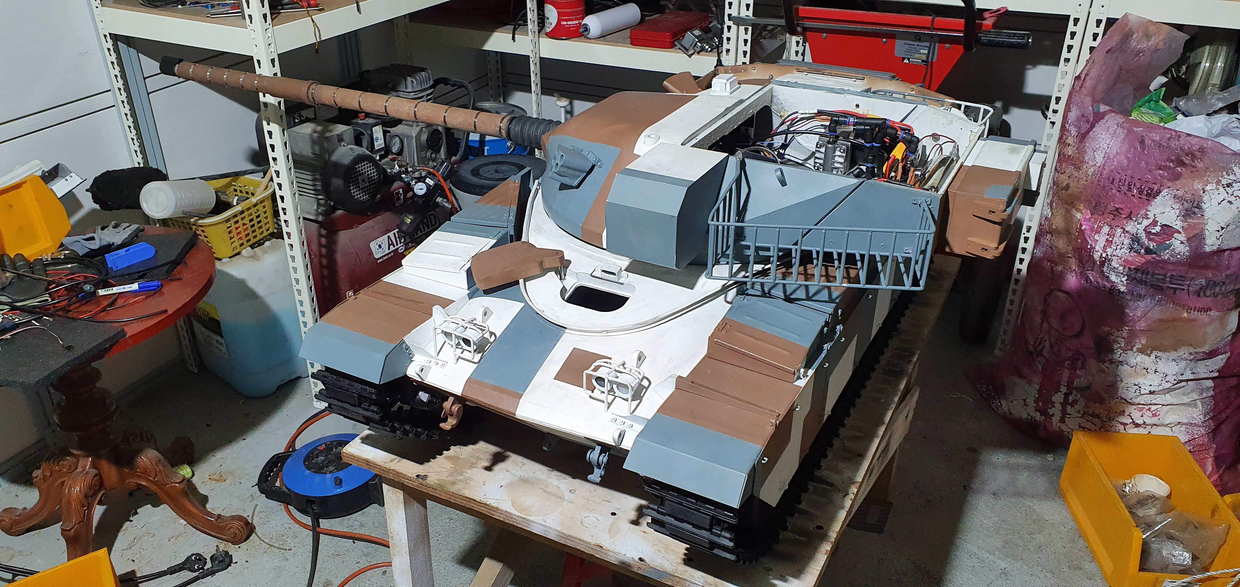

- Youngjae Bae
- Posts: 277
- Location: South Korea
- Has liked: 761 times
- Been liked: 613 times
I modified the P&ID for the power system and control system while waiting for the order for several days.
Today, Sabertooth 2*25 and DC-DC converter arrived at home, so I'm going to do some work at home after work.
The delay in procuring orders has turned my personality into a very annoying person.
The components to complete the system configuration are the fitting for the pressure gauge, the vibration proof mount and the mpu9250.
Youngjae
Youngjae

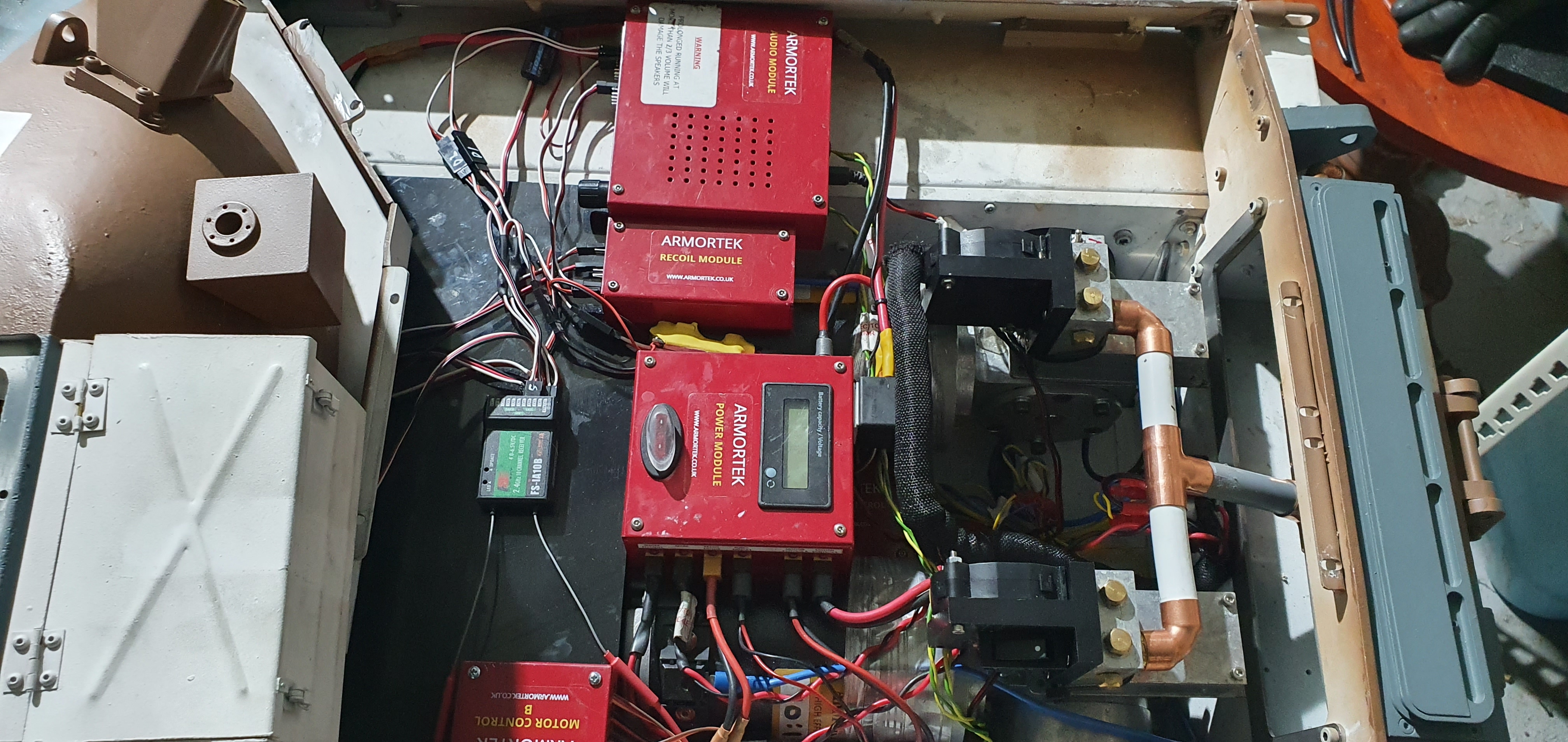

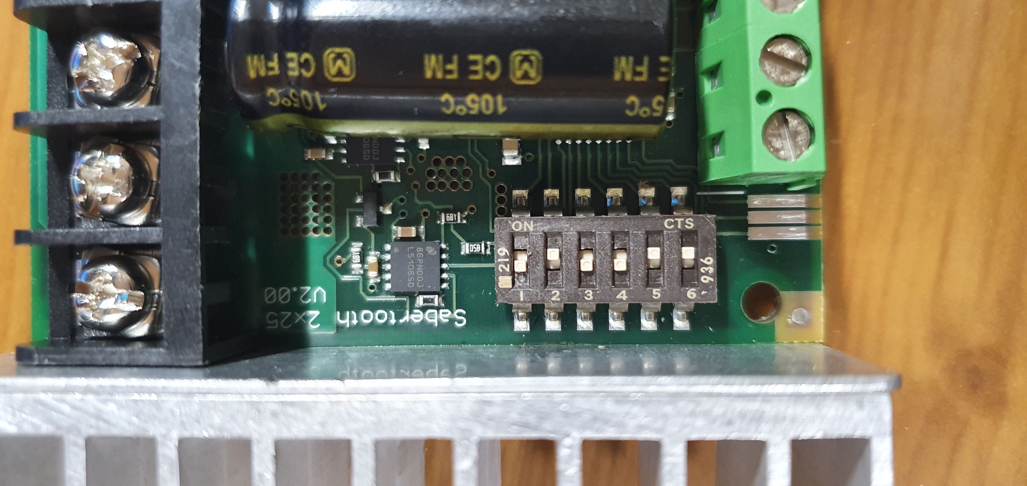

After work, I had dinner and finished a short walk in the house yard.
I will exchange the function of motion controller B with the product that arrived today.
The deep switch of the motor controller was adjusted according to the manual.
Especially, it's common to use exponential curves at the center of the stick, but I adjusted it to linear mode because it has to be linearly proportional to the reaction of the gyro.
And I will adjust the power supplied by the sound module to 24V. The sound module worked well even when supplying 29V. However, I will install a DC-DC stepdown converter here to ensure safety by removing electrical shock as it is a valuable part of the chieftain's engine sound output.
The range of operation of the pneumatic solenoid valve for the recoil is 24 to 26V, where the voltage supplied to the coil components must be fixed at 24V.
Therefore, I will distribute it from the power line to the sound module adjusted to 24V.
Youngjae
The final dipswitch has been modified as shown in the picture.
The motion test of the new motion controller B was well done. Especially, the inertia moment of horizontal and vertical movement of the turret was controlled with ease.
Youngjae
