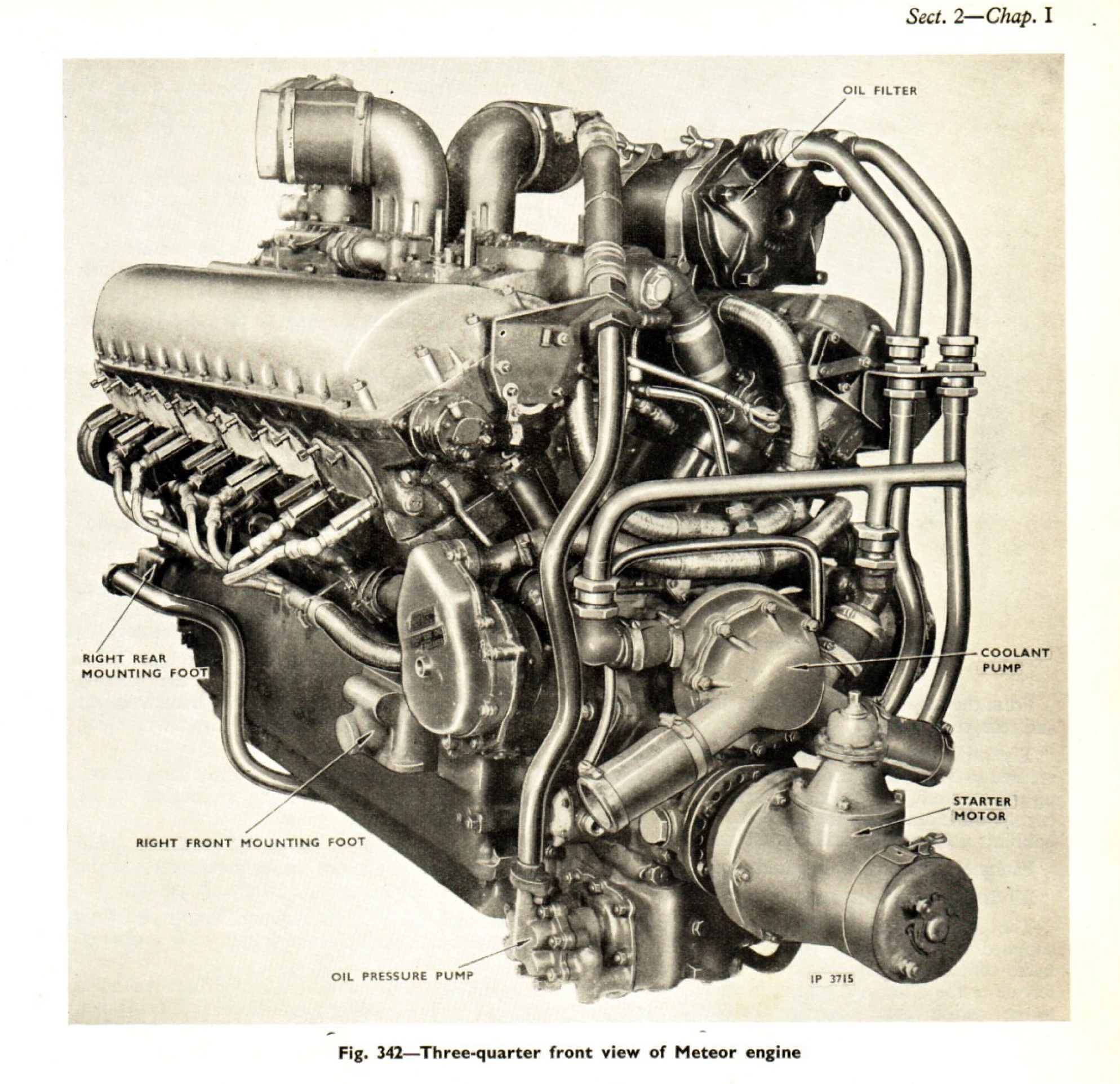

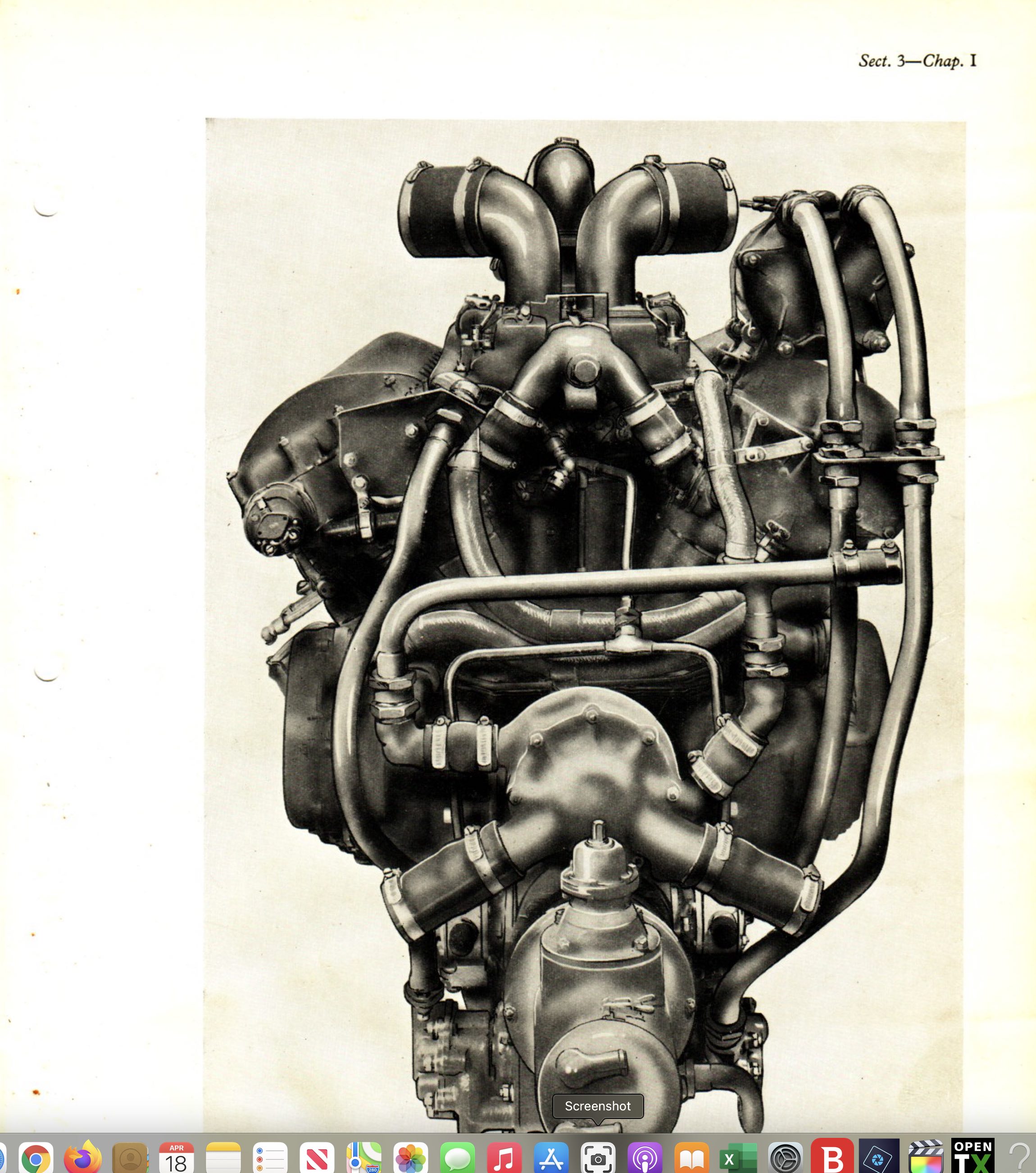

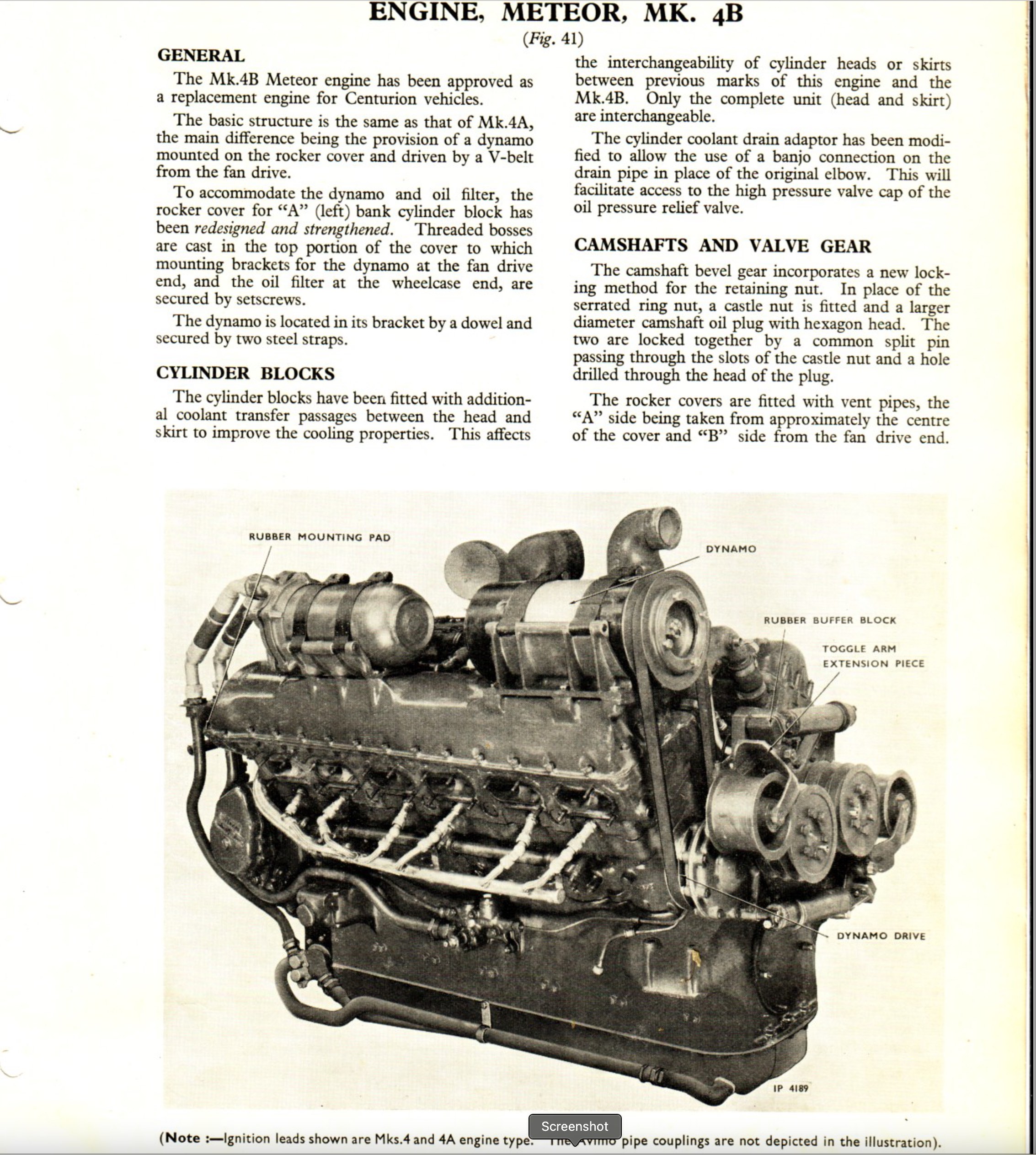

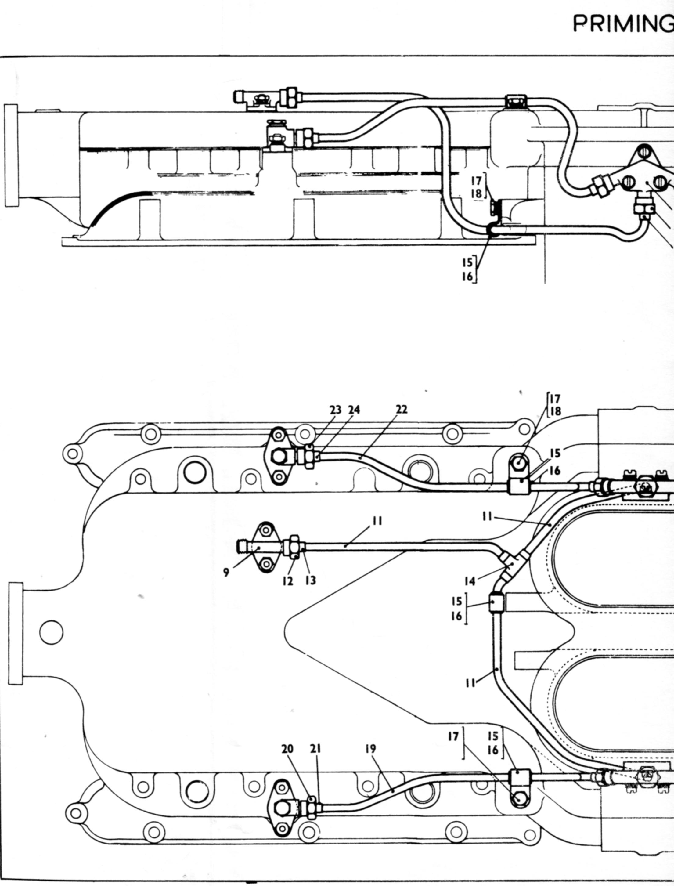

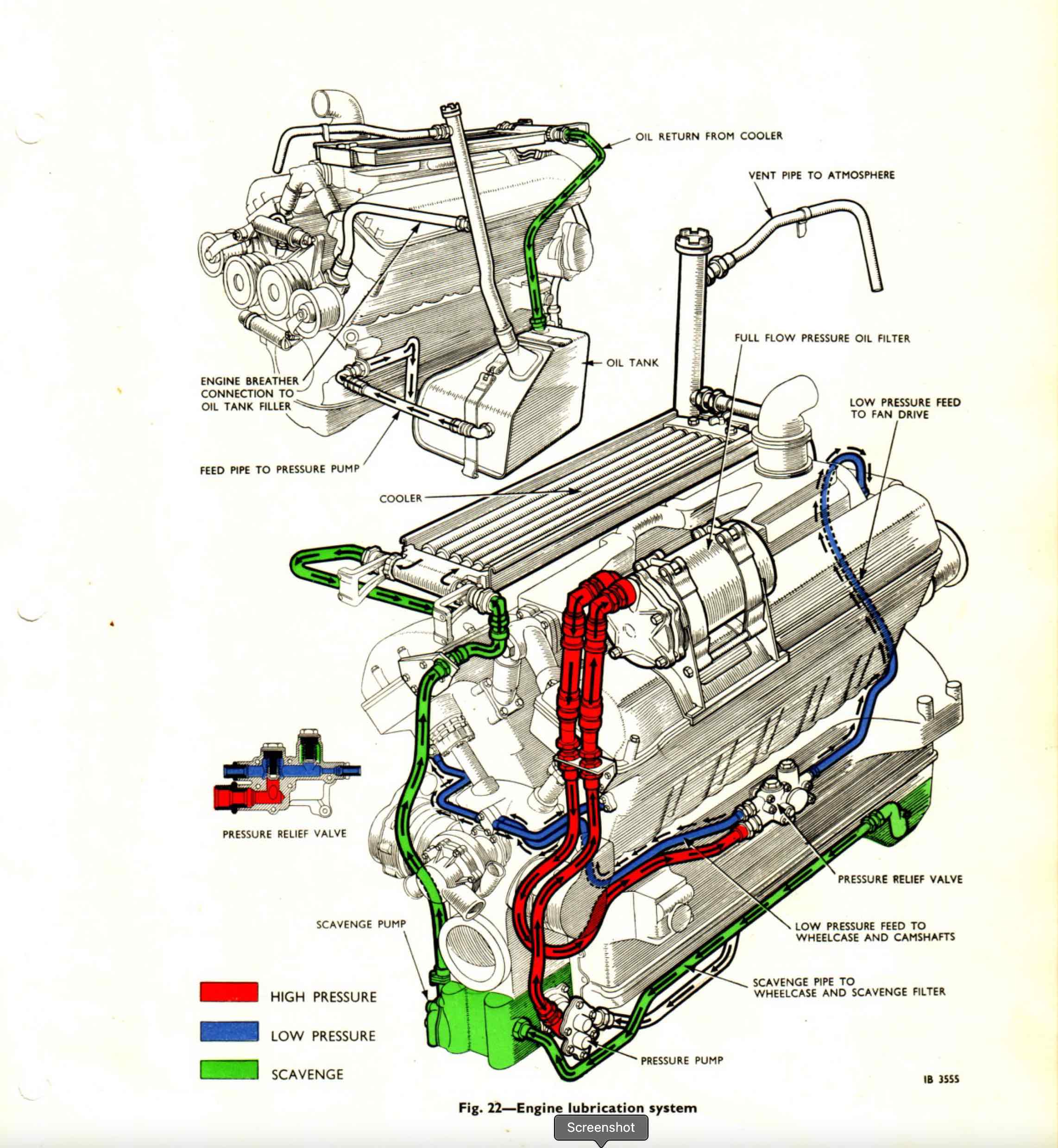

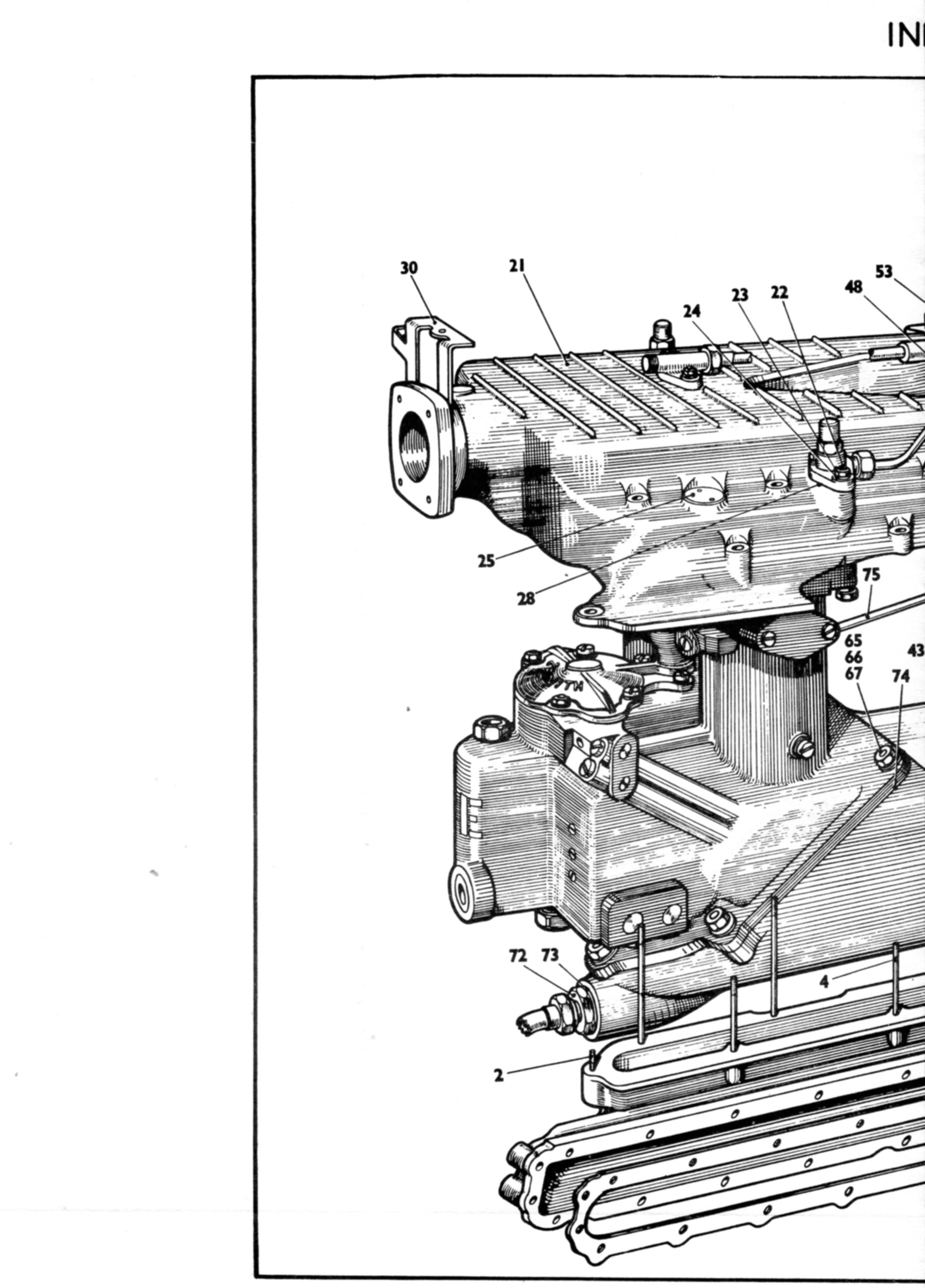

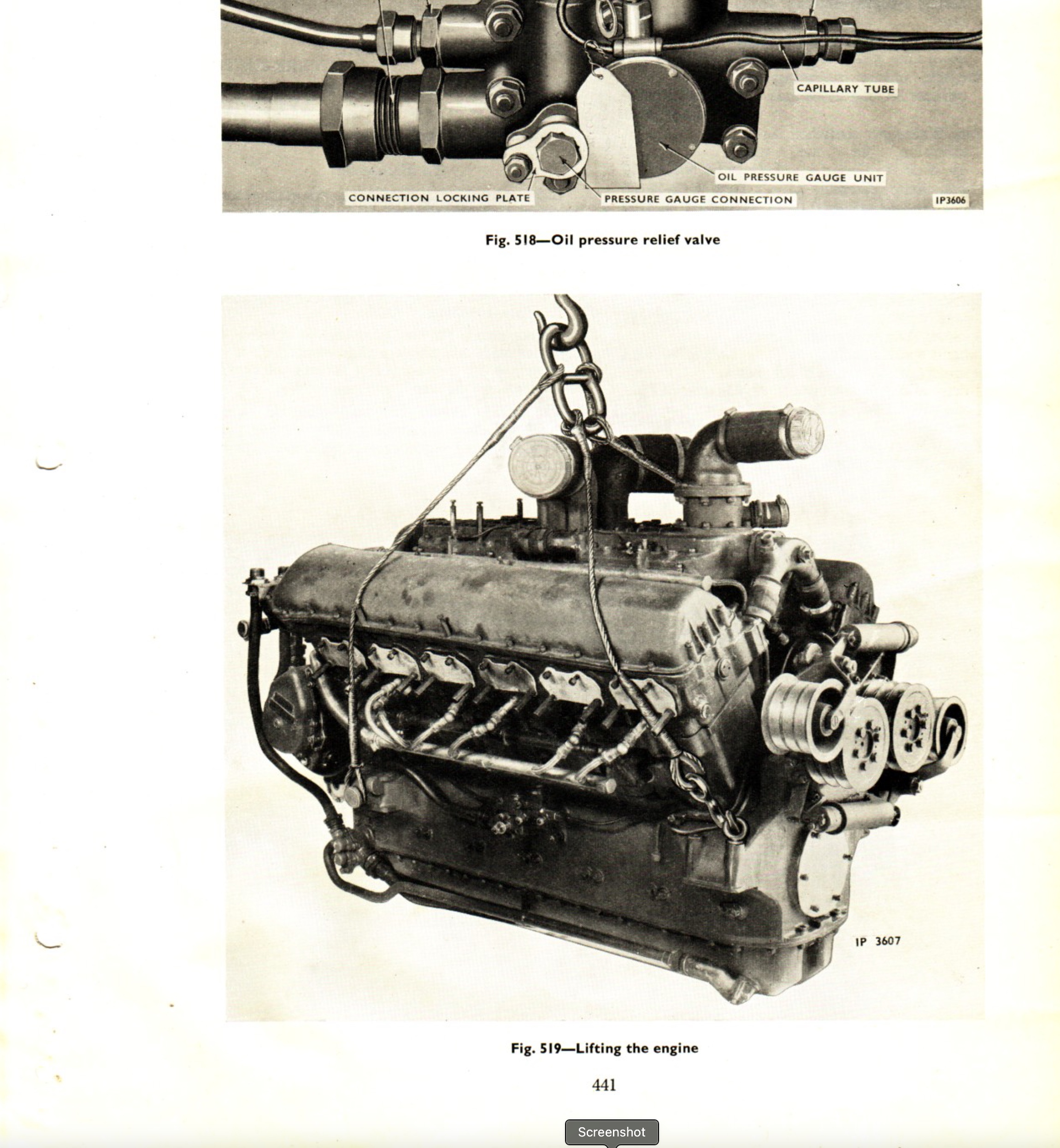

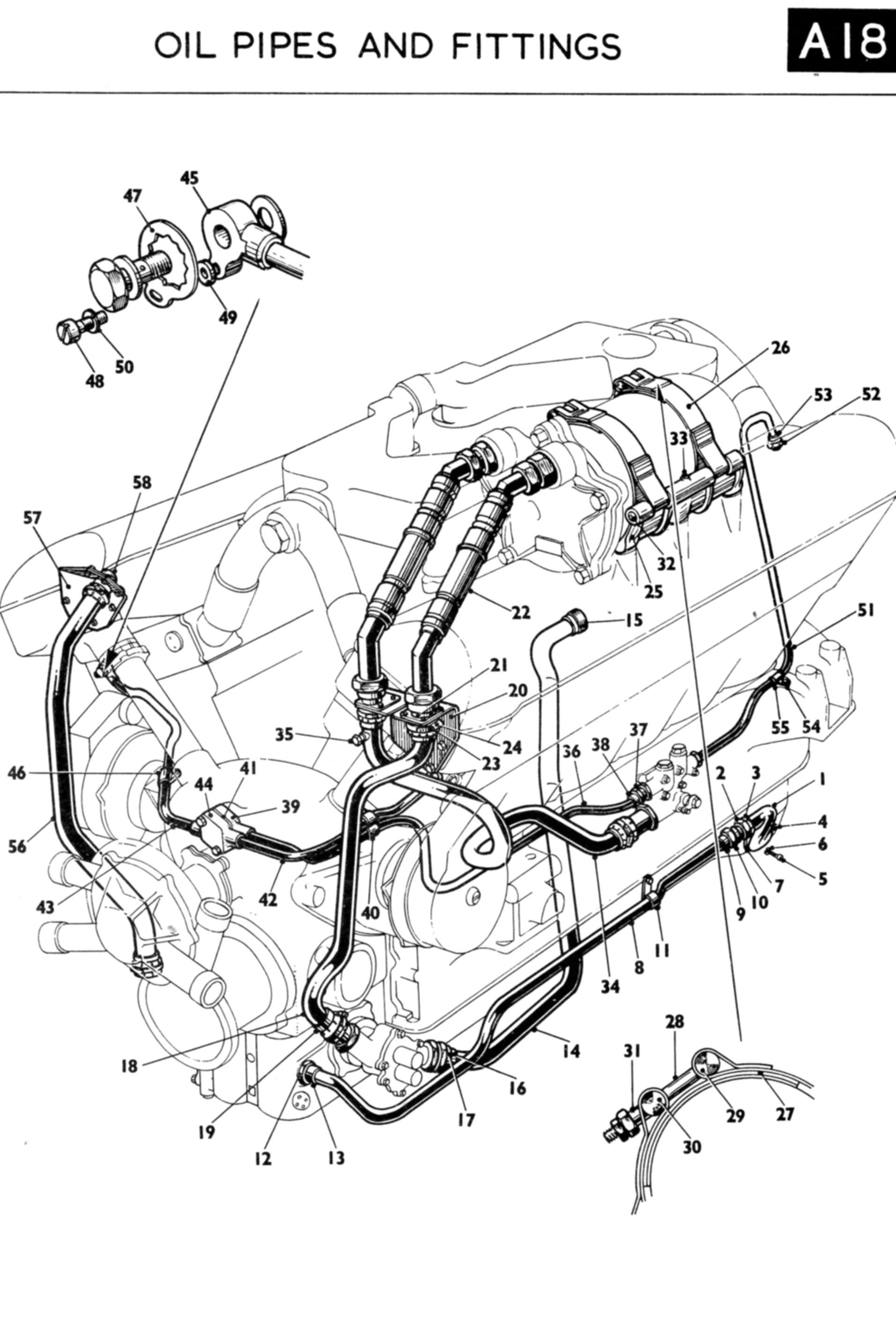

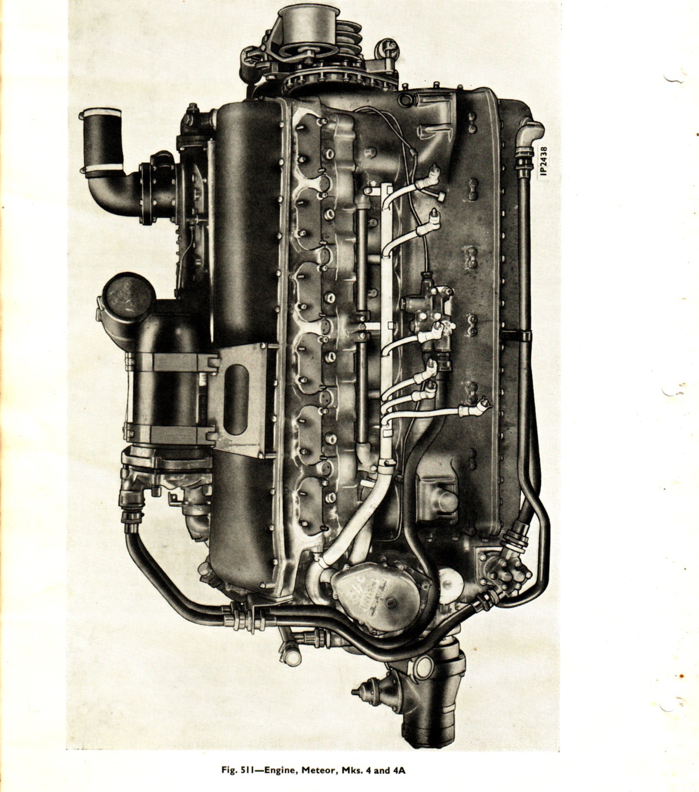

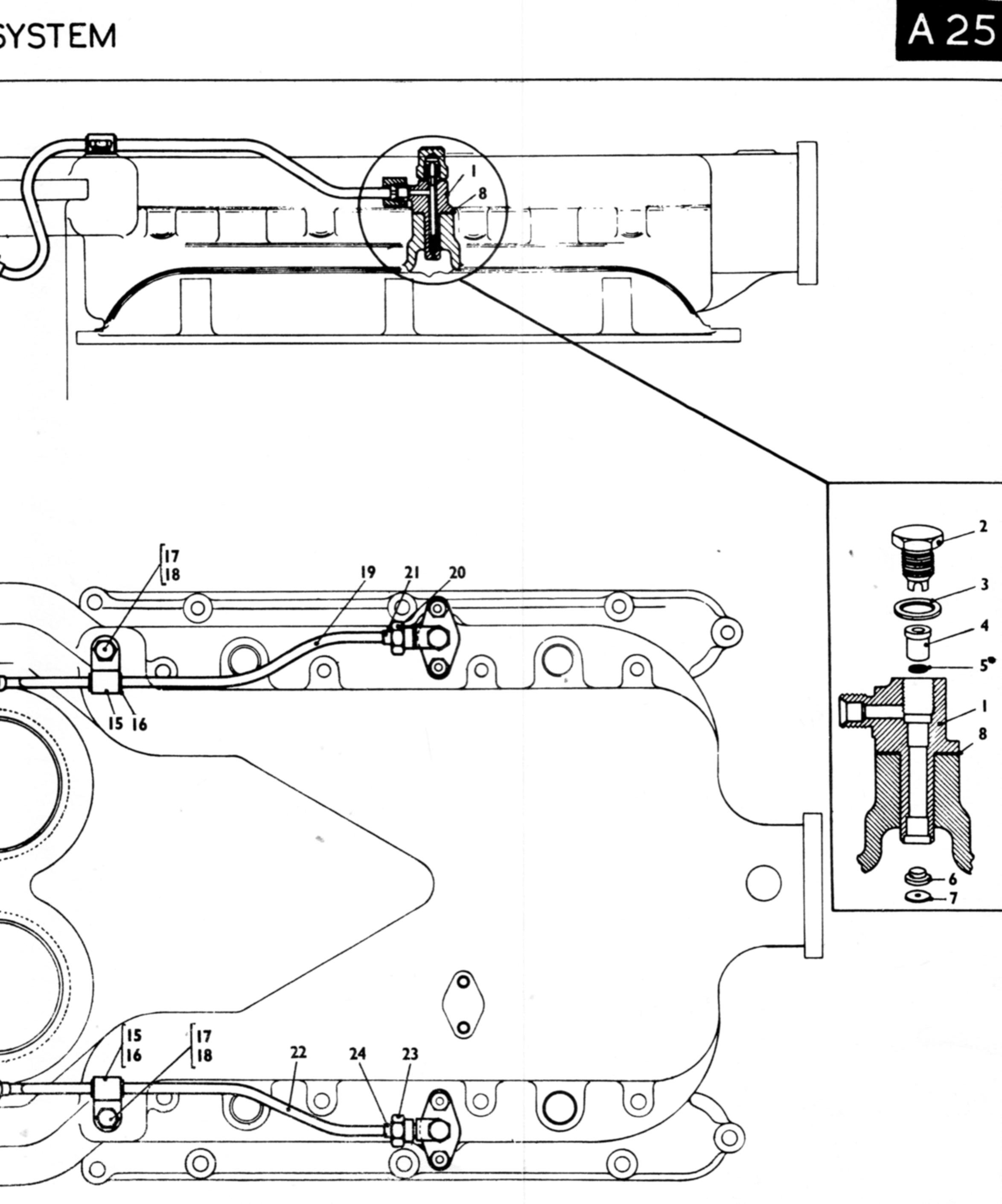

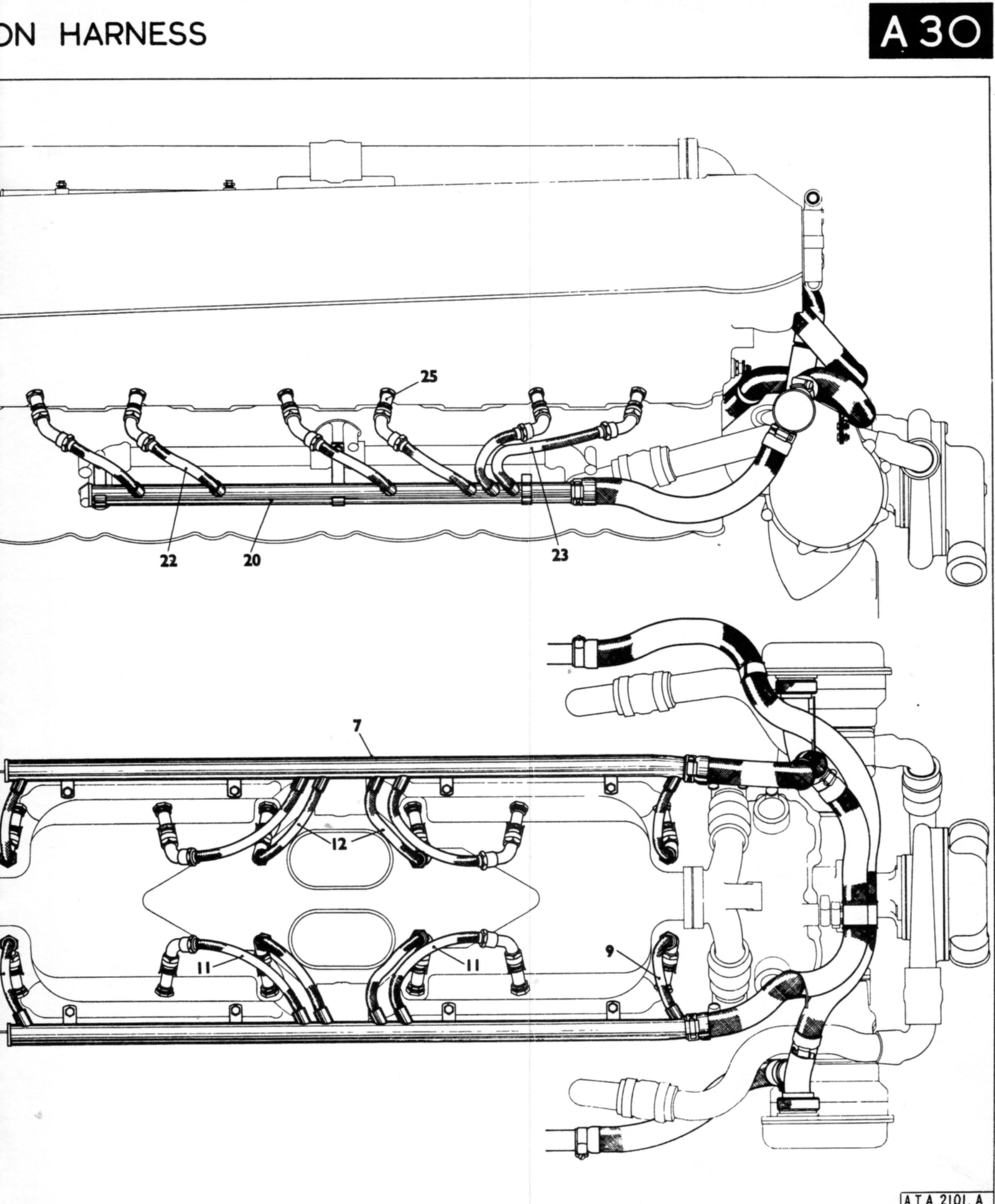

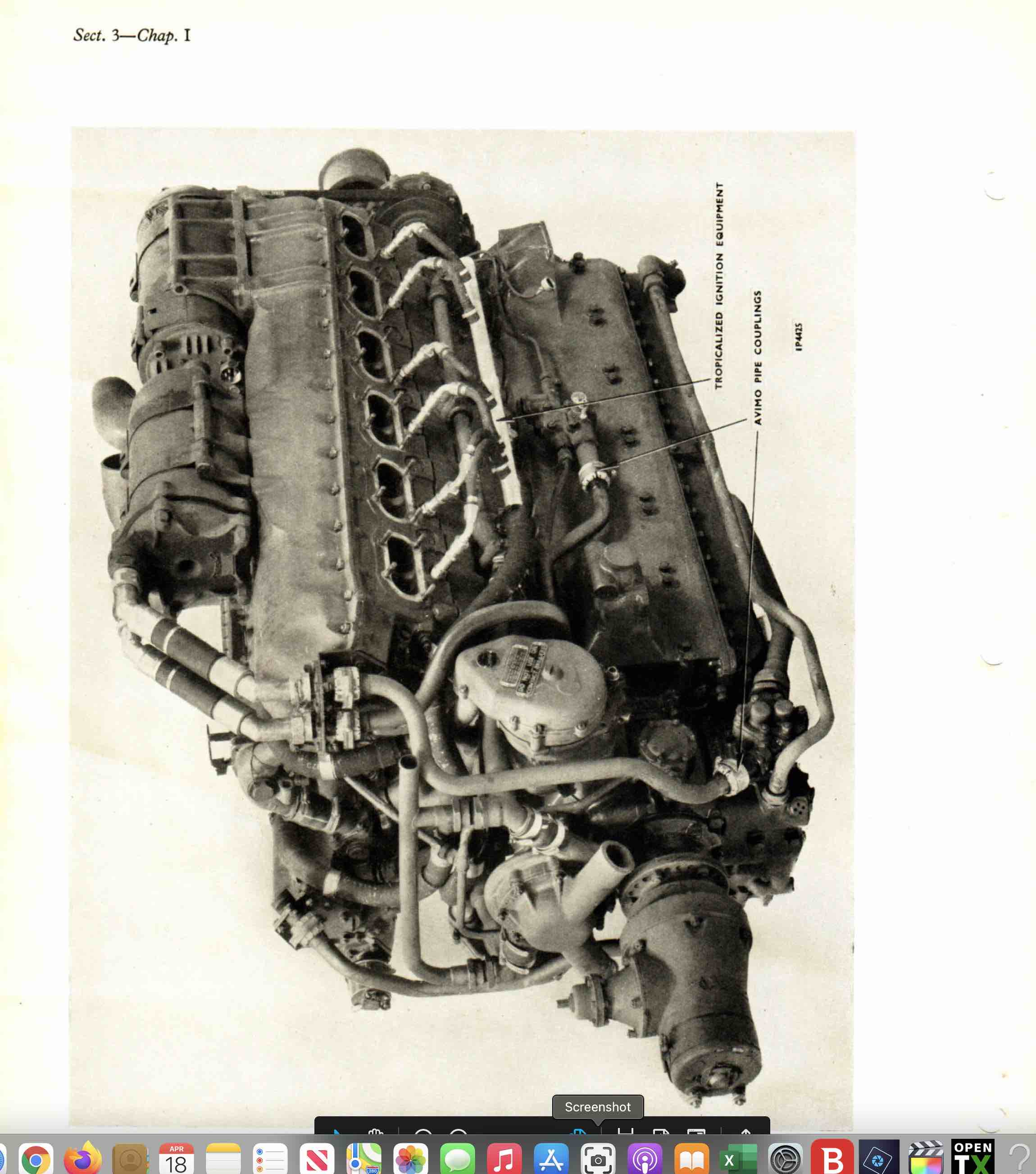

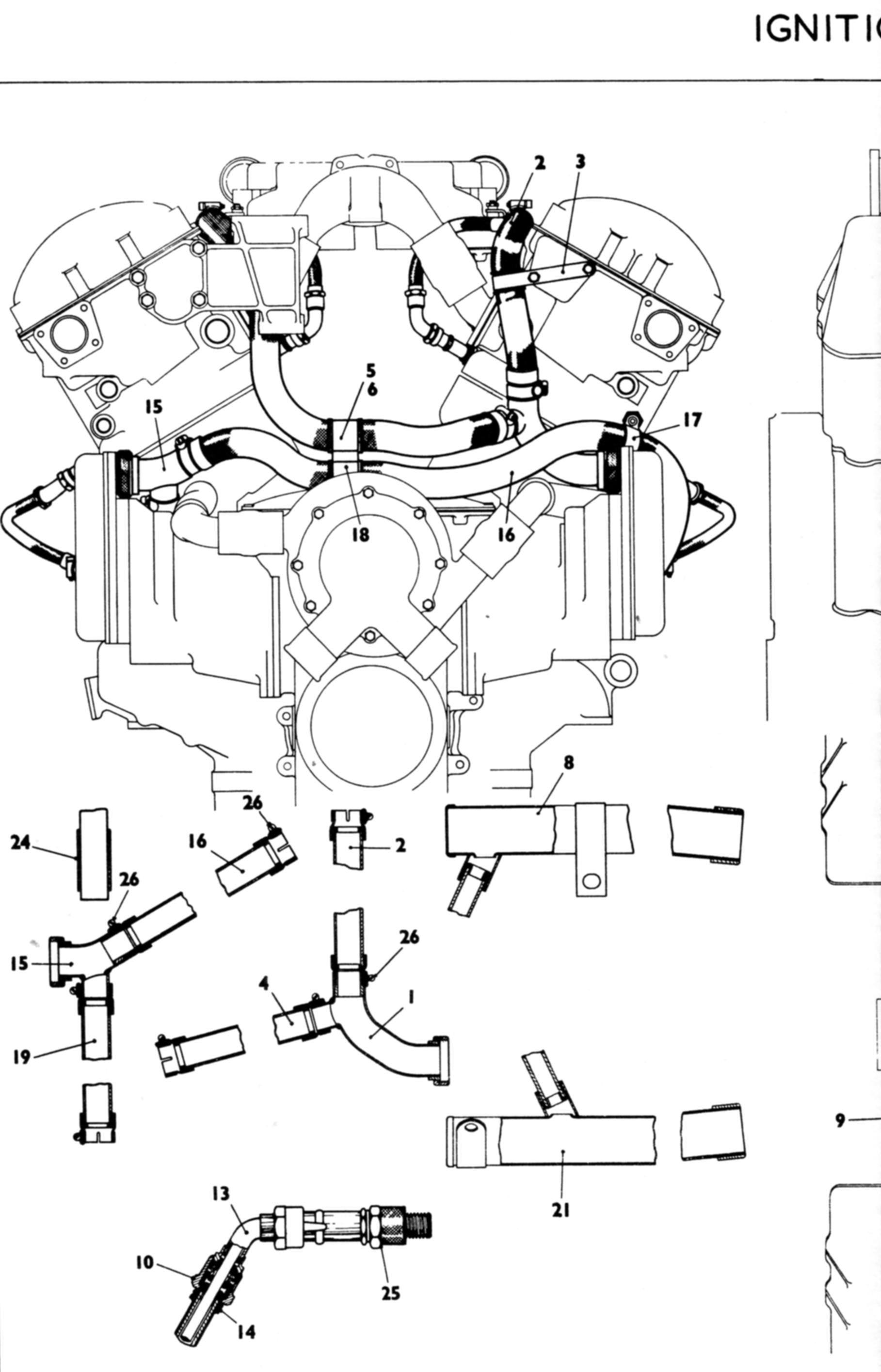

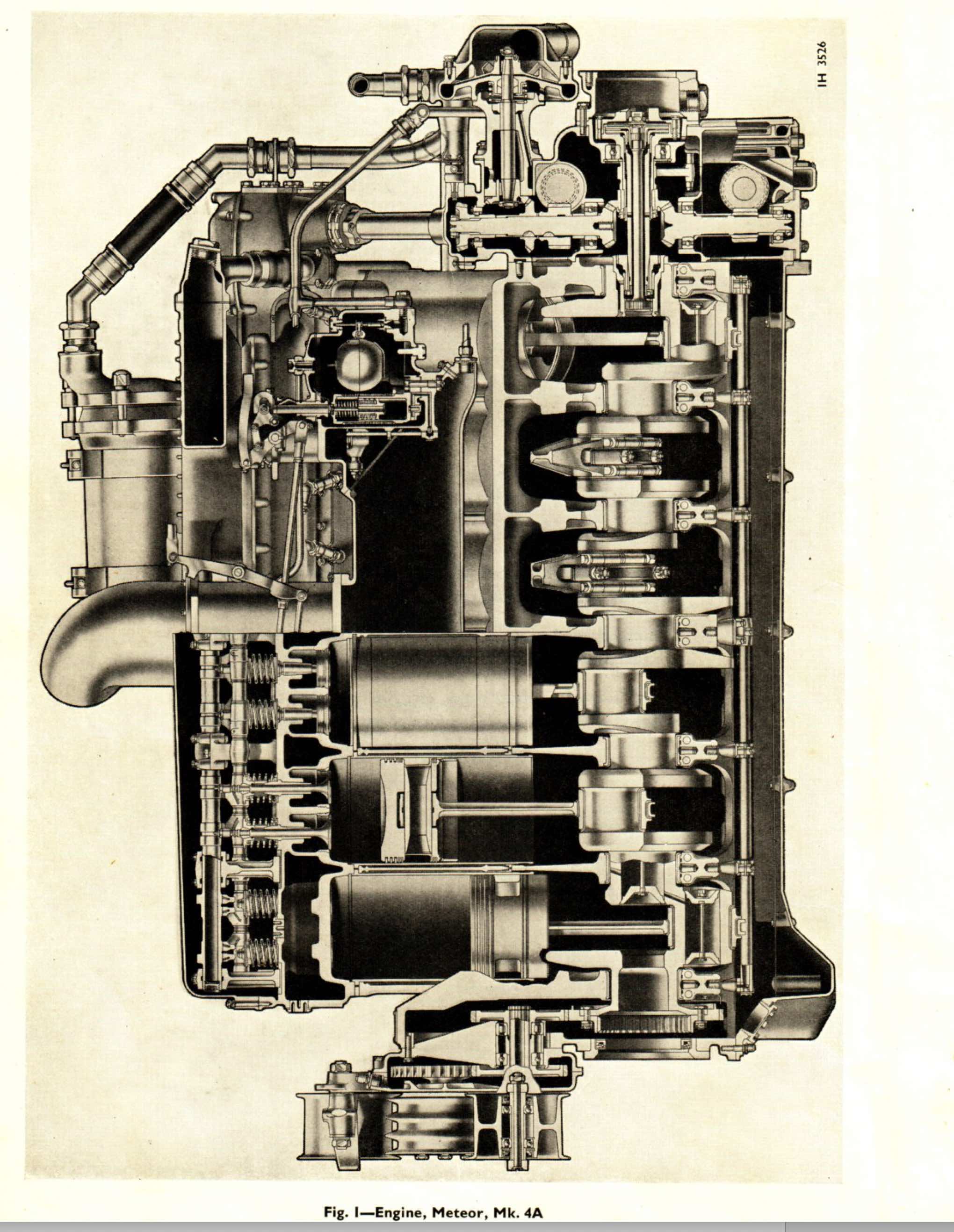

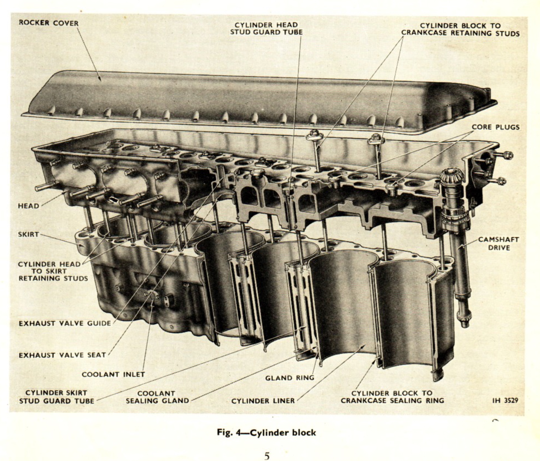

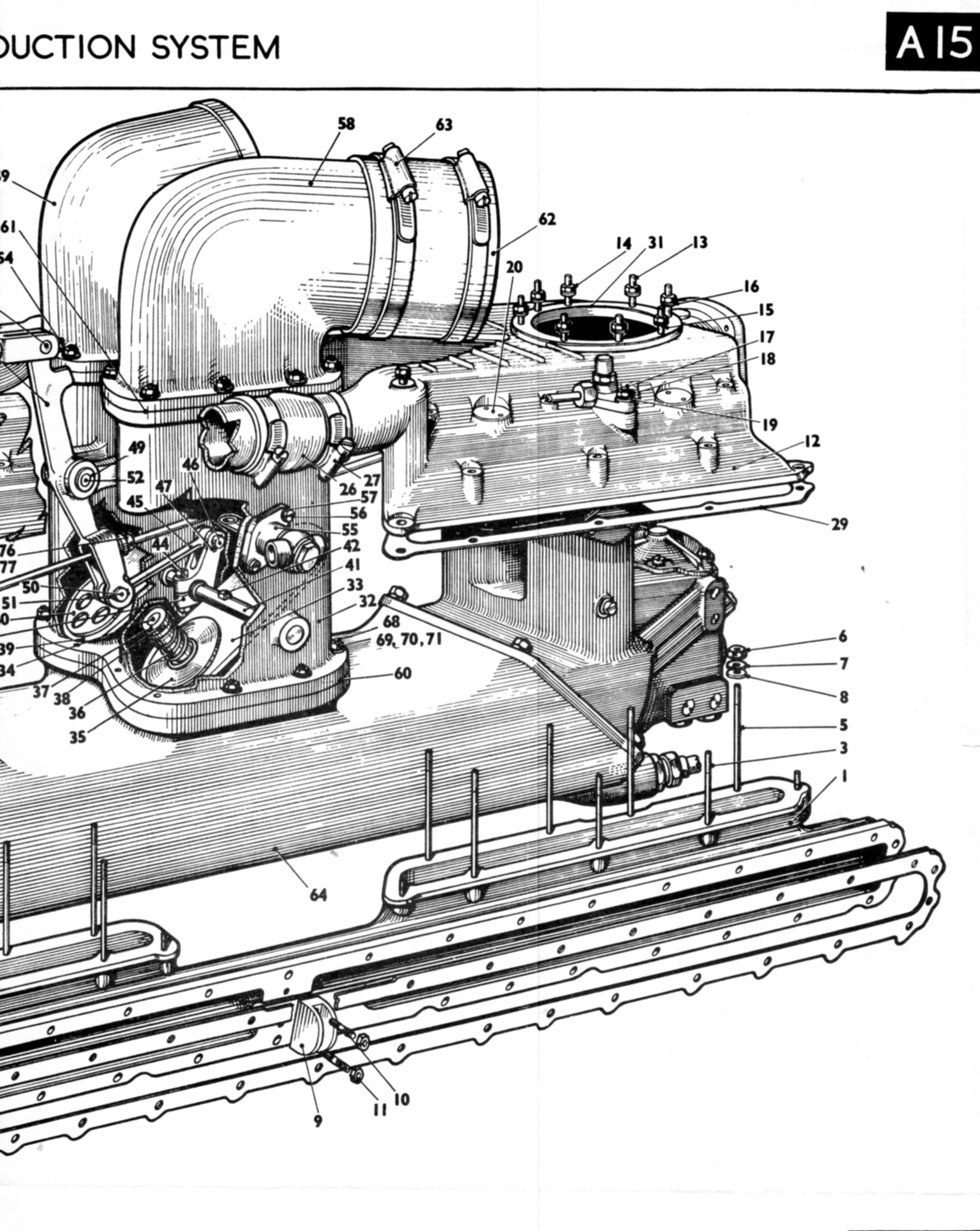

Ambitious Frank, well done...
Would these help?

Frank Breitenbach
Posts: 254
Joined: Sun Feb 12, 2012 8:52 am
Location: Grafenau, Germany
Has liked: 54 times
Been liked: 689 times
Re: A 47 years old love
Post by Frank Breitenbach »
Hello Stephen
Many thanks! Very helpful – especially the longitudinal section!
In the past I had believed, that the right cylinder bank is a little bid forward. But now I understand how the crankshaft works.
The right help to the right time!
All the best
Frank
