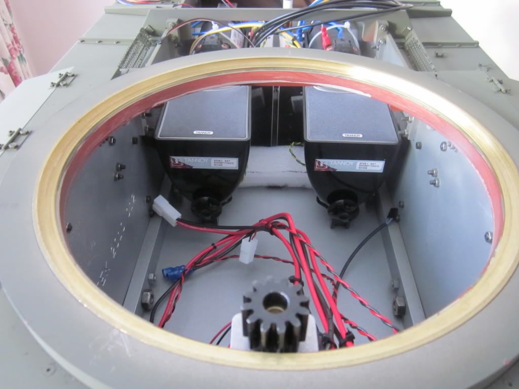

hi phil
you have been busy, looks like theirs more room to play with
inside the comet ,looking very good wont be long know for the test drive .its been good to watch .

Nick
Hi Nick
Yes ther is a lot more room in the Comet and much easyier to get at things.
The two big hatches over the engine bay are ideal and the top comes off
with 4 screws.
My power cables are too short to reach from the power supply at the front
shelf,to the speed controler and amplifiere at the back,even thogh I have fitted them about 80mm closer than the drawings they are still about 60 t0
80mm short.
I was going to extend my battery cables to the rear anyway so all my
switches and charging lead are at the rearunder the doors.

Lift
Hi Mick
you was lucky with that nut not dropping down into the gear box.
I've dropped a little bracket and a switch today,down into the hull at the rear and there is not enough room to get my hand down.
So I had to manouver them with a stick until I could grab them with my
crimping pliers.
My Tank is on blocks at the moment on top of a B&Q work bench,but I
have got a lift,see Page 15 on this posting,the last entry I gave you details
and the adress where I got mine from.
Its a Sealey scissor lift model MC5905.V2.
Ive had mine running on the bench today,have got a bit more wiring to do
in the hull then its up to the turret.
Phil
