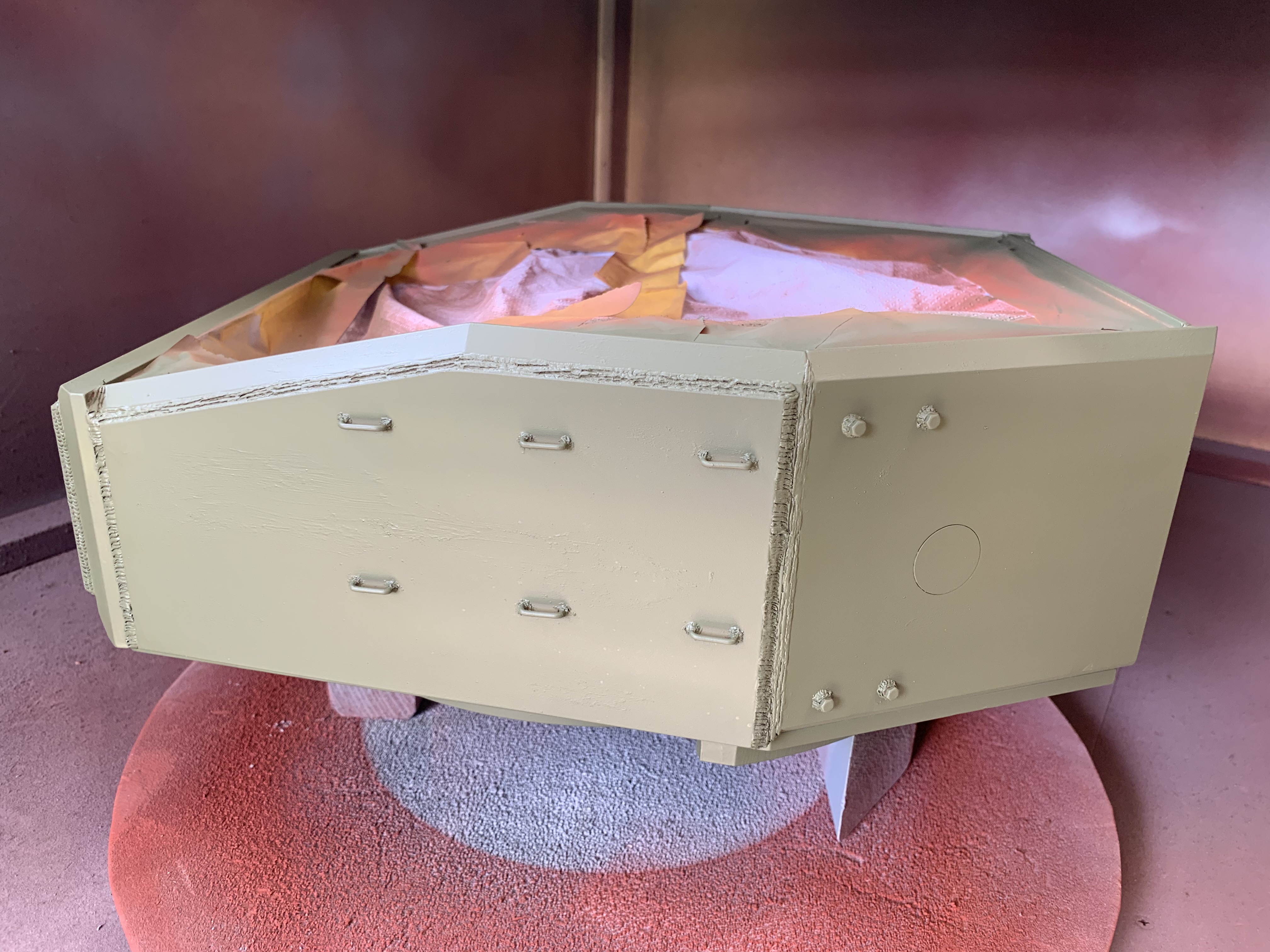

Just a photo showing the top coat being applied to the turret, this is a Mike Starmer mix of Tamiya acrylic paints to achieve the SCC15 used on the AVREs when upgraded before D-Day.

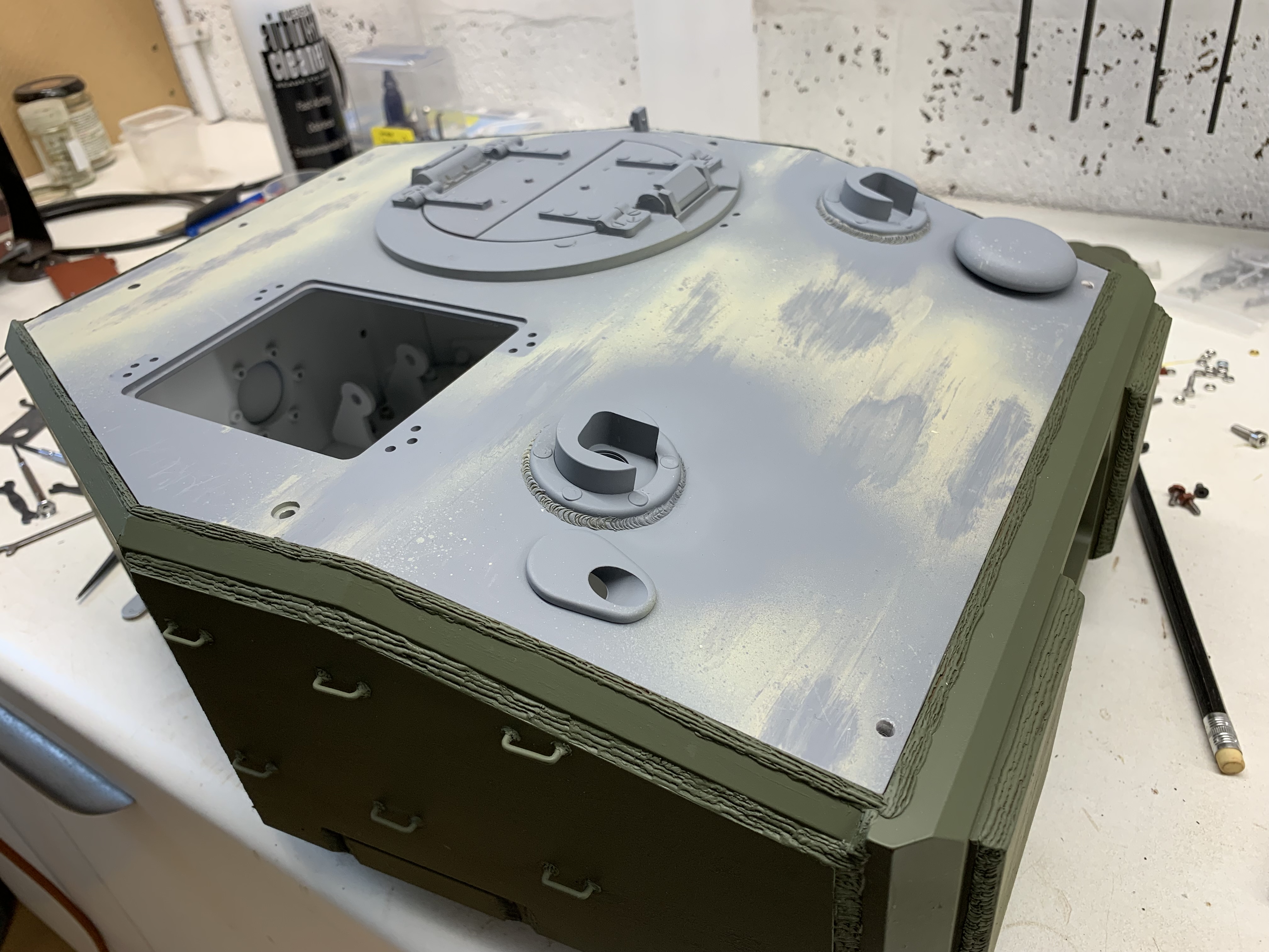

Hi all

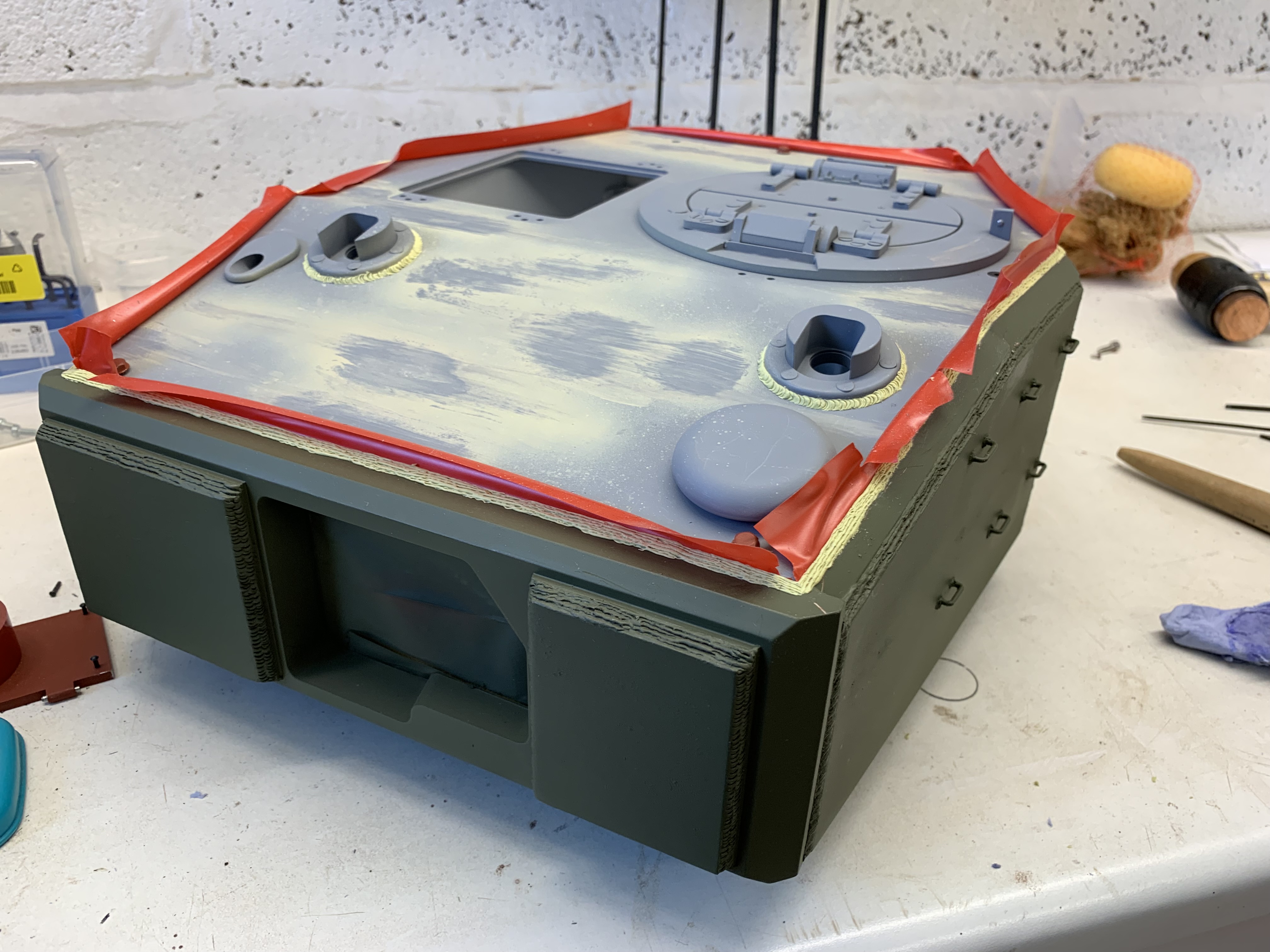

I finished top coating the turret this morning and while I was on a roll decided to get the turret lid welds done. As usual it is done with Milliput with the welds imprinted in lines going along the seams as per full size. The electrical tape ensures there is a minimal gap and is easily removed once the Milliput has set by pulling from one end. The tape thins as it stretched and pops out. I also finished making one of the drivers hatch brackets that holds the hatch in the open position. I used a magnet on the underside of the deck and M2 steel bolt through the bracket bottom. This works really well and the hatch stays open even when I give the deck a good shake.

A quick update regarding the turret welds. After letting the Milliput harden the tape was pulled until it stretched enough to come free. I did a little bit of trimming with a scalpel to ensure there was a slight gap between the welds and the turret roof.
The welds were red oxide primed and top coated. I am now working on completing all the hatch detailing but may have to wait until after Tiger day at the Tank Museum as I need a few more photos to confirm if the drivers rear hatch also had the curved lid latch like the one I made for the front section. I suspect it will have but it is difficult to see on the Mk4 example without hanging off the walkway

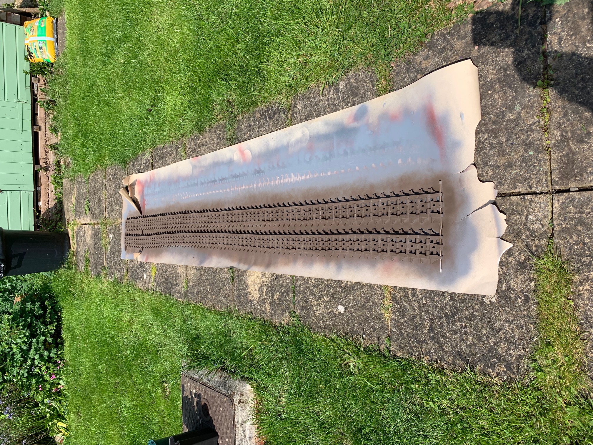

With the recent few days of warm dry weather I started putting the top coats on the tracks. I wanted a brown finish which will allow the metal to show through as the tracks wear. The paint is from Railmatch and is called Frame Dirt, I was talking to a friend of my who makes model railways and he mentions the paints saying the truck frames always end up with a dirty brown colouration. As British tank tracks tend to have a bronze brown colour to them I thought I would try it out. They also do a lighter brown which may have been better but nobody had any in stock.
I will add further layers to make them look used with plenty of mud effects.

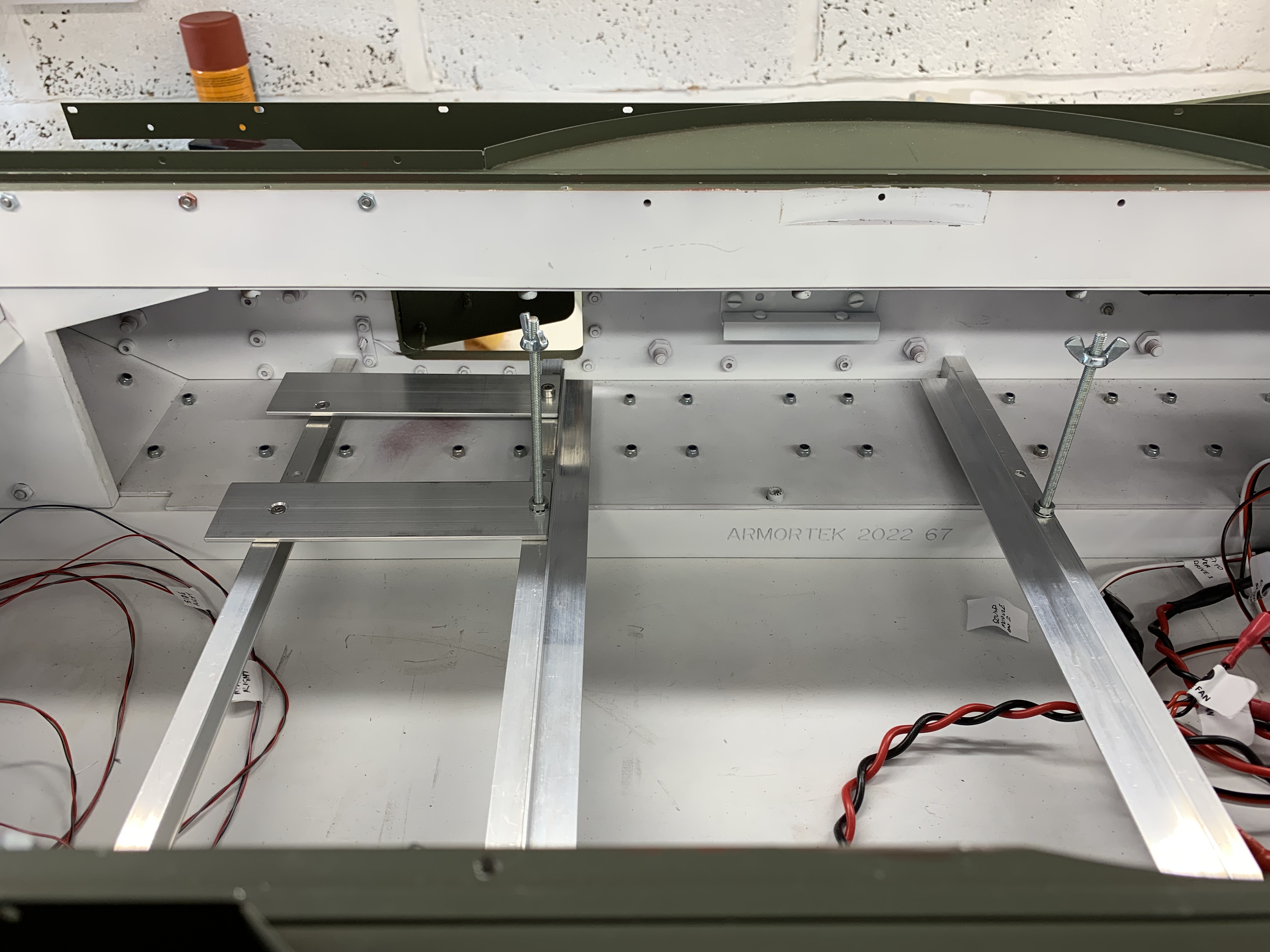

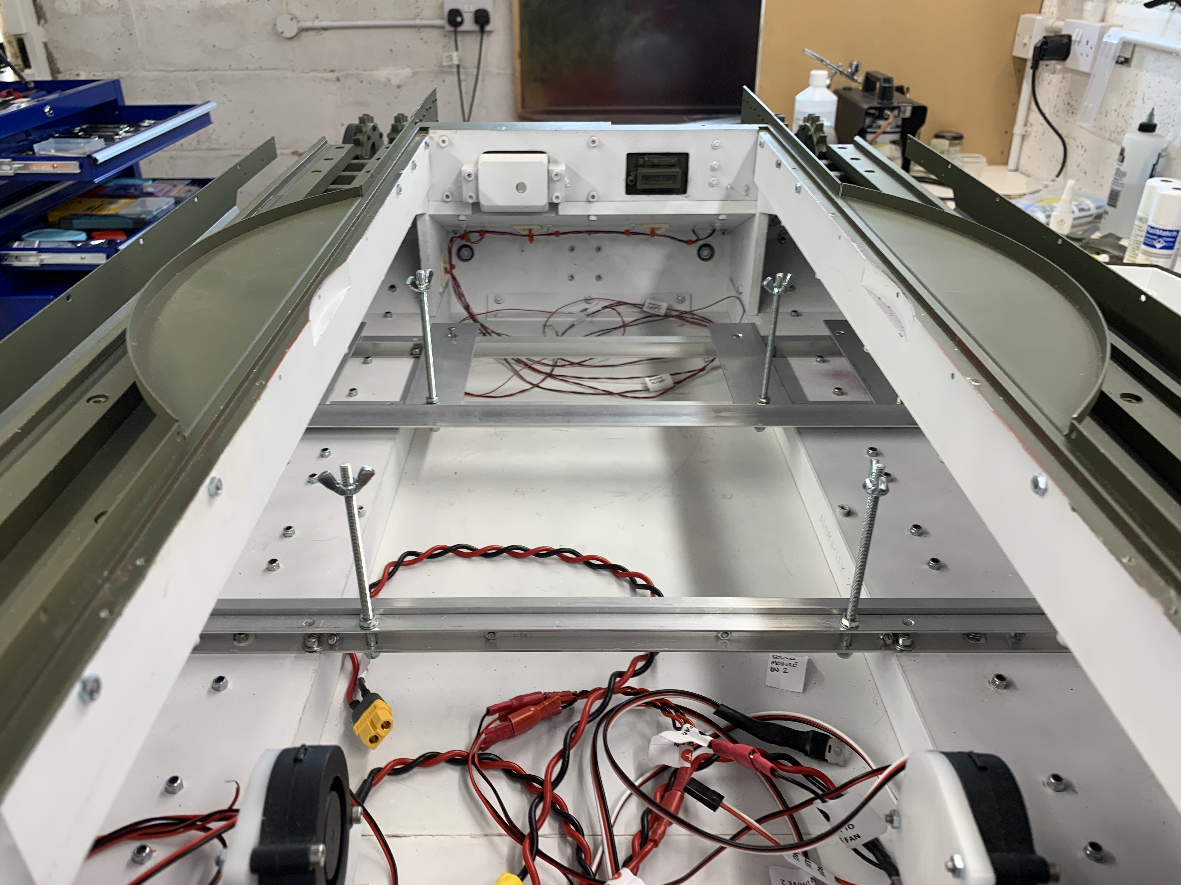

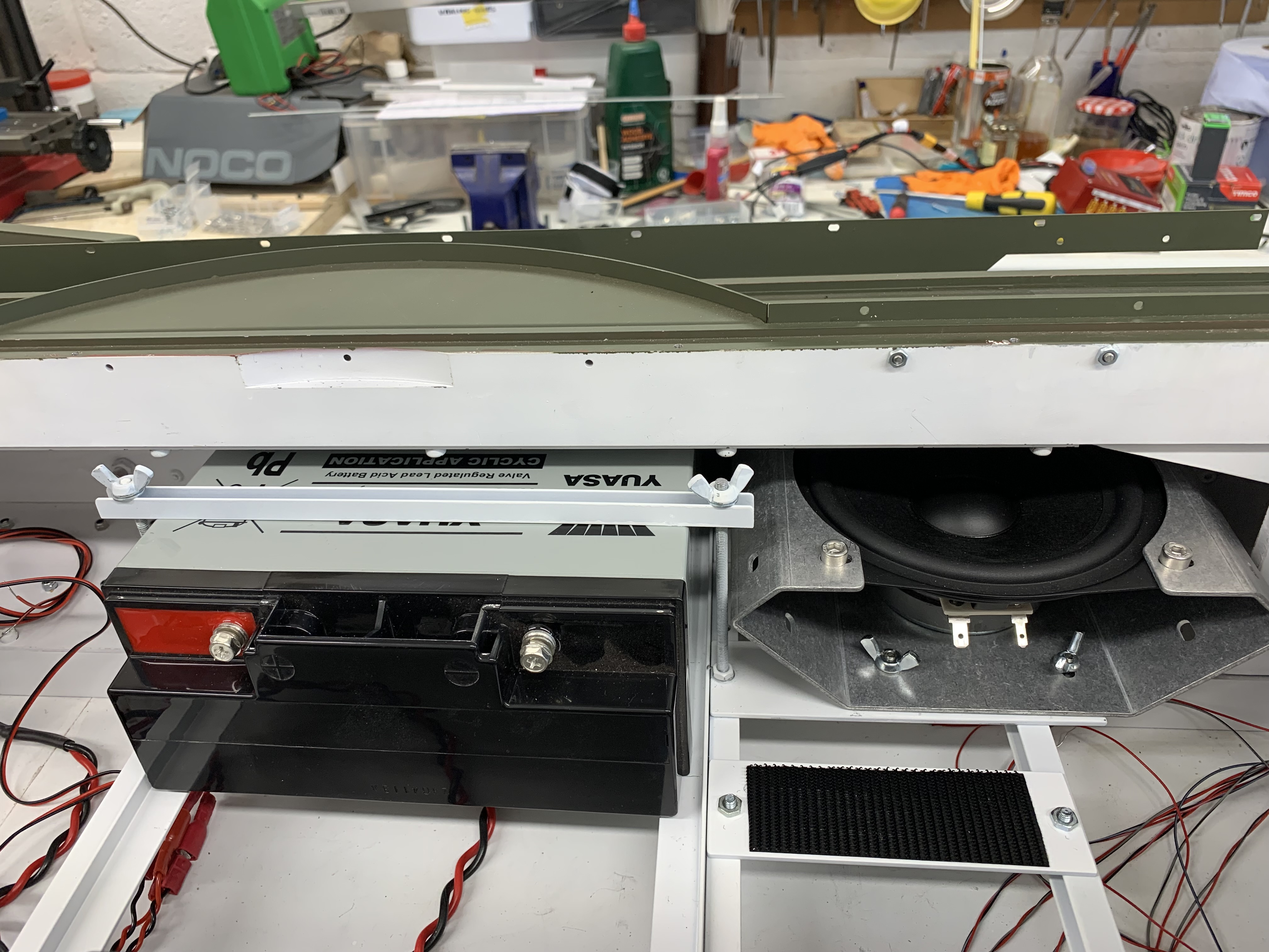

The Churchill build is going slowly but I have made some progress on the battery and speaker positions. I have made up aluminium rails which use the existing pannier bolt holes to stay in place. The batteries and speakers will partially reside inside the panniers leaving a decent amount of space in the hull for the other modules. I will spray the bearers white so they are not so intrusive and the speaker plates will have Velcro strips at the rear with grommet mounted bolts and wing nuts for the centre fixings.
The batteries are held in place with threaded M4 rods and a bar at the top. This installation leave enough room for the turret turn motor and means the front hatches can be used for switches etc. I will add more photos once it is all painted and installed.

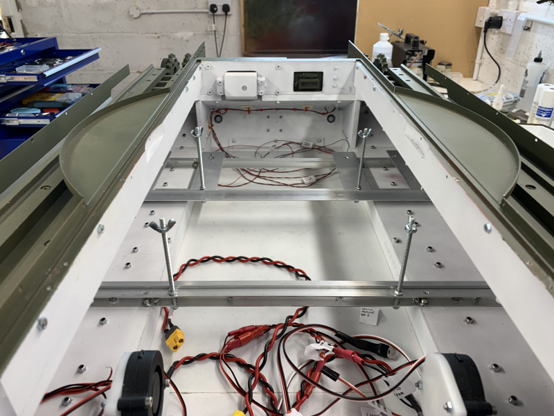

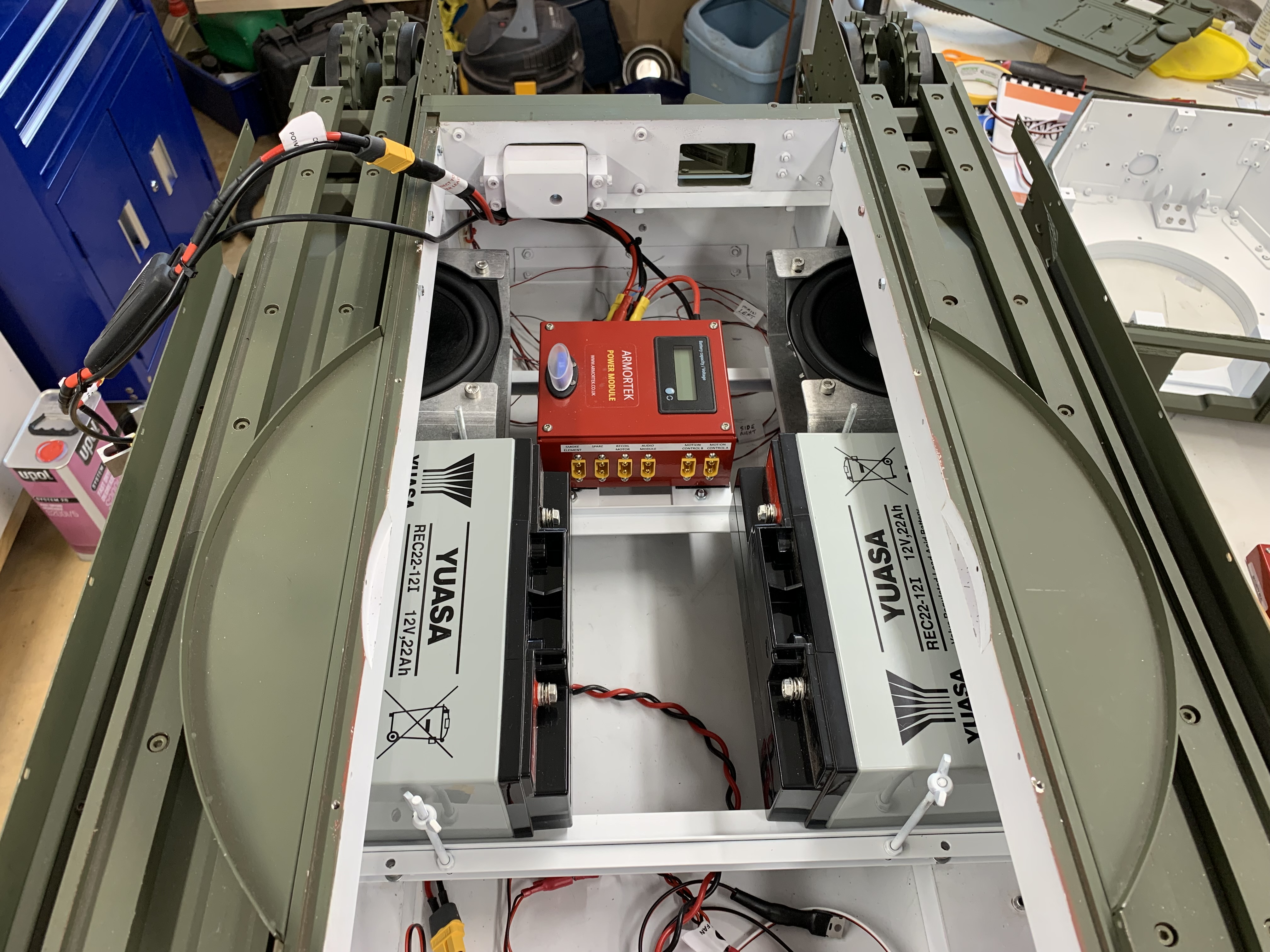

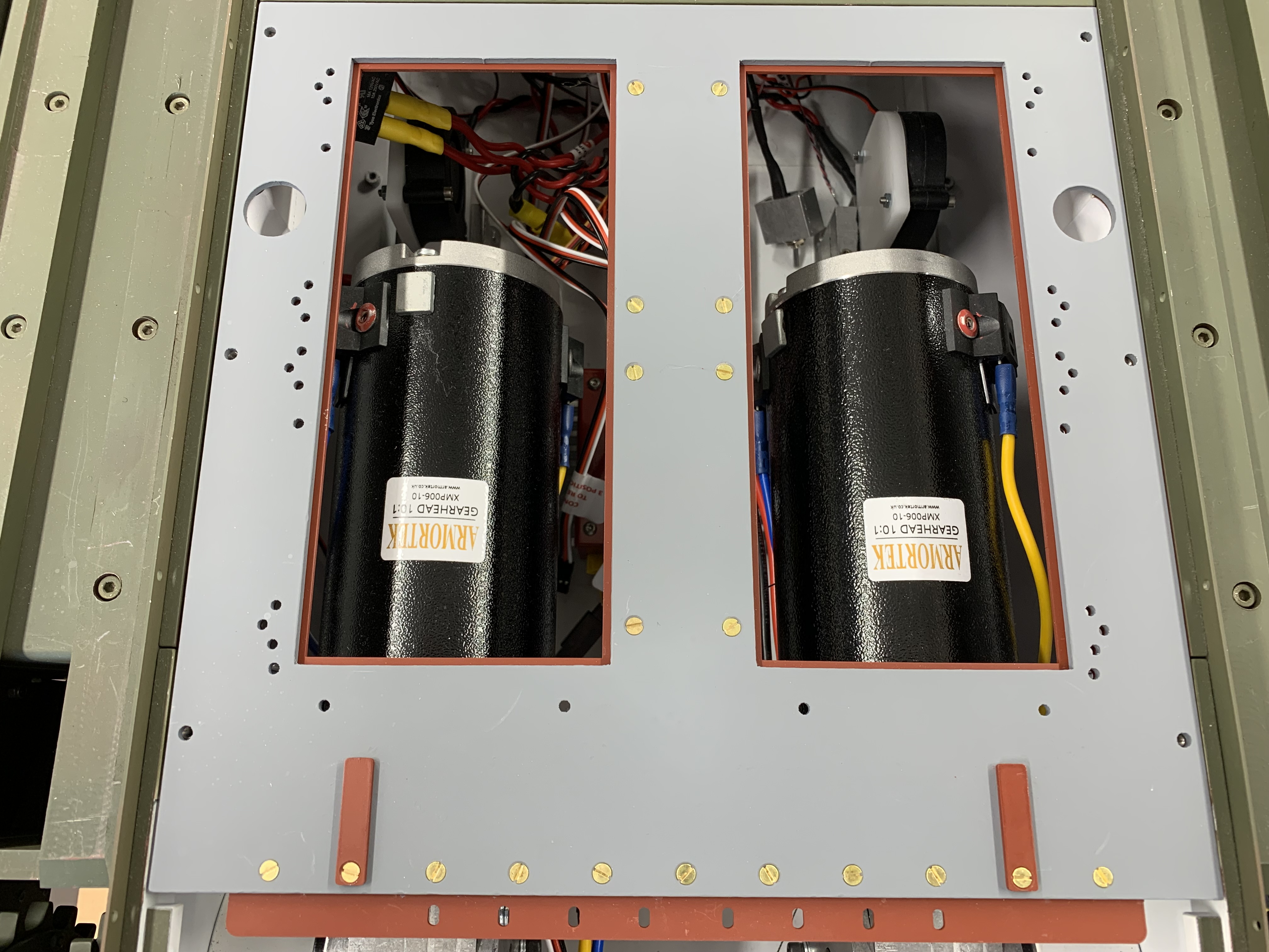

After a couple of minor tweaks I have the power module situated between the speakers. I am using Velcro to hold it in place as this worked well on the Tiger and makes it easy to remove.
Just a couple of photos to show the progress so far. Next step is the audio module location which I want to place near the exhaust/rear deck hatches so I can access the volume switch.

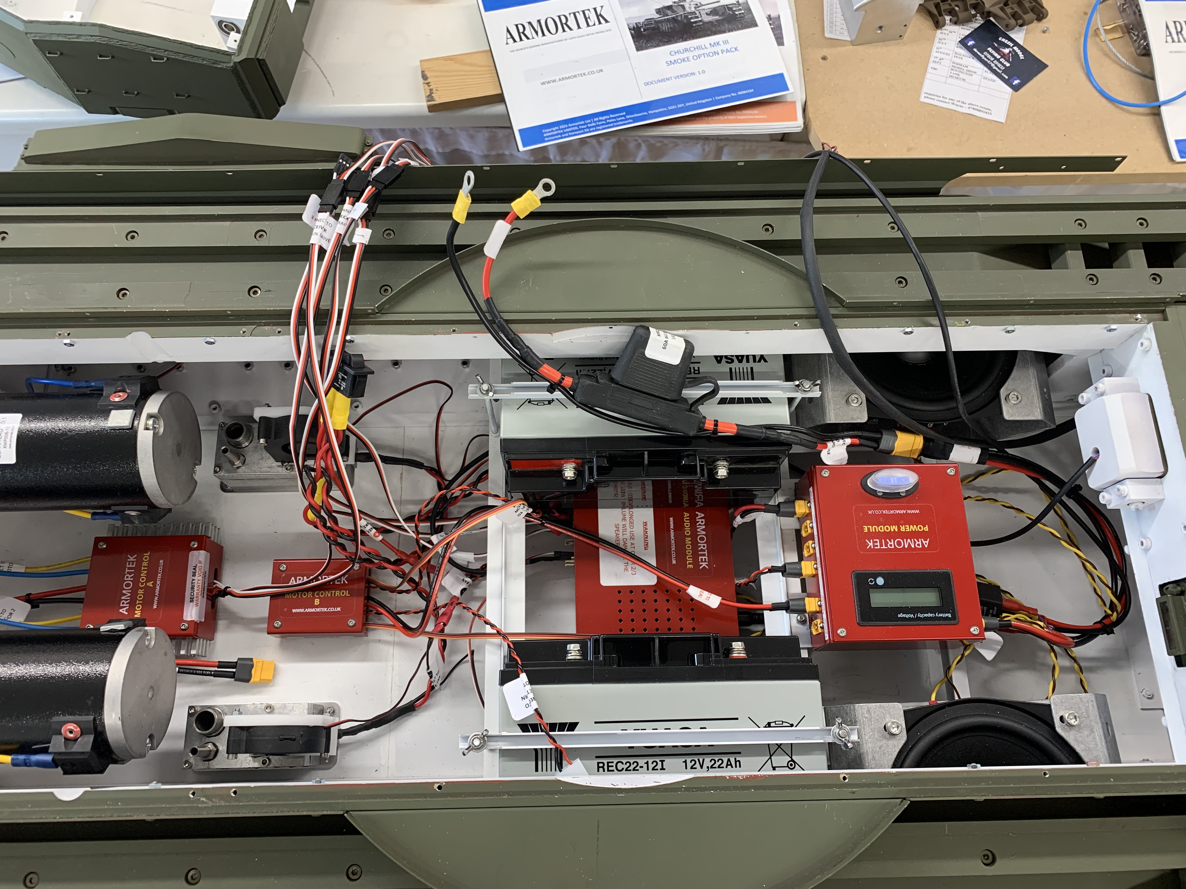

After a short break I have cracked on with the module installations. Putting the batteries in the panniers has given enough space to allow me to use the front hatches for the derrick connections I will need later. The on/off switch and smoke switch will go under the exhaust deck hatches.
Still a bit to do as the main power lead from module A to the power module needs extending plus I will fit the FAS100 to monitor the battery conditions.
I have started the wiring loom for the lights which will be controlled via a 12v regulator and electronic switch from the receiver.

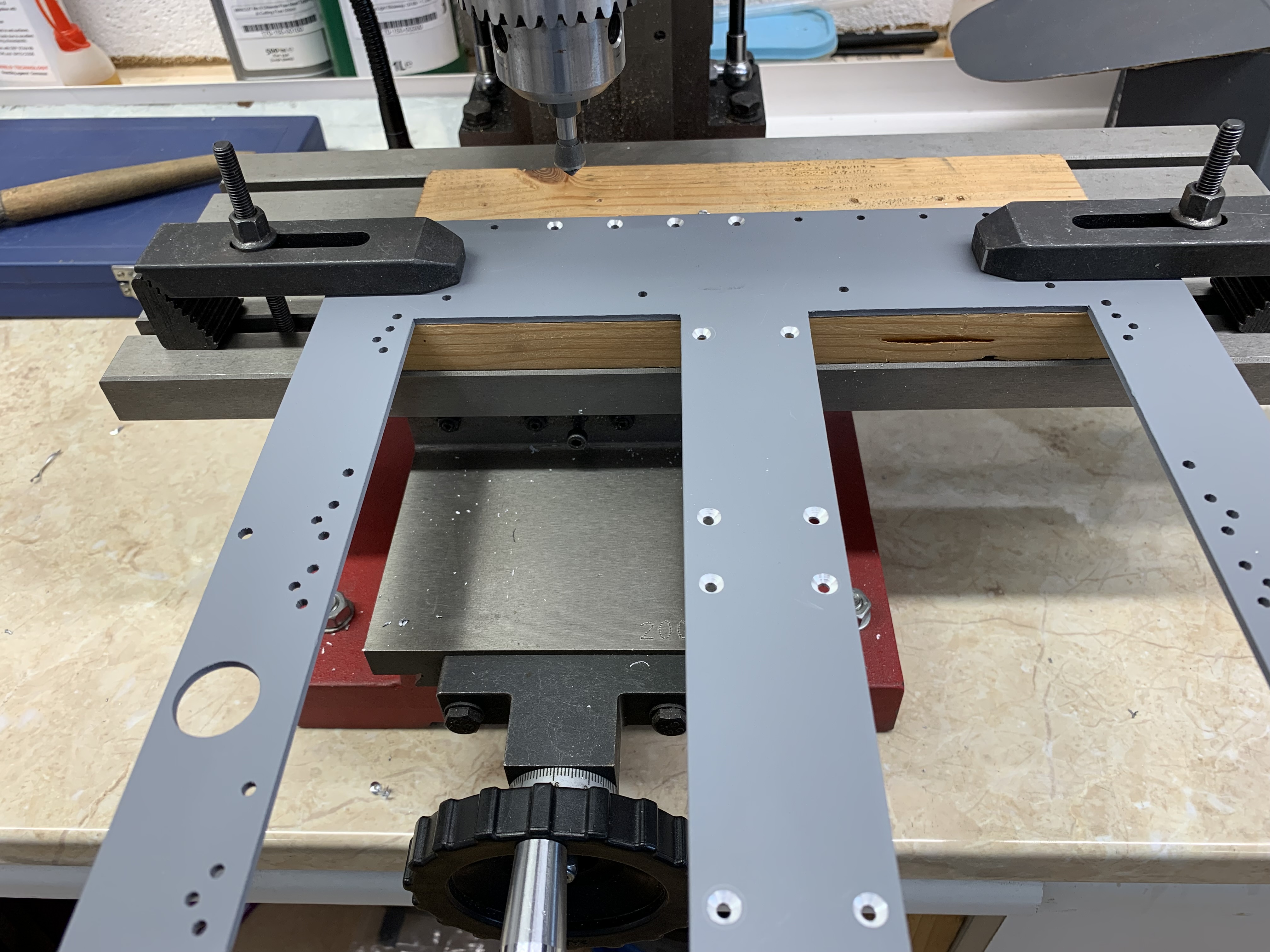

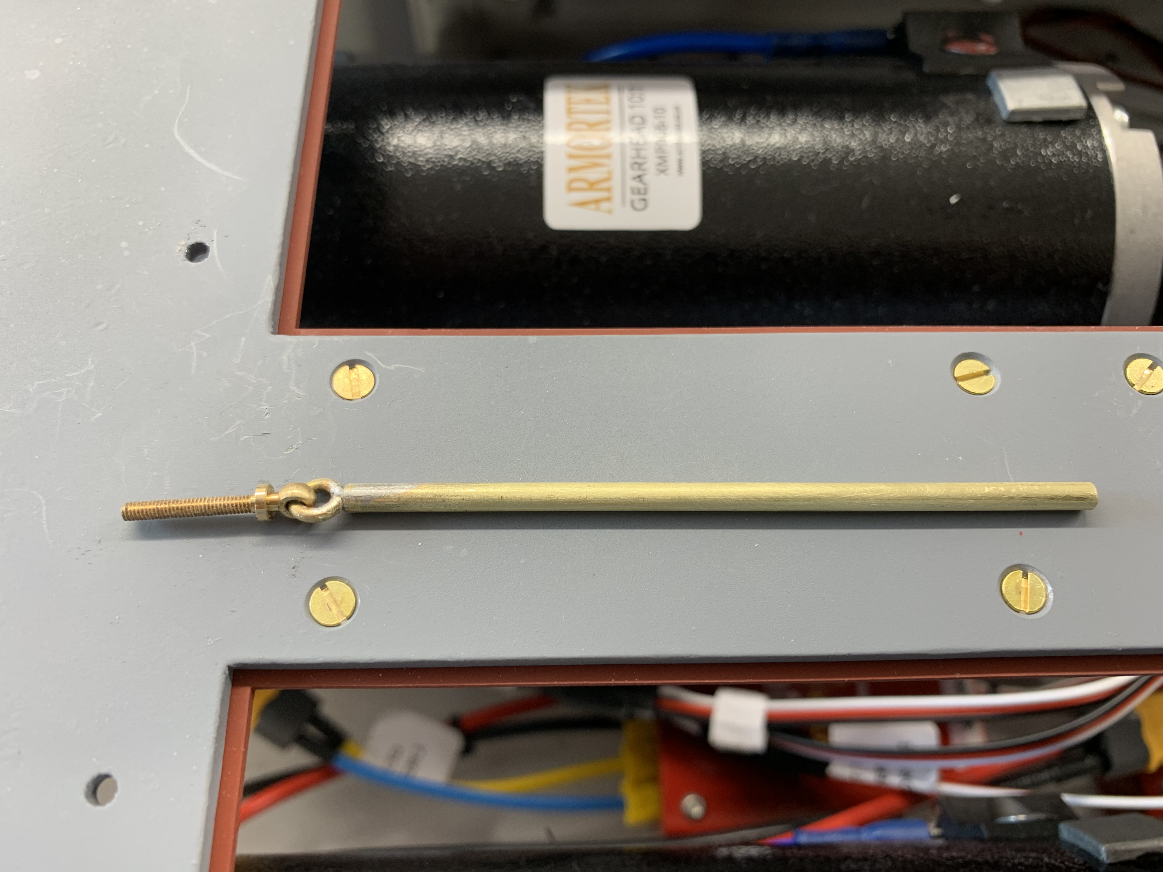

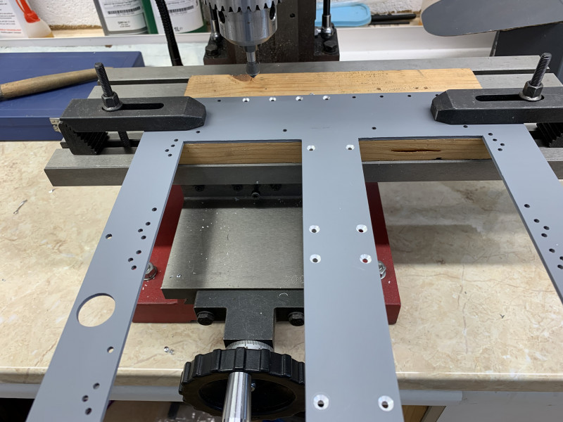

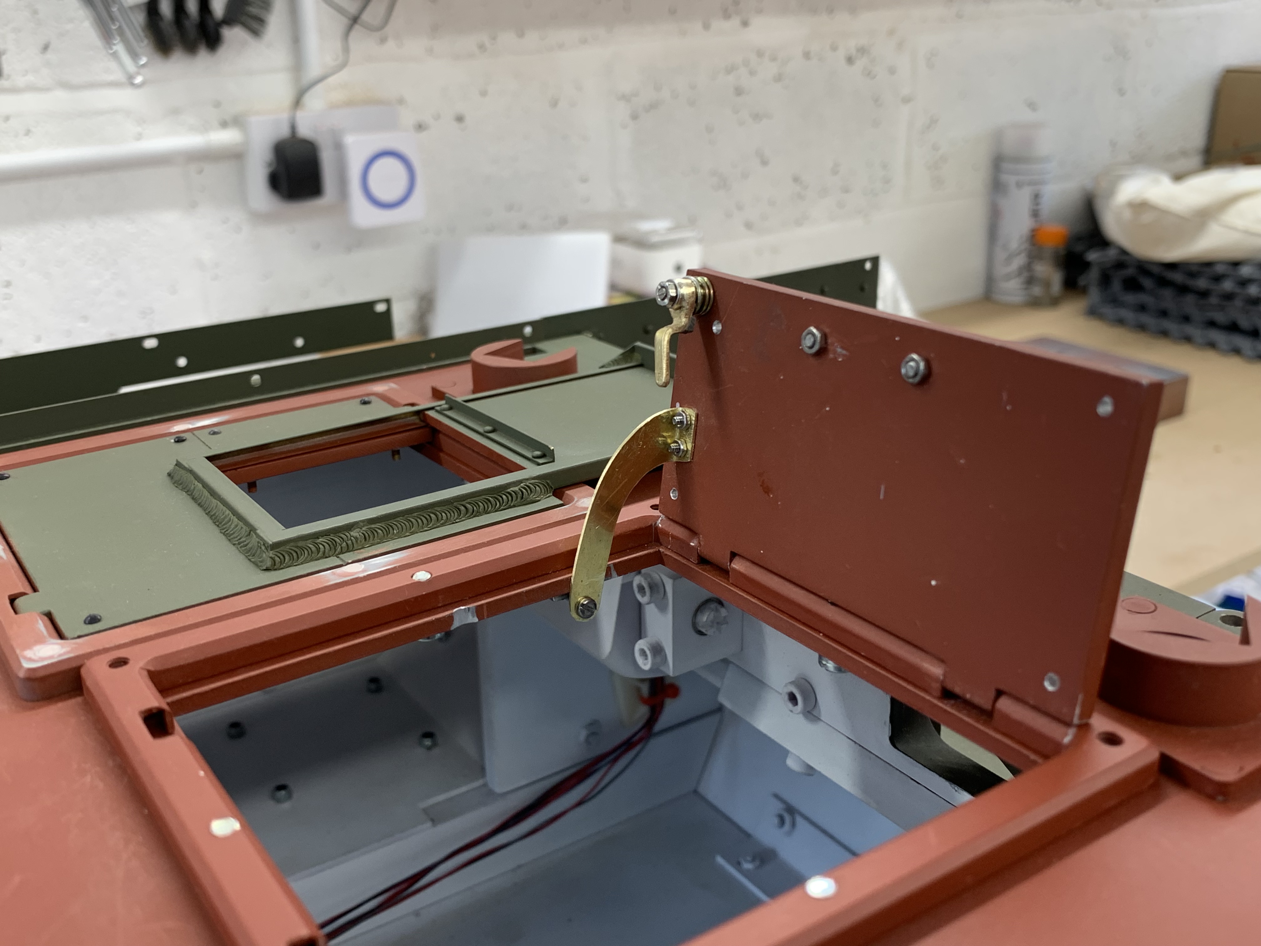

While a await some XT60 connectors to arrive to extend the power to the drive module I decided to get the mid deck assembled. I am hoping to be able to place the on/off and smoker switch under one of the hatches. I checked some photos of the MK 3 AVRE at the Tank Museum and will use countersunk slotted 2.5mm screws instead of the button heads and hex bolts shown in the manual. This requires quite a few holes to be countersunk
in the mid deck plate. I used the stop on my mill to ensure the countersinks were all the same depth and the screws are flush with the deck. I will also be adding the four stays that keep the hatches open, they are held along the centre line of the deck and I have started to make one just to get an idea what will be required. I will try and get some decent photos when I go to Tankfest as the ones I have are lacking detail/partially obstructed.
The smokers have been bolted in place albeit using the edge holes so nearer to the tank sides than in the manual. I need to work out how to attach the tubing to the exhaust in such a way the mid deck can still be easily removed. Having had an oil spill in the Tiger, partly due to a tube working loose, I want to ensue the Churchill smoke system if completely sealed.
