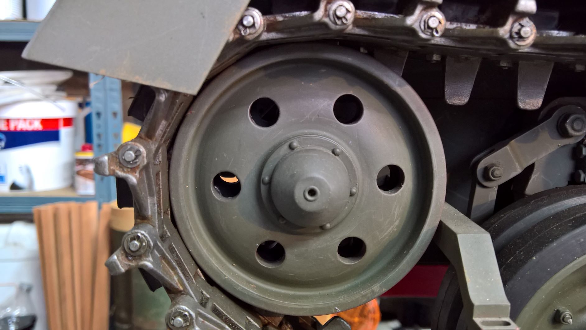

Hi John.
I will have a proper look at mine tomorrow, like Richard's mine too have been run, maybe an 1hr if that. I did note my tracks are fitted/set nicely around the idler, no gap.
As I will hopefully be starting to put the electrics in the tank, testing it all, I will take the tracks off and have a closer look.
Cheers Charles

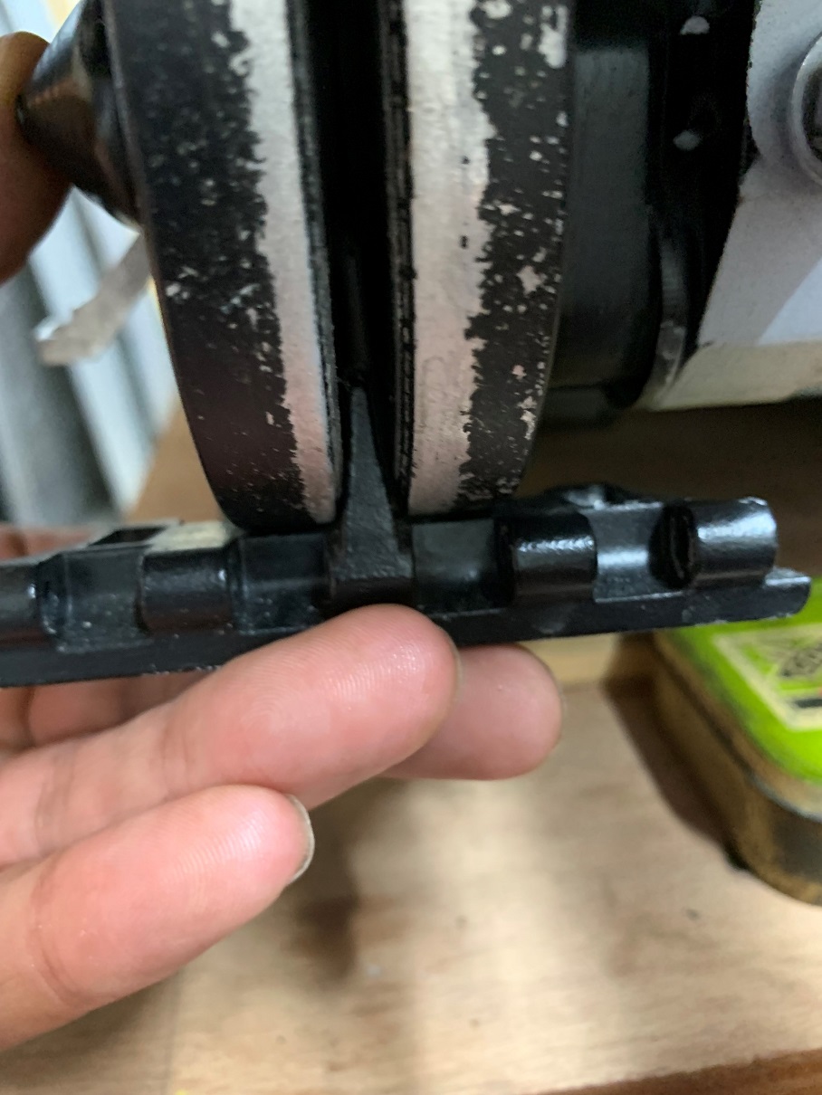

Thanks for the picture Richard, Would the track sit flat if pitched forward. If I pitch mine back they flatter onto the wheel, I can't expect that once the tracks are connected to each other. The wear on the paint doesn't look even either, which could mean the wheel have been prised apart fractionally lifting the outer edge of the wheel off the track.
I suppose they'll bed in sooner or later.
I still think my horns are going to be getting a tickle from the grinder. May even lighten them up a bit i shouldn't wonder too

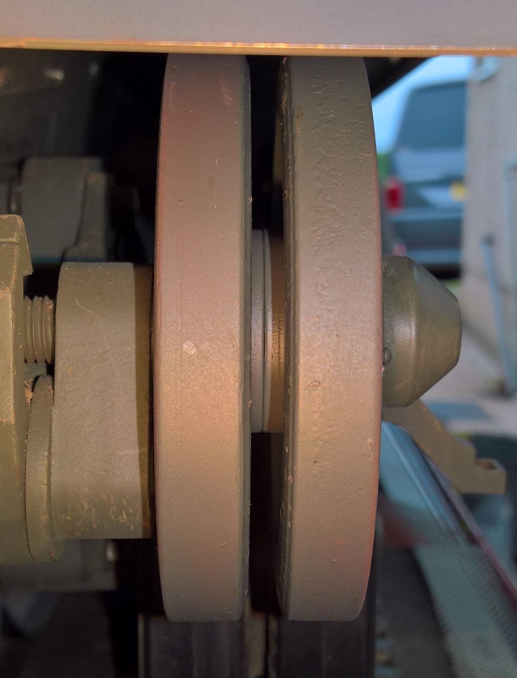

Hi John,
Well spotted, checked mine and they have the same clearance problem. I suspect that there is enough play in the bearings to allow the two idler wheel halves to splay apart, which is why it’s not really showing up as an obvious problem on the running models. Regarding a solution though, faced with either potentially weakening the horns on 200+ track links or taking a light skim off the inside faces of 2 idler wheels, I know which one I will be trying first.

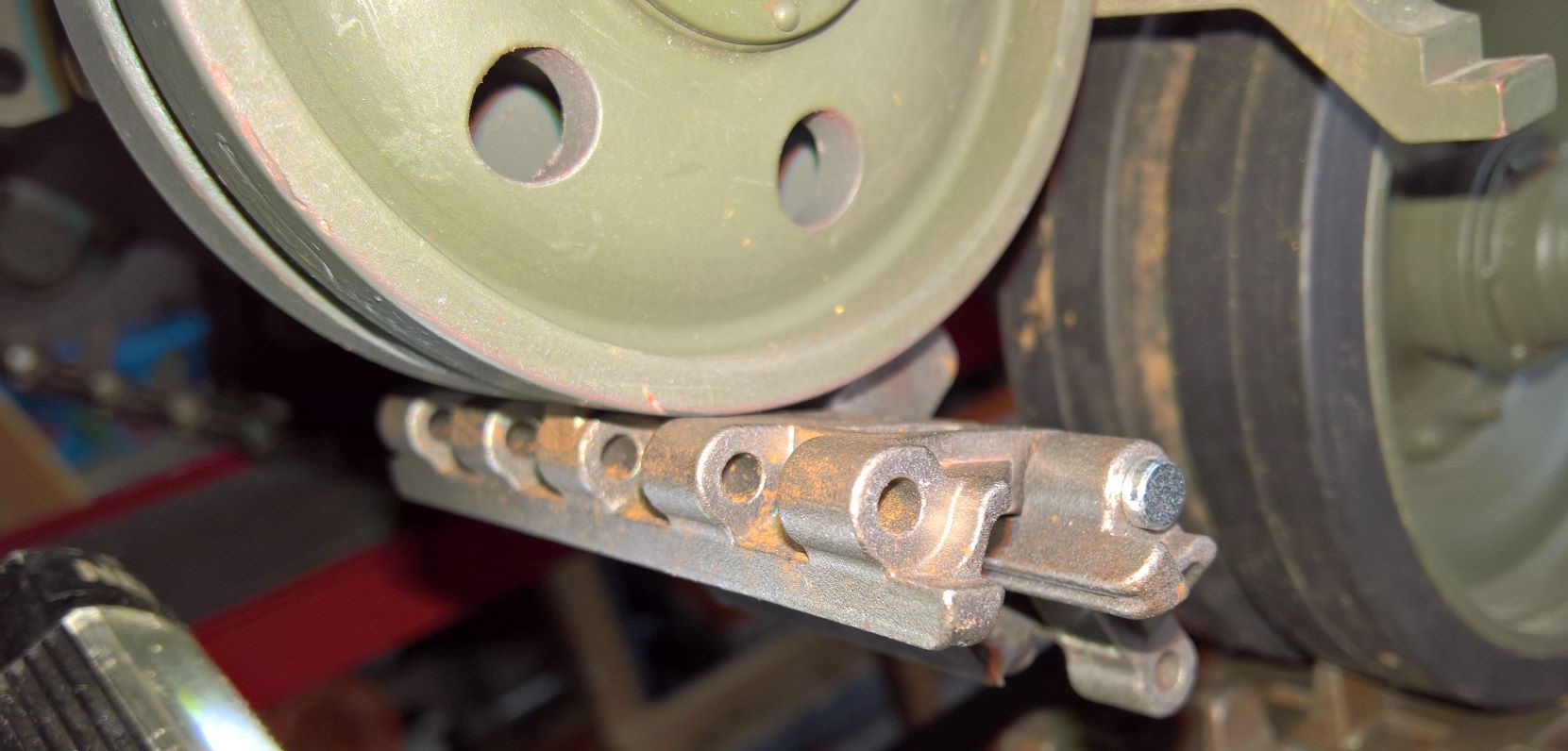

Good evening all.
I John hope the photos help, before you embark on another grinding session!
I dismantled all the wheels & suspension after the Sept 2020 mud bath, so idlers have been repainted(they will get another coat now the tracks are off). As i said earlier perhaps an hour of running.

- Posts: 1691
- Been liked: 1839 times
Thanks for the pictures Charles, the paint work looks marvellous.
I would like to ask, if you were to roll the track link inwards on the leading edge, does the track stay in contact with the wheel.
I can pitch my track backwards and the gap closes.
From my point of view, the connected track should rotate around the idler wheel with the leading edge and the trailing ideally having equal pressure all the way round idler
I don't mind giving the horns a grind. Anything that will ensure a smooth track motion from first push of the stick.

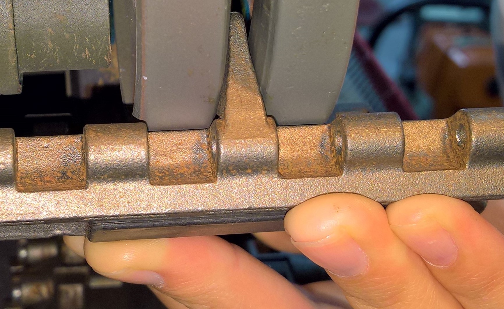

Hi John.
I hope this is what you are after, I found the horn a push fit but in contact with the idler. As there is wear on the idler, I think I will continue to drive around slowly and allow things to bed in, I hope that dosen't sound to thuggish.
Cheers Charles

Thanks Charles, excellent pictures. They confirm what I thought.

Well it's been a Good Day to Grind Hard Richard.
Taking the heavy tracks to the operating table outside. A couple of flap wheel disks made short work of the slight thinning of the horns, that now pass majestically though the idler wheels with out restriction or premature wear on the idler.
Certainly an easier mod than the clipping of the horns and it should aid the initial setup of the track tension.
Something I'm wary of due to the closeness of the track line to the gear box outer casing. A slack track could start attacking said casing.
